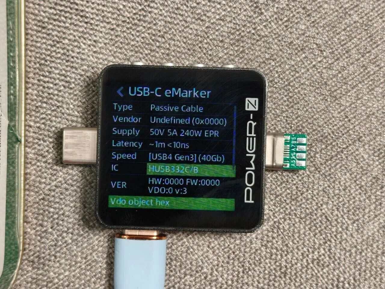

POWER-Z KM003C tester adds another new compatibility milestone! It now successfully supports the Hynetek HUSB332B chip. Cables equipped with this chip can be quickly identified through the device’s E-marker reading function, with related chip information displayed clearly and intuitively.

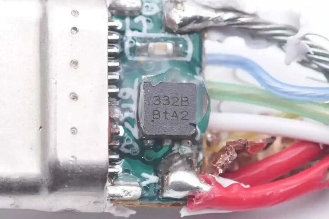

The E-Marker chip mounted on the terminal PCB is marked “332B,” while its actual model is HUSB332B. This new chip is the industry’s first USB Type-C eMarker chip to pass the USB PD3.1 eMarker Silicon certification test, and it also supports the Thunderbolt 3 specification.

After upgrading the POWER-Z KM003C to the latest firmware, users can perform chip identification tests through the E-marker reading function.
