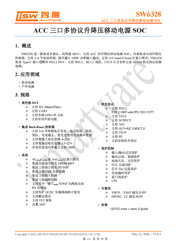

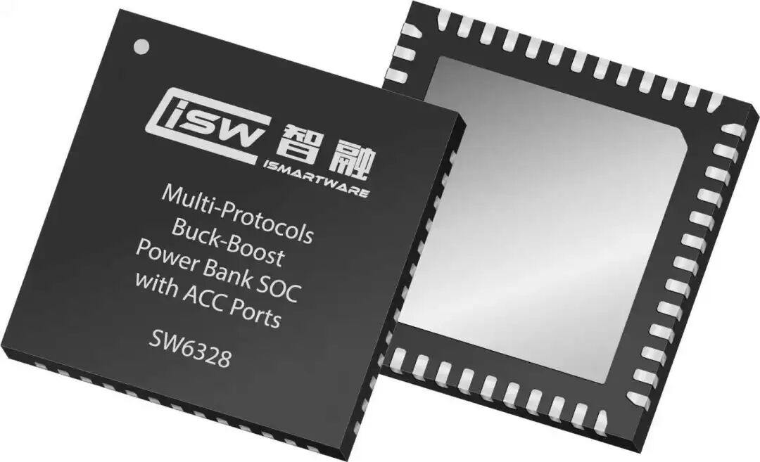

Tailored for new national standards and outdoor power stations, the SW6328 is an A+C+C three-port multi-protocol buck-boost SoC. It packs a high-performance MCU, bidirectional buck-boost controller, and fast-charging PHYs directly onto the silicon. Supporting 2 to 6 series cells of ternary lithium, LiFePO4, or sodium-ion batteries, it handles up to 100W of charge/discharge power. On the protocol front, it natively integrates dual independent DPDM and PD PHYs with hardware-level UFCS and PD3.2 support. UFCS output hits up to 100W—scalable to 140W—with direct drive capabilities for vibrant TFT color displays. Additionally, a built-in hardware coulomb counter supports self-learning battery capacity alongside multi-channel high-precision ADC temperature sensing, effortlessly meeting safety and thermal rules like IEC62368. With comprehensive hardware protections including a >30V VBUS tolerance, the SW6328 slashes external discrete component counts, lowering BOM expenses and speeding up time-to-market.
