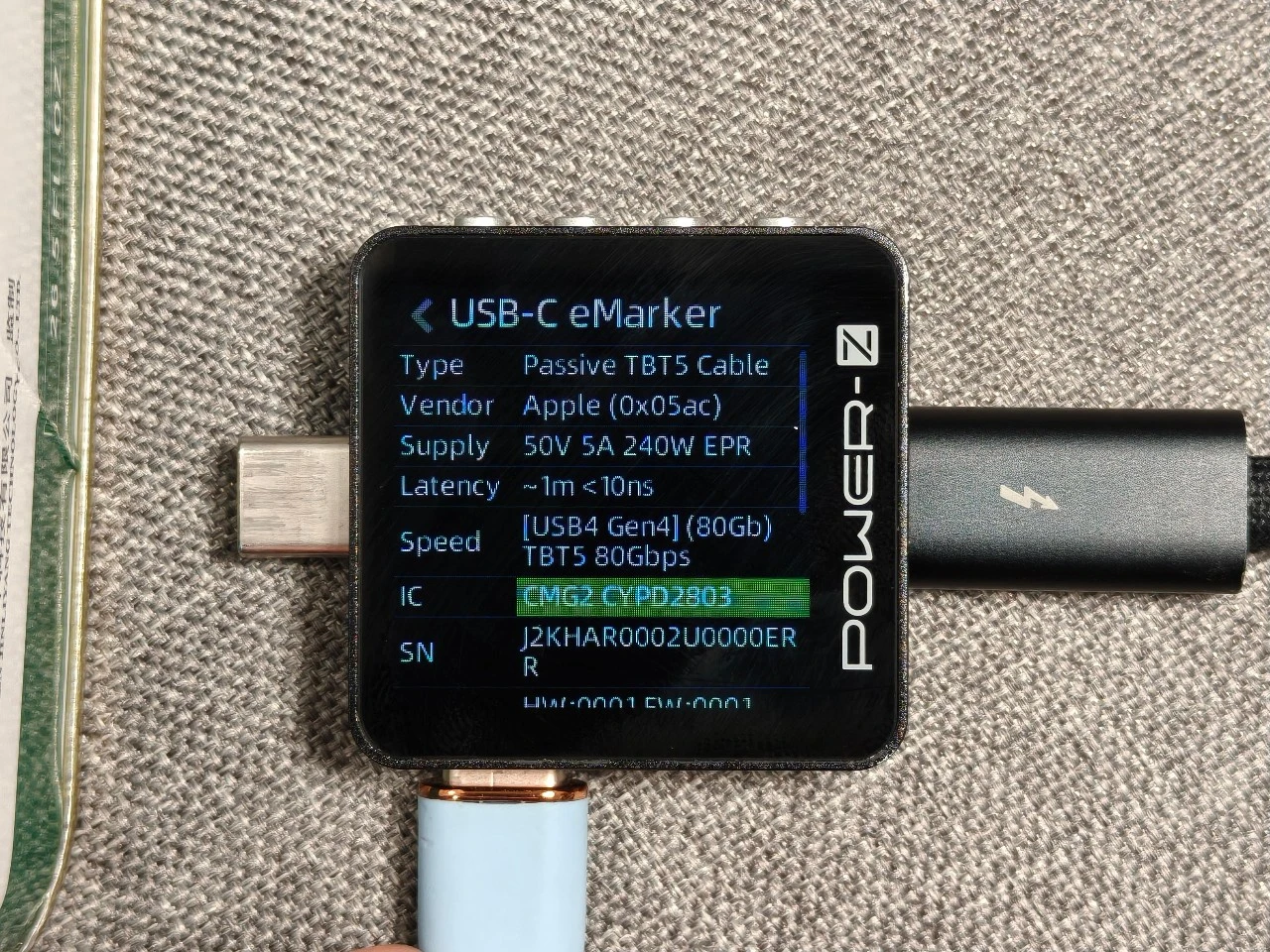

POWER-Z KM003C tester adds another major compatibility milestone! It now successfully supports the Infineon CMG2 CYPD2803. Cables equipped with this chip can be quickly identified through the device’s E-marker reading function, with related chip information displayed clearly and intuitively.
Also Read: E-Marker Test for High-End Thunderbolt 4 and Magsafe 3 Cables | The New Update of POWER-Z KM003C
ChargerLAB POWER-Z KM003C E-Marker Detection Now Supports CYPD2803-Chargerlab
In the recently released V2.0.0 firmware, the KM003C introduced industry-first cable IC solution identification on top of its existing E-marker reading capability. Without any destructive operations such as cutting or stripping cables, users can now accurately identify the built-in chip solution inside a cable with a single click, clearly displaying core configuration details for efficient cable quality inspection and solution verification.

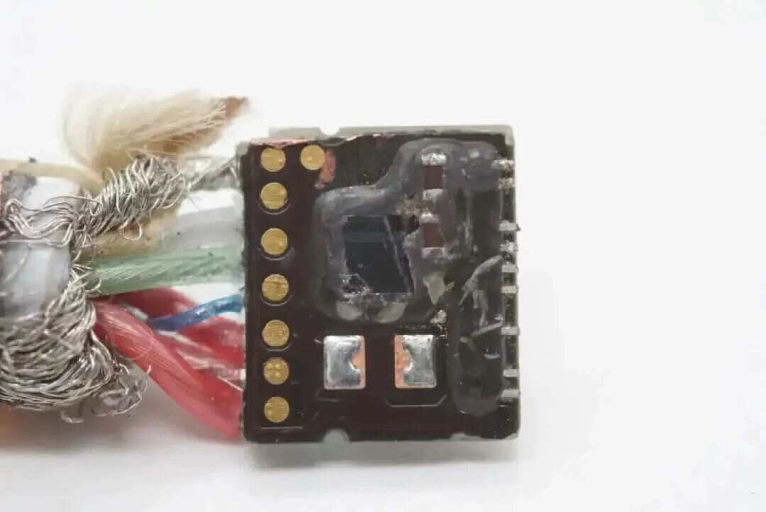

ChargerLAB has also conducted a teardown of cables using the Infineon CMG2 CYPD2803 chip before, which you can check out for more details.
Also Read: Teardown of Apple 240W USB-C Charge Cable (A2794)
