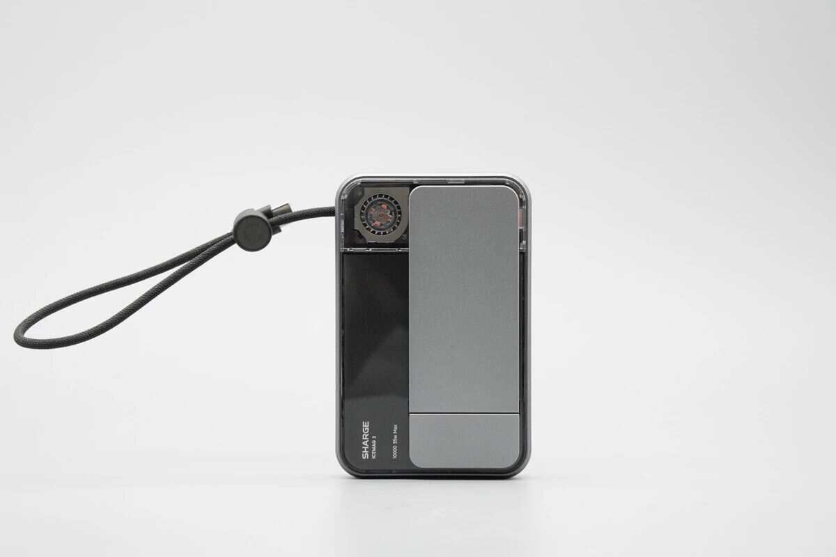

The protocol detection feature of the POWER-Z KM003C tester has been adapted to the SHARGE ICEMAG 3 power bank. It can accurately read the fast charging protocols of the entire device. In actual testing, compatibility was stable, and the data reading was complete and reliable. This power bank supports dual output through a Type-C port and a built-in cable.

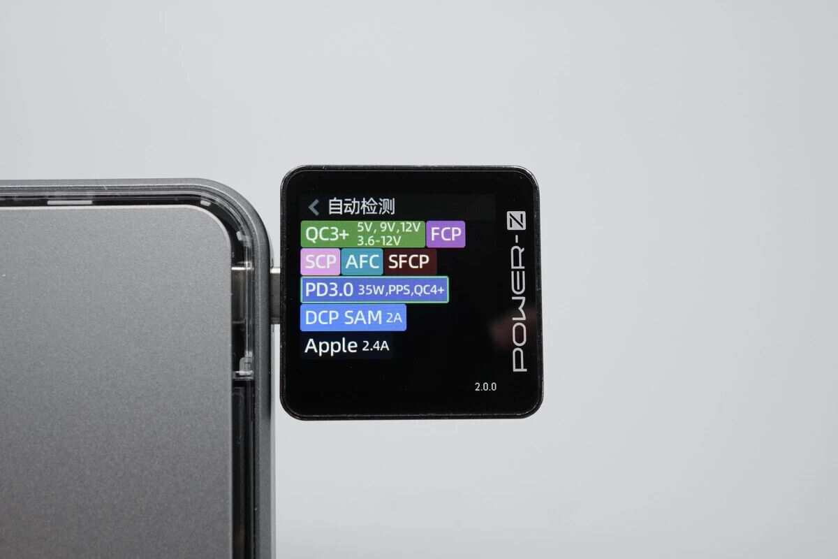

ChargerLAB POWER-Z Reveals the Fast Charging Protocols of the SHARGE ICEMAG 3 Power Bank-Chargerlab
The KM003C shows that the Type-C port supports mainstream fast charging protocols, including QC3/4+, FCP/SCP, AFC, SFCP, PD3.0, PPS, DCP SAM 2A, and Apple 2.4A.

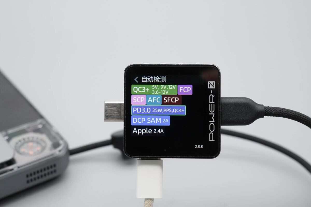

In addition, the built-in cable supports mainstream fast charging protocols, including QC3/4+, FCP/SCP, AFC, SFCP, PD3.0, PPS, DCP SAM 2A, and Apple 2.4A.

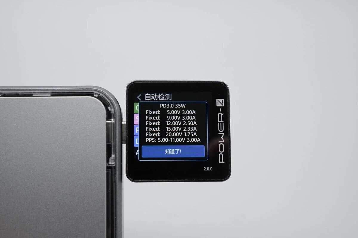

In terms of PDOs, the Type-C port has five fixed PDOs of 5V3A, 9V3A, 12V2.5A, 15V2.33A, and 20V1.75A. It also supports a 5–11V3A PPS voltage range.

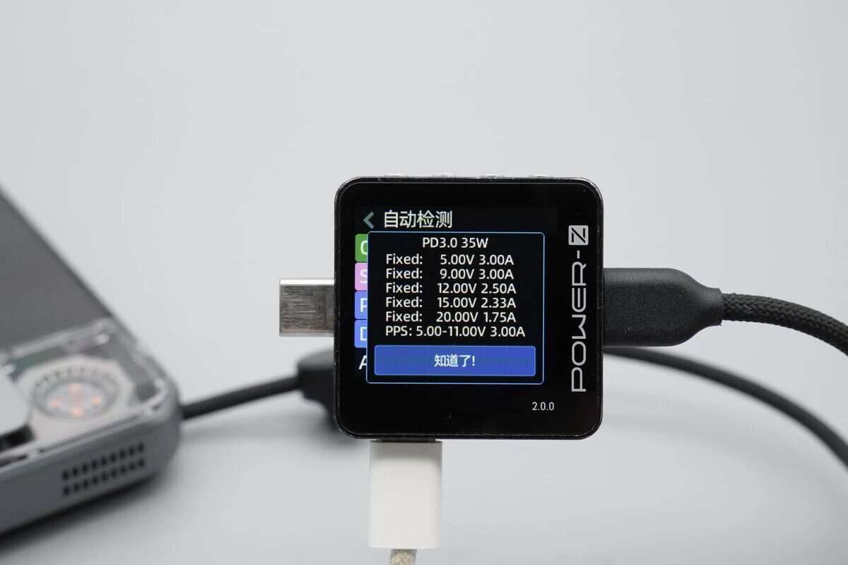

The built-in cable also has five fixed PDOs of 5V3A, 9V3A, 12V2.5A, 15V2.33A, and 20V1.75A. It also supports a 5–11V3A PPS voltage range.
