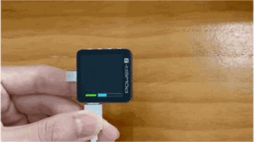

As shown in the gif, when you hold the back button while powering the tester, it will force the device into DFU mode. There are two solutions to this.
How to Exit DFU Mode on Your ChargerLAB POWER-Z KM003C-Chargerlab
Method 1: Disconnect the KM003C, then plug it back into the charger after it has completely powered off. This should restore normal operation. If it doesn't exit DFU mode after re-plugging, use the following method.
