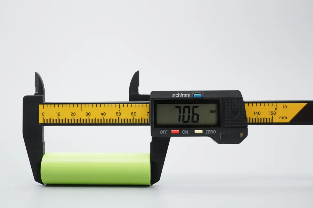

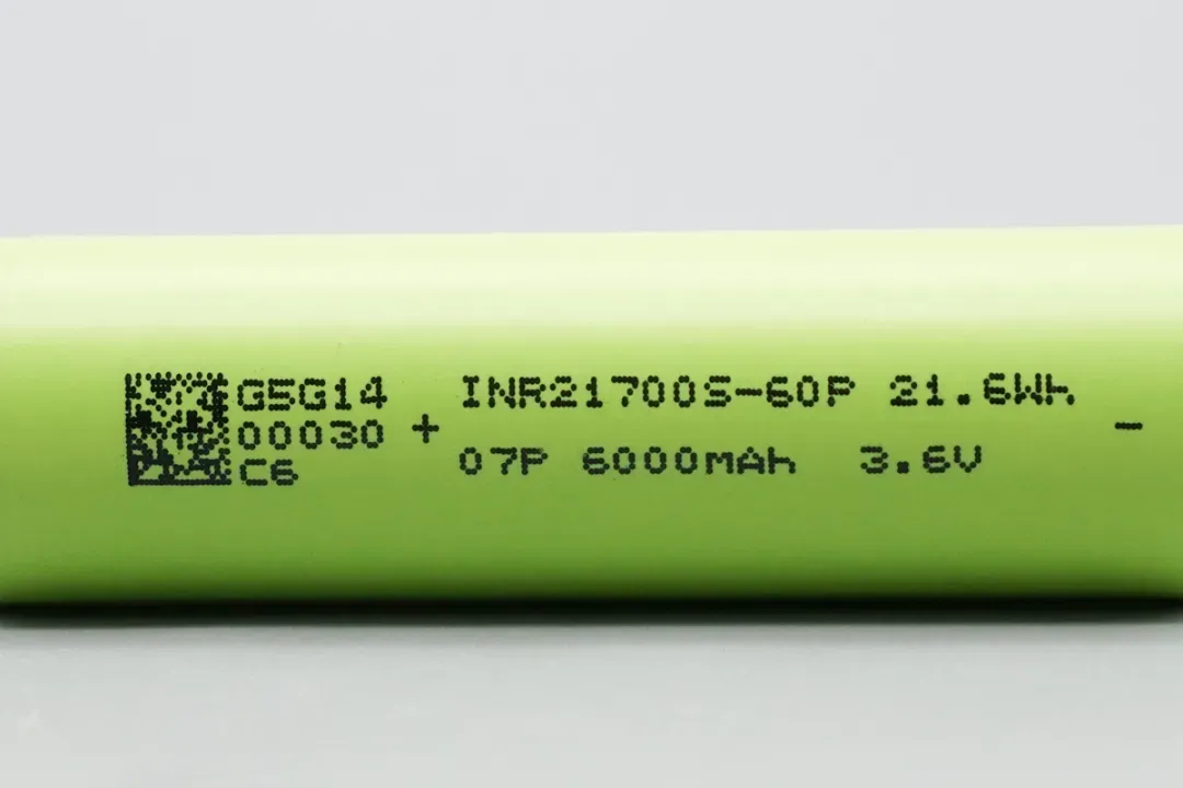

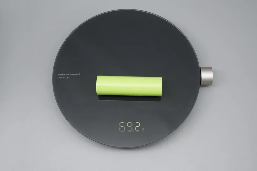

The robust performance of the CEGN INR21700S-60P comes down to its refined internal architecture and advanced manufacturing. Wrapped in a cyan heat-shrink sleeve, it measures approximately 70.6mm × 21.4mm and weighs in at 69.2g.

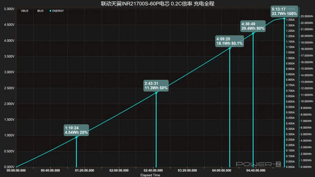

Test results show that internal resistance at both full (4.2V) and depleted (2.5V) states sits between 3.3mΩ and 3.7mΩ—well outperforming the 4.5mΩ rating. For charging, it seamlessly handles 2C (12A) high-current input and has passed the ChargerLAB "2050" fast-charge protocol, hitting 50% capacity in just 16 minutes and a full charge in 41 minutes.

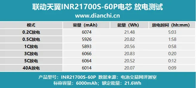

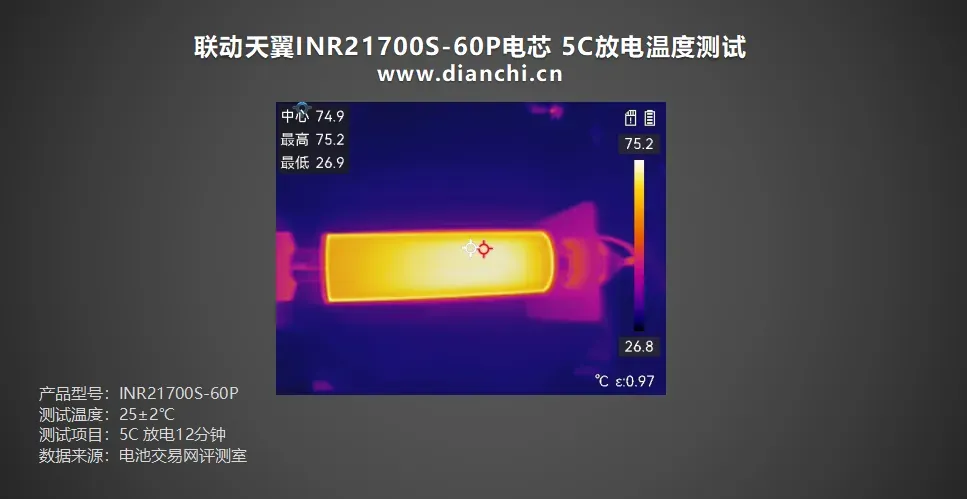

Under punishing discharge regimens ranging from 0.2C up to 5C (30A) and 40A, delivered energy stays steadily above 20Wh across all levels. Even when subjected to a brutal 40A continuous limit draw for 7 minutes, surface transient temperature spikes are restrained at 87.8°C—showcasing a high-rate current tolerance and thermal safety margin rarely seen in such high-capacity cells.
