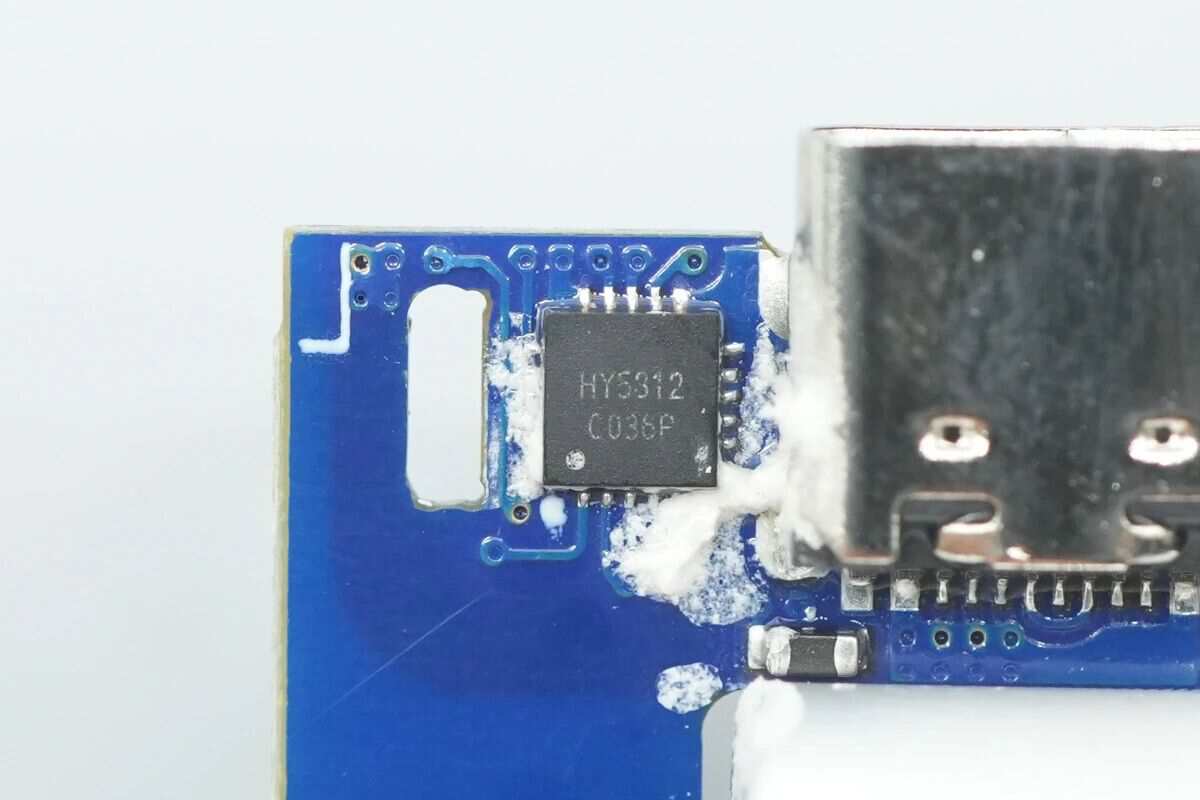

ChargerLAB has also recently completed teardowns of chargers using the HYASiC HY5312 chip for those interested in learning more.

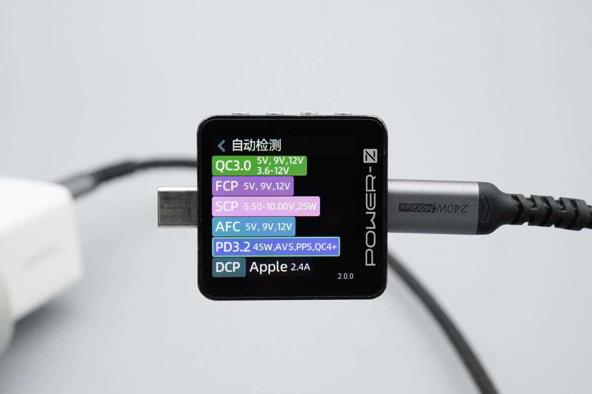

Using the ChargerLAB POWER-Z KM003C, the UGREEN Nexode Air 45W GaN Charger was confirmed to support QC3.0/4+, FCP, SCP, AFC, PD3.2, PPS, DCP, and Apple 2.4A charging protocols.

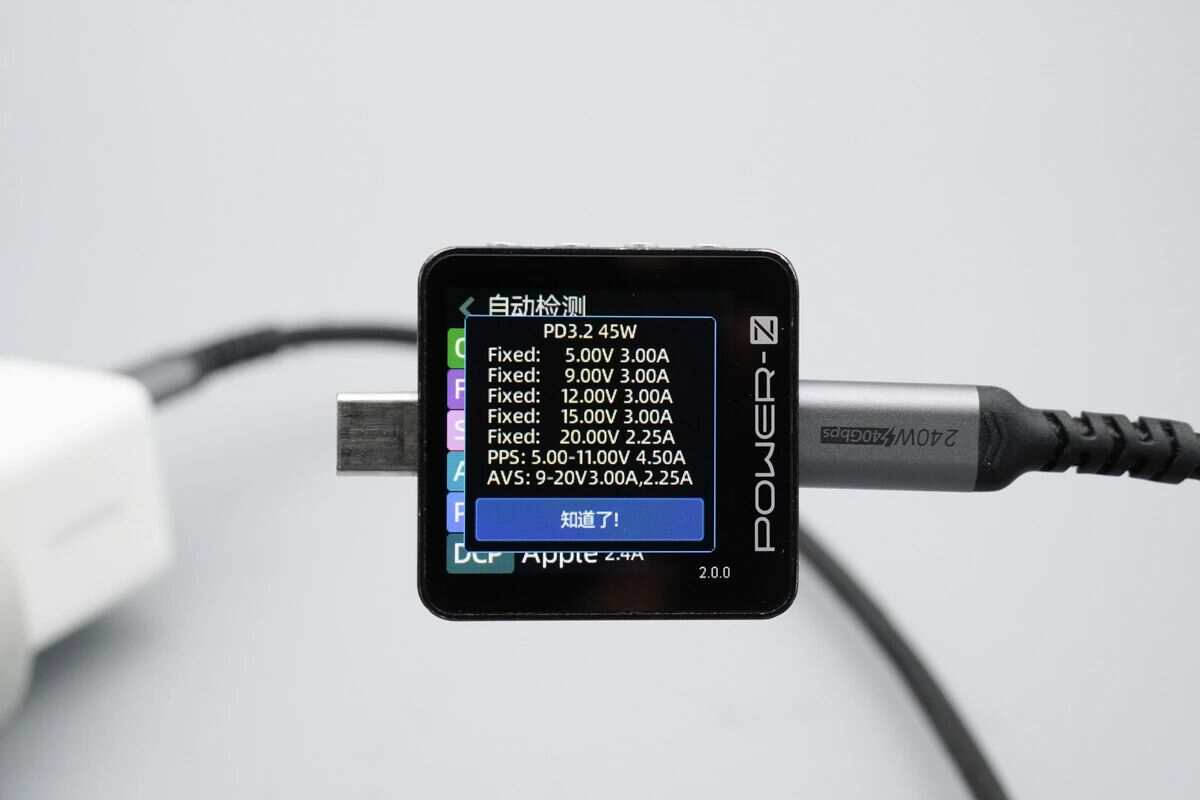

And it has five fixed PDOs of 5V3A, 9V3A, 12V3A, 15V3A, and 20V2.25A. It also supports a 5–11V4.5A PPS voltage range, as well as 9–20V3A and 2.25A AVS voltage ranges.
