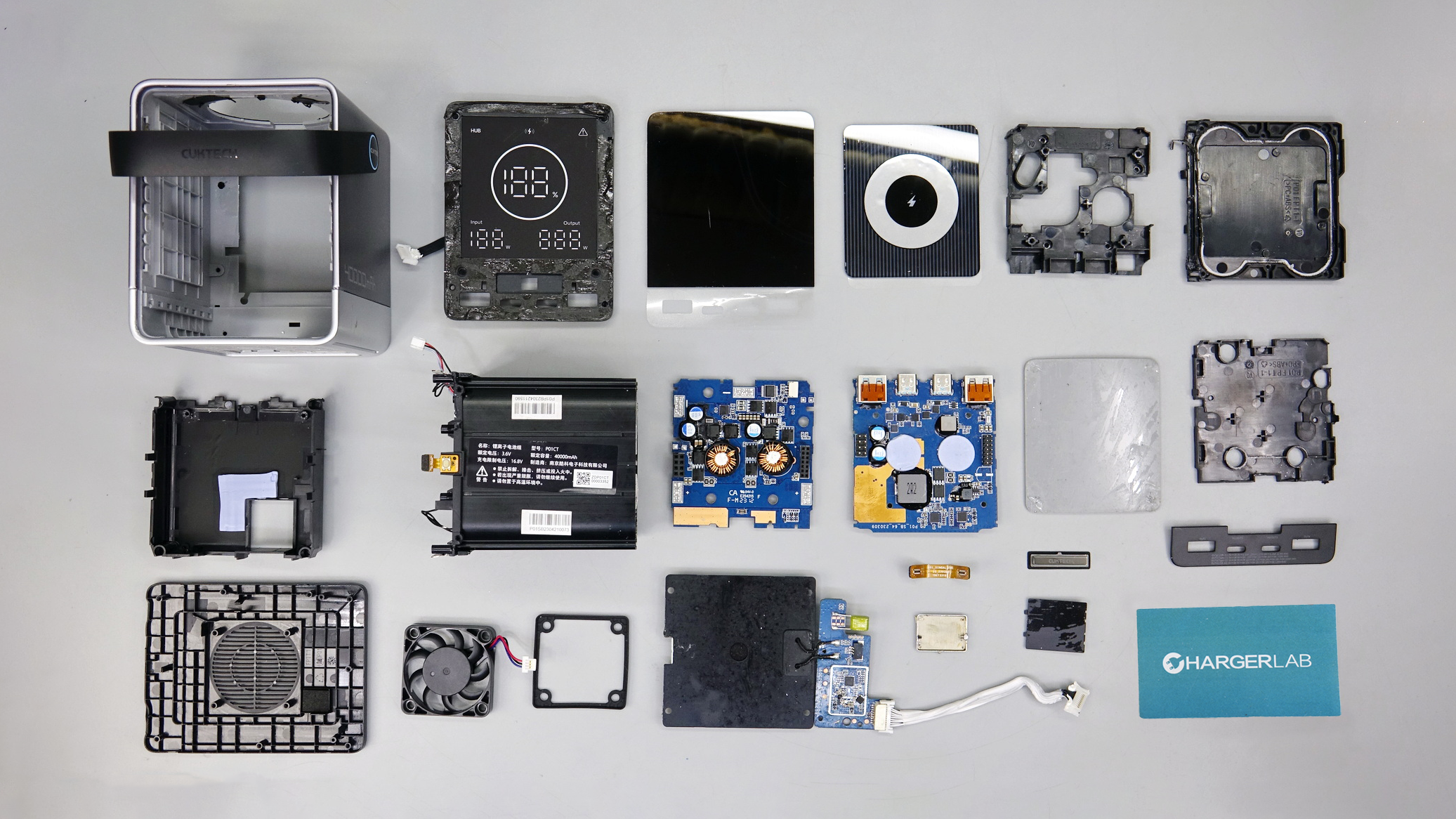

Next, let's try to take apart this power bank from the front panel.
Teardown of CUKTECH No.30 PD3.1 & 300W Power Bank (P01CT)-Chargerlab
The display is fixed with double-sided tape and screws.
Remove those screws.
And disconnect the front panel from the battery.
The solder joints are covered with silicone adhesives.
Most of the internal space is occupied by the battery pack. The model is P01CT, and the rated voltage is 3.6V.
The top wireless charging area is also fixed with double-sided tape and screws.
Tear off the silicone pad at the bottom.
Here is the connector of wireless charging module.
Then, take out the entire battery pack.
We can see the cooling fan inside.
Continue to remove the remaining screws.
And separate the cooling fan.
First, let's introduce the PCBA module for wireless charging.
The charging circuit is under the metal shield.
During the teardown of the metal shield, the components' positions were accidentally disturbed due to excessive temperature.
The wireless power transmitter is from NuVolta, model is NU1705. It integrates many critical functions, such as a full-bridge power stage, a 32bit MCU core, low-EMI drivers, bootstrap circuit, as well as multiple protection functions.
Here is all the information about NuVolta NU1705.
The MOSFET is from Toshiba. 30V 6.8mΩ. Model is TPCC8104.
The resonant capacitor is coated with yellow resin.
Next, let's remove all screws that fixed the battery pack.
And then, clean up the potting compound.
There're eight Samsung 21700 batteries inside, which are fixed by the plastic frame. Two sets of four batteries connected in series are connected in parallel.
Then, let's check the other side. There's a thermal pad inside the cover.
And the PCBA module is fixed inside the frame by screws.
Then, separate those two parts. It consists of two layers, connected by two sets of pins for higher space utilization.
And nickel strips of the battery pack are connected to the lower PCB.
This is the power button, with a TVS for electrostatic protection.
The voltage of the battery pack is about 16.6V.
The lower PCB is also fixed in a black frame.
After removing it, we can see those nickel strips.
We even found the outer case adopts aluminum alloy after scraping off the black paint.
Then, let's go ahead and introduce all components one by one.
The battery protection chip is from Cellwise, model CW1244, which supports 3-4 lithium batteries connected in series and multiple battery protection functions.
Those two MOSFETs for battery protection are from AOS and adopt DFN5 x 6 package. 30V, 2.75mΩ. Model is AON6354.
Two 2mΩ resistors are connected in parallel to detect the current of the battery pack.
The buck-boost controller is from Southchip SC8815, used to convert DC input voltage. It can control the charging of the battery pack and USB-C output.
Here is all the information about the Southchip SC8815.
The synchronous buck-boost MOSFET is from AOS and adopts DFN5 x 6 package. 40V, 5mΩ. Model is AONS66406.
The 5mΩ resistor is used for current sensing while also providing overcurrent protection.
Those two solid capacitors for output filtering are connected in parallel, and used for the 140W output.
35V 100μF for each.
For the 100W output circuit, two MOSFETs for battery protection are the same model as the 140W circuit.
And this solid capacitor is from CapXon. 100μF 25V.
These six MLCC capacitors are connected in parallel.
The buck-boost controller for 100W output is also from Southchip SC8815.
These six MLCC capacitors are yet again connected in parallel.

Well, that's all components of this CUKTECH No.30 PD3.1 & 300W Power Bank.
Well, as the world's smallest 300W power bank, this device can be seen as a miniature version of a portable power station, offering impressive power capacity in a compact size. It is particularly suitable for Apple laptop users, Xiaomi smartphone users, DIY enthusiasts, as well as people who prioritize portability without the need for AC power while on the go.
After taking it apart, we found it consists of eight battery cells, two stacked output PCBs, wireless charging module, and a cooling fan. The compact and robust internal structure ensures efficient and reliable performance. With the top handle, this power bank allows you to easily carry it wherever you desire. However, it is important to note that due to aviation regulations, this power bank cannot be taken on a plane.
