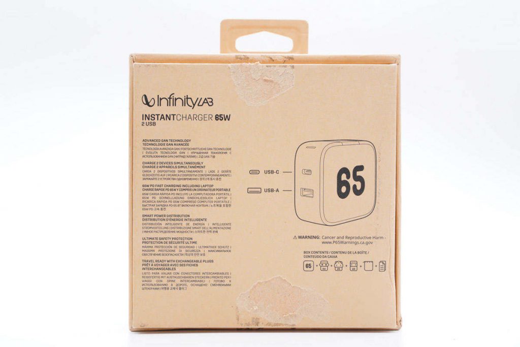

Turn to back. We can see the specs and other info.
Teardown of Harman Kardon InfinityLAB 65W GaN Charger (ILINC65W)-Chargerlab

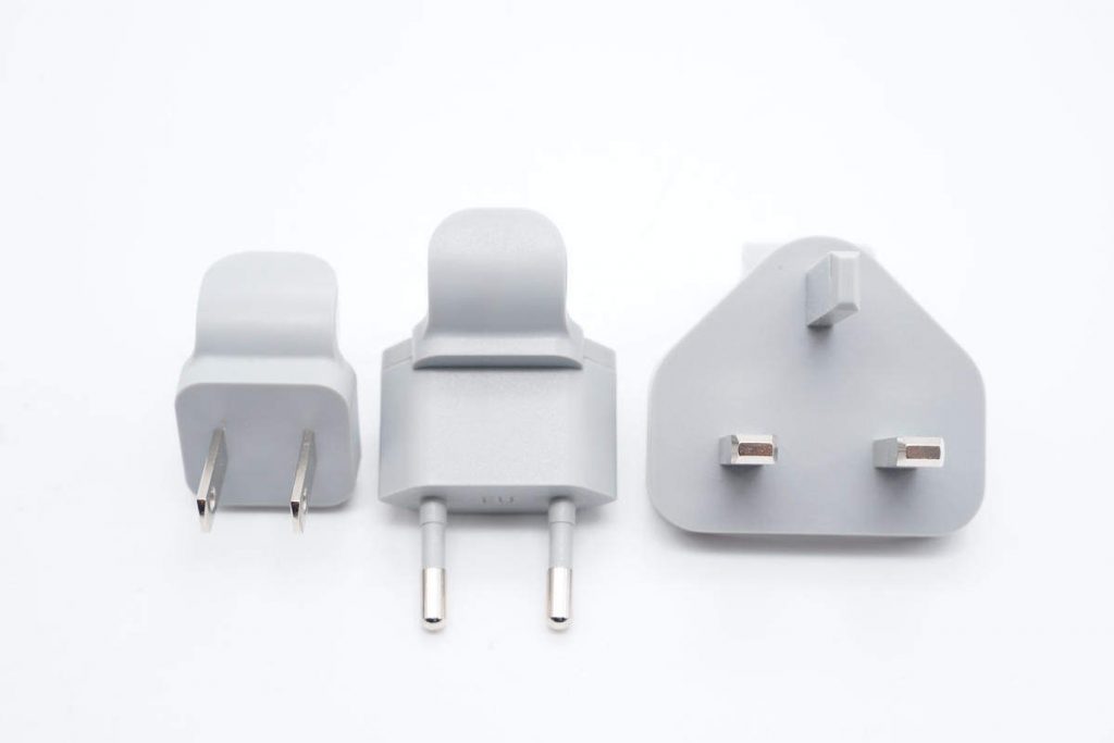

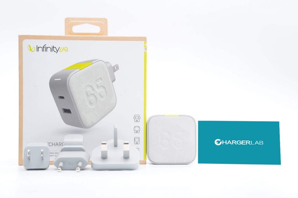

Open the box. It contains a charger and three different plugs.
 They’re the US, EU, and UK plug, respectively.

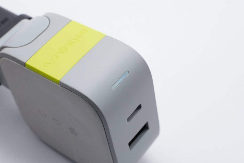

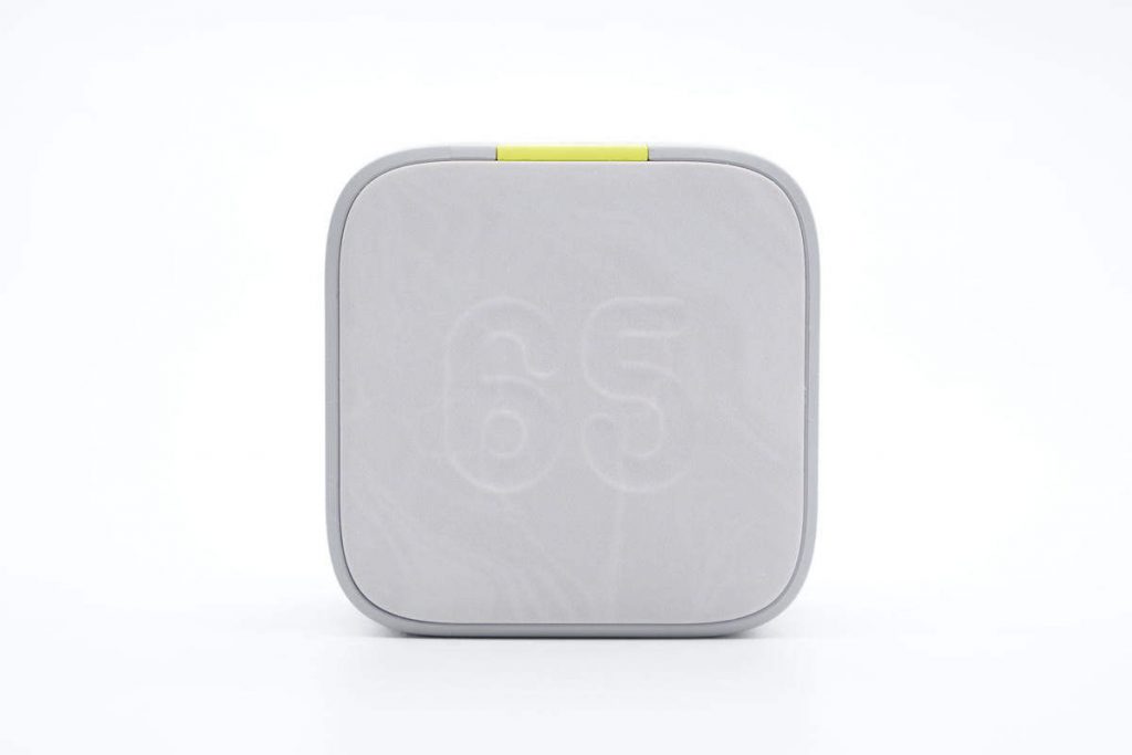

The charger adopts the rounded rectangle design, with a yellow bar on the top.
We can see “65” on the front of the charger, indicating that this charger can support 65W.

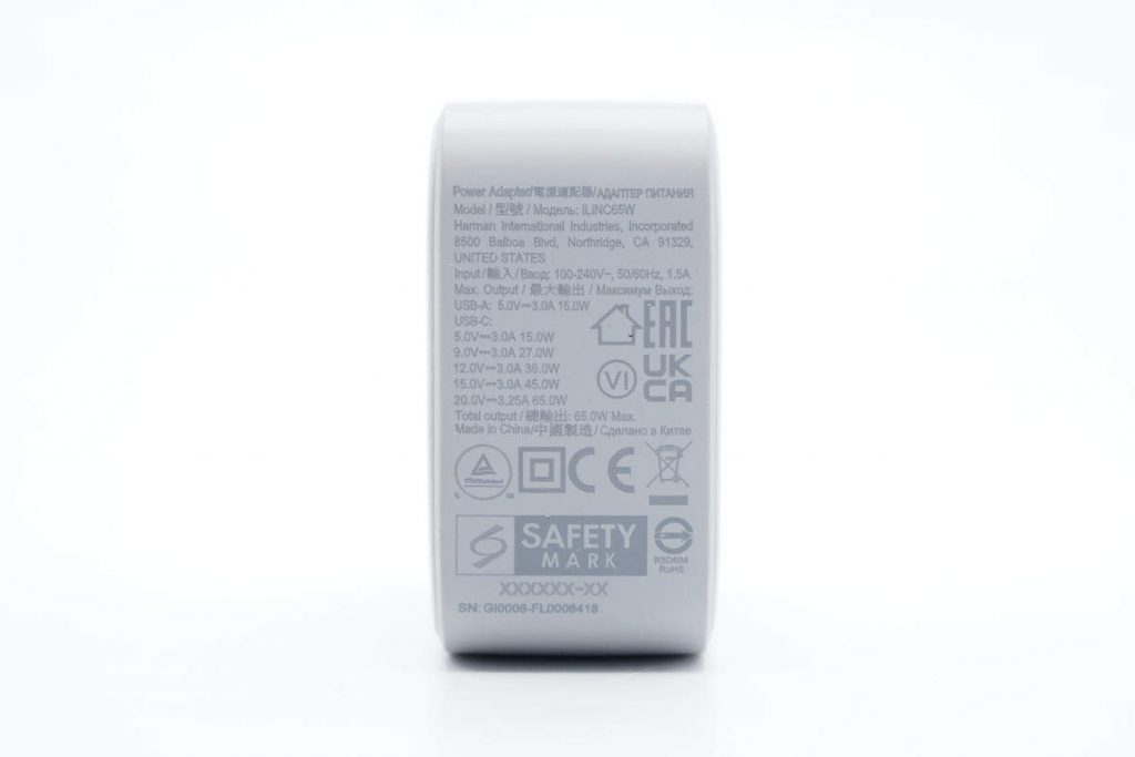

Here are the specs of this charger.
Model is ILINC 65W. It supports 100-240V~50/60HZ 1.5A.
And the output of USB-A is 5V3A, 15W. Output of USB-C is 5V3A, 9V3A, 12V3A, 15V3A, 20V3.25A. The maximum output power is 65W.
It also has passed lots of certifications, such as EAC, UKCA, TUV, CE, SAFETY MARK.

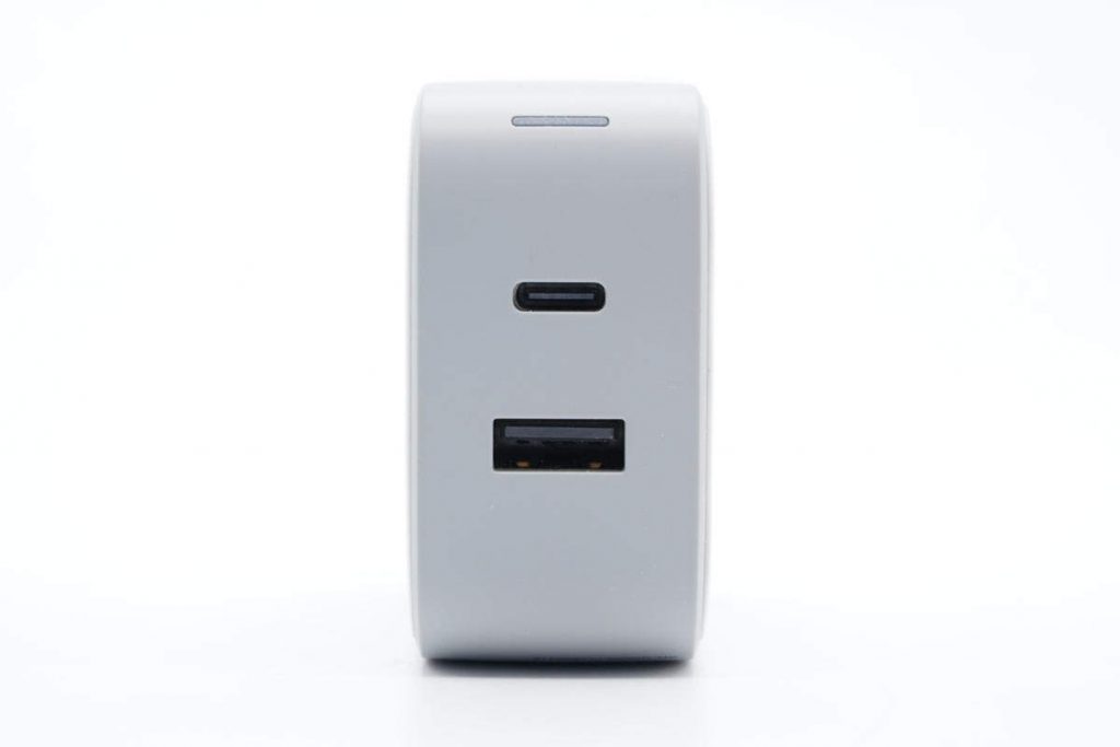

It is equipped with an LED indicator, one USB-A, and one USB-C at the output.

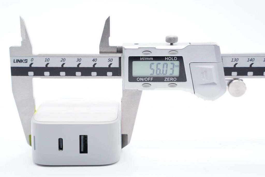

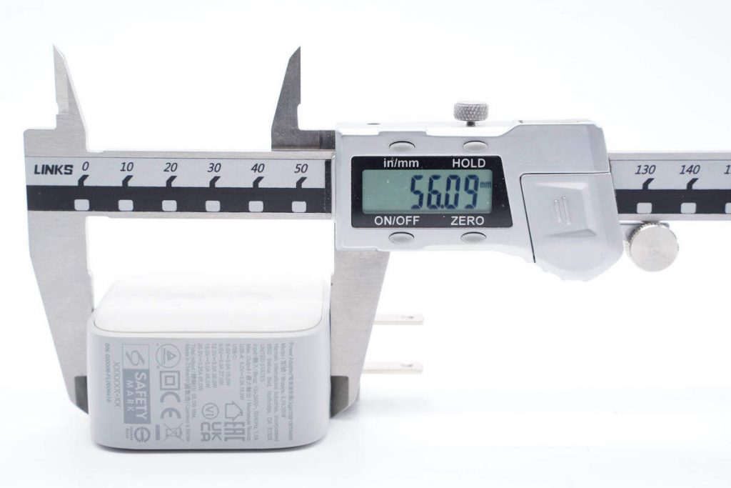

The length of the charger is 56.09mm (2.21 inches).
The width is 56.03mm (2.21 inches).

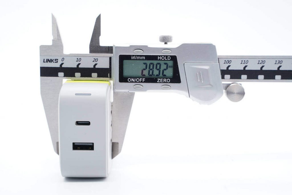

The thickness is 28.92mm (1.14 inches).
So the size of this charger is 90.89cm³, and the power density is 0.72W/cm³.

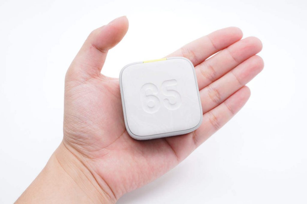

This is how it looks like when you hold it.

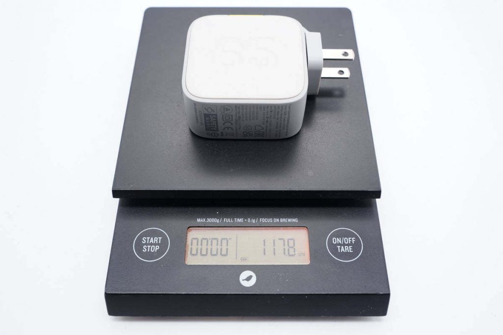

The weight is about 118g (4.16 oz).

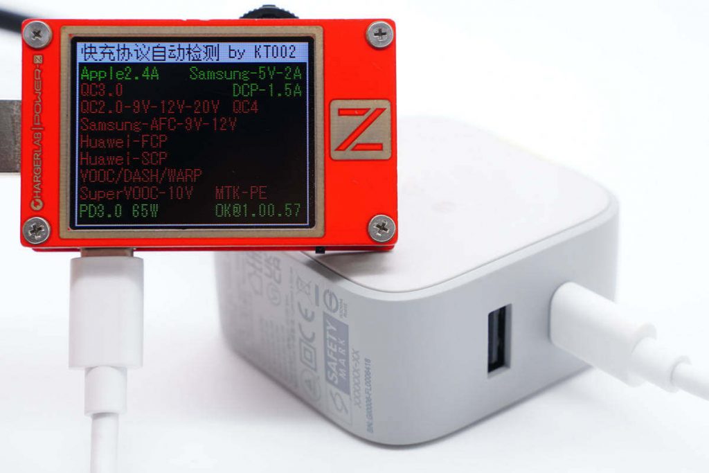

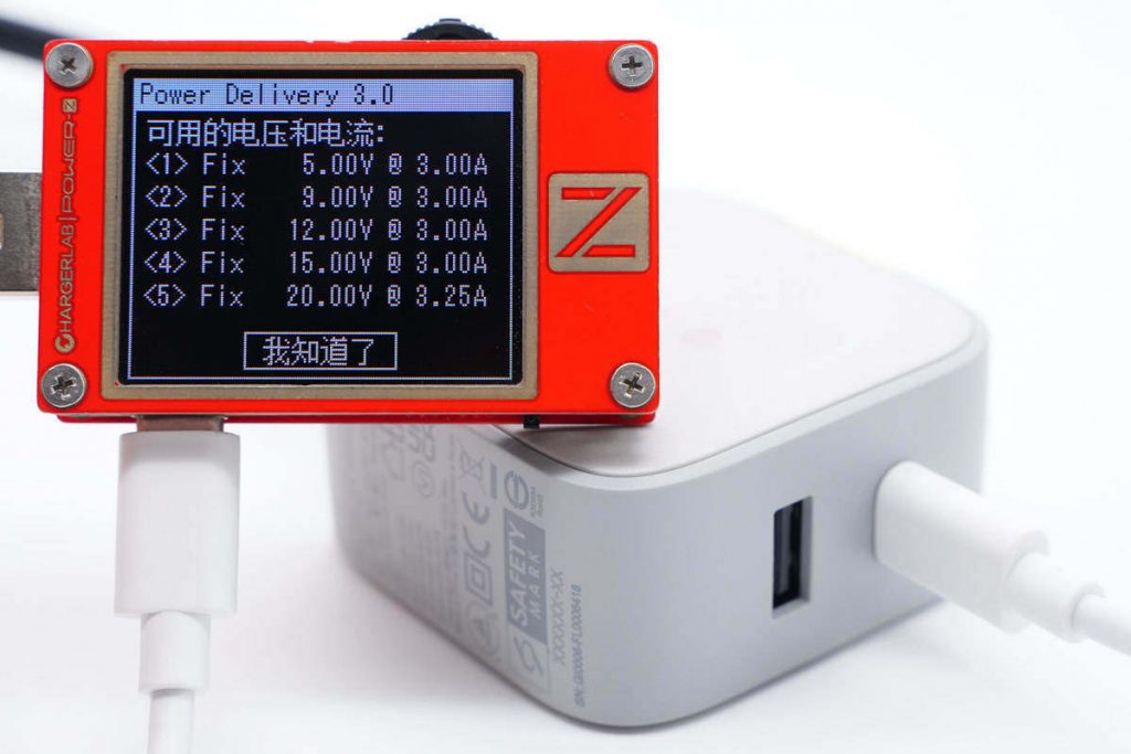

Using ChargerLAB POWER-Z KT002 to test it.
The USB-C supports Apple 2.4A, Samsung 5V2A, DCP protocol, and PD3.0 fast charging protocols.
The USB-C also has five fixed PDOs of 5V3A, 9V3A, 12V3A, 15V3A, and 20V3.25A.

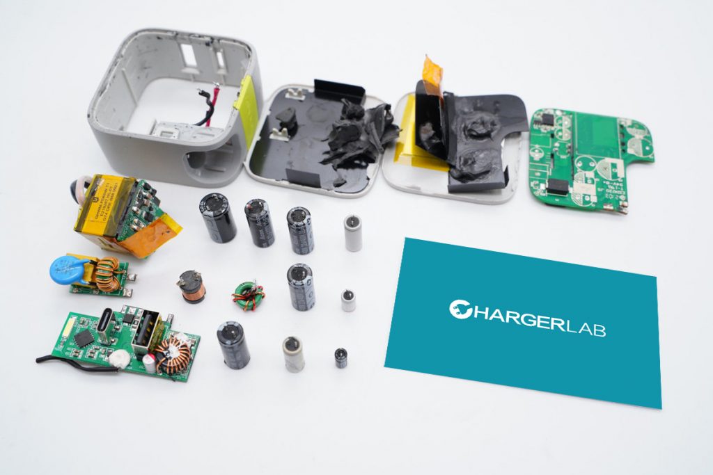

2. Teardown

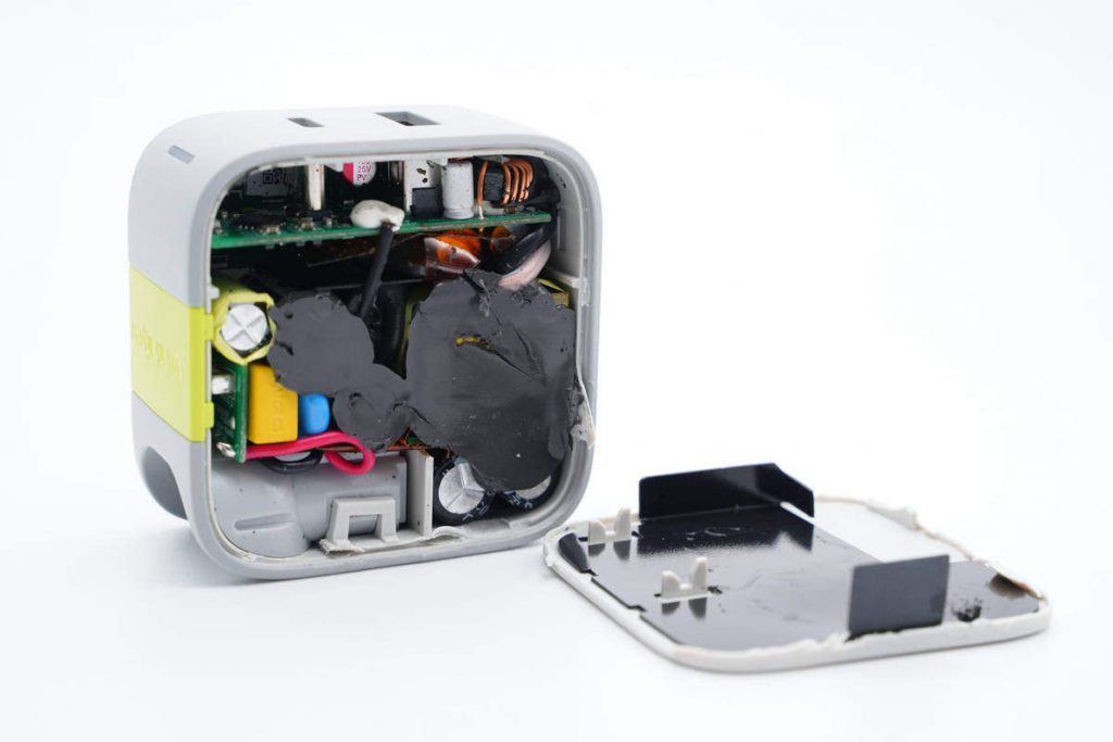

After opening the shell, we can see the insulating plate is pasted on the shell.
And there’re lots of black thermal adhesives inside for heat dissipation.
The input plug connects to PCB through the red and black wires.

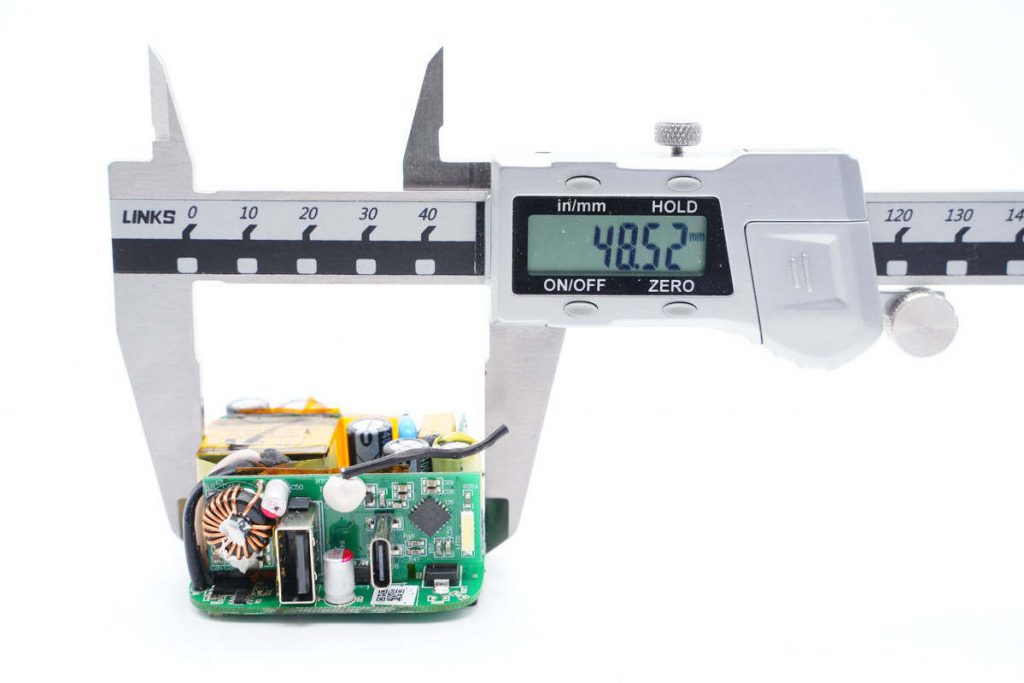

The width is 48.52mm (1.91 inches).

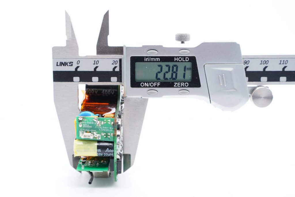

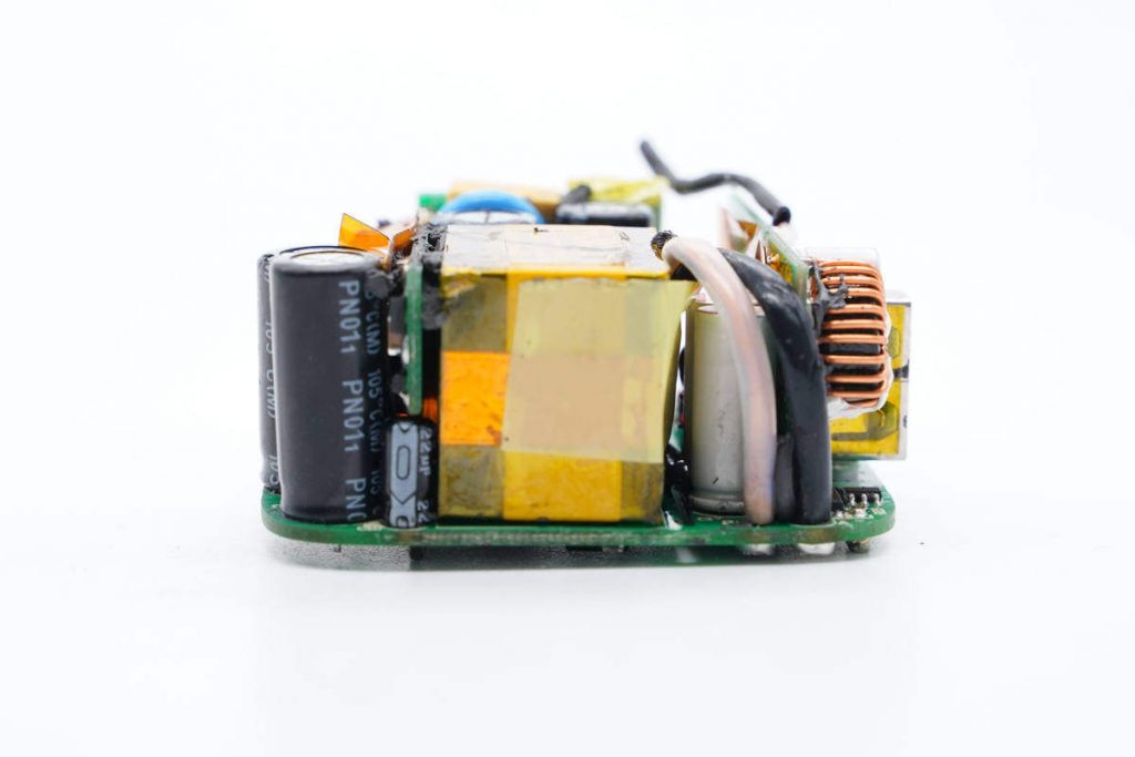

The thickness is 22.81mm (0.9 inches).

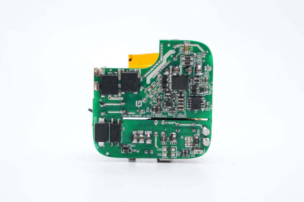

And this is the back of the PCB.
The master control chip and the GaN FET from GaN Systems are on the right. And two bridge rectifiers, optocoupler, SMD Y capacitor are on the left.
We found it adopts the high-frequency QR topology. The protocol chip can control the USB-C output voltage, and the USB-A will output at a constant 5V after the secondary step-down.
Next, we will start from the input to analyze every single component.

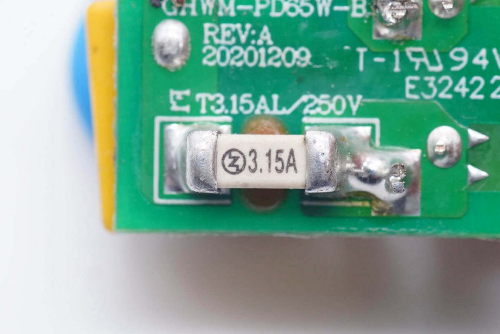

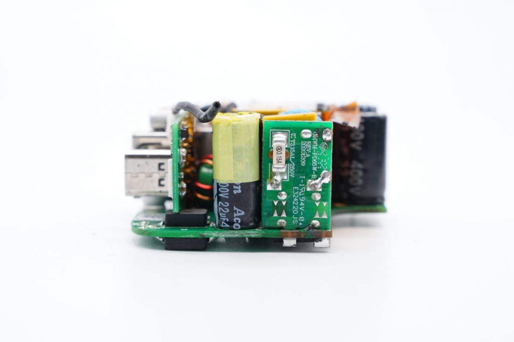

Here is a small PCB, which is equipped with an SMD fuse. And the electrolytic capacitor for high-voltage filtering is wrapped with insulating tape.
Turn to another side. There are three electrolytic capacitors for high-voltage filtering.

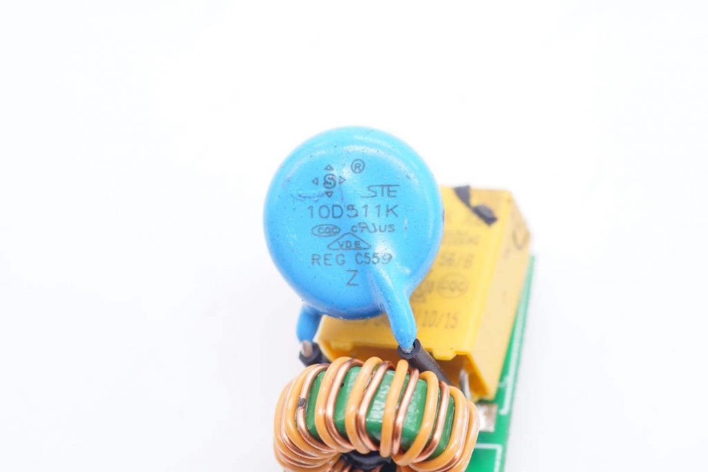

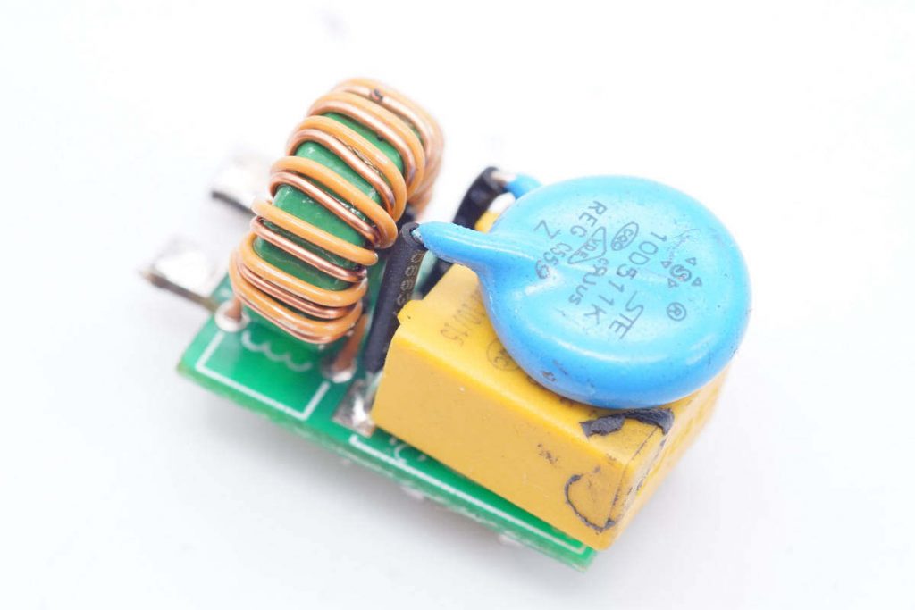

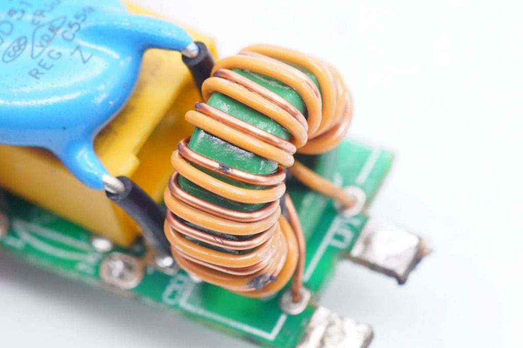

Remove the small PCB. There is common mode choke, varistor, and safety X capacitor.
 The rated current of the SMD fuse is 3.15A.
And the common mode choke is wound by double-wire to filter out EMI interference.
The 10D511K varistor comes from STE Electronics, used for input overvoltage protection.

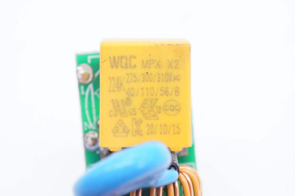

The safety X capacitor comes from WQC Electronics.

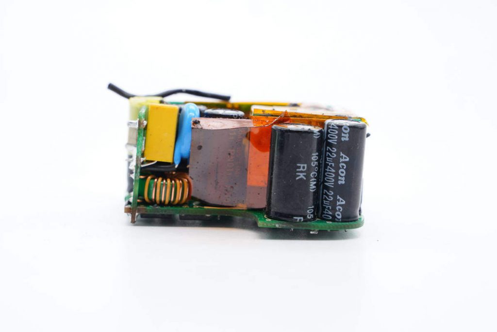

There are five primary electrolytic capacitors for high-voltage filtering, four of which are from Acon, 400V 22μF.
The fifth one comes from Fujicon Electric, 400V 33μF.
It has more than 30 years of designing, manufacturing, and supplying aluminum electrolytic capacitors.

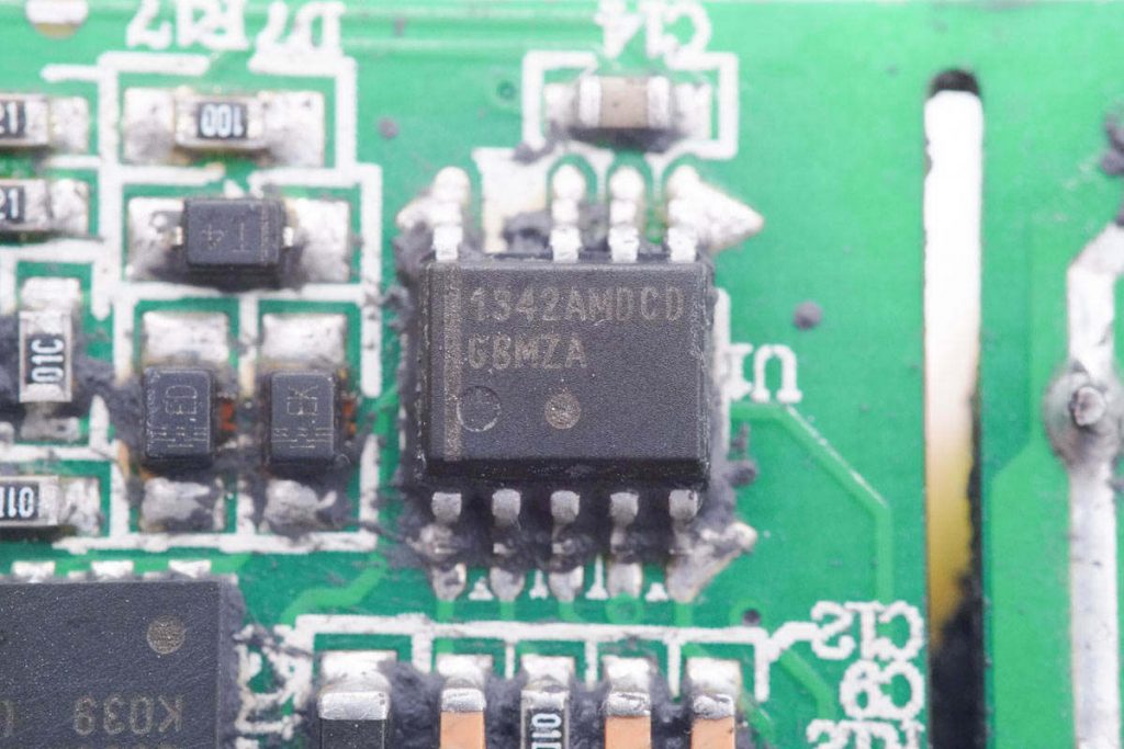

The master control chip comes from ON Semiconductor NCP1342, which is a highly integrated quasi−resonant flyback controller with active X2 capacitor discharge feature and has complete protection functions.

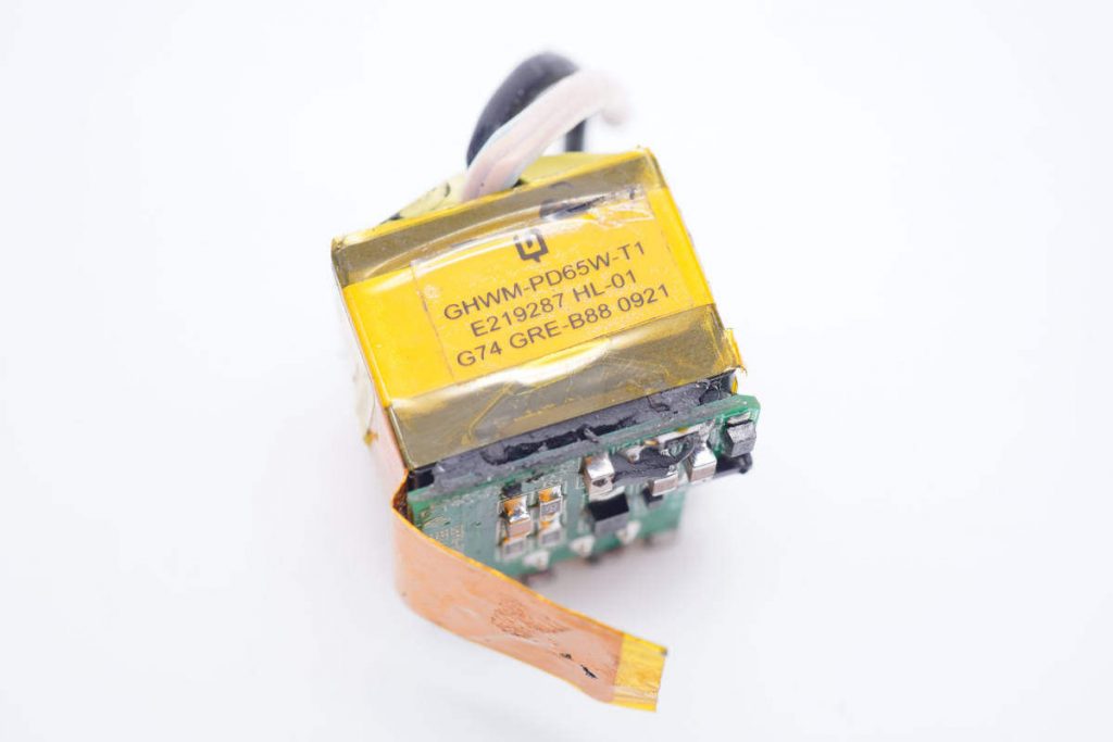

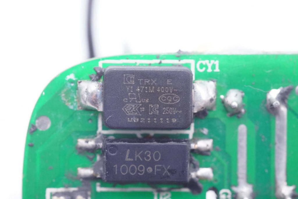

The transformer is soldered on the small PCB. And the small PCB is equipped with and an RCD snubber circuit.

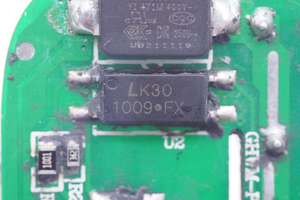

This is a 1009 optocoupler, used for communication and output voltage feedback.

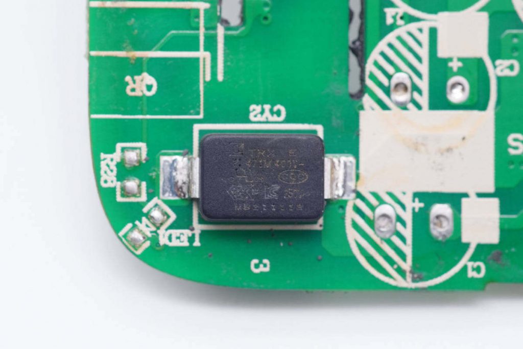

The SMD Y capacitor comes from TRX Technology. It’s small and light, suitable for high-density power products, like GaN fast chargers.

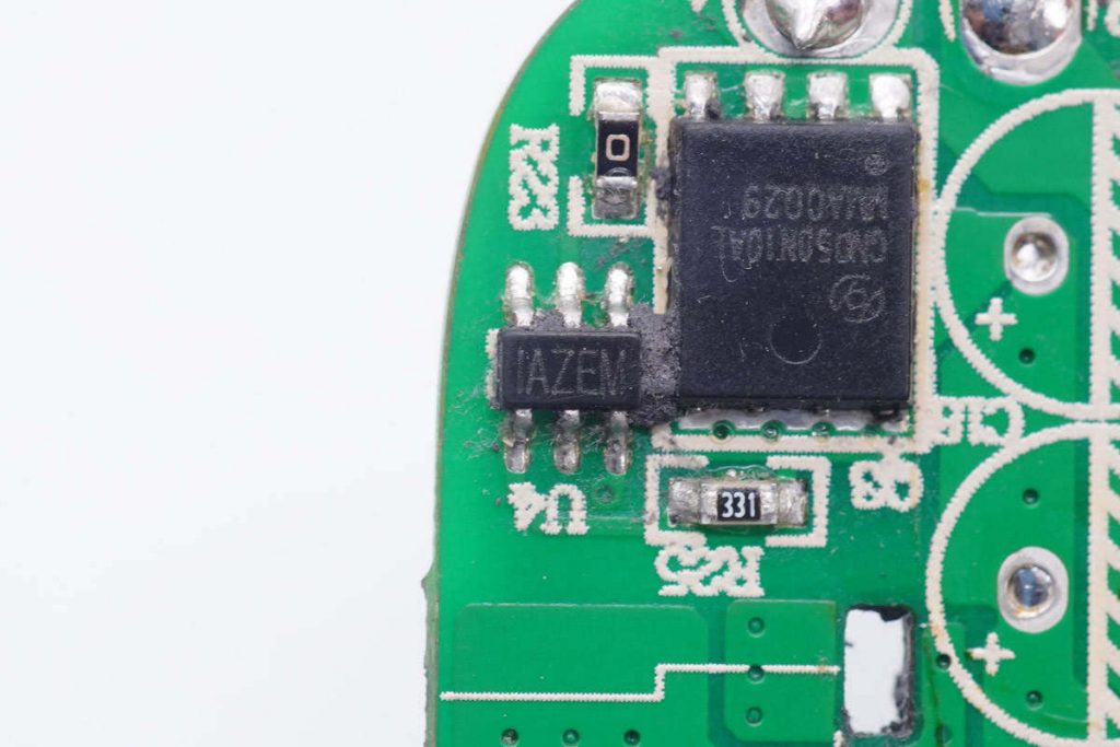

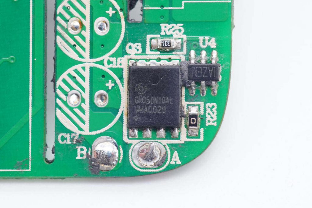

The secondary synchronous rectification controller is marked with IAZEM. Model is MPS MP6908.
It supports wide-voltage output and multiple operation modes, such as DCM, CCM, and quasi-resonant. It also supports the synchronous rectification of the high-side and low-side.
The synchronous rectifier comes from Hunteck HGN050N10AL, which adopts DFN 5x6 package. Withstand voltage is 100V.

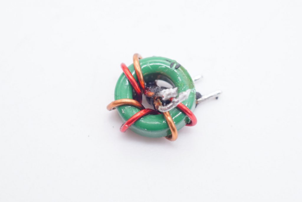

This is the filter inductor.

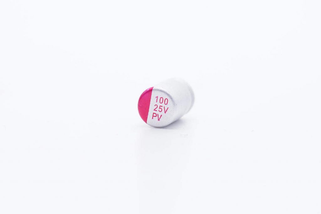

Another solid capacitor for output filtering is 25V 100μF.

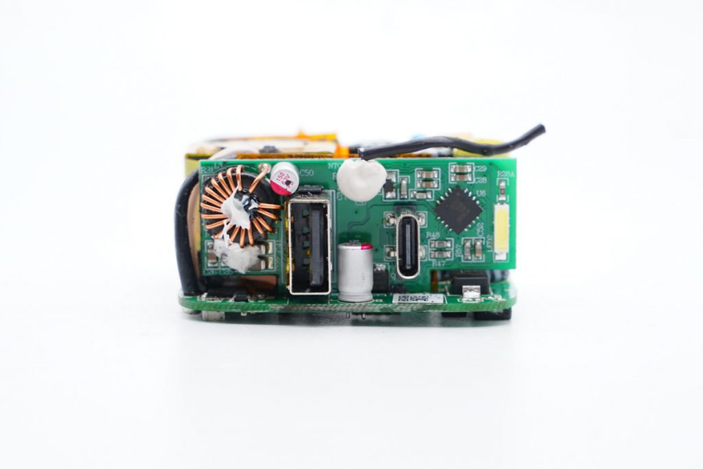

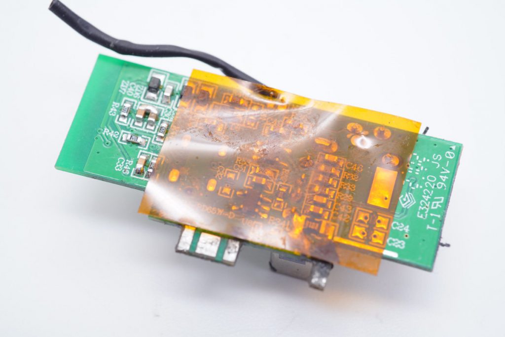

This is the small output PCB. And there’re USB receptacles, protocol chip, step-down inductor, filter capacitors, thermistor, and other components on it. The inductor and thermistor are reinforced by glue.
Remove the small PCB. There’s a layer of insulation tape on the other side.

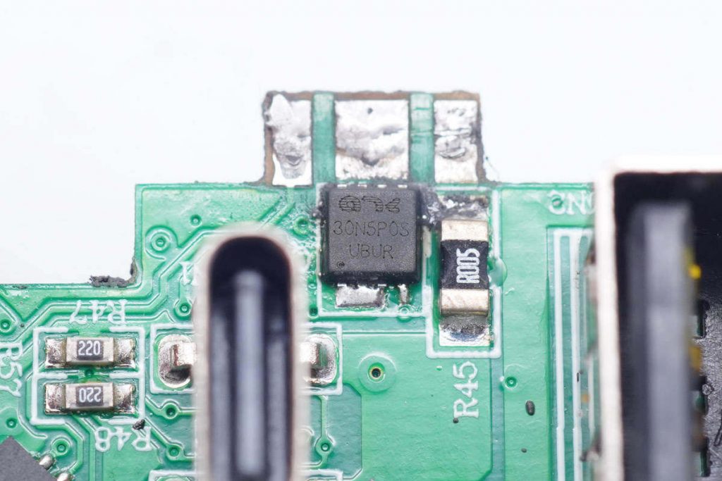

The output VBUS switch MOSFET comes from ARKmicro AKF30N5P0S. It adopts PDFN3333 package and withstand voltage is 30V.

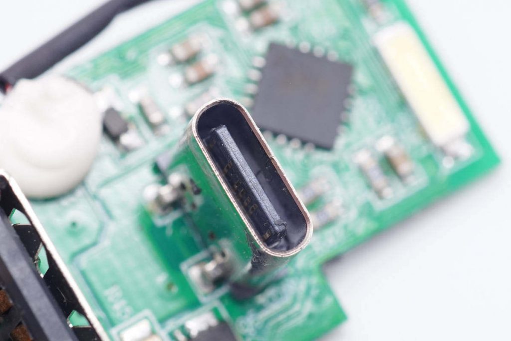

This is the USB-C receptacle.

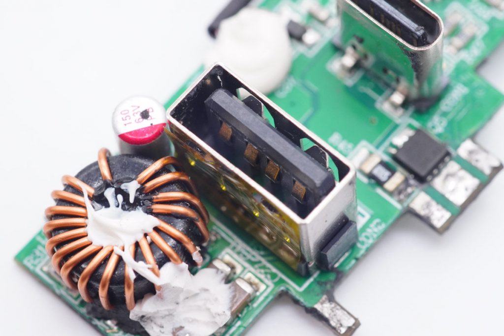

The step-down inductor is reinforced by silicone adhesives.

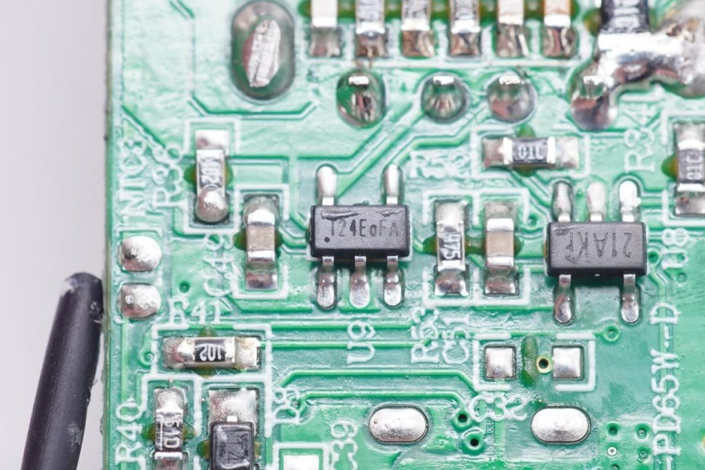

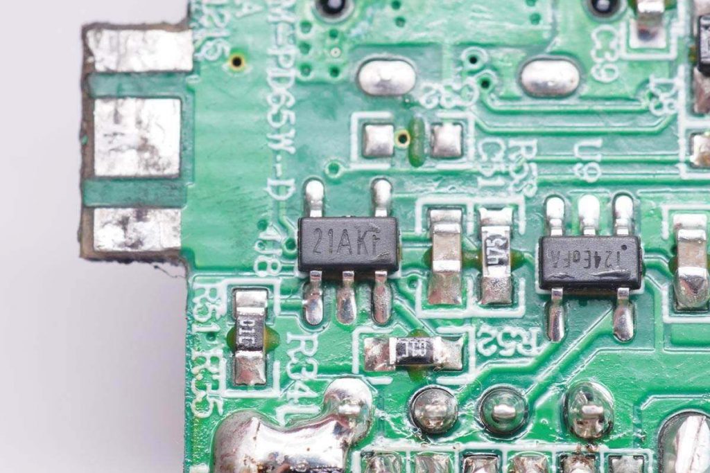

This is an automatic identification chip of USB-A, marked with T24EaFA.

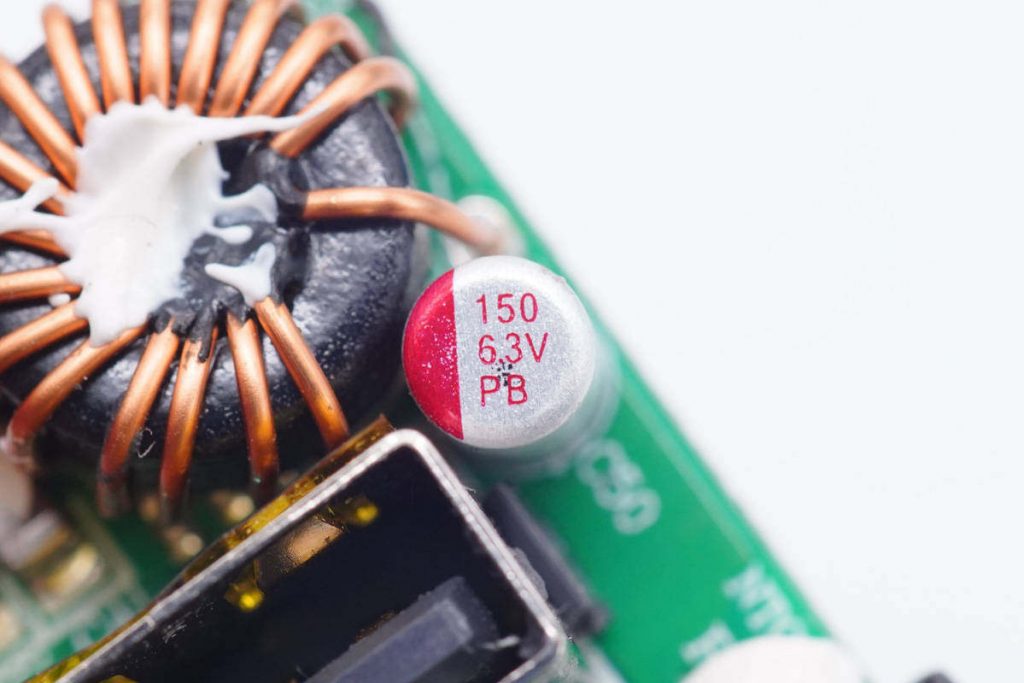

And this is the 321 single op amp, used to detect the current of the USB-A and control the power distribution of USB-C.
The spec of solid capacitor for output step-down is 6.3V 150μF.

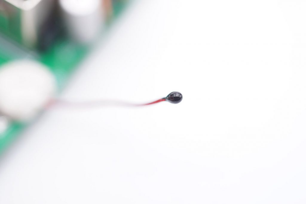

This is the thermistor that detects the internal temperature of the charger.
Finally, here is the USB-A receptacle.
