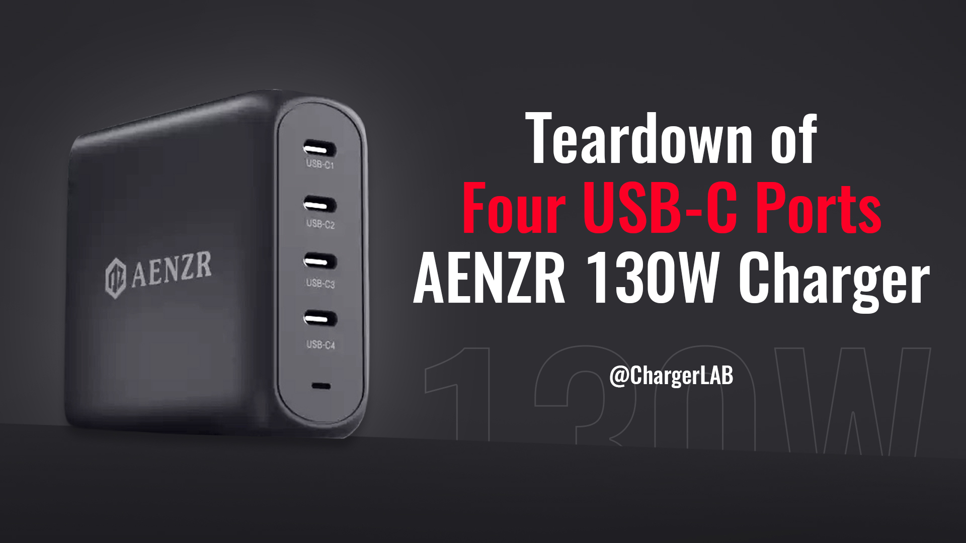

Teardown of AENZR 130W GaN Charger (Four USB-C Ports)
December 4, 2022
Recently, AENZR launched a 130W GaN charger. Unlike most multi-port high-power chargers, all those four output ports are USB-C.
And it didn’t have any USB-A ports. It reduces the charger compatibility somewhat. But you can say goodbye to the old USB-A port.
