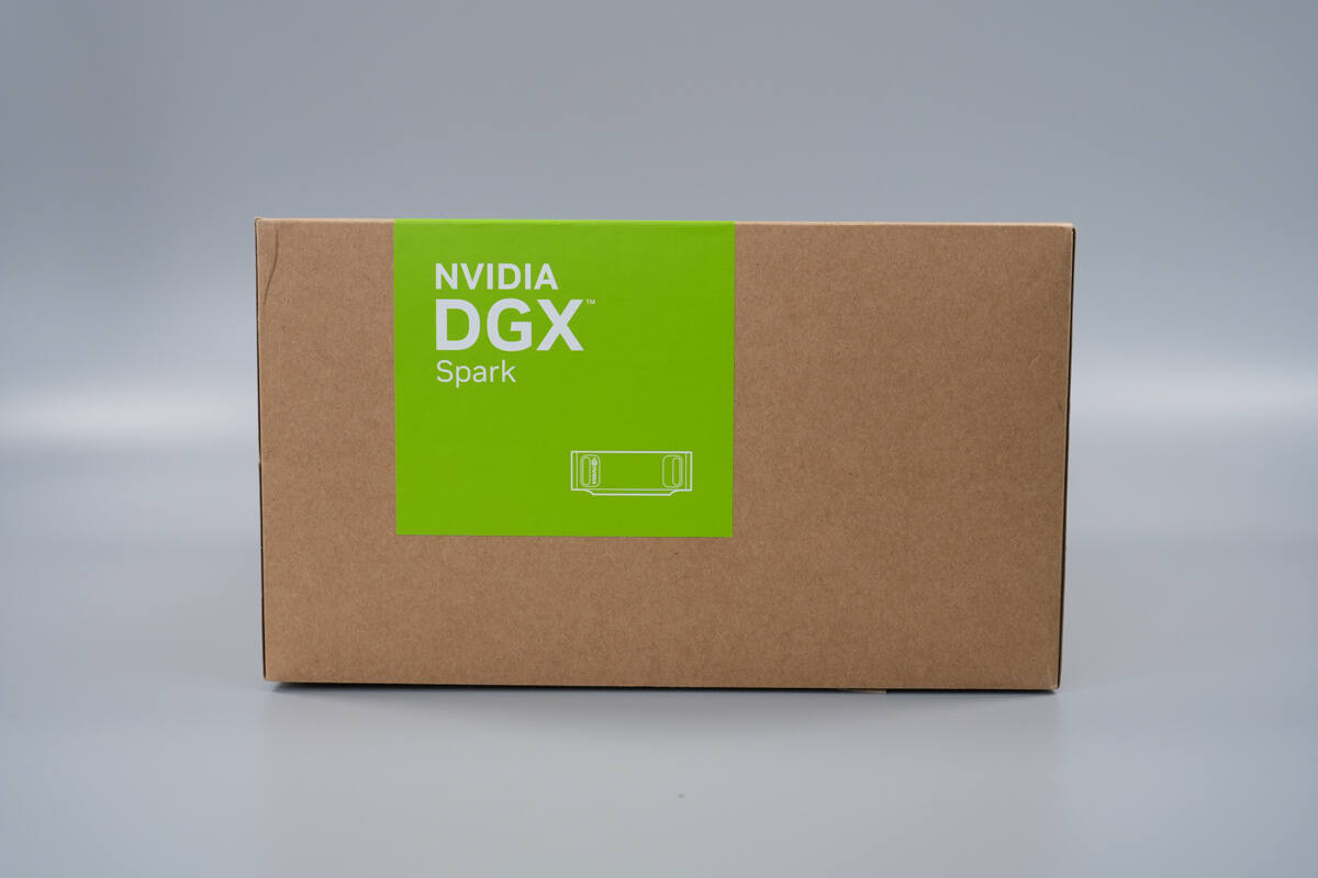

Packaged in a natural-colored cardboard box, printed with the NVIDIA, DGX, and Spark logos.
Teardown of NVIDIA DGX Spark 4TB-Chargerlab
The sides also feature the NVIDIA, DGX, and Spark logos.

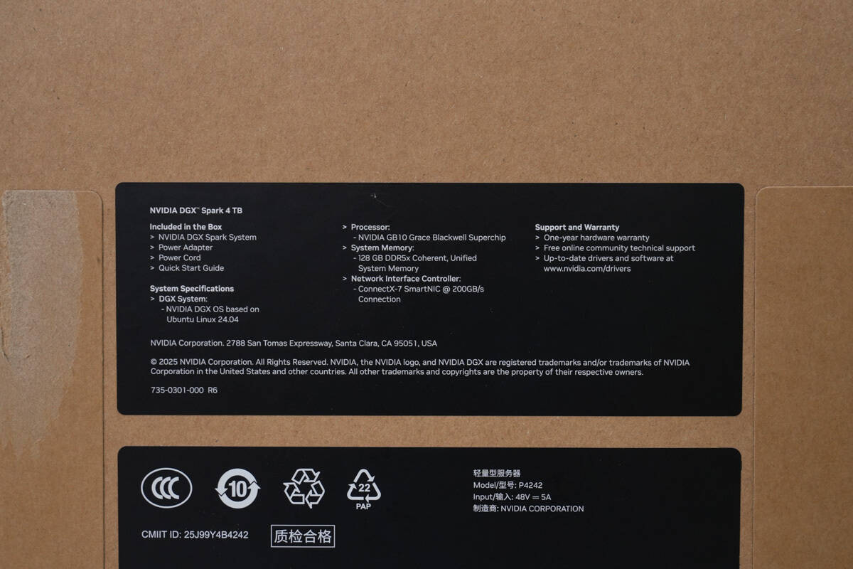

The rear has a tear-off seal and an information label attached.

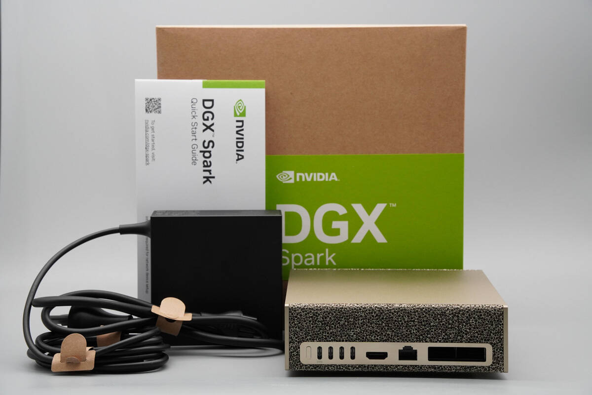

The package contains the NVIDIA DGX Spark system, a power adapter, a power cord, and a quick start guide.
Processor
NVIDIA GB10 Grace Blackwell Superchip
System memory
128 GB DDR5X unified system memory
Network interface controller
ConnectX-7 smart network card
Includes a one-year hardware warranty
The package includes the NVIDIA DGX Spark, a PD 3.1 power adapter, a power cord, and a quick start guide.

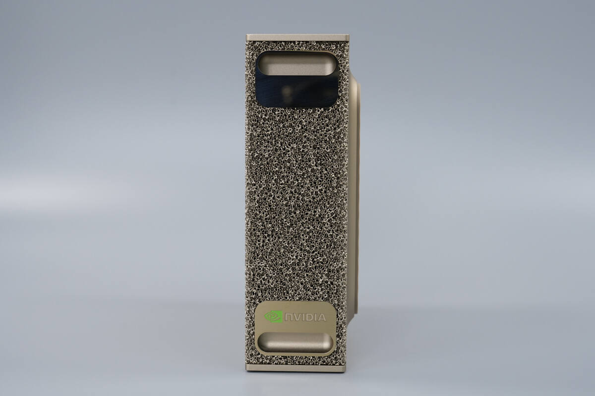

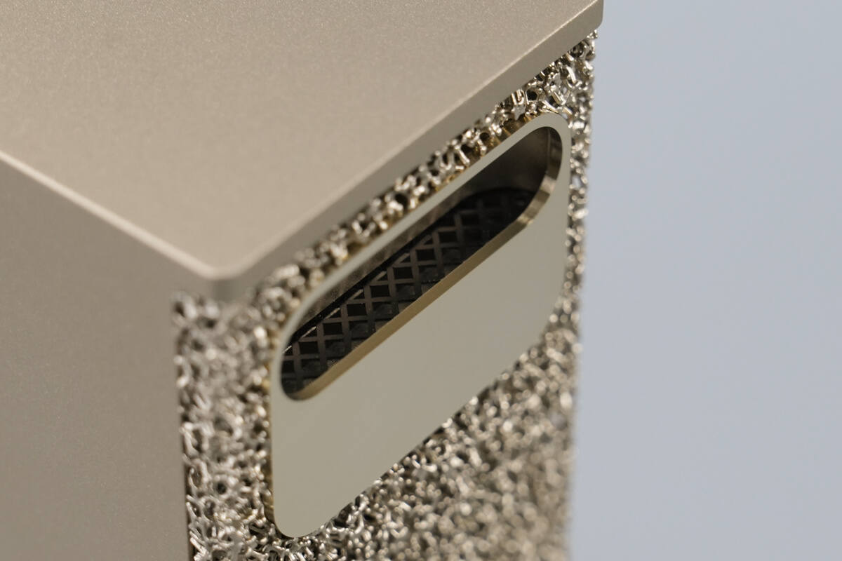

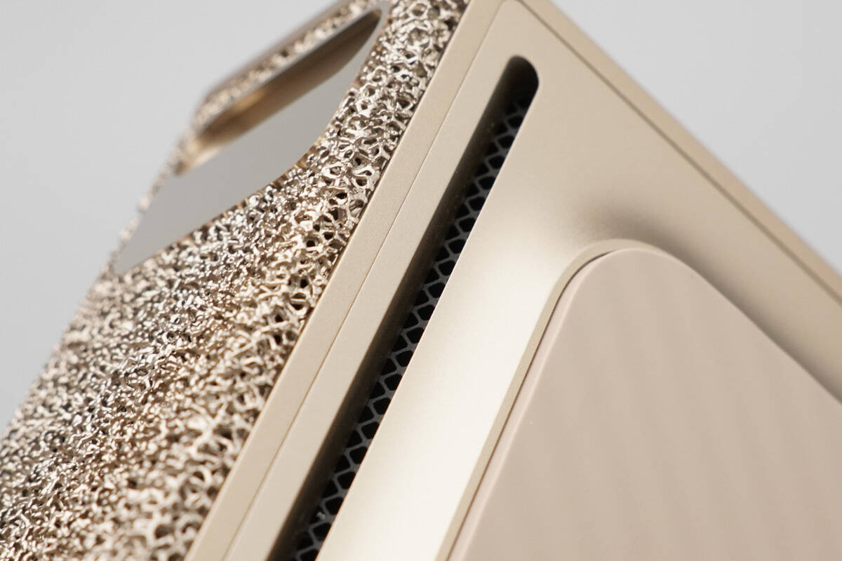

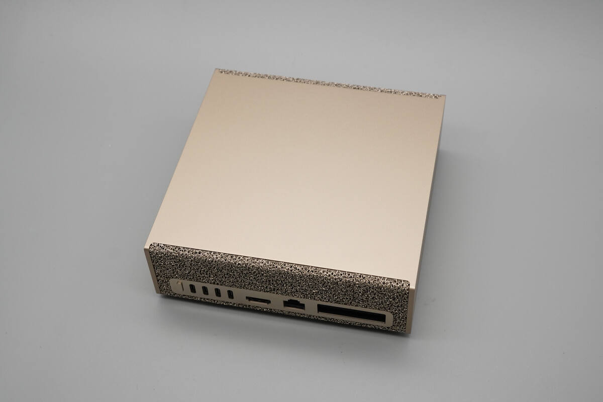

The front of the chassis features metal foam decoration, with air intakes located at the top and bottom.
The air intakes are equipped with dust filters.

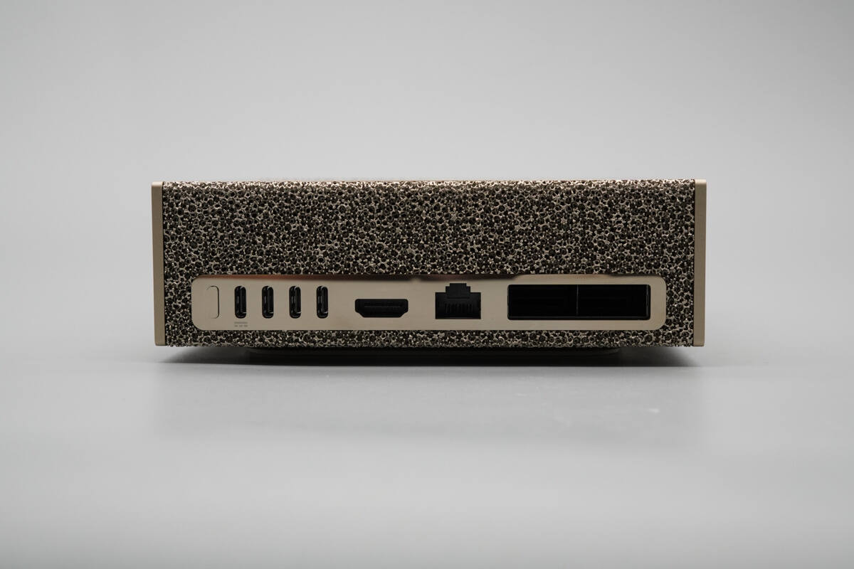

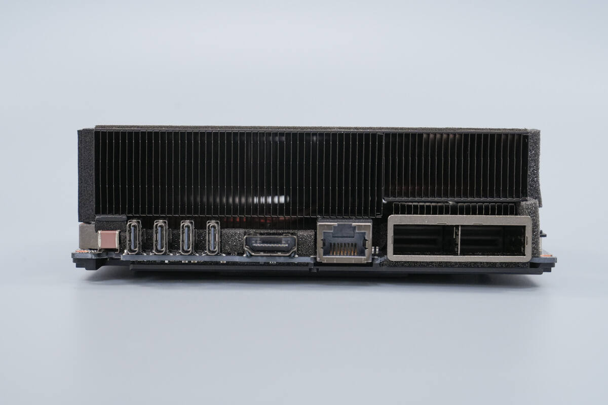

Overview of the rear ports.

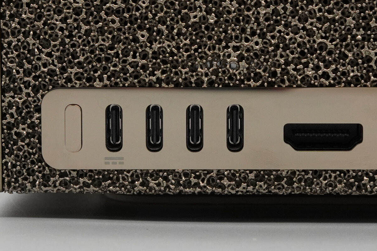

On the left side, there is a power button and four USB-C ports. The leftmost port is for power input, with a DC symbol printed below.
Close-up of the HDMI and 10G Ethernet ports.
The right side has two QSFP ports.

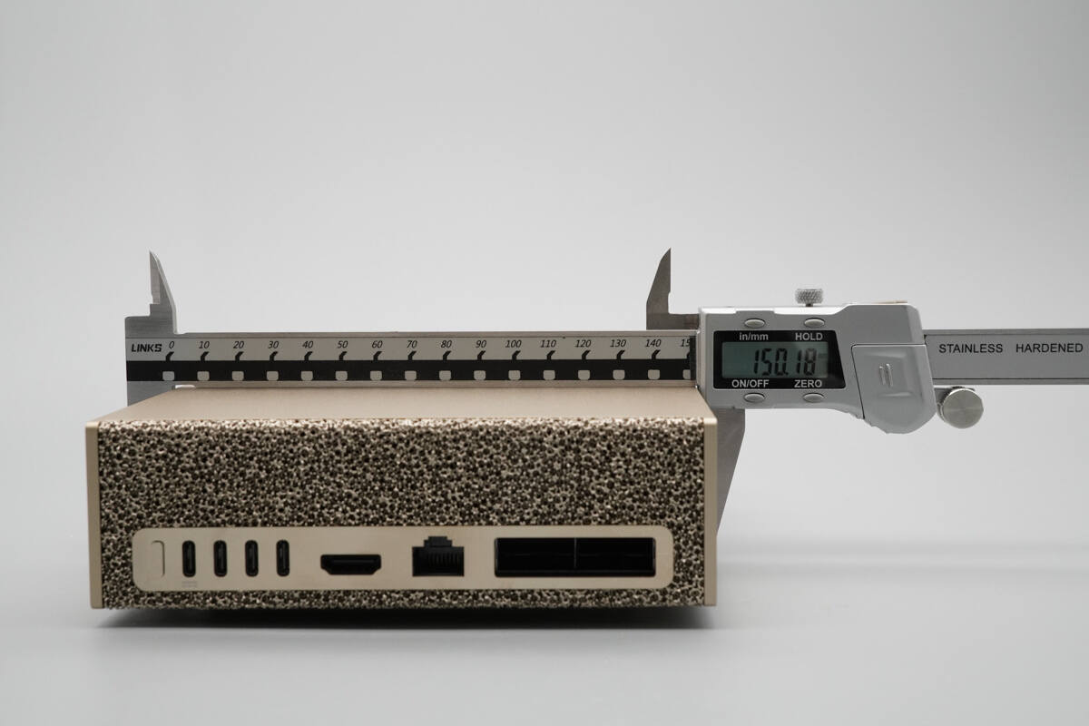

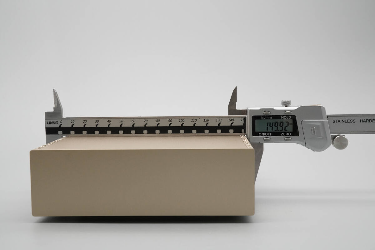

The length is about 150 mm (5.91 inches).

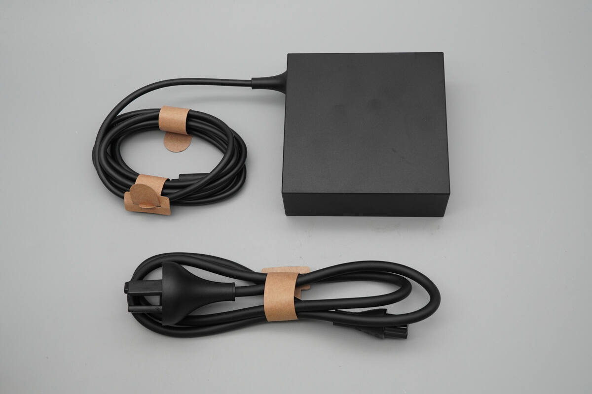

The power adapter and the included power cord are both secured with paper straps.

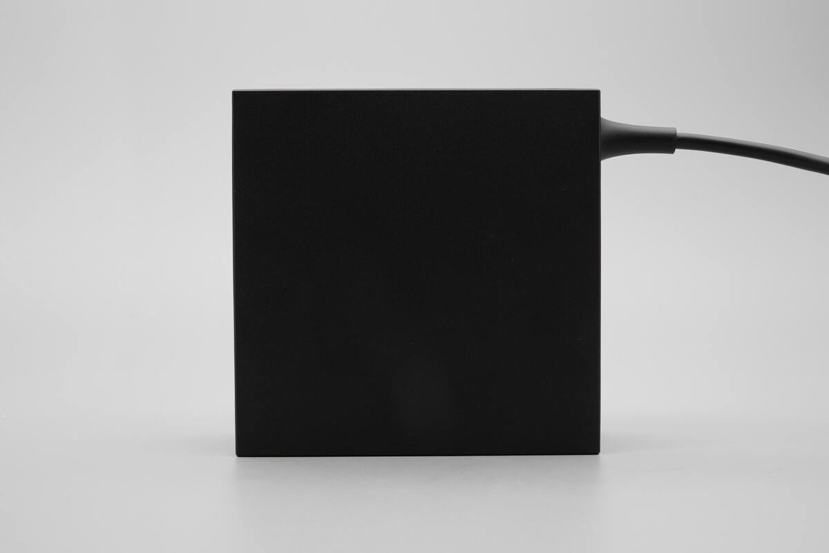

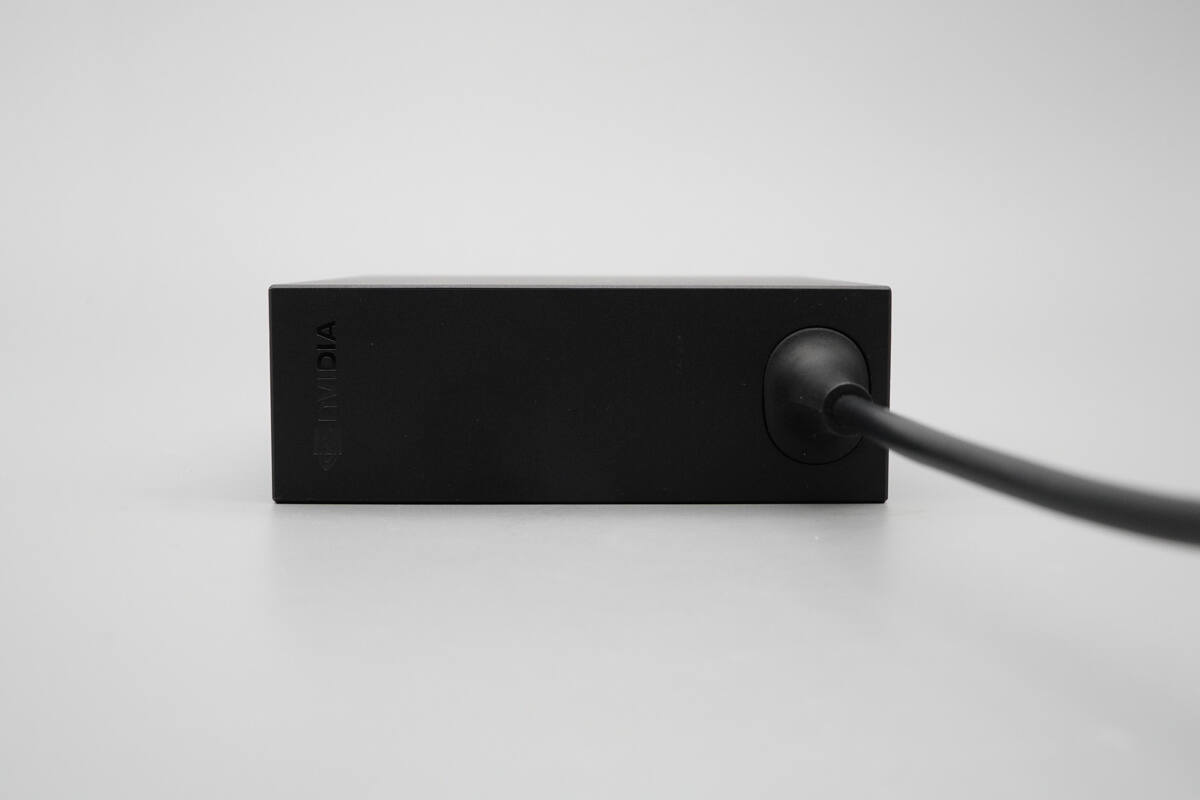

The power adapter has a rectangular block shape.
The input side features a cloverleaf connector.

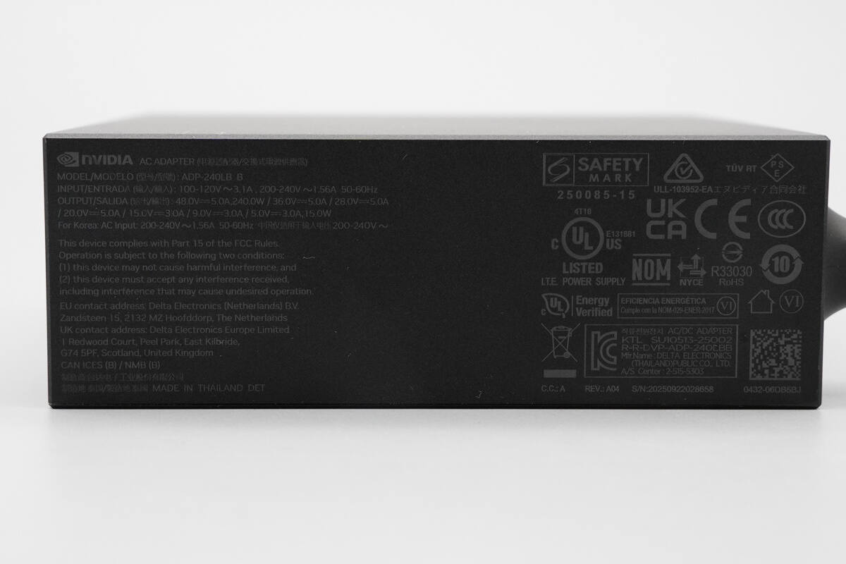

The output cable is integrated and features a rubber sleeve for bend protection.
Model: ADP-240LB B
Input: 100–120V ~ 3.1A, 200–240V ~ 1.56A, 50–60Hz
Output: 48V⎓5A, 240W / 36V⎓5A / 28V⎓5A / 20V⎓5A / 15V⎓3A / 9V⎓3A / 5V⎓3A, 15W
Manufacturer: Delta Electronics, Inc.

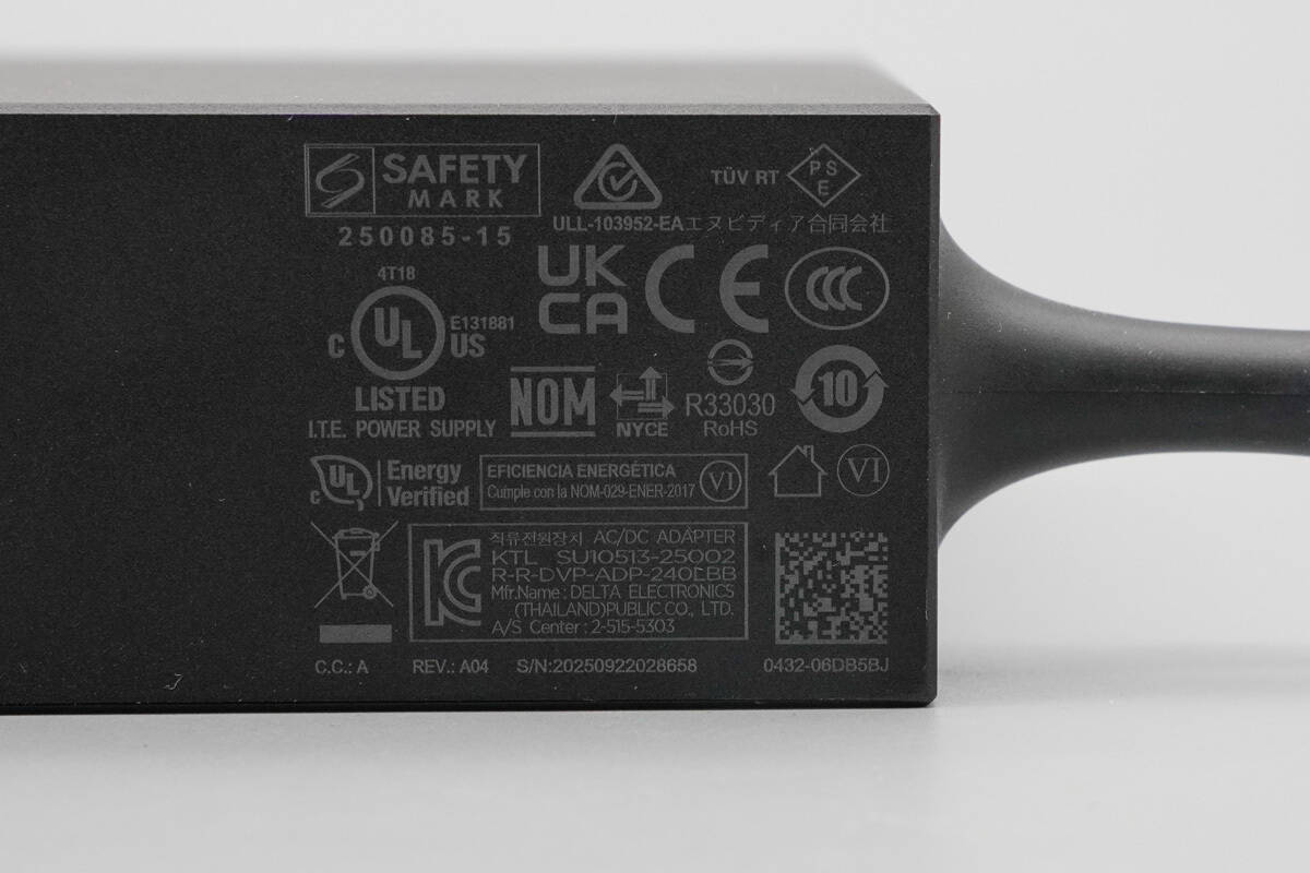

Close-up of multiple safety certification marks on the right side.

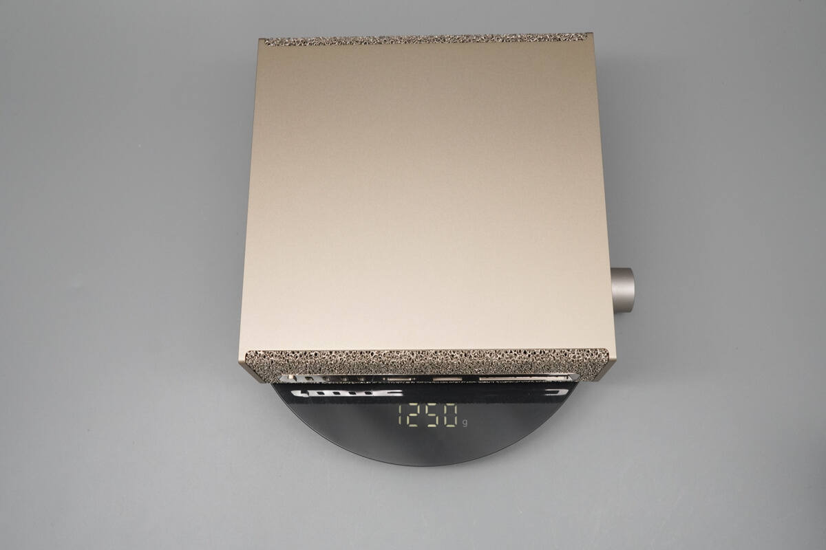

The weight is about 1250 g (44.092 oz).

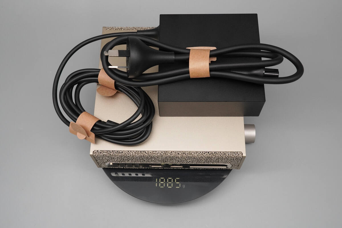

The combined weight of the power adapter and power cord is about 1885 g (66.49 oz).

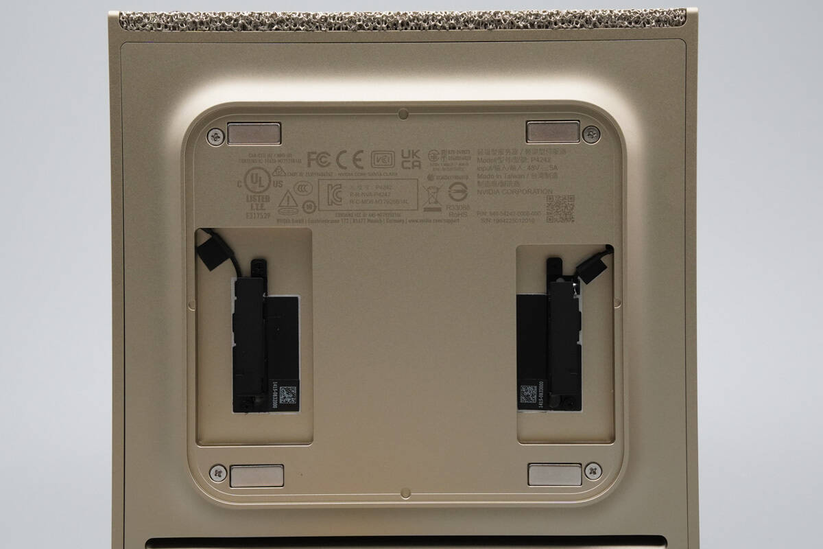

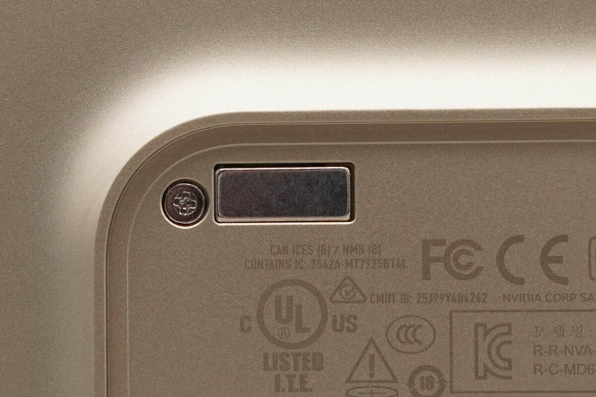

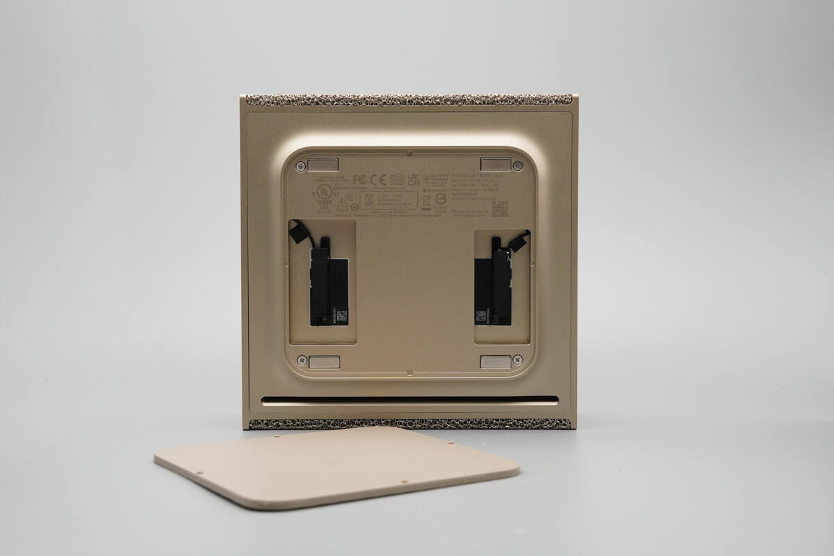

First, remove the non-slip cover plate from the bottom.

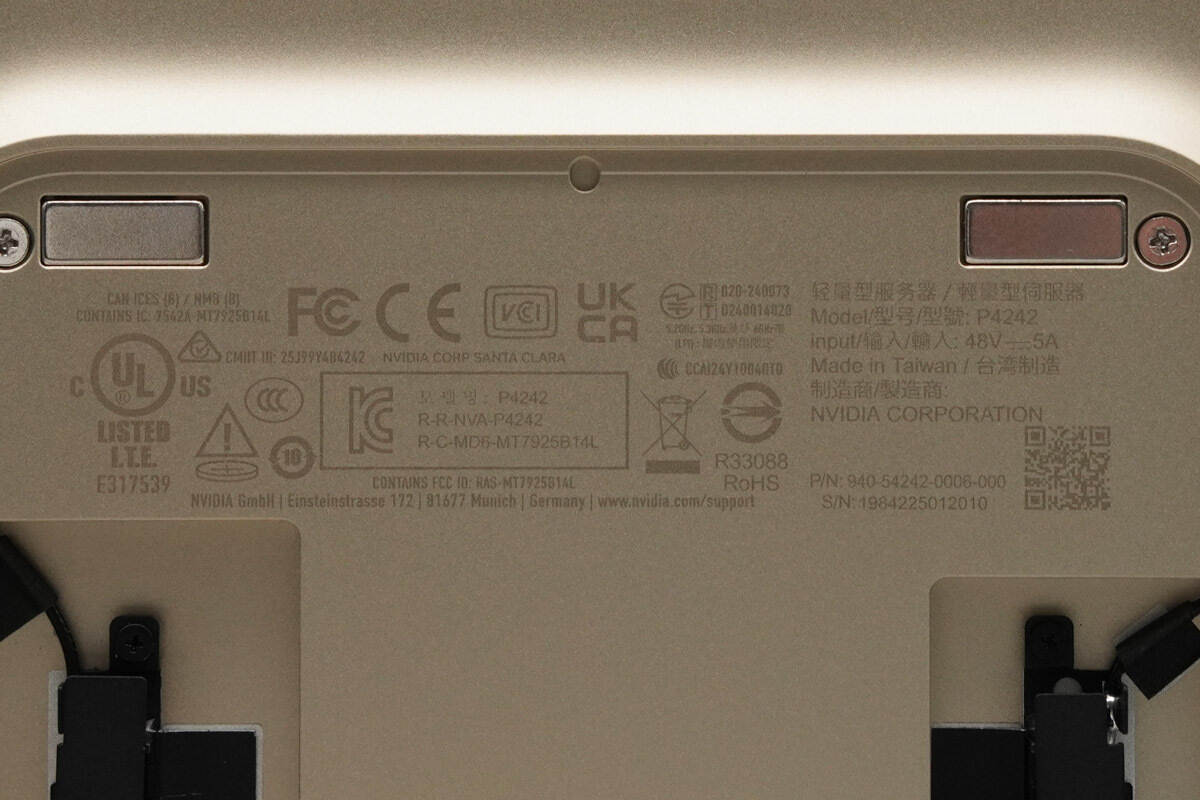

Inside the cover plate, there are mounting screws, a WiFi antenna, and printed product information.
Lightweight server
Model: P4242
Input: 48V⎓5A

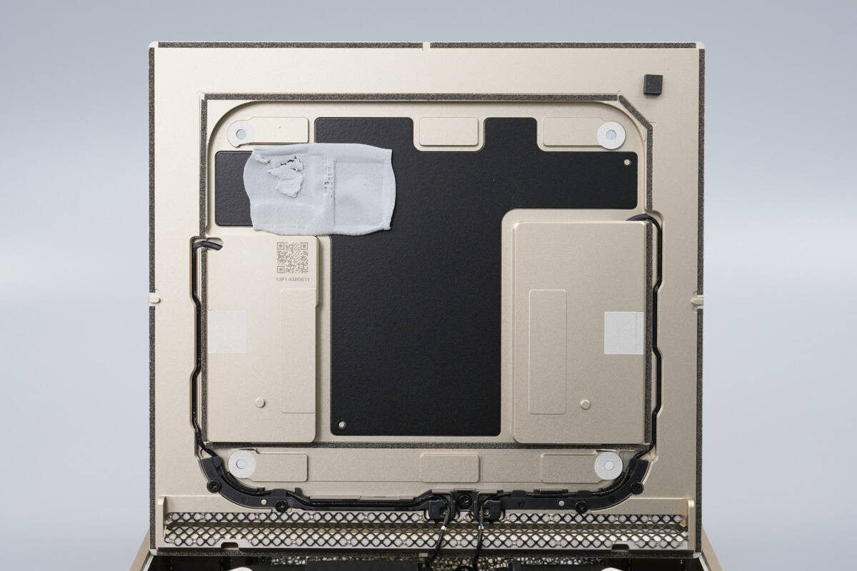

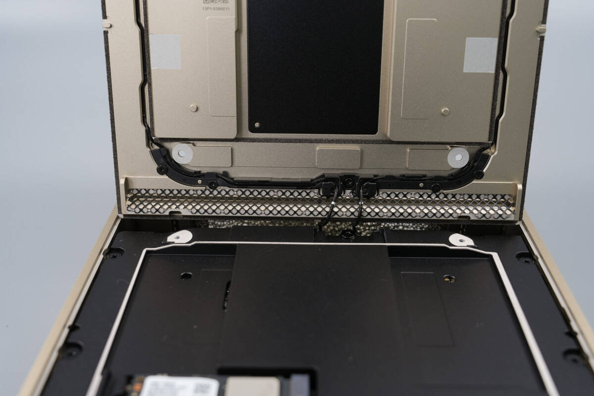

Remove the rear cover. The aluminum alloy base plate is secured to the chassis with screws along both side edges.
Inside the rear cover, a graphite thermal pad is attached, with a thermal pad positioned corresponding to the SSD location.

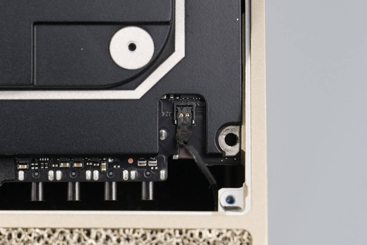

The power button is connected via a connector.

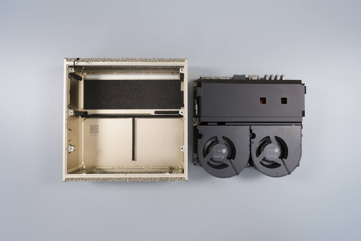

Remove the internal module.

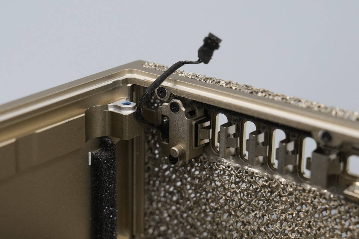

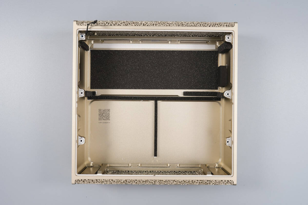

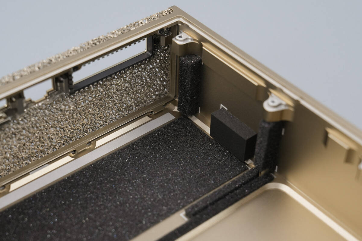

The chassis is made of aluminum alloy using CNC machining, with sealed foam inside.
The power button is connected via a ribbon cable and secured with a retaining plate.
The chassis has spring shields corresponding to the ports.
Foam is attached inside to seal gaps and prevent airflow backflow, which could affect cooling performance.

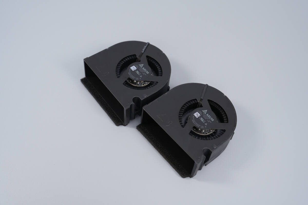

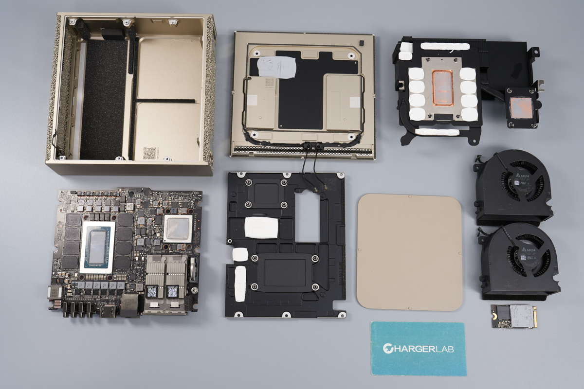

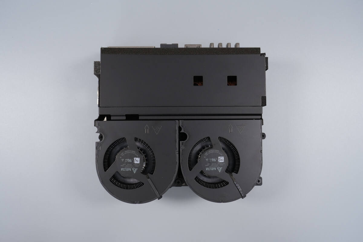

The cooling fans and heat dissipation module are mounted above the PCBA module.
The cooling fan is from Delta, model NS8CC50, rated at 12V 0.5A.
The other fan has the same model.

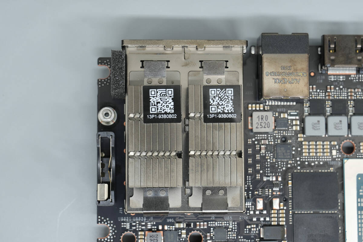

Overview of the exhaust heat sink fins; the housing corresponding to the QSFP connectors also has heat sink fins to dissipate heat using airflow.
The clock battery is vertically mounted in a battery holder for easy replacement. The battery model is CR2032.
The cooling fans are connected via sockets.
The aluminum alloy base plate has a cutout to secure a 2242-size SSD.
Remove the cooling fans.
The heat dissipation module has standoff screws to secure the fans.
The heat dissipation module is secured with screws.

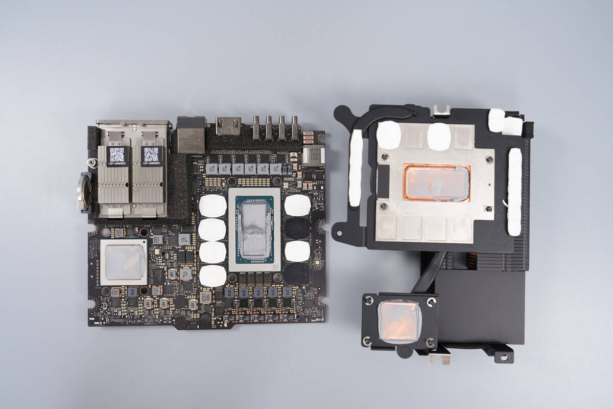

Remove the heat dissipation module.
The heat dissipation module has a heat spreader positioned over the GB10 chip. Thermal pads are applied to the memory chips, buck inductors, and buck MOSFETs for heat dissipation. The DrMOS components feature heat pipes with thermal pads to enhance cooling. The network card chip also uses a heat pipe for thermal management.

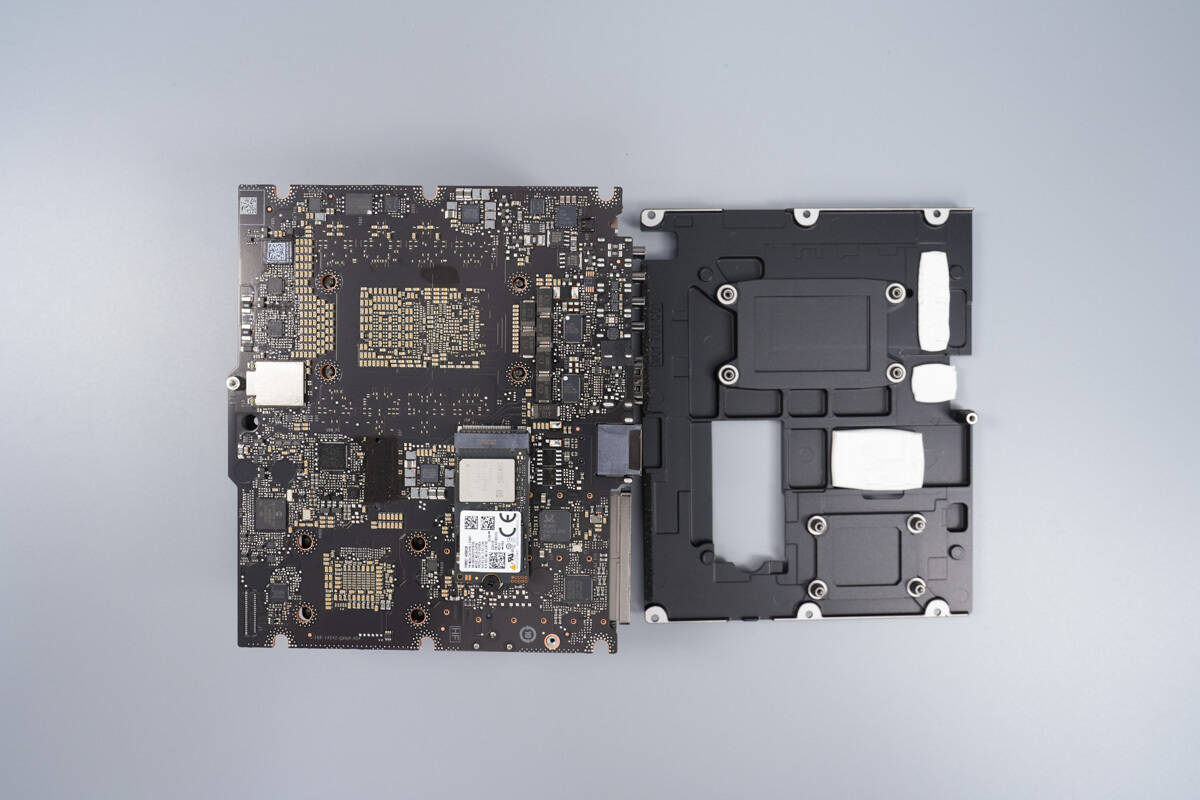

Next, remove the aluminum alloy base plate from the back of the PCBA module.
Thermal pads are applied on the base plate at the locations corresponding to the wireless network card and DrMOS components to enhance heat dissipation.

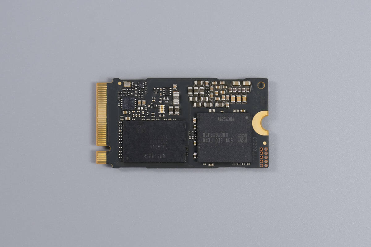

The back of the PCBA module is equipped with an SSD.
The SSD is from Samsung, model PM9E1, with a capacity of 4096 GB and a 2242 form factor.
The SSD has a double-sided design, with the controller and flash memory chips on the front, and memory chips and flash memory chips on the back.

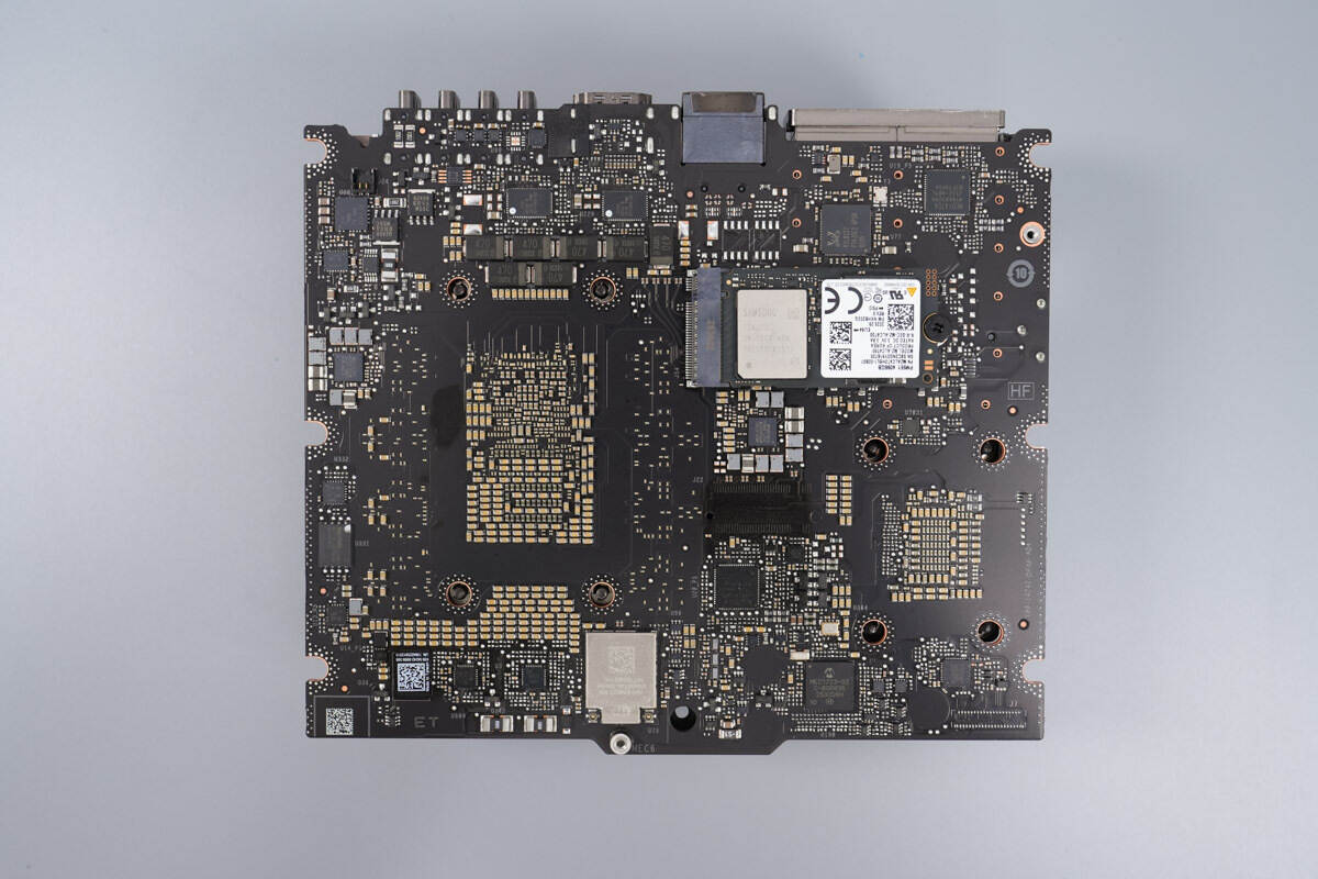

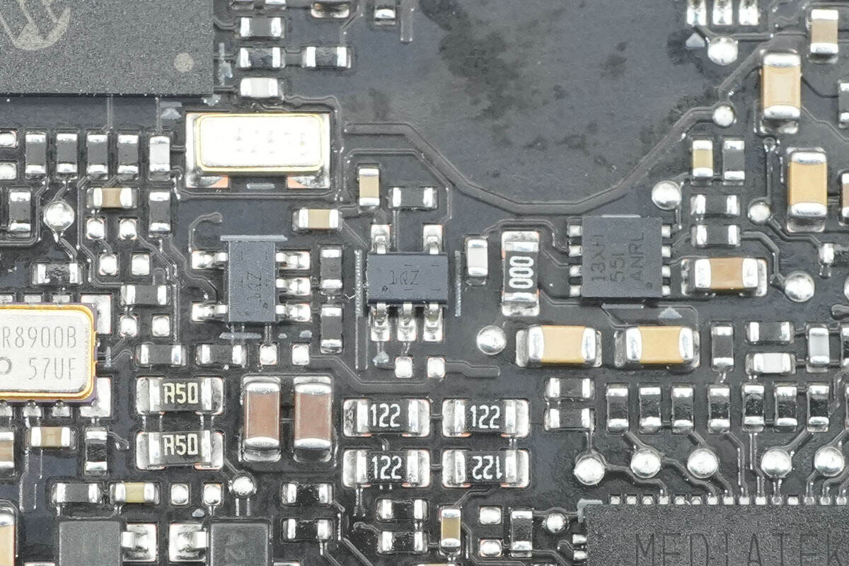

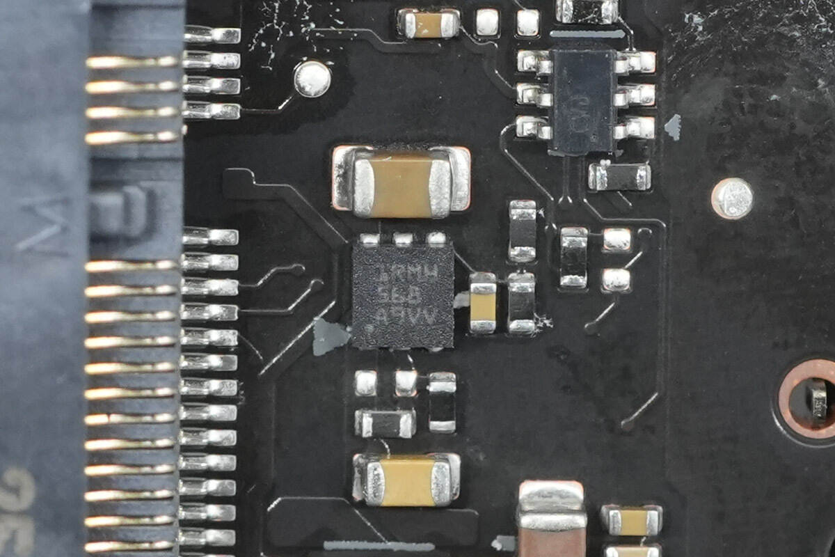

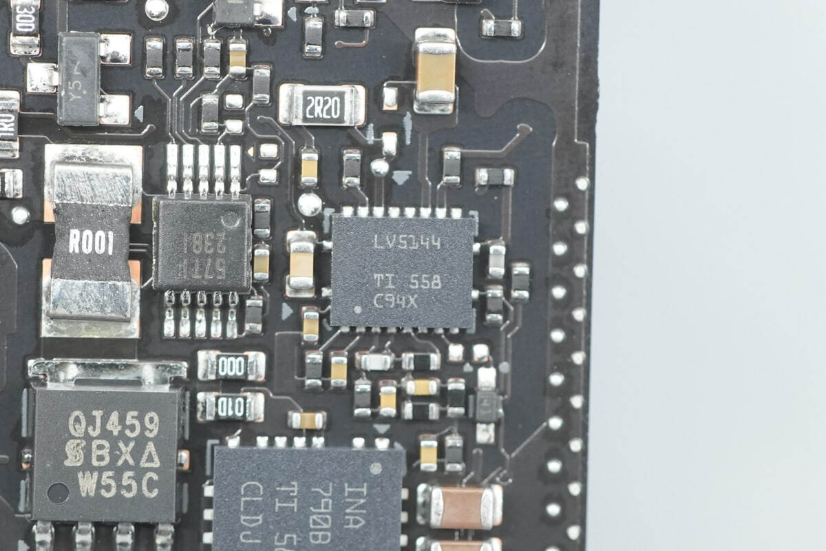

Overview of the front side of the PCBA module.
Overview of the back side of the PCBA module.

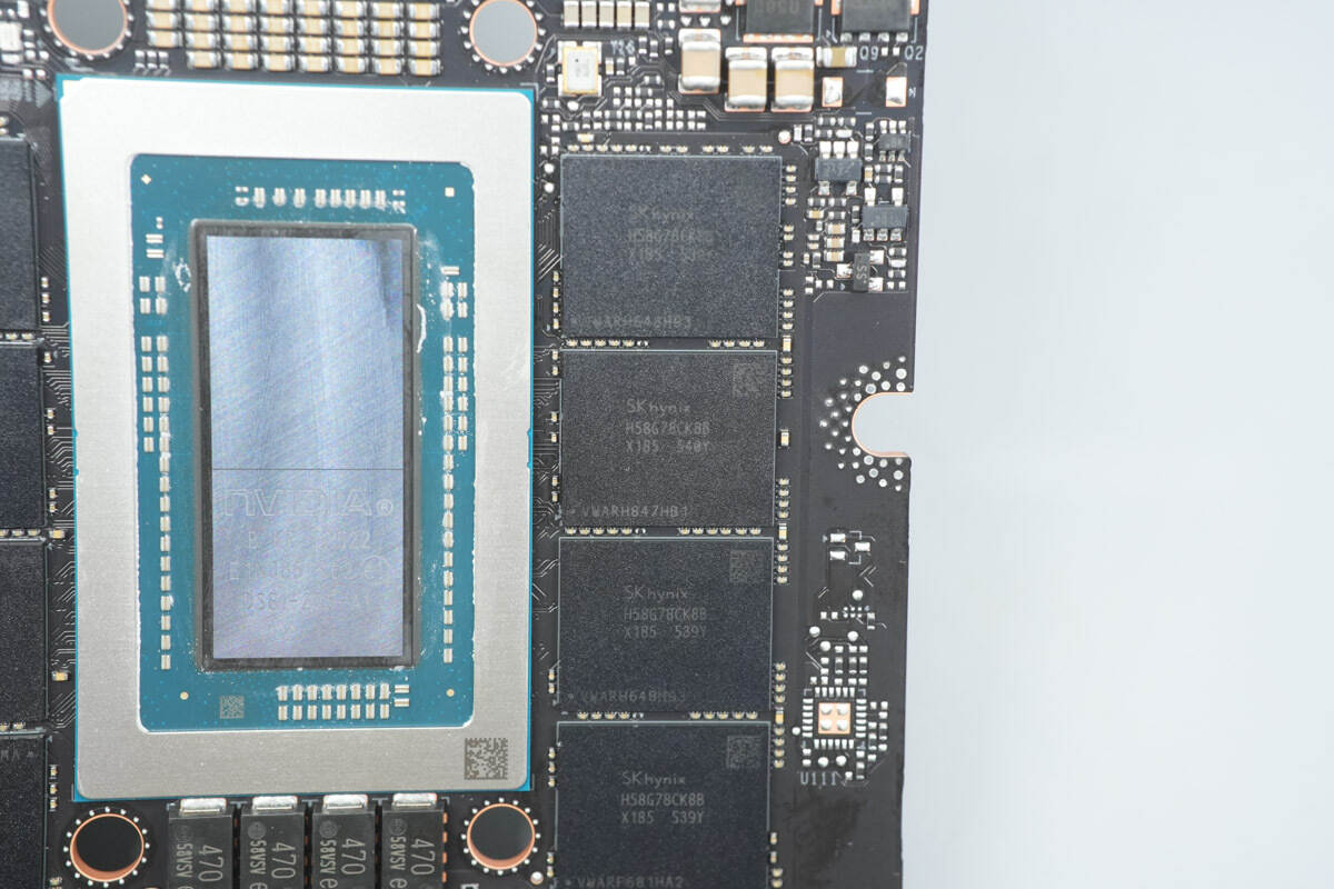

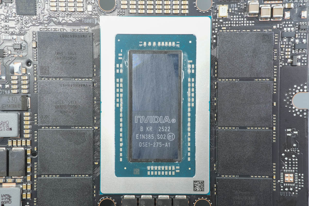

The NVIDIA GB10 superchip has a reinforced metal frame along the edges. The chip is marked with B KR 2522 E1N385.S02 DSE1-275-A1. It is manufactured using TSMC’s N3 3nm process and features a 2.5D package. The rectangular area on top is the SoC region, while the nearly square area below is the GPU region.

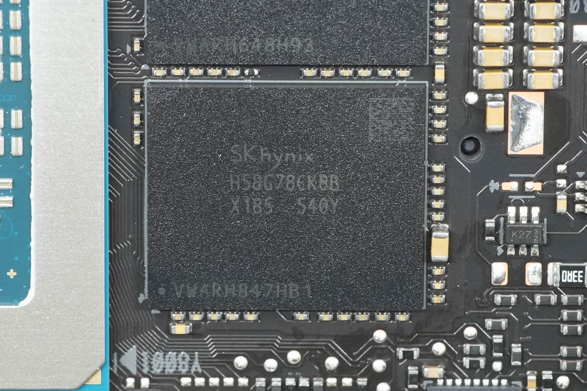

There are four memory chips located on the left side.
There are also four memory chips on the right side.
The memory chips are from SK Hynix, model H58G78CK8BX185. They are LPDDR5X memory, each with a capacity of 16 GB, using a 315-ball FBGA package.

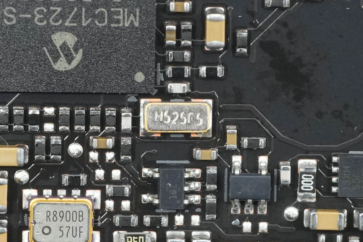

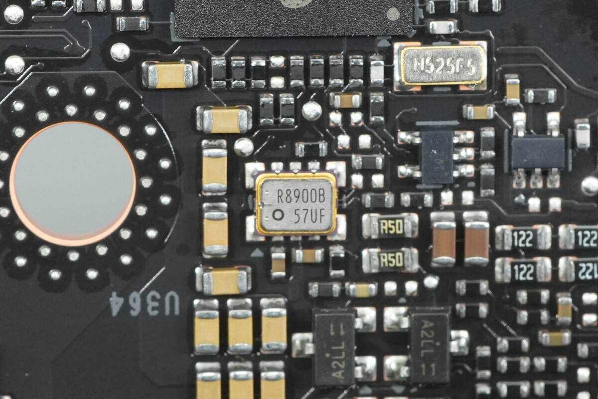

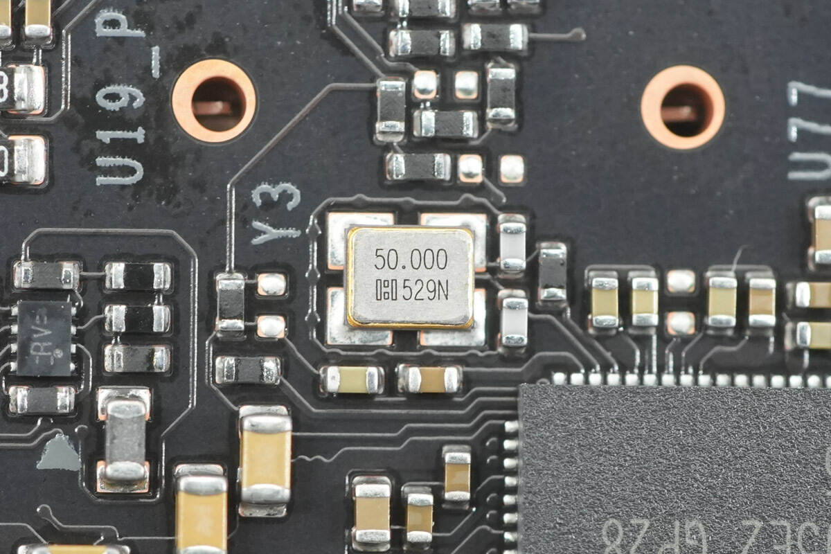

Close-up of the clock crystal oscillator.
Close-up of another clock crystal oscillator.

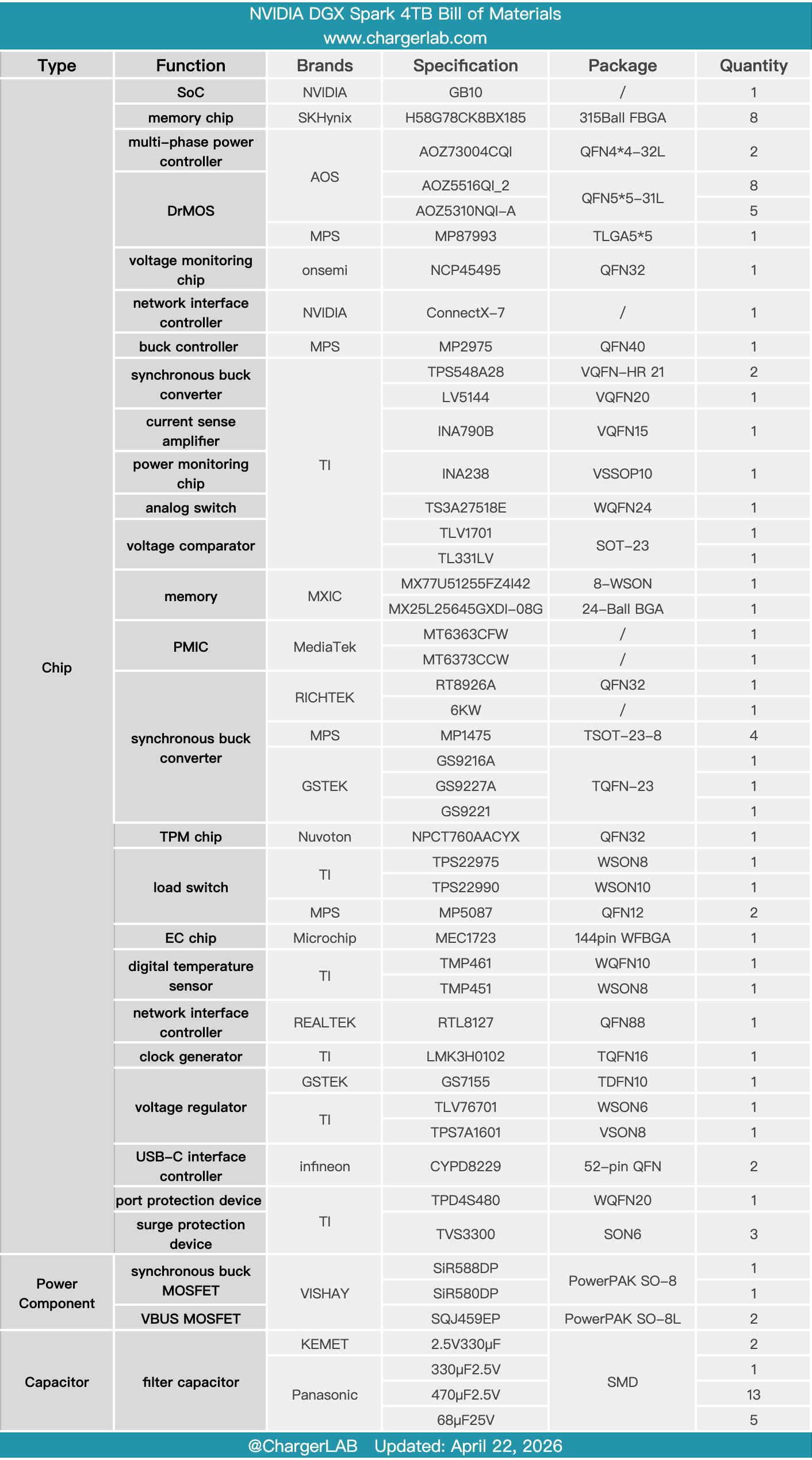

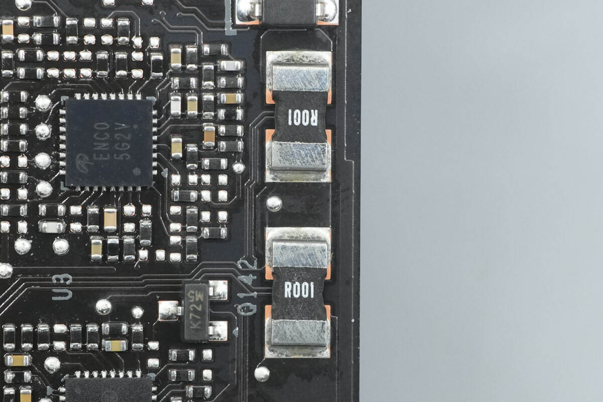

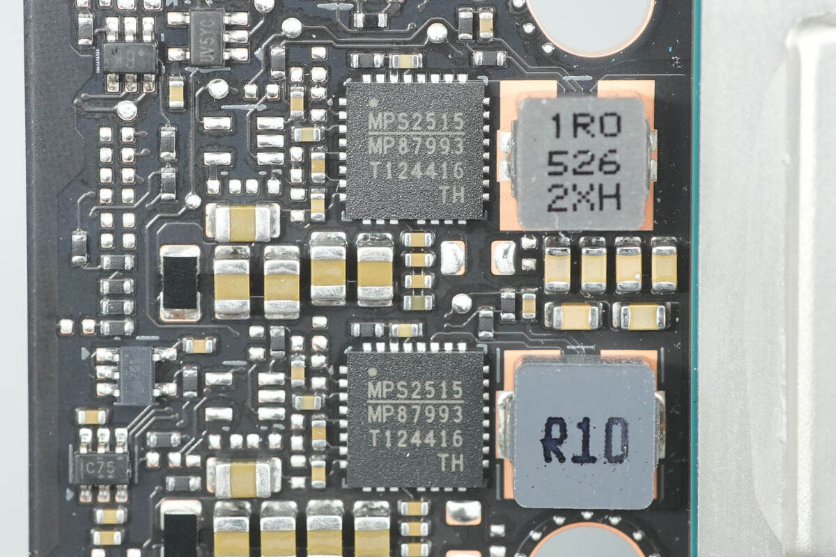

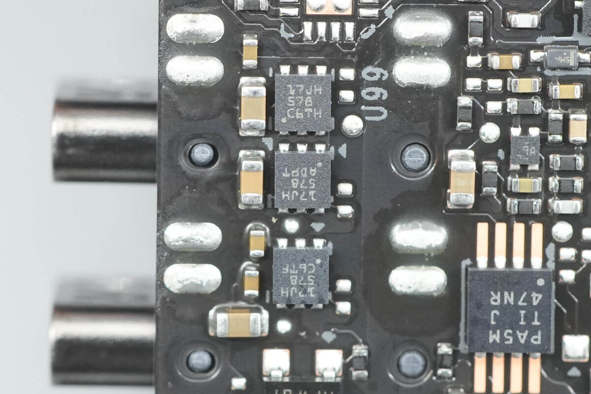

The multi-phase power controller is from AOS, marked ENC0, model AOZ73004CQI. This chip is designed for the Blackwell GPU platform and complies with the OVR-4-22 standard. It supports 4-phase applications and features a proprietary high-performance advanced transient regulator control scheme, dynamic phase current balancing, and seamless CCM-to-DCM control. The chip comes in a 4×4 mm QFN-32L package.
Here is the information about AOS AOZ73004CQI.

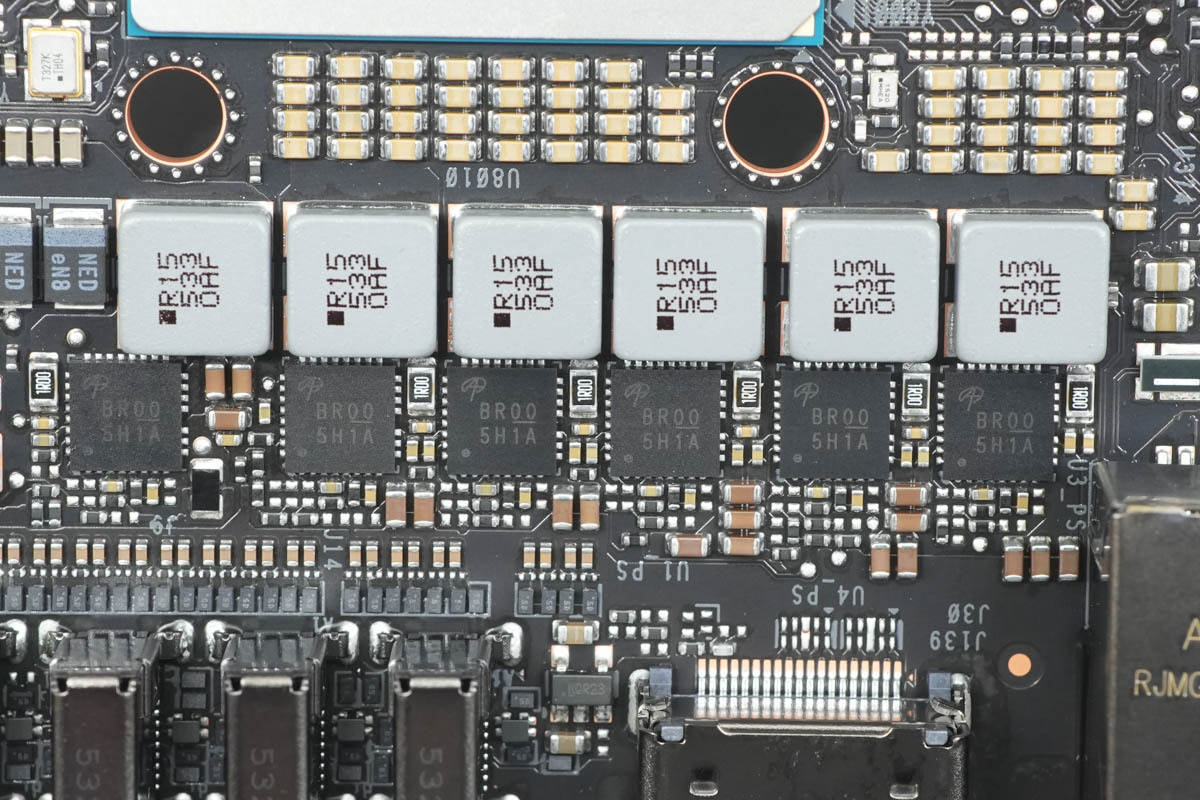

The other multi-phase buck controller also uses the AOS AOZ73004CQI.

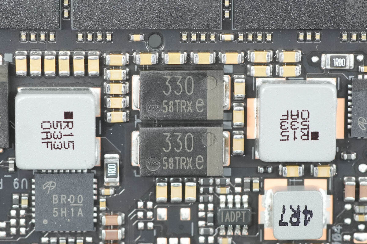

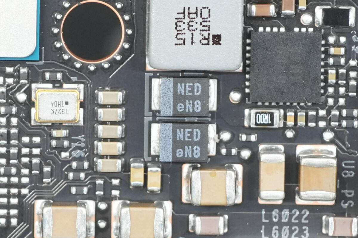

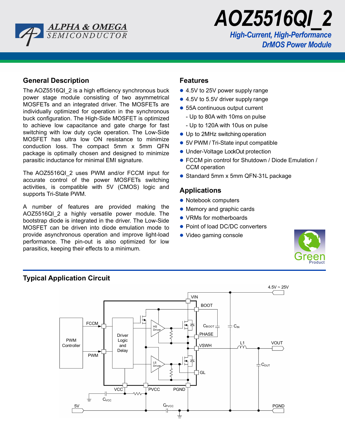

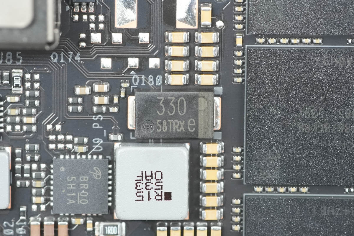

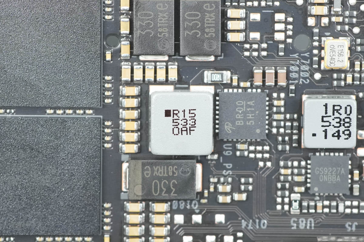

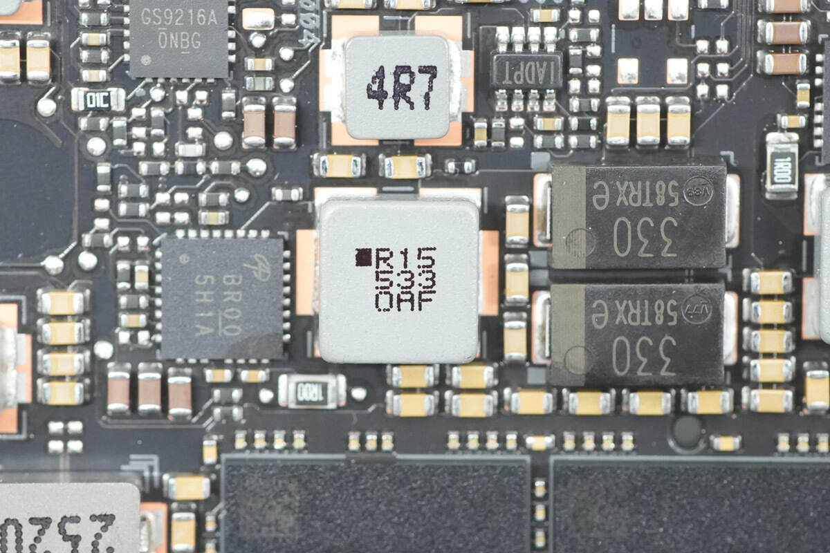

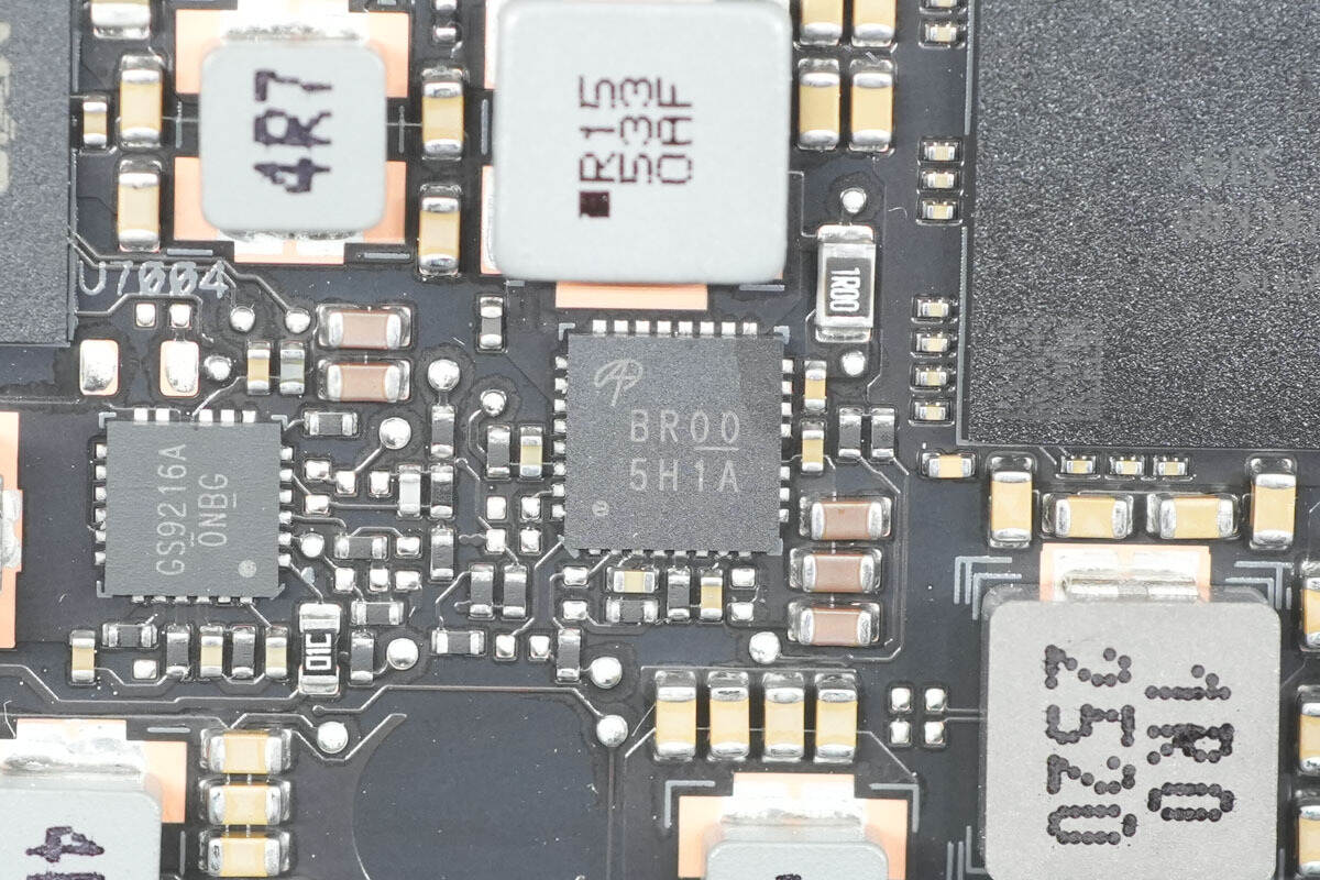

The DrMOS components are from AOS, marked BR00, model AOZ5516QI_2. They are high-performance, high-current DrMOS devices, supporting an input voltage range of 4.5–25V, with a continuous output current capability of 55A. The switching frequency can reach up to 2 MHz. They support 5V PWM and tri-state inputs, feature under-voltage lockout protection, and are packaged in a 5×5 mm QFN-31L package.
Here is the information about AOS AOZ5516QI_2.

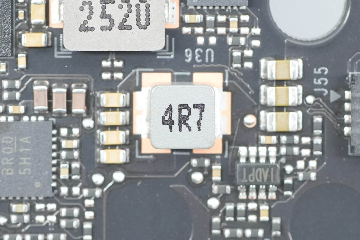

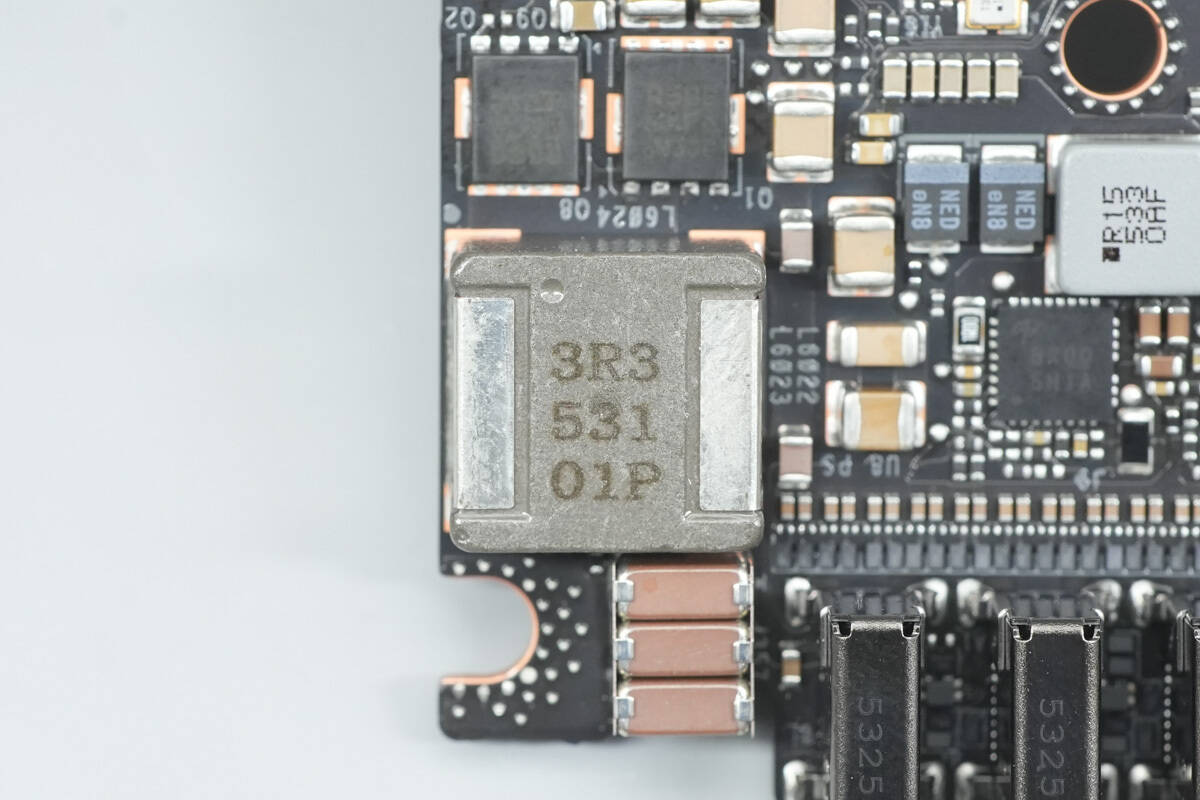

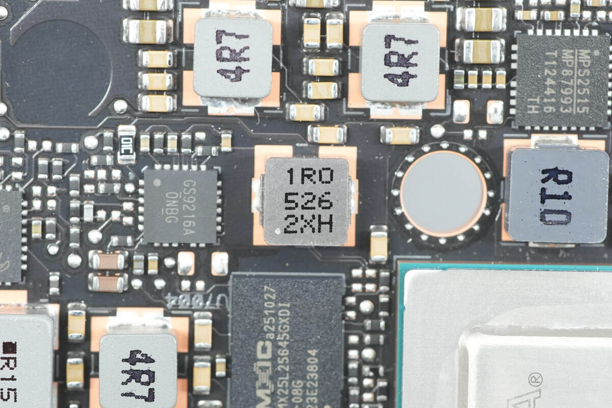

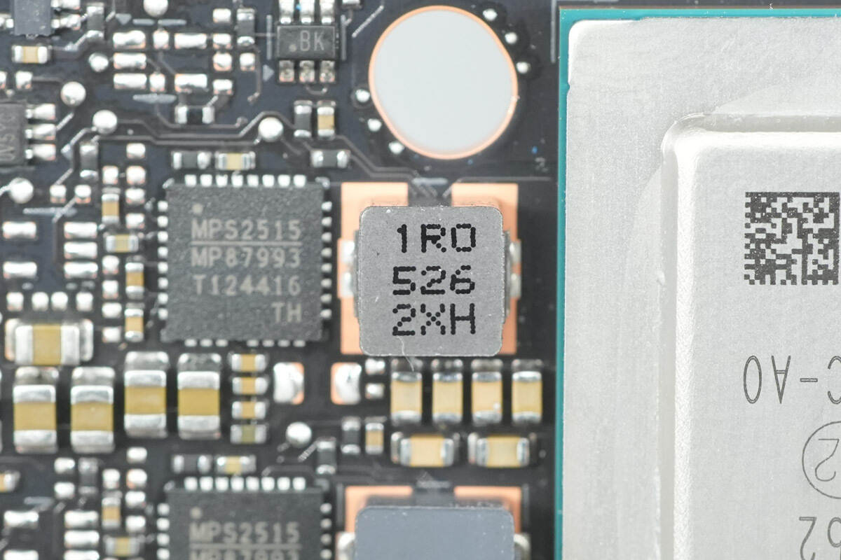

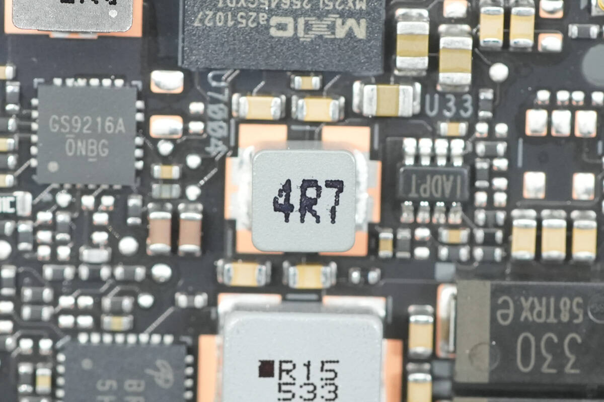

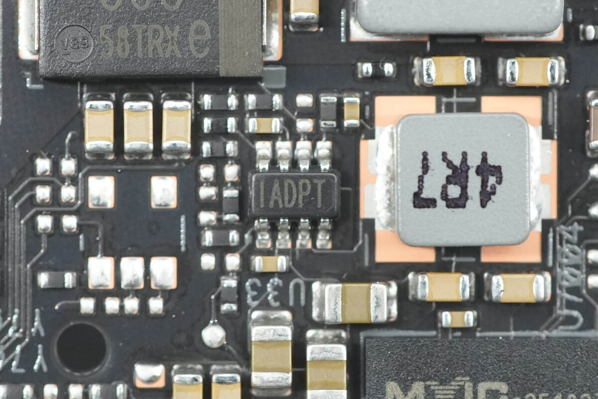

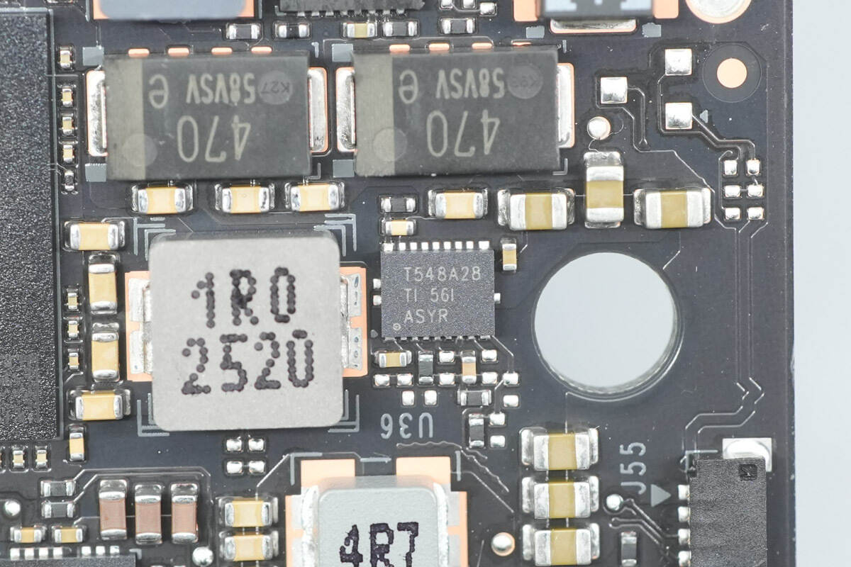

Close-up of the 0.15μH buck inductors.
The polymer tantalum capacitor is from KEMET, with a specification of 2.5V and 330 μF.

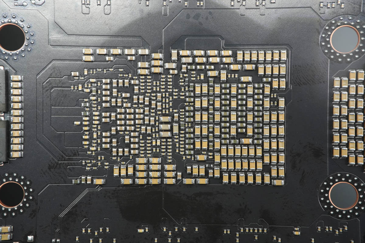

A close-up of the MLCC capacitors used for filtering.

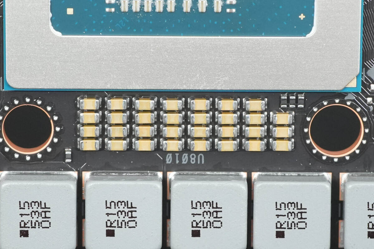

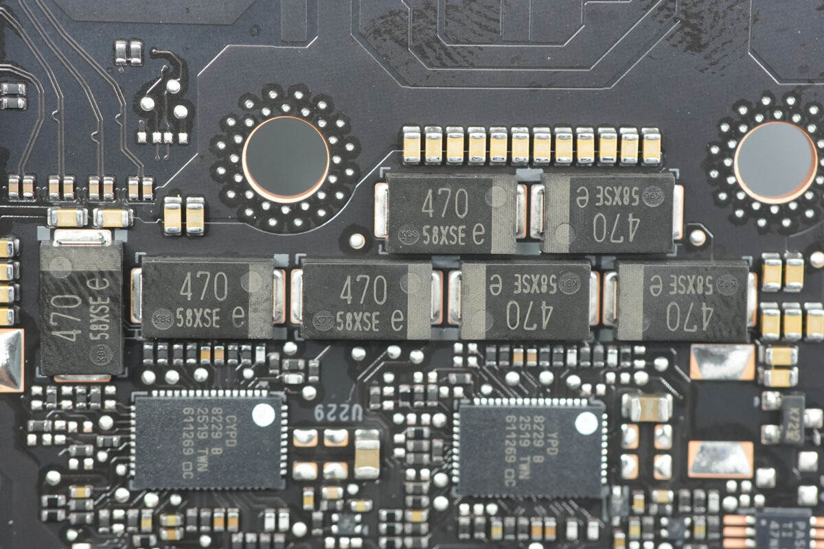

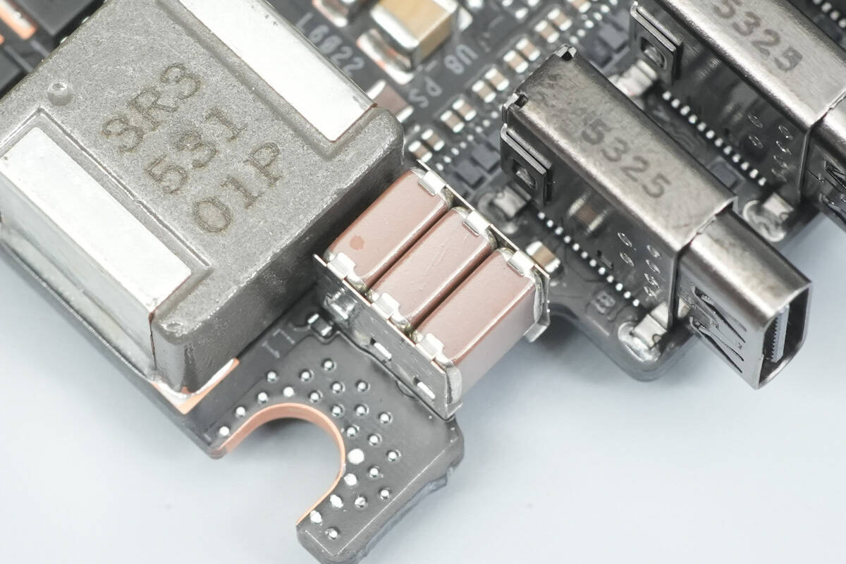

The backside of the PCBA module is equipped with seven filtering capacitors, rated at 470 μF, 2.5V.
The DrMOS uses the AOS AOZ5516QI.
A close-up of the 0.15 μH buck inductor.
The filtering capacitors are from Panasonic, part of the SPCAP series, rated at 330 μF, 2.5V.
DrMOS uses AOS AOZ5516QI_2.
Close-up of the 0.15μH buck inductor.
The filter capacitor is rated at 330μF 2.5V.

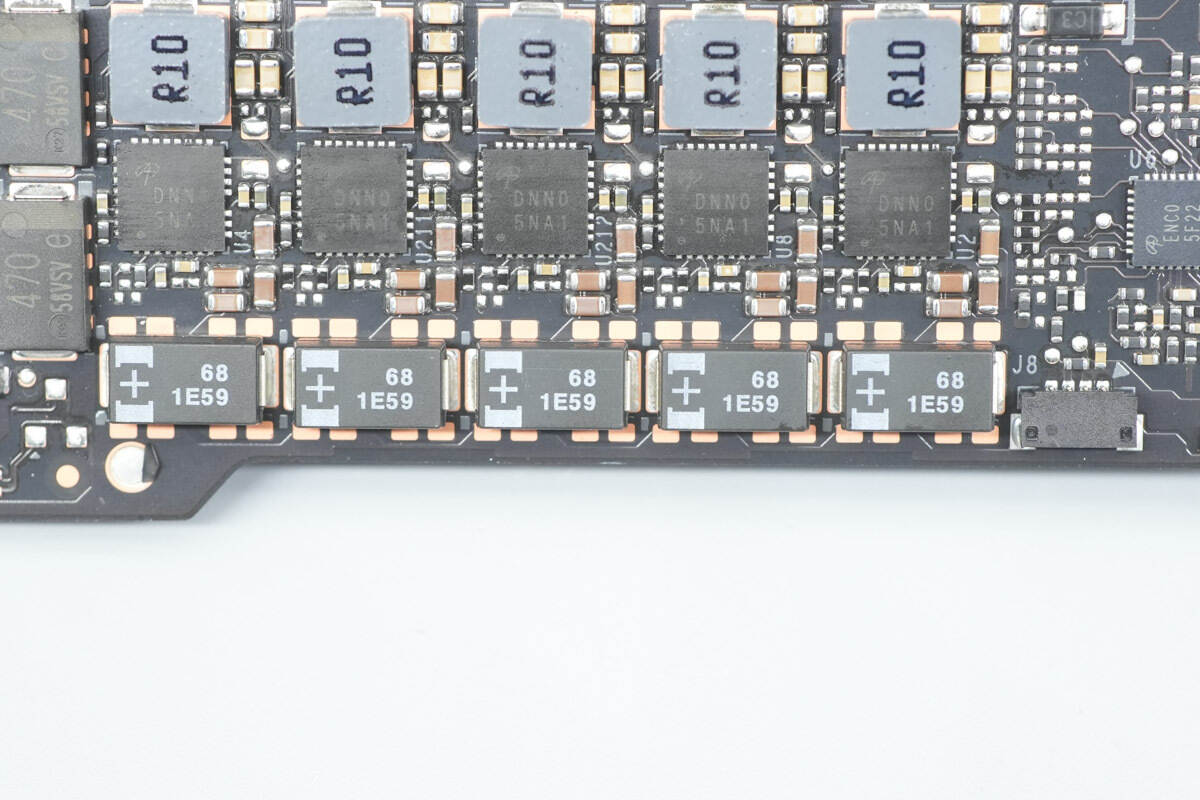

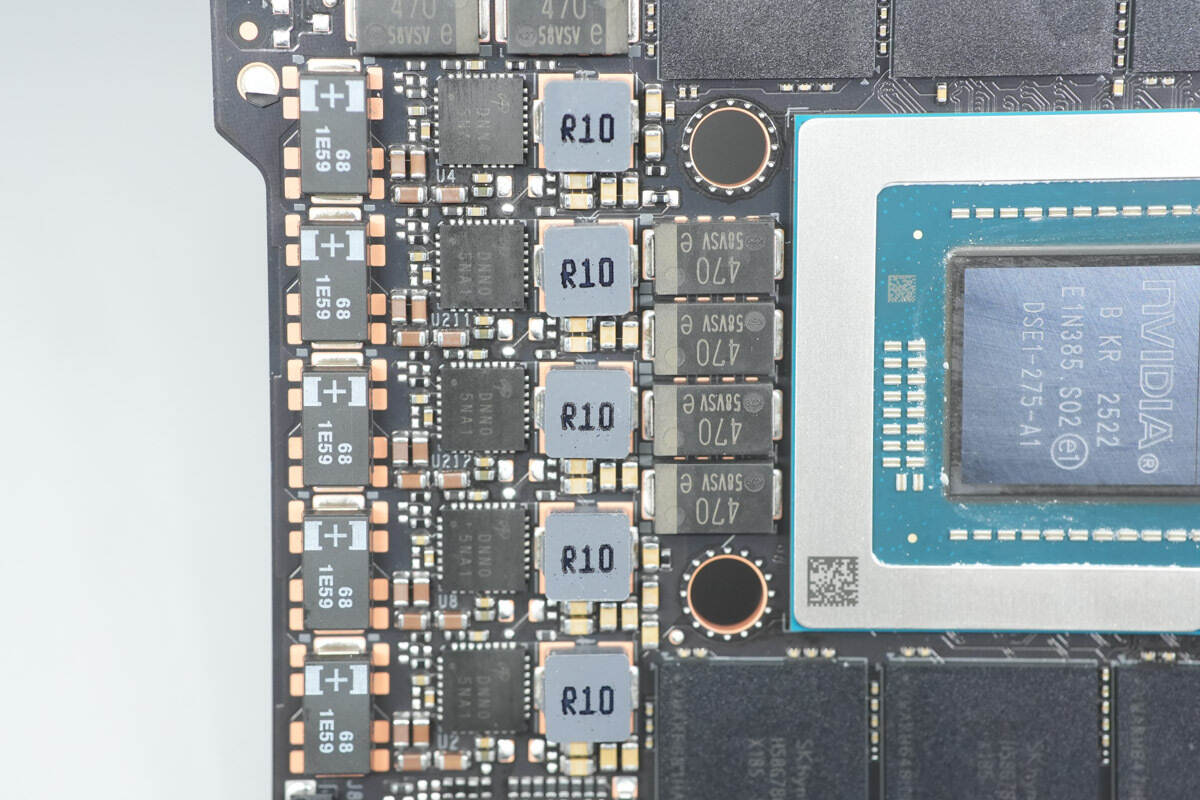

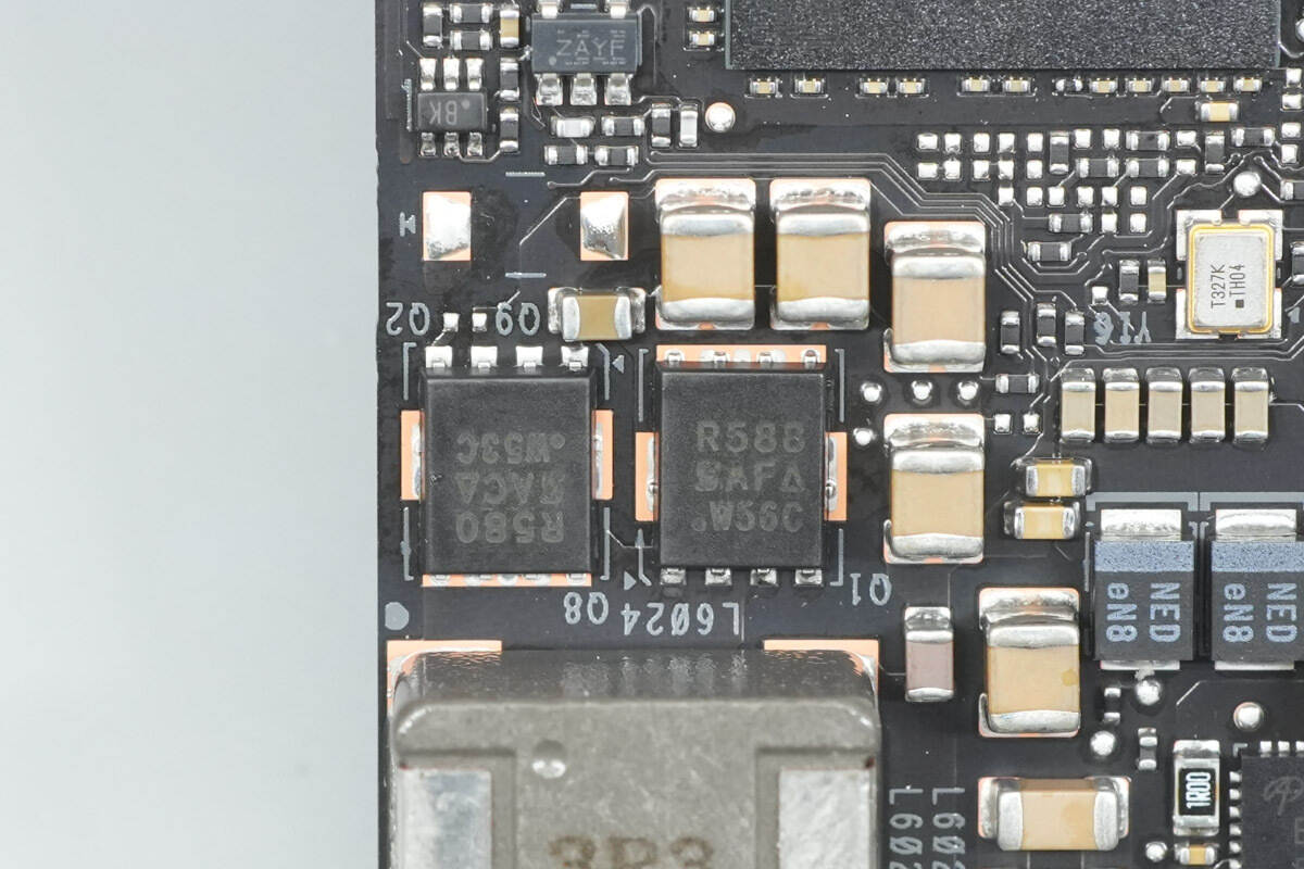

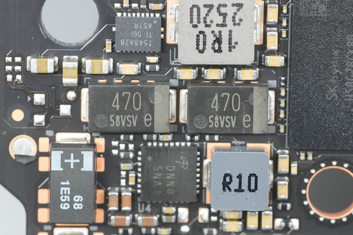

The lower DrMOS devices are also from AOS, marked with DNN0 and identified as AOZ5310NQI-A. They are high-performance, high-current DrMOS devices supporting a 4.5–18V supply range, with up to 60A continuous output current. The switching frequency reaches 2 MHz, and they support 3V/5V PWM and tri-state inputs. They also feature undervoltage lockout protection and come in a QFN 5×5-31L package.
Here is the information about AOS AOZ5310NQI-A.

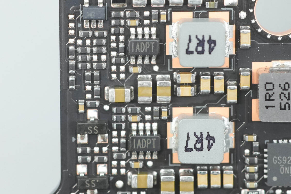

The filter capacitors are from Panasonic and are rated at 68μF 25V.

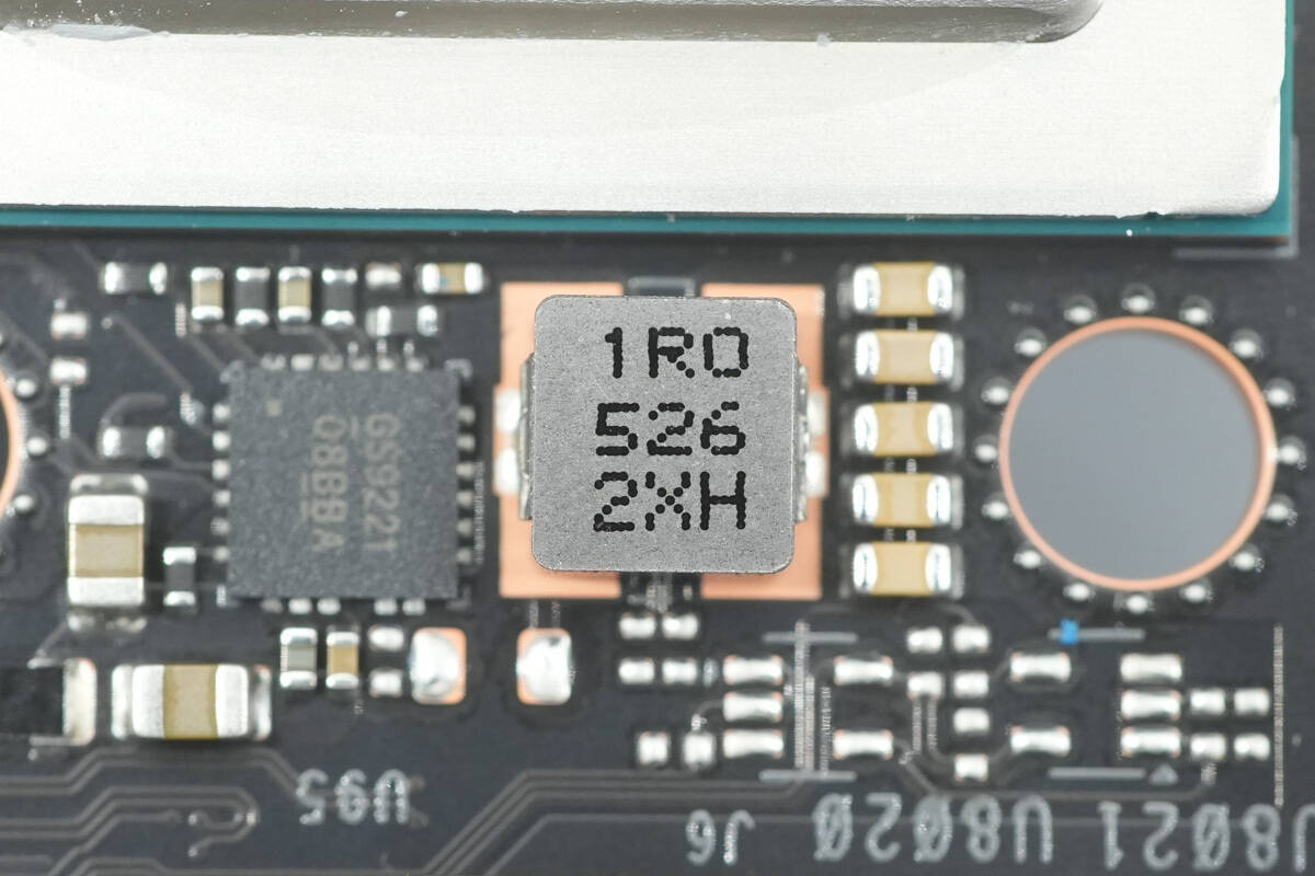

Close-up of the 0.1μH buck inductors.
The filter capacitors are rated at 470μF 2.5V.
These two filter capacitors have the same specifications.

The synchronous buck controller is from Texas Instruments, model LV5144. It features a wide duty cycle range, supports a 6–95V operating voltage range, and provides an output voltage range of 0.8–60V. The switching frequency is adjustable from 100 kHz to 1 MHz, and it comes in a VQFN-20 package.

The PMIC is from MediaTek, model MT6373CCW.

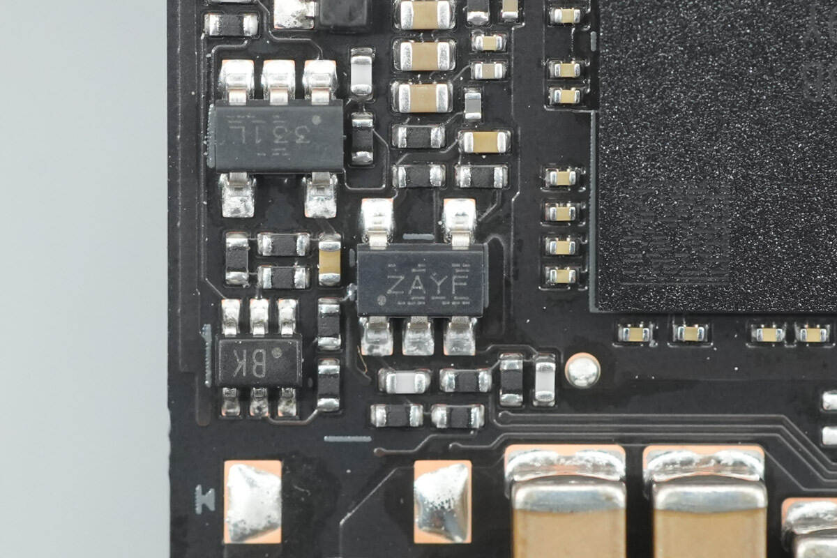

The voltage comparator is from Texas Instruments, marked with ZAYF and identified as TLV1701. It is a micropower comparator supporting a 2.2–36V supply range, and comes in a SOT-23 package.
The voltage comparator is from Texas Instruments, marked with 331L and identified as TL331LV. It is a low-voltage standard comparator and comes in a SOT-23 package.

The buck controller is from MPS, model MP2975, and uses a QFN40 package.
The DrMOS is from MPS, model MP87993, and uses a TLGA5*5 package.
Close-up of a 1μH buck inductor.

The synchronous buck chip is from GStek, model GS9216A, and uses a TQFN-23 package.
Close-up of a 1μH alloy buck inductor.

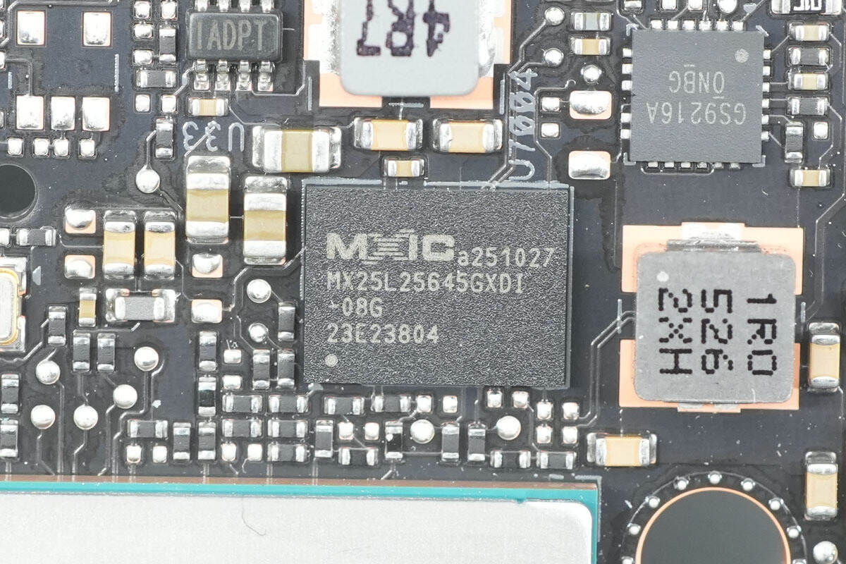

The memory is from MXIC, model MX25L25645GXDI-08G. It has a capacity of 256 Mb and operates within a 2.7–3.6V voltage range. The device comes in a 24-ball BGA package.

The synchronous buck chip is from GStek, model GS9221. It supports a 2.7–26V input voltage range and a 0.6–12V output voltage range, with up to 6A output current. The device integrates MOSFETs, supports a 100–600 kHz switching frequency, and features overvoltage, undervoltage, overtemperature, and overcurrent protection. It comes in a TQFN-23 package.

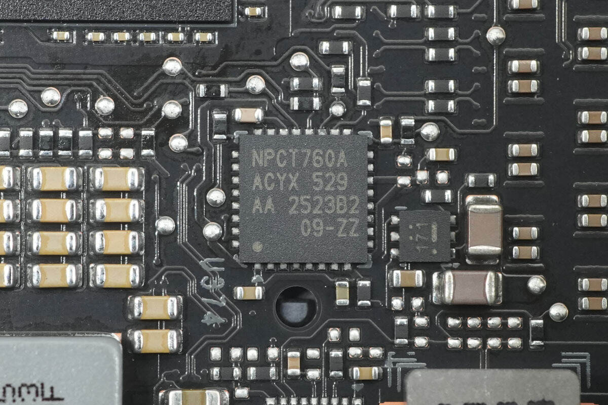

The TPM chip is from Nuvoton, model NPCT760AACYX, and comes in a QFN-32 package.
The EC chip is from Microchip, model MEC1723. It integrates an ARM Cortex-M4F embedded processor, supports eSPI and I²C interfaces, and comes in a 144-pin WFBGA package.
Close-up of an SMD crystal oscillator.
The real-time clock module is model RA8900CE. It integrates a 32.768 kHz clock and a digitally temperature-compensated crystal oscillator, and supports an I²C interface.
Close-up of a 50.000MHz clock crystal oscillator.

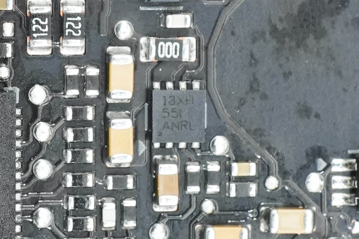

The load switch is from Texas Instruments, marked with 13XH and identified as TPS22975. It is a 5.7V, 6A load switch with 16 mΩ on-resistance, featuring adjustable rise time, selectable output discharge, and thermal shutdown protection. The device comes in a WSON-8 package.

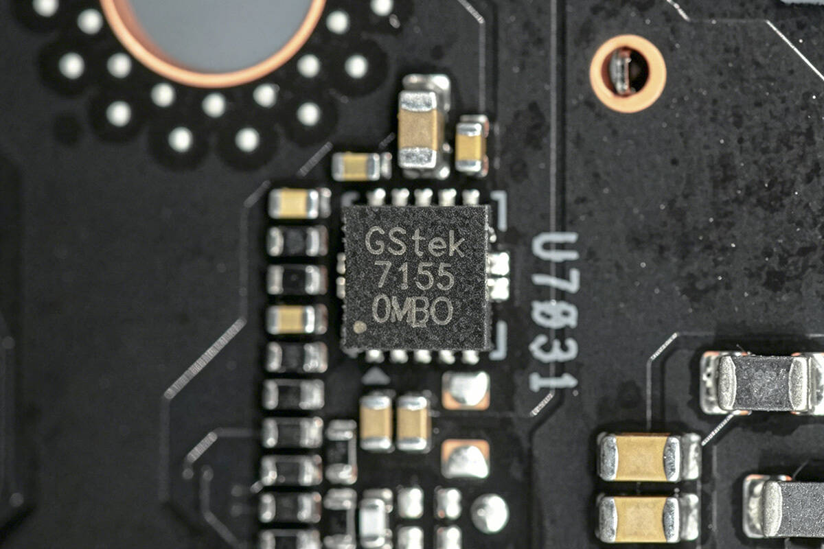

The voltage regulator is from GStek, model GS7155. It is a low-dropout regulator with up to 3A output current and comes in a TDFN-10 package.

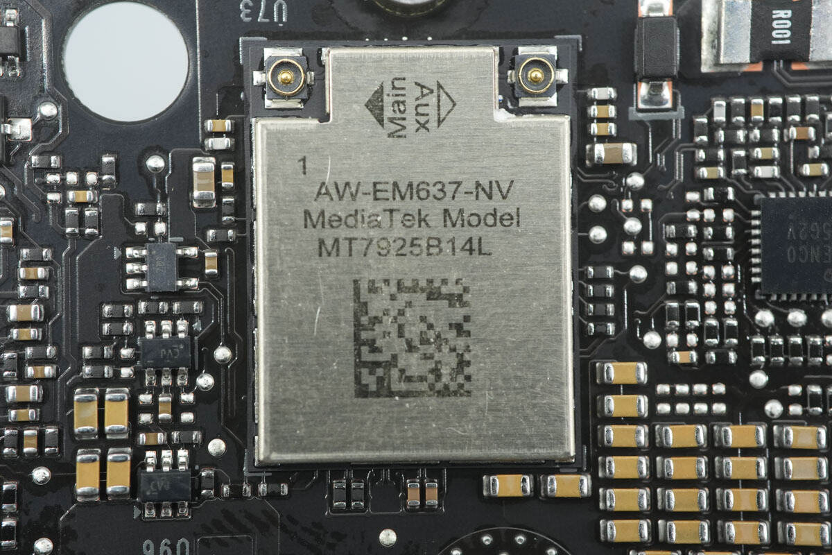

The wireless network module, model AW-EM637-NV, integrates a MediaTek MT7925 chipset.

The surge protection devices are from Texas Instruments, marked with 17JH and identified as TVS3300. It is a 33V flat-clamp surge protection device featuring low leakage current and low capacitance, and comes in a SON-6 package.
The voltage regulator is from Texas Instruments, marked with PA5M and identified as TPS7A1601. It supports a 3–60V input voltage range, features a 5 μA quiescent current, and provides up to 100 mA output current. The device is a linear regulator and comes in a VSON-8 package.

The USB-C sockets are secured using through-hole soldering, and TVS diodes are used for overvoltage protection.
A close-up of the 10GbE network interface.
A close-up of the heatsink fins above the QSFP interface.

It uses an aluminum alloy enclosure in an SFF form factor. The rear panel is equipped with four USB-C ports, an HDMI interface, a 10GbE network port, and two QSFP ports. The server is powered by a PD 3.1 power supply with a 48V 5A rating.
After taking it apart, we found that the PCBA module is found to be secured to the enclosure via an aluminum alloy baseplate, with the heatsink mounted directly on it. Inside, the system integrates a GB10 superchip, surrounded by eight SKHynix LPDDR5X memory chips on the left and right sides. On the top and bottom sides, there is an Alpha & Omega Semiconductor AOZ73004CQI multiphase power controller, along with AOZ5516QI_2 and AOZ5310NQI-A DrMOS devices.

At the bottom of the system, there is a 2242 M.2 SSD slot, with the 4TB configuration pre-installed with a Samsung PM9E1 SSD. Thermal design includes a vapor chamber for the GB10 chip, heat pipes for the network controller and DrMOS stages, and thermal pads applied across memory, DrMOS, wireless module, and SSD to ensure stable and reliable operation.
