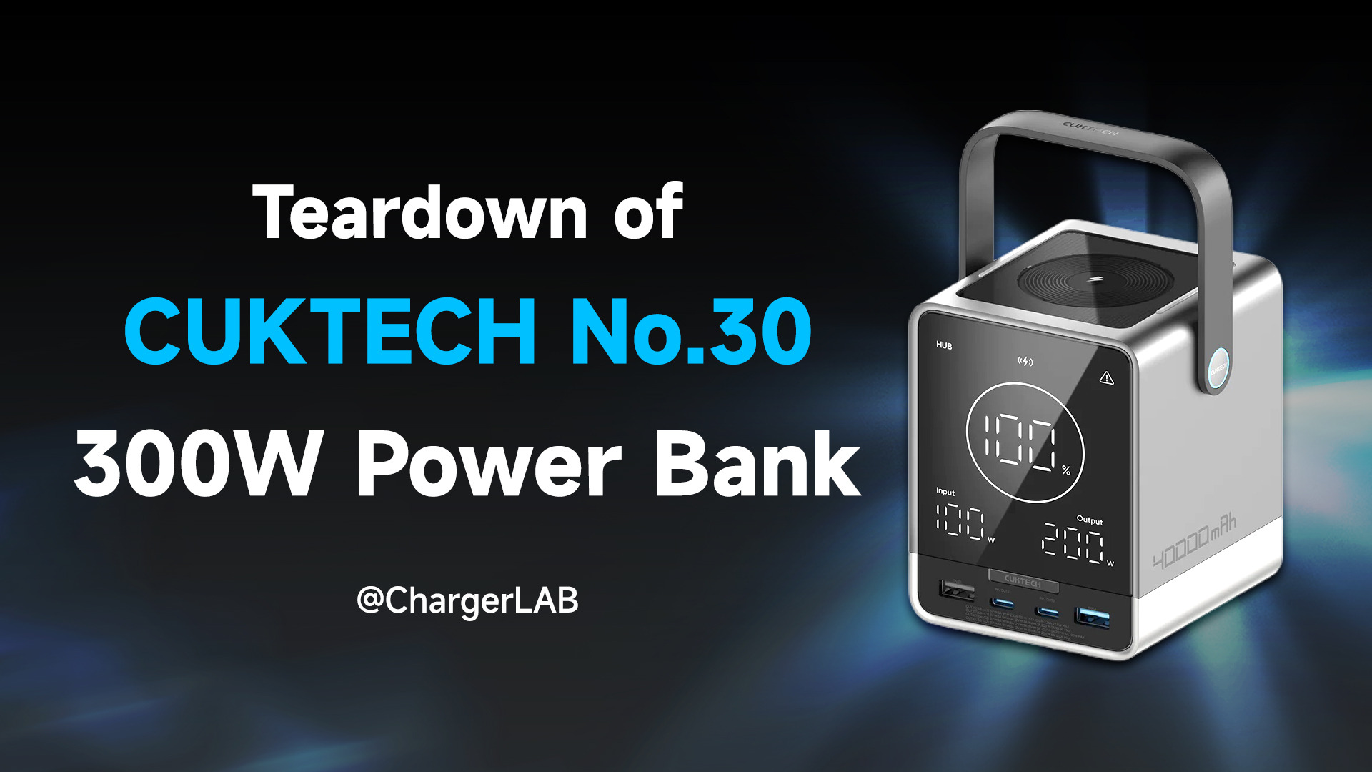

Teardown of CUKTECH No.30 PD3.1 & 300W Power Bank
June 29, 2023
You can support them on Indiegogo: https://igg.me/at/cuktech/x#/
Today, we got a powerful power bank from CUKTECH, called No.30. It's equipped with a 40000 mAh battery pack and the total output power can be up to 300W. But you can still take it anywhere, like camping and traveling. Let's take it apart to how it can be so small but powerful.
