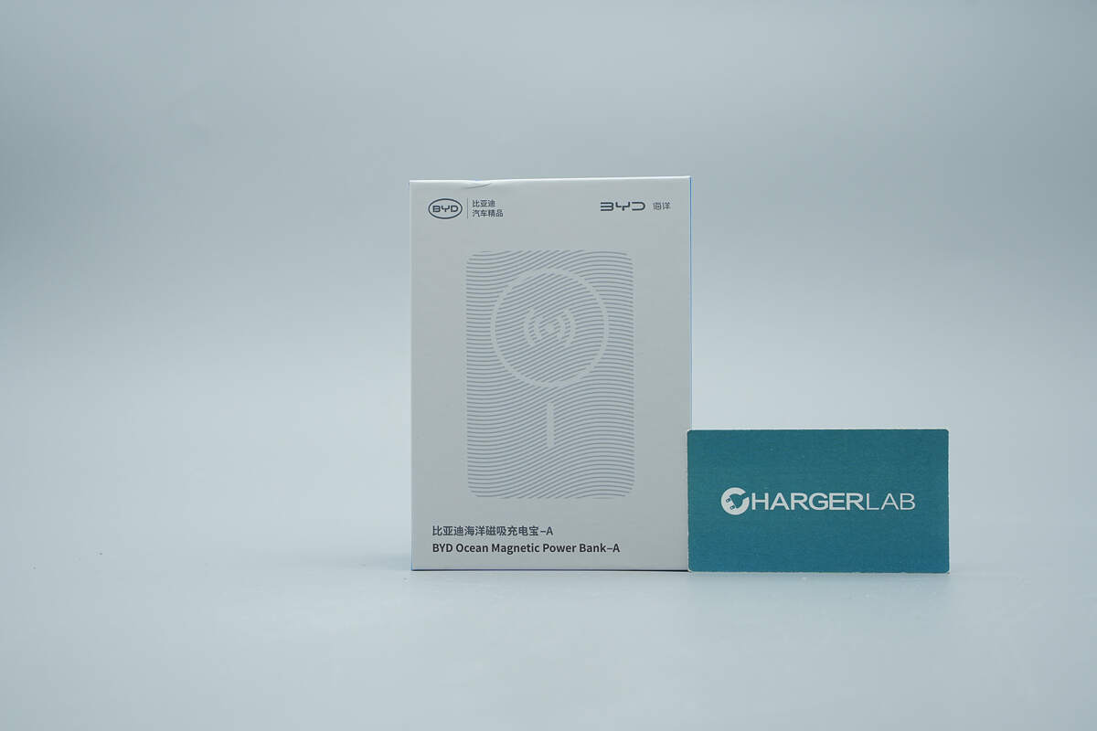

The packaging box is white and features an outline illustration of the power bank. The BYD logo is printed in the top-left corner, with the product name placed below it.
Teardown of BYD Ocean Series Magnetic Power Bank YM117 (Need for Speed Edition)-Chargerlab

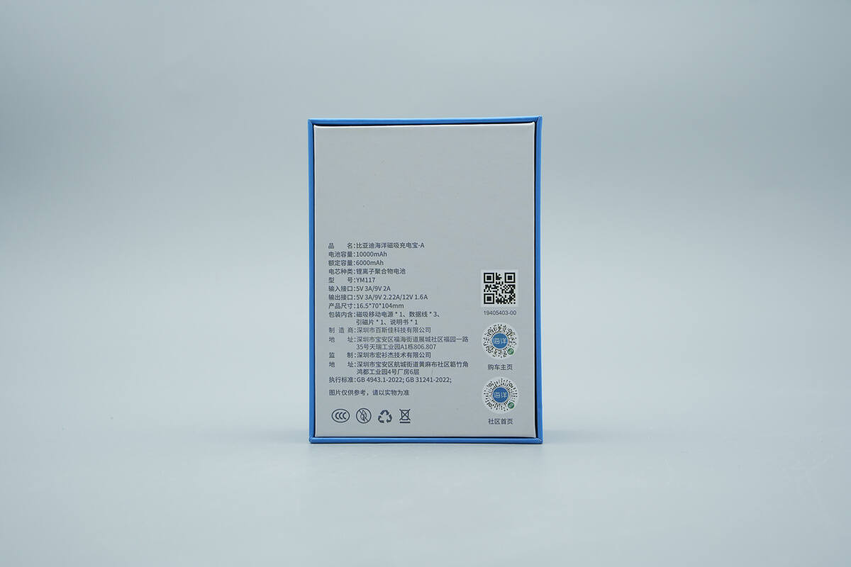

The back side is printed with the technical specifications and certification markings.

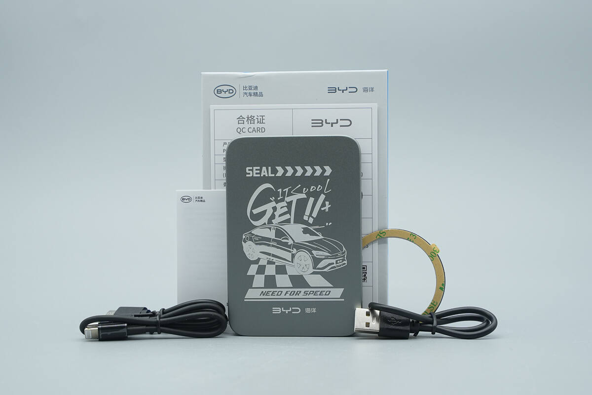

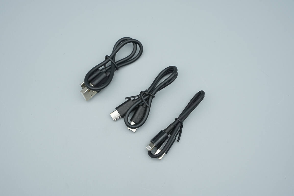

The package includes the power bank, three short cables, a magnetic alignment ring, a product certificate of conformity, and a user manual.
The three included cables are USB-A to USB-C, USB-C to USB-C, and USB-C to Lightning, covering charging needs across different device types.

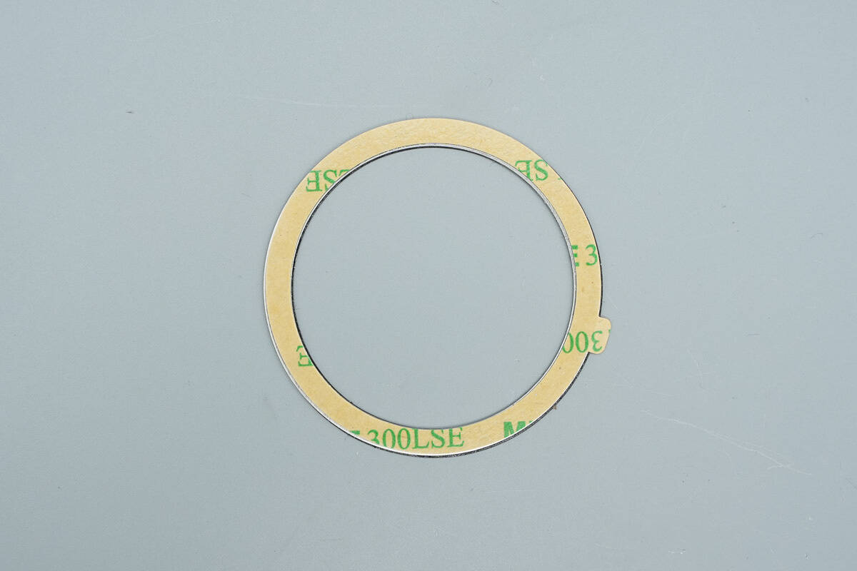

The magnetic alignment ring comes with adhesive tape on the back for easy installation.

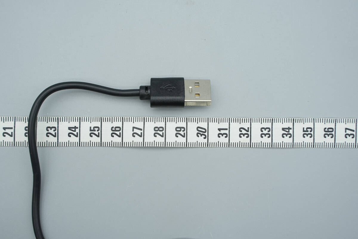

The length of the USB-A to USB-C cable is about 30 cm (11.81 inches).

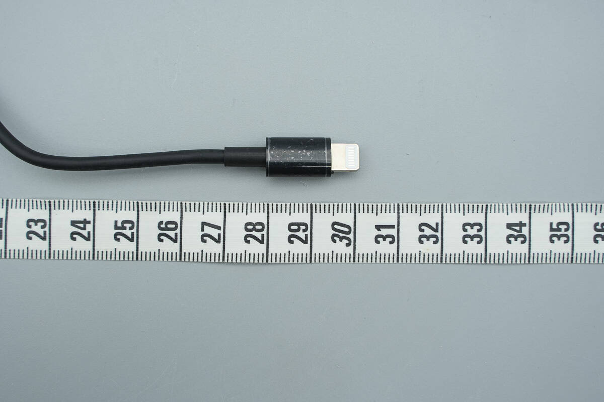

The length of the USB-C to Lightning cable is about 30 cm (11.81 inches).

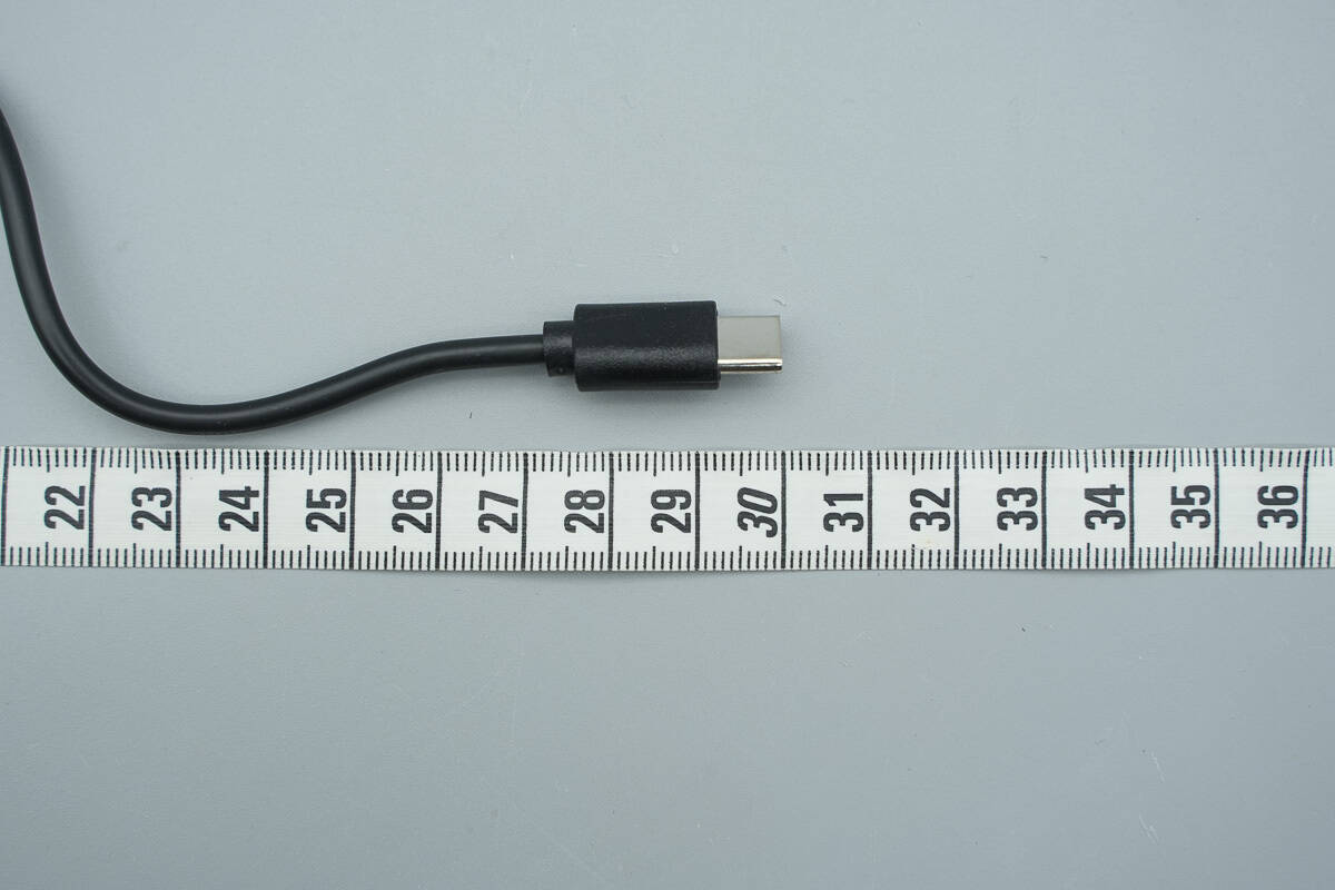

The length of the dual USB-C cable is about 30 cm (11.81 inches).

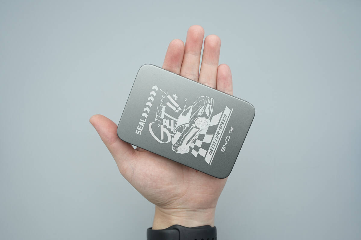

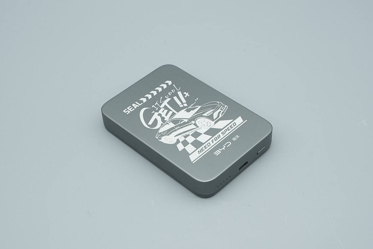

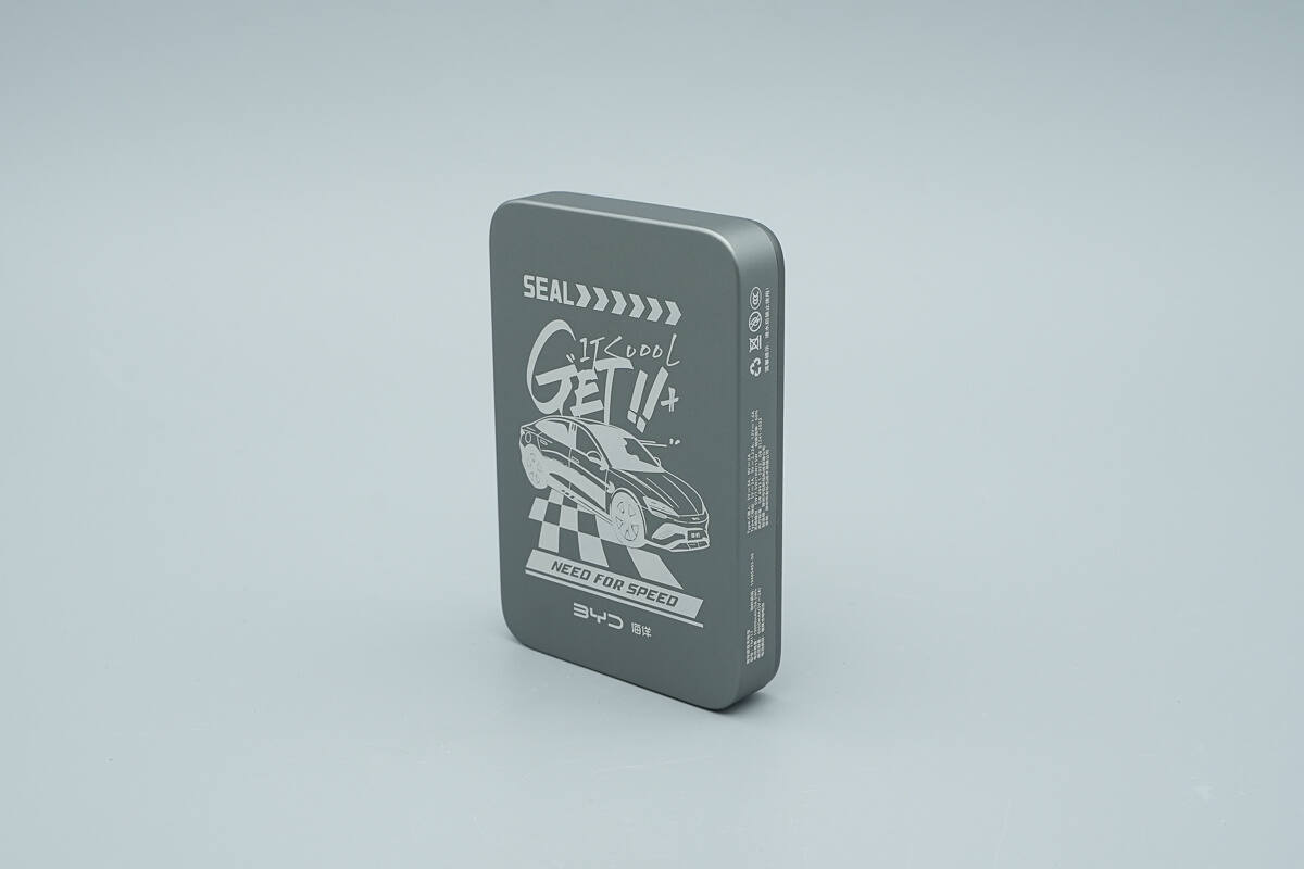

The power bank features a dark gray metal shell. The front side is printed with a graffiti-style illustration of the BYD Seal model in collaboration with Need for Speed, along with the “NEED FOR SPEED” branding.

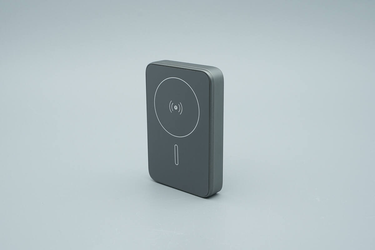

The wireless charging surface is coated with a skin-friendly material finish.
The edges feature smooth, rounded corner transitions on all four sides.

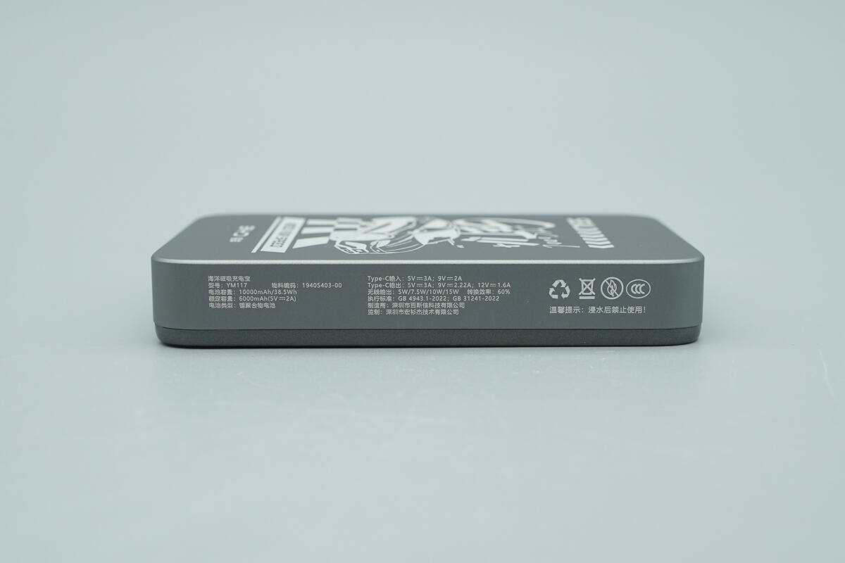

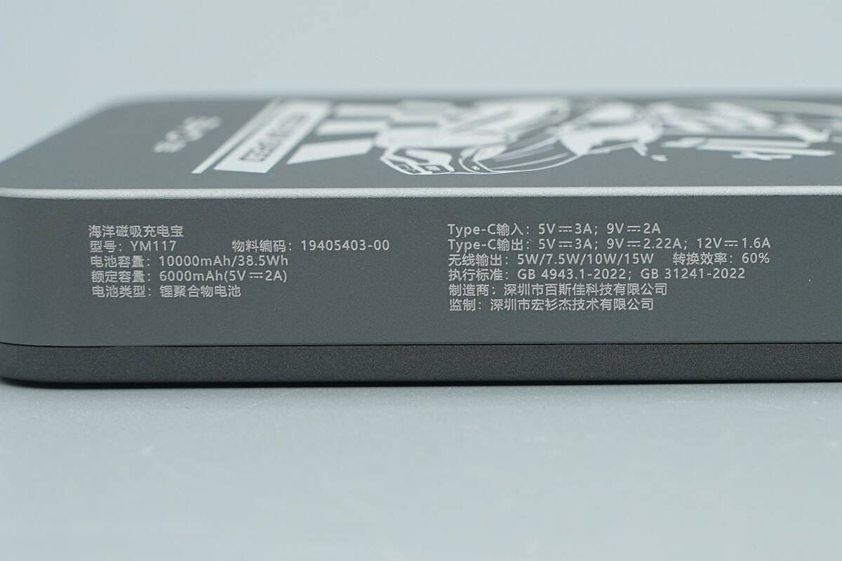

The side is printed with detailed technical specifications.
Model: YM117
Material code: 19405403-00
Battery capacity: 10,000mAh / 38.5Wh
Rated capacity: 6,000mAh (5V 2A)
Battery type: Lithium polymer battery
Type-C input: 5V 3A, 9V 2A
Type-C output: 5V 3A, 9V 2.22A, 12V 1.6A
Wireless output: 5W / 7.5W / 10W / 15W
Conversion efficiency: 60%
Standards: GB 4943.1-2022; GB 31241-2022

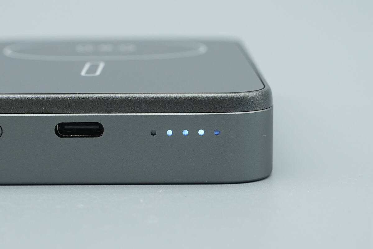

The bottom is equipped with a power button, a USB-C bidirectional fast-charging port, and five LED indicator lights.
When the power button is pressed, the five LED indicator lights turn on. The first indicator on the left lights up during wireless charging or fast charging, while the remaining four white LEDs indicate the battery level.

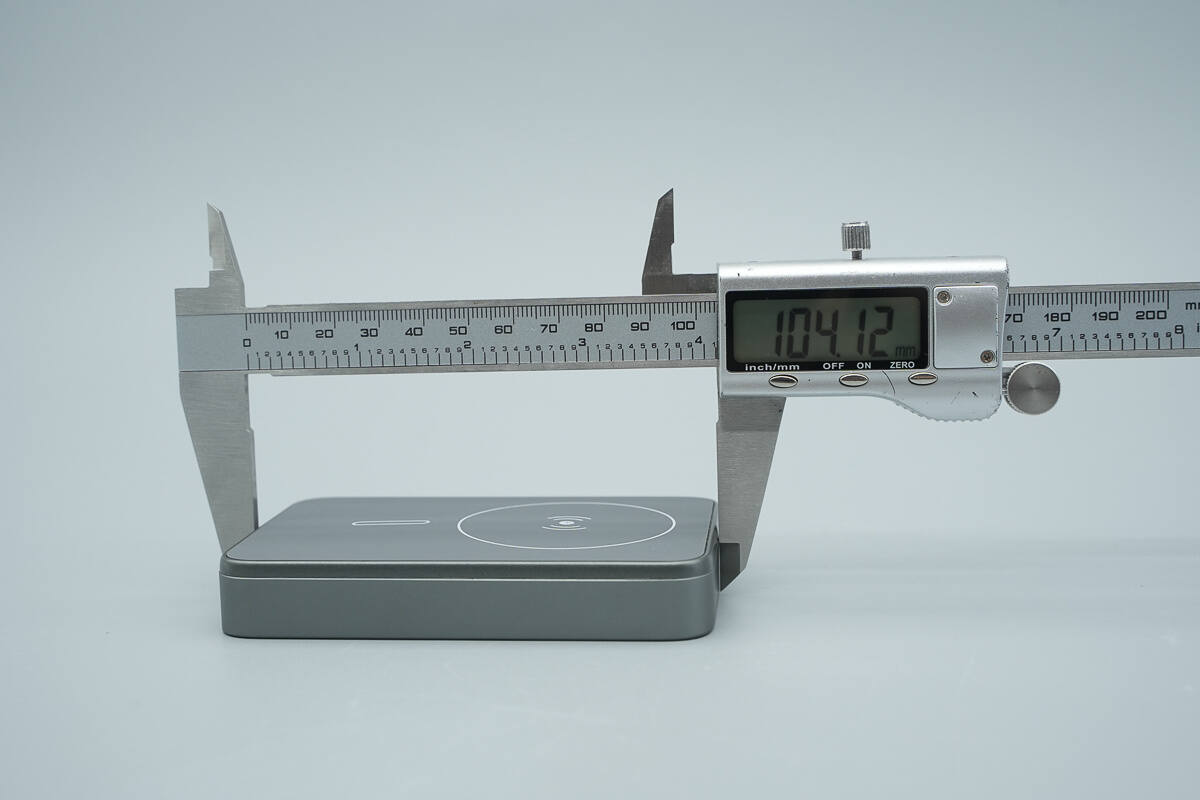

The length of the power bank is about 104.12 mm (4.099 inches).

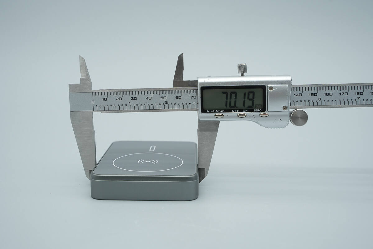

The width is about 70.19 mm (2.76 inches).

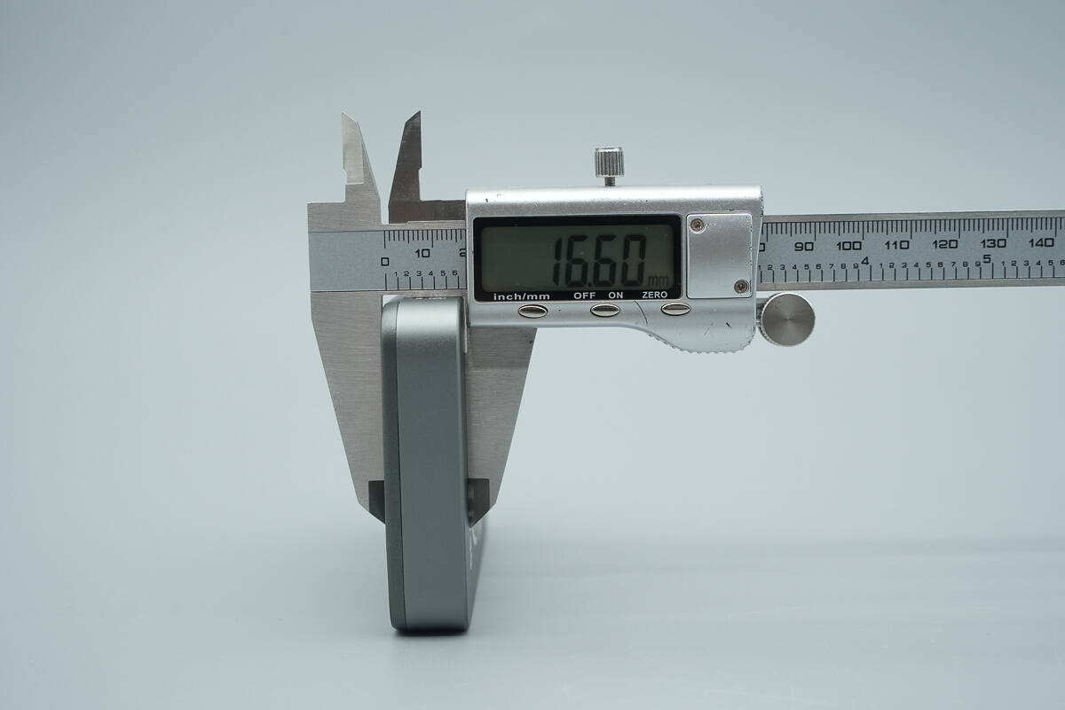

The thickness is about 16.60 mm (0.65 inches).

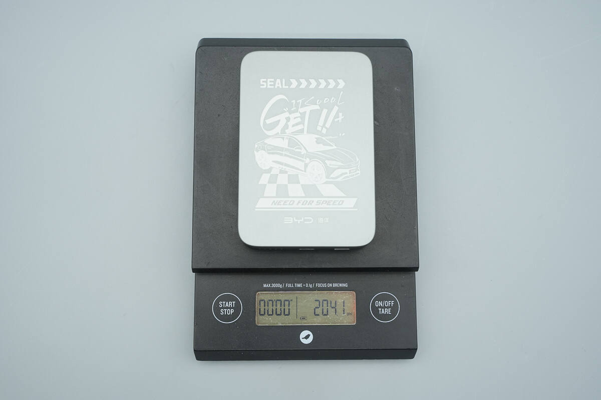

The weight is about 204.1 g (7.2 oz).

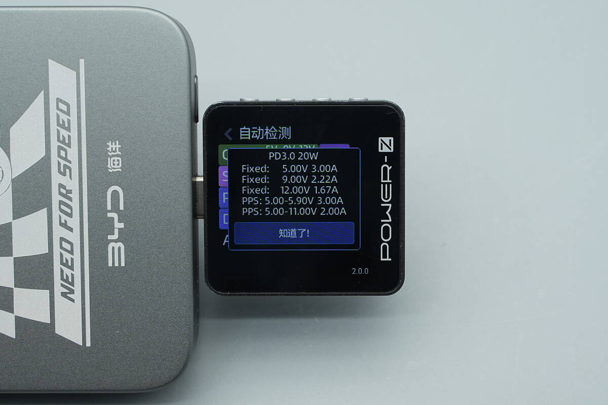

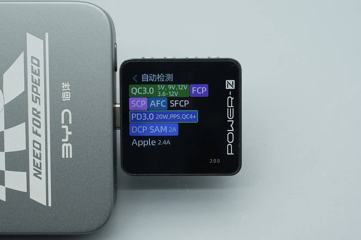

ChargerLAB POWER-Z KM003C shows that the USB-C port supports QC3.0, FCP, SCP, AFC, PD3.0, PPS, QC4+, DCP, SAM 2A, and Apple 2.4A charging protocols.
It also supports three fixed PDO profiles of 5V3A, 9V2.22A, and 12V1.67A, as well as two PPS voltage ranges: 5.00-5.90V3A and 5.00-11.00V2A.

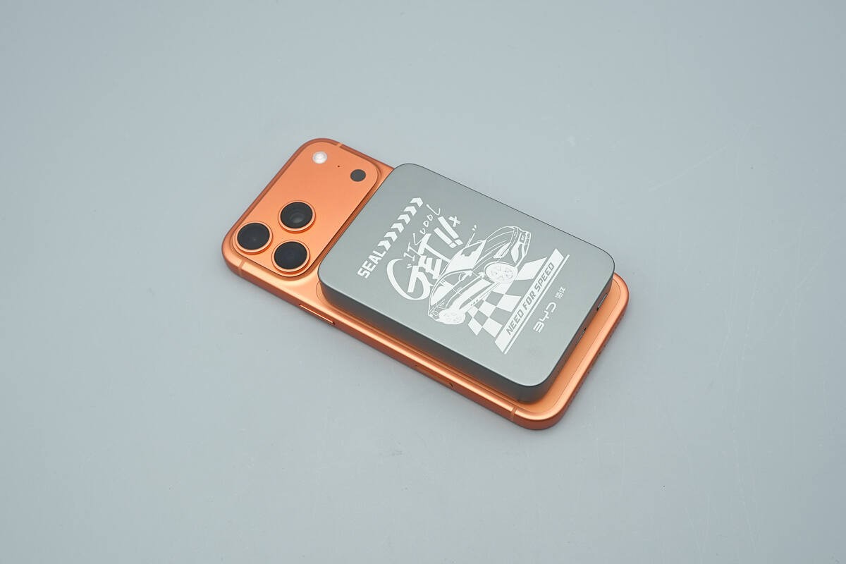

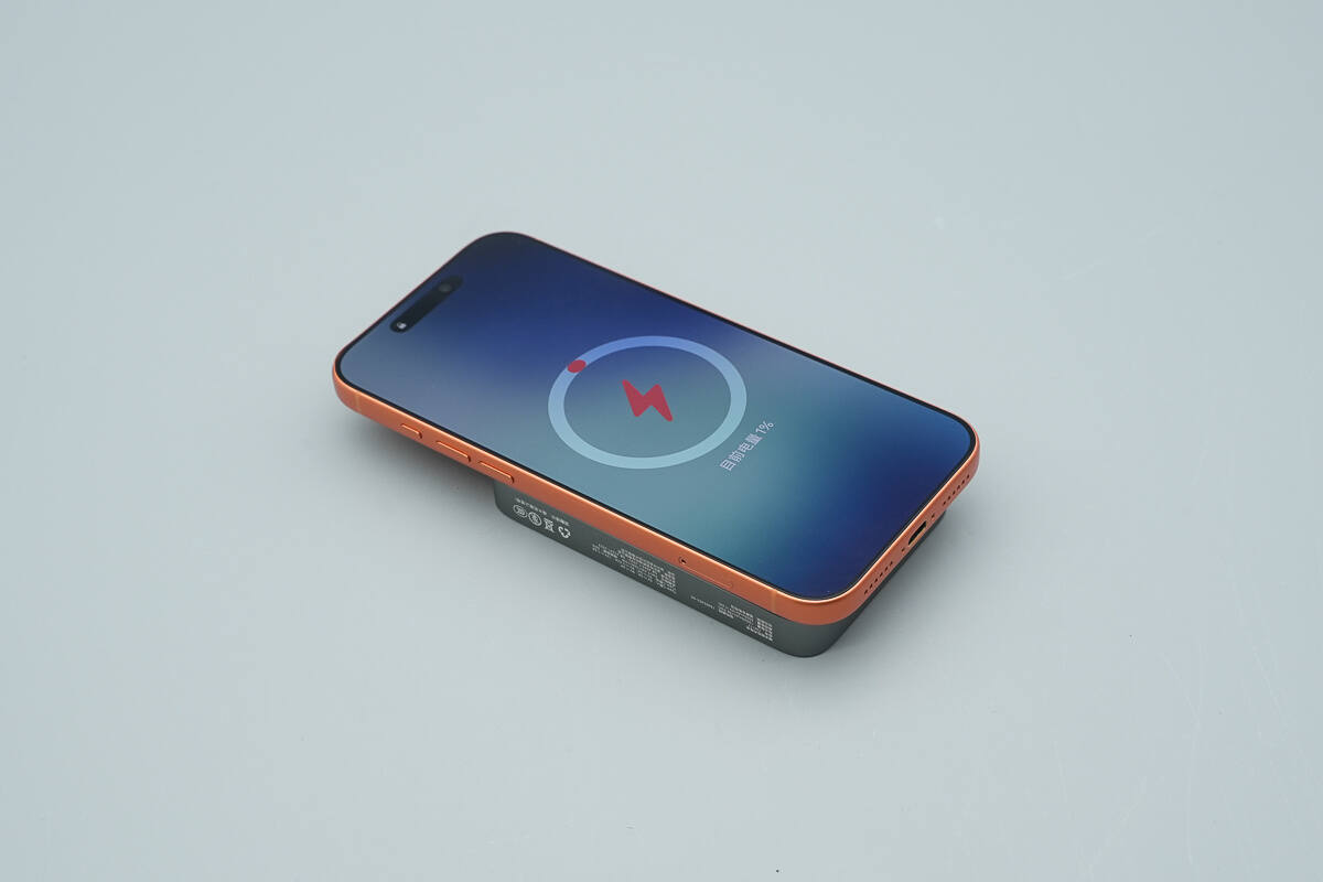

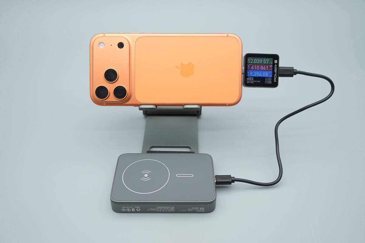

When the power bank is attached to the back of the iPhone 17 Pro Max, the MagSafe charging animation appears on the phone.
The power bank does not obstruct the camera module.

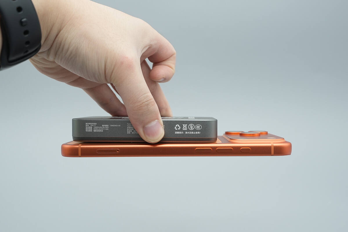

It remains securely attached even when inverted and does not fall off.
The USB-C port delivers approximately 19.39W of wired charging power to the iPhone 17 Pro Max.

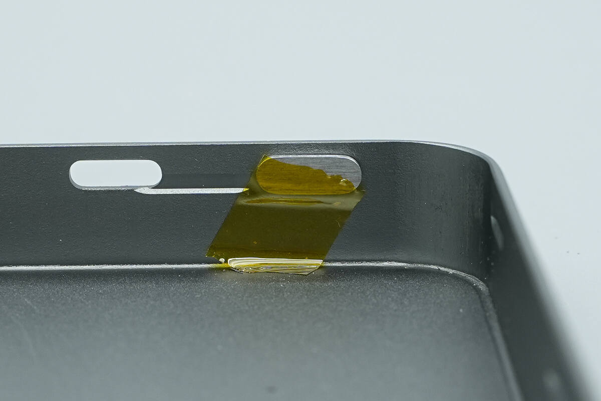

Inside the front panel, there is a small piece of insulating high-temperature adhesive tape in the upper-left corner, used to secure the power button.
The insulating high-temperature adhesive tape is used to secure the power button and prevent it from detaching.

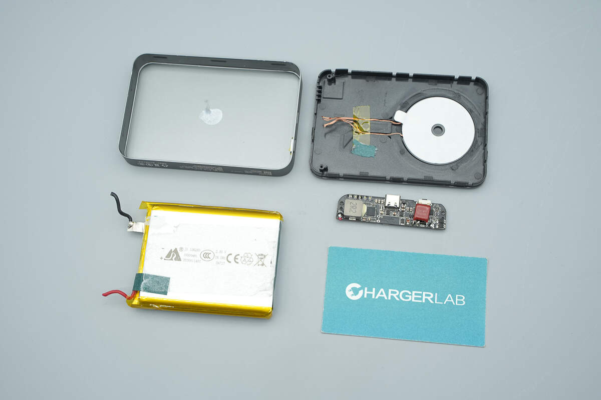

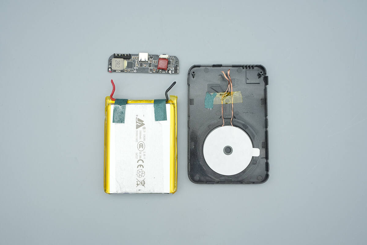

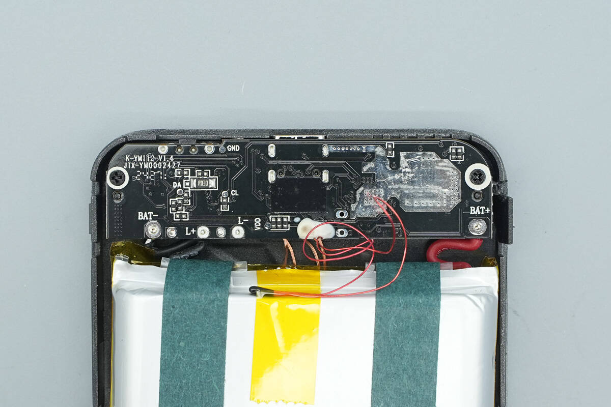

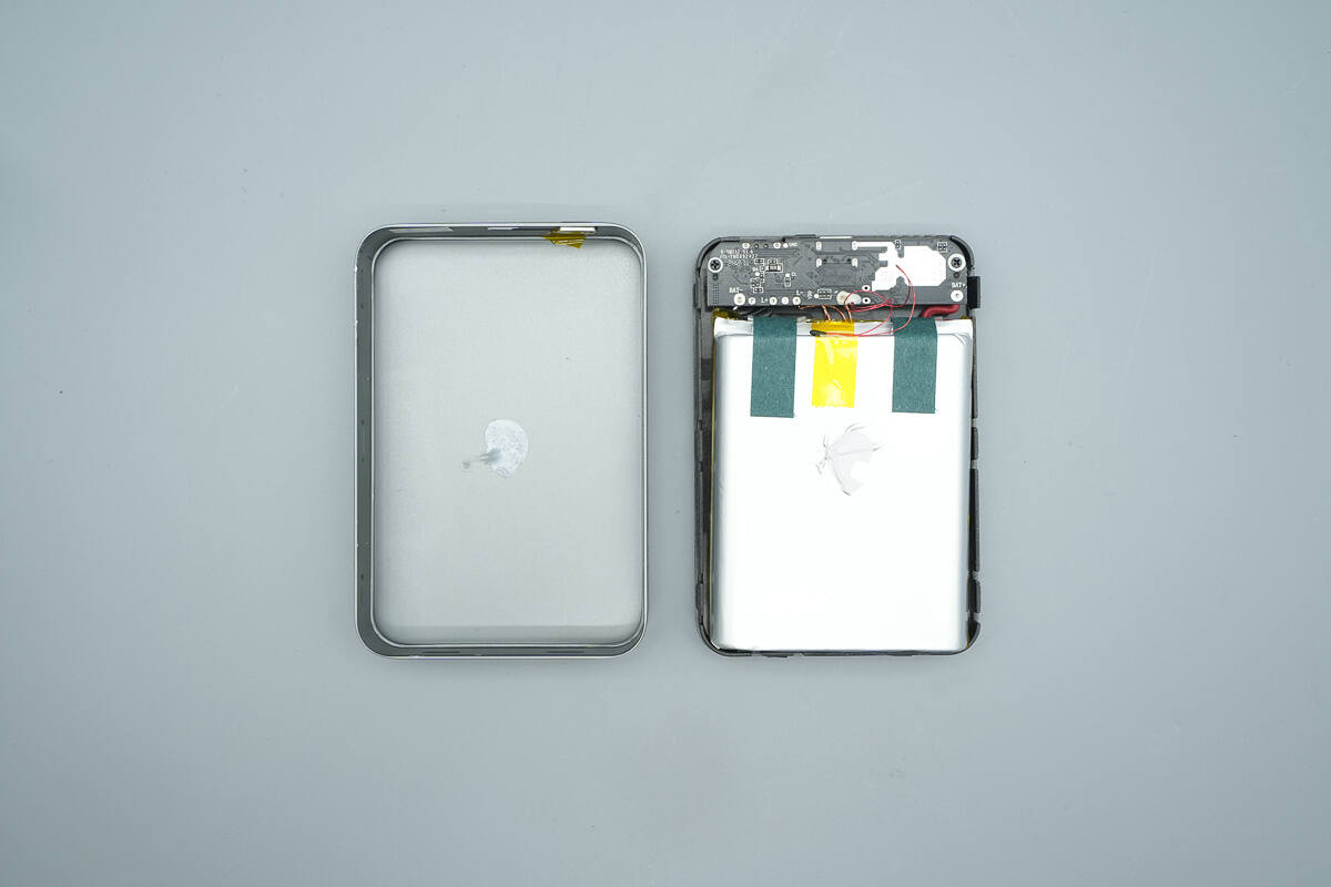

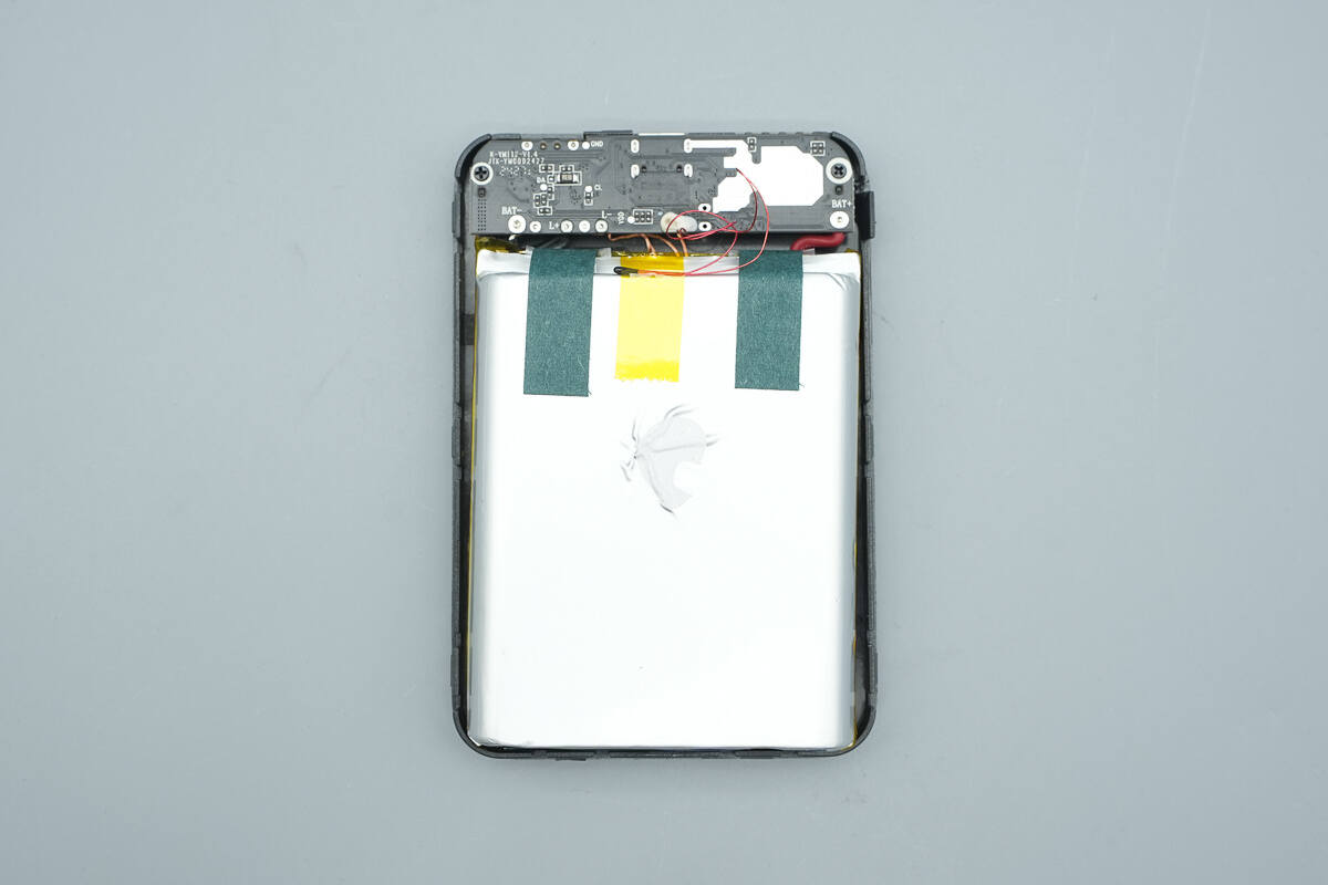

The upper section houses the PCBA module, while the lower section contains the battery. The battery surface is protected with fish paper insulation and high-temperature adhesive tape.
The PCBA module is secured with two screws.
Separate the battery and PCB from the plastic rear shell.

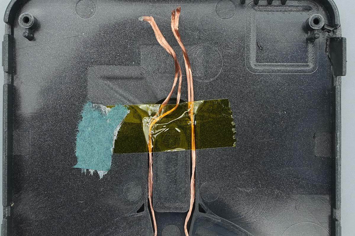

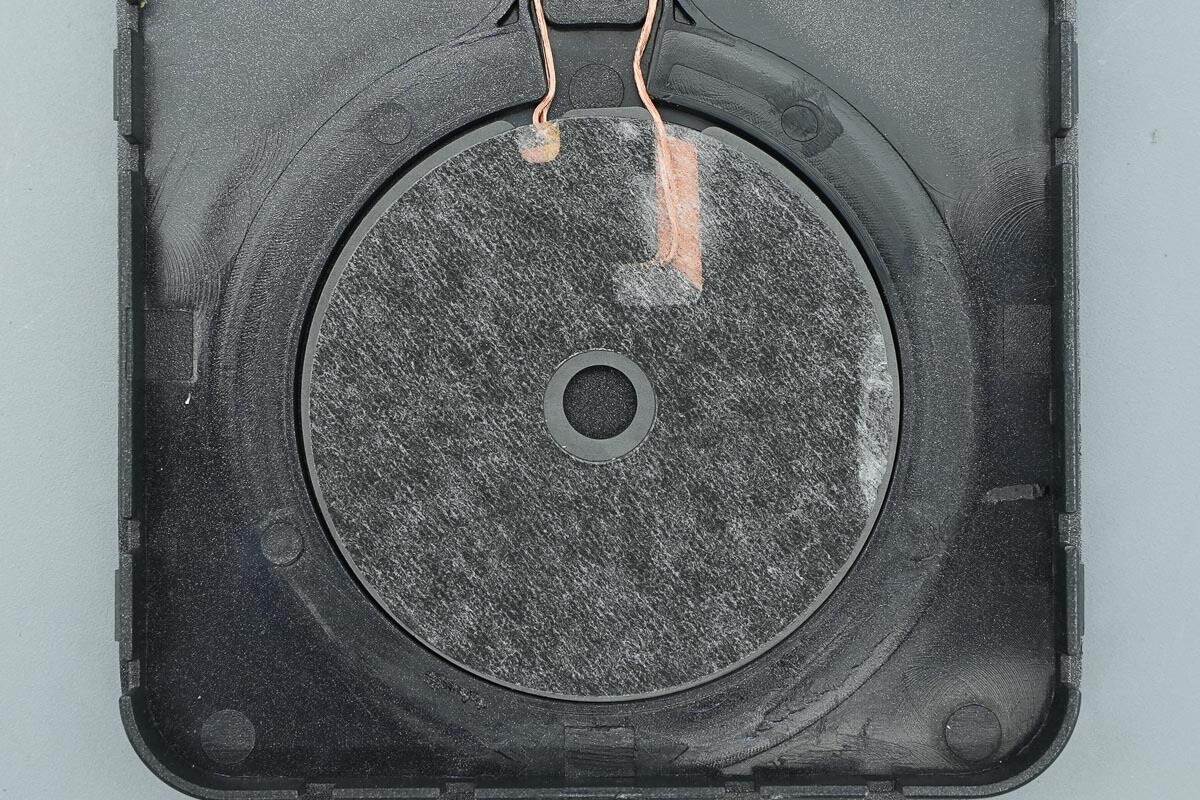

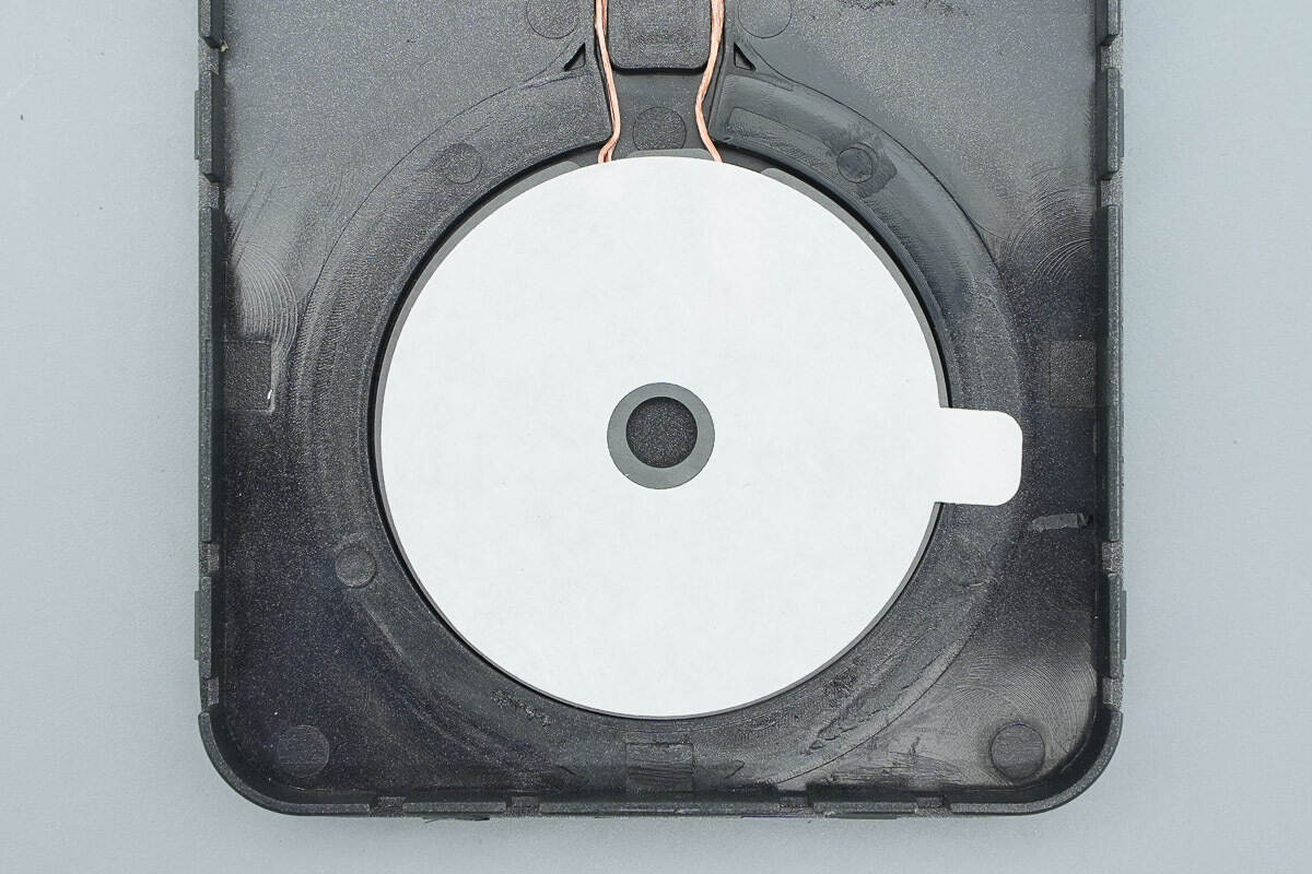

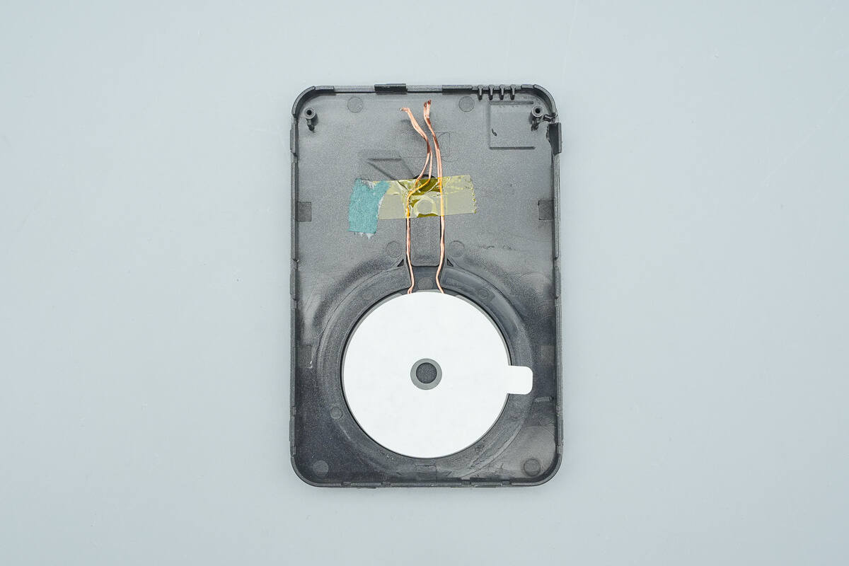

The inner side of the plastic rear shell is shown, with the wireless charging coil located in the center.
The wires are secured with high-temperature insulating adhesive tape.
A layer of white protective film is attached to the charging coil.
After removing the white protective film, a layer of gray magnetic shielding material is revealed underneath.

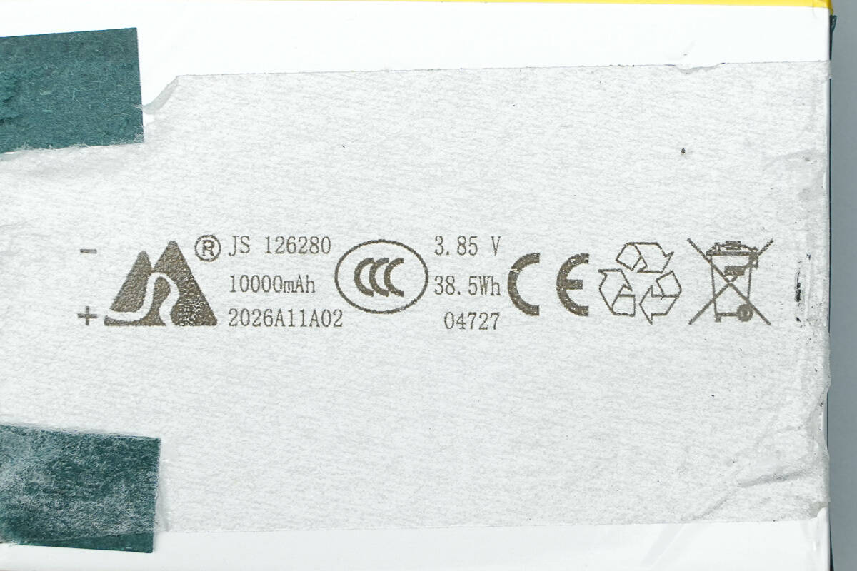

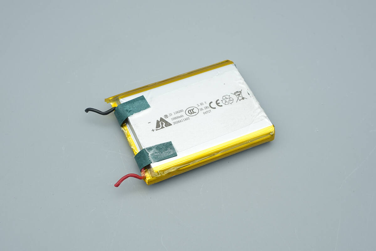

The edges of the battery pack are protected with green fish paper, insulating the battery tabs.
The battery is from JS, model 126280, with a capacity of 10,000mAh. It has a nominal voltage of 3.85V and an energy rating of 38.5Wh. The production batch is 2026A11A02, and it has passed CCC certification.

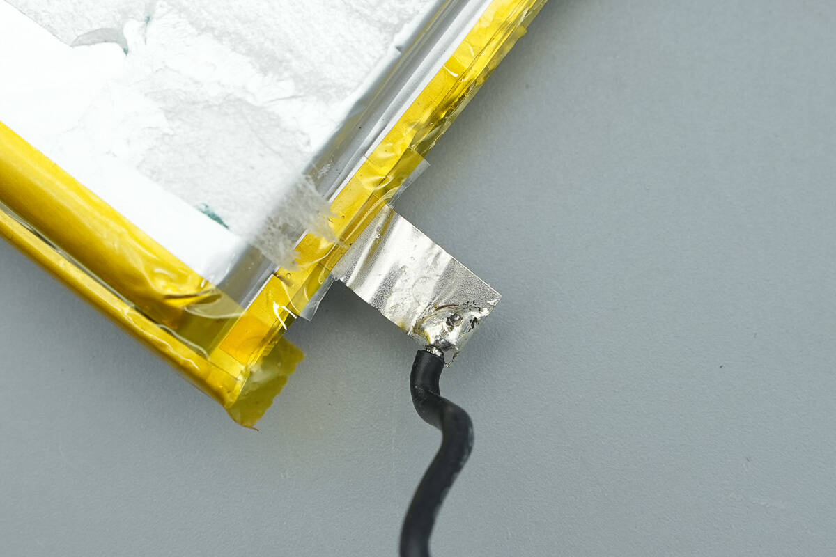

After removing the insulating tape and fish paper, the weld joint between the tabs and the wires is exposed.

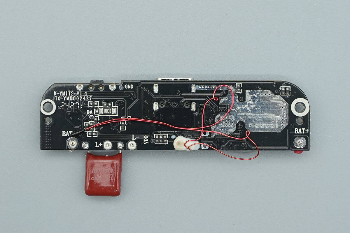

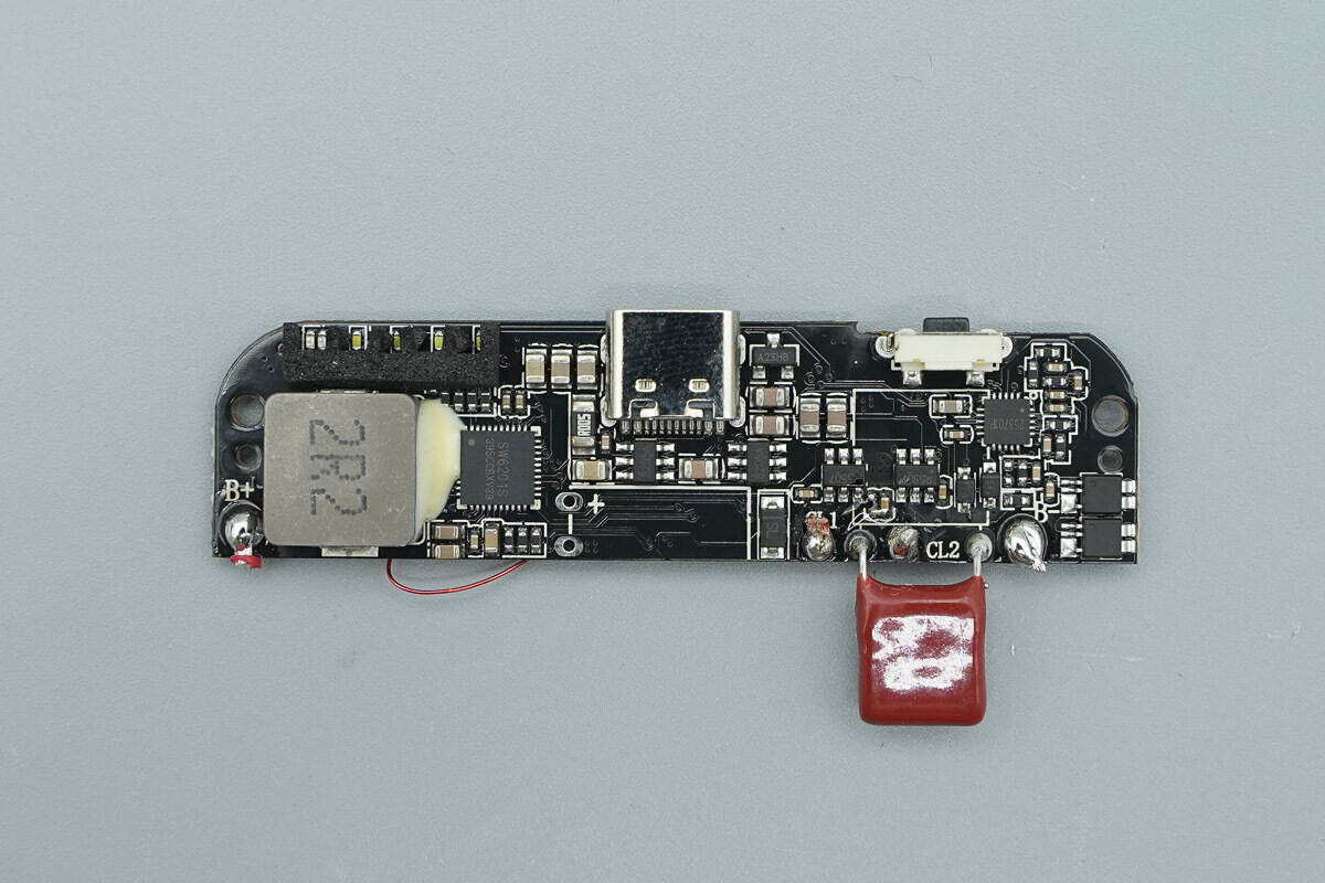

Overview of the front side of the PCB.
Overview of the back side of the PCB.

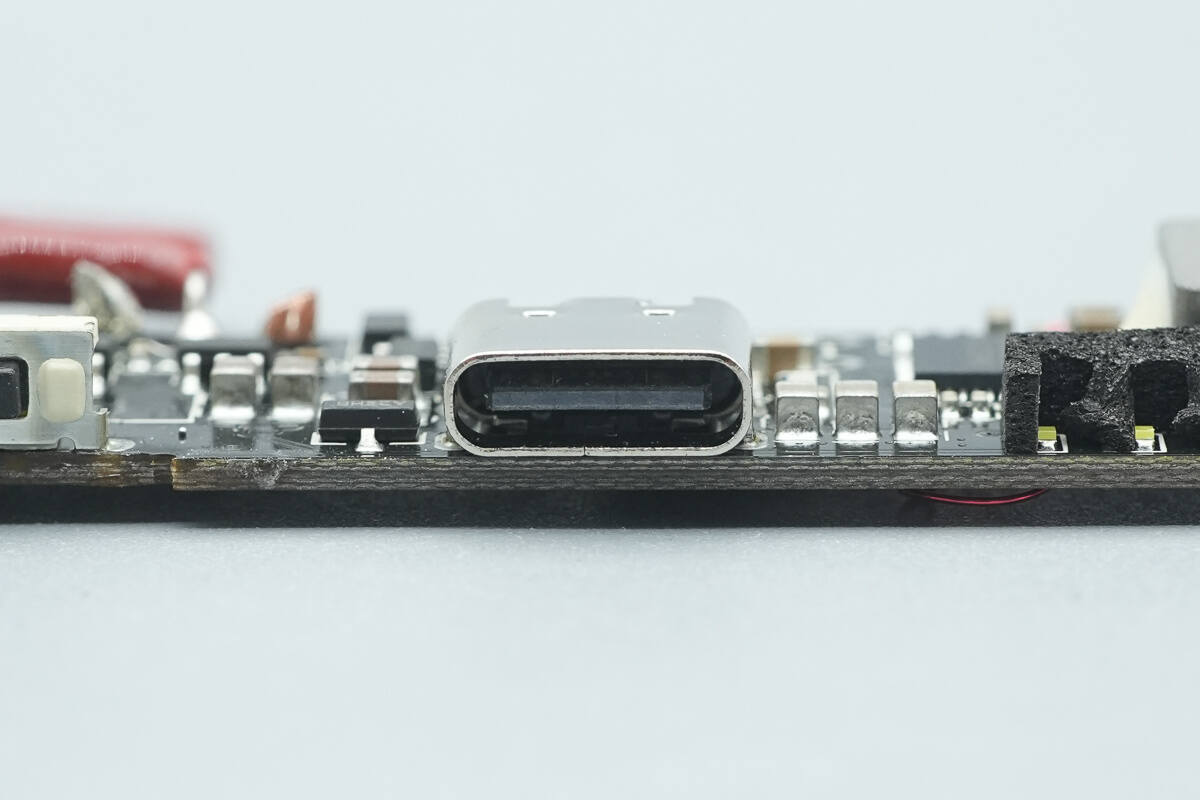

The plastic sheet of the USB-C socket is black.

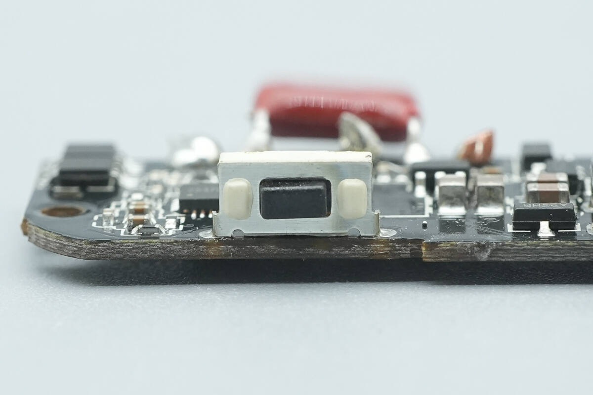

Close-up of the power button.

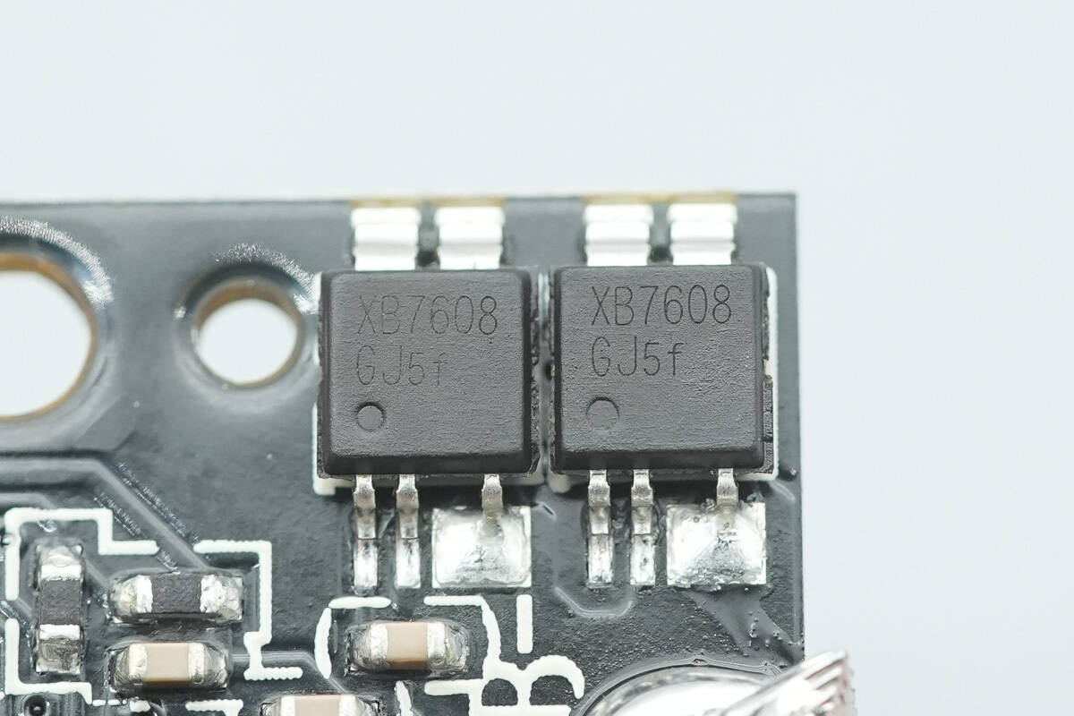

Two Xysemi XB7608GJ highly integrated battery protection chips are used. They adopt a CPC5 package and integrate lithium battery protection MOSFETs internally, providing overcharge, over-discharge, and overcurrent protection functions for the battery.

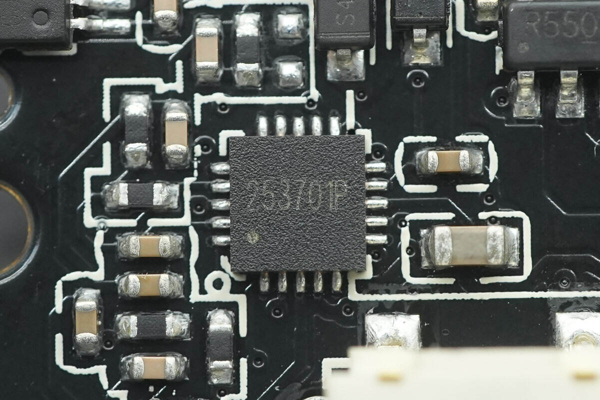

The wireless charging transmitter chip is marked as 25370P.

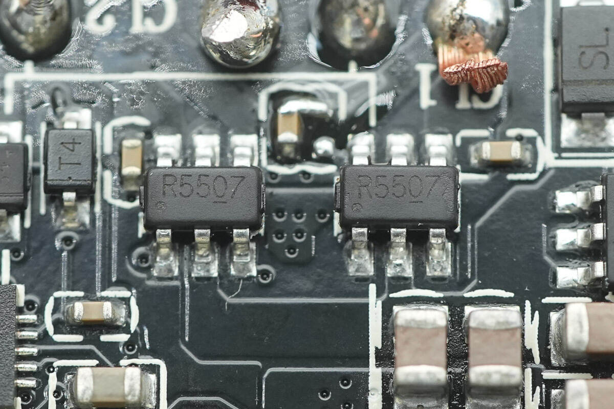

Close-up of the two wireless charging power MOSFETs marked “R5507.”

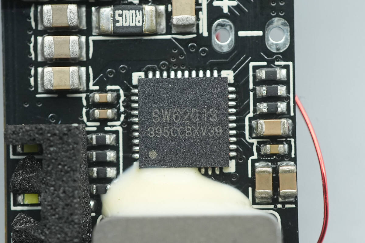

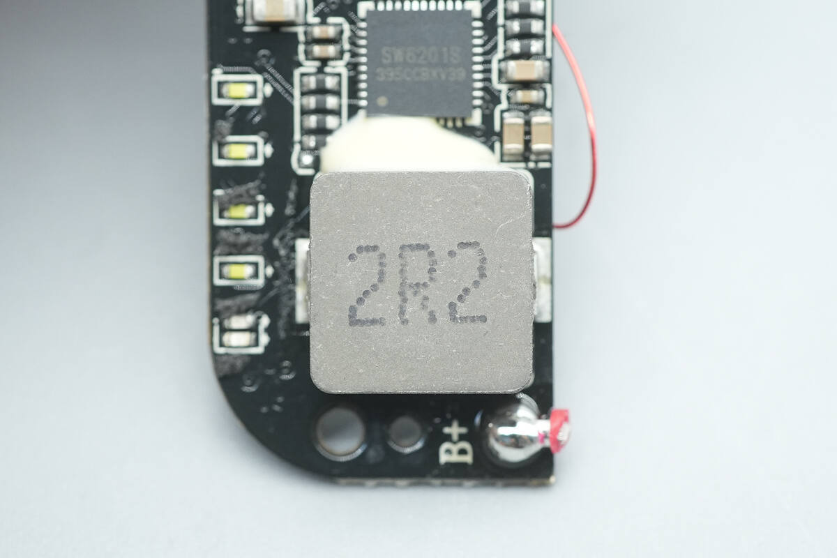

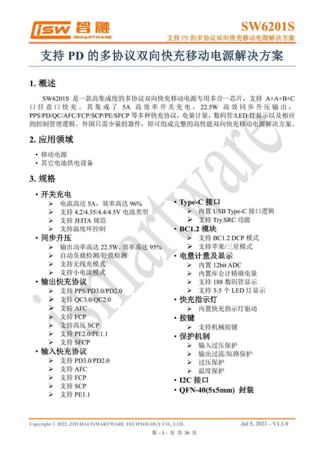

The iSmartWare SW6201S is a highly integrated all-in-one solution designed for multi-protocol bidirectional fast-charging power banks. It supports fast charging on A+A+B+C ports in any combination, integrates a high-efficiency 5A switching charger, and enables up to 22.5W high-efficiency synchronous boost output. It is compatible with mainstream fast-charging protocols such as PPS, PD, and QC.
The chip also features power metering, digital display/LED indication, and associated control and management logic. Only a small number of external components are required to build a complete high-performance bidirectional fast-charging power bank solution.
The SW6201S supports up to 5A switching charging with efficiency reaching up to 96%. It features synchronous boost capability with output power up to 22.5W, along with automatic load detection, wireless charging support, and a low-current mode to ensure efficient charging. It is compatible with multiple fast-charging protocols, including PPS, PD 3.0, and QC 3.0, making it suitable for a wide range of devices.
The SW6201S also integrates a Type-C interface, BC1.2 module, power metering and display, support for 7-segment LED displays, button control, and comprehensive protection mechanisms, providing both convenience and safety.
With an I2C interface and a compact QFN-40 (5×5mm) package, it is easy to integrate into various applications, making it an ideal choice for power bank designs while delivering strong functionality and high performance.

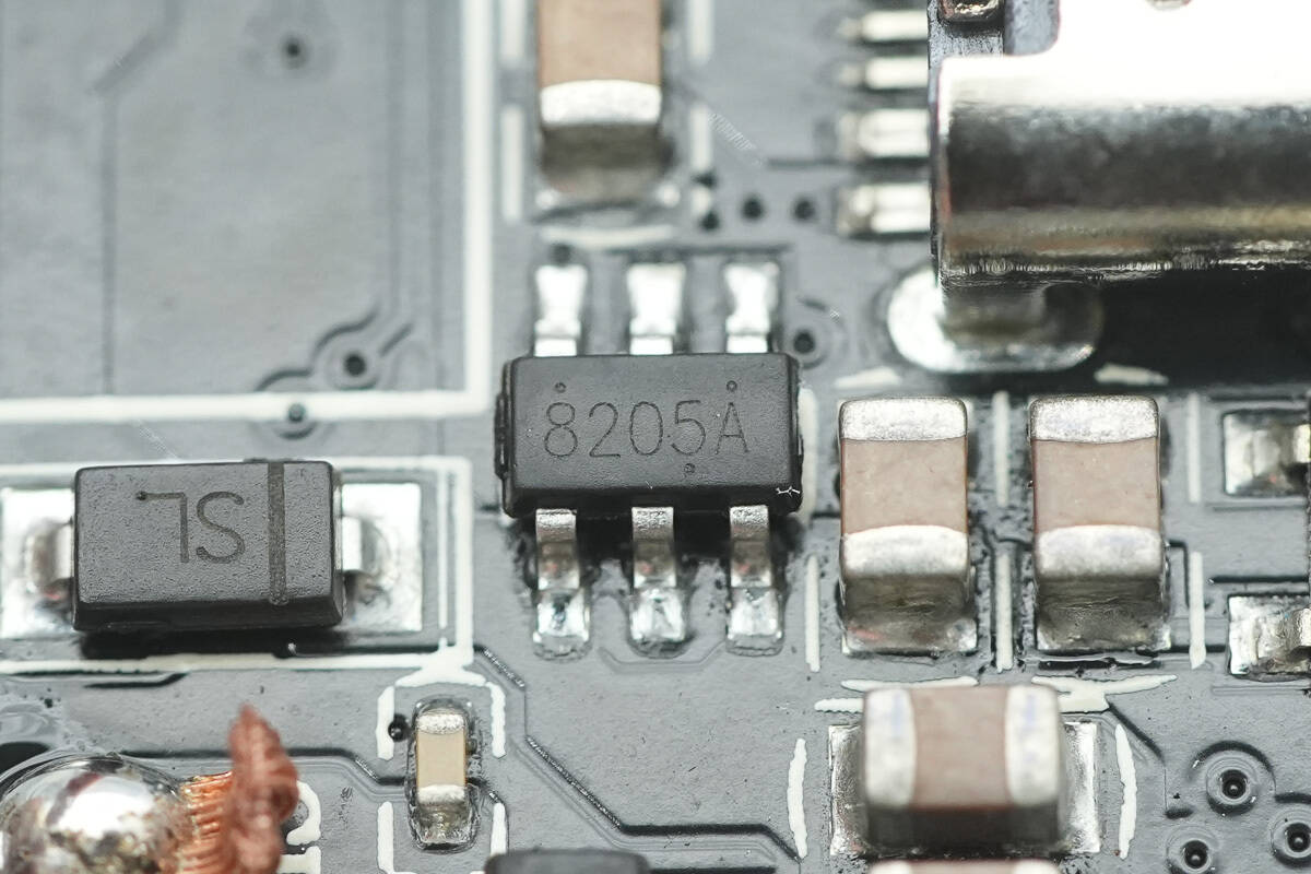

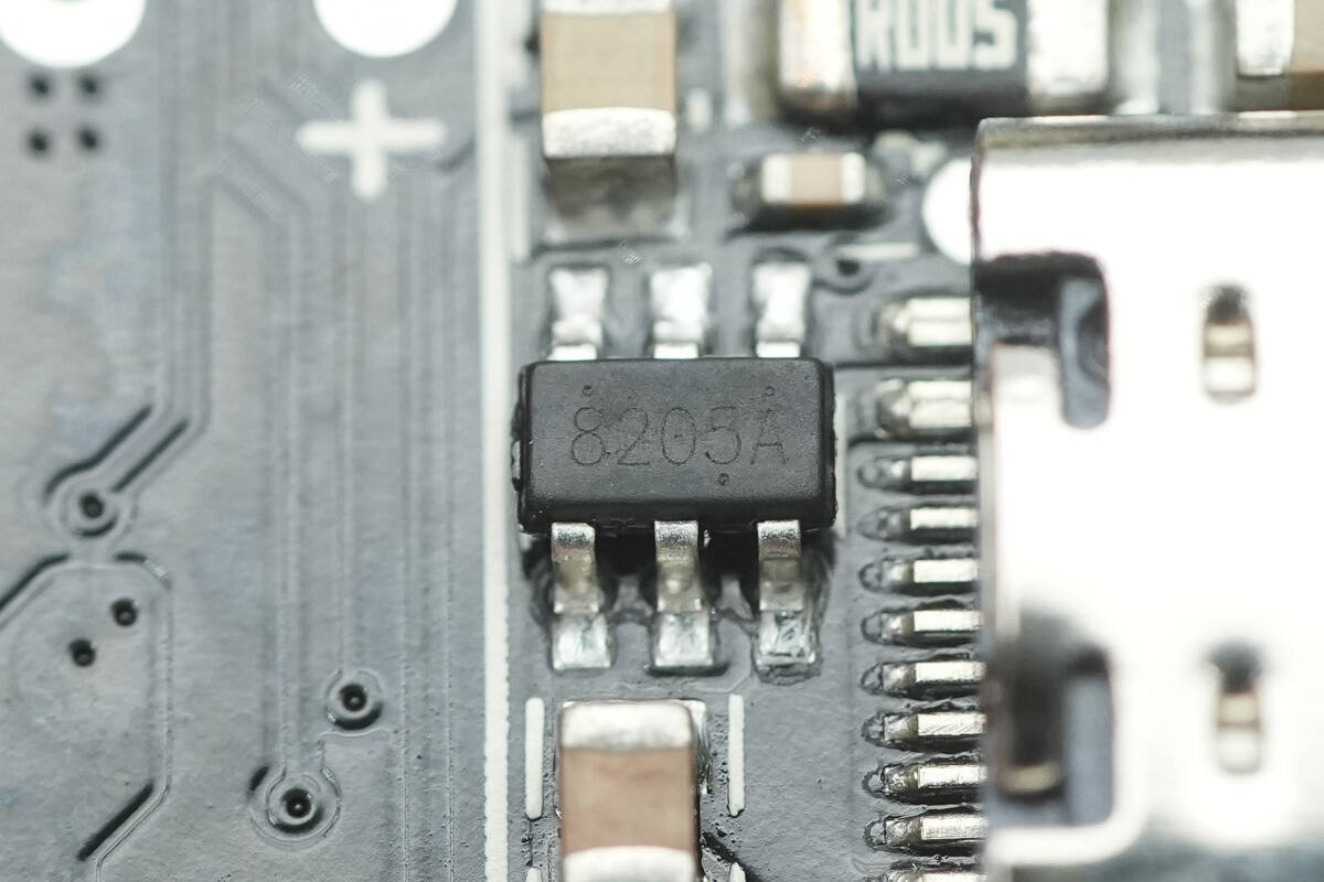

Close-up of a VBUS MOSFET marked “8205A.”
Close-up of another VBUS MOSFET marked “8205A.”

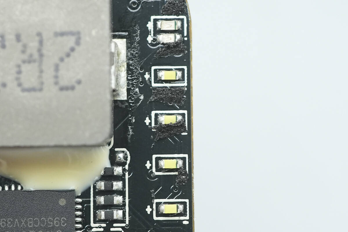

Close-up of the LED indicator diodes.
Close-up of the 2R2 alloy inductor.

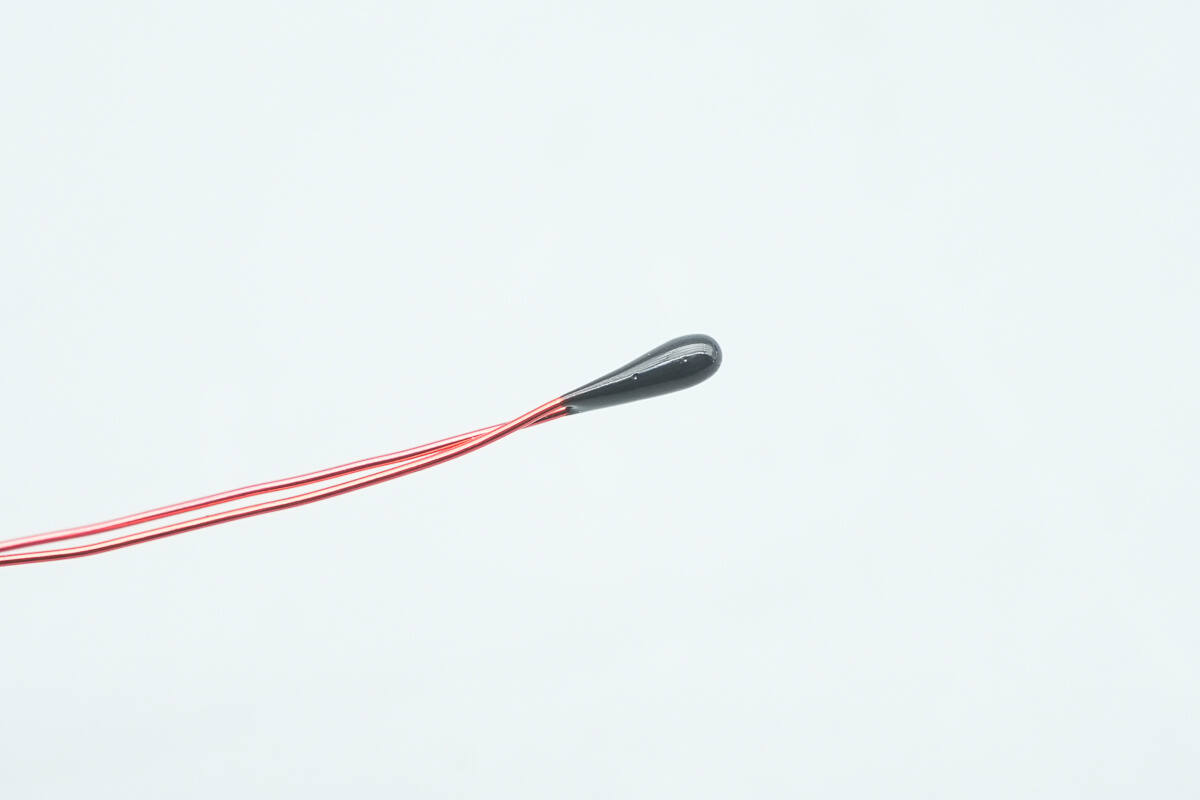

An NTC thermistor is used to monitor the battery pack temperature in real time.

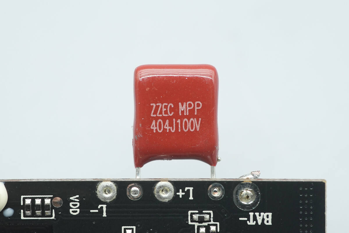

The resonant capacitor used for wireless charging is from KEYA, part of the ZZEC MPP series, with the part number 404J100V.

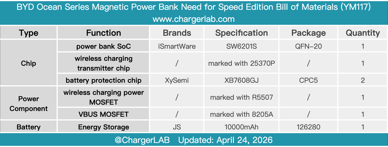

Here is the component list of the BYD Ocean Series Magnetic Power Bank YM117 (Need for Speed Edition) for your convenience.
It features a built-in 10,000mAh battery, delivering up to 15W magnetic wireless charging for the iPhone, while also supporting 20W wired fast charging output.
After taking it apart, we found that it adopts the highly integrated iSmartWare SW6201S power bank SoC with broad protocol compatibility. It uses a JS battery cell, paired with Xysemi XB7608 protection chips and an NTC thermistor. The overall build quality is solid, making it a suitable choice for iPhone users.
