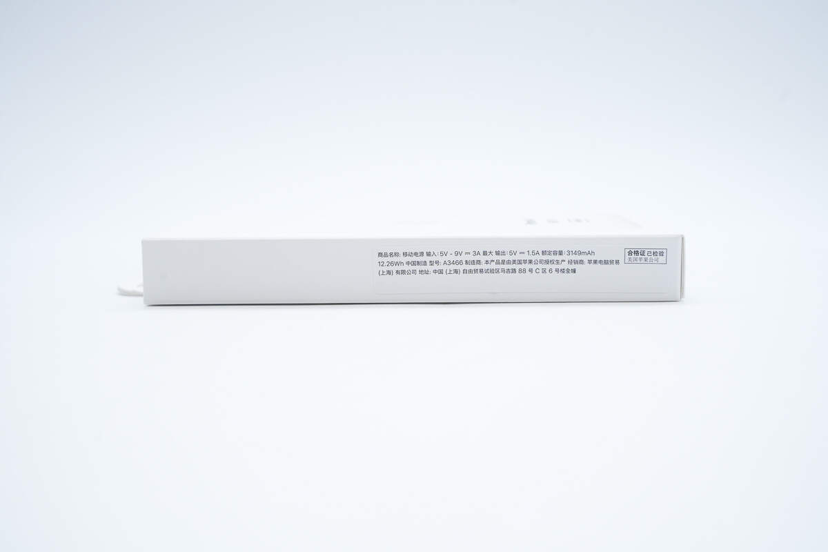

The side of the packaging box has a label with the product specifications.
Teardown of Apple iPhone Air MagSafe Battery (A3466)-Chargerlab

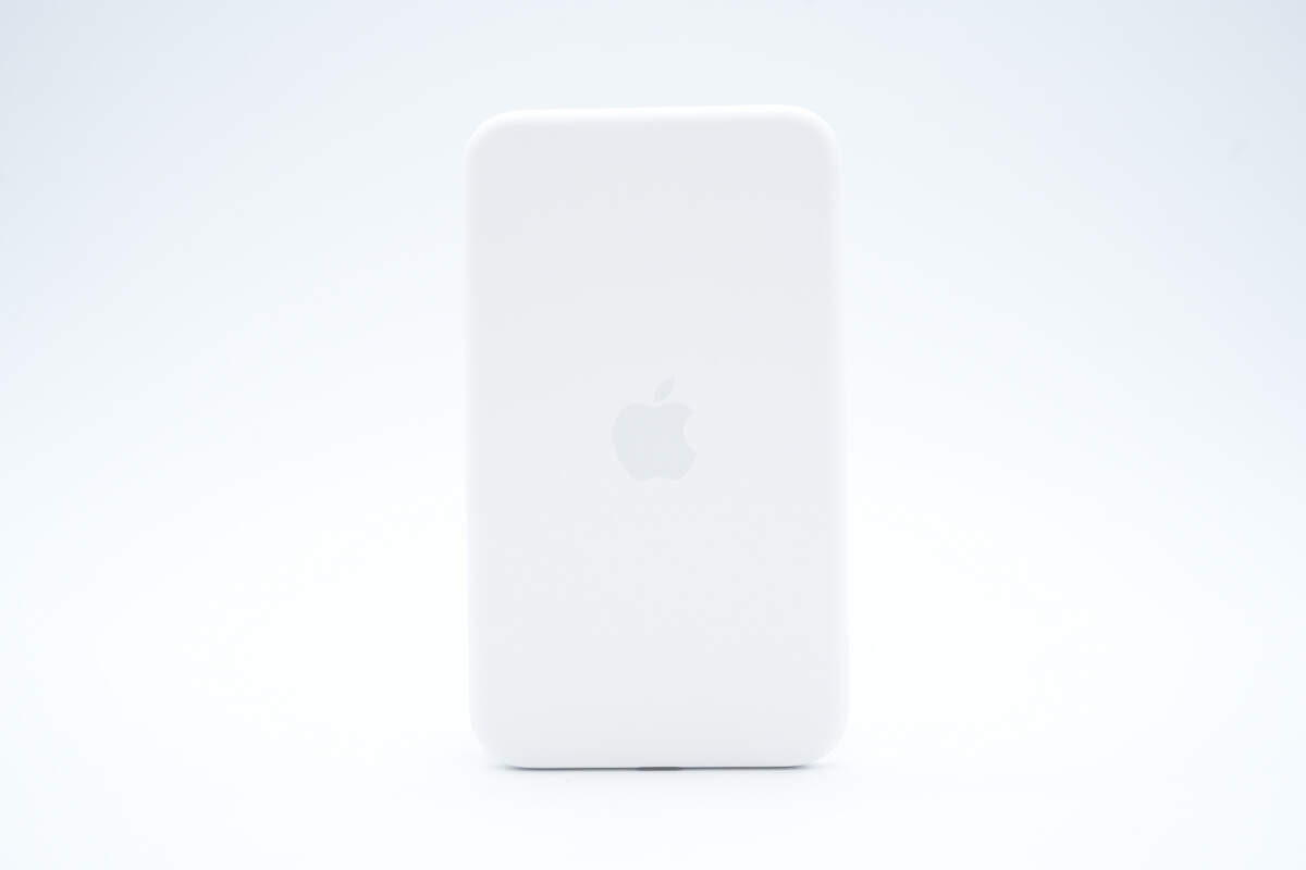

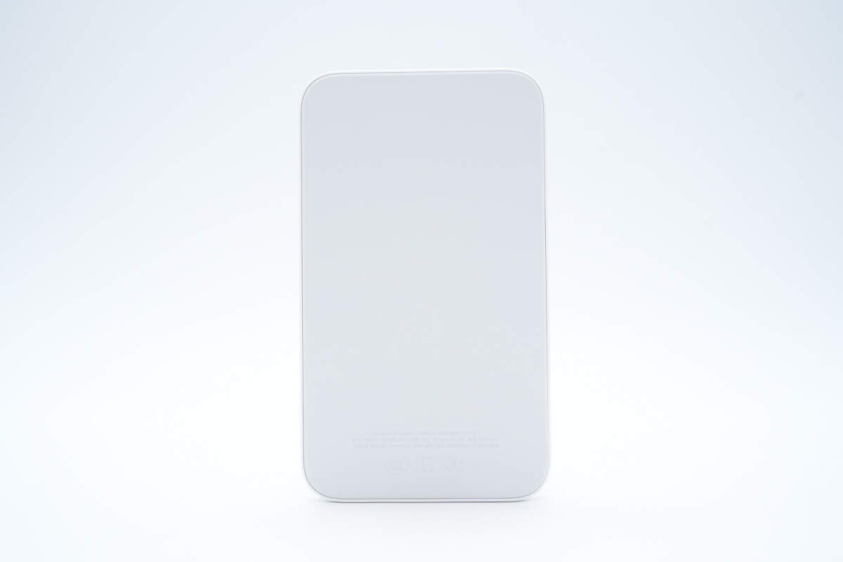

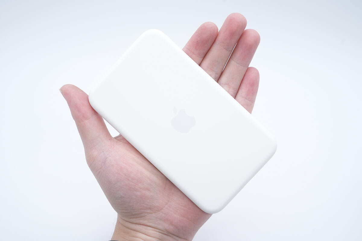

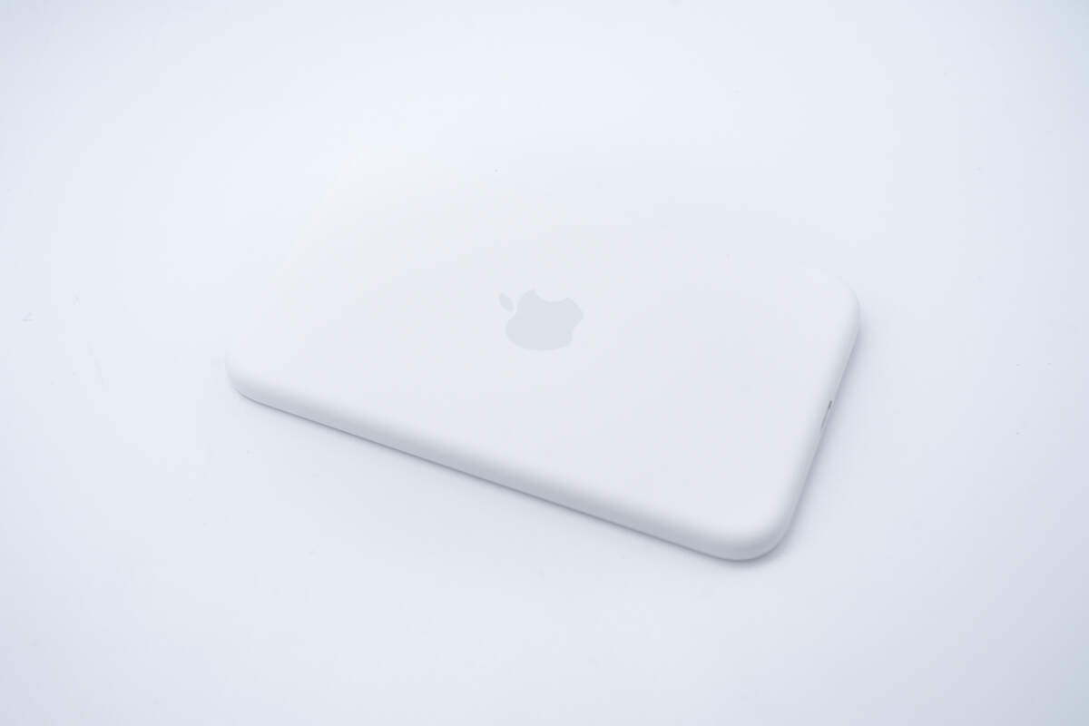

The back features the Apple logo.
The side that attaches to the phone uses a skin-like material.

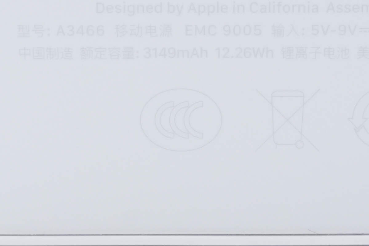

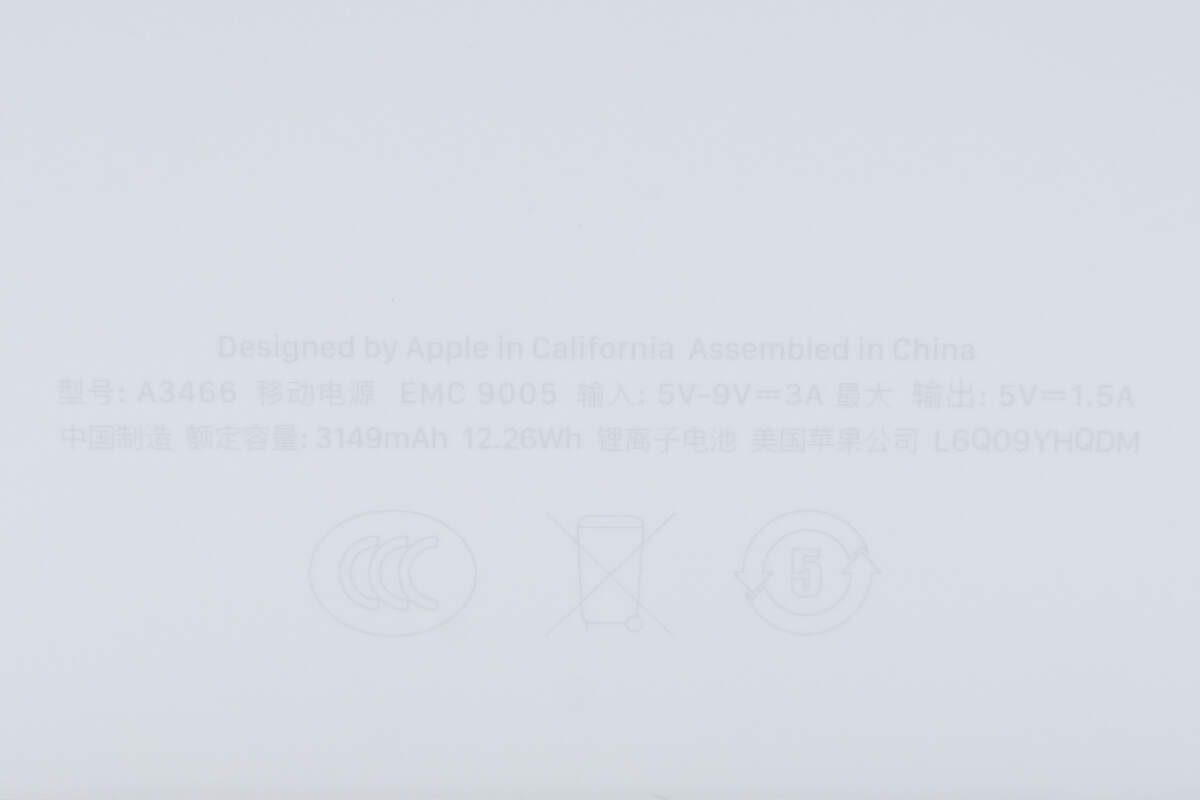

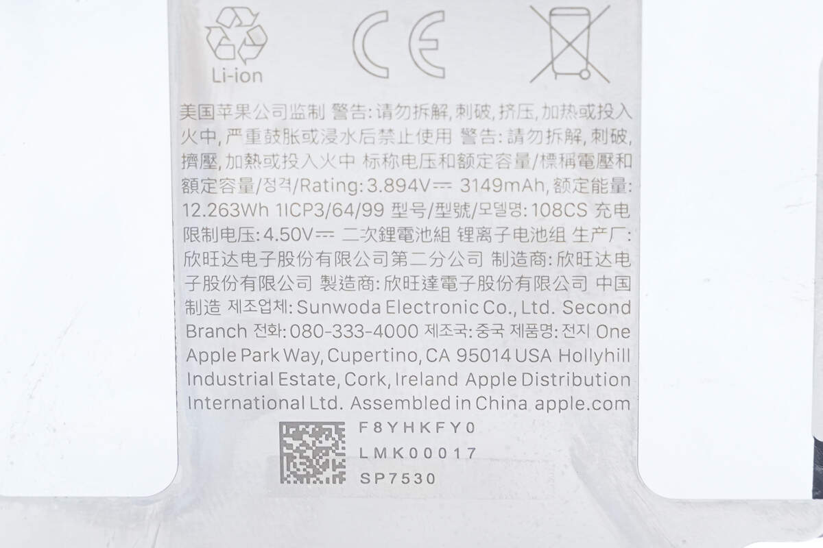

Model: A3466
Input: 5-9V 3A
Output: 5V 1.5A
Rated Capacity: 3149mAh, 12.26Wh
Battery Type: Lithium-ion battery

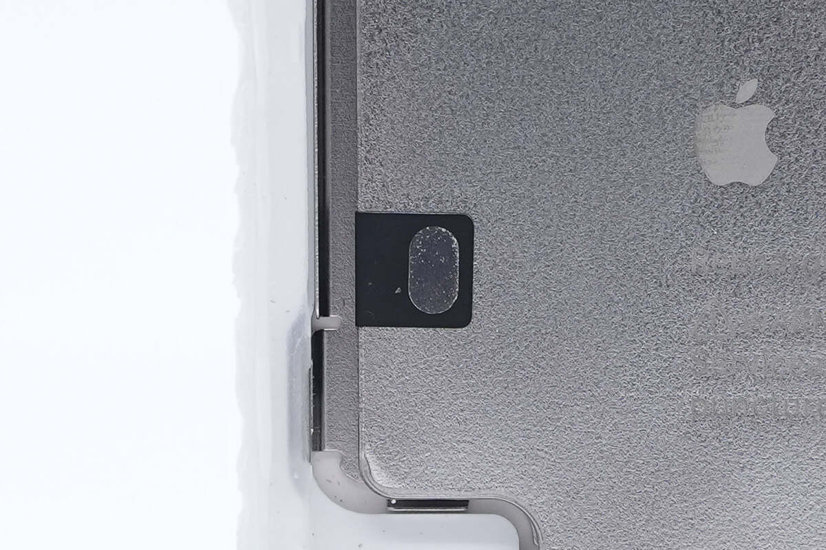

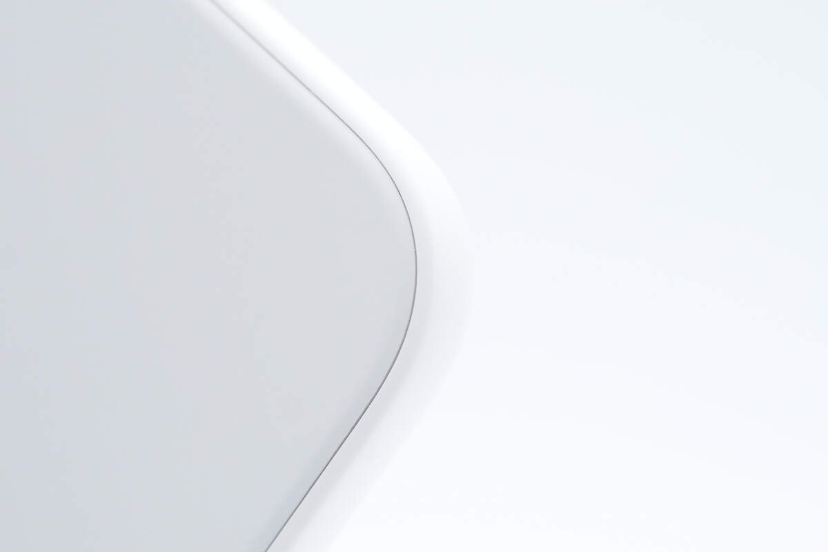

Close-up of the seam.

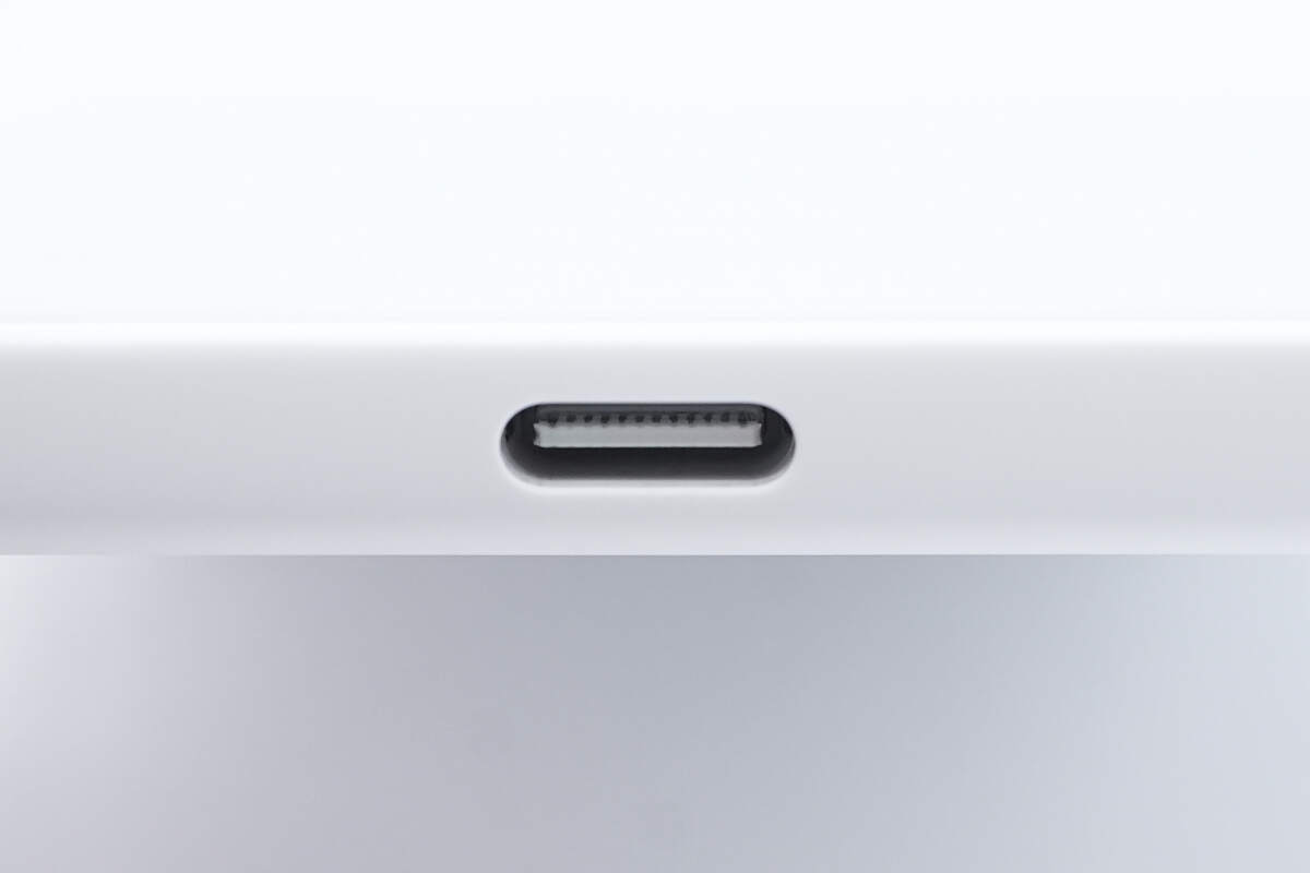

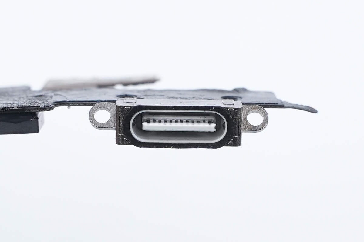

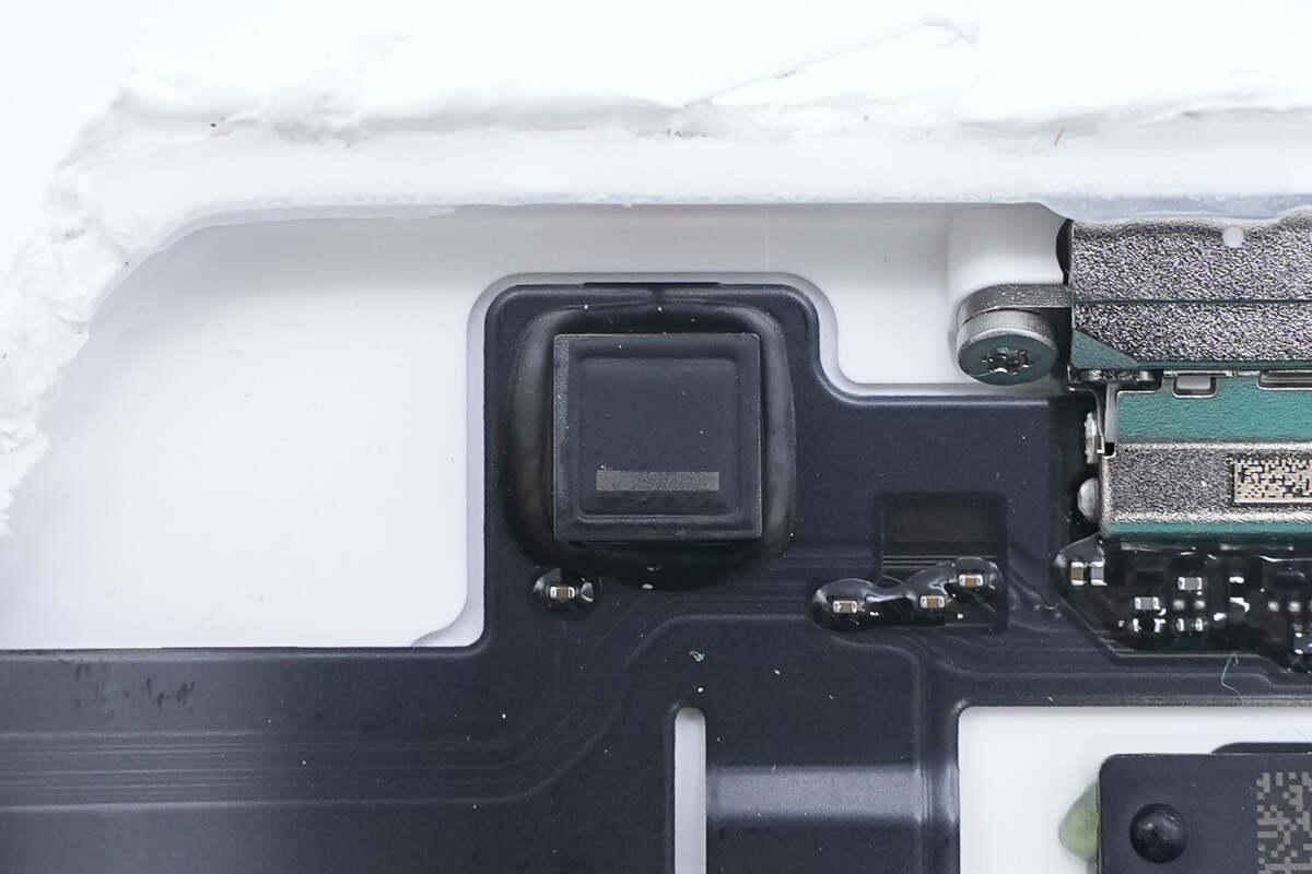

There is a USB-C port located at the bottom.

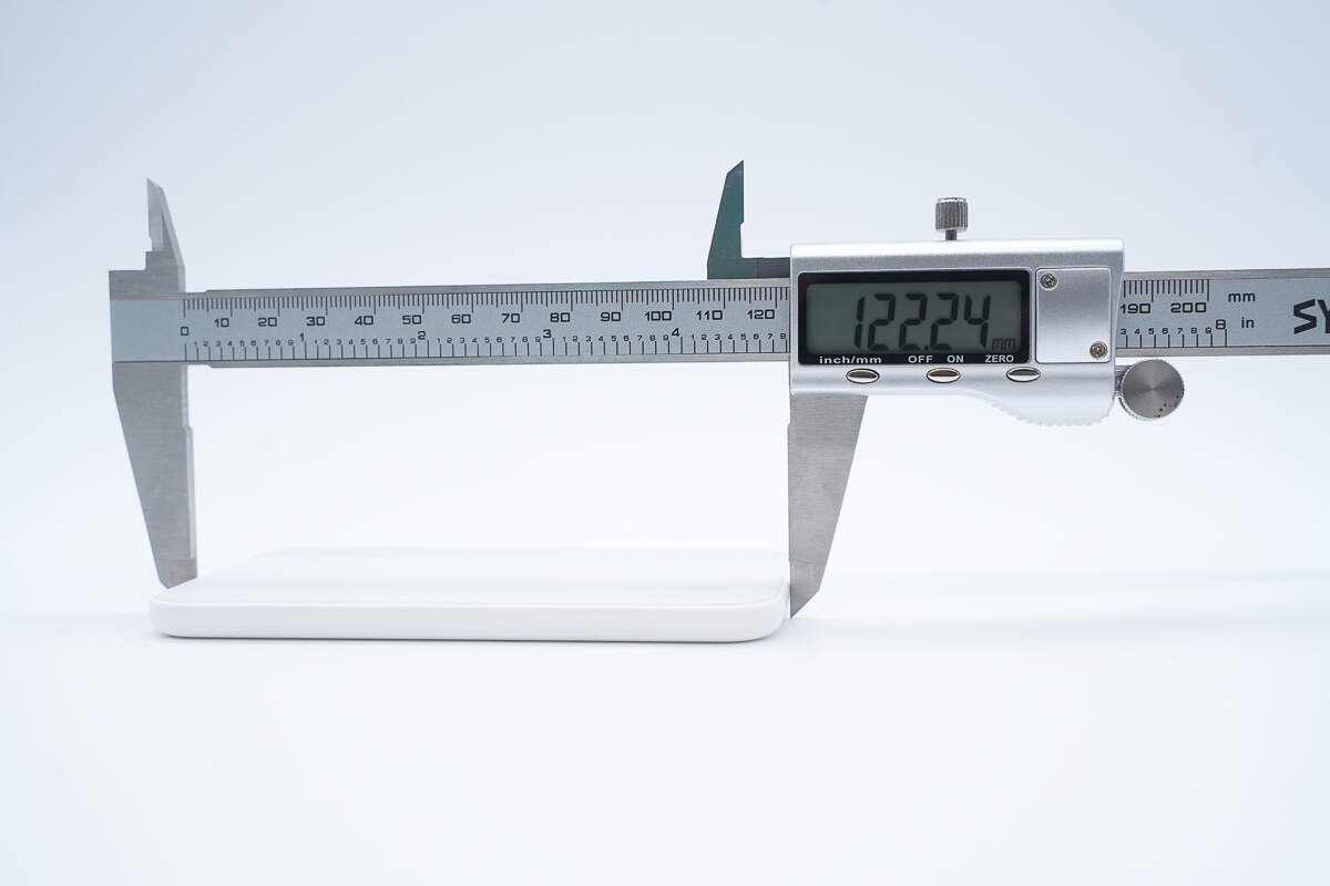

The length is about 122.2 mm (4.81 inches).

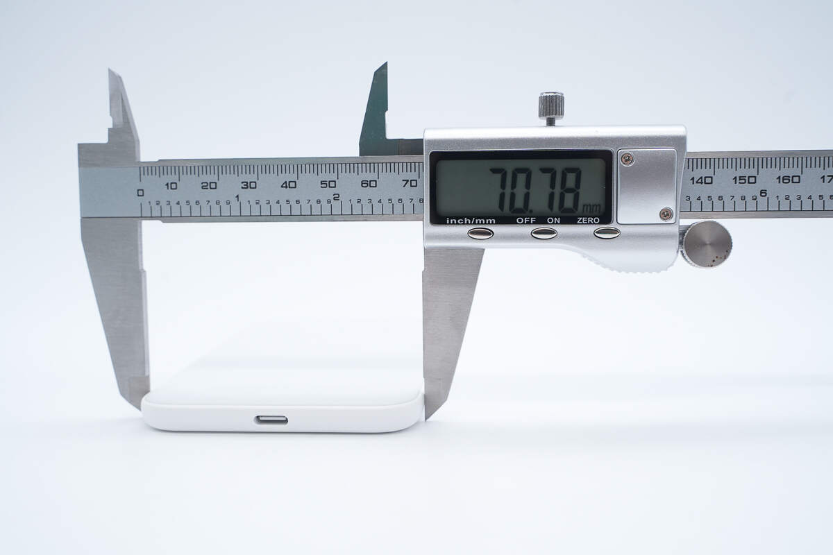

The width is about 70.8 mm (2.79 inches).

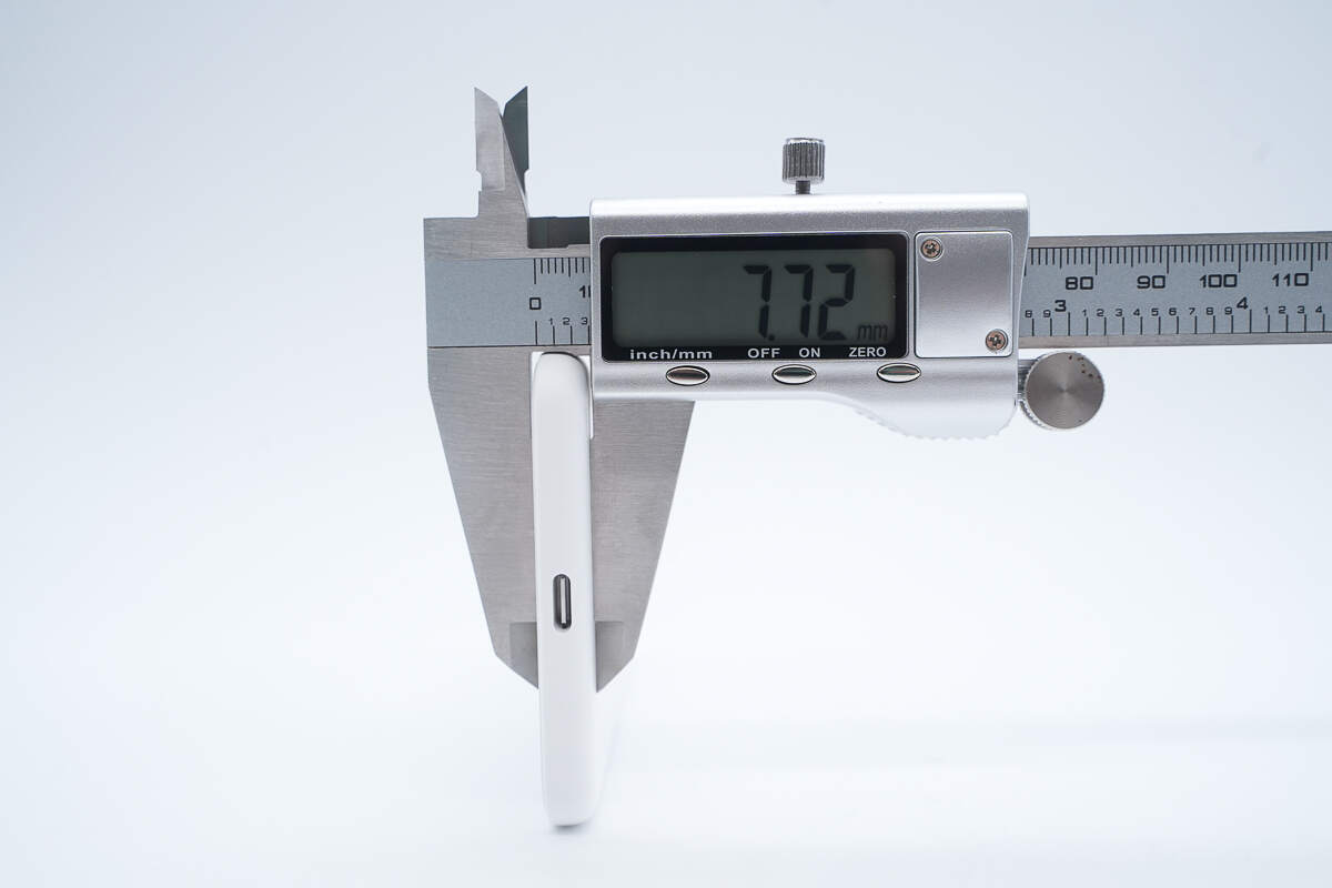

The thickness is about 7.7 mm (0.3 inches).

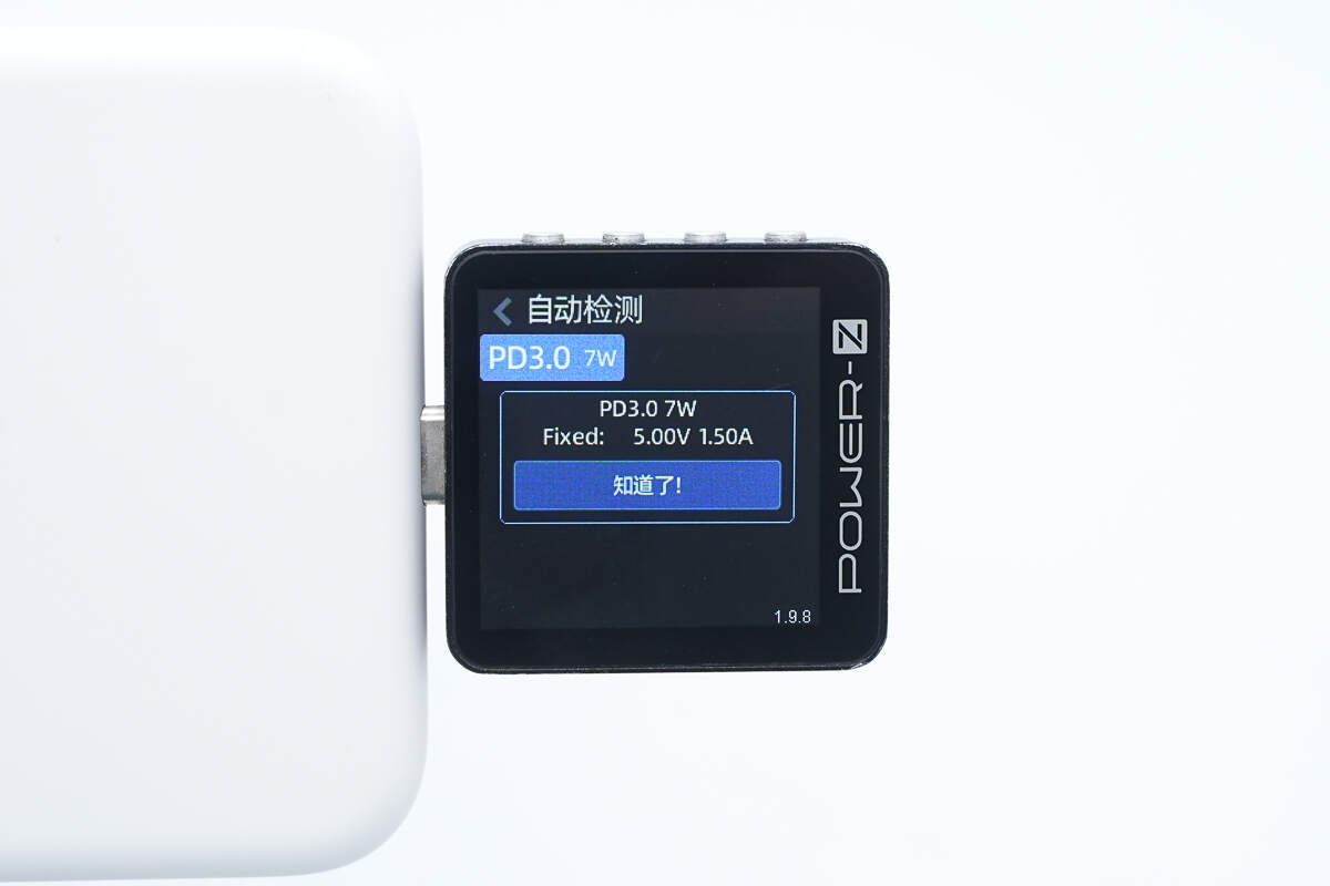

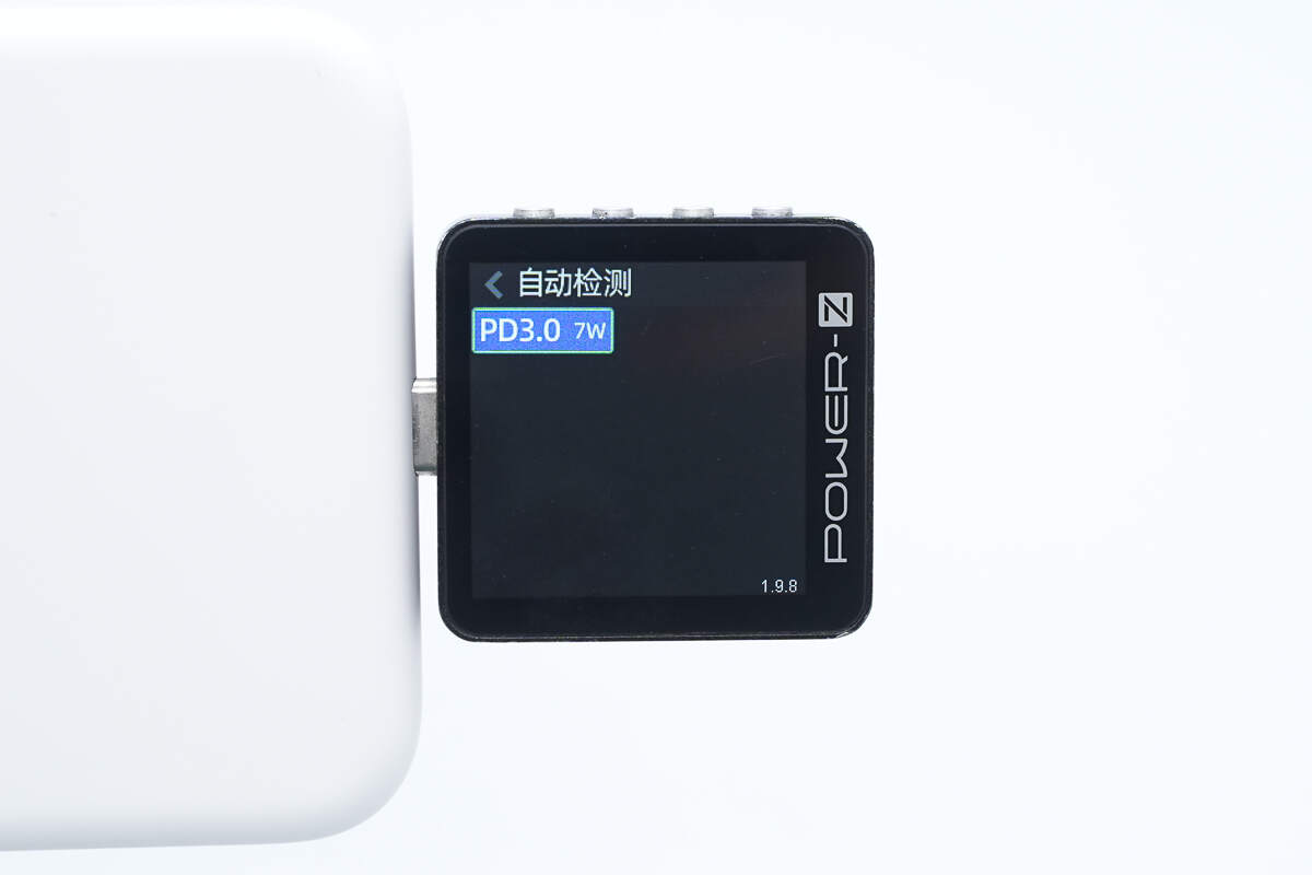

ChargerLAB POWER-Z KM003C shows that it supports PD3.0.
And it has one fixed PDO, which is 5V1.5A.

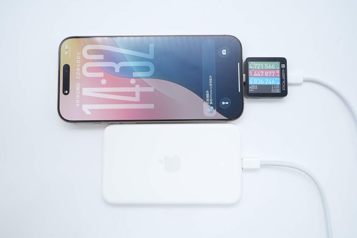

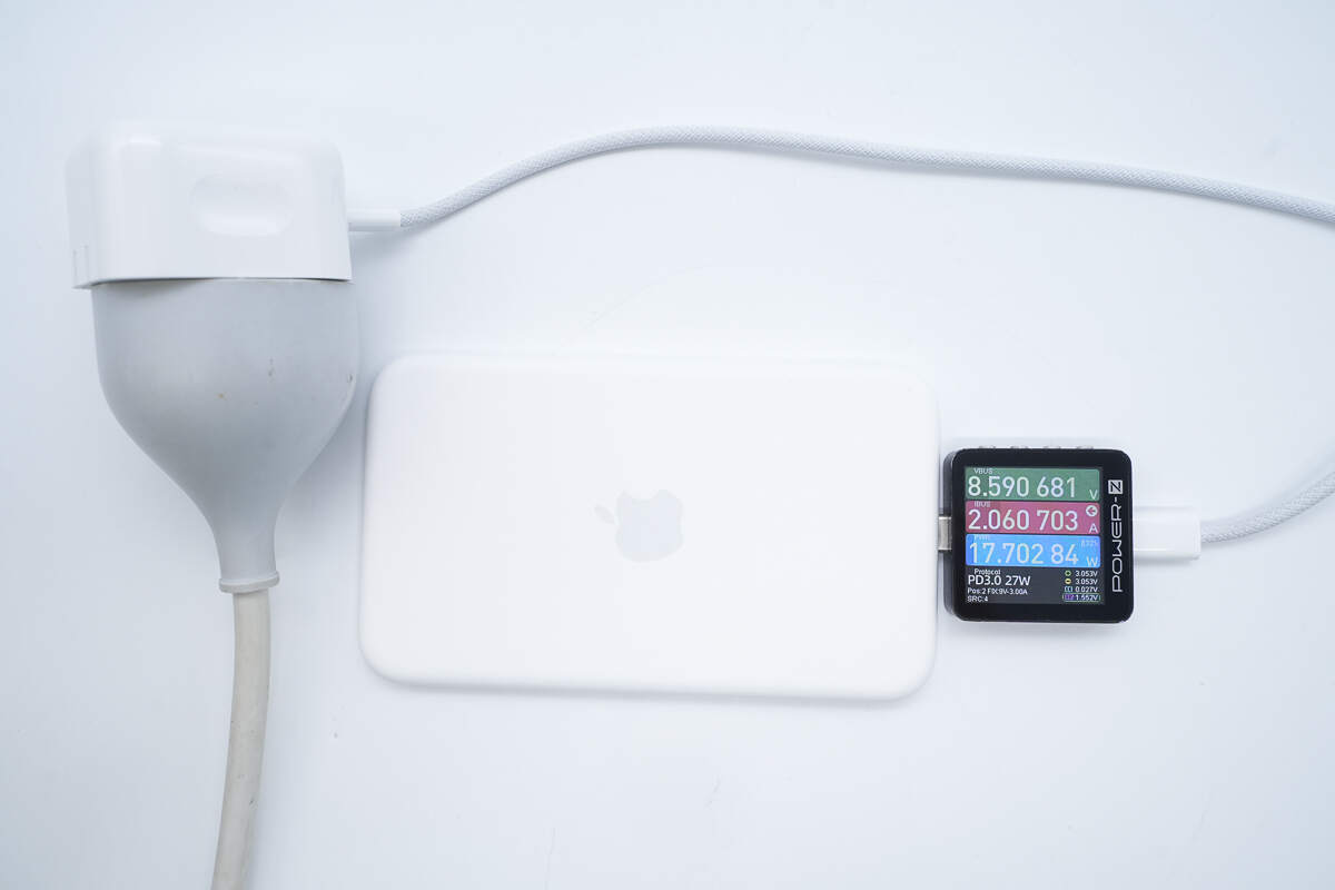

Charging the MagSafe Battery with the Apple 40W charger, the voltage is 8.6V, the current is 2.06A, and the power is 17.7W.
When the MagSafe Battery is connected to the iPhone 16 Pro Max for charging, the voltage is about 4.72V, the current is about 1.45A, and the power is about 6.84W.

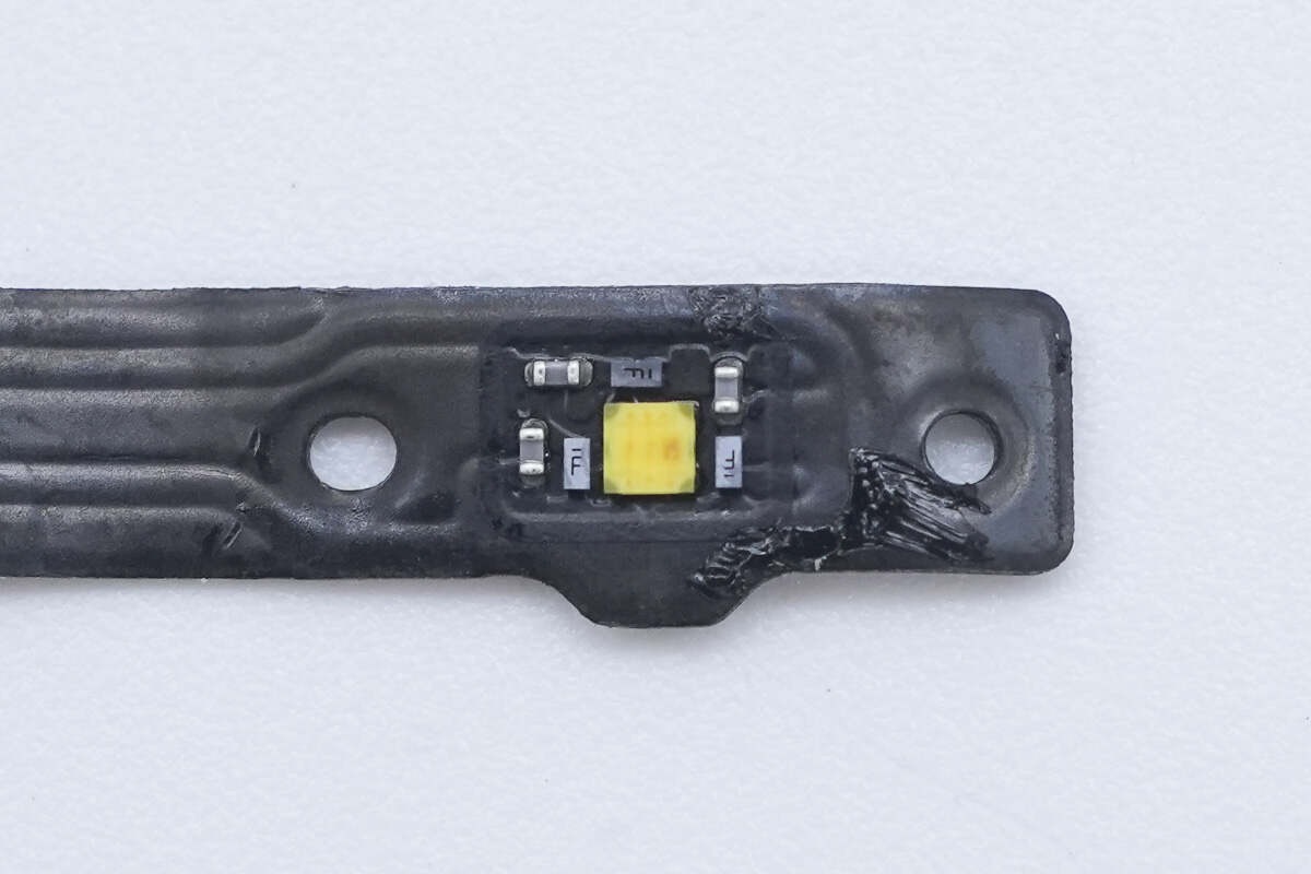

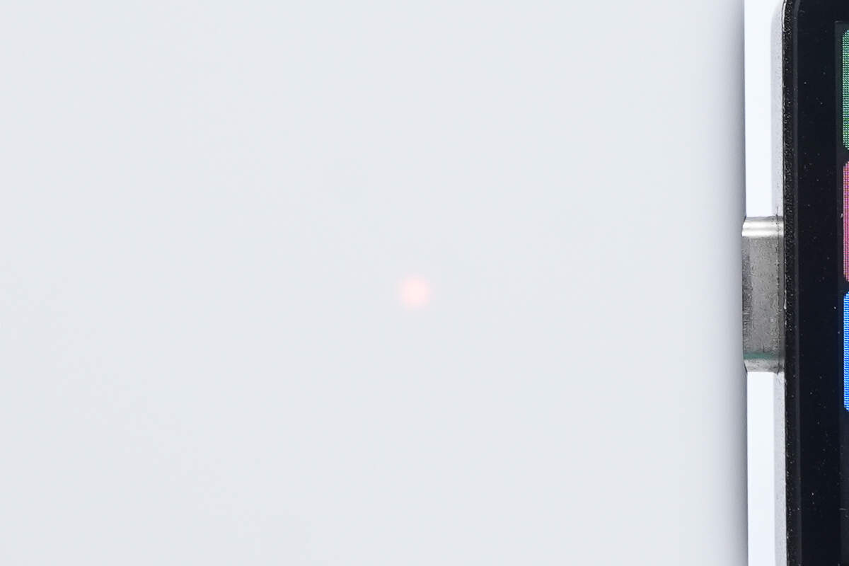

There is an LED indicator on the back.

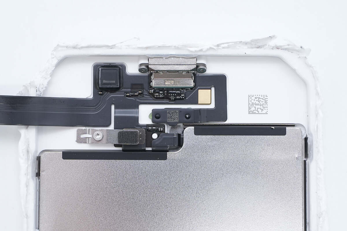

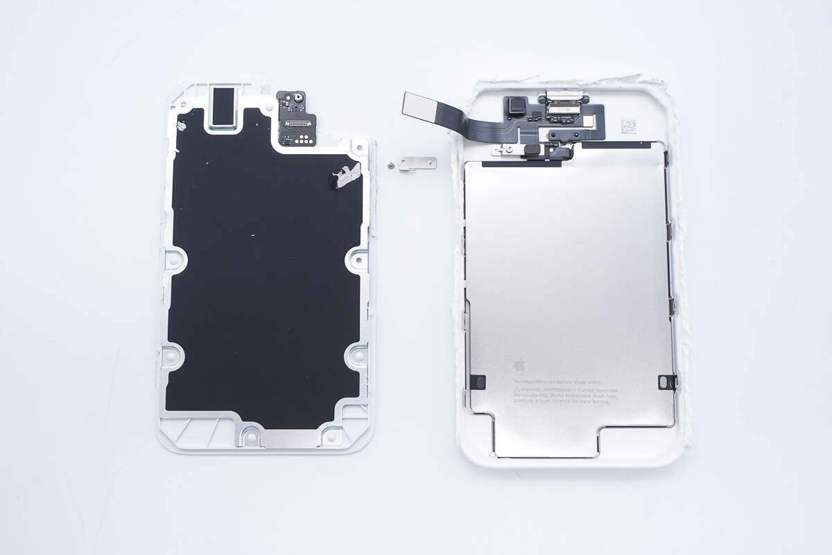

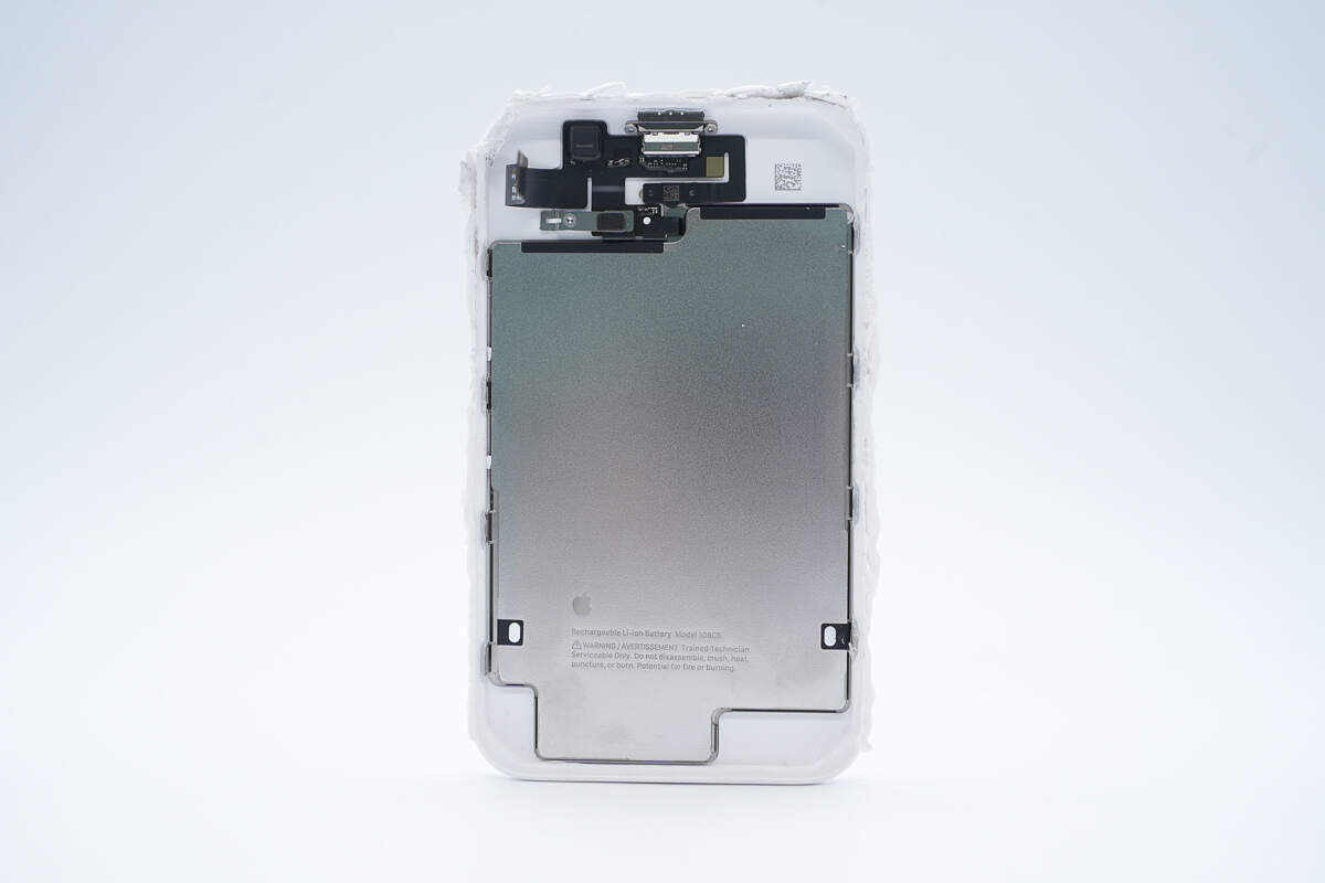

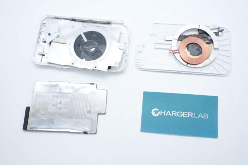

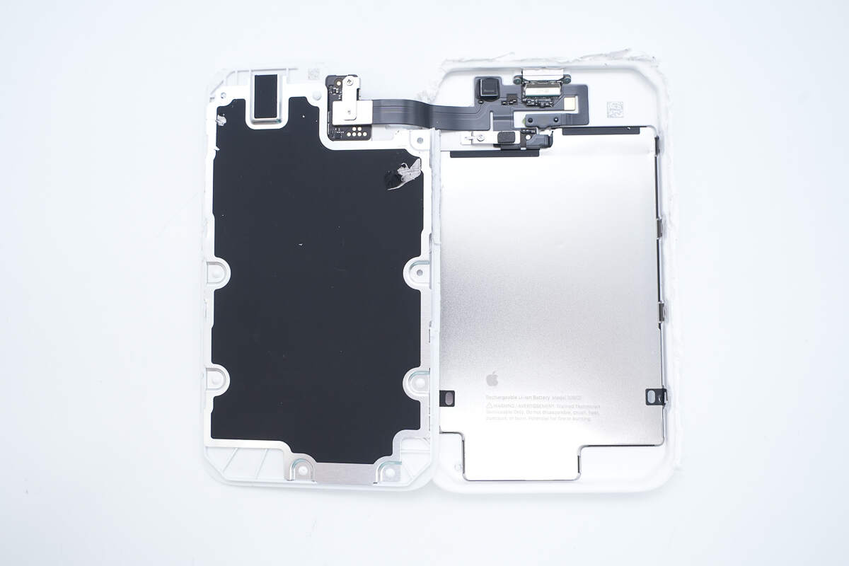

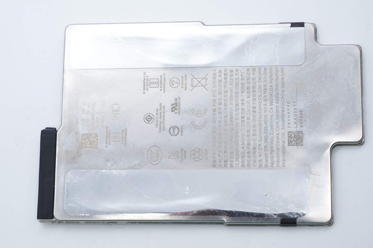

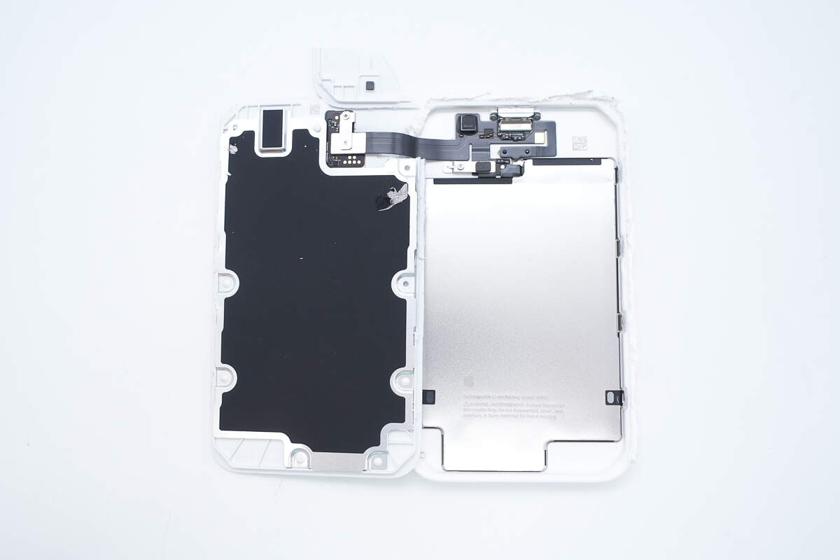

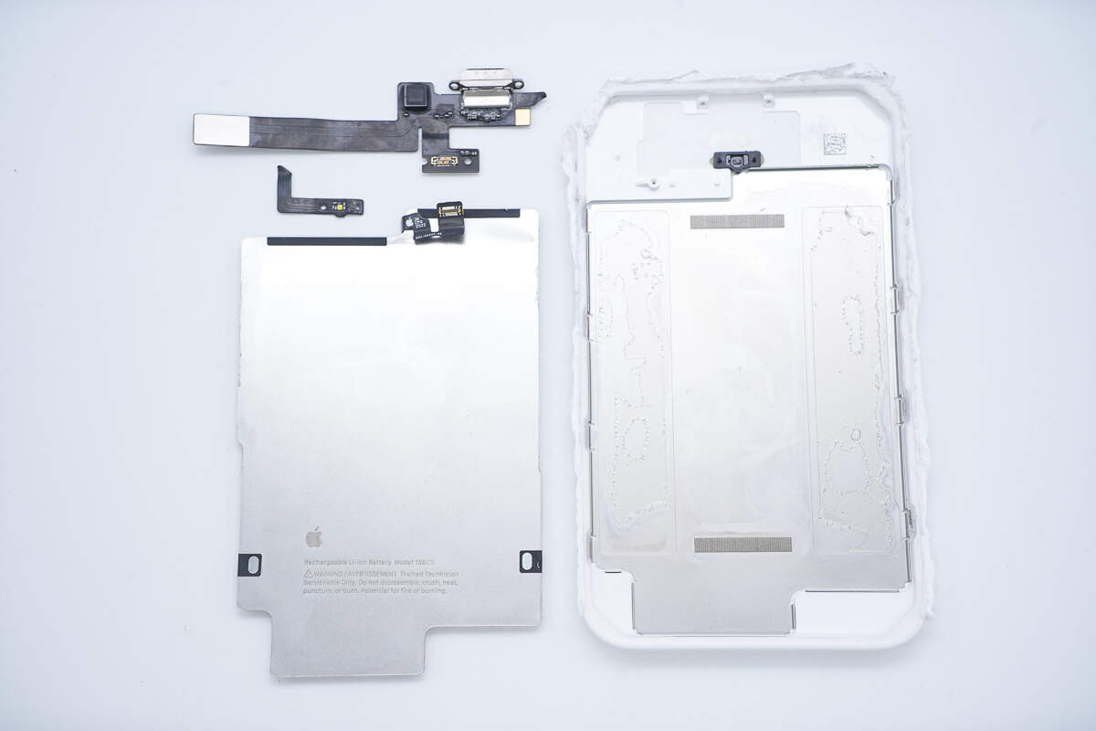

First, disassemble the casing along the seam, and the interior is a double-layer design.

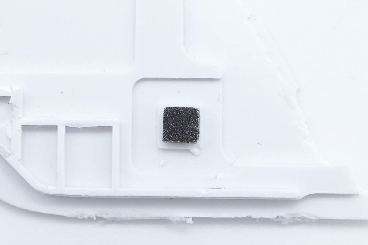

A cushioning foam pad is attached at the position corresponding to the filter inductor.

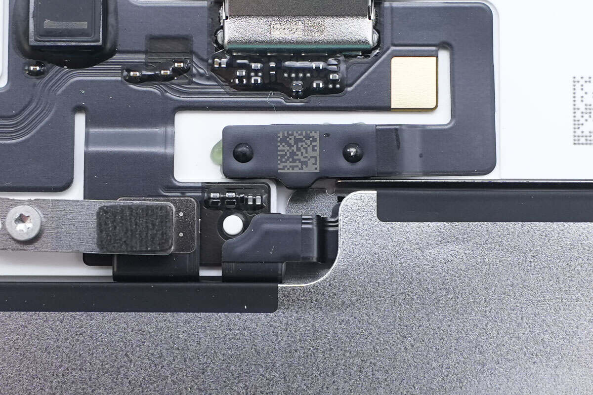

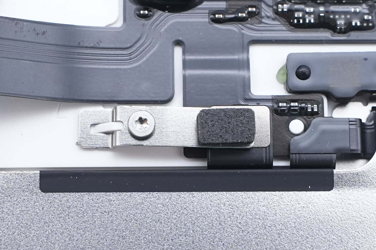

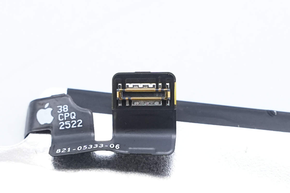

Inside the panel, the wireless charging module is connected to the battery casing via a flex cable.
The flex cable connector is secured with a screw clamp.
Disconnect the flex cable to separate the wireless charging module inside the panel from the battery component within the casing.

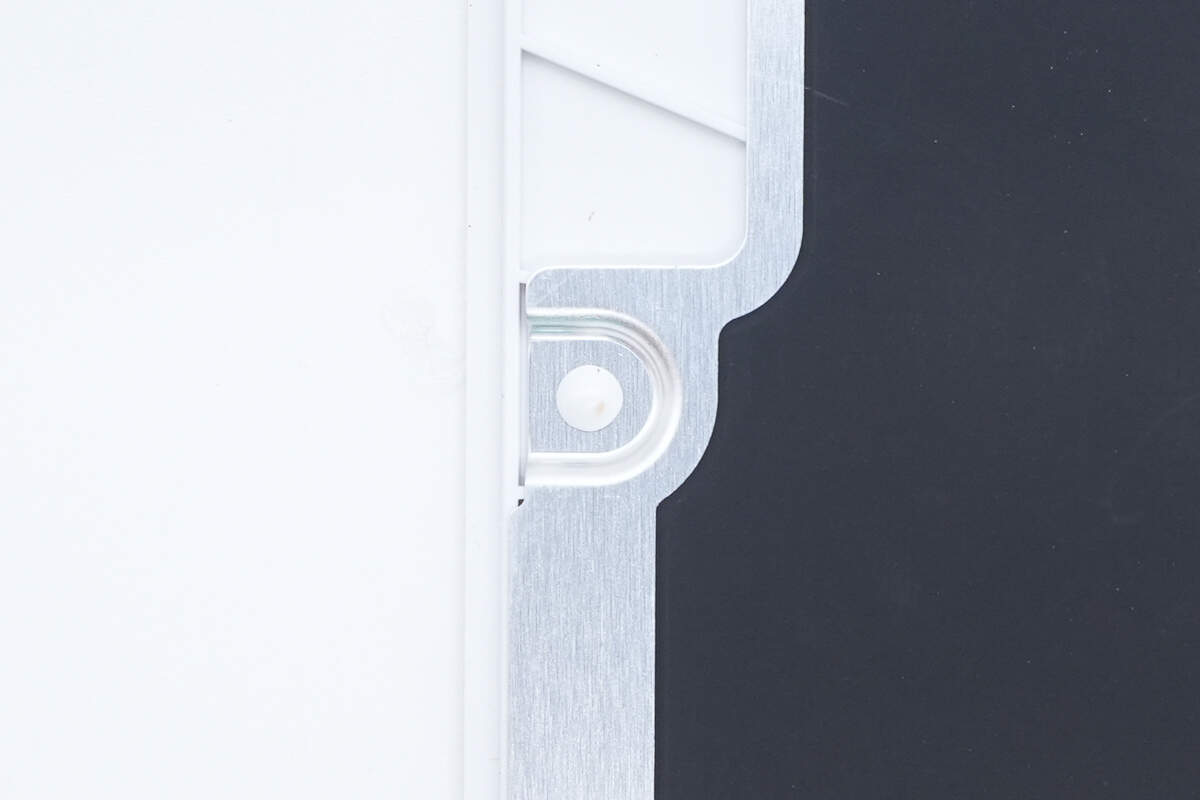

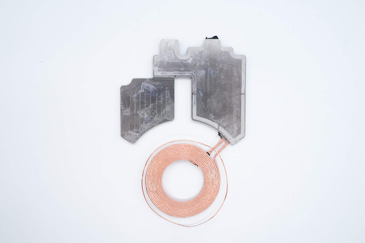

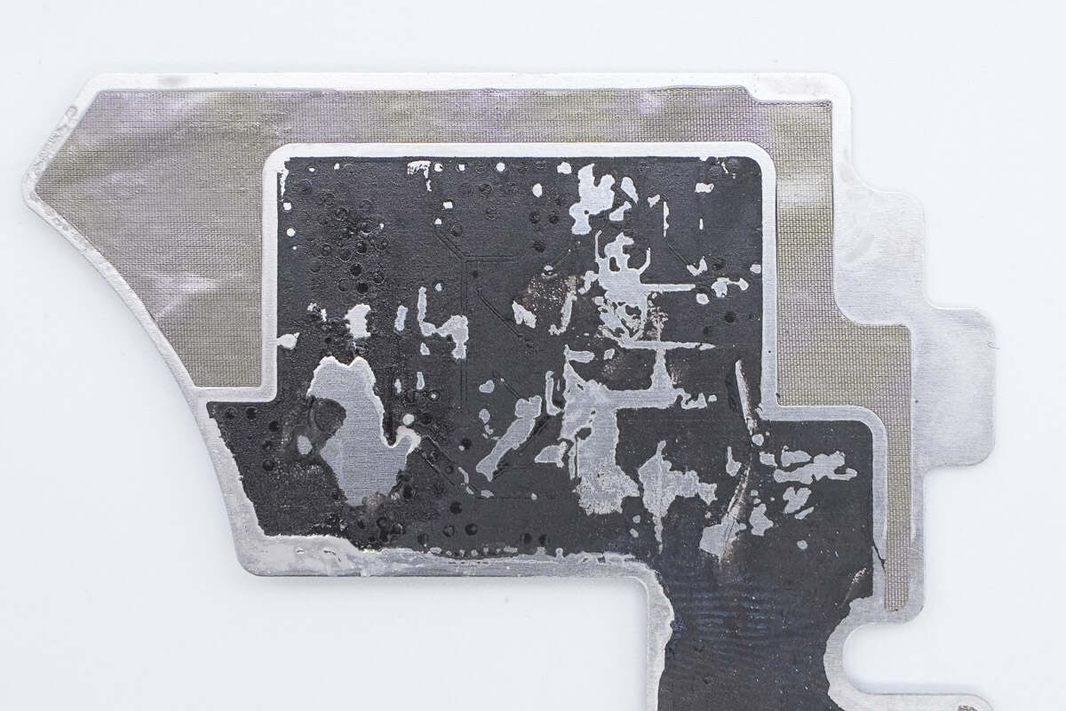

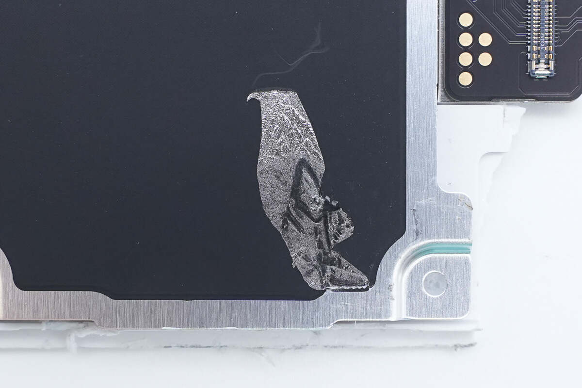

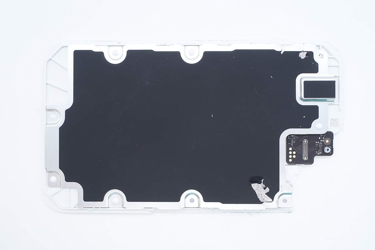

The back of the wireless charging module is covered with an aluminum alloy plate.
The aluminum alloy plate is secured with plastic heat welding.

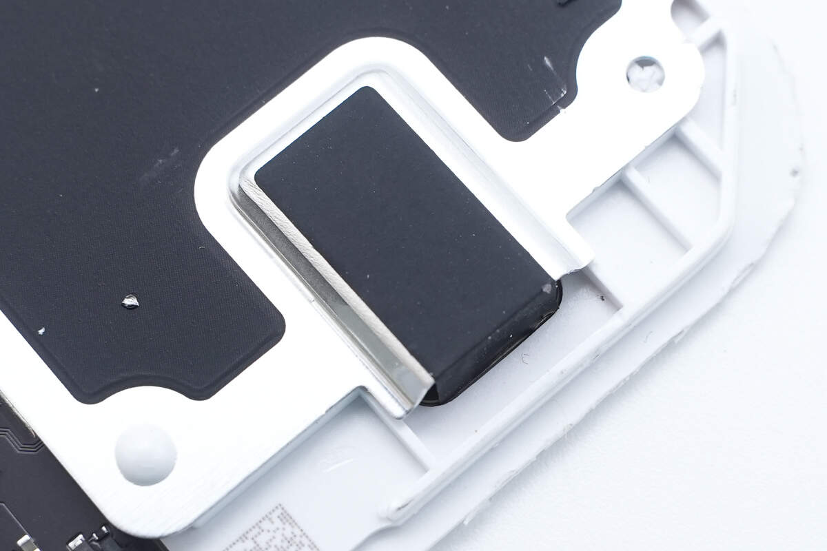

A graphite thermal pad is attached to the aluminum alloy plate.
The aluminum alloy plate is stamped with a raised bump corresponding to the shapes of the components beneath.

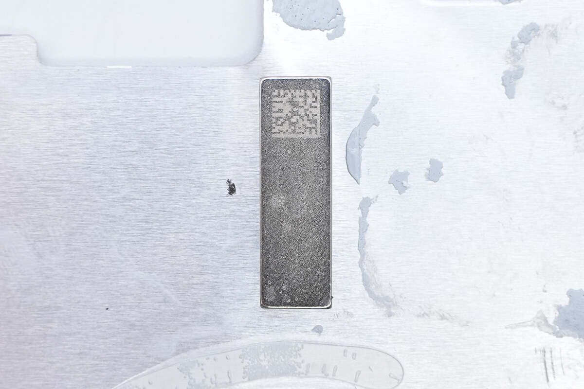

A QR code is printed on the positioning magnet.

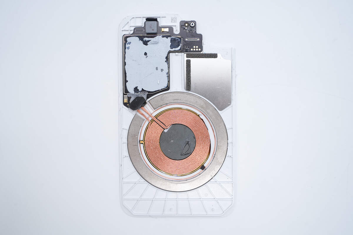

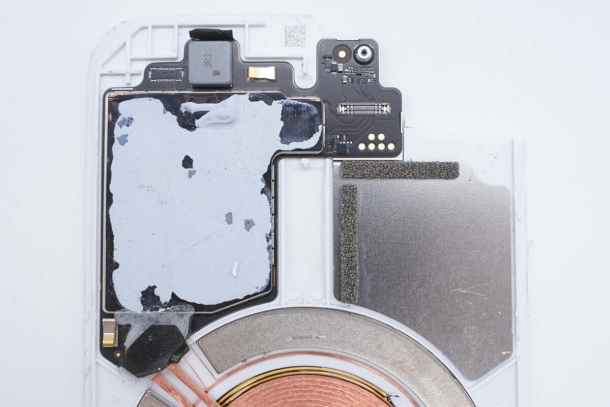

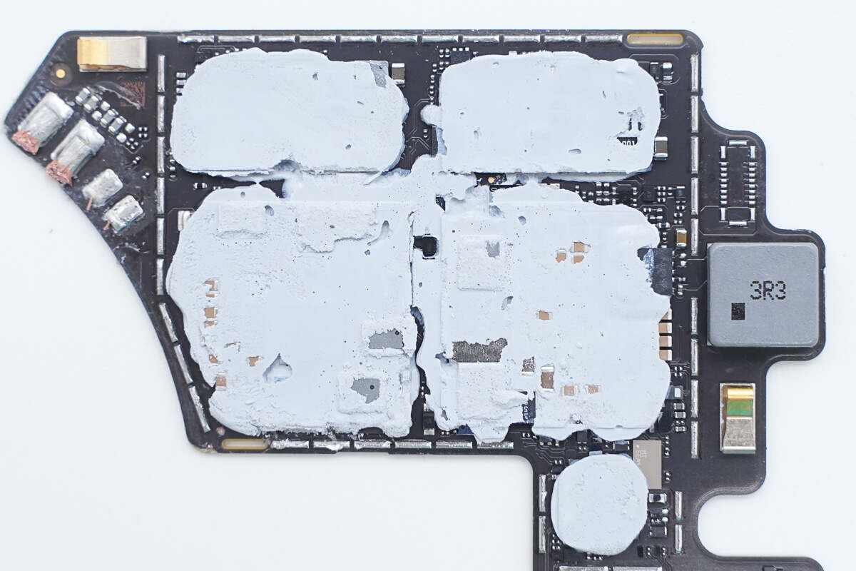

Inside the panel, there is a PCBA module and a wireless charging coil.
The PCBA module is equipped with a metal shielding cover and coated with thermal adhesive to facilitate heat dissipation through contact with the aluminum alloy plate.

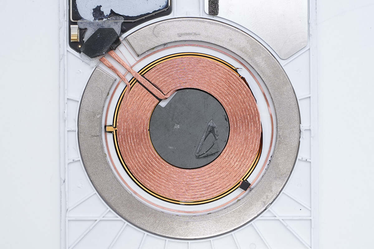

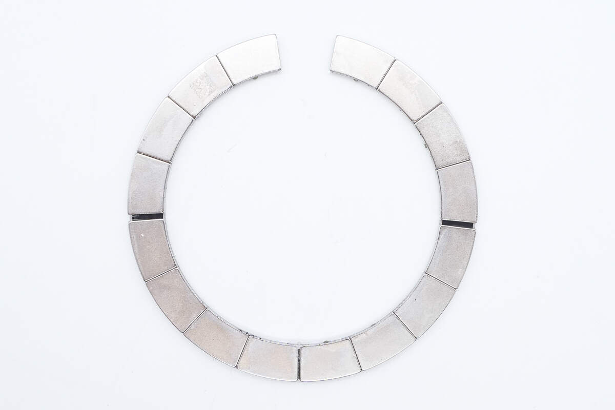

The magnet is arranged around the edge of the wireless charging coil to attach to the phone.
A communication coil is also placed between the wireless charging coil and the magnet.

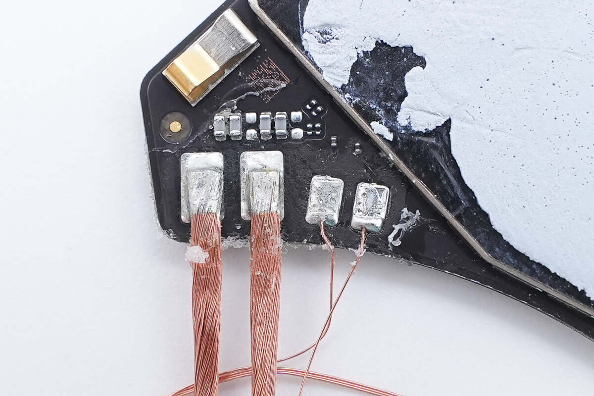

The solder joints of the wireless charging coil are reinforced with adhesive and insulated with tape.

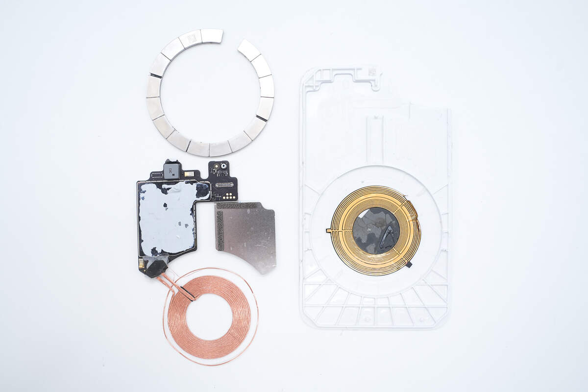

Remove the PCBA module, magnets, and wireless charging coil from inside the aluminum alloy plate.
Close-up of the shielding layer.

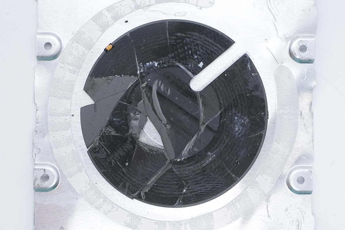

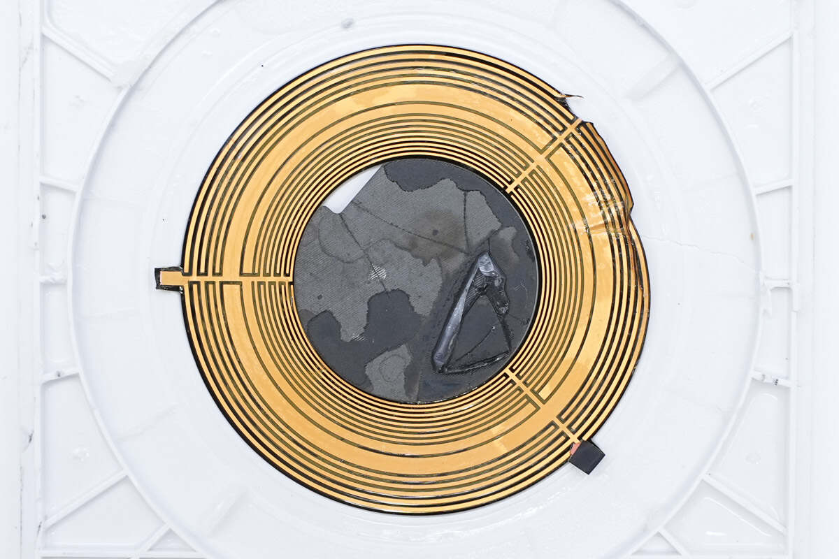

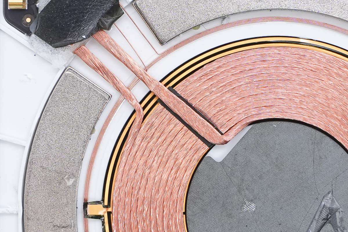

The ring-shaped magnet consists of a total of 16 individual magnets.
Close-up of the wireless charging coil and communication coil.
The coils are connected by soldering.

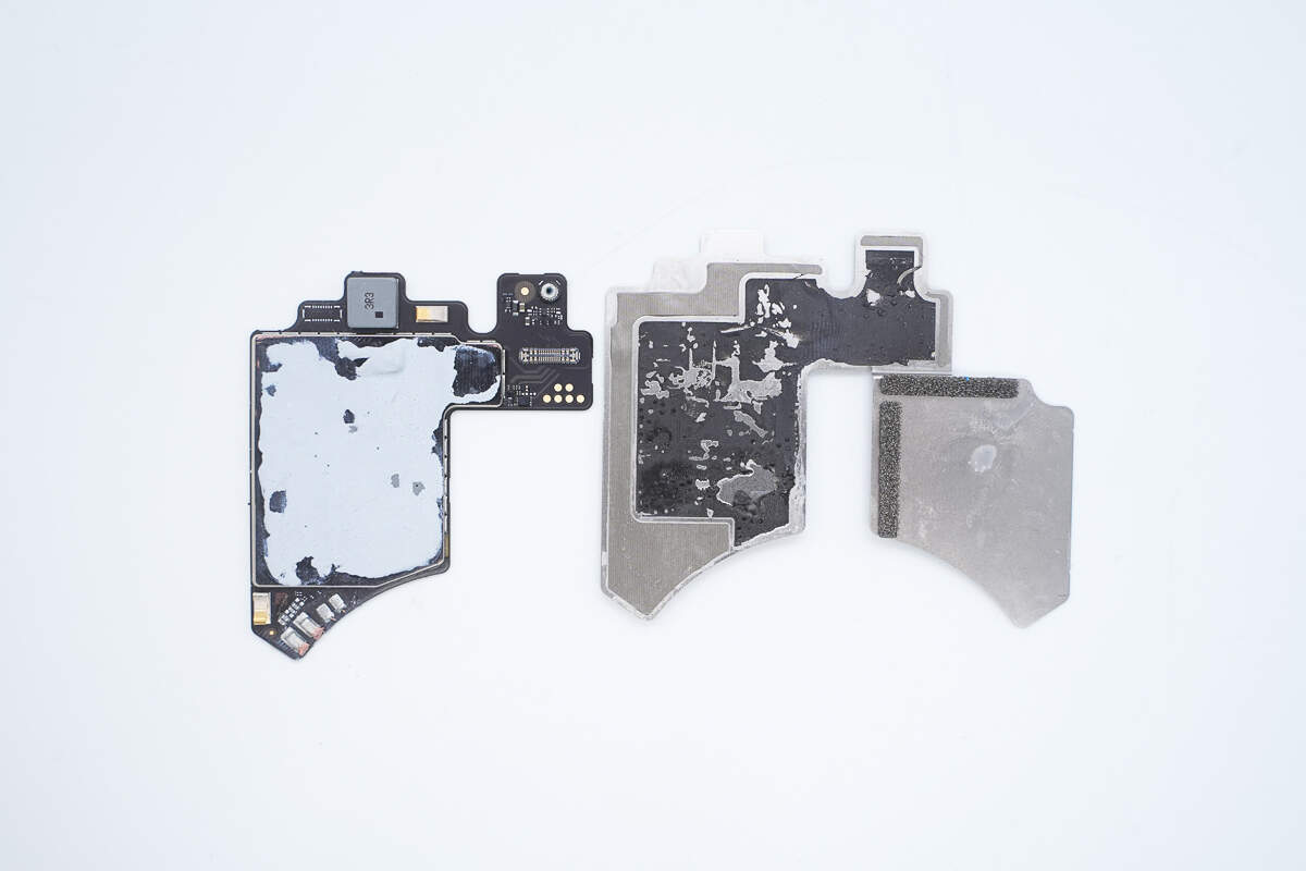

The back of the PCBA module is equipped with aluminum plates for heat dissipation.
Separate the PCBA module and the aluminum plates.
The aluminum plate is lined with conductive fabric and uses double-sided adhesive to secure the PCBA module.

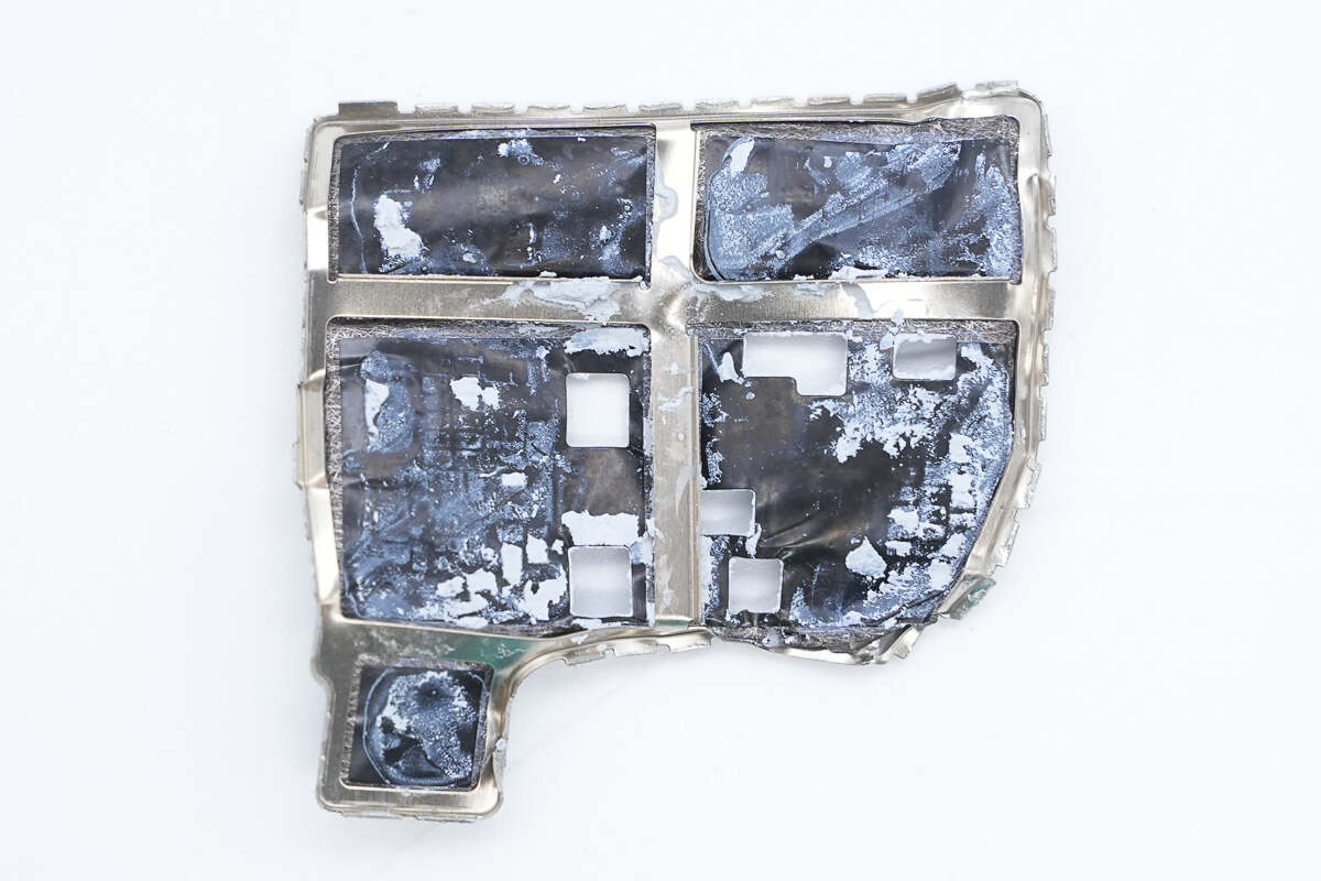

The front of the PCBA module is covered with a metal shielding case.
The shielding case is made up of a metal frame with adhesive tape applied.
Thermal adhesive is applied to the components to enhance heat dissipation.

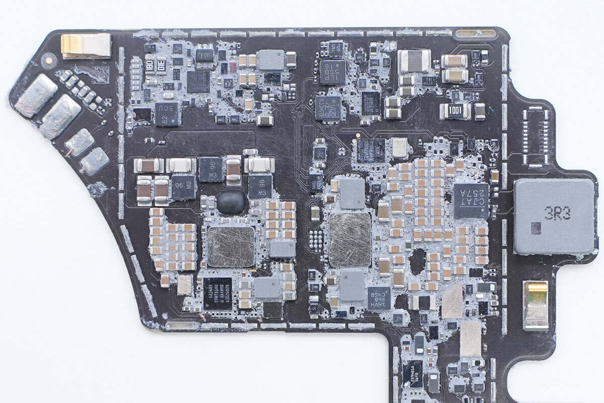

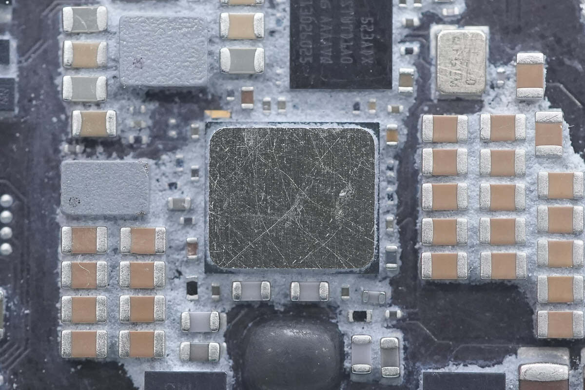

Clean off the thermal adhesive. Aluminum plates are attached to the wireless charging chip and power conversion chip to enhance heat dissipation.

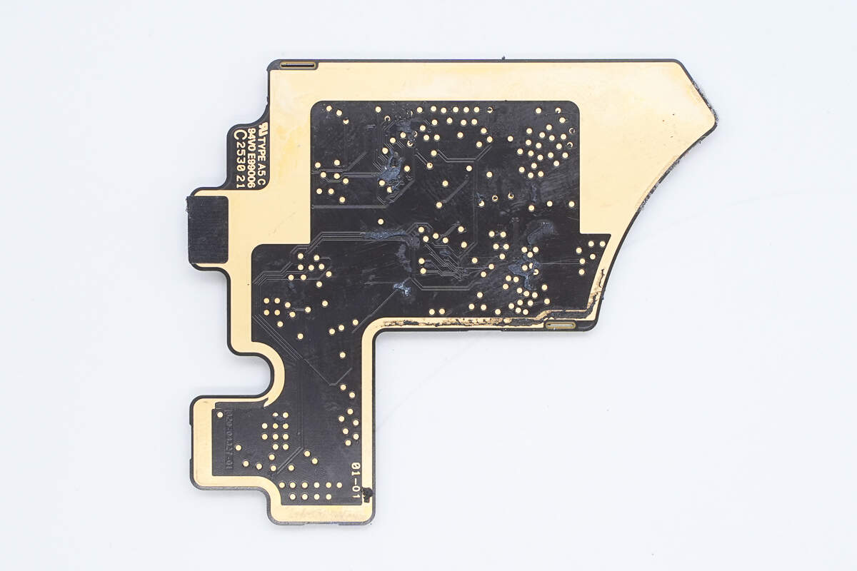

There are no components on the back of the PCBA module.

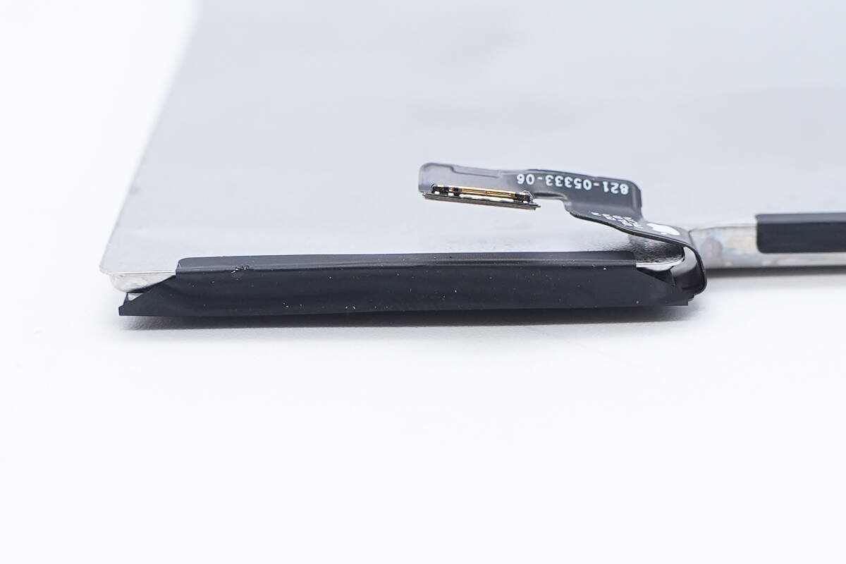

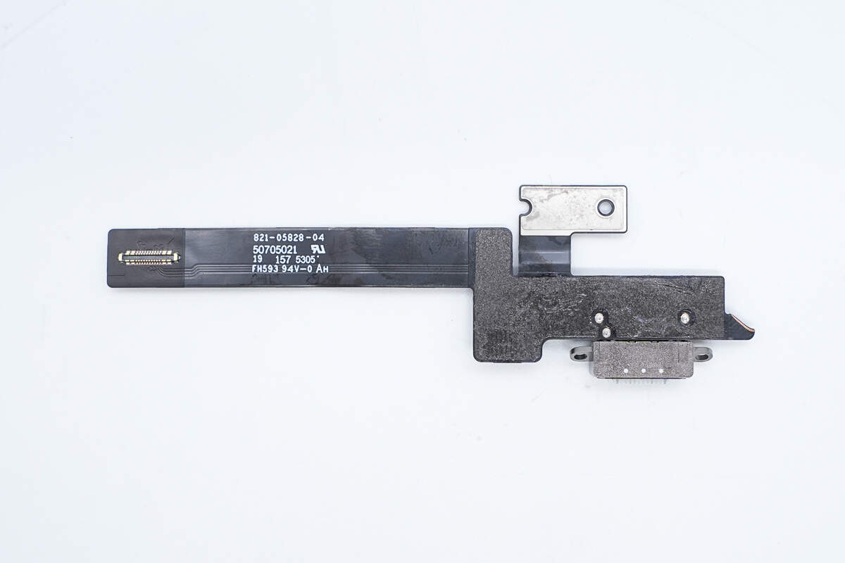

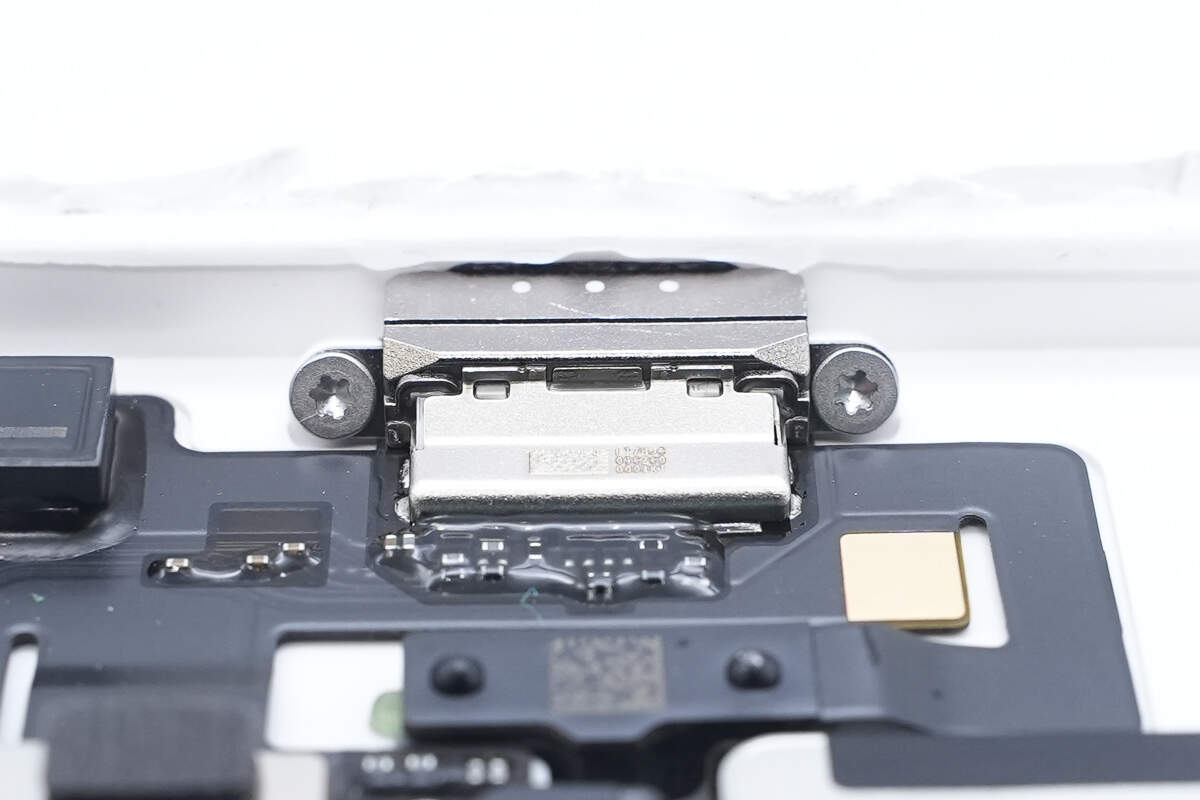

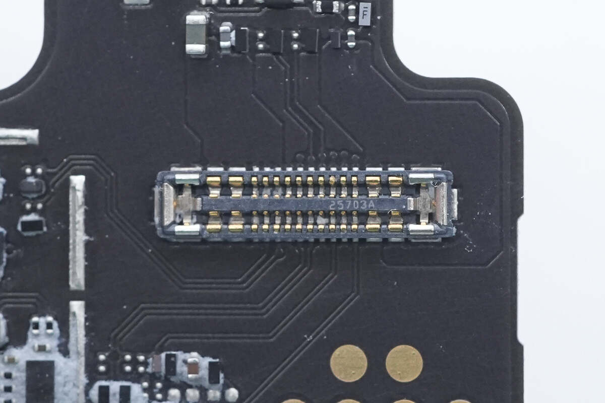

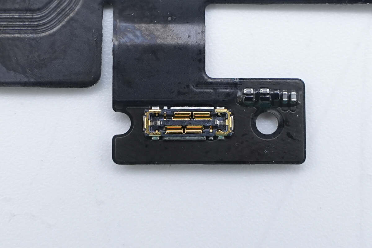

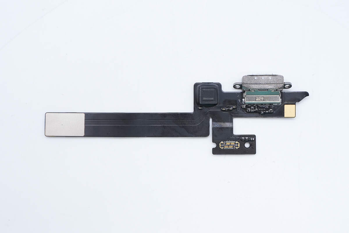

Close-up of the flex cable connector connected to the USB-C port and battery.

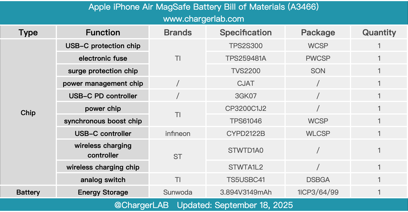

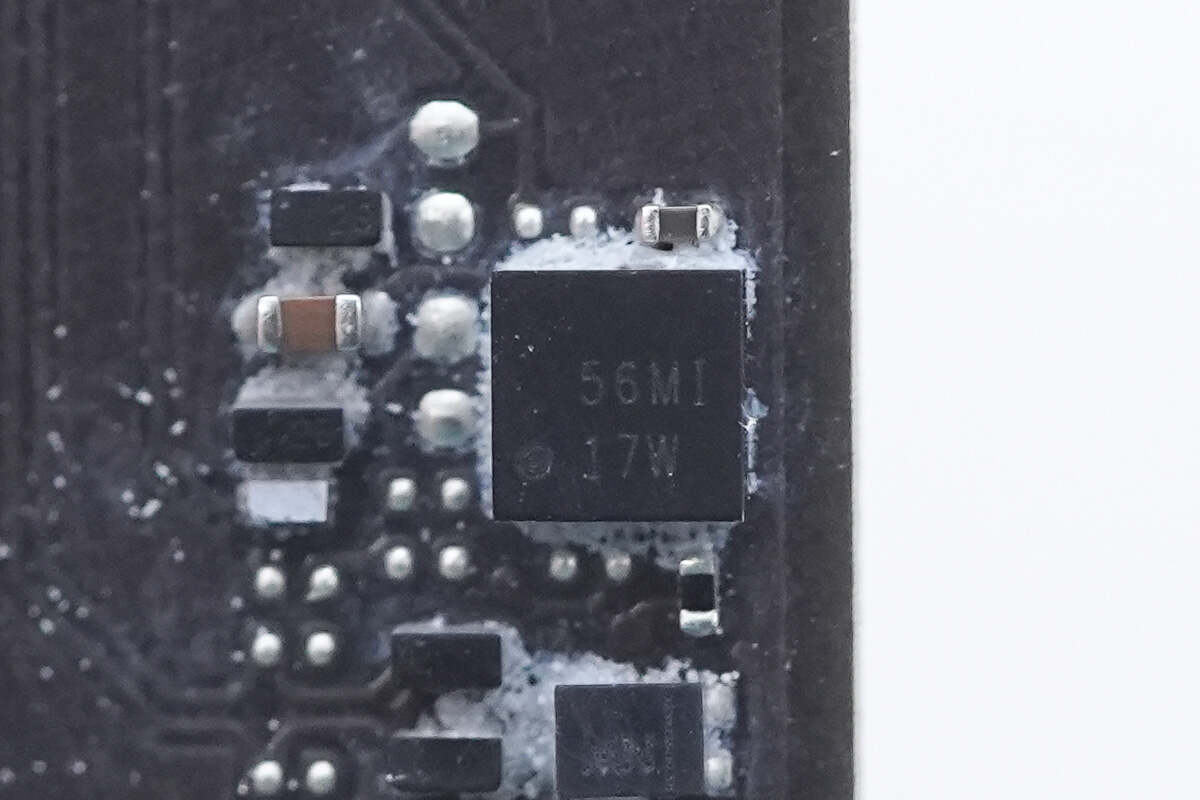

The protection chip for the USB-C port is from Texas Instruments, marked with "17W," model TPS2S300. It provides overvoltage and electrostatic discharge (ESD) protection by shorting the CC pin to VBUS, supports up to 24V withstand voltage, and supports a VCONN power supply. The chip comes in a WCSP package.

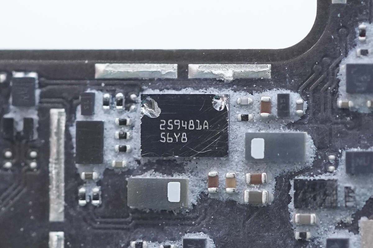

The electronic fuse is from Texas Instruments, model TPS259481A. It is a bidirectional electronic fuse that supports an operating voltage range of 3.5–23V, has an on-resistance of 12.2mΩ, supports a continuous current of 8A, and comes in a PWCSP package.

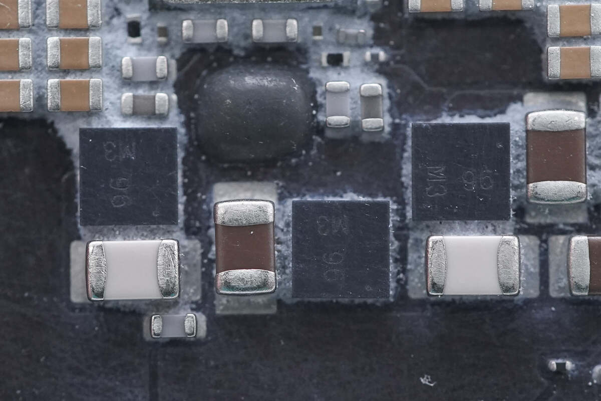

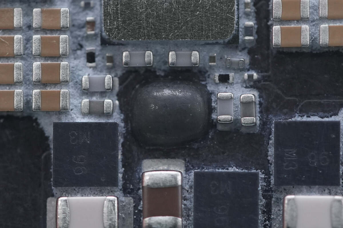

Close-up of the two current-sensing resistors.
Two MOSFETs are used for circuit switching control.
Close-up of the current-sensing sampling resistor.

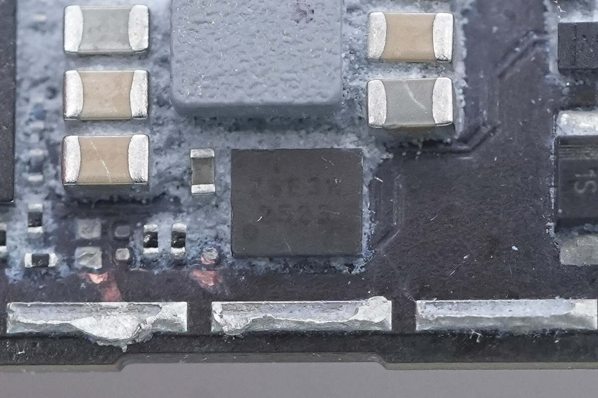

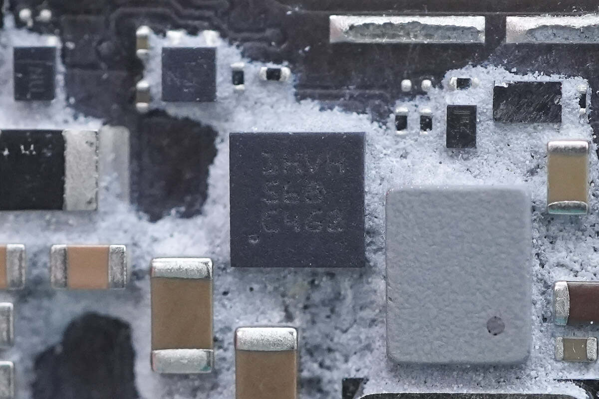

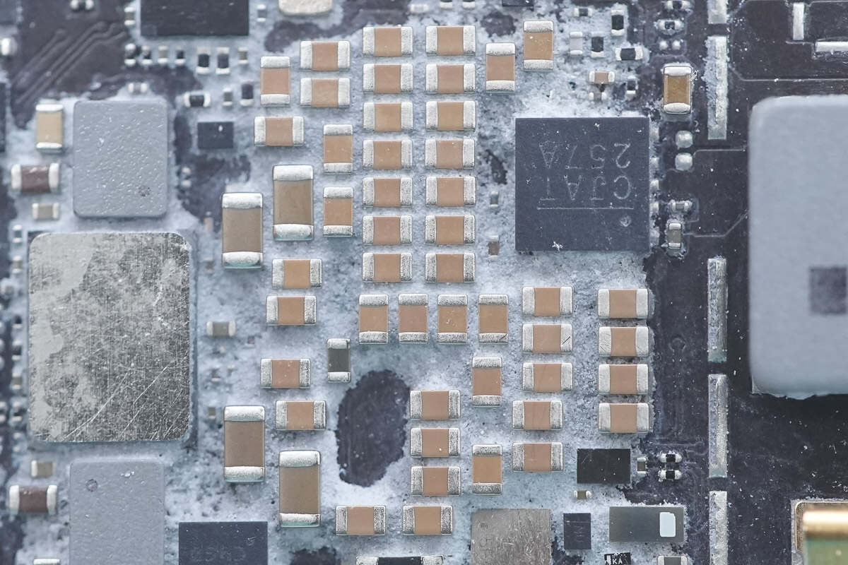

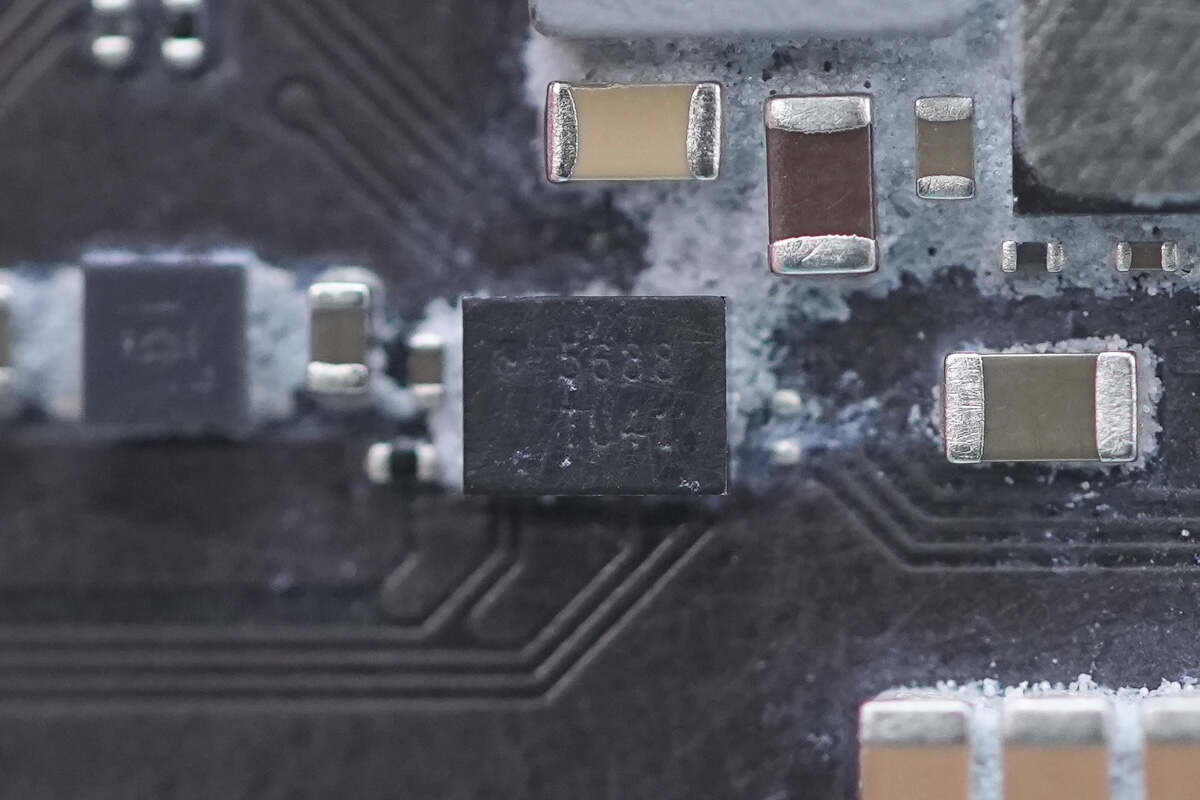

The surge protection chip is from Texas Instruments, marked with "1HVH," model TVS2200. It operates at 22V and provides overvoltage protection. The chip is packaged in a SON package.

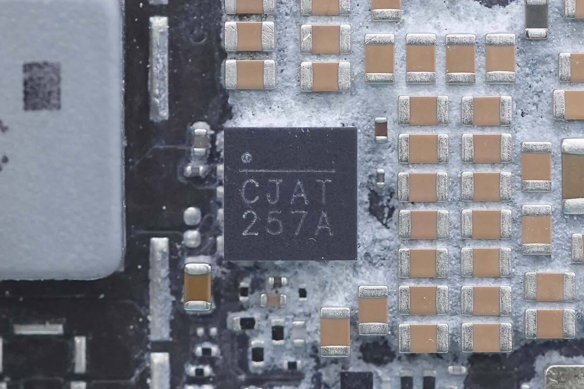

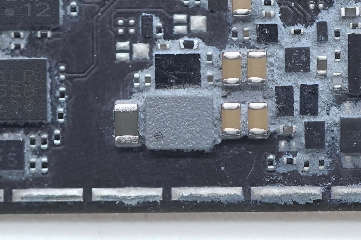

The power management chip is marked with "CJAT 257A."

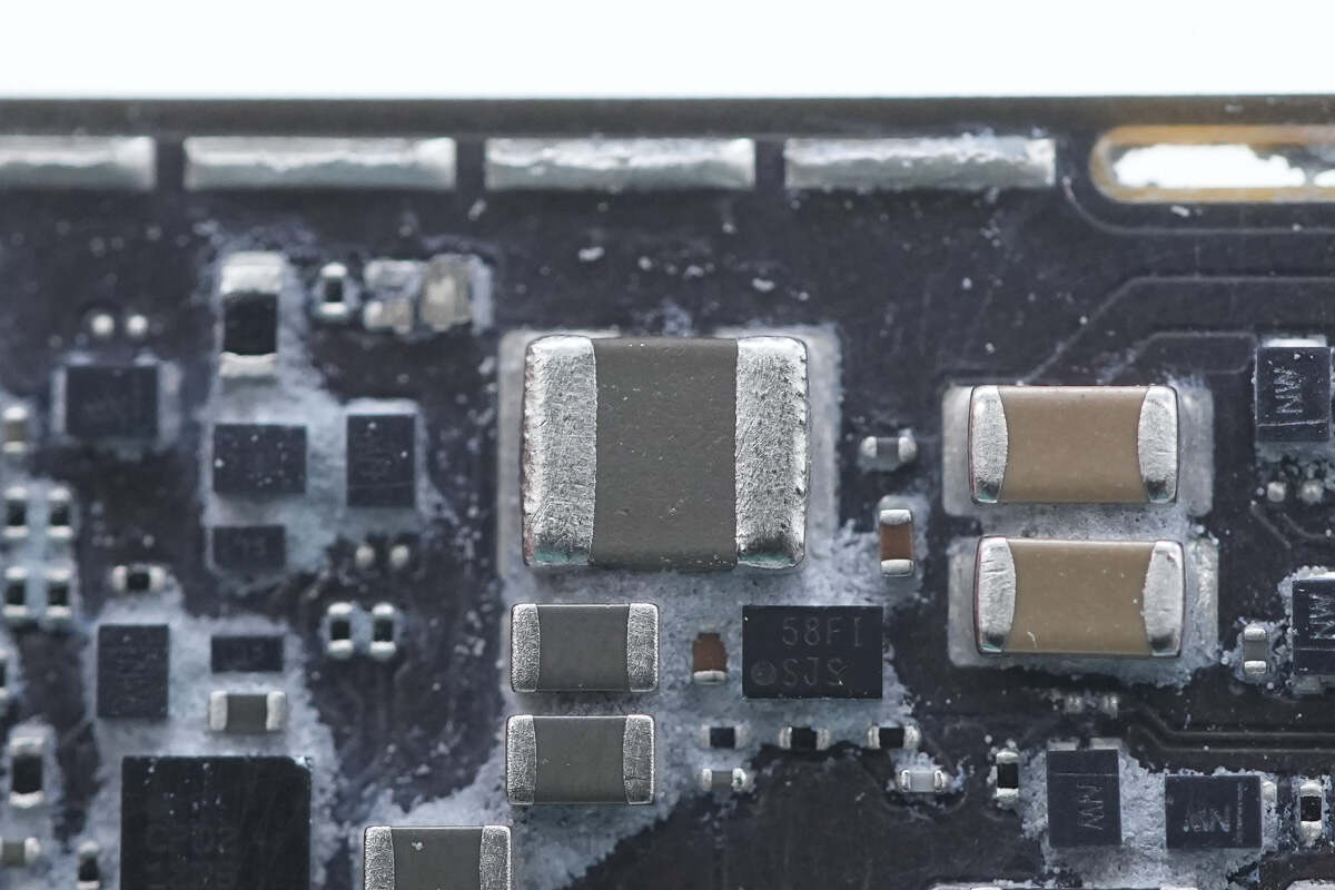

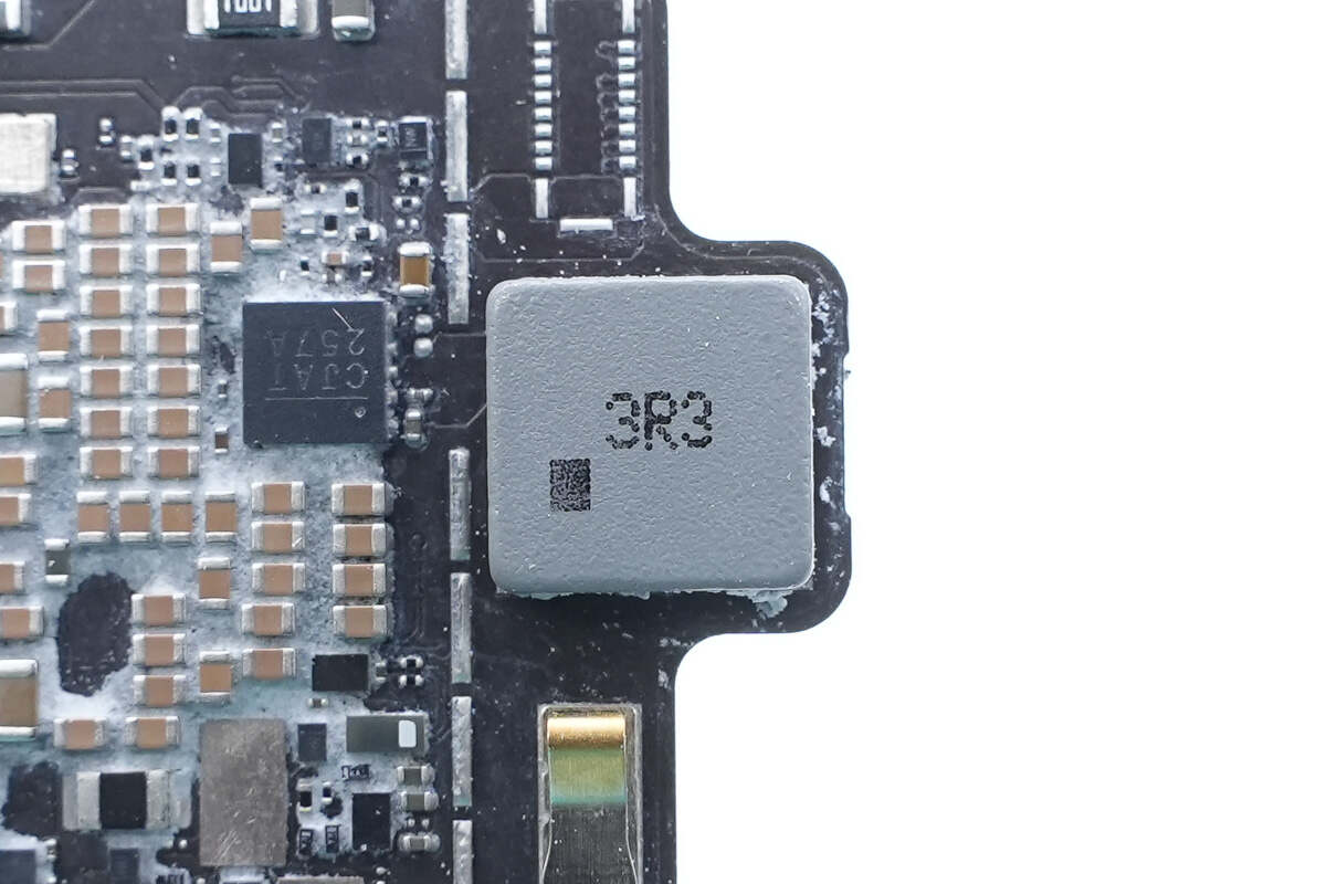

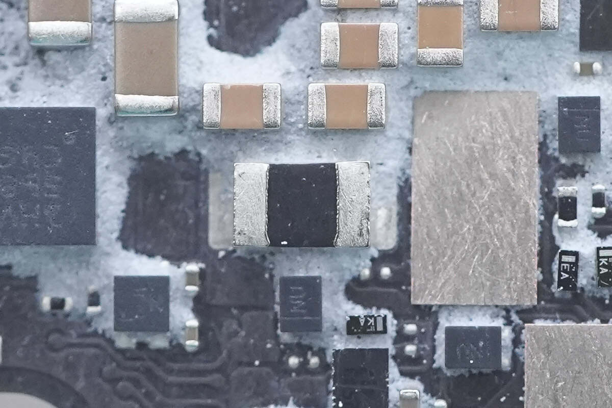

Close-up of the 3.3μH alloy inductor.

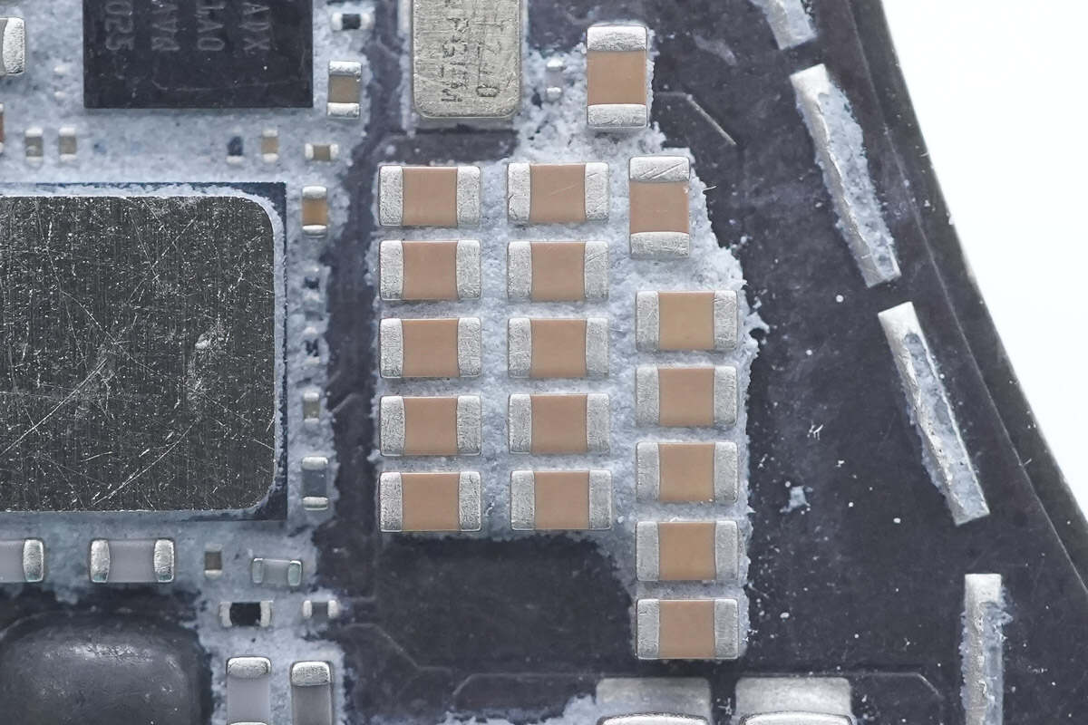

The MLCC capacitors are used for power supply filtering.

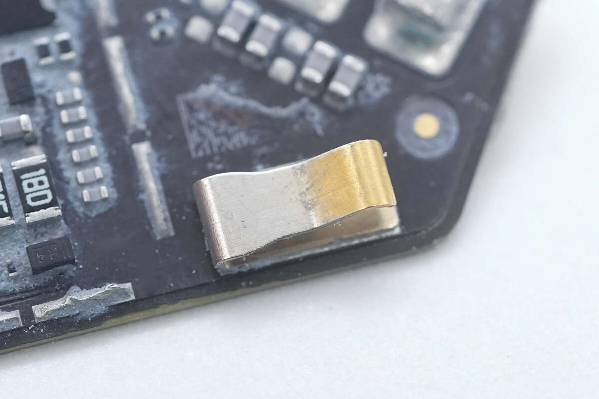

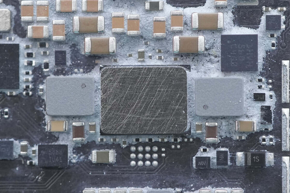

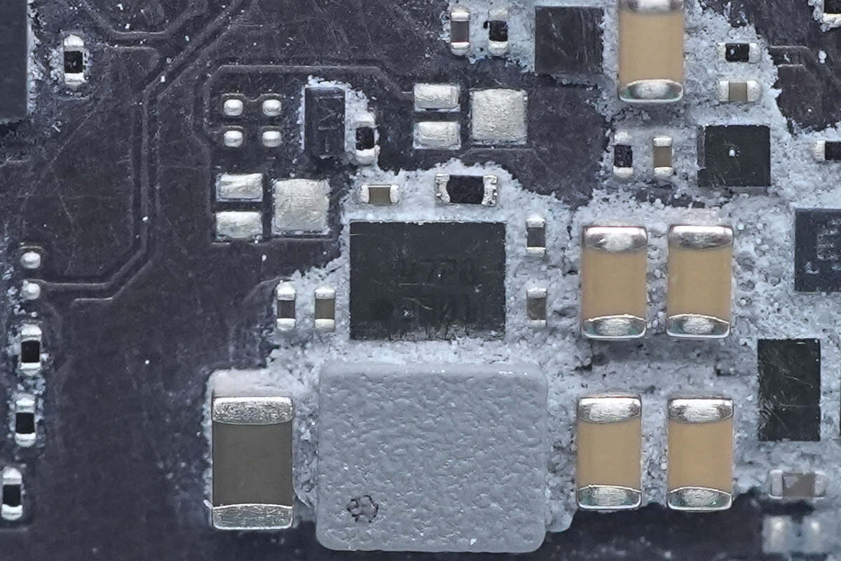

A metal spring contact is used to connect the aluminum alloy cover plate to ground.

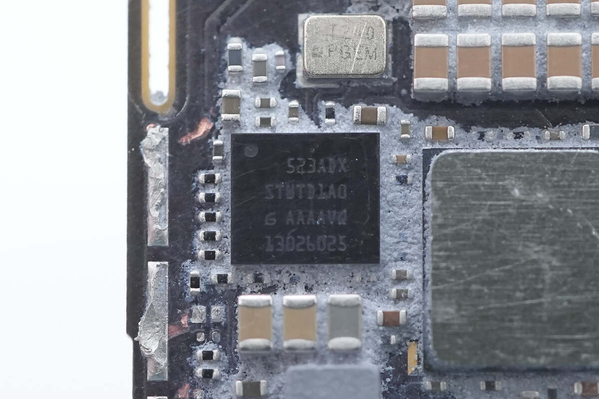

The power chip is attached to an aluminum plate with thermal adhesive to enhance heat dissipation.
The power chip is from Texas Instruments, marked with CP3200C1J2, and is flanked by SMD inductors on both sides.
The PD controller is marked with "3GK07."

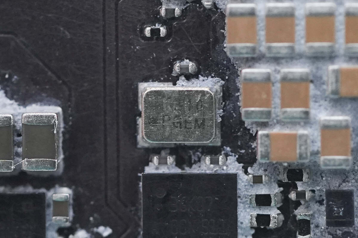

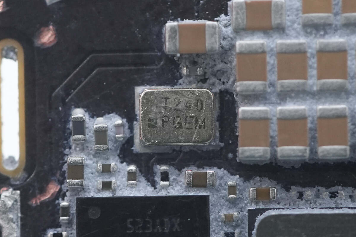

Close-up of the crystal oscillator.
The boost converter chip is from Texas Instruments, marked with "SJS," model TPS61046. It is a synchronous boost converter with an integrated internal switch, supporting an input voltage range of 1.8–5.5V and an output voltage up to 28V. The chip features output short-circuit protection, overvoltage protection, and thermal shutdown protection. It comes in a WCSP package.
Close-up of the SMD boost inductor.

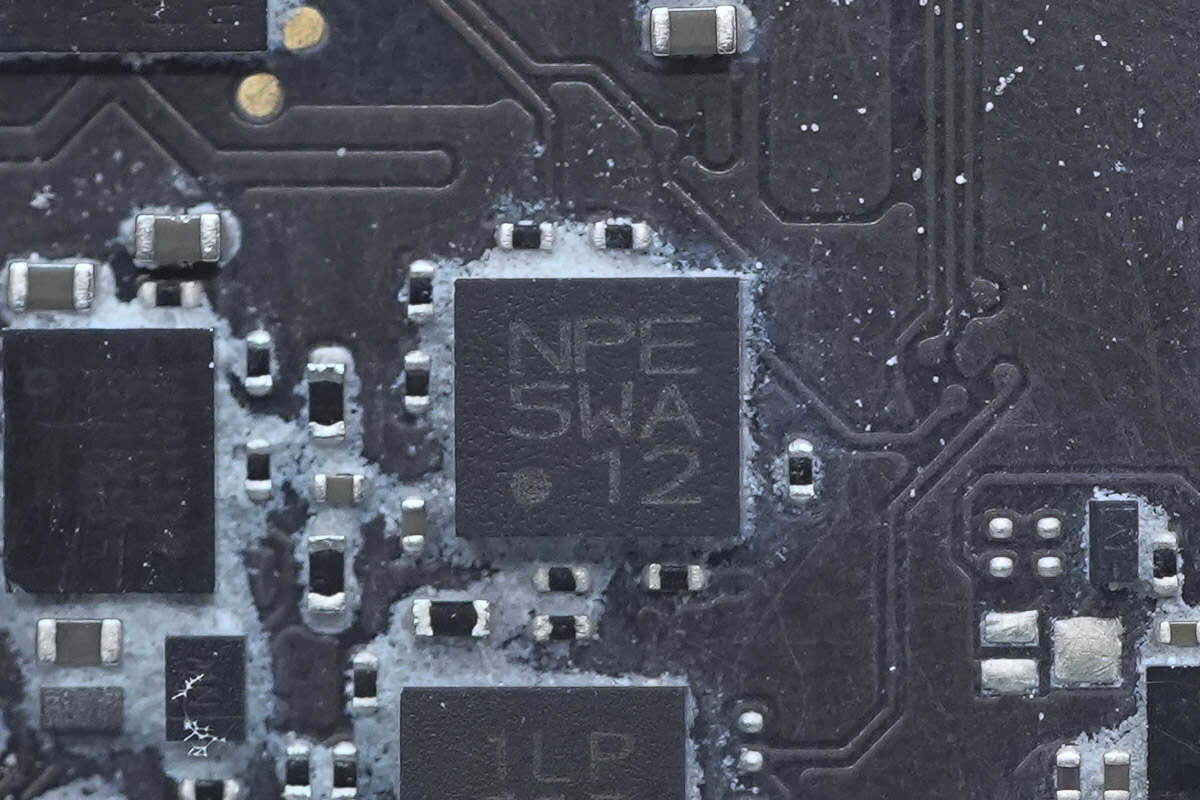

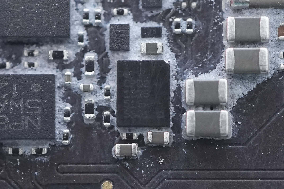

The USB-C port controller is from Infineon, model CYPD2122B. It features a built-in Cortex-M0 processor running at 48MHz, includes 32KB of FLASH memory, integrates a Type-C transceiver, and comes in a WLCSP package.
Close-up of the chip marked with "NPE 5WA 12."

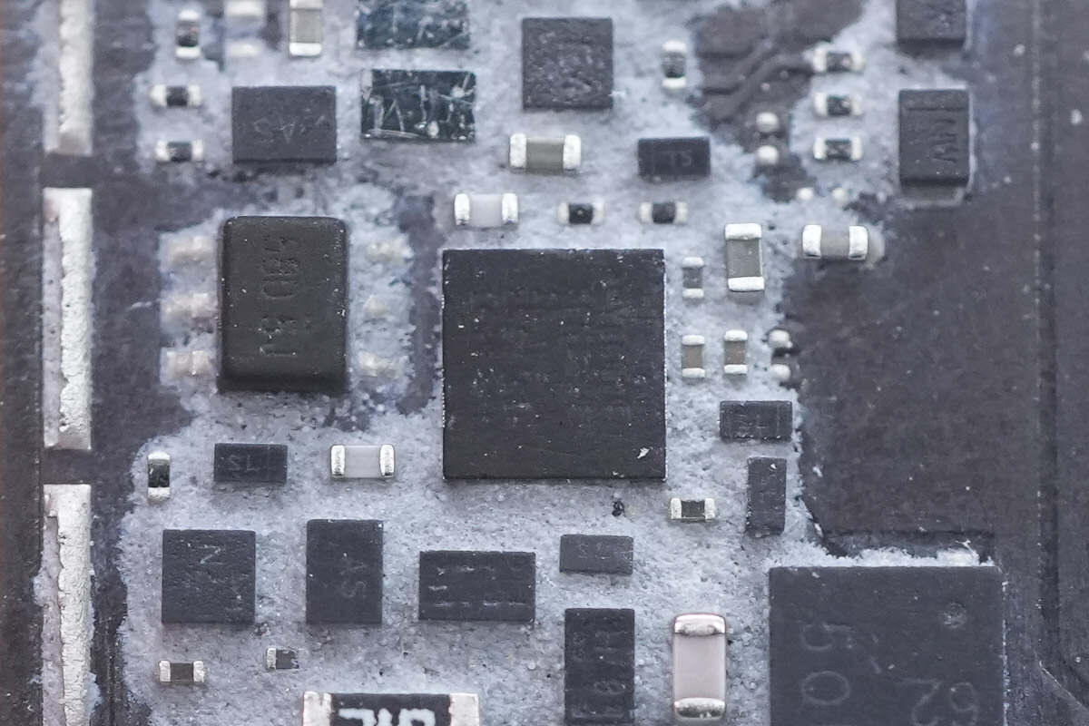

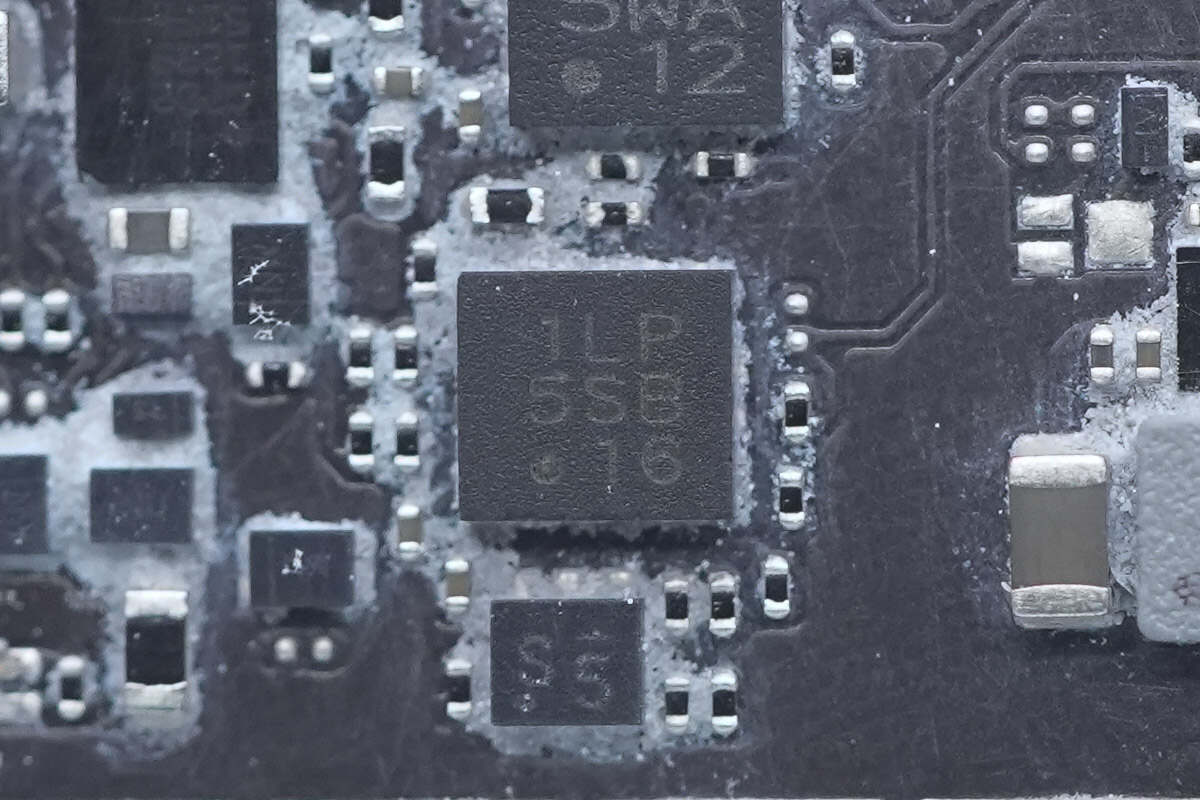

Close-up of the chip marked with "1LP 5SB 16."
A power chip marked with "4728."
Close-up of the accompanying SMD inductor.

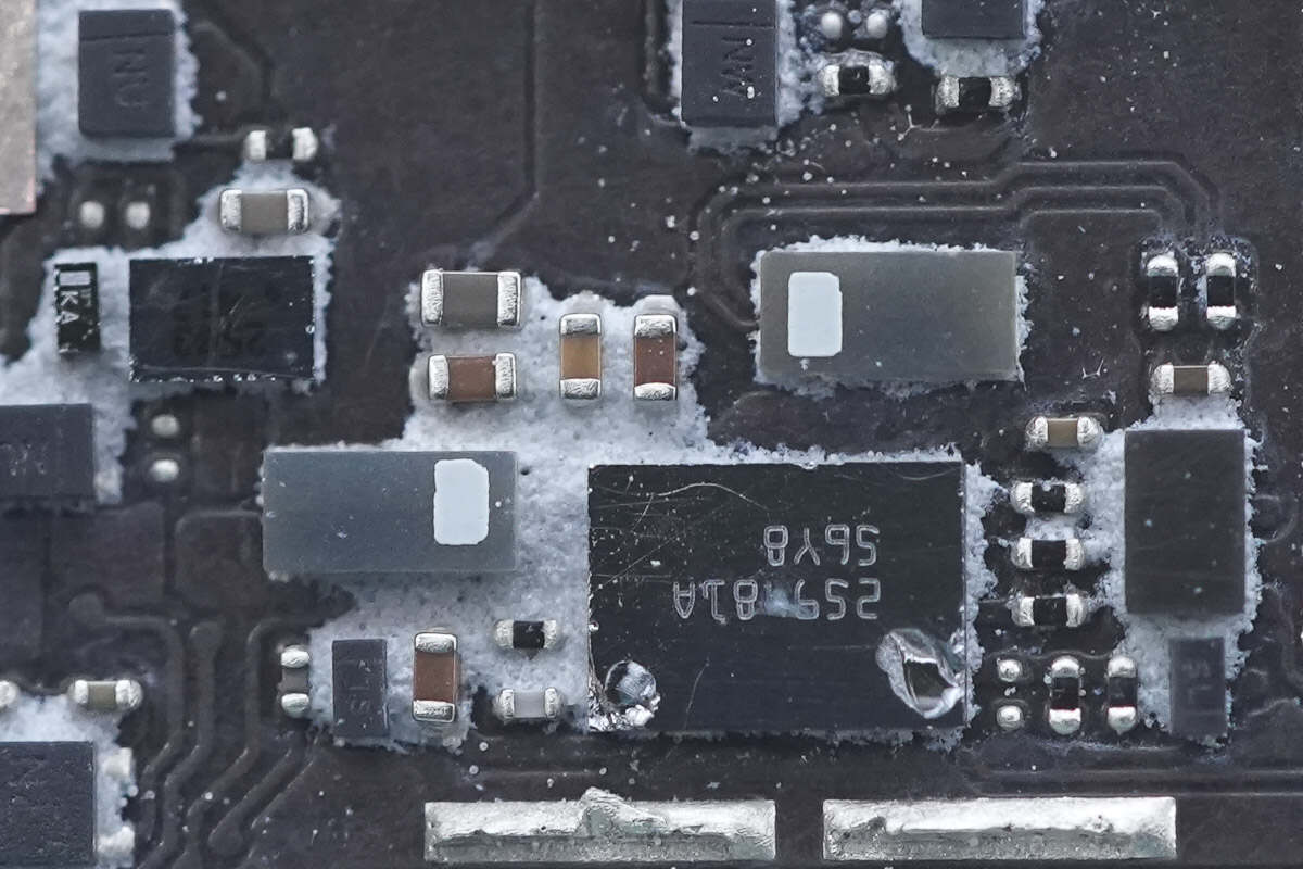

This chip has no markings and cannot be identified.

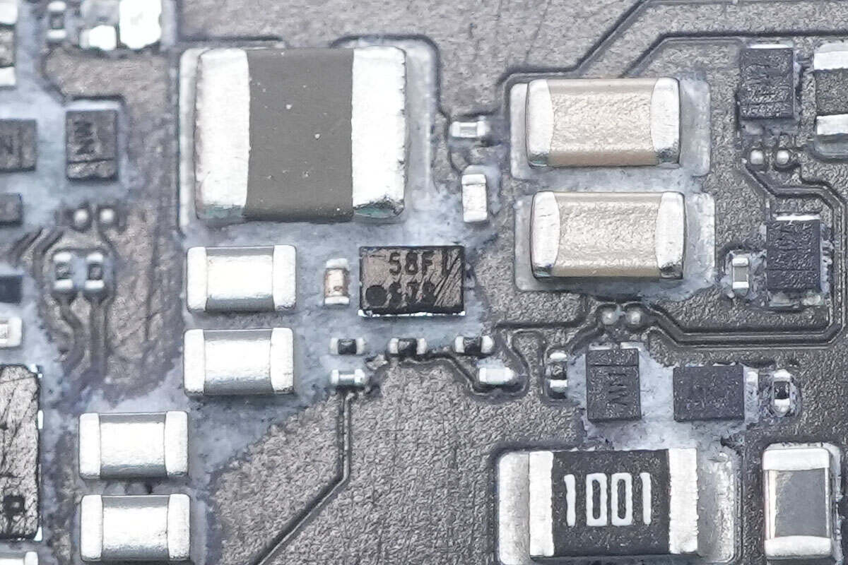

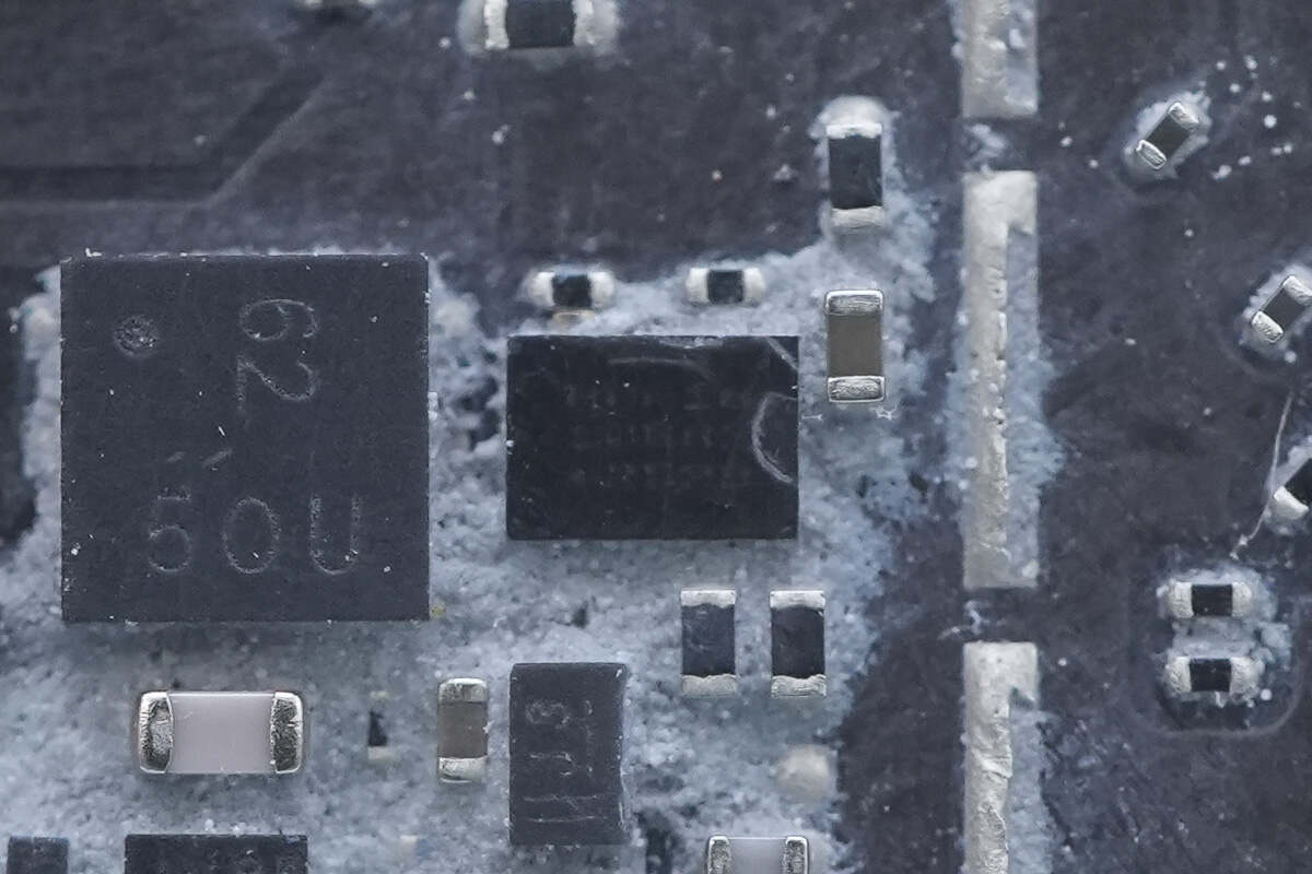

Close-up of the chip marked with "58D 5J."

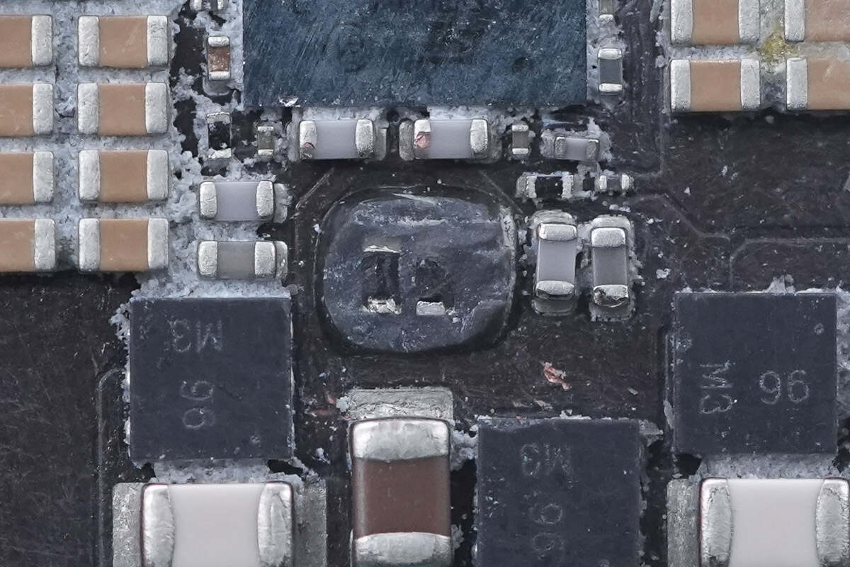

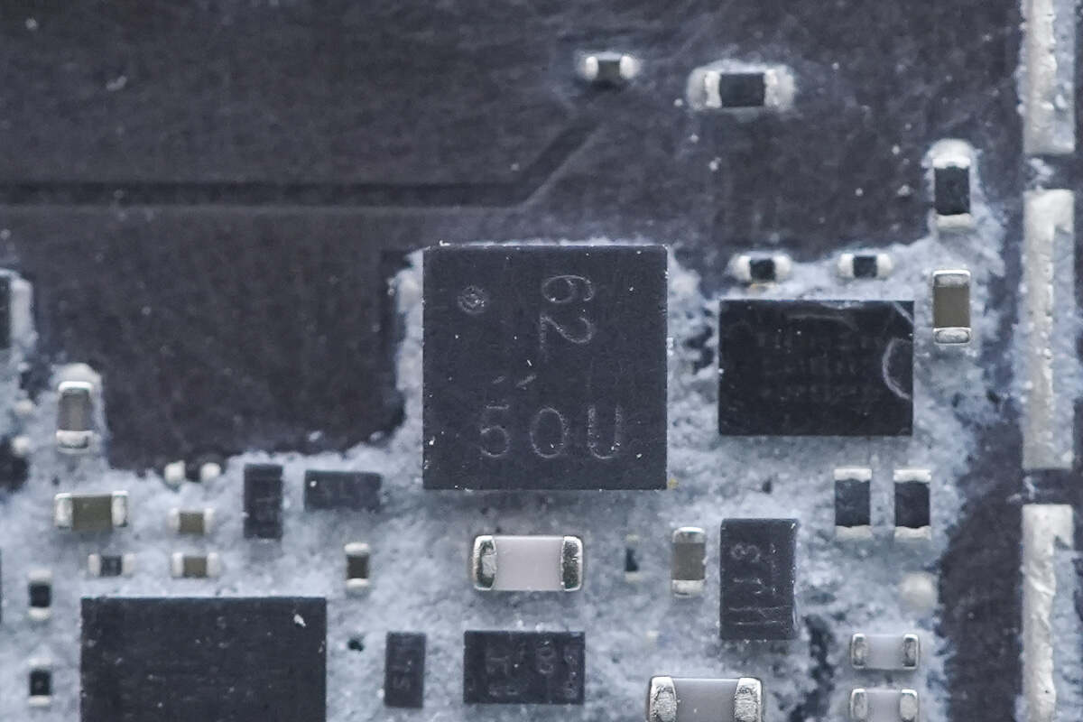

Close-up of the MOSFET marked with "62."
Close-up of the MLCC capacitors used for wireless charging filtering.
The wireless charging chip is attached to an aluminum plate by thermal adhesive to enhance heat dissipation.

The wireless charging chip is from STMicroelectronics, marked with "STWTA1L2."
Close-up of the SMD inductor.
Close-up of the three MOSFETs marked with "96."
One area is covered with glue.
There are two resistors located beneath the glue.
The analog switch is from Texas Instruments, marked with "TU41," model TS5USBC41. It is a dual 2:1 switch with overvoltage protection, packaged in a DSBGA package.

A metal spring contact connects the aluminum alloy cover plate to ground.
After removing the battery and the flex cable, a metal shell is revealed inside the casing to enhance structural strength.
The edges of the metal shell have securing clips.
The USB-C socket has a white plastic sheet with a black rubber ring around the edge.

The battery connector features a widened design.
The battery is enclosed in a metal casing.
Nominal Voltage and Rated Capacity: 3.894V, 3149mAh
Rated Energy: 12.263Wh
Charge Limit Voltage: 4.5V

The PCBA module is equipped with a shielding cover filled internally with thermal materials. Two heat-generating chips are attached to aluminum plates to shorten the heat transfer path and reduce temperature rise. The battery, sourced from Sunwoda, features a stainless steel casing. The internal structure of the MagSafe battery is compact and well-built, continuing Apple’s high-quality standards to ensure stable and reliable performance.
