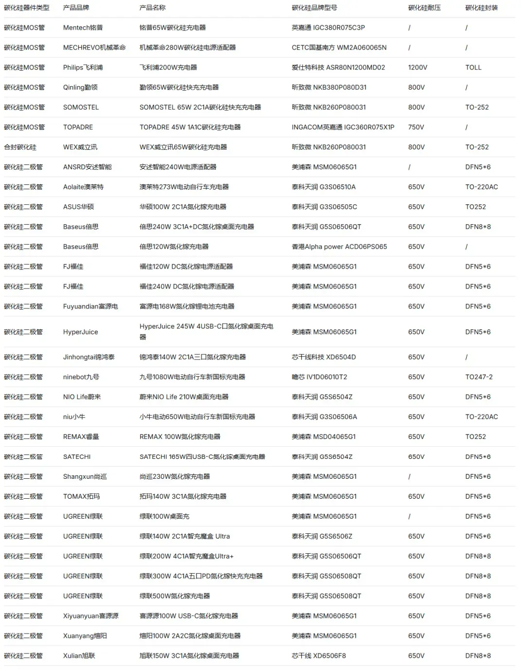

Below is a curated look at industry-leading chargers featuring SiC technology (arranged alphabetically).

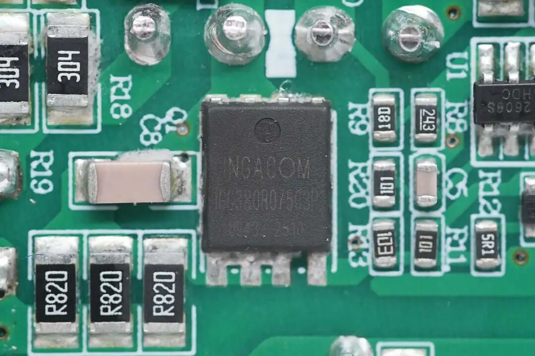

Mentech
Mentech 65W SiC Fast Charger
1080W Peak Power | An In-Depth Analysis of Silicon Carbide Chargers from 26 Brands-Chargerlab
Mentech’s 65W dual-USB-C fast charger highlights the performance advantages of SiC. The device offers versatile output modes, including 65W single-port charging and a dynamic 45W+20W split for multi-device workflows.
Distinct from the GaN-heavy competition, Mentech utilizes the INGACOM IGC380R075C3P SiC MOSFET. This choice enables a highly efficient design that fits into a compact 60.5 × 31 × 34 mm housing, delivering a power density of 1.02 W/cm³—proving that SiC is a potent competitor in the drive for miniaturized high-performance charging.

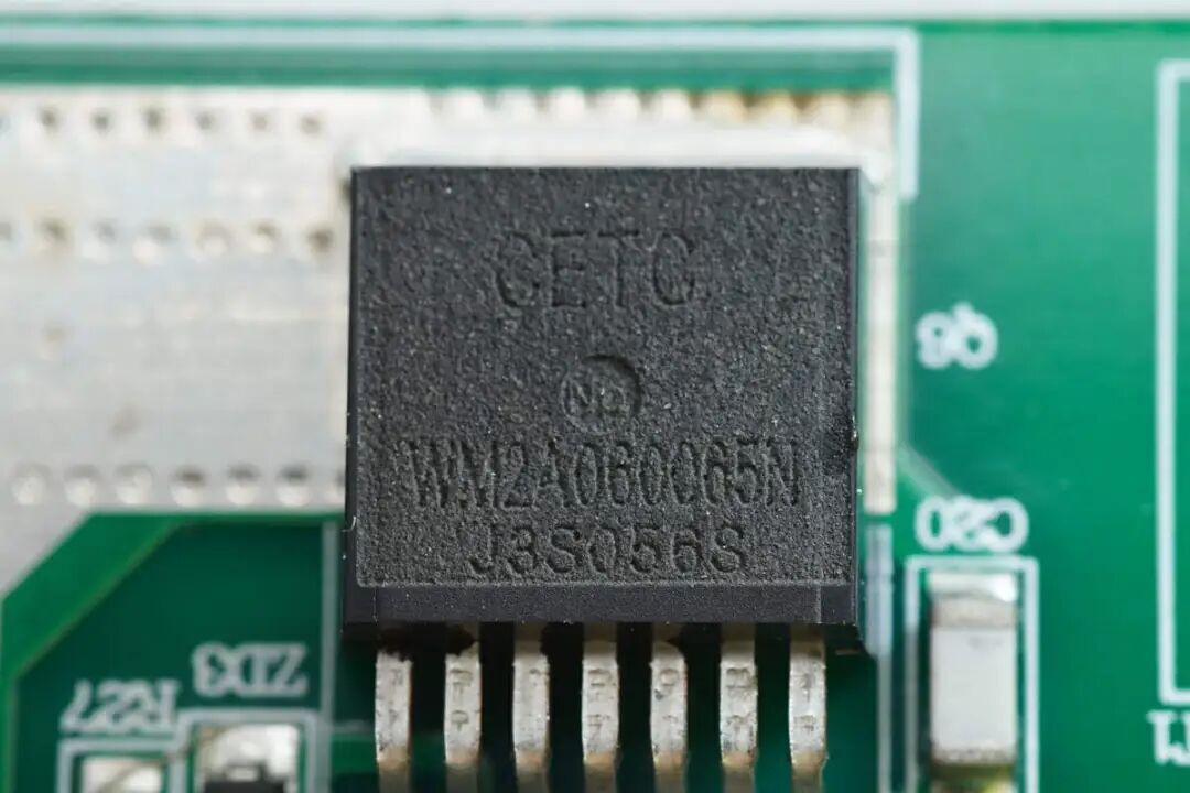

MECHREVO
MECHREVO 280W SiC Power Adapter

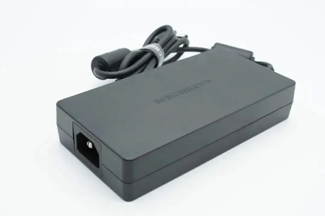

The MECHREVO 280W power adapter features a classic modular design with a detachable AC power cord, allowing for international compatibility. The DC output cable is equipped with a right-angle connector for space-constrained environments and features dual ferrite beads for enhanced EMI suppression.
The PFC boost switch is powered by a Silicon Carbide (SiC) MOSFET from CETC Guoji Nanfang, model WM2A060065N.

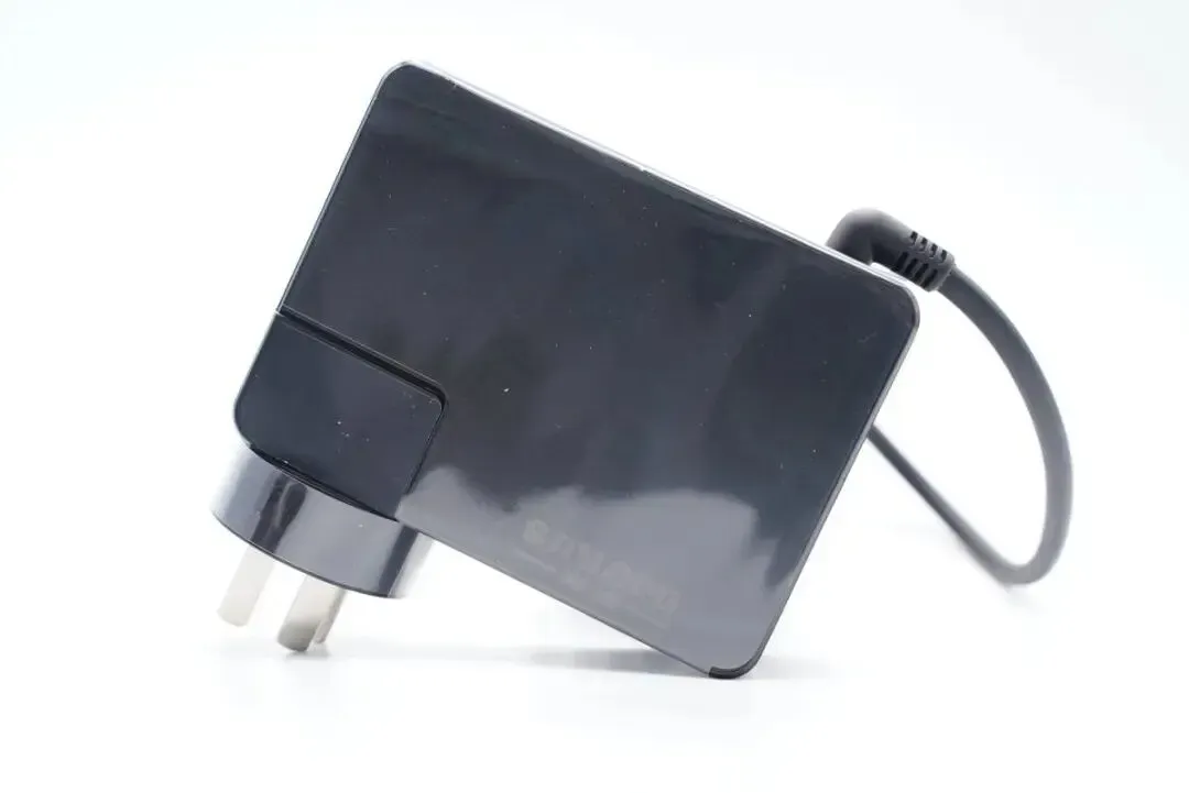

Philips
Philips 200W Charger
The Philips 200W fast charger features a black enclosure with fixed EU-standard prongs. It supports a wide-range input of 100–240Vac. The output configuration includes 3 USB-C ports and 1 USB-A port. The USB-C1 port delivers up to 140W, while USB-C2 provides up to 100W. When both C1 and C2 are in use, the charger provides a dynamic 100W+100W power distribution, enabling simultaneous fast charging for two laptops.

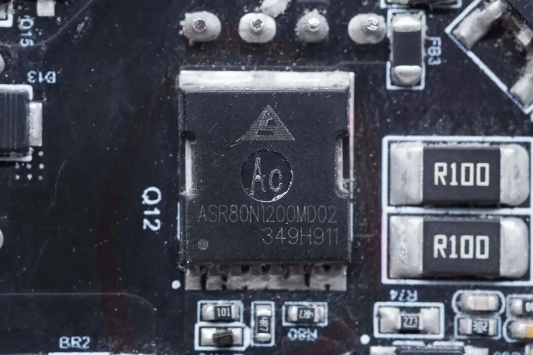

The PFC boost stage utilizes an ASR80N1200MD02 Silicon Carbide (SiC) MOSFET from AST. This device is rated for 1200V with an 80mΩ on-resistance and is housed in a TOLL package.

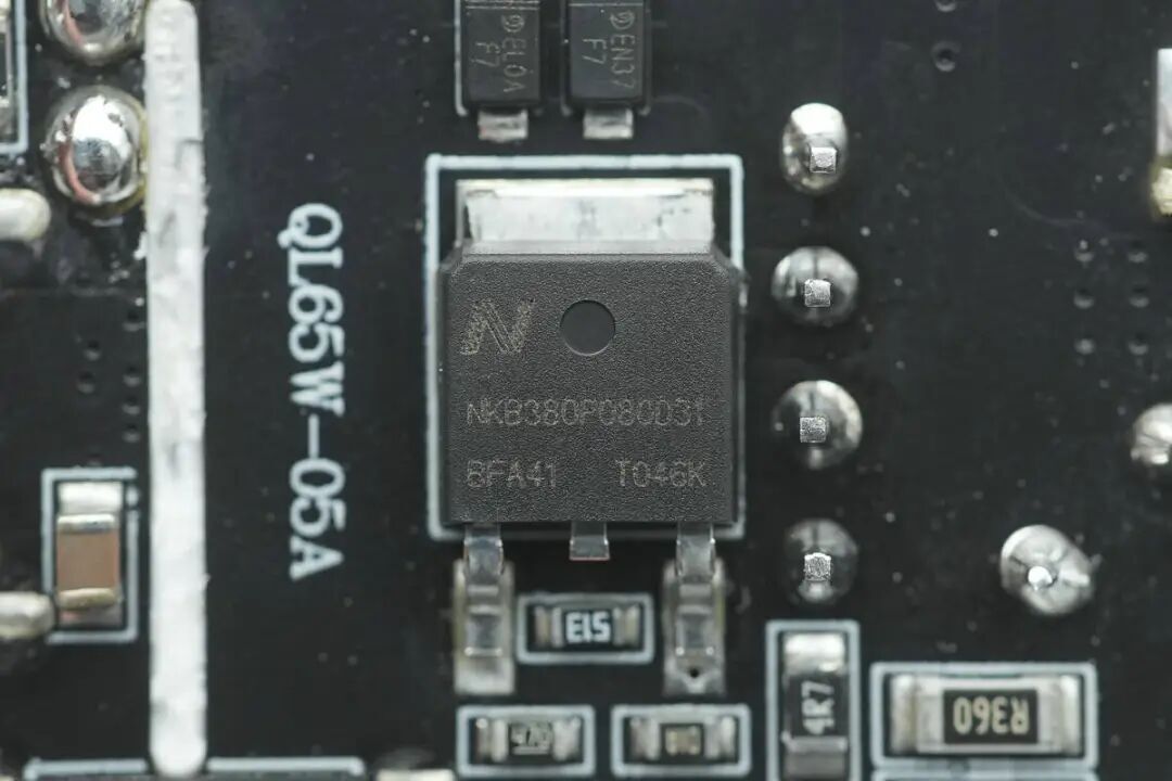

Qinling
Qinling 65W SiC Fast Charger
Qinling has introduced a 65W fast charger that balances power density with high-level protocol compatibility. By integrating NEXIC’s advanced SiC technology, the design remains compact and highly portable, further enhanced by the inclusion of foldable plugs. The charger is a versatile multi-protocol powerhouse, supporting PD 3.2, PPS, UFCS, and legacy standards like QC and SCP.
At its core lies the NEXIC NKB380P080D31 SiC MOSFET, a high-reliability 800V component that ensures efficient power conversion in a small, traveler-friendly package.

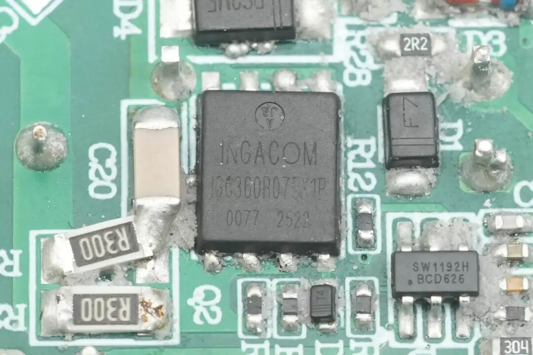

Driven by INGACOM’s IGC360R075X1P SiC MOSFET—a 750V high-performance component—this charger delivers efficient energy conversion in a sleek, mobile-friendly package.

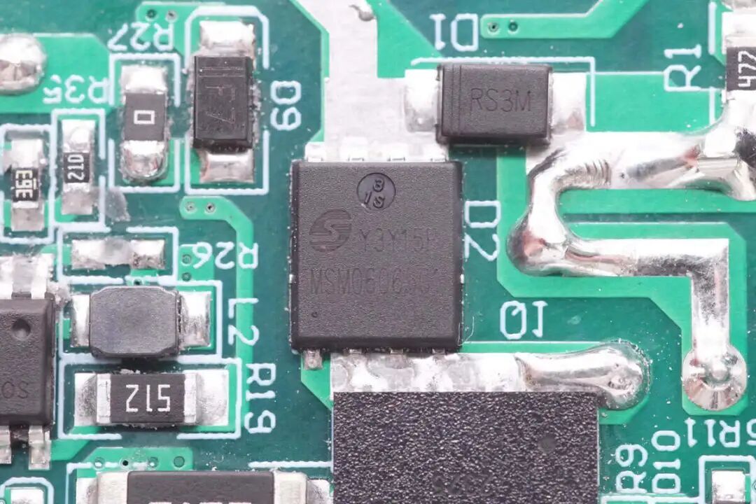

WEX
WEX 65W SiC Fast Charger

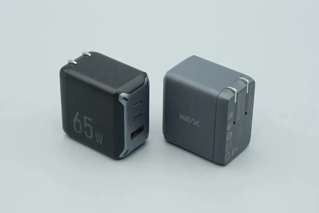

WEX has released a 65W fast charger that combines professional styling with high performance. With a foldable, travel-ready design and a versatile 2C1A configuration, it is an ideal solution for professionals on the move. The charger supports a wide array of protocols, such as PD, PPS, and SCP, ensuring compatibility across laptops and mobile devices.
A key design highlight is the integration of NEXIC’s NKB260P080031 SiC MOSFET. By utilizing this 800V, 260mΩ device in a TO-252 package, WEX achieves efficient power conversion in a highly compact footprint.

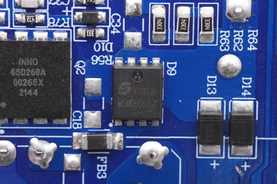

SiC Diodes
In PFC circuits for chargers exceeding 100W, Silicon Carbide (SiC) diodes are becoming the standard due to their superior high-frequency characteristics. Below is a summary of power adapter teardowns utilizing SiC diodes (sorted alphabetically by brand).

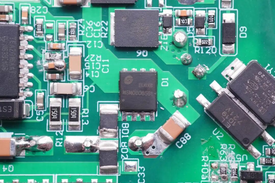

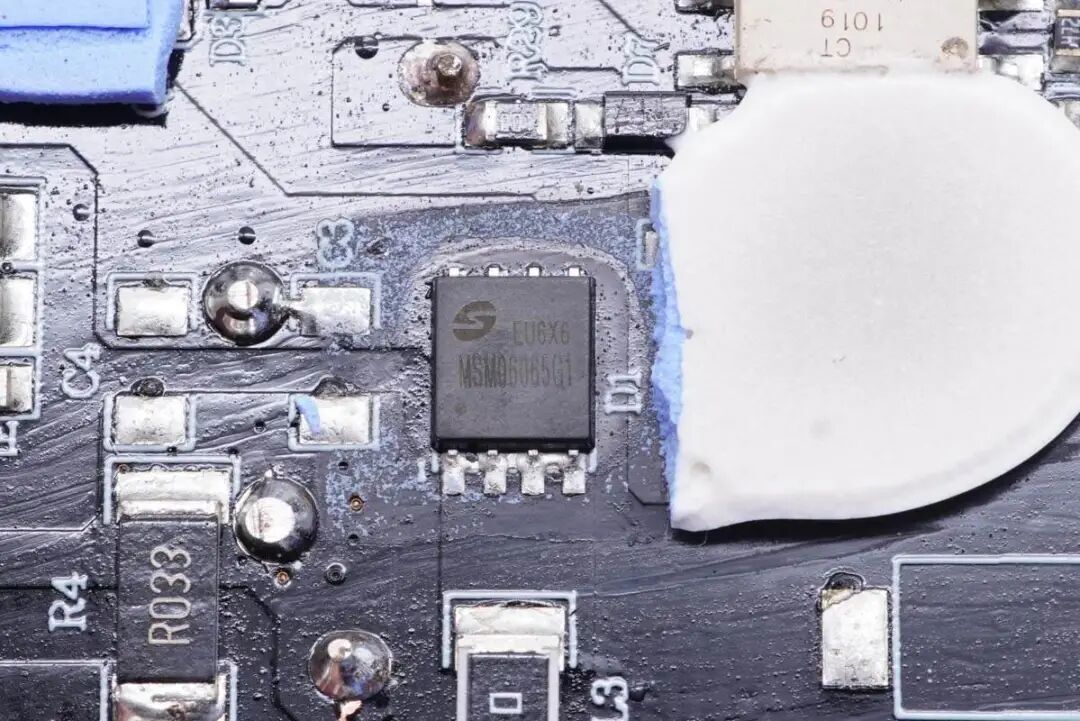

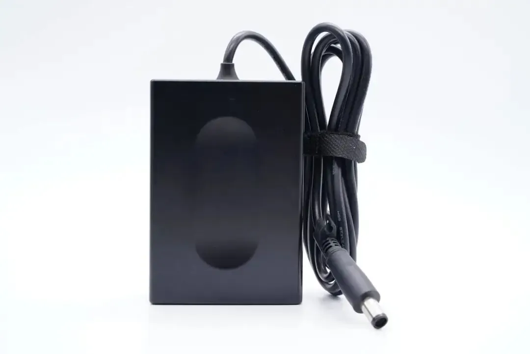

ANSRD
ANSRD 240W Power Adapter
ANSRD has pushed the boundaries of portable power with its 240W adapter, utilizing advanced GaN and SiC technologies to pack immense power into a 103 × 72 × 29 mm form factor—a size profile typically reserved for 100W devices. Designed for maximum portability, the adapter features integrated foldable prongs and a long 1.7m output cable, streamlining the charging experience for professionals.

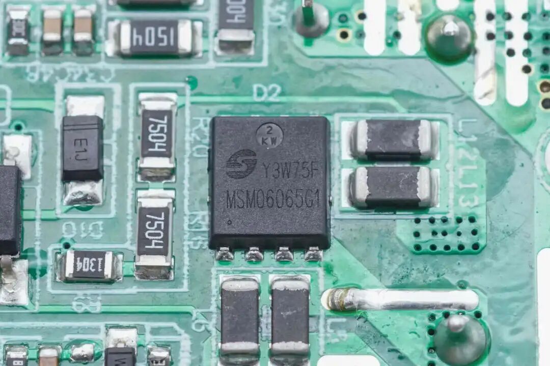

Inside, the adapter features the MSemitek MSM06065G1 SiC diode for its PFC stage. This DFN5*6 packaged component is specifically designed to meet the space-saving requirements of high-performance, high-power-density adapters.

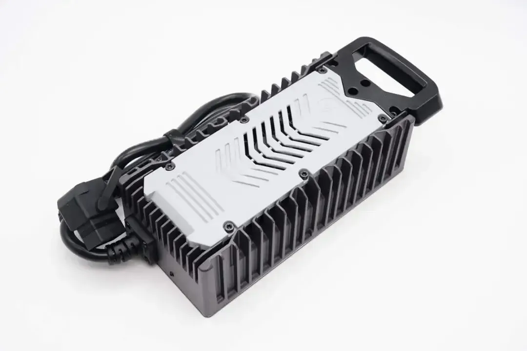

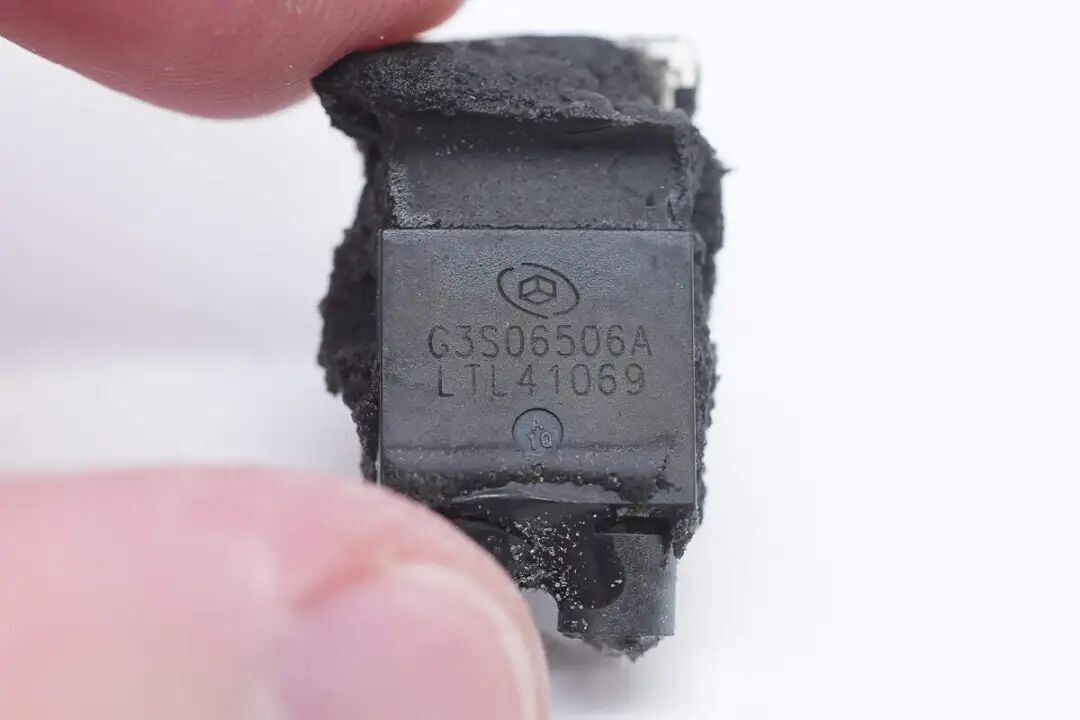

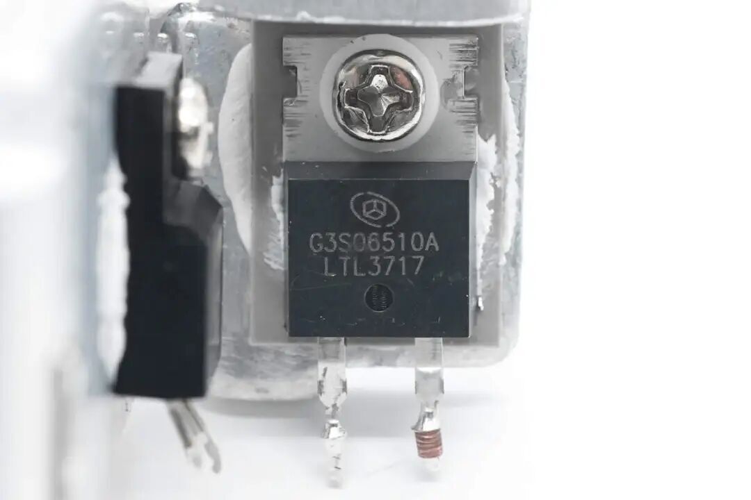

Aolaite
Aolaite 273W E-Bike Charger
Aolaite has introduced a high-performance 273W charger specifically designed for 13S lithium batteries. By adopting an advanced PFC+LLC+SR architecture, Aolaite has successfully optimized energy conversion, enabling a fanless design that is significantly more compact than standard e-bike chargers. The charger is equipped with a durable 1.5-meter output cable and a standard AC power cord, offering a user-friendly and portable solution.
At the heart of its power factor correction stage is the G3S06510A SiC Schottky MOSFET from GPT, which provides the thermal efficiency and reliability required for this high-density design.

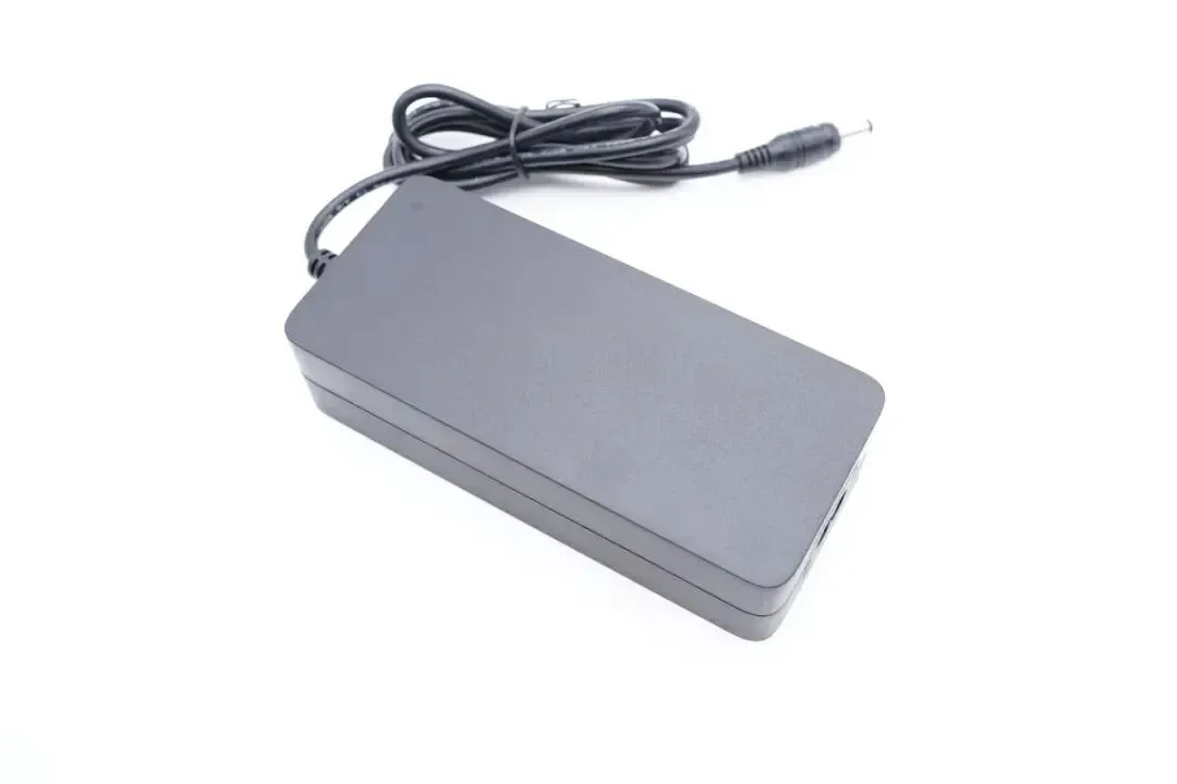

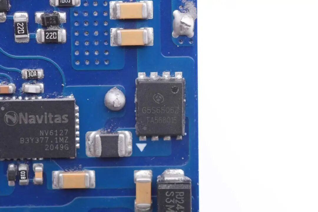

ASUS
ASUS 100W 2C1A GaN Charger
ASUS has launched a versatile 100W GaN charger that blends sleek aesthetics with high-utility functionality. Featuring a compact, foldable white design, it is perfectly suited for travelers and professionals. The 2C1A interface supports intelligent power distribution, offering up to 100W for single-device fast charging or a convenient 65W+30W split for multi-device setups.

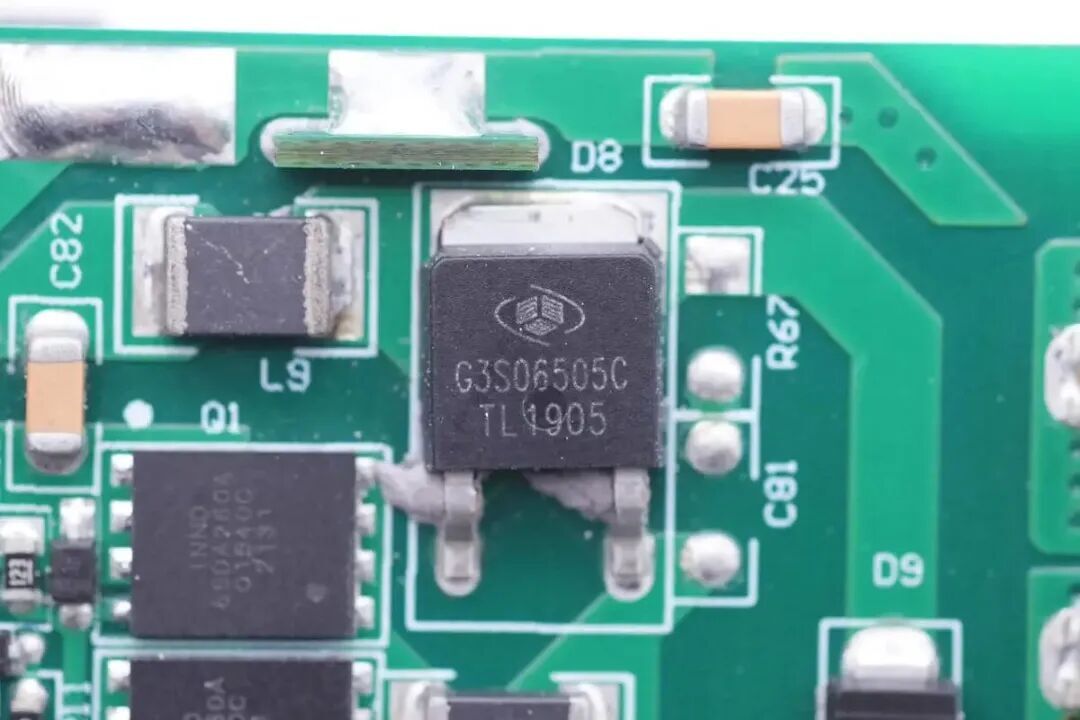

Under the hood, the charger leverages GPT G3S06505C SiC diode, ensuring high efficiency and thermal stability for its power factor correction circuitry.

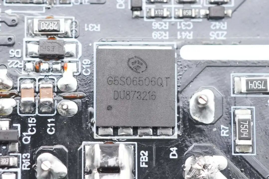

Baseus
Baseus 240W 3C1A+DC GaN Desktop Charger

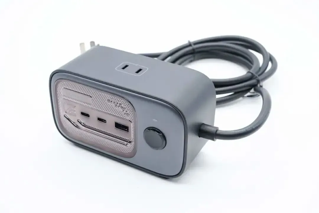

Baseus has introduced a powerful 240W desktop charging solution designed for high-performance workstations. By combining a 3C1A port layout with a specialized DC output and various adapters, Baseus ensures compatibility with diverse laptop and mobile device ecosystems. A standout feature is the onboard display, which provides users with real-time feedback on power allocation, further enhanced by Bluetooth app integration for advanced monitoring.

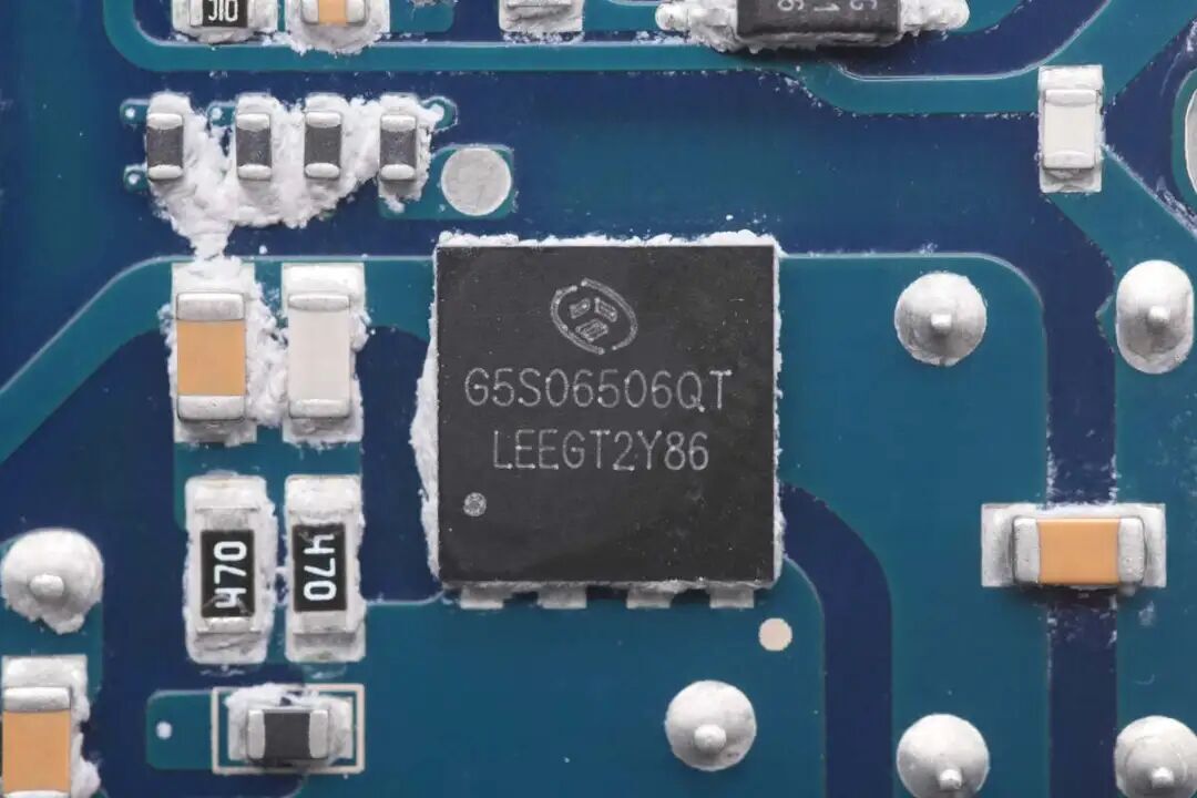

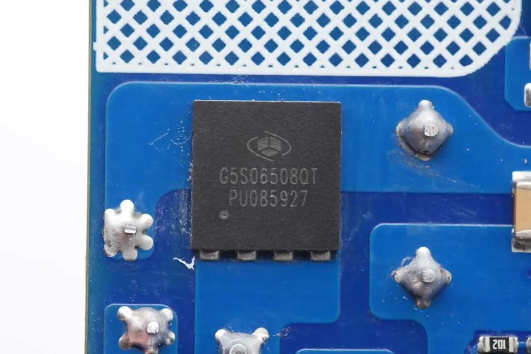

Internally, the charger utilizes the GPT G5S06506QT SiC diode, a robust 650V component that ensures high efficiency and thermal reliability under high-load conditions, all within a space-efficient DFN8*8 package.

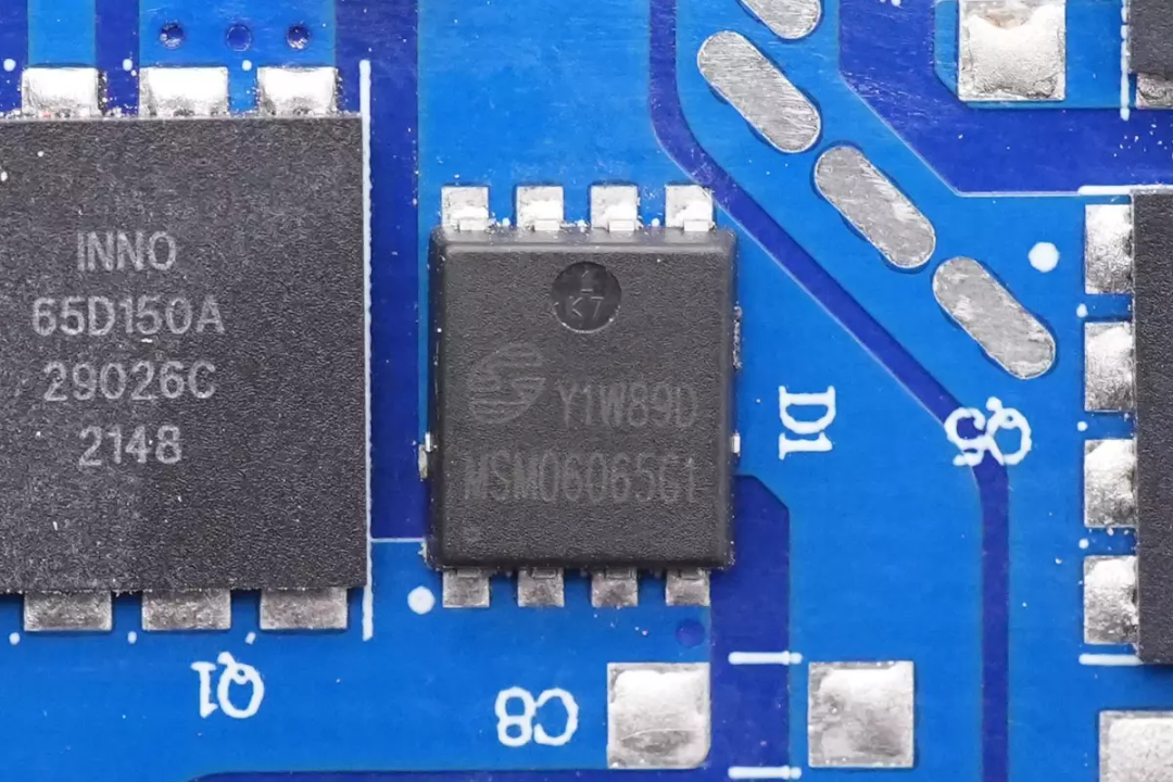

FJ

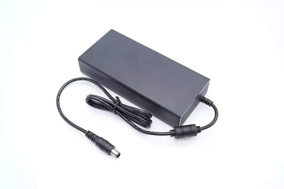

FJ 120W DC GaN Power Adapter

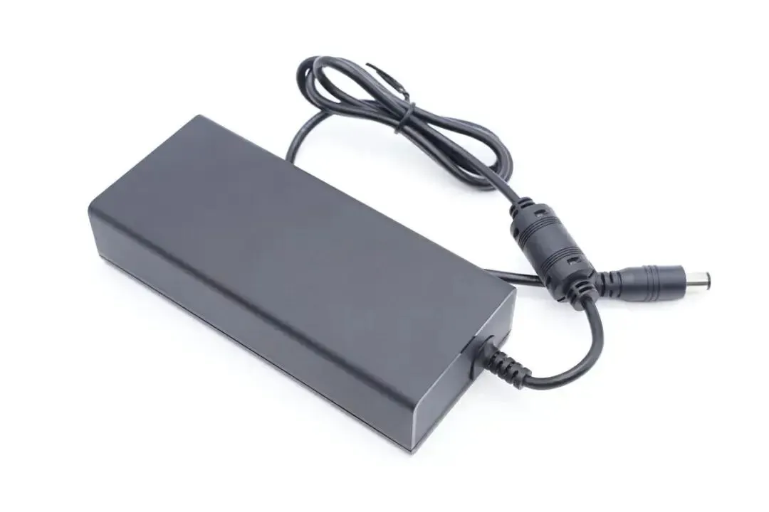

FJ’s 120W GaN power adapter is designed for professional setups, featuring an integrated output cable that ensures quick, direct connectivity. By utilizing a standard C13 input port, users can easily select the optimal power cord length for their desktop, eliminating unnecessary clutter. Delivering a robust 24V/5A output, the adapter also includes a convenient power indicator light for at-a-glance status monitoring.

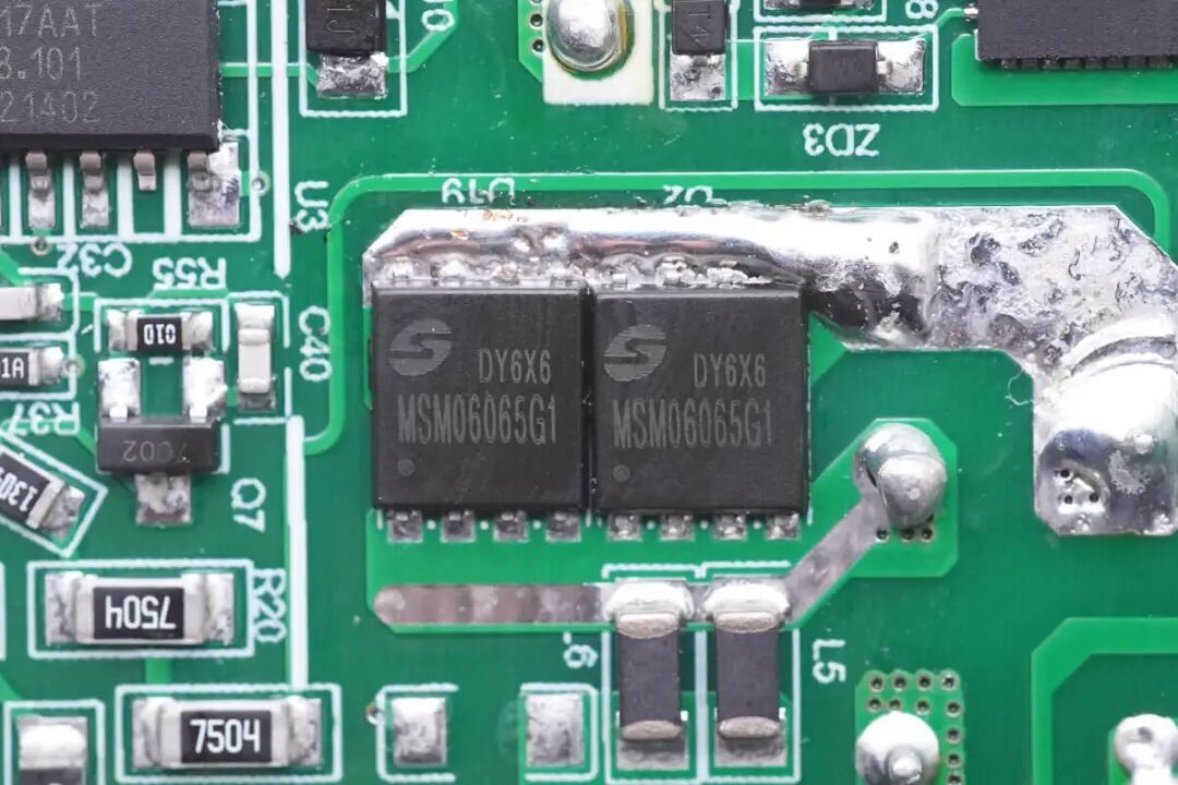

Internally, the FJ adapter leverages high-efficiency MSemitek MSM06065G1 SiC diodes in a compact DFN5*6 package, ensuring top-tier thermal performance and power density for high-demand electronic devices.

Internally, FJ employs the MSemitek MSM06065G1 SiC diode—a state-of-the-art component that ensures thermal stability and efficiency, reinforcing the reliability of its 240W GaN architecture.

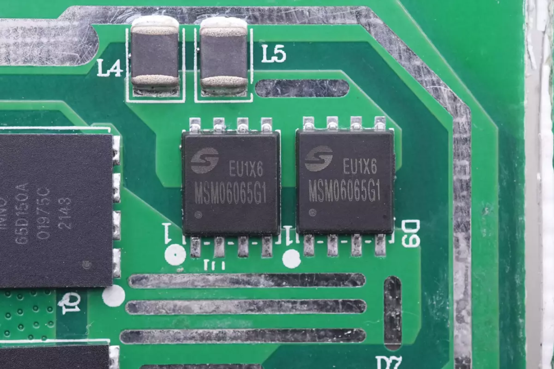

A key technical highlight is the implementation of a dual-parallel MSemitek MSM06065G1 SiC diode configuration in the PFC stage. These ultra-slim DFN5*6 diodes ensure optimal thermal performance and power density, positioning this charger as a top-tier solution for modern high-power-density applications.

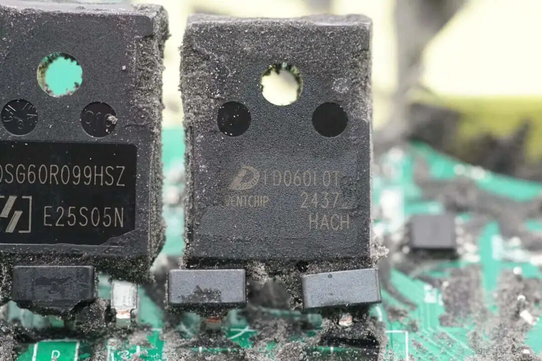

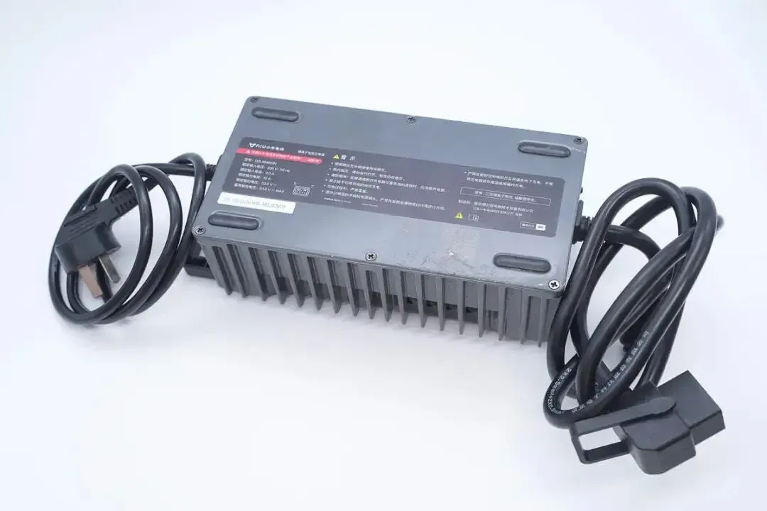

Ninebot

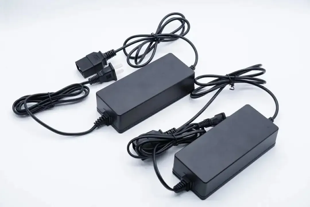

Ninebot 1080W E-Bike Charger
Ninebot has redefined e-bike charging with its 1080W intelligent charger. Designed for versatility, this high-power unit features advanced communication capabilities, allowing it to interface directly with various battery chemistries, including Lithium Manganate, LiFePO4, and Ternary Lithium batteries. Its smart handshake mechanism ensures that power is only delivered once the battery is authenticated, adding a critical layer of safety.
At its core, the charger utilizes the robust 650V/10A IV1D06010T2 SiC diode from IVCT, which provides the thermal efficiency necessary for handling 1080W of power while maintaining reliable operation for daily mobility needs.

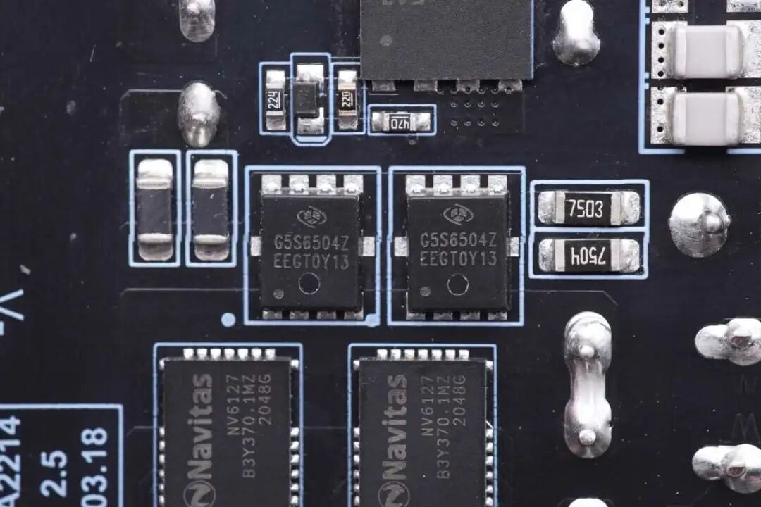

NIO Life

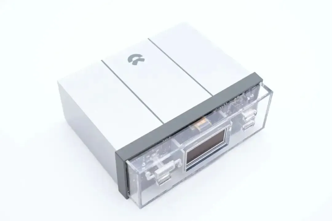

NIO Life 210W Desktop Charger
Combining NIO’s design language with TEGIC’s charging expertise, the 210W desktop charger is a standout in both aesthetics and functionality. With a high-tech transparent front panel and an integrated OLED screen, users can monitor real-time charging metrics across all four ports (3 USB-C and 1USB-A). This level of granular visibility, paired with a massive 210W output capacity, positions it as a premium solution for power-hungry multi-device workstations.
Internally, the charger features a dual-parallel configuration of GPT’s G5S6504Z SiC diodes, ensuring stable and efficient power conversion at high densities.

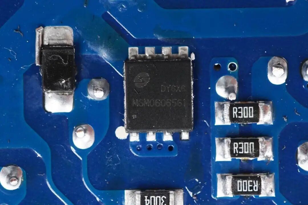

At the core of its compact engineering is the MSemitek MSM06065G1 SiC diode. Utilizing this ultra-slim DFN5*6 component, Shangxun optimizes the PFC stage for maximum efficiency, demonstrating a clear commitment to leveraging advanced semiconductor technologies to deliver superior performance in a reduced physical footprint.

At its core, TOMAX has selected MSemitek MSM06065G1 SiC diode, a premium component that enables stable, high-efficiency power conversion, perfectly complementing the charger's sophisticated GaN-based architecture.

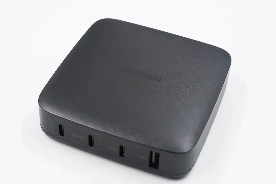

UGREEN
UGREEN 100W Desktop Charger
UGREEN has engineered a sophisticated power solution that combines premium design with high-utility functionality. Featuring a distinct laser-textured finish and a portable, flat form factor, this 100W desktop charger is a stylish addition to any workspace. With its included 1.6m extension cord, UGREEN eliminates the inconvenience of distance, providing a versatile charging station for up to four devices.
At its heart, the charger uses MSemitek MSM06065G1 SiC diode. By integrating this high-performance component in a compact DFN5*6 package, UGREEN achieves reliable, high-density power conversion, ensuring efficient performance for all your connected tech.

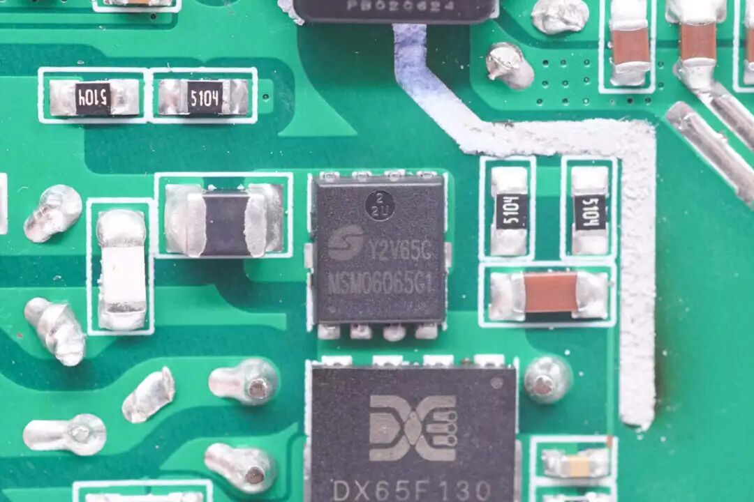

Xiyuanyuan
Xiyuanyuan 100W USB-C GaN Charger
Xiyuanyuan has delivered a highly practical power solution with its 100W GaN charger. By integrating a 1.5-meter cable and foldable pins, Xiyuanyuan has prioritized user convenience for travel and home office setups. The charger’s ability to handle high-wattage PD and PPS standards makes it a versatile tool for any modern device ecosystem, from high-performance laptops to the latest Android flagships.
Internally, Xiyuanyuan utilizes the high-efficiency MSemitek MSM06065G1 SiC diode, demonstrating a commitment to advanced power semiconductor technology that keeps the device compact, cool, and reliable.

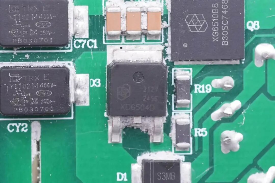

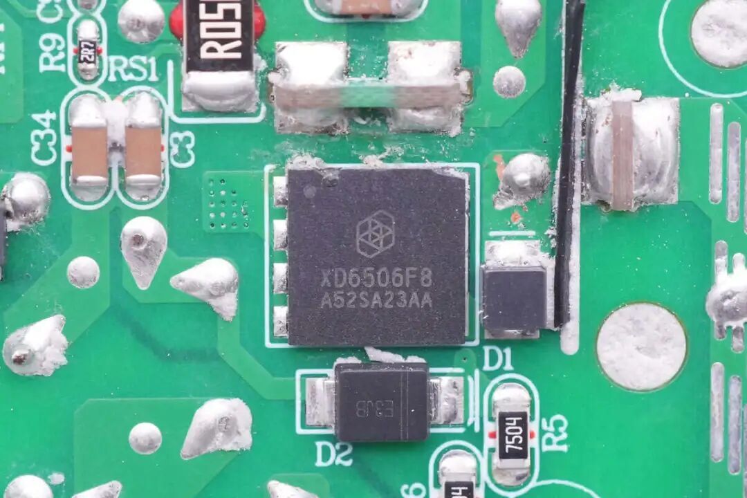

Xulian
Xulian 150W 3C1A GaN Desktop Charger
Xulian has introduced a professional-grade 150W desktop charging solution designed for convenience and versatility. With its modular power cord approach and high-output 3C1A port configuration, the charger provides a streamlined, clutter-free power experience. Its intelligent distribution logic ensures that multiple laptops and mobile devices receive optimized power without compromise.
By integrating X-IPM XD6506F8 SiC diode—a high-current, thermally efficient component in a DFN8*8 package—Xulian delivers a compact yet powerful charging station that meets the rigorous demands of today’s power-intensive multi-device users.
