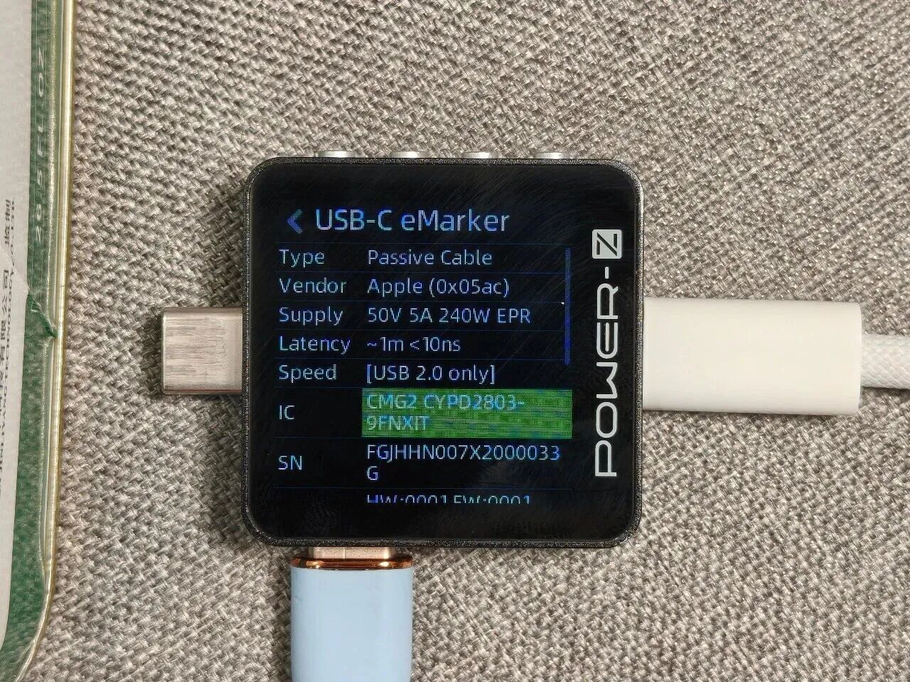

ChargerLAB POWER-Z KM003C tester has achieved another compatibility milestone. The latest firmware now fully supports the Infineon CYPD2803A1-09FNXI chip. Cables equipped with this chip can be quickly identified through the device's E-Marker reading function, allowing related chip information to be displayed clearly and intuitively.

After upgrading the POWER-Z KM003C to the latest firmware, users can immediately test and read information from the chip.

With the recently released V2.0.0 firmware, the POWER-Z KM003C introduces industry-first cable IC identification capabilities on top of its existing E-Marker reading functions. Without the need for destructive operations such as cutting or stripping cables, users can accurately identify the embedded cable IC solution with a single click, clearly view key configuration details, and efficiently perform cable quality inspection and solution verification.

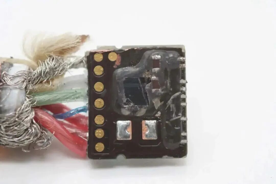

ChargerLAB has also previously performed a teardown of a cable utilizing this chip.
Also Read: Teardown of Apple 240W USB-C Charge Cable (A2794)
