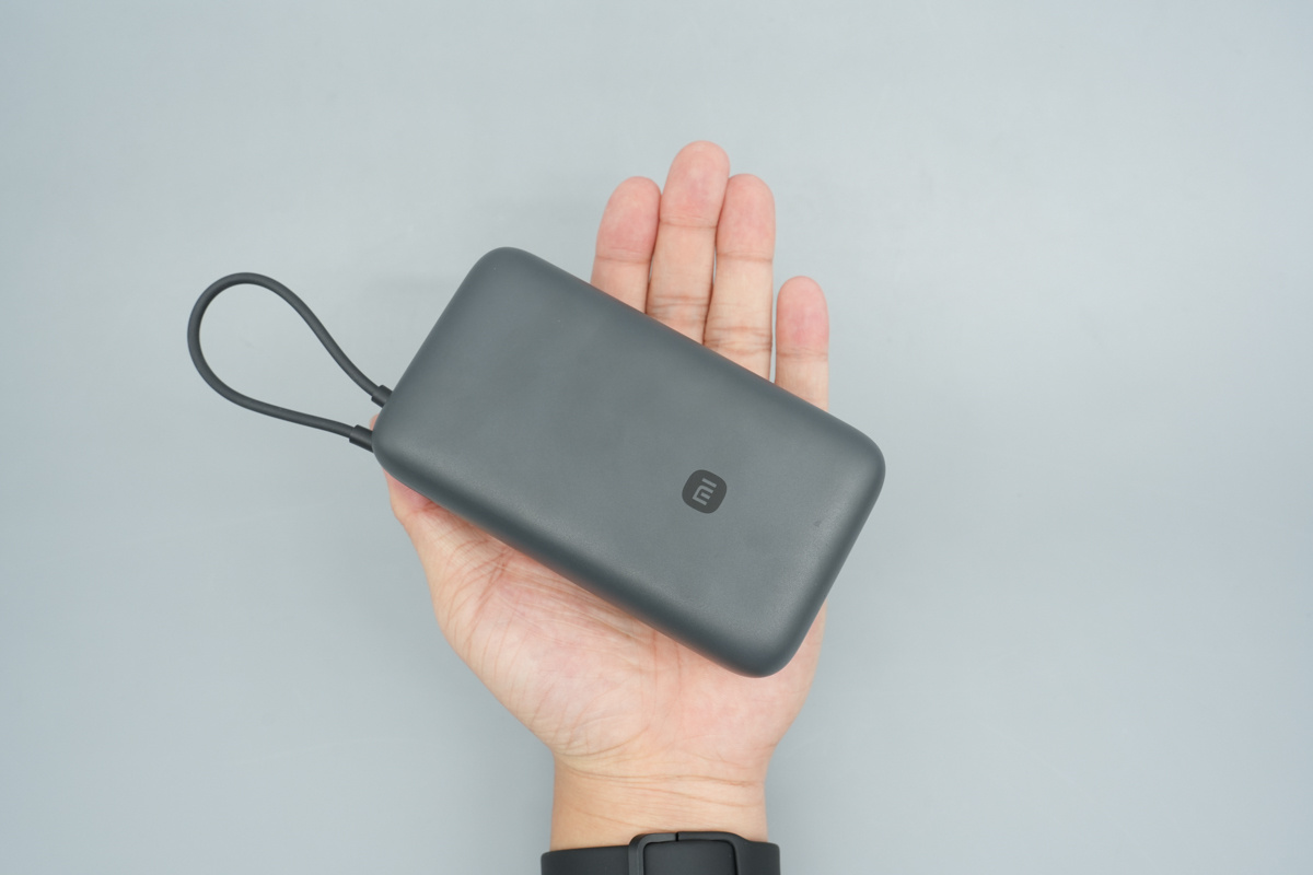

Product Exterior Design

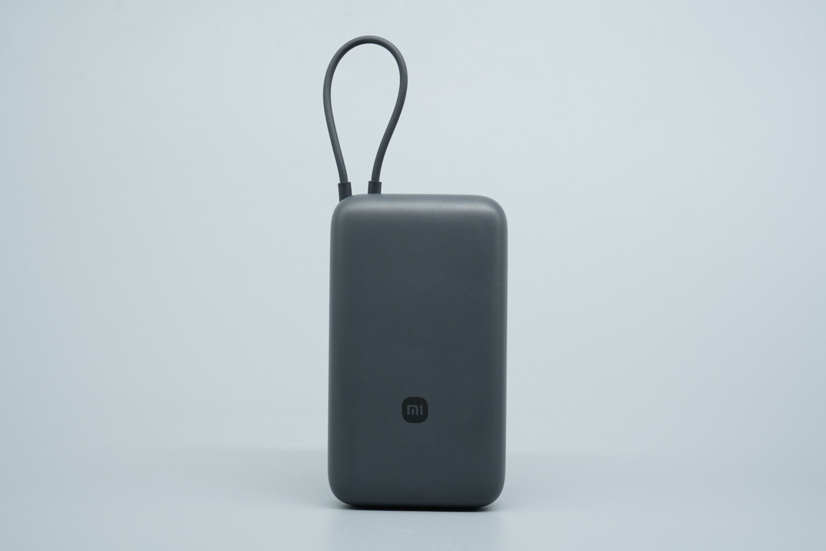

Teardown of the Xiaomi Built-in Cable Power Bank 20000mAh 22.5W 2026-Chargerlab

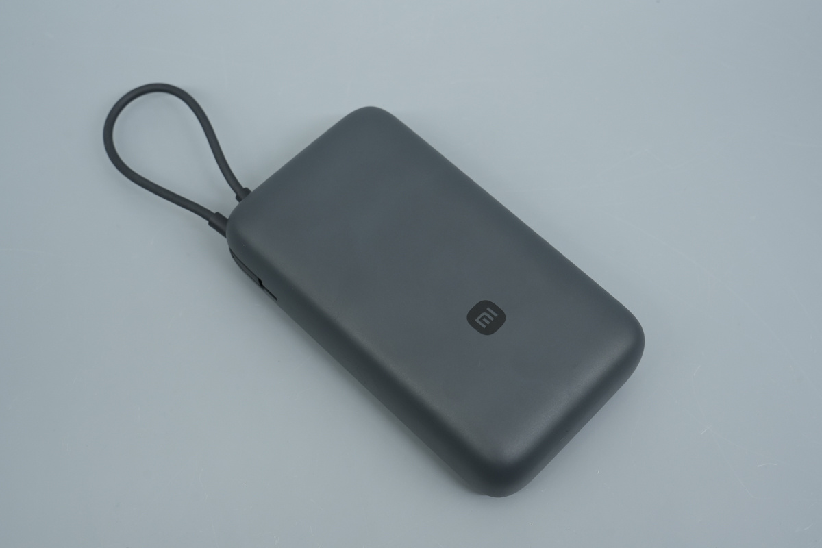

Encased in a dark gray, flame-retardant PC+ABS shell with a refined matte finish, the power bank delivers a smooth, fingerprint-resistant grip and a sophisticated, professional aesthetic.
The center of the front panel adopts a glossy finish, printed with the brand logo for high recognizability.

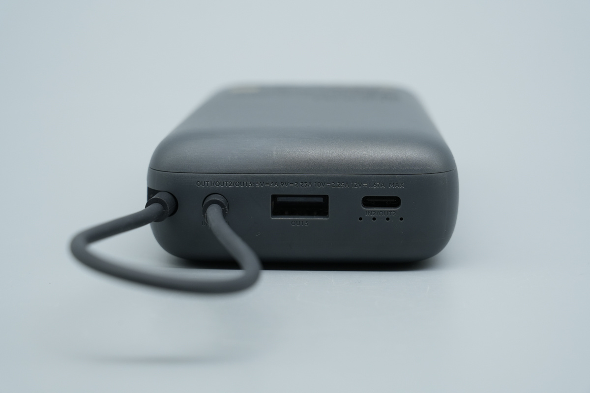

The top is equipped with a versatile array of ports and an integrated cable, including a permanently attached USB-C built-in cable, a USB-A output port (OUT3), and a USB-C bidirectional port (IN2/OUT2).
Parameters and markings are clearly printed above the ports:OUT1, OUT2, and OUT3 all support outputs of 5V 3A, 9V 2.23A, 10V 2.25A, and 12V 1.67A, delivering up to 22.5W MAX.

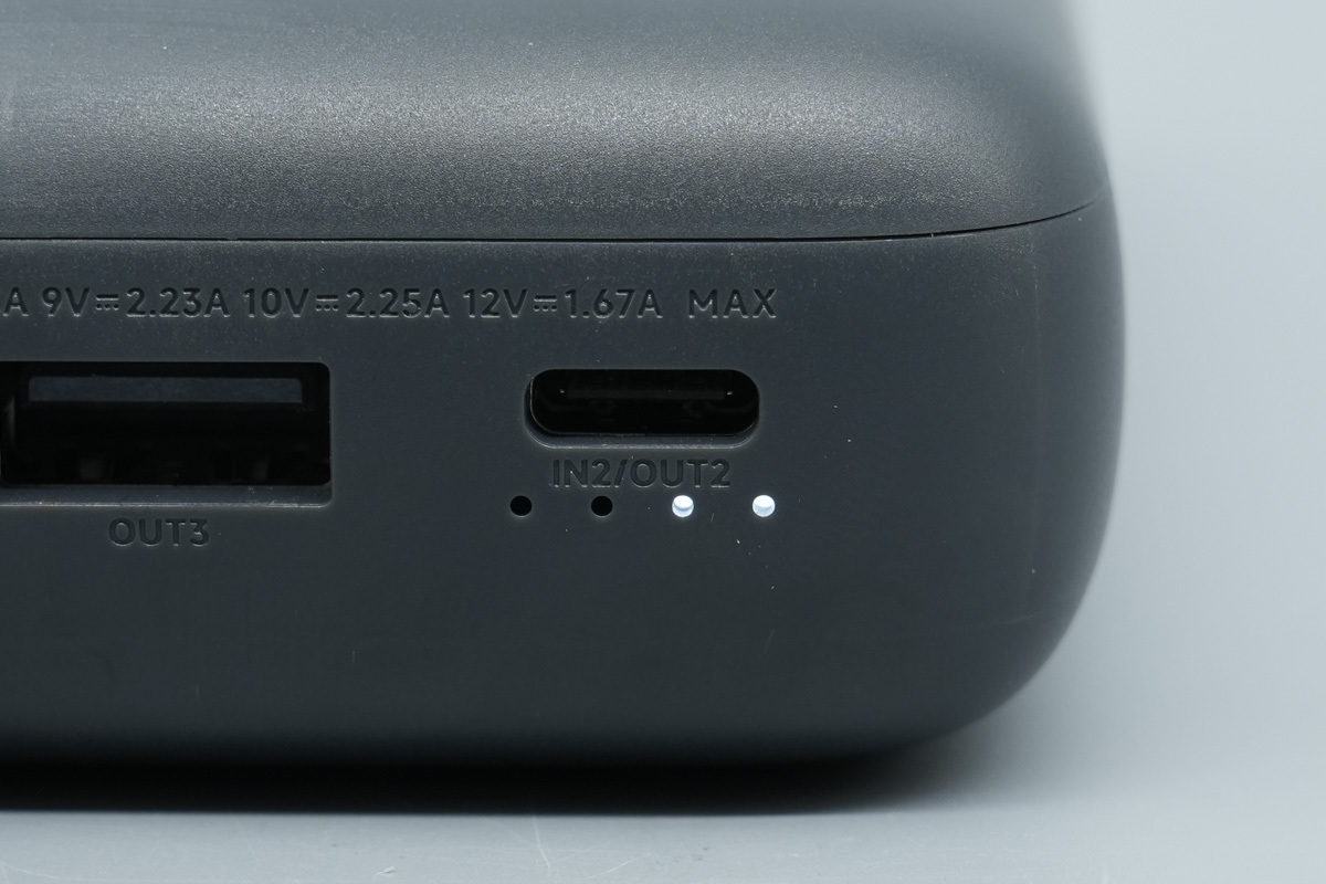

Four white LED indicators sits beneath the Type-C interface, providing clear real-time battery level visibility upon activation.

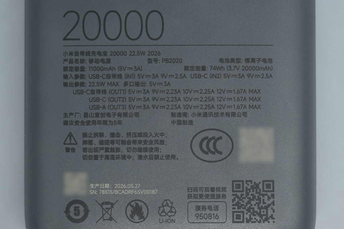

The nameplate parameters on the back:
Product Model: PB2020
Battery Type: Lithium-ion battery
Rated Capacity: 11000mAh (5V 3A)
Rated Energy: 74Wh (3.7V 20000mAh)
Input:
USB-C Built-in Cable (IN1): 5V 3A, 9V 2.5A
USB-C Port (IN2): 5V 3A, 9V 2.5A
Output:
Max Single-Port Output Power: 22.5W MAX
Multiple Ports Output Simultaneously: 5V 3A
Single-Port Output Specs per Interface:
USB-C Built-in Cable (OUT1): 5V 3A, 9V 2.23A, 10V 2.25A, 12V 1.67A MAX
USB-C Port (OUT2): 5V 3A, 9V 2.23A, 10V 2.25A, 12V 1.67A MAX
USB-A Port (OUT3): 5V 3A, 9V 2.23A, 10V 2.25A, 12V 1.67A MAX
Manufacturer: Kunshan Huangchuang Electronic Co., Ltd.
Maker: Xiaomi Communications Co., Ltd.
Recommended Safe Use Period: 5 years
Origin: Made in China
Production Date: 2026.05.27
The product has passed 3C certification.

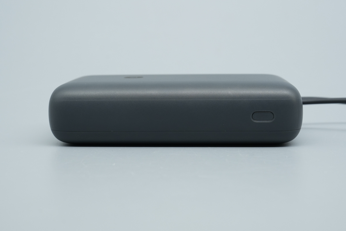

A racetrack-shaped power button sits on the side of the chassis, engineered with a slightly recessed, flush profile to guard against accidental activation in a bag or pocket.

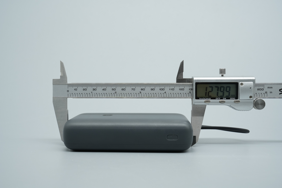

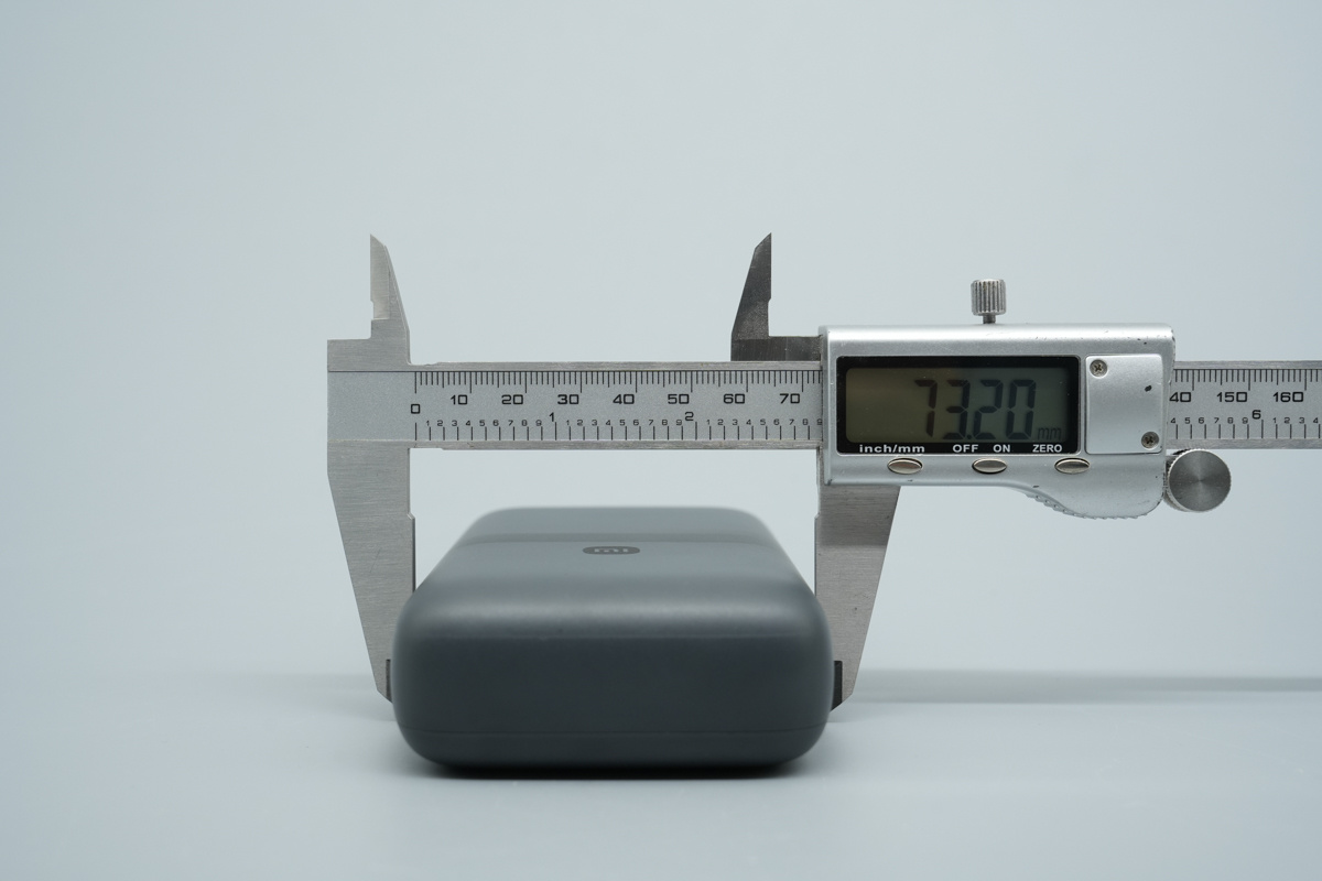

The length of the power bank is about 127.99mm (5.039 inches).
The width of the power bank is about 73.20mm (2.882 inches).

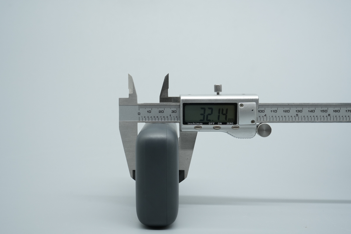

The thickness of the power bank is about 32.14mm (1.265 inches).

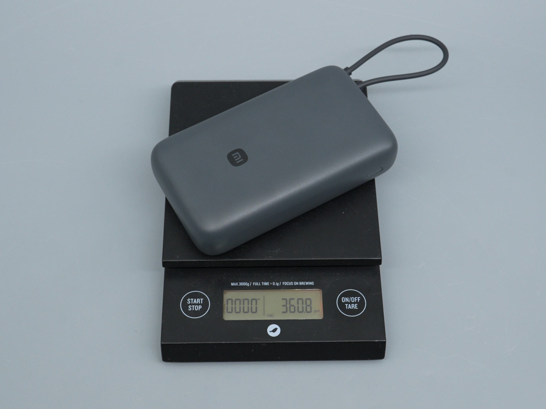

The weight is about 360.8g (12.73 oz).

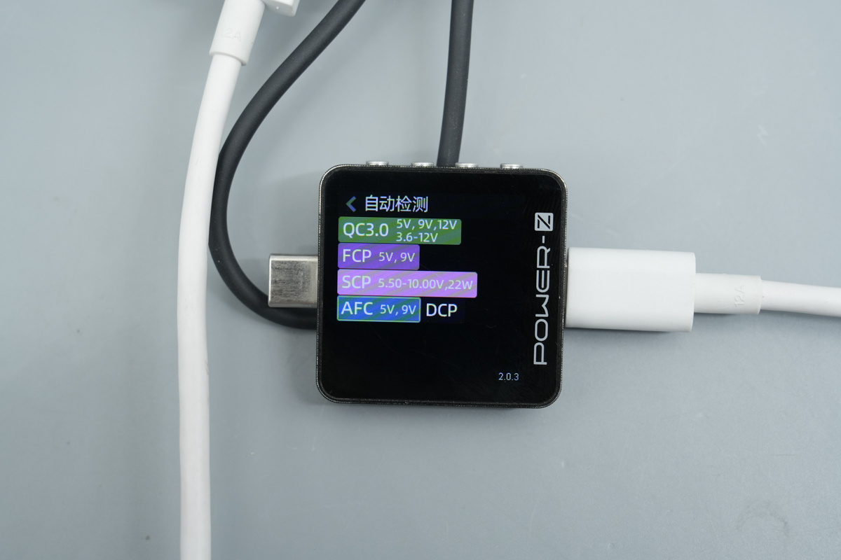

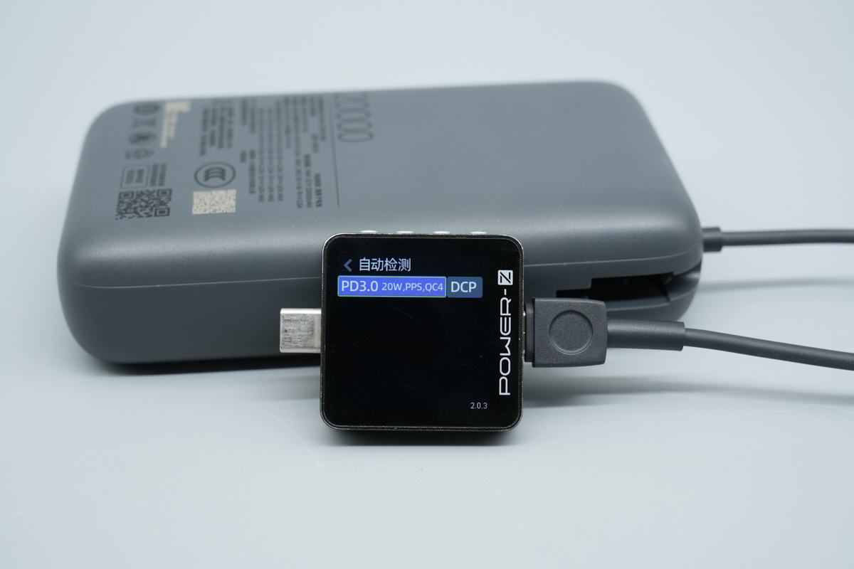

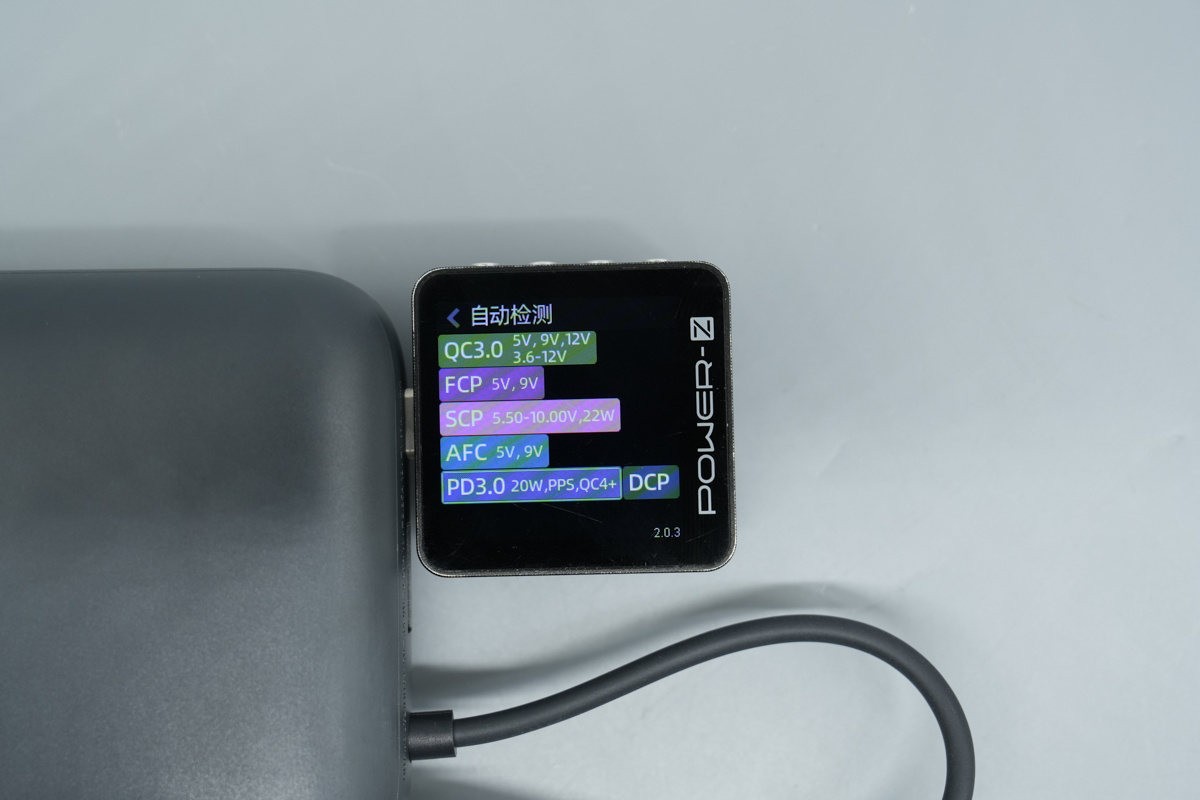

ChargerLAB POWER-Z KM003C shows that the integrated Type-A port supports QC3.0, FCP, SCP, AFC and DCP.

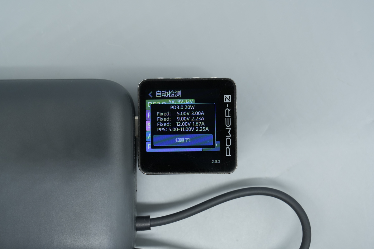

ChargerLAB POWER-Z KM003C shows that the integrated USB-C cable supports PD3.0/PPS, QC4 and DCP.
And it also supports three fixed PDOs of 5V3A, 9V2.23A and 12V1.67A, and features a PPS subset: 5-11V 2.25A.
ChargerLAB POWER-Z KM003C shows that the USB-C port supports QC3.0, FCP, SCP, AFC, PD3.0/PPS, QC4+ and DCP.

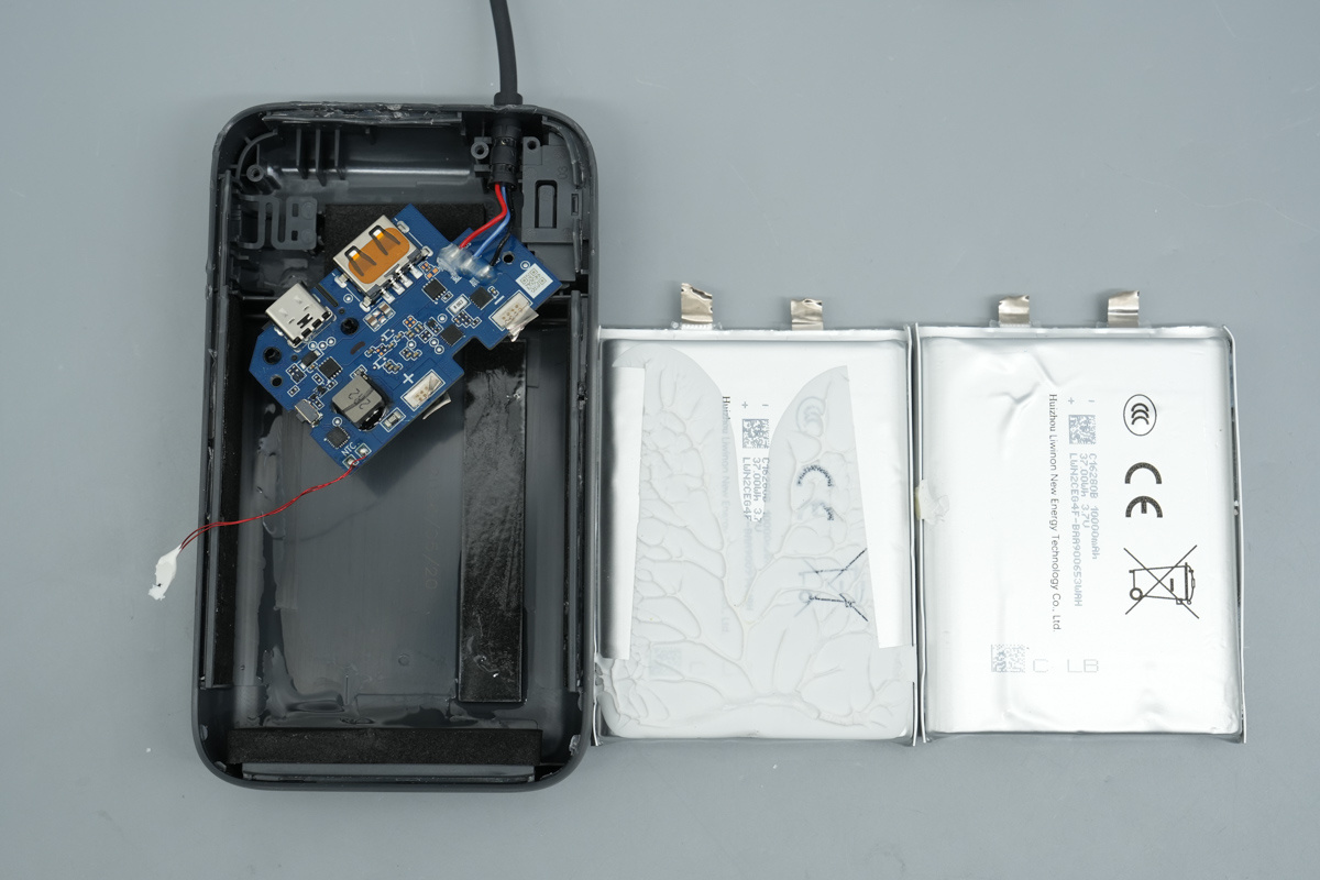

The back chassis panel is pried open along the side seam, revealing the interior of the casing is fixed with a combination of snaps and a large amount of potting compound, resulting in a very tight bond.
Once opened, the internal structure is clearly visible, featuring an upper PCBA and lower lithium polymer battery cells. The surface of the PCBA is covered with a thick layer of black foam, which provides cushioning and shock absorption.

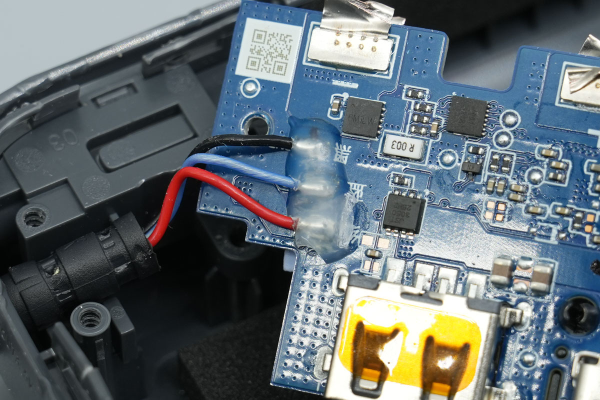

The connection between the cell tabs and the PCBA, where the spot-welding craftsmanship is neat and secure.
The red, blue, and black wires of the built-in USB-C cable are directly soldered onto the mainboard, with the solder joints fully filled and secured with transparent insulating adhesive for fixture and protection, preventing unsoldering caused by daily pulling.
Removing the PCBA from the casing reveals that a rectangular black foam pad is similarly affixed to the back of the mainboard, with a filtering solid cap exposed through a cutout in the mainboard.

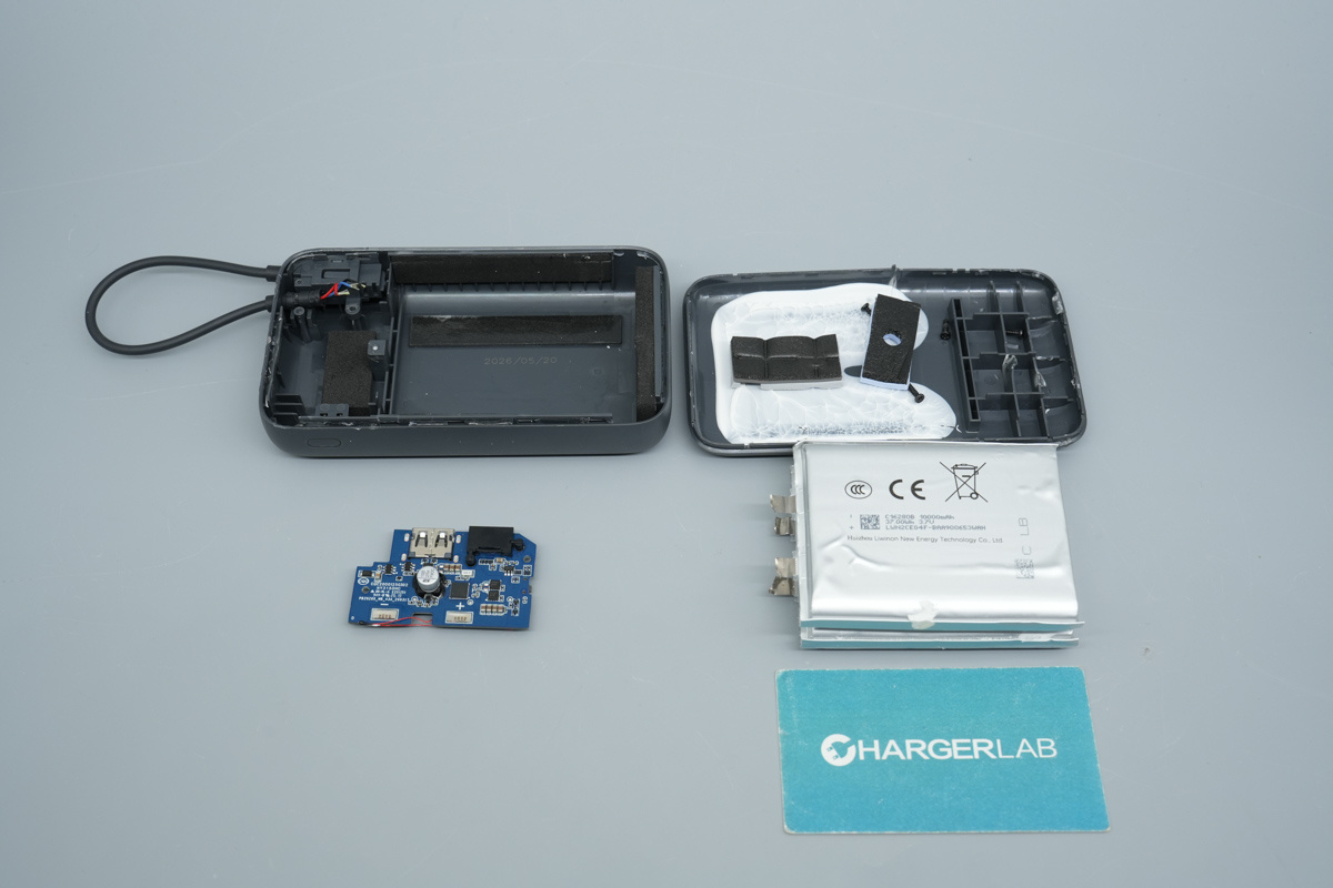

Battery Cell Analysis

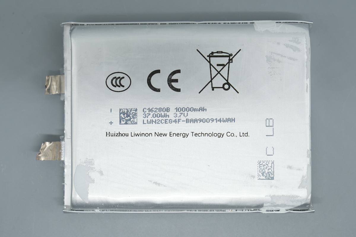

Separating the battery cells and the PCBA mainboard from the bottom shell of the body reveals that a large area of fixing adhesive is also applied inside the bottom shell, which stabilizes the structure and enhances the safety of the battery cells.
The battery cells are from Liwinon, model C16280B, with a single-piece capacity of 10000mAh, an energy rating of 37.00Wh, a nominal voltage of 3.7V, and the cells have successfully passed CCC certification.

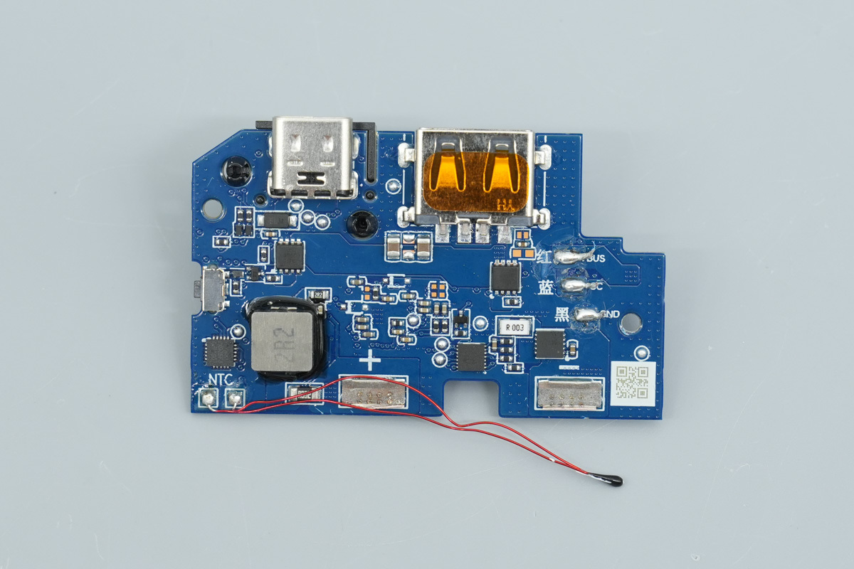

The front of the PCBA shows a compact and reasonable component arrangement, with a filtering capa in the center and the master control chip and various interfaces distributed on both sides.
The back of the PCBA features a large-sized alloy choke, MOSFETs, and an NTC thermistor used for detecting the temperature of the battery pack.

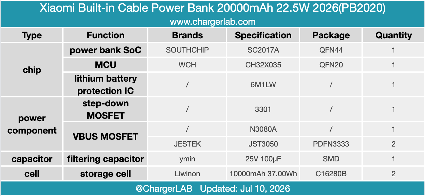

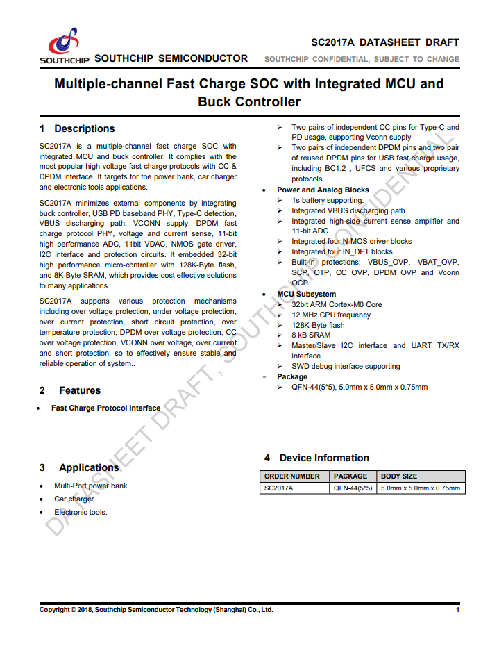

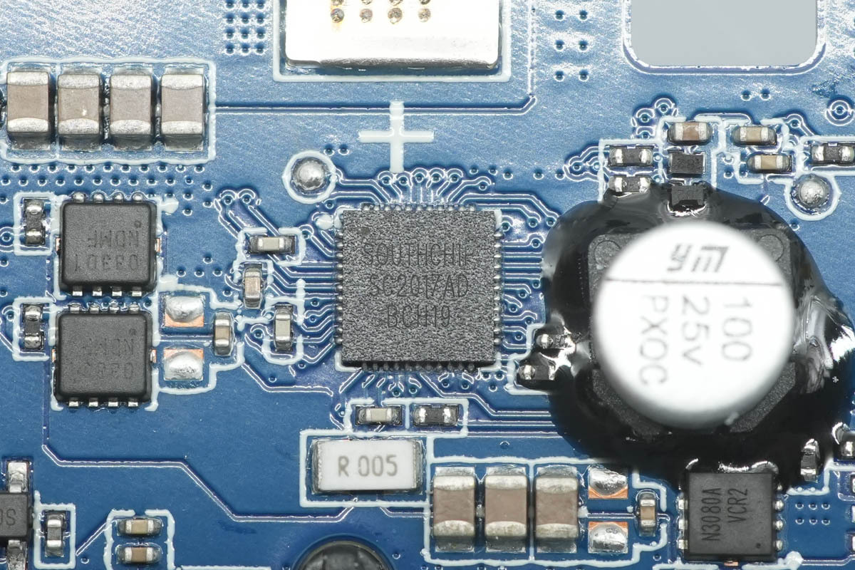

The power bank SoC is from SOUTHCHIP, model SC2017A, utilizing a QFN44 package and integrating both a buck controller and an MCU internally.
This chip significantly streamlines the peripheral component count and optimizes BOM by featuring a built-in USB PD baseband physical layer, Type-C detection, VBUS discharge path, VCONN power supply, and a comprehensive suite of system protection circuits.
For application, the SC2017A is primarily targeted at multi-port power banks, car chargers, and power tools markets, providing an efficient and stable single-chip solution for high-voltage fast-charging devices.
In terms of protocol compatibility and system configuration, it is equipped with two independent sets of CC pins and DP/DM pins, which not only support standard USB PD protocols and Vconn power supply, but also feature broad compatibility with BC1.2, UFCS, and multiple mainstream proprietary fast-charging protocols.
Its internal MCU subsystem adopts a 32-bit ARM Cortex-M0 core, with built-in 128KB Flash and 8KB SRAM, delivering robust programmable capabilities. Additionally, the chip integrates a high-precision 11-bit ADC and VDAC, supporting comprehensive and multiple protection mechanisms including OCP, OVP, SCP, and OTP.

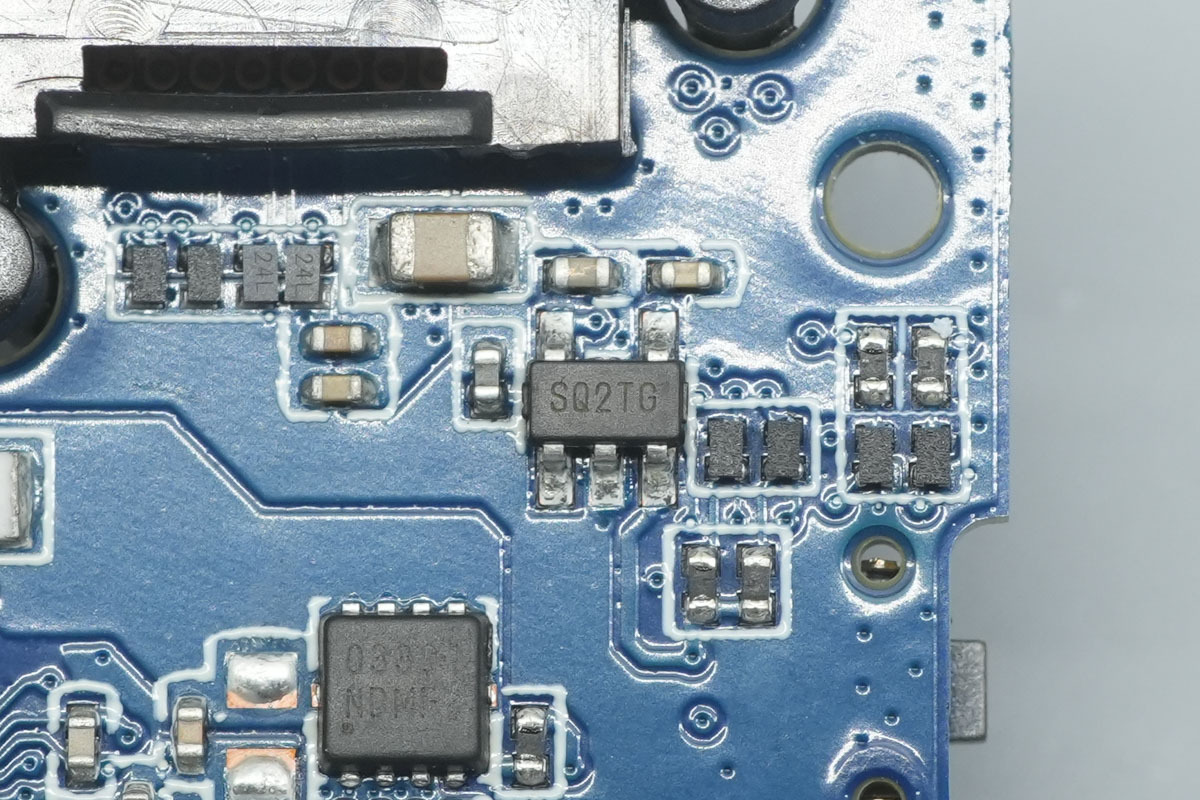

The two step-down MOSFETs, marked 03301.
A chip, marked SQ2TG.
The VBUS MOSFET used for the USB-A port, marked N3080A.

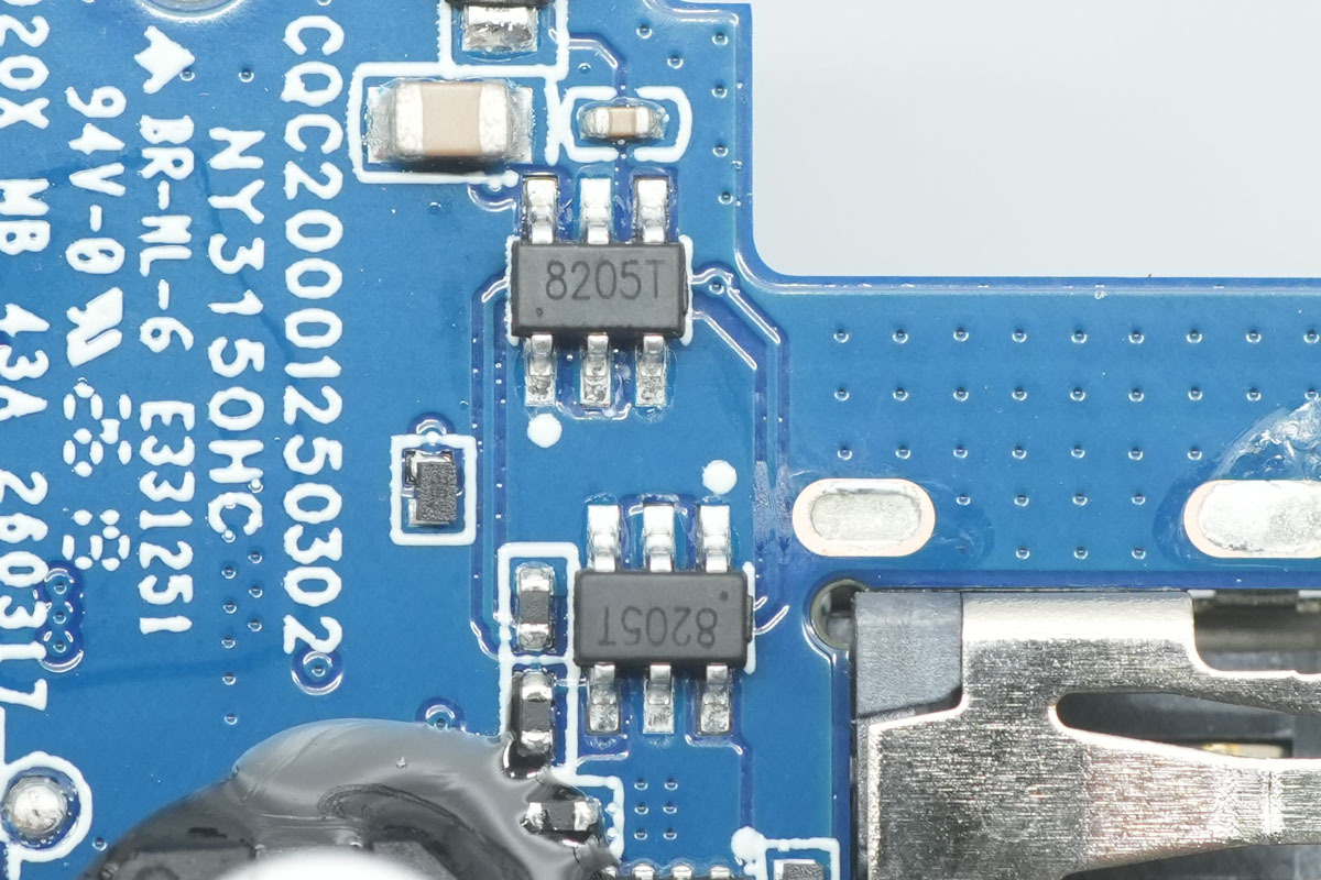

Two devices, model 8205T.
The VBUS MOSFET used for the USB-C port is from JESTEK, model 03111, 30V and 10mΩ, and in a PDFN3333 package.

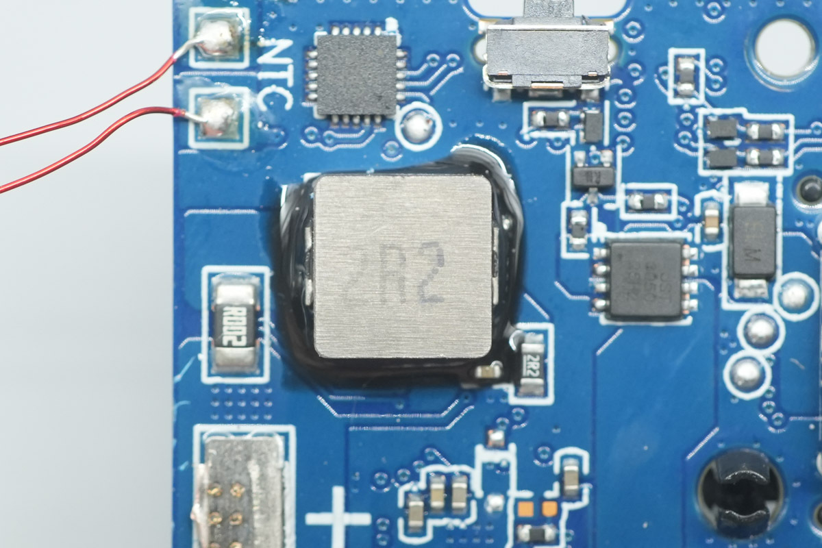

An alloy choke.

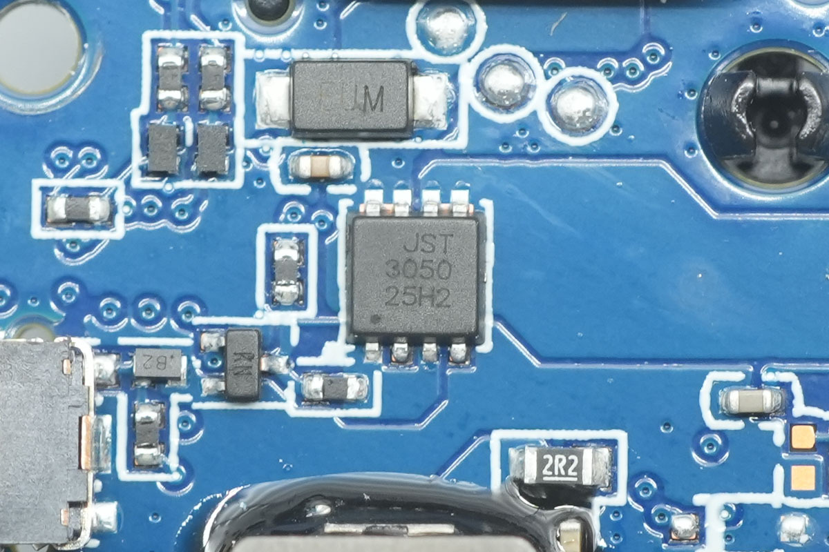

The VBUS MOSFET used for the built-in cable is also from JESTEK, model JST3050.

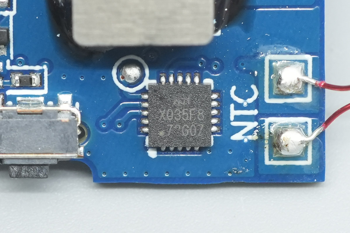

An MCU used for implementing product info query is from WCH, model CH32X035, which is an industrial-grade microcontroller designed based on the QingKe V4C core, operating at up to 48MHz with built-in 20KB SRAM and 62KB Flash, packaged in a QFN20 outline.

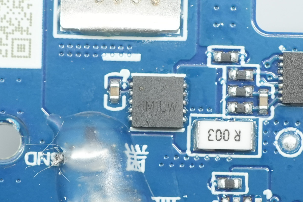

A lithium battery protection IC, marked 6M1LW.
A component, model 7001.
This is the NTC thermistor probe.

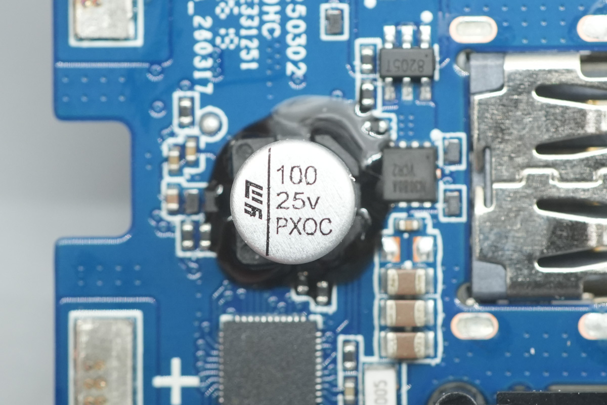

A solid cap used for charge and discharge filtering, spec 25V 100µF.
