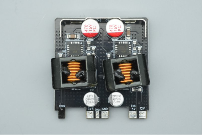

The PCB features the filtering caps, the synchronous step-down chips, and the step-down chokes, to produce stable 3.3V and 5V outputs.
Teardown of the ZIENER 450W GaN TFX PC PSU-Chargerlab
The exposed copper and tin on the back of the PCB enhances current carrying capacity and improves heat conduction.
The two filter caps, 470μF 16V.
The synchronous step-down chip is from NDP, model NDP23803QB. It supports 8-18V input voltage, continuous output current of 12A, and integrates a 5mΩ MOSFET. It is packaged in a QFN5*5 package.
The step-down chokes are wound with flat copper wire.
The filtering caps are from APAQ, spec 560μF/6.3V.
A 2mΩ shunt resistor is used for monitoring the 3.3V output current.

Another one is used for monitoring the 5V output current.
The filtering caps, 560μF/6.3V.
