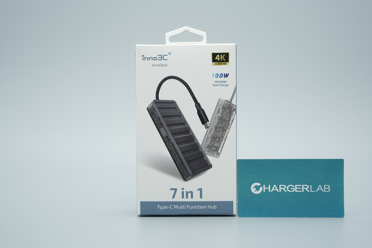

The packaging features the Inno3C logo and a product render on the front, with 4K and 100W PD charging icons clearly displayed in the upper right corner.
Teardown of Inno3C 7-in-1 Docking Station-Chargerlab

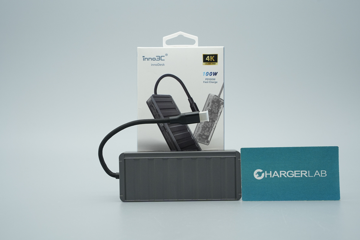

Unpacking the contents reveals the Inno3C 7-in-1 docking station along with its retail packaging.

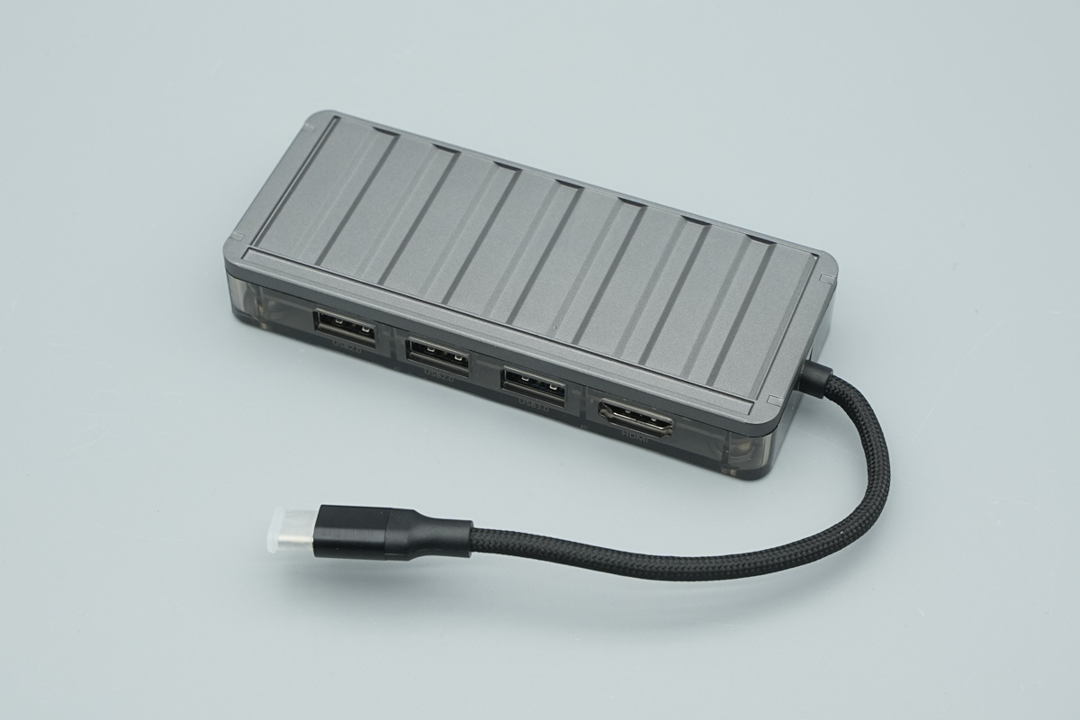

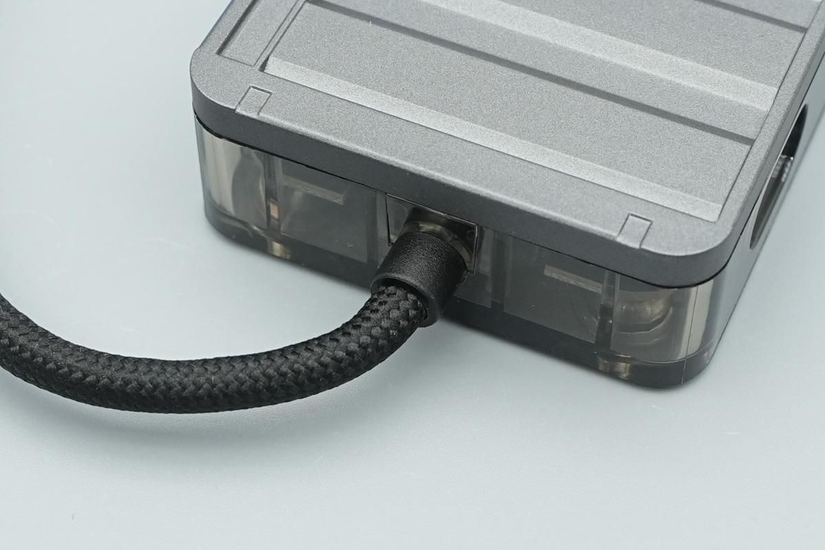

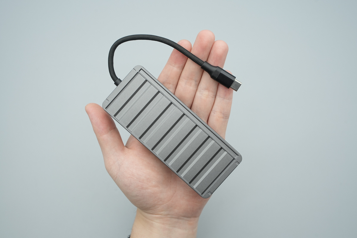

Featuring an integrated cable design, the dock’s top shell is crafted from space-gray aluminum alloy, accented with a grooved texture that enhances visual depth while promoting heat dissipation. The integrated cable is wrapped in a durable black braided material.
The cable joint is reinforced with thick injection molding, improving overall durability and bend resistance.

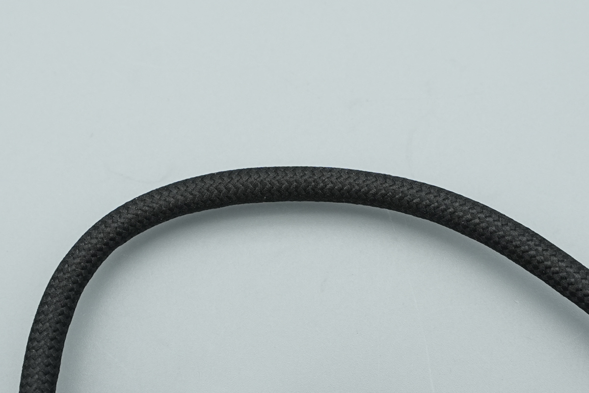

The cable features a high-density nylon braided sleeve, providing excellent durability, tangle resistance, and a longer overall service life.

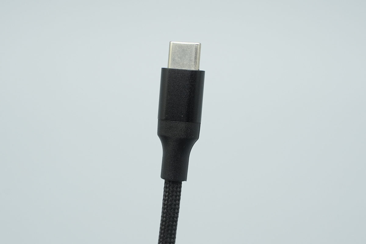

The USB-C plug includes extended injection-molded strain relief at the cable connection point for enhanced durability.

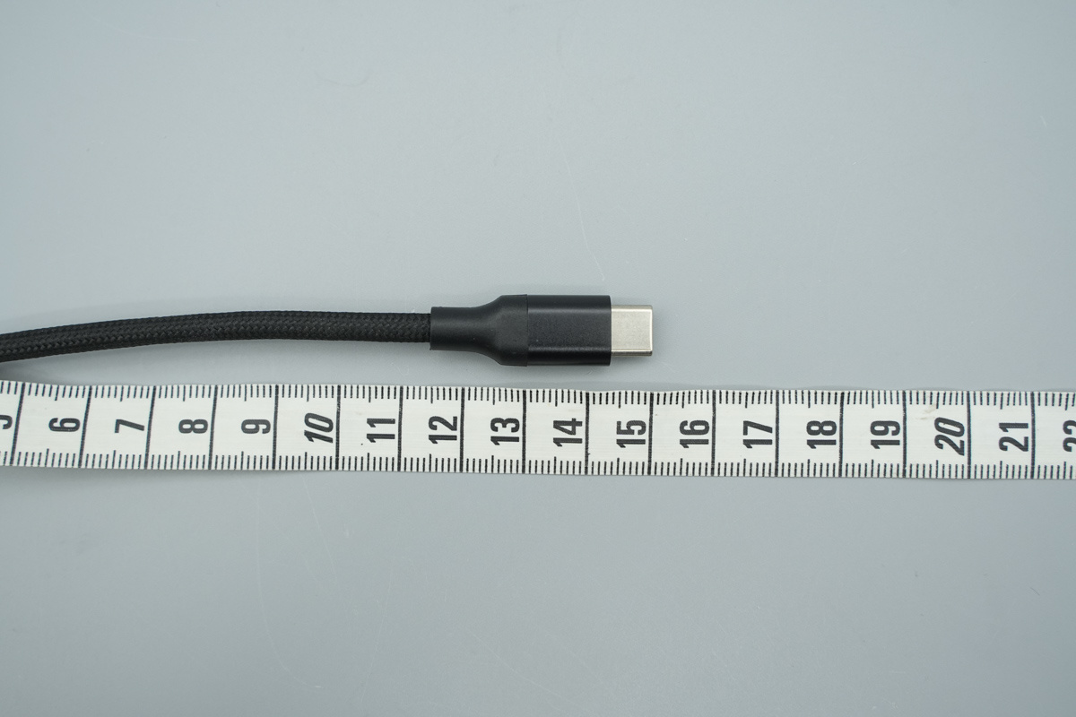

The length of the integrated cable is approximately 15cm.

回到扩展坞机身,金属顶盖边缘均做了倒角处理。
The edges of the dock’s metal top cover are chamfered for a clean, premium look.

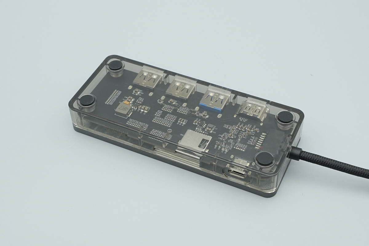

The underside of the dock features a transparent gray PC, allowing for a striking look into the internal PCBA and components—perfect for tech enthusiasts. To keep the device securely in place, the base is equipped with four circular anti-slip rubber feet at the corners.

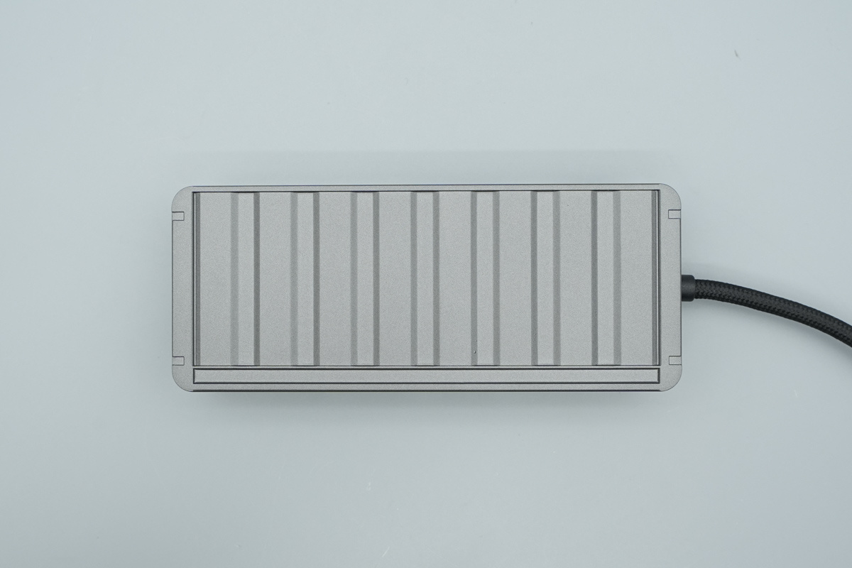

Here is the aluminum alloy top cover, its grooved surface delivers a bold, sharp, and distinctly rugged look.

The transparent base allows for a clear view of the internal layout, including the SMDs and conversion chips.

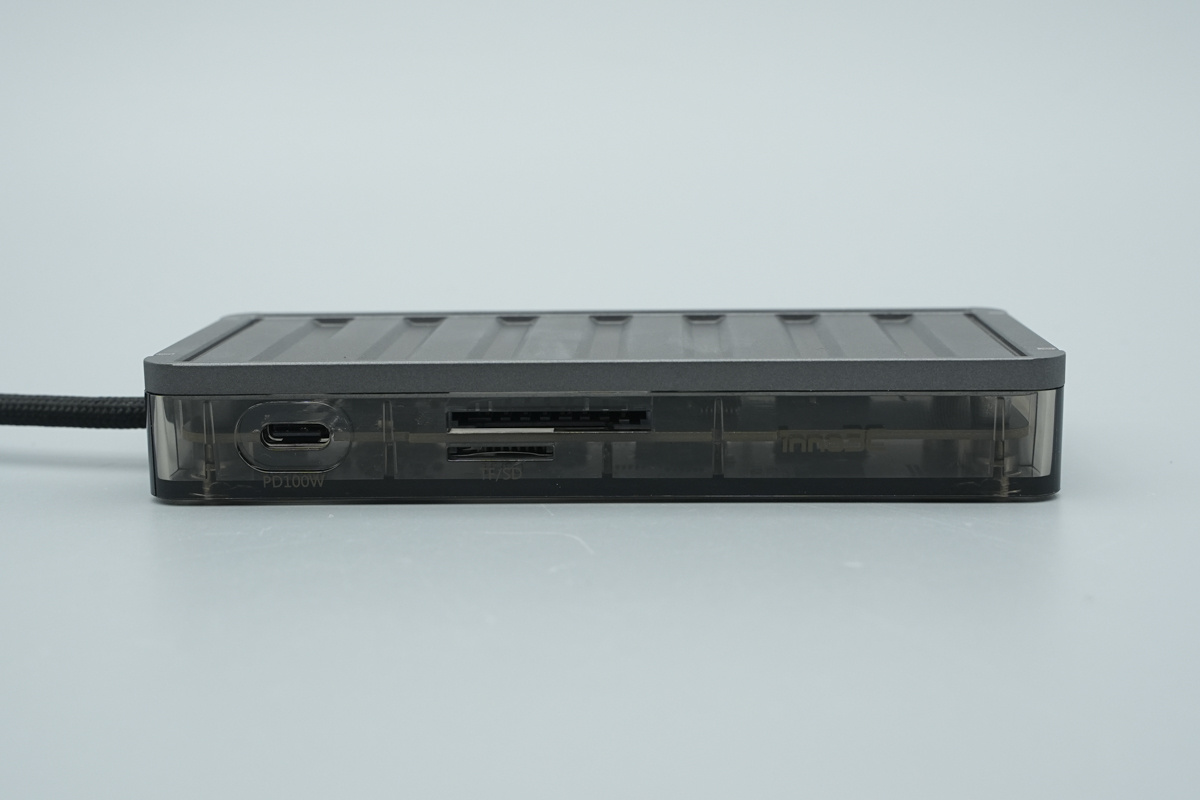

The side of the unit features a USB-C port (100W PD input), an SD card slot, and a TF card slot.

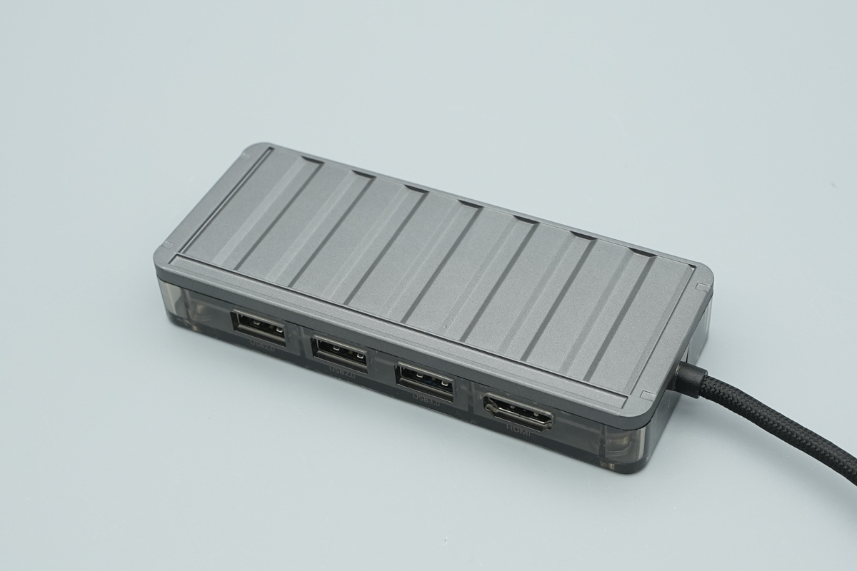

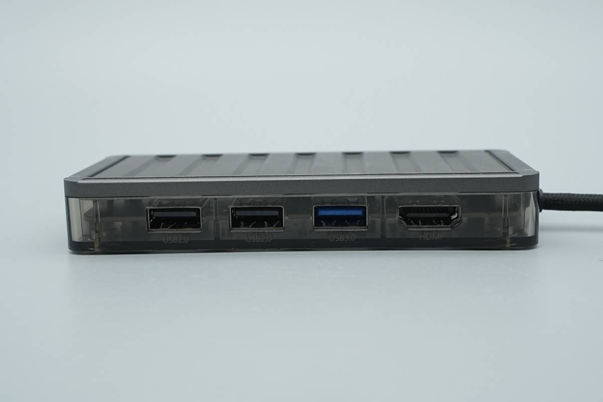

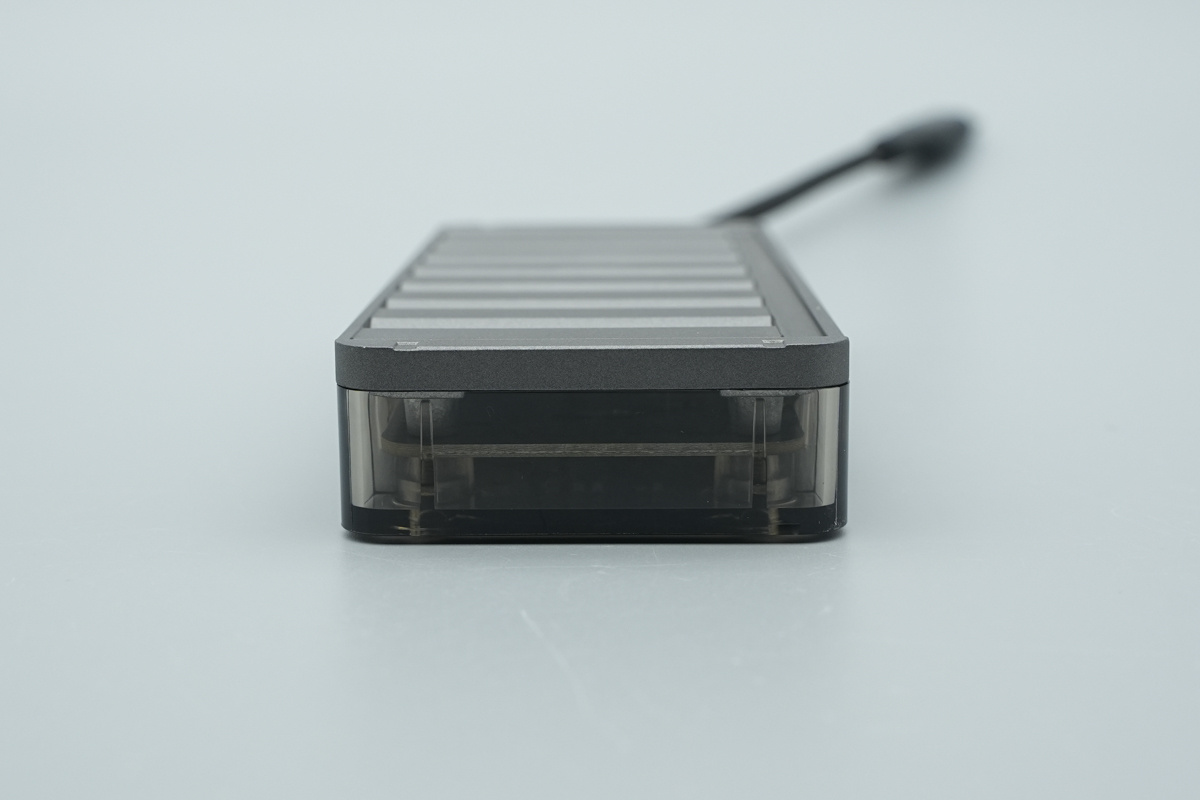

The other side of it houses two USB 2.0 ports, one USB 3.0 port and one HDMI video port.

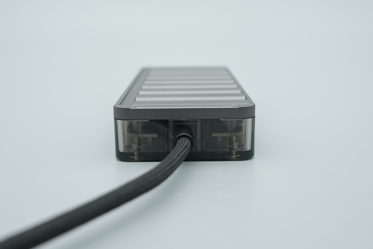

The built-in cable exits from the center of the dock housing.

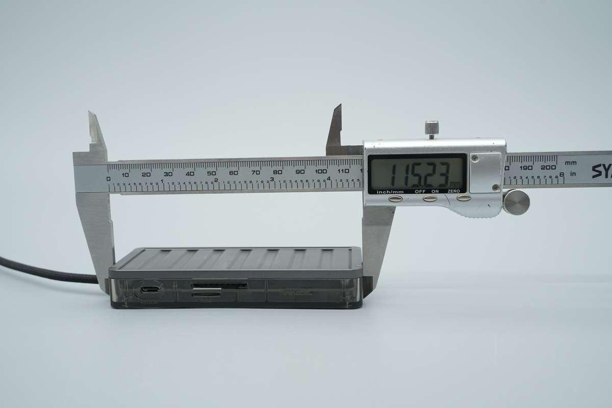

The length of the dock is about 115.23mm (4.537 inches).

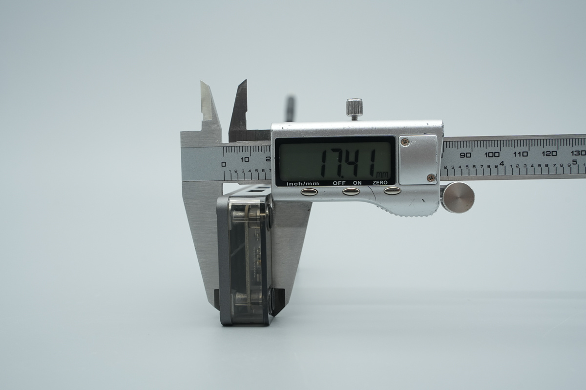

The thickness of the dock is about 17.41mm (0.685 inches).

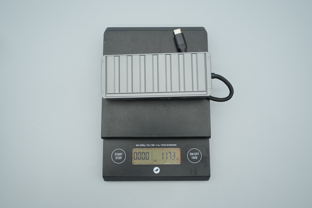

The weight is about 117.3g (2.91 oz).

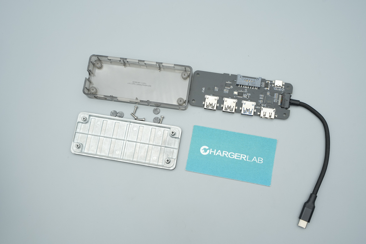

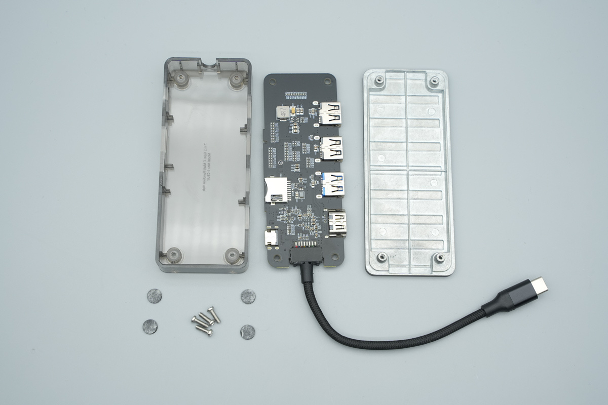

Remove the four anti-slip pads and the four screws beneath them to separate the metal top cover from the transparent base and extract the internal PCBA module.

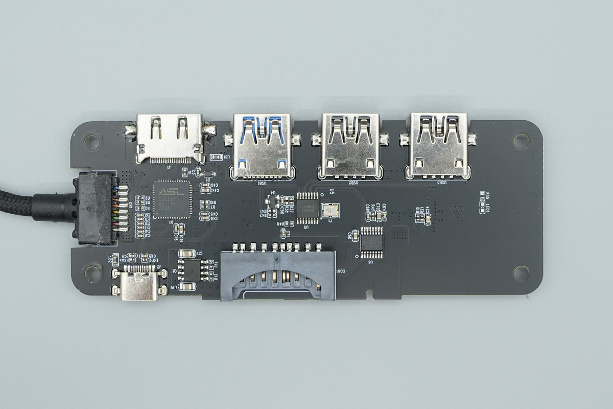

The topside of the PCBA features the SMDs and all primary interface ports, including USB-A, USB-C, HDMI, and TF card slots.
Here is the back of the PCBA. It is clean and well-organized, housing the main conversion chip, the crystal oscillator, and the SD card slot.

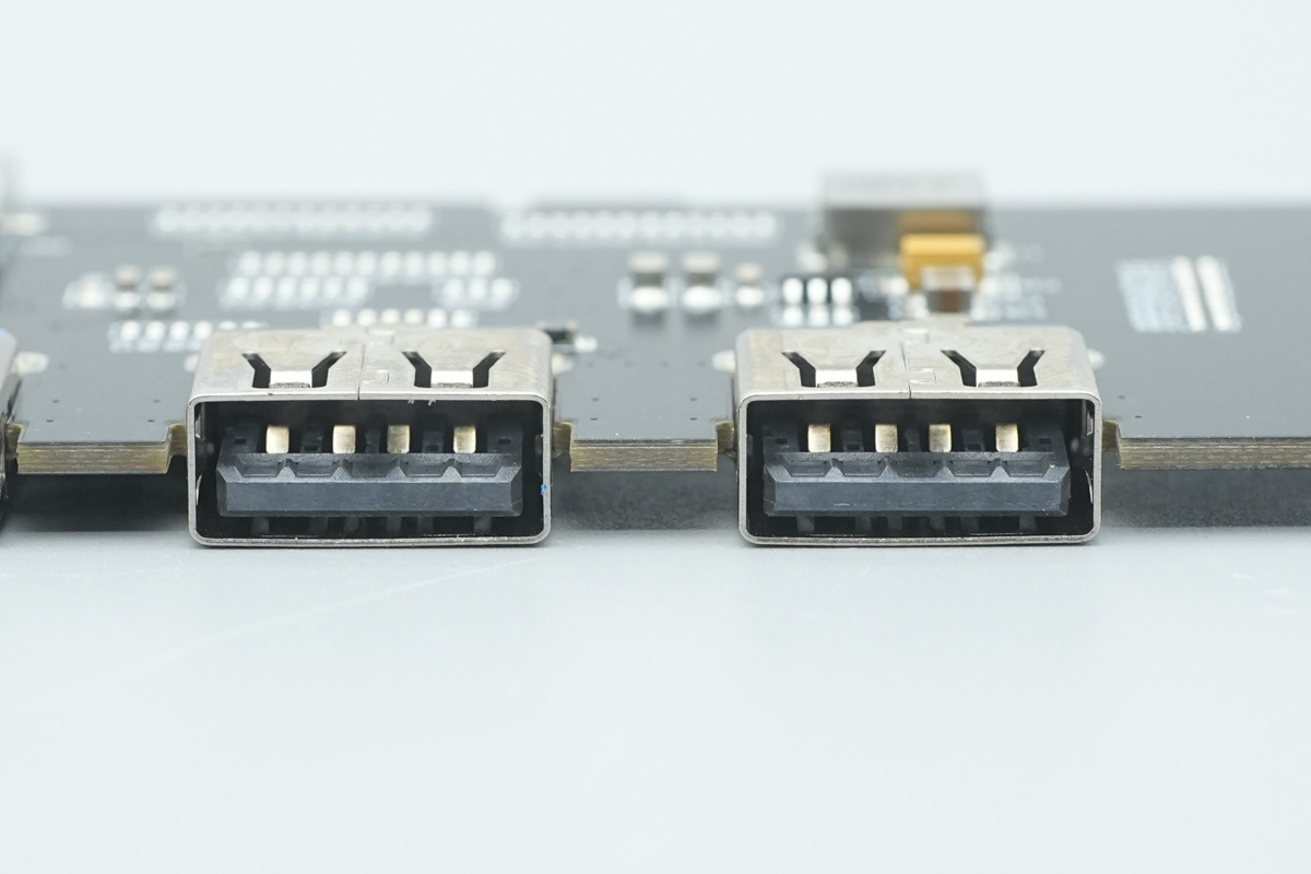

Here are two USB 2.0 ports, both featuring black plastic sheets.

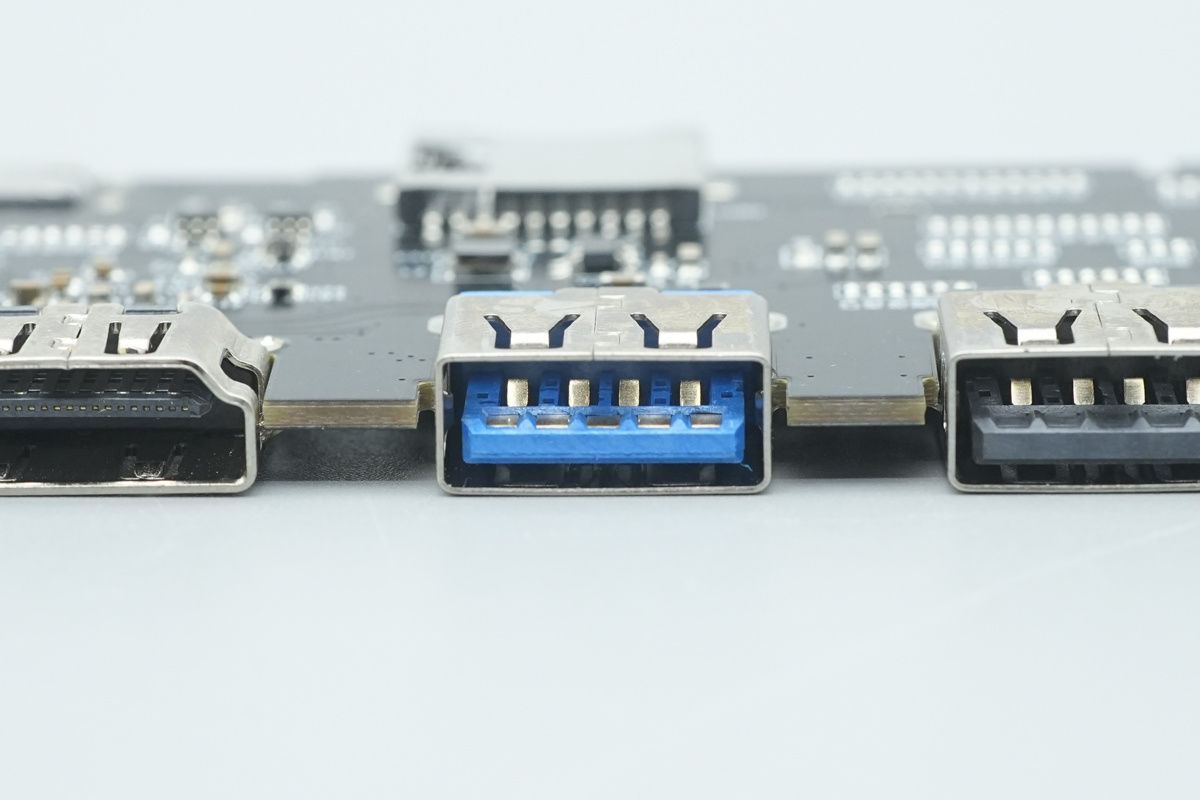

The USB 3.0 port utilizes a sink-mount through-hole soldering process and a blue plastic sheet for easy identification, with clearly visible internal contact pins.
The HDMI video port is secured to the board using the sink-mount through-hole soldering process for enhanced structural integrity.

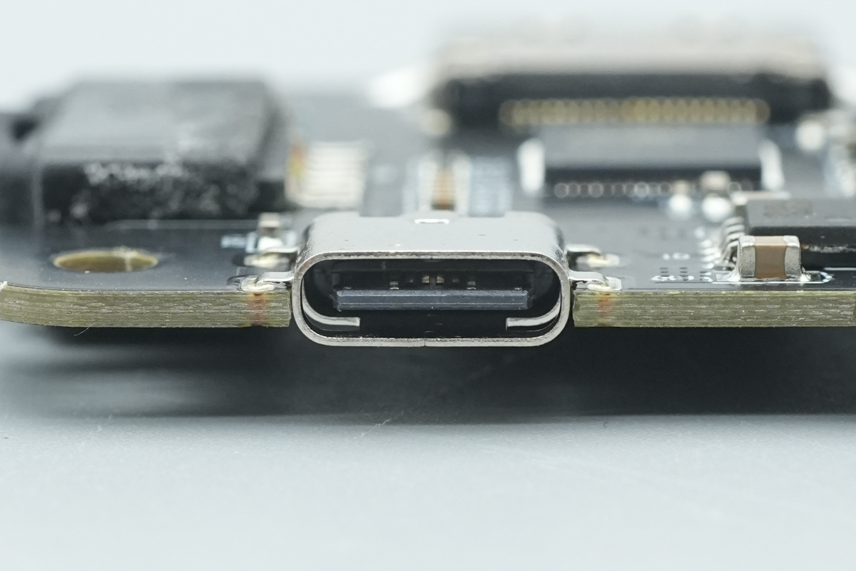

The USB-C PD input port also features the sink-mount through-hole soldering process, which helps keep the docking station’s design compact and thin.

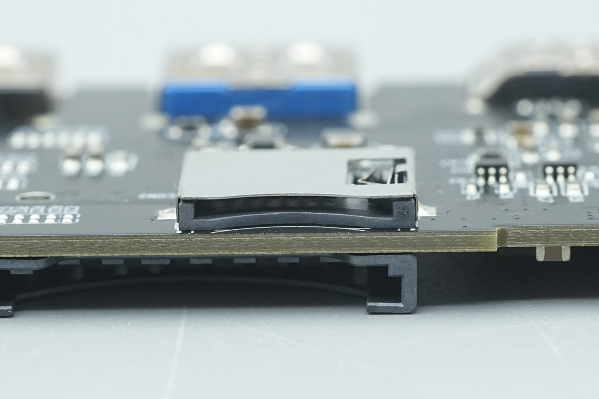

The SD card slot and TF card slot are located on opposite sides of the PCBA.
The TF card slot includes a built-in spring-loaded mechanism for easy card removal.

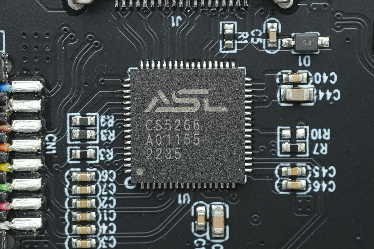

The dock utilizes the video conversion chip is from ASL, model CS5266, housed in a QFN68 package, this high-performance chip facilitates USB Type-C to HDMI 2.0b (4K@30Hz) conversion. It natively supports up to 100W PD pass-through and works in tandem with a USB hub chip to enable USB 3.1 high-speed data transmission.

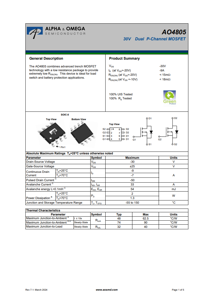

A VBUS MOSDFET is from AOS, model AO4805, dual PMOS, -30V and 15mΩ, housed in a SOIC-8 package.
Here is the info about AO4805.

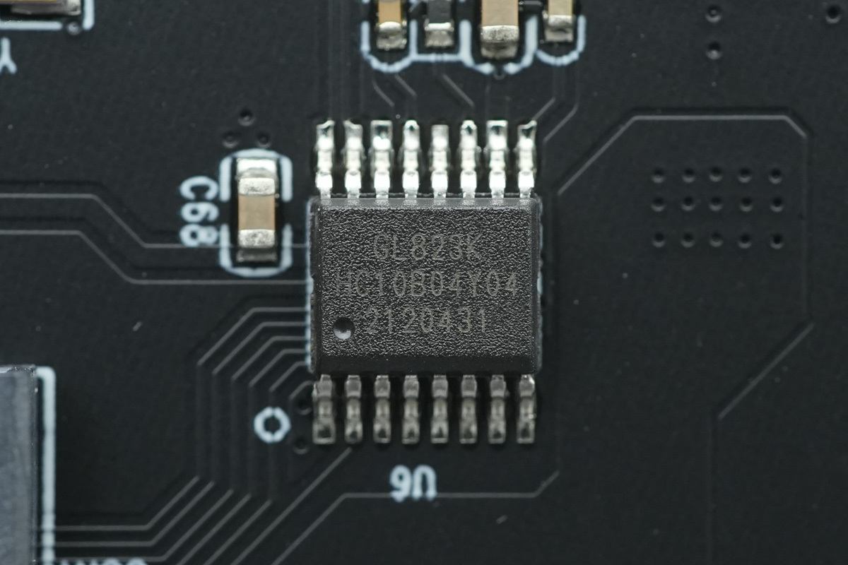

The card reader chip is from Genesys, model GL823K, housed in a SSOP16 package. It's a highly integrated controller chip designed for USB 2.0 SD/MSPRO card reader functionality.

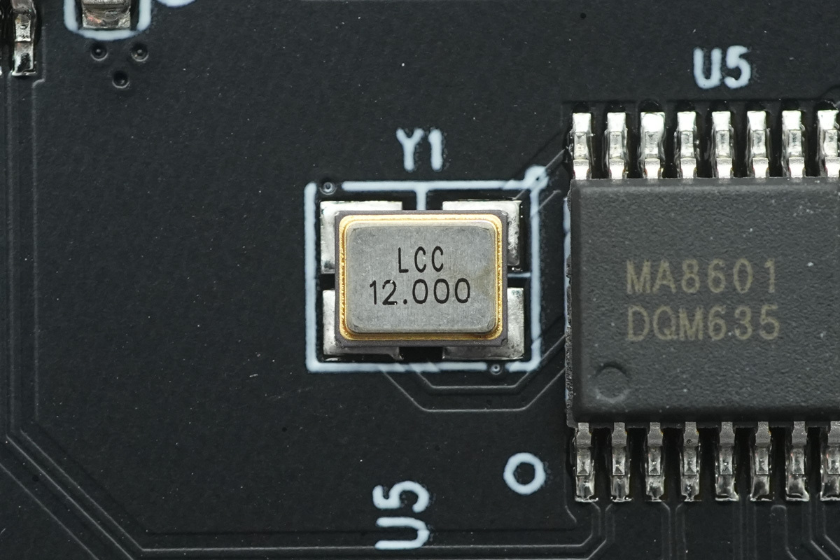

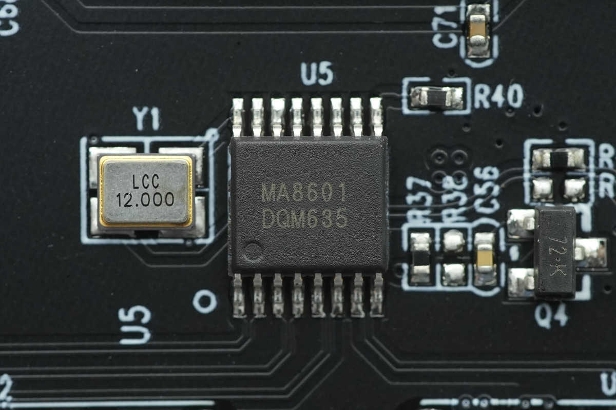

The USB hub chip is from Prolific, model MA8601, housed in a SSOP28 package. It's a 4-port USB 2.0 controller that enables signal expansion for multiple external USB devices.
A 12.000 MHz crystal oscillator is positioned next to the USB hub chip to provide the required system clock signal.

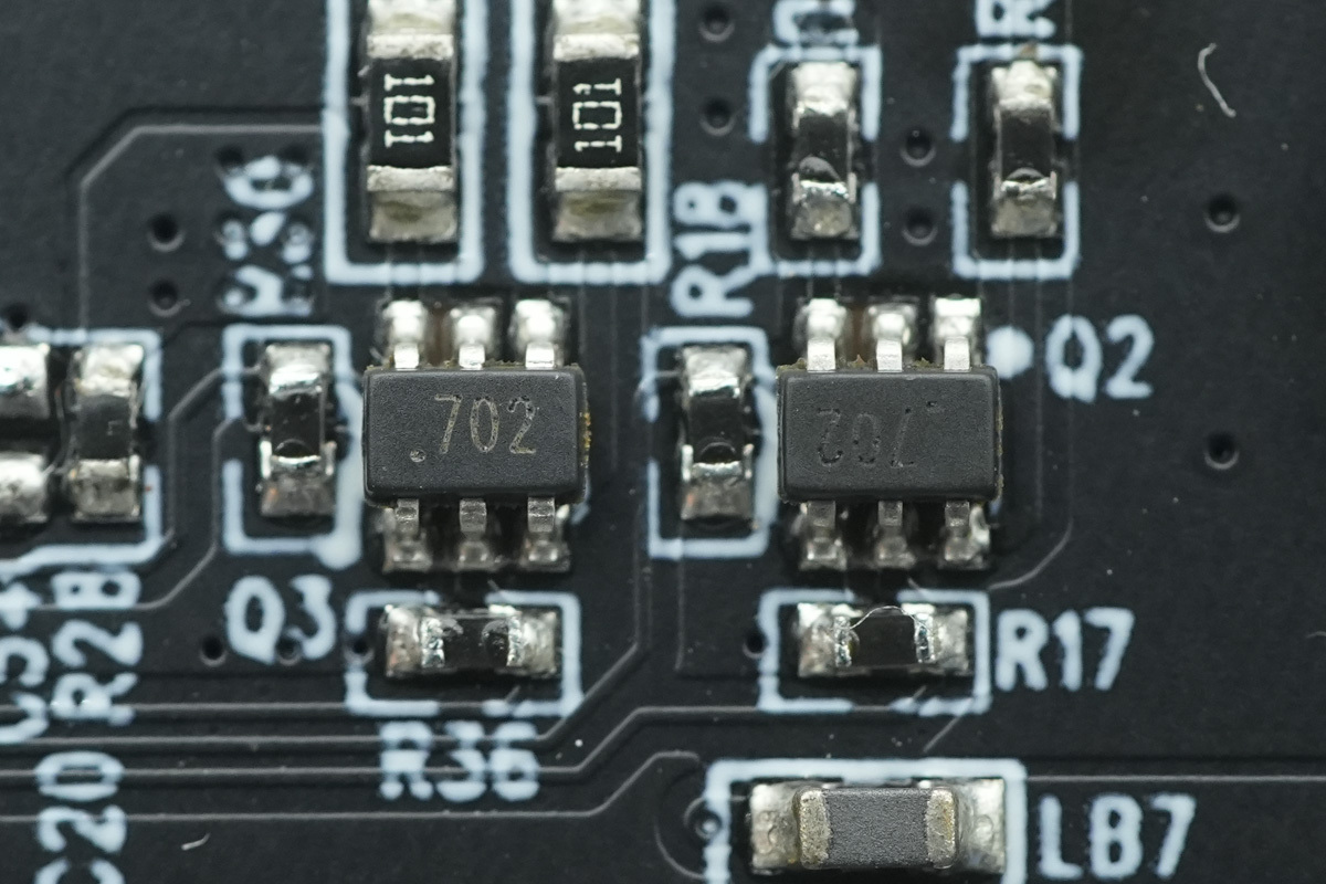

There are two components, marked 702.

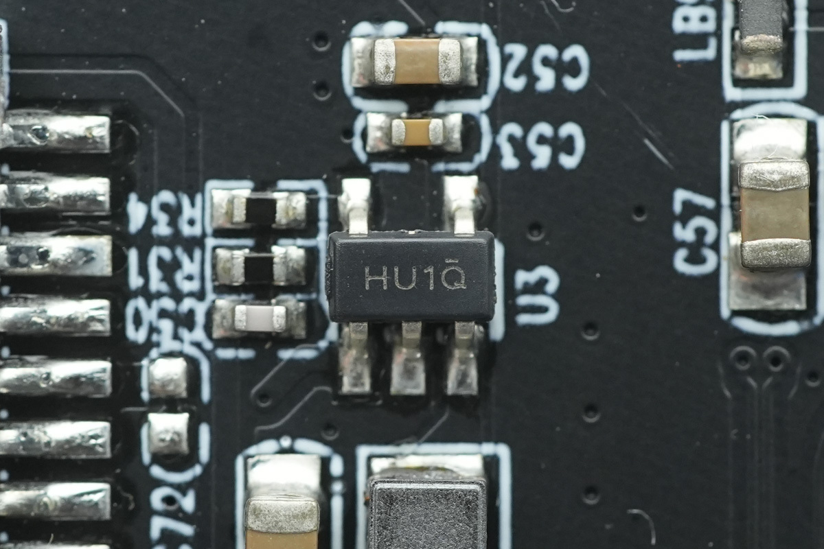

There is a chip, marked HU1Q.

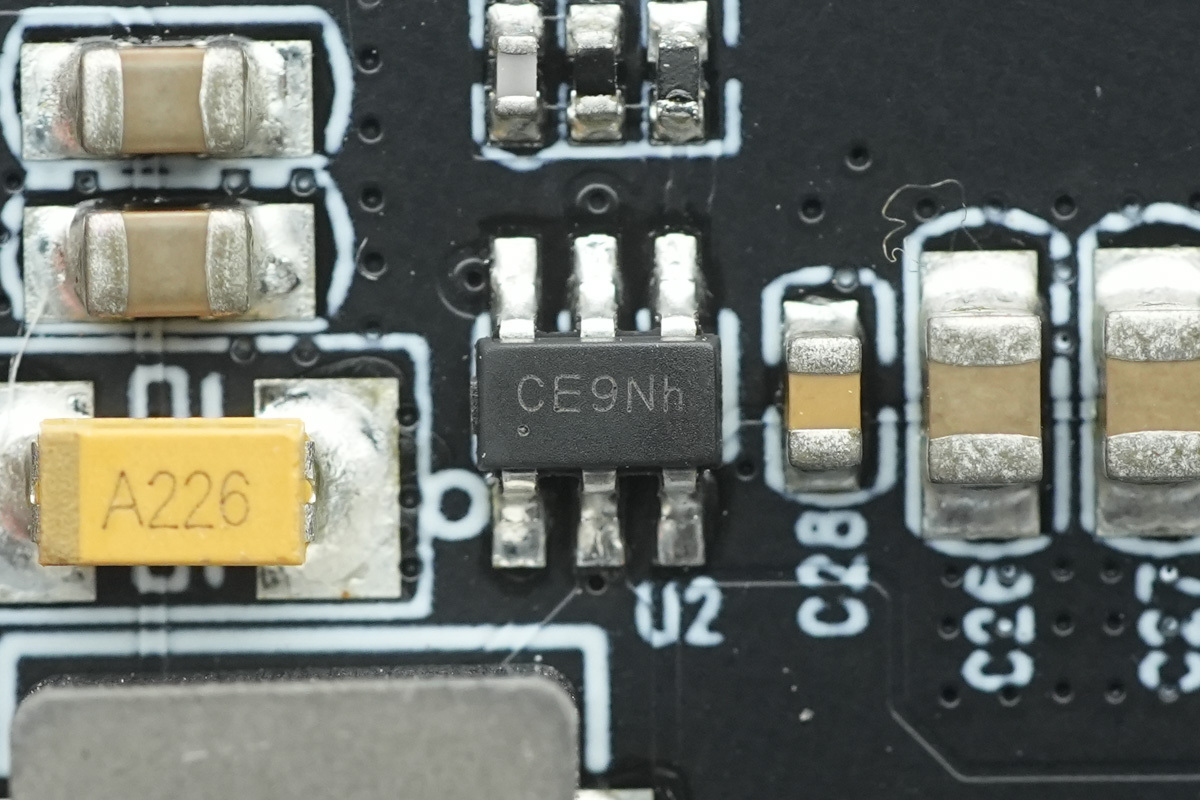

Another one is marked with CE9Nh.

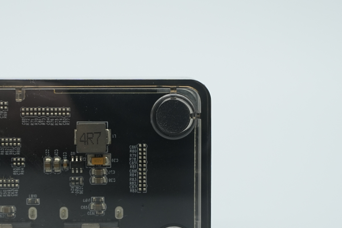

This is a surface-mount alloy choke.
