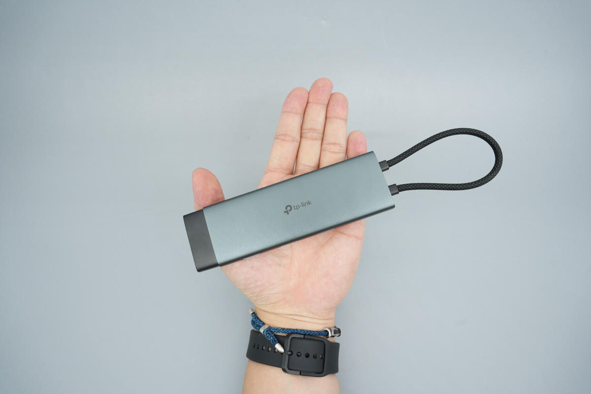

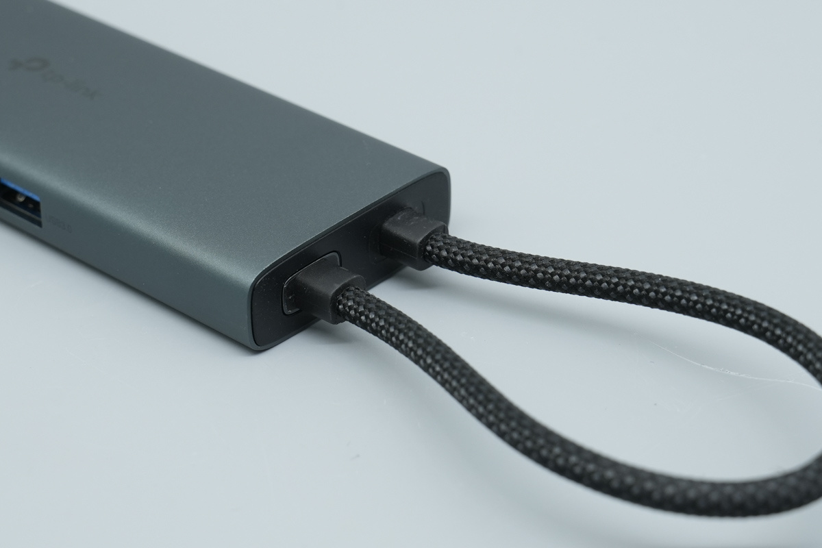

The dock features a durable space-gray anodized aluminum housing with a self-storing braided cable that docks into the rear to create a convenient carry handle.
Teardown of tp-link 9-in-1 Docking Station-Chargerlab

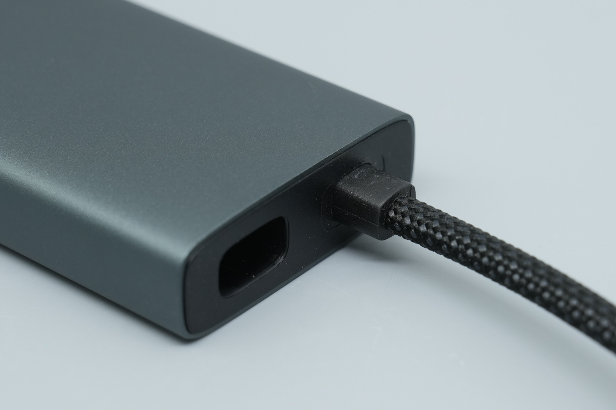

The rear of the dock is cleverly designed with a dedicated slot for the USB-C connector, letting it snap neatly into the body for easy, secure transport.
With the USB-C connector removed, the internal stowage channel is clearly revealed, demonstrating a dedicated design for secure integration.

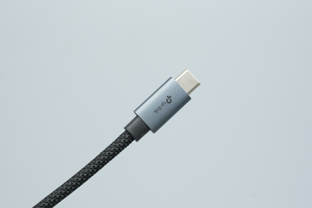

The USB-C connector sports the tp-link logo on its metallic exterior, paired with a robust nylon braided cable that provides excellent durability and resistance to pulling and fraying.

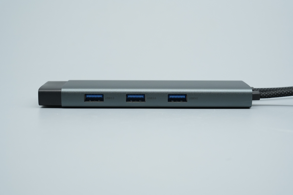

The side of the chassis houses three USB-A 3.0 data ports, distinguished by their blue internal plastic sheet.

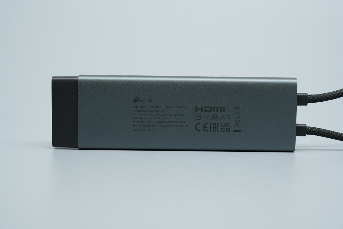

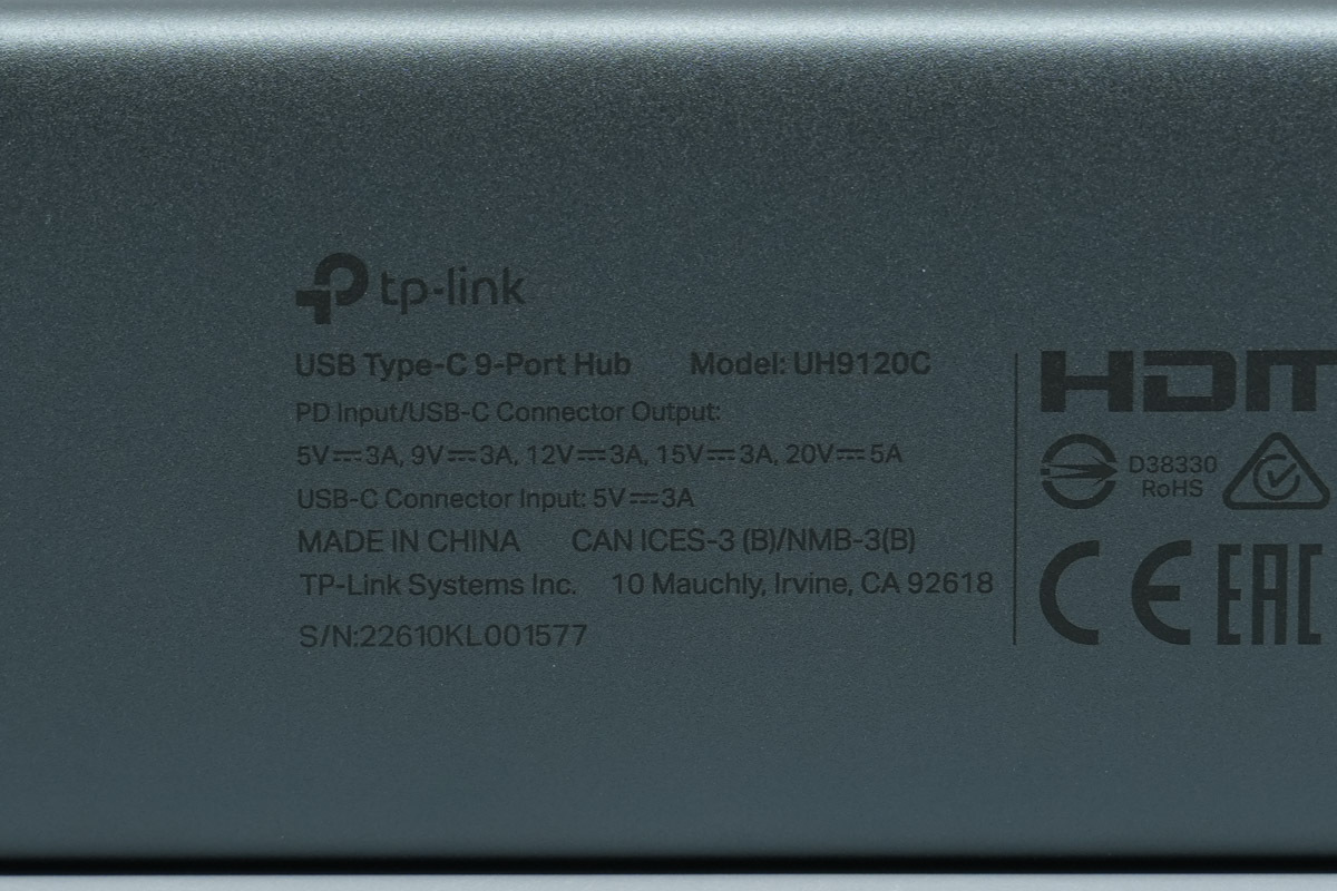

The rear of it is laser-etched with comprehensive technical specs and mandatory safety certifications.
Product Data:
Model: UH9120C
Power Delivery: Input/Output supports 5V/3A, 9V/3A, 12V/3A, 15V/3A, 20V/5A
Origin: Made in China
Certifications: CE, EAC

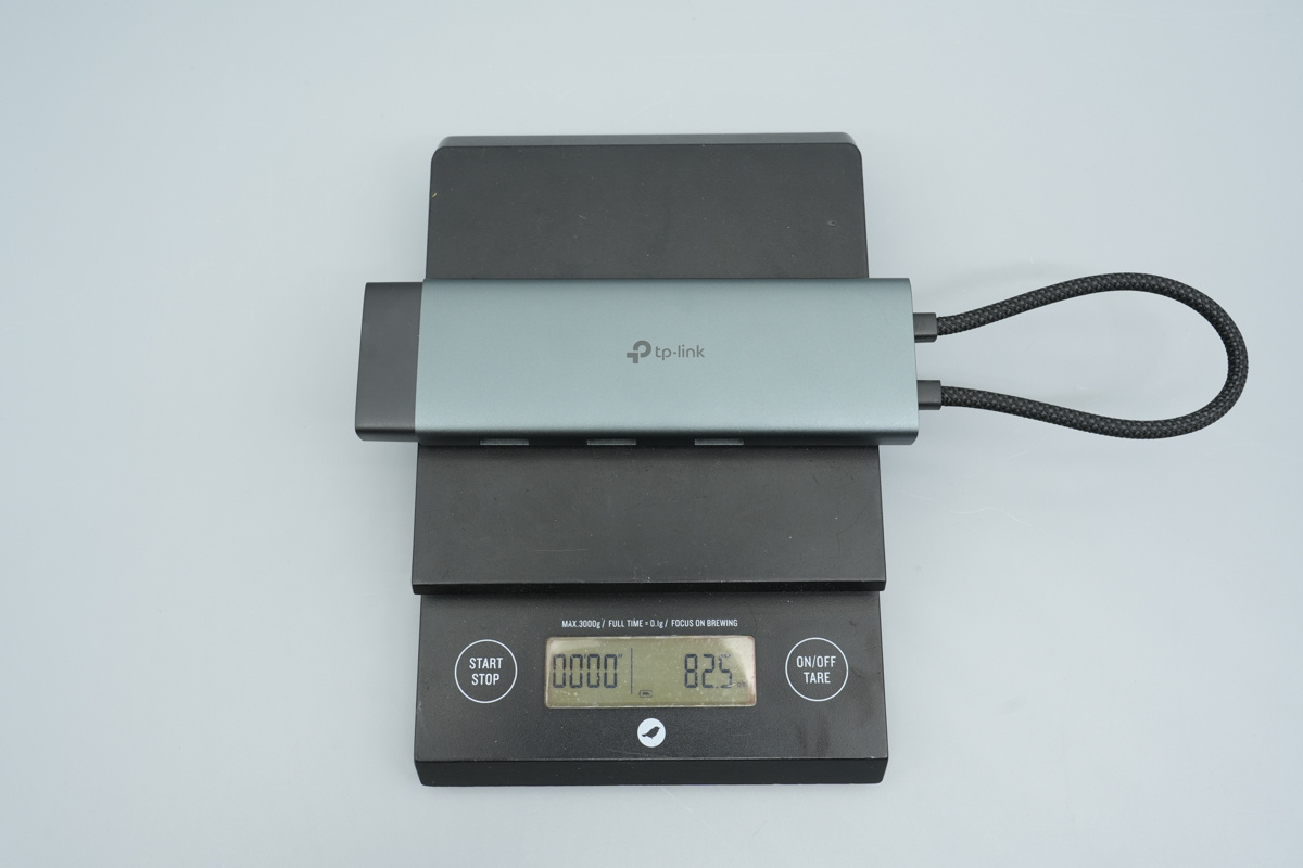

The weight is about 82.5g (2.91 oz).

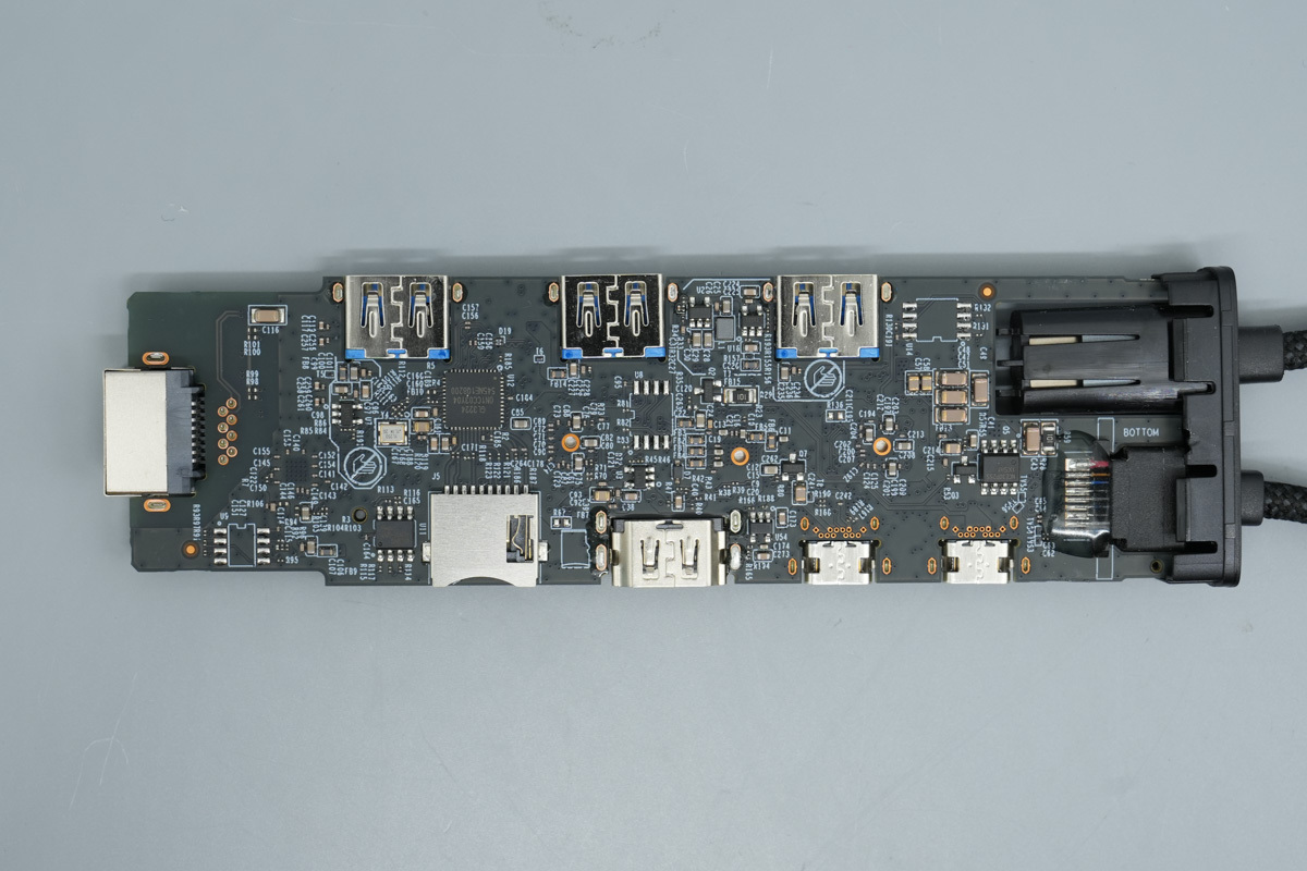

Removing the PCBA reveals that the chassis interior utilizes snap-fit clips on both sides to keep everything locked perfectly in place.
The top of the PCBA houses the card reader chip, the memory chip, and the VBUS MOSFETs, showcasing a highly integrated design.
The back of the PCBA houses the USB HUB controller, the video conversion chip, and the network isolation transformer.

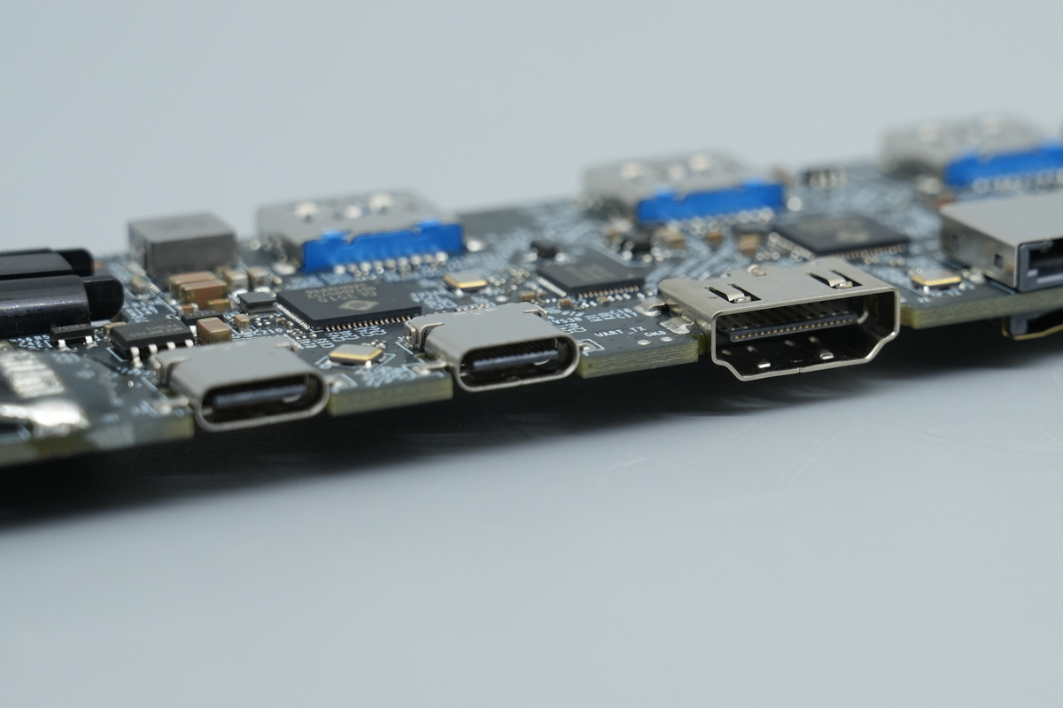

The side houses two USB-C ports with black plastic sheets, one for PD power delivery input and one for USB 3.1 data transmission.

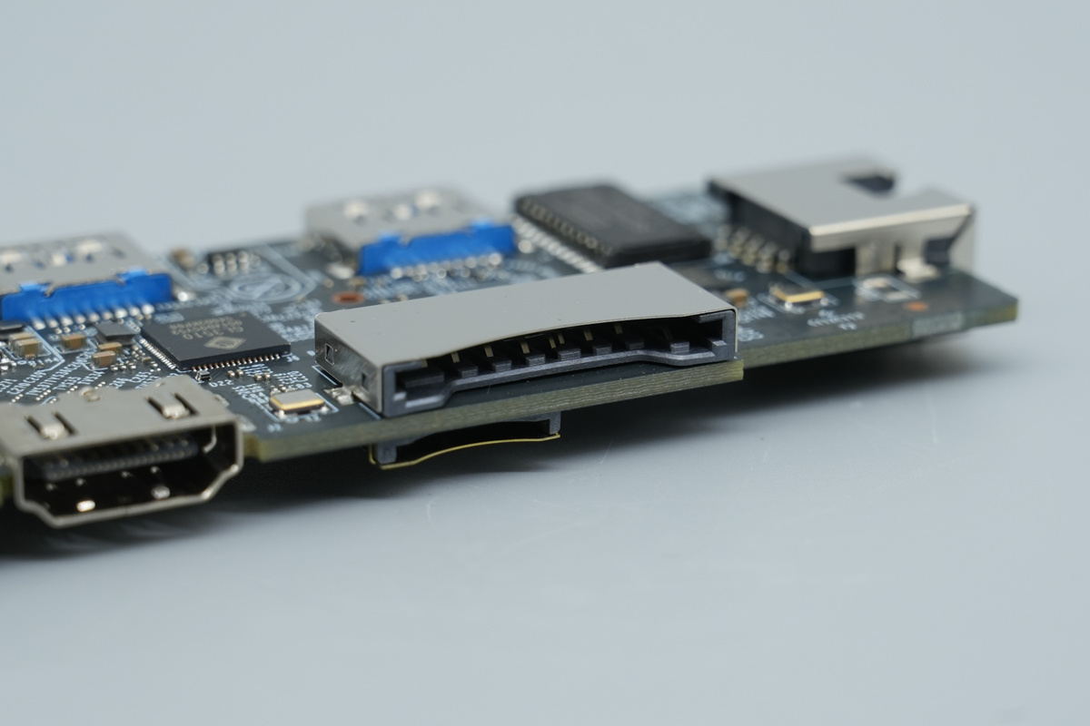

There is an HDMI video port, and integrated slots for SD and TF memory cards.
The PCBA features a RJ45 Gigabit Ethernet port integrated on its side.

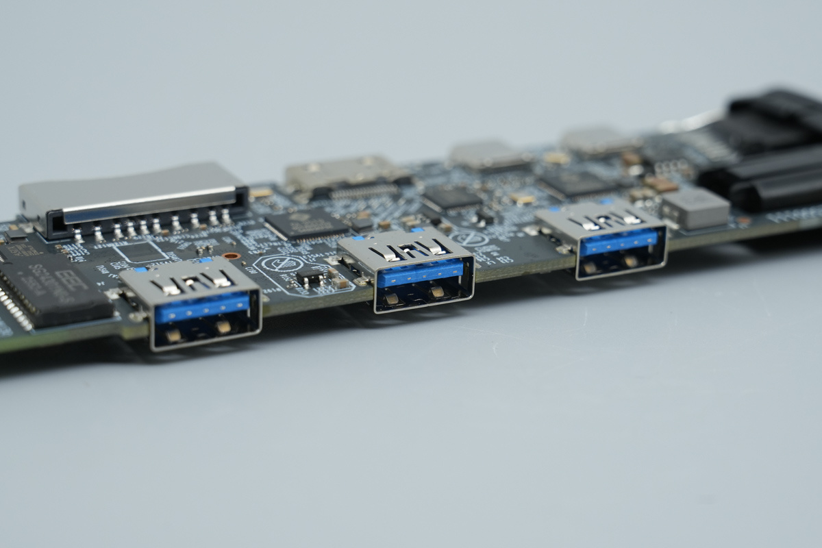

The other side features three USB-A 3.0 ports, all distinguished by their blue plastic sheets.

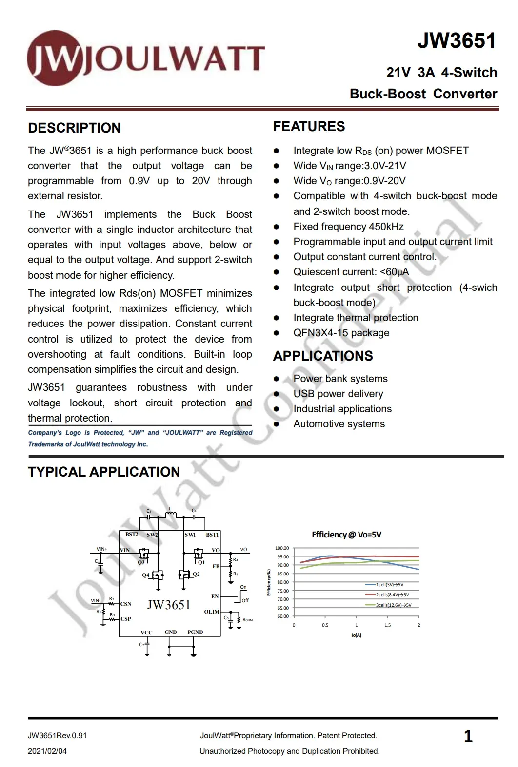

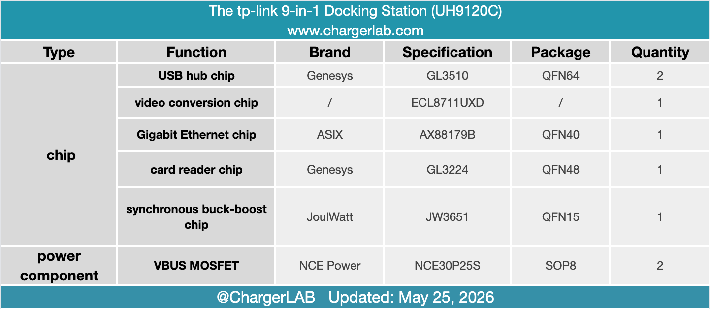

The synchronous buck-boost chip is from JoulWatt, model JW3651. It features a single-choke architecture, supporting output voltages up to 20V. It offers robust versatility by maintaining stable output regulation across input voltages that are equal to, lower than, or higher than the target output voltage.
It integrates four MOSFETs within a compact architecture to minimize PCB footprint and optimize energy efficiency. Key features include:a 450kHz switching frequency, programmable output voltage and current limiting, constant current control, output short-circuit protection, and thermal shutdown functionality, all housed in a space-saving QFN3x4-15 package.
This is a metal alloy choke from JoulWatt, model JW3651.

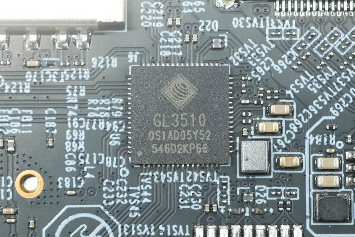

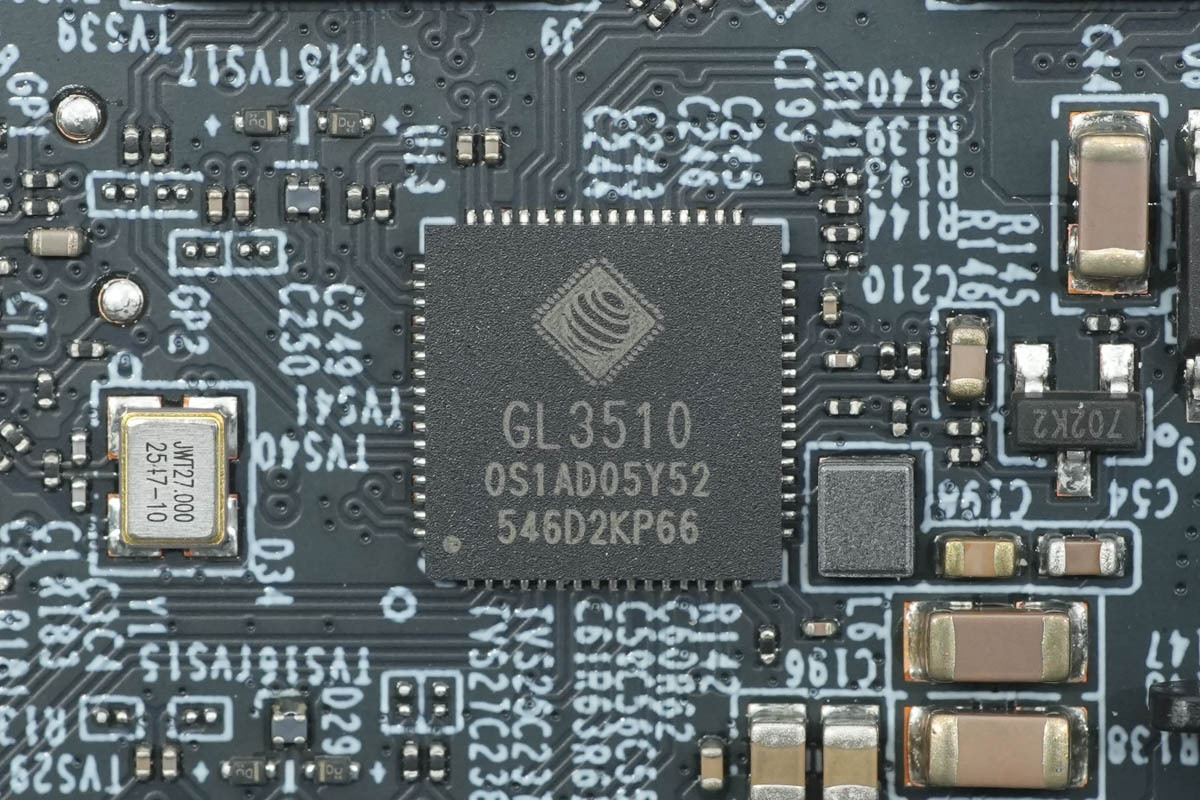

The USB hub chip is from Genesys, model GL3510, in a QFN64 package. This four-port, low-power chip supports USB 3.0 while maintaining full backward compatibility with USB 2.0, and features an integrated switching voltage regulator. It facilitates USB 3.0 expansion, driving the three USB-A ports and the downstream GL3510.

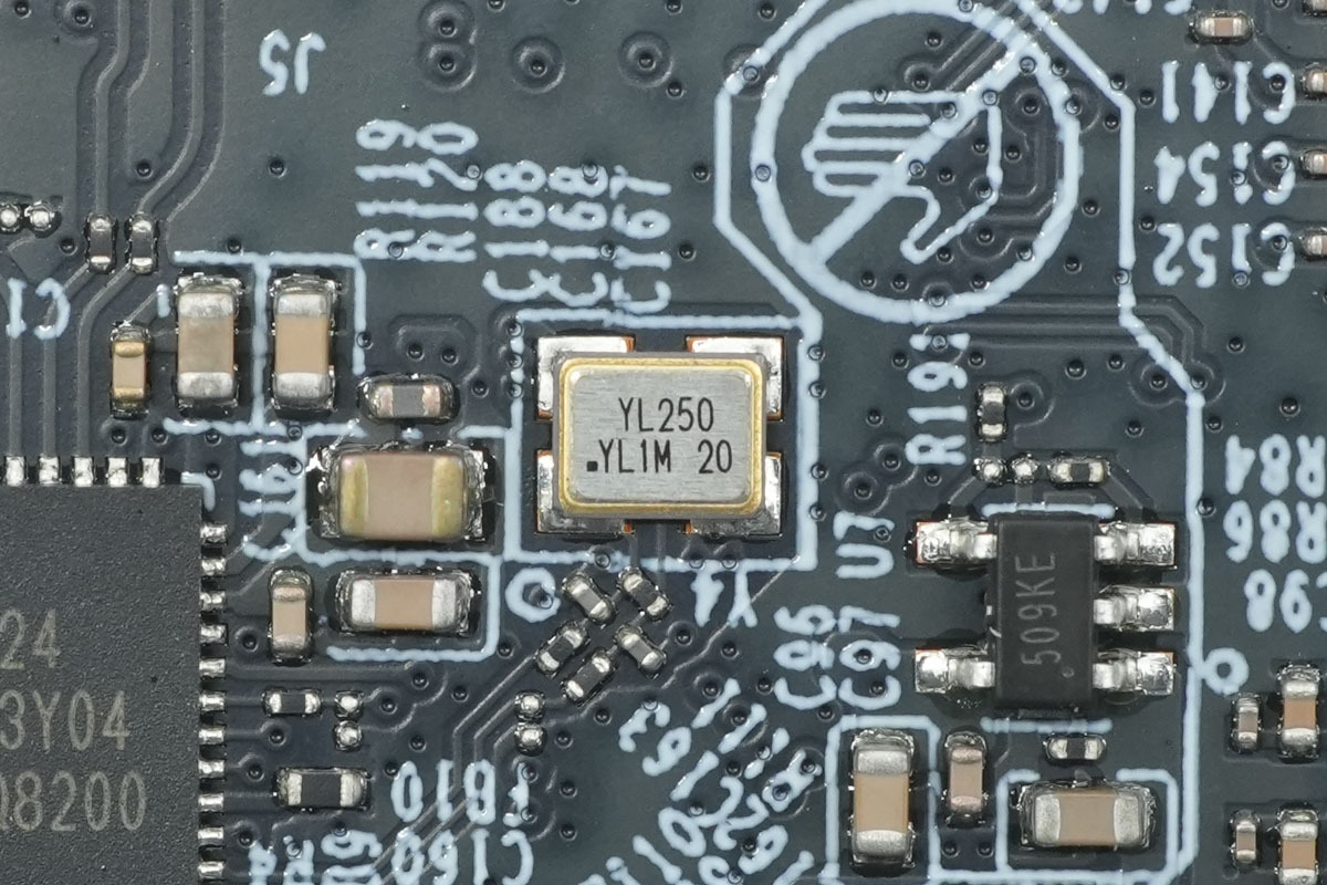

A crystal oscillator is located alongside the USB hub chip.
A control chip, marked ECL8711UXD, is for HDMI output conversion.

The dock features a second USB hub chip, also from Genesys, model GL3510.
Another crystal oscillator is located nearby.

A Gigabit Ethernet chip is from ASIX, model AX88179B.

The card reader chip is from Genesys, model GL3224, and in a QFN48 pakage, which provides high-speed read/write support for both SD and MicroSD memory cards.

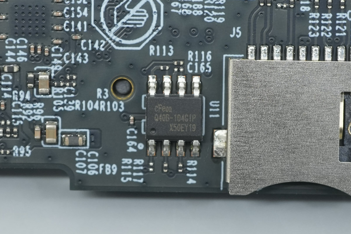

The memory chip is from cFeon, model Q40B-104GIP NOR Flash.

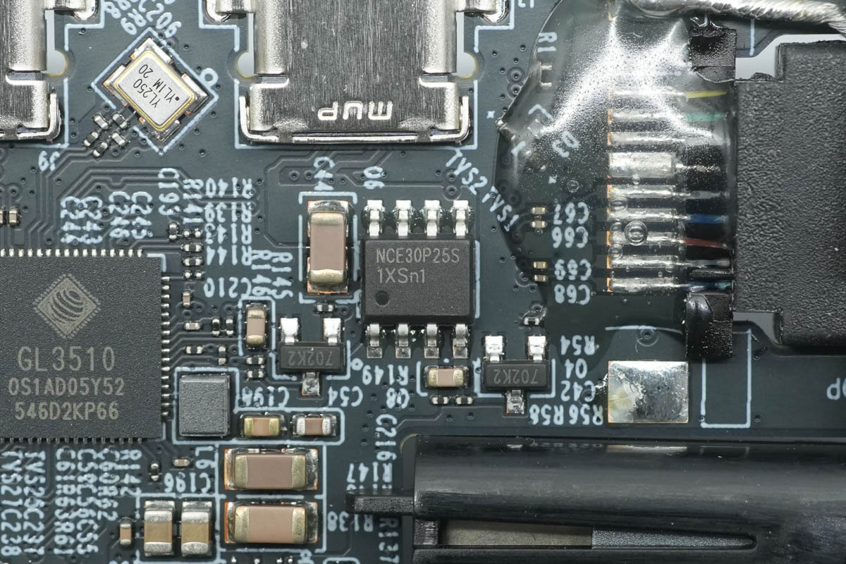

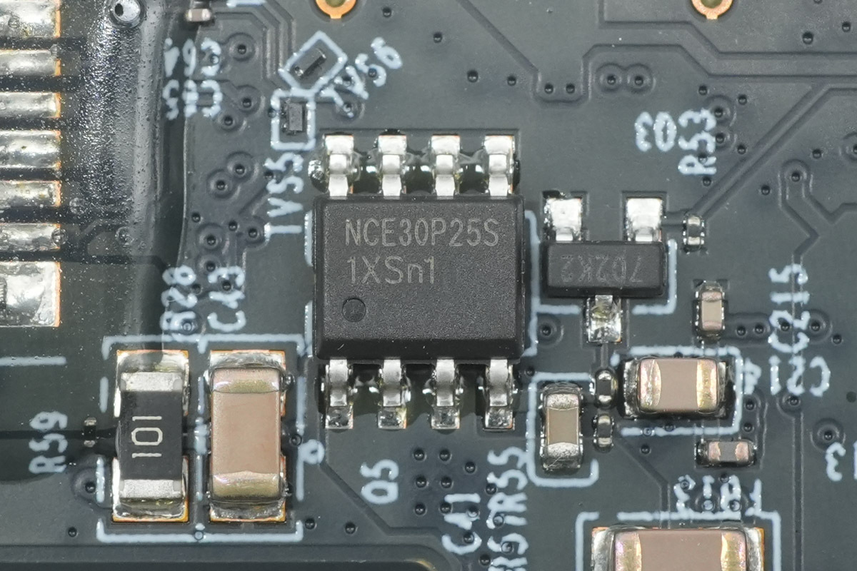

The VBUS MOSFET is from NCE, model NCE30P25S, PMOS, -30V and 9mΩ, and in a SOP8 package.
Another one is also from NCE, model NCE30P25S.
