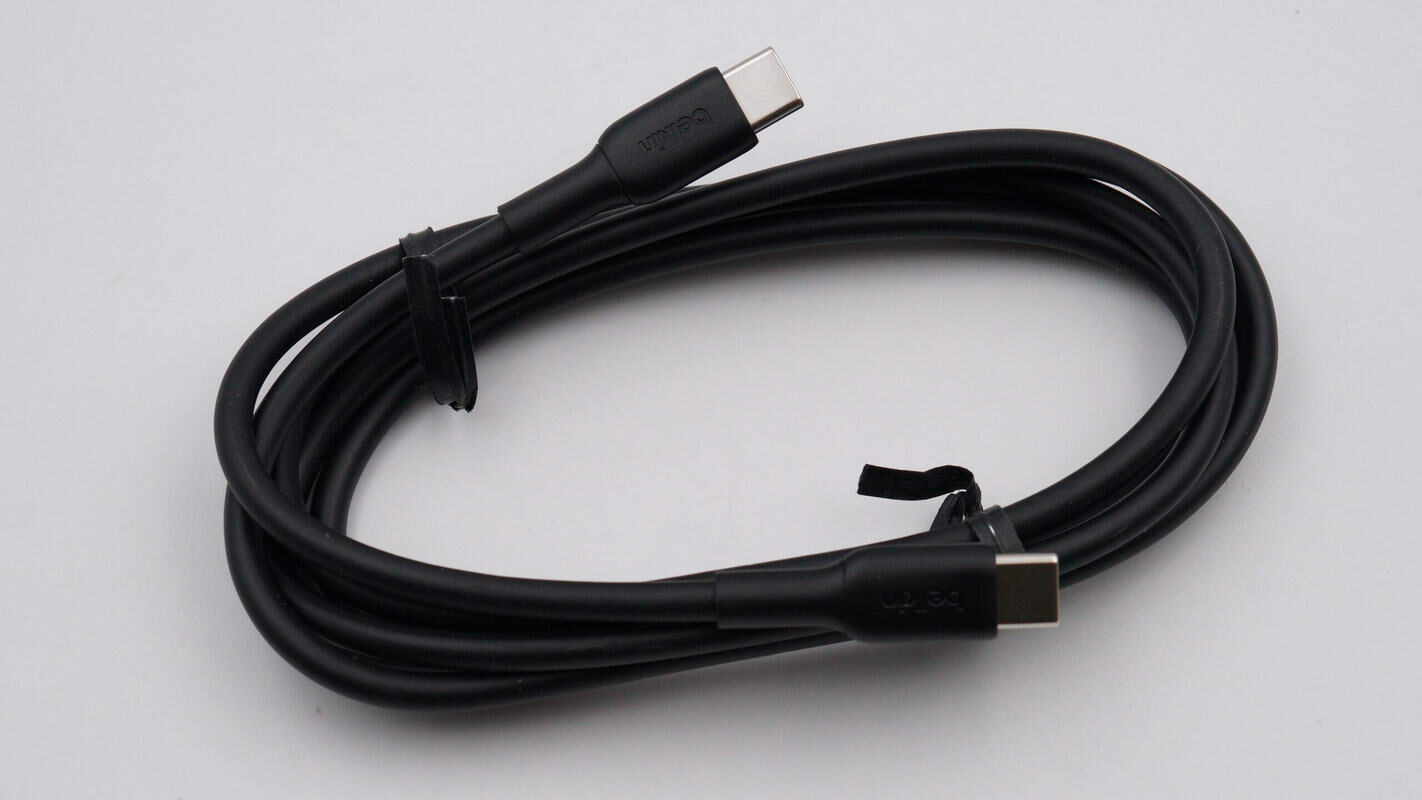

Inside the packaging, in addition to the charging stand, there is a charging cable, a user manual, and a warranty card.
Teardown of Belkin 15W Auto‑Tracking Stand Pro with DockKit (MMA008)-Chargerlab
The included charging cable is a USB-C to USB-C type.

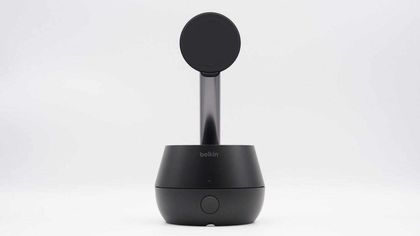

The charging stand is composed of three parts: the base, the support rod, and the MagSafe wireless charging pad. The base rotates 360° horizontally and, combined with Apple’s DockKit facial tracking technology, is designed to meet the needs of live streaming, outdoor selfies, vlogging, and other content creation scenarios.
The casing is made from renewable plastic materials, reflecting Belkin’s commitment to low-carbon and environmentally friendly practices.

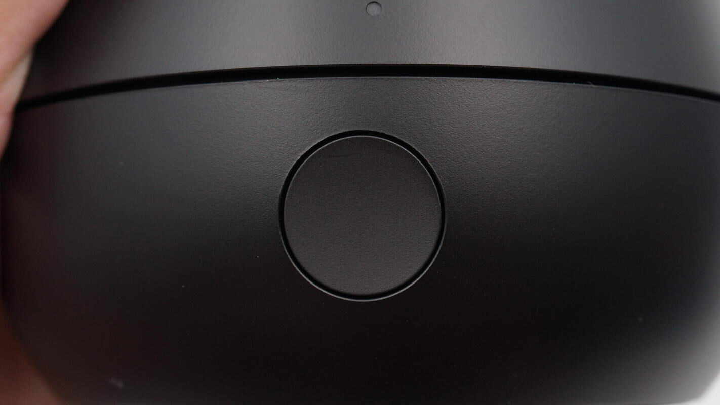

The front of the base features a button to start and stop the auto-tracking function.
Above the button is an LED indicator light. A flashing white light indicates NFC pairing in progress, while a steady white light means pairing is successful. A flashing green light signals that facial tracking is active, and a steady green light indicates tracking is ready.

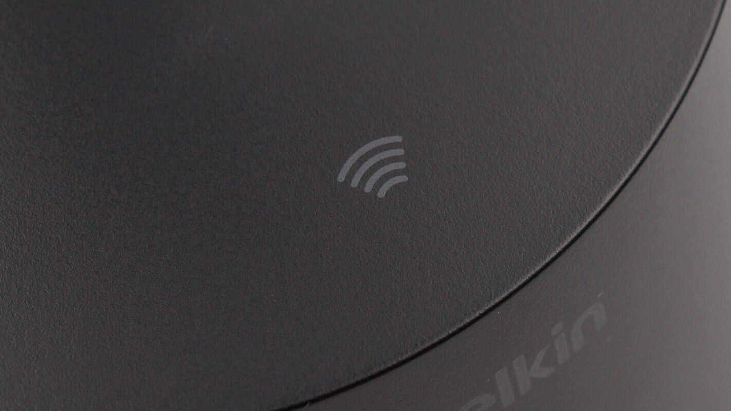

The top of the base is marked with an NFC logo. Simply bringing your phone close enables seamless connection without the need to download any additional apps.

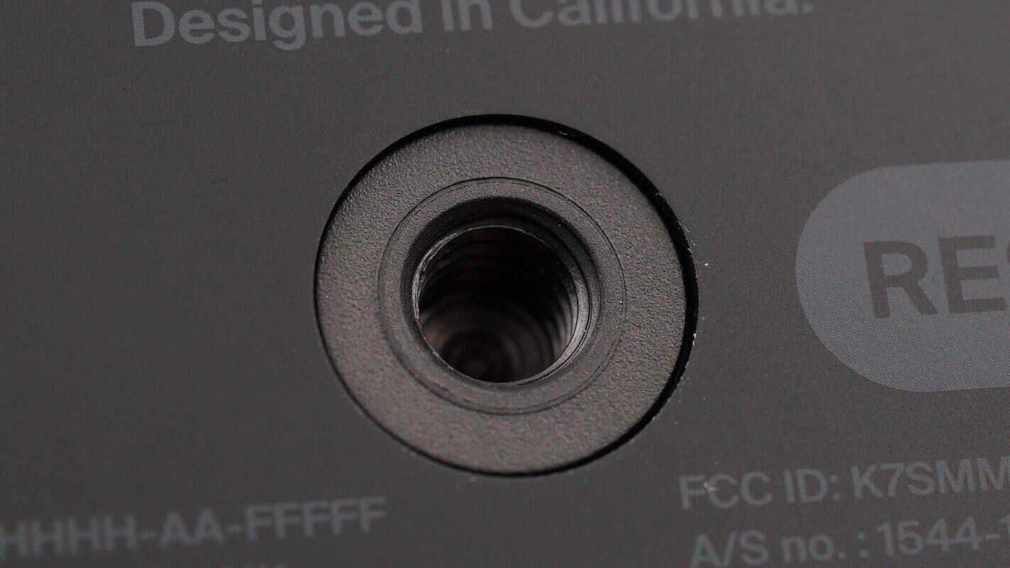

There is a standard 1/4-inch threaded nut at the center of the bottom, allowing it to be used with camera tripods and other mounts.

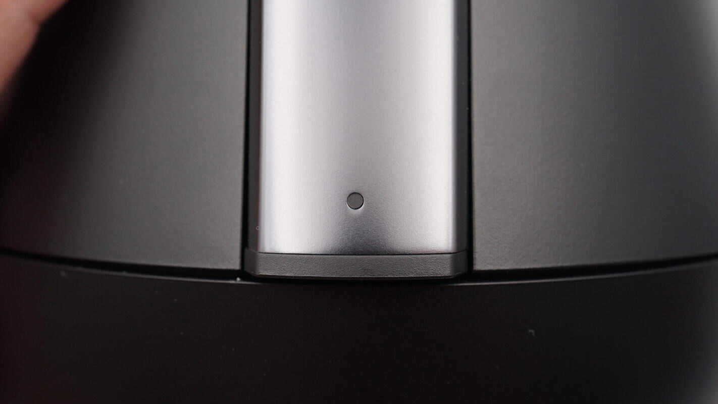

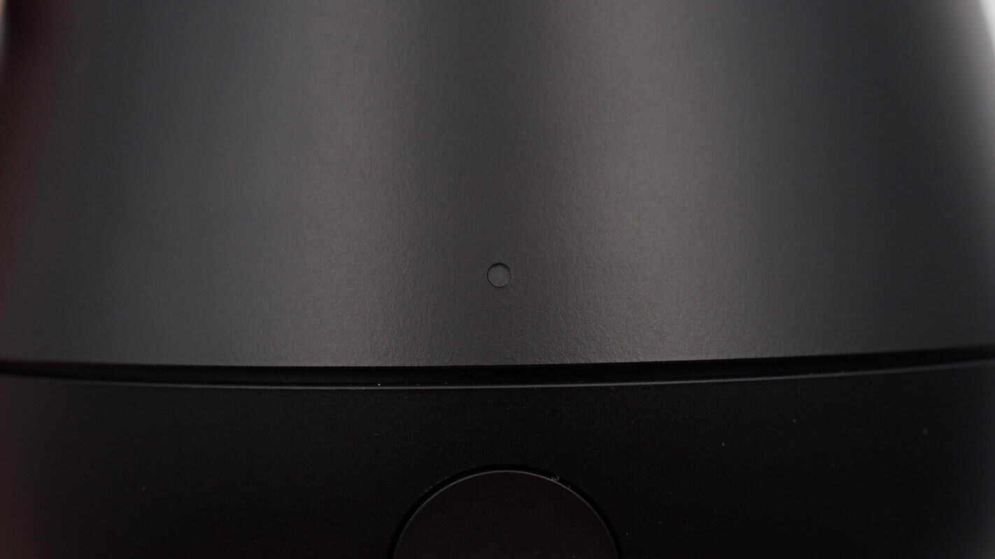

Indicator lights are designed on both the front and back of the base, allowing users to monitor the device status whether shooting from the front or rear.

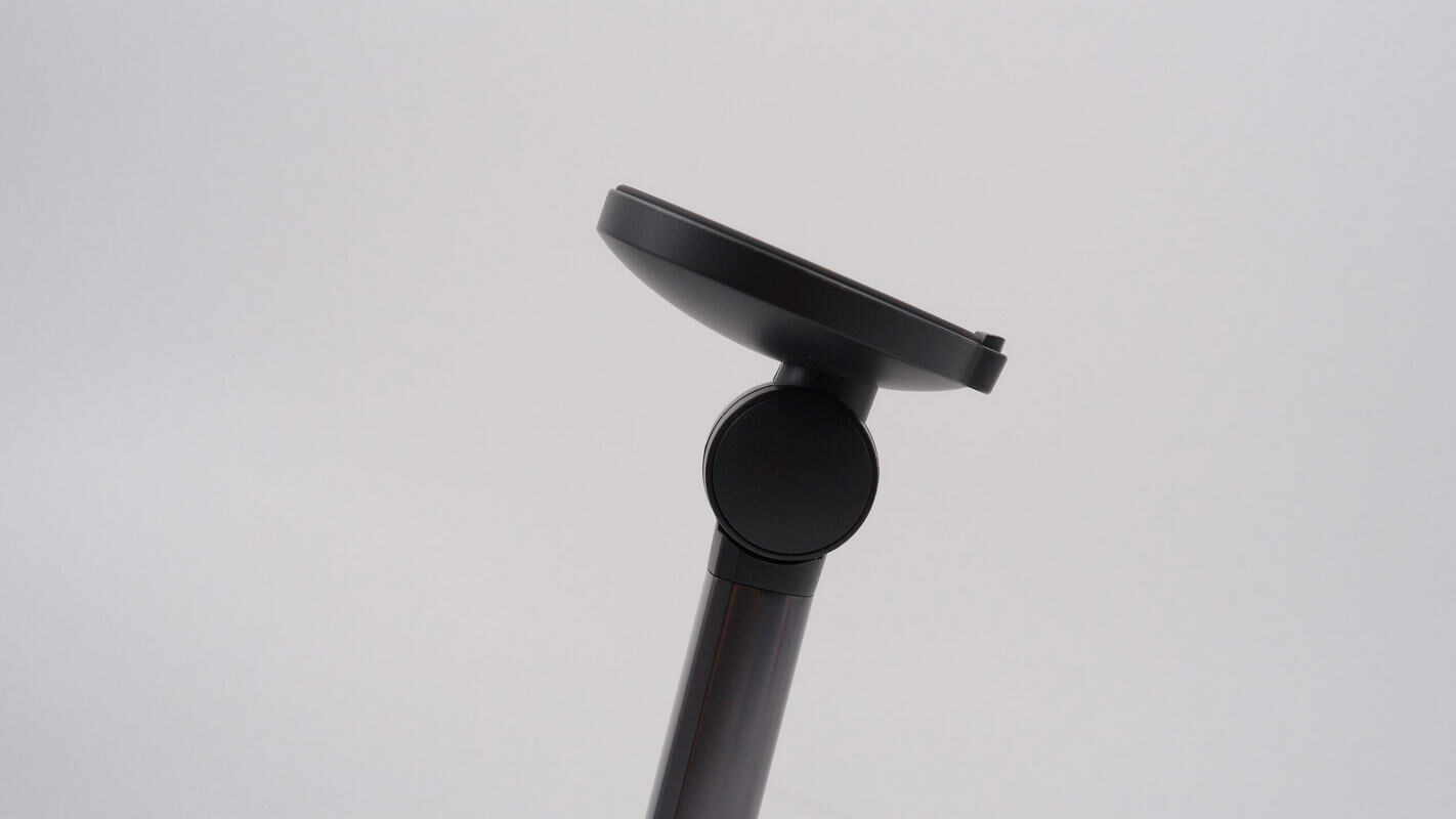

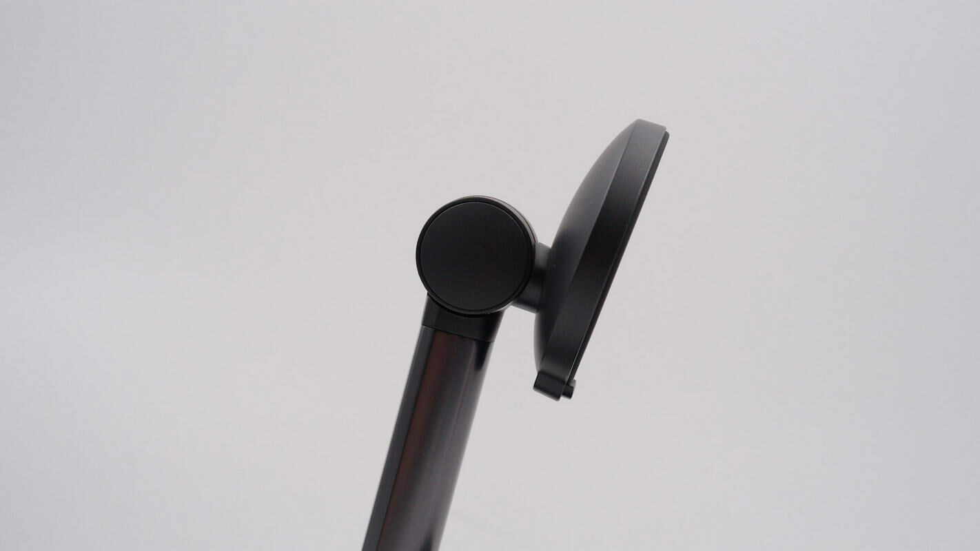

The wireless charging pad and support rod are connected with an adjustable joint.
The wireless charging pad supports 90° adjustment.

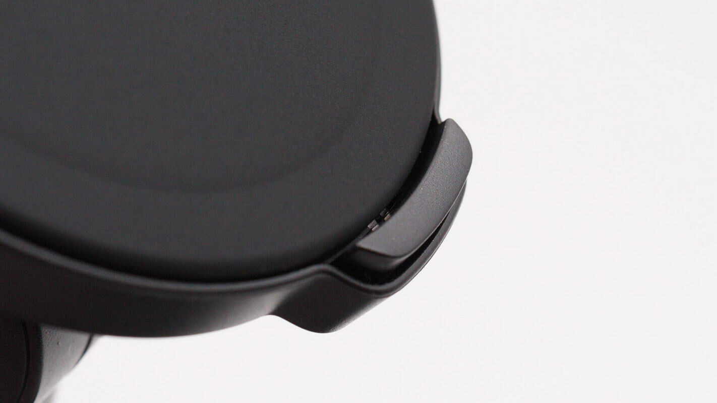

There is a touch-sensitive button located beneath the charging pad.

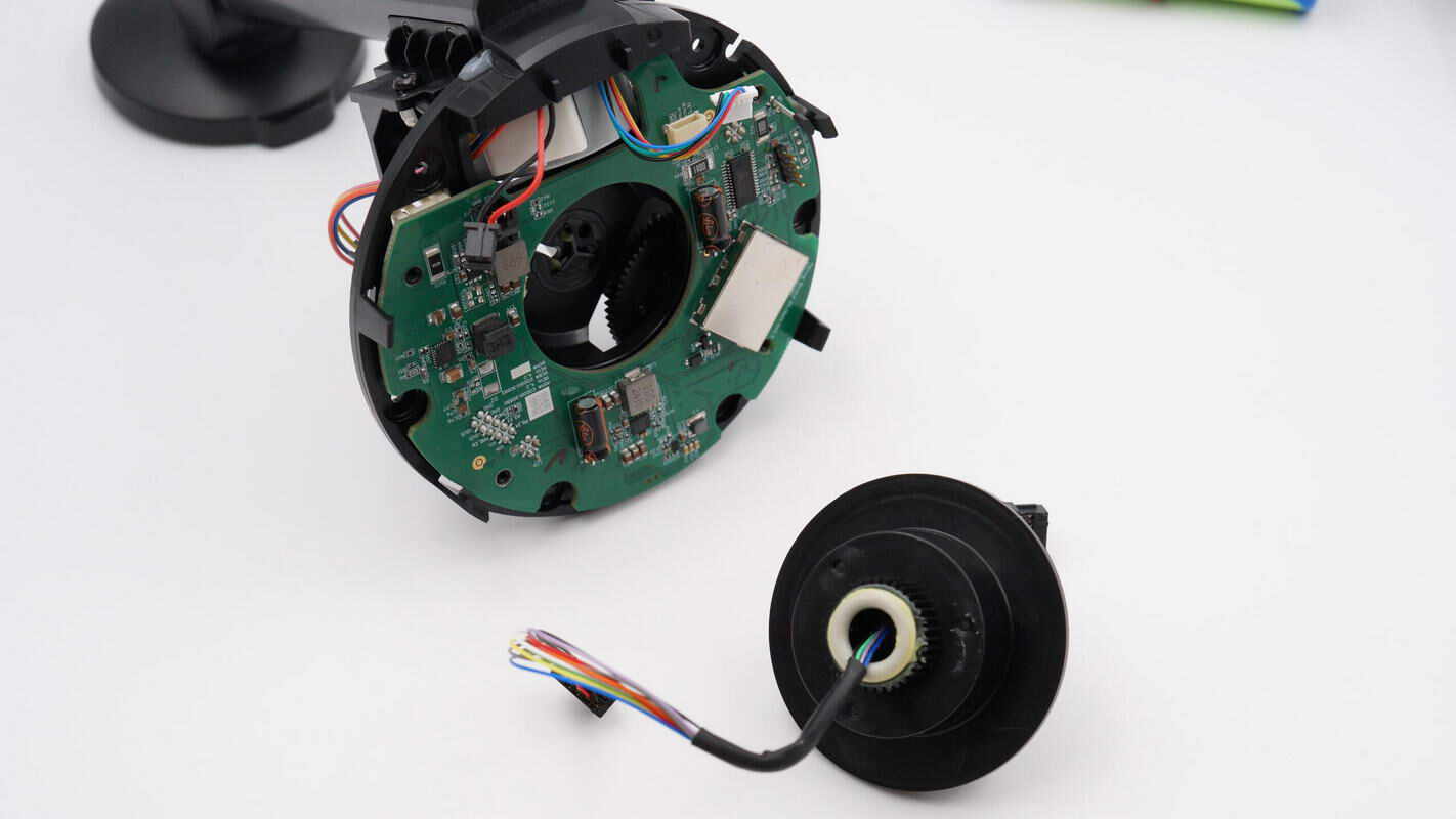

Remove the black PCB. On the other side, there is a connector slot for the slip ring wires.

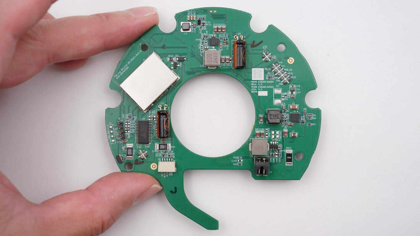

After removing the inner plastic casing, a green PCB is revealed inside.
The PCB is secured with screws, and a white sealing ring is positioned along the edge of the module.
Remove the top cover of the base to reveal a close-up view of the internal NFC antenna.

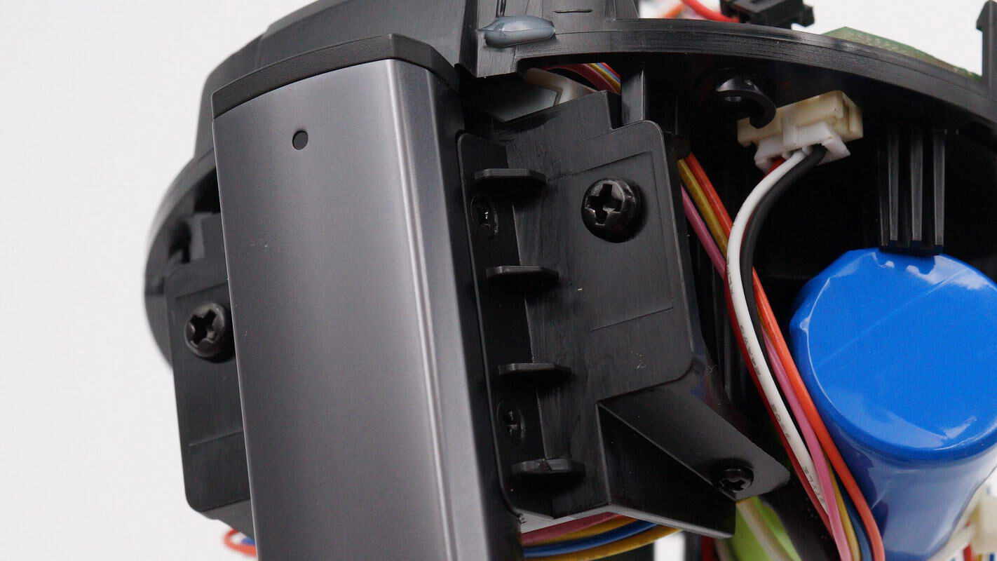

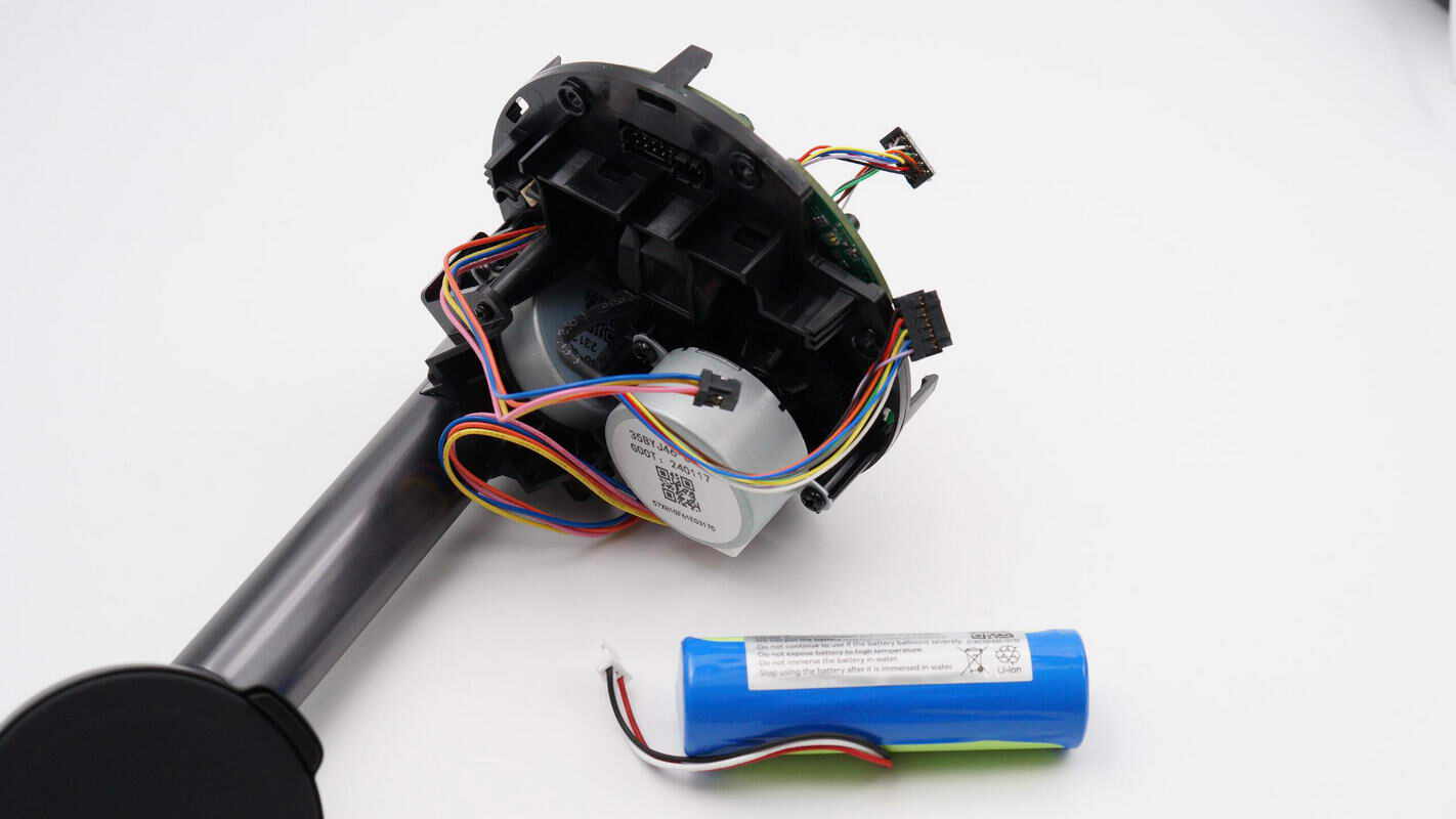

The module is connected to the support rod using screws.
At the top of the module, there is a battery and a motor. The motor is secured with screws, while the battery is fastened with two zip ties.
Remove the battery.

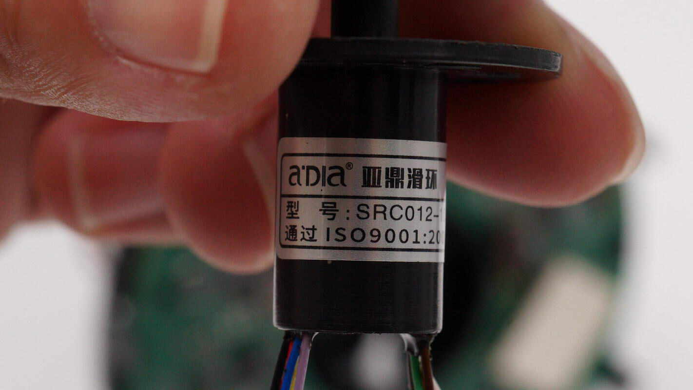

Remove the slip ring located at the center of the base.
Close-up view of the SRCO12 series miniature cap-type slip ring.

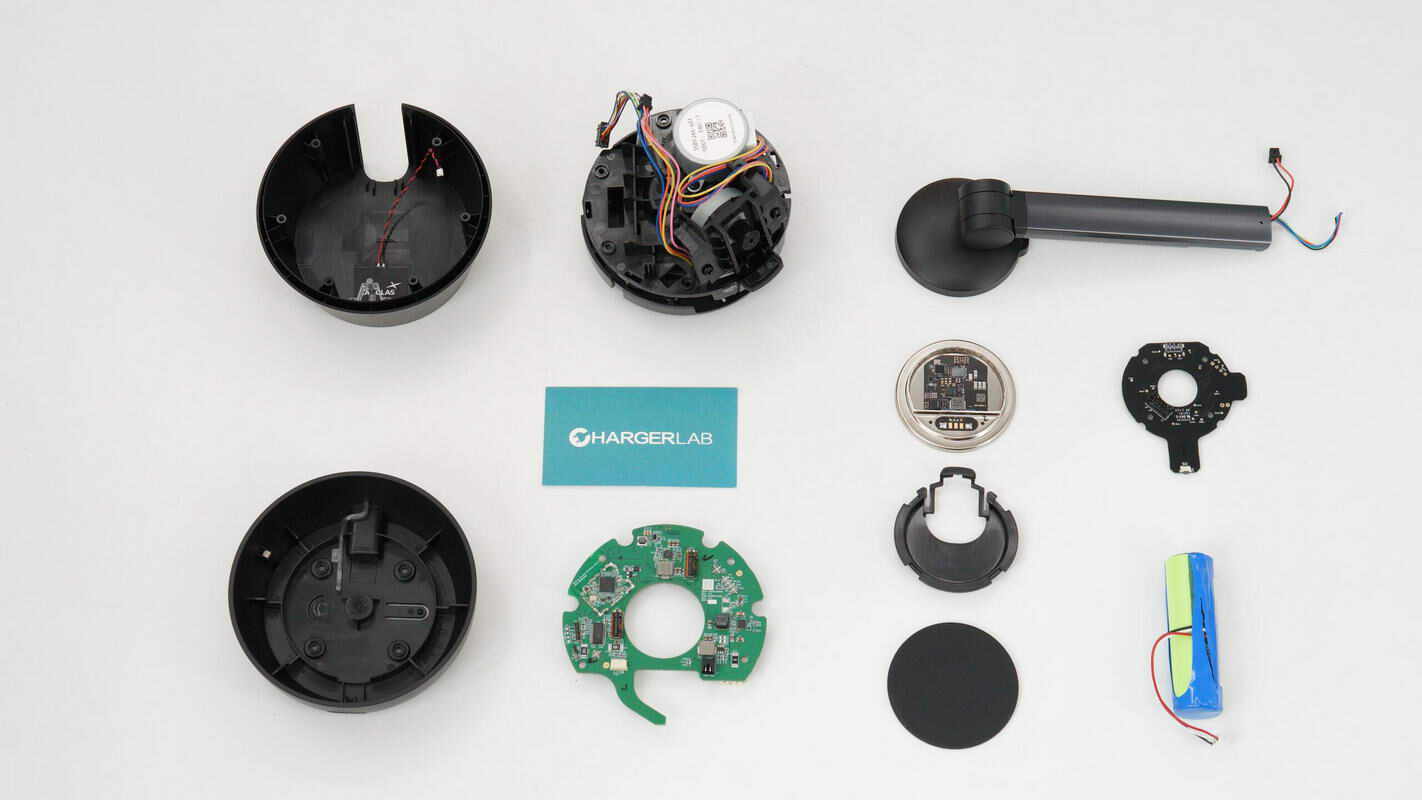

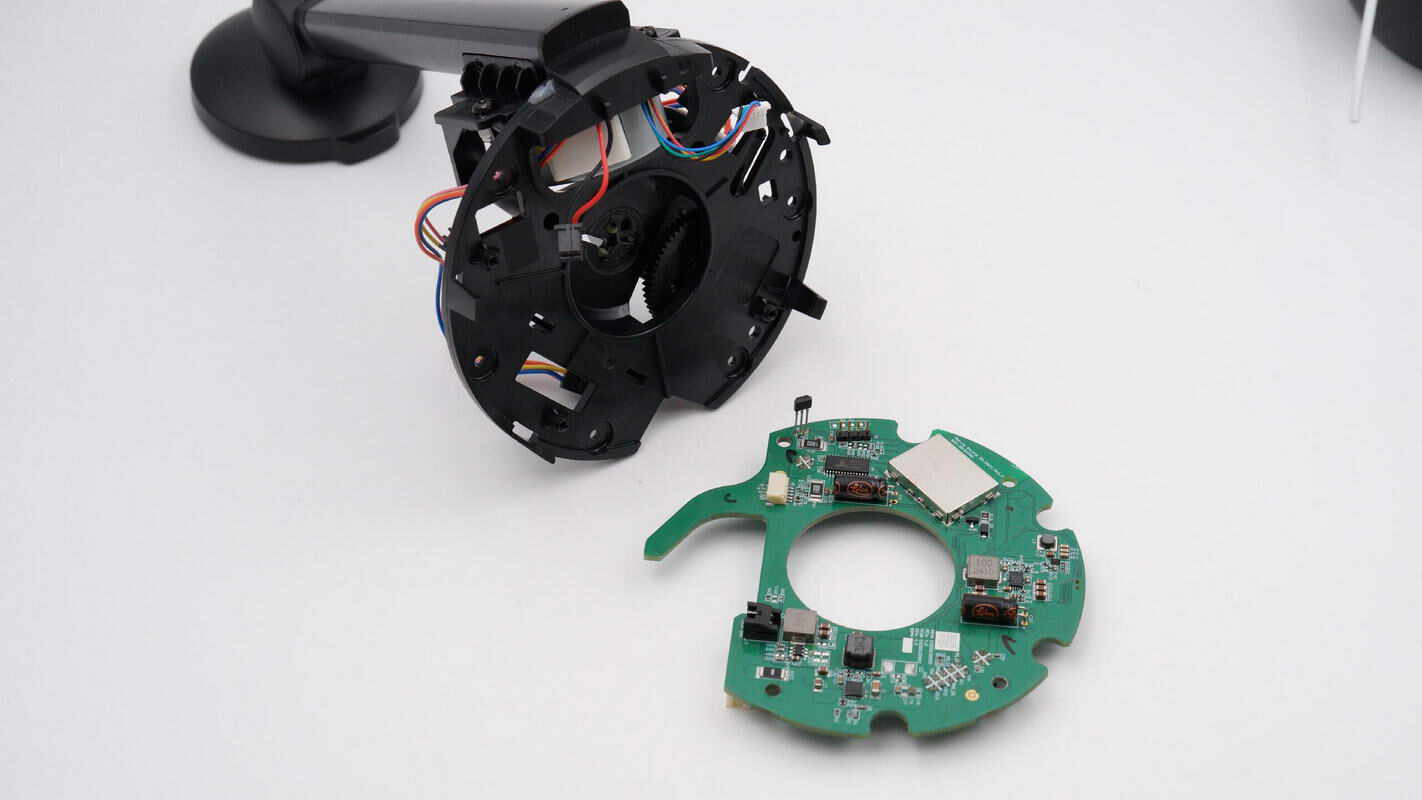

Remove the green PCB as well. The motor, MagSafe wireless charging module, and other components are connected to the green PCB via plug-in wire connectors.

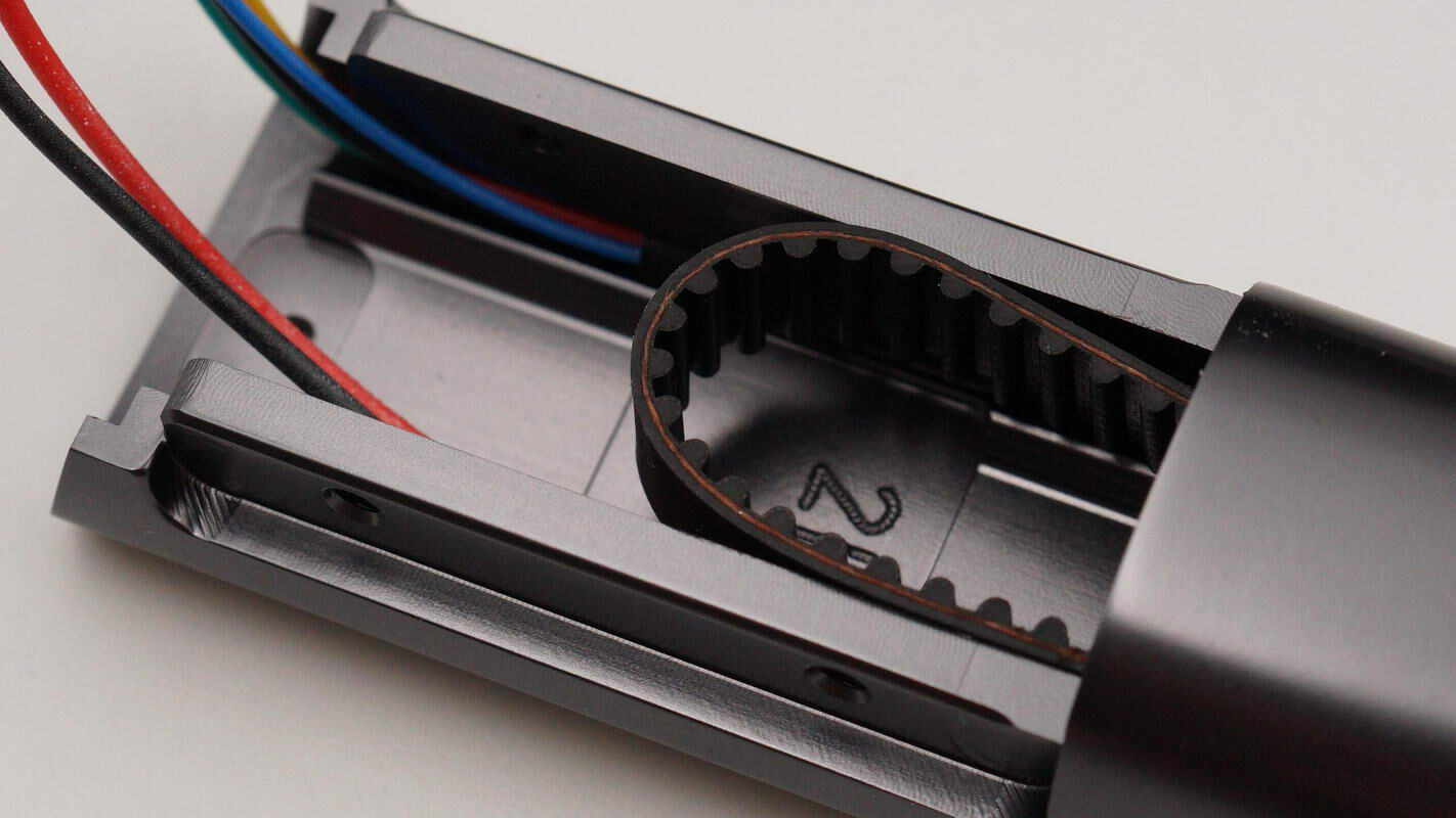

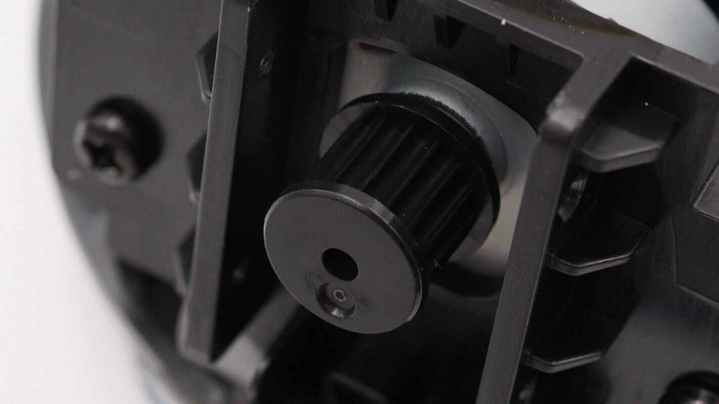

Separate the bottom module from the support rod. The module contains two motors that independently control rotation in the horizontal and vertical directions.
Close-up of the vertical control motor shaft.
Close-up of the timing belt inside the support rod.

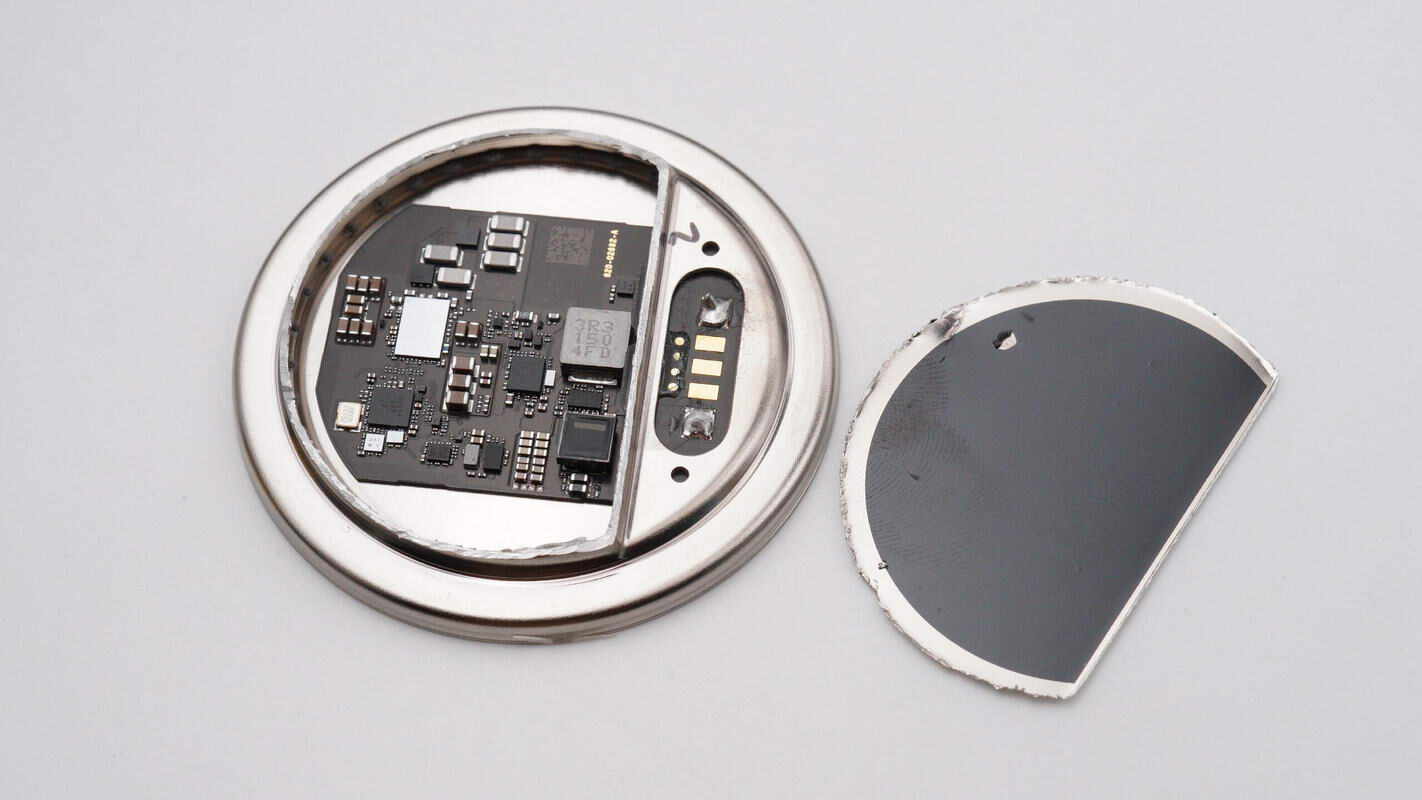

Remove the front plastic cover of the wireless charging pad.
The magnetic ring is composed of 16 curved small magnets.
Remove the magnetic charging module.
Separate the charging stand from the magnetic charging module.

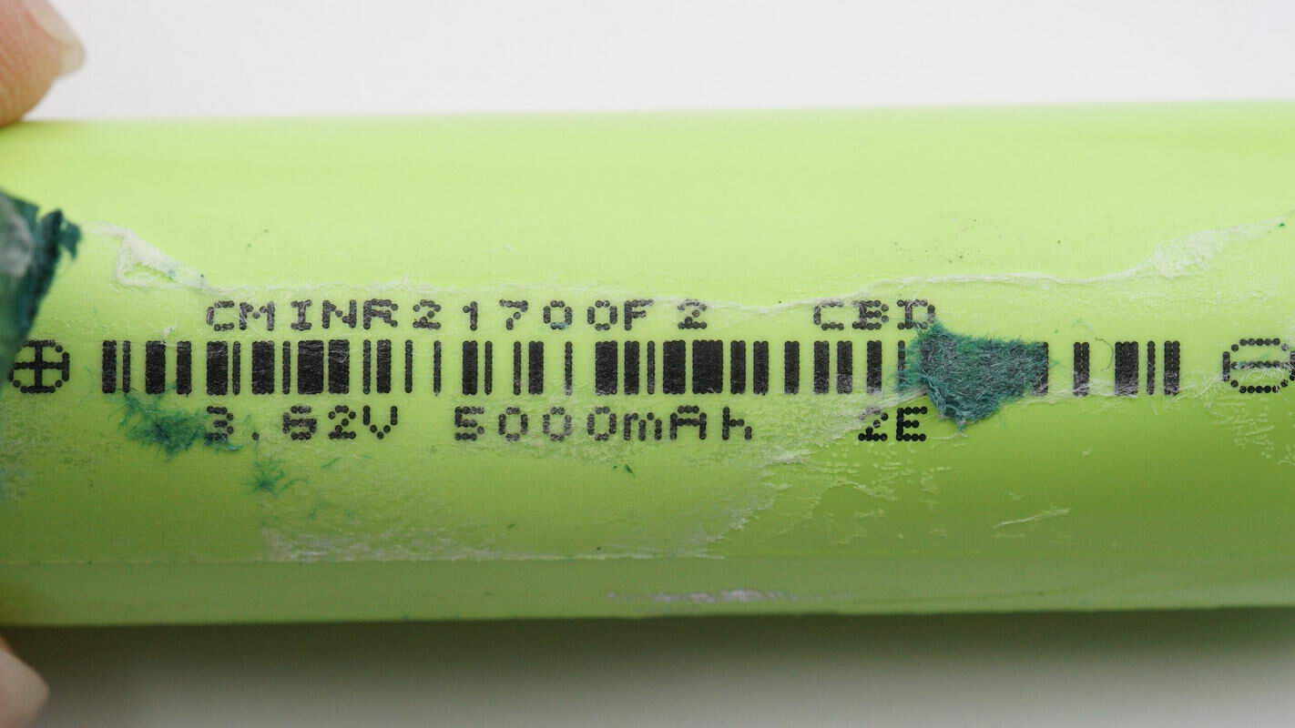

The battery model is CMINR21700F 2, with a nominal voltage of 3.62V and a capacity of 5000mAh.

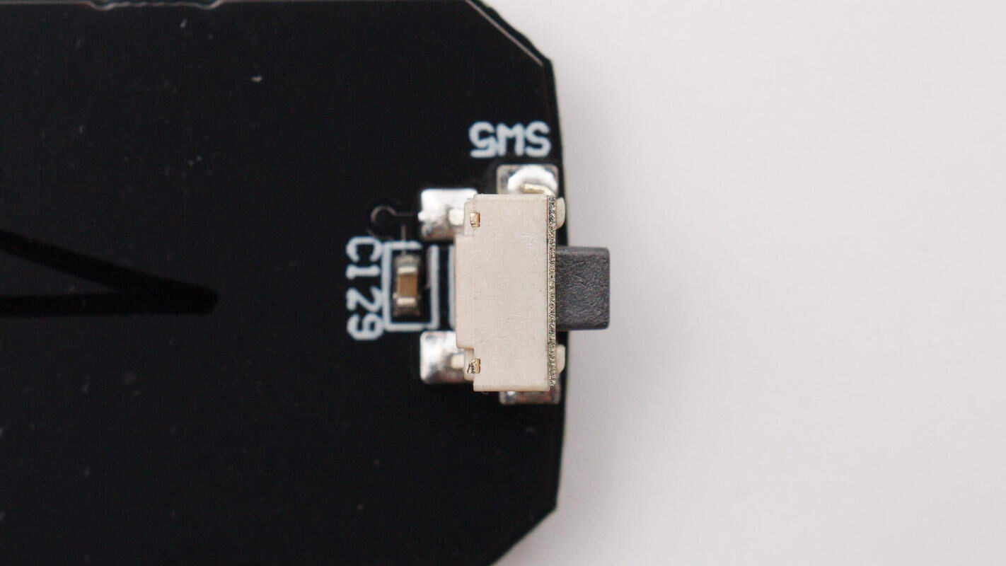

The front side of the black PCB features a USB-C socket, a protocol chip, a crystal oscillator, and a reset button.
The other side is equipped with the auto-tracking start/stop button and the slip ring connector slot.

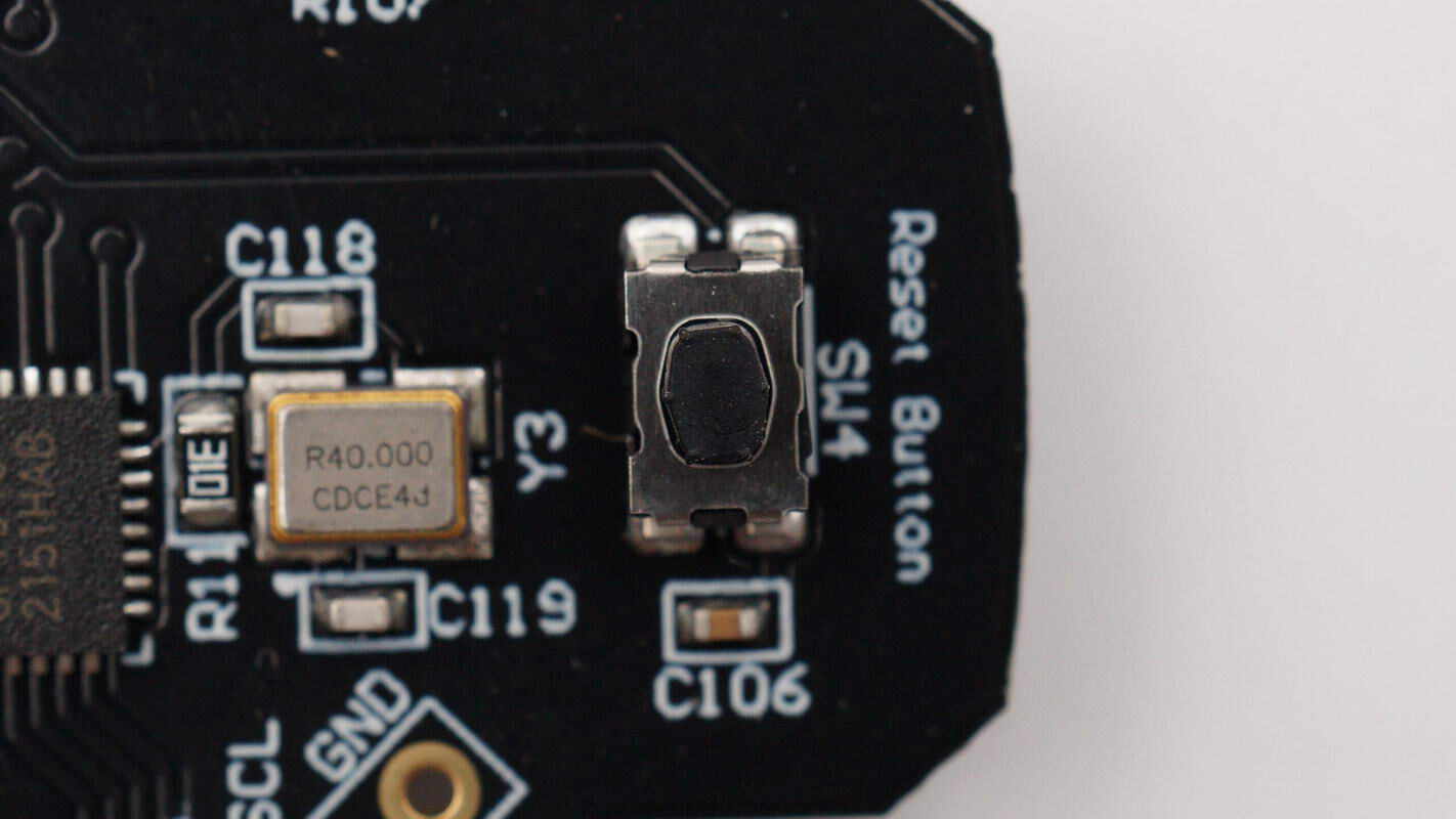

Close-up of the reset button.
Close-up of the auto-tracking start/stop button.

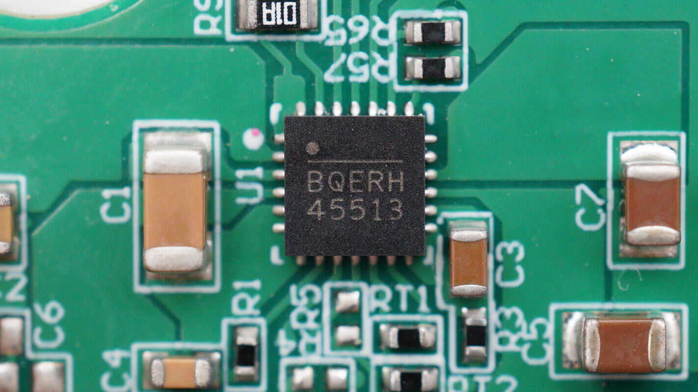

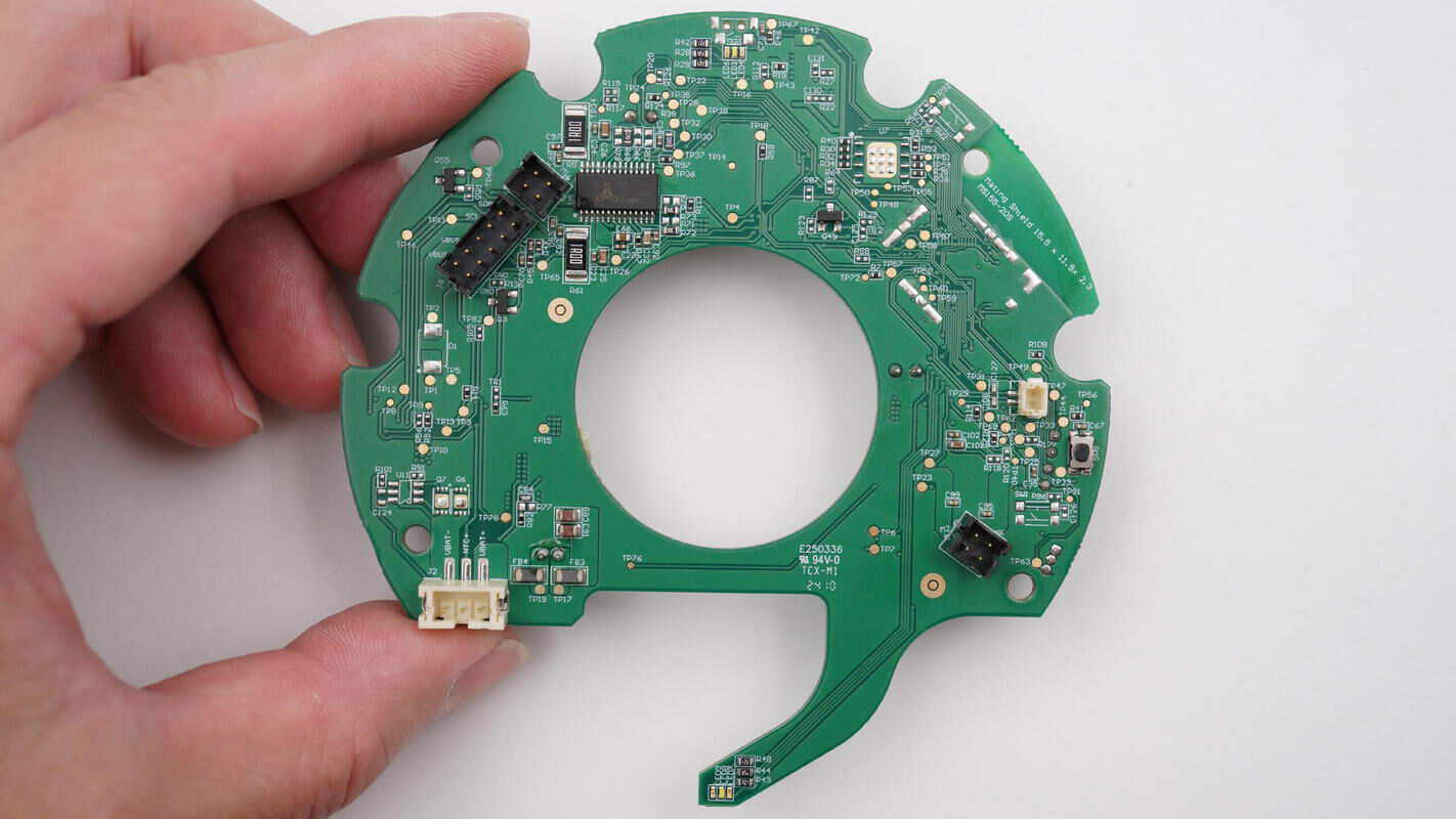

The front side of the green PCB features a motor driver chip, a synchronous boost converter, filtering capacitors, inductors, and other components. A shielding cover is located in the left section.
Remove the shielding cover to reveal a Bluetooth SoC.
The other side features another motor driver chip along with multiple connector slots.

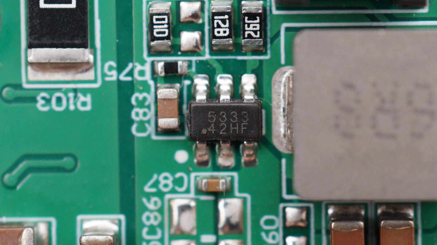

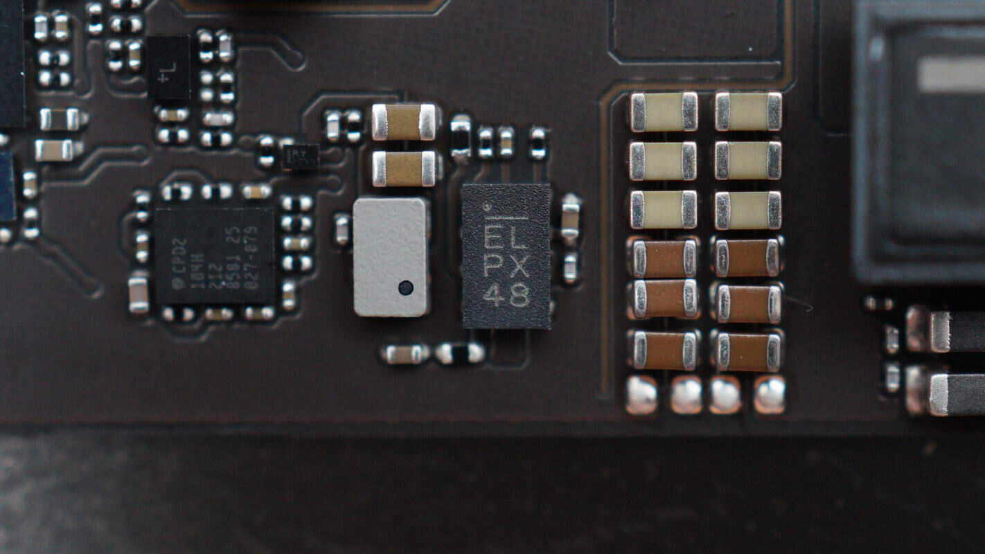

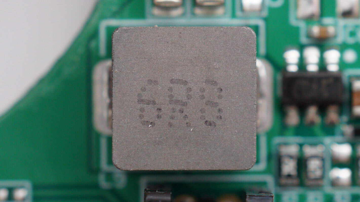

The MPS MP3432 is a 600kHz fixed-frequency, wide input range, highly integrated boost converter. It can start up with input voltages as low as 2.7V and, with its integrated low RDS(ON) power MOSFET, supports output power up to 30W from a single-cell battery. It comes in a QFN-13 (3mm x 4mm) package.
Close-up of the 10μH boost inductor.

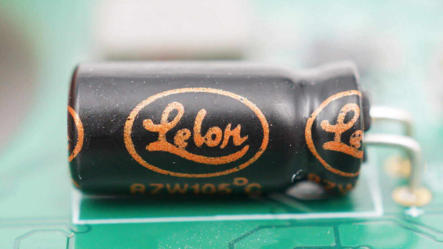

The filtering capacitor is manufactured by Lelon.
The capacitor is rated at 25V 47μF, and another capacitor on the board has the same part number.

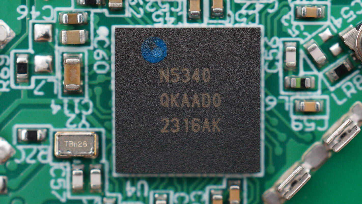

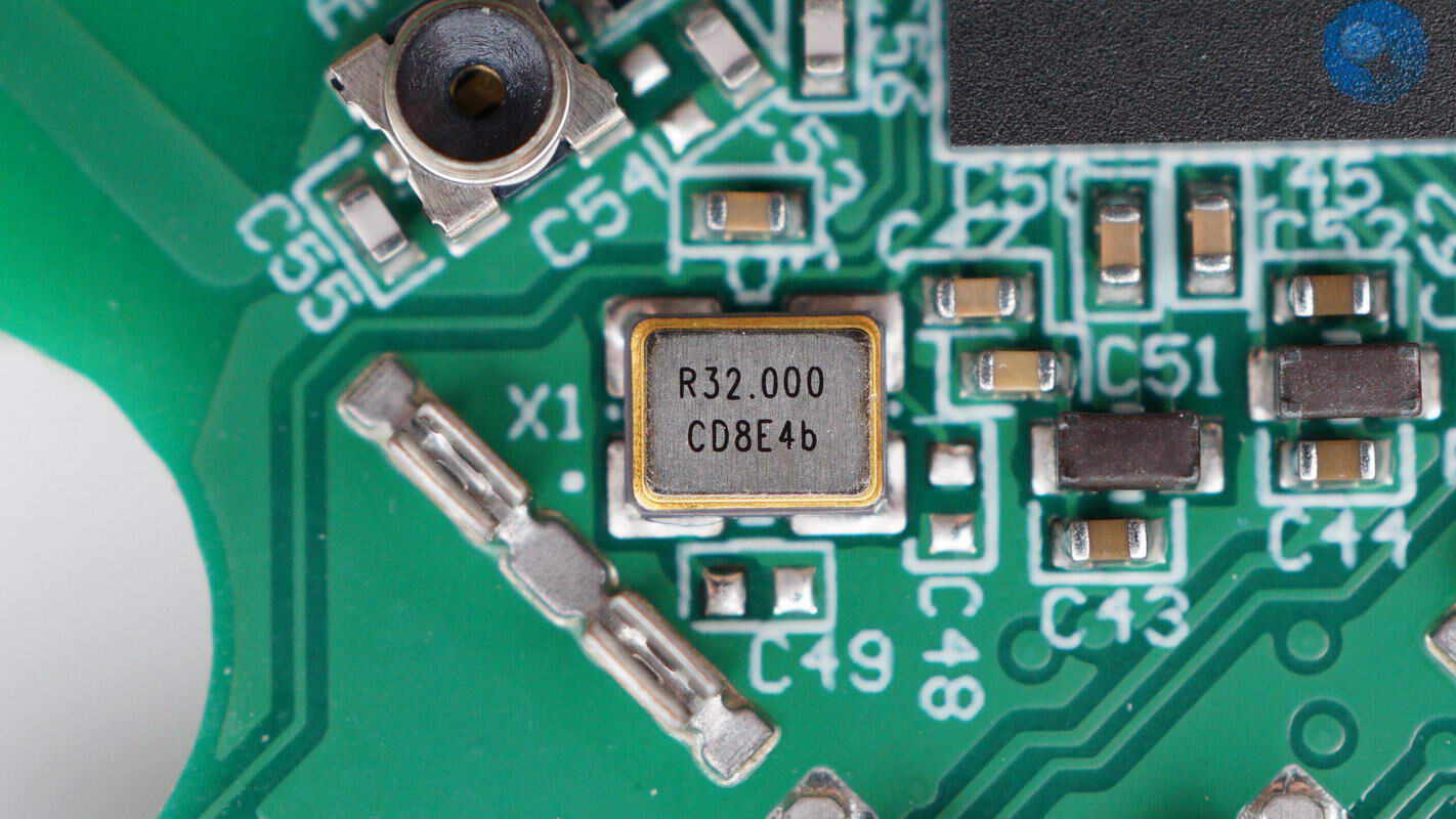

The Bluetooth SoC is from Nordic, model nRF5340. It is the world’s first wireless system-on-chip featuring dual Arm® Cortex®-M33 processors. The chip combines a dual flexible processor architecture with advanced features and supports operation up to 105°C. It comes in an AQFN-94 (7x7 mm) package and is an ideal solution for LE Audio streaming, professional lighting, high-end wearables, and other complex IoT applications.
Close-up of the 32.000 MHz clock crystal oscillator.

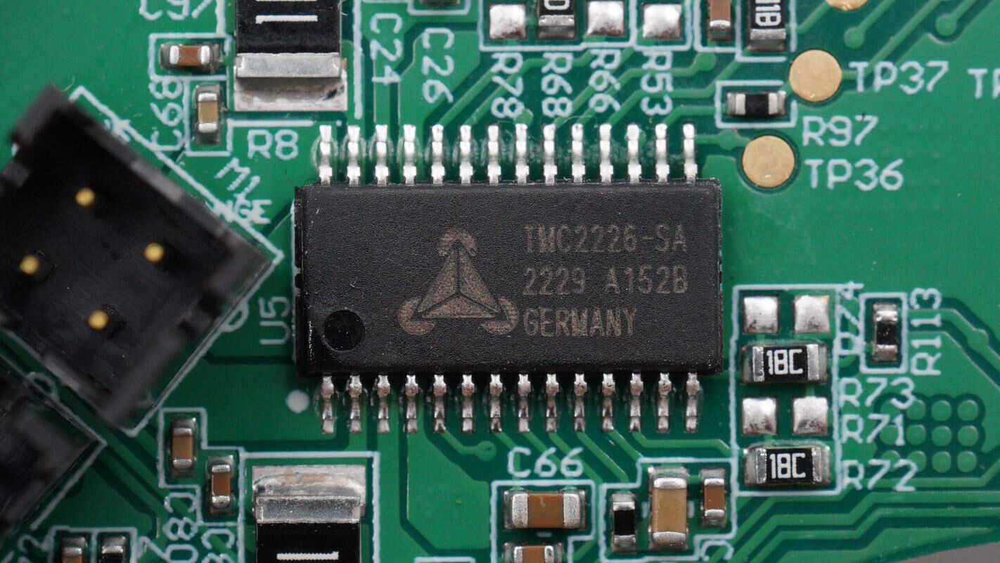

The motor driver chip is from Trinamic, model TMC2226-SA. It is an ultra-silent driver for two-phase stepper motors, featuring advanced StealthChop2 chopper technology for noiseless operation, maximum efficiency, and optimal motor torque. The integrated power MOSFETs can handle motor currents up to 2A RMS. The chip also includes multiple protection and diagnostic features to ensure stable and reliable performance.
The other motor driver chip is also a Trinamic TMC2226-SA.

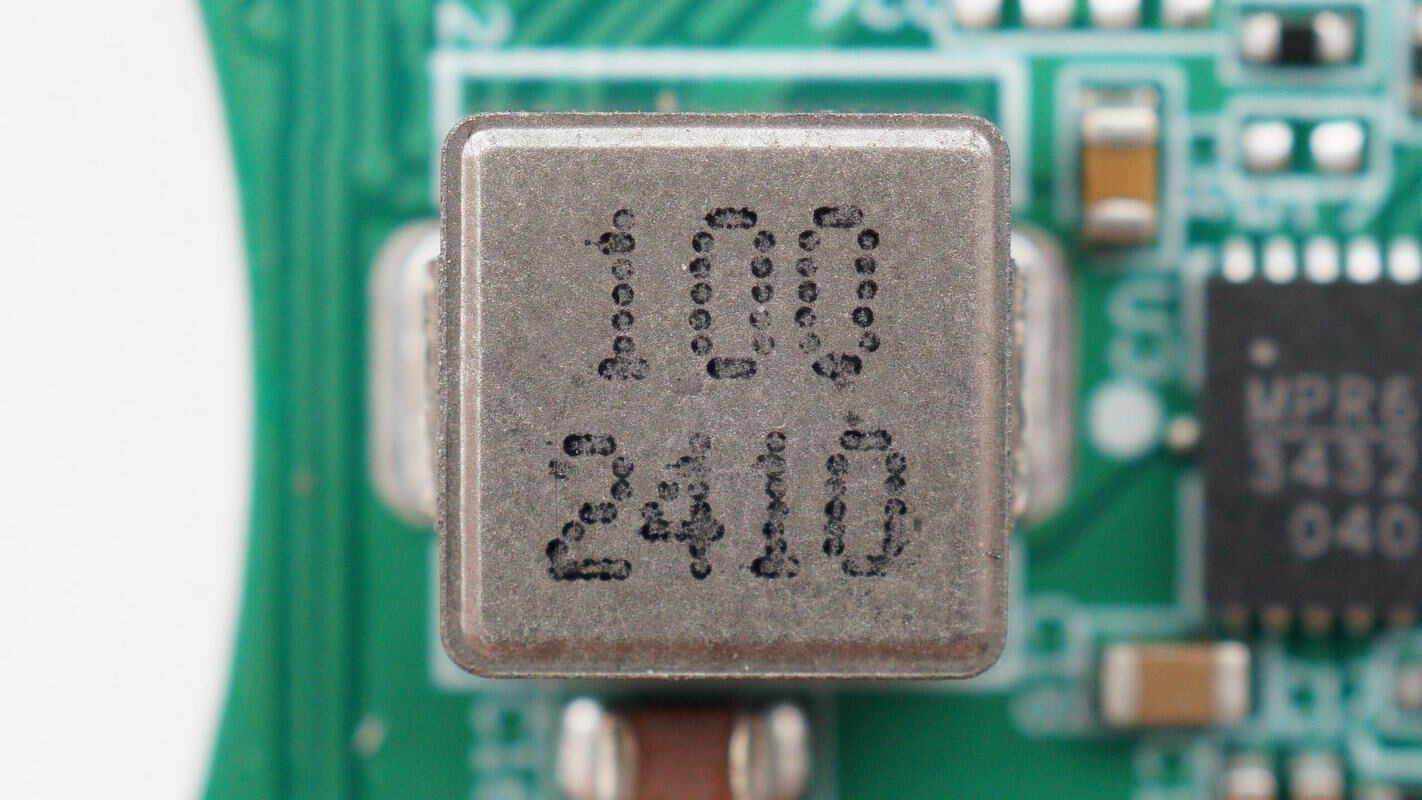

Close-up of the inductor.

There is also a voltage regulator chip marked with 5333, housed in a SOT-23-6 package.

Close-up of the 6.8μH alloy inductor.

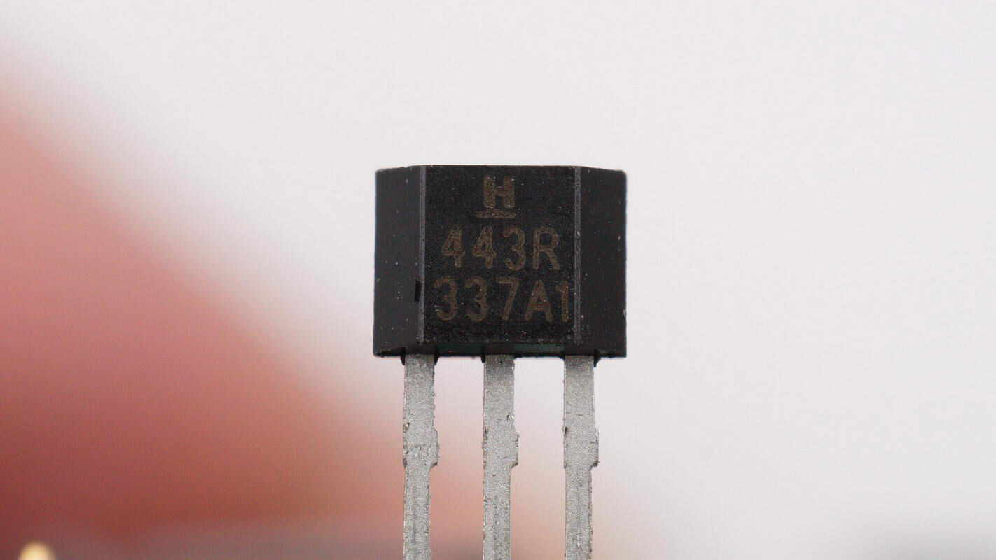

Close-up of a Hall effect sensor.

Close-up of an SMD tactile button.

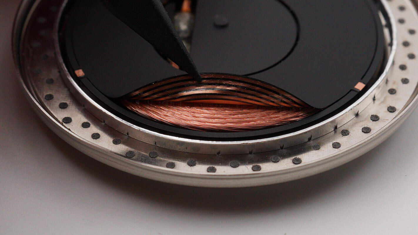

A sensing coil is attached to the wireless charging coil.

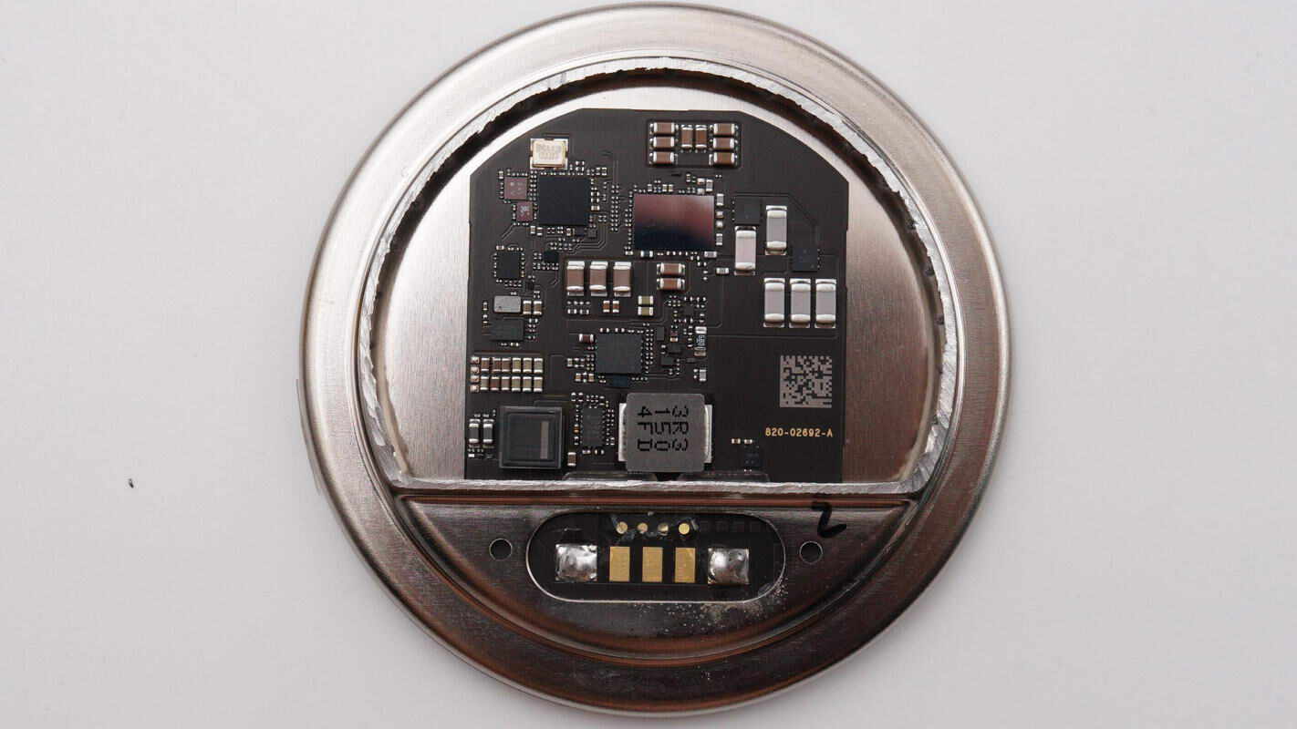

Cut open the metal casing on the back, revealing insulating paper attached to the inside.
The PCB has components only on the front side.

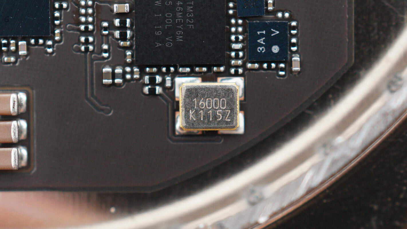

Next to it is a crystal oscillator that provides the clock signal for the master controller chip.

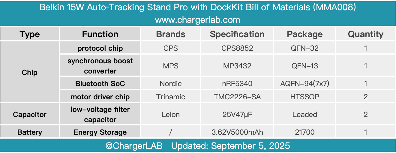

Here is the component list of the Belkin 15W Auto‑Tracking Stand Pro with DockKit for your convenience.

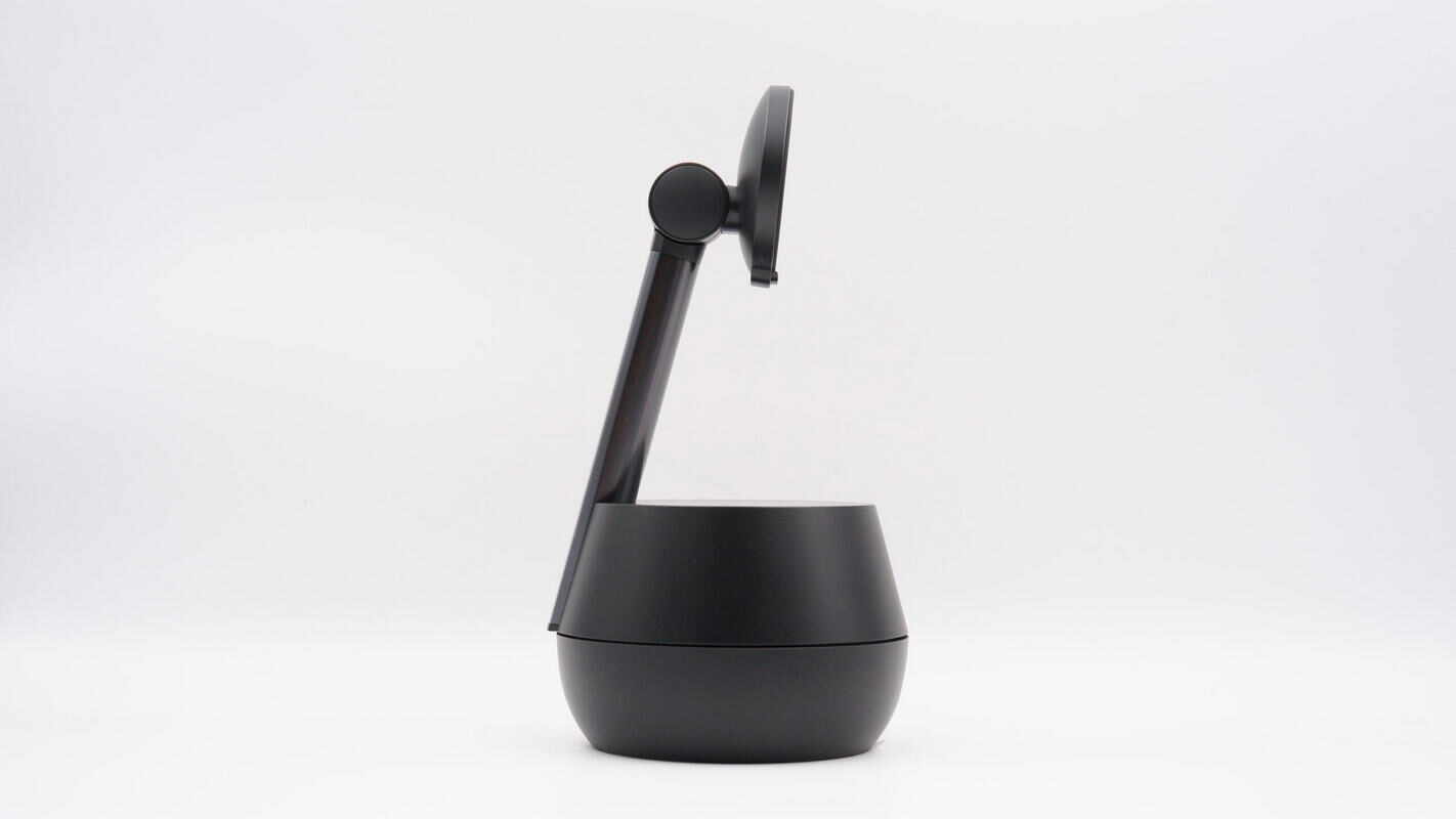

It continues Belkin’s signature minimalist design, made from renewable plastic materials that reflect a low-carbon, eco-friendly philosophy. The base and wireless charging pad support dynamic facial tracking with 360° horizontal and 90° vertical rotation. Simply bring your phone close to connect, with support for Apple Watch camera control. Powered by Apple’s DockKit facial tracking technology, it enables impressive results even when shooting solo.
It functions both as an auto-tracking gimbal and a wireless charging stand. The bottom features a standard 1/4-inch threaded nut, allowing it to be mounted on camera tripods and other supports. Notably, to provide 15W wireless charging for your phone, the device must be connected to a power source; the built-in battery is solely for powering the auto-tracking function.

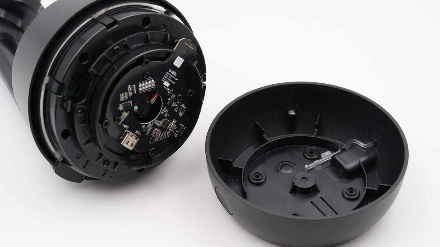

After taking it apart, we found that the internal PCB connects to the motor, slip ring, battery, and other components via plug-and-play connectors. It uses the CPS CPS8852 protocol chip for input control, the MPS MP3432 boost converter for charging, the Nordic nRF5340 for Bluetooth connectivity, and Trinamic TMC2226-SA motor driver chips to drive the motors.
