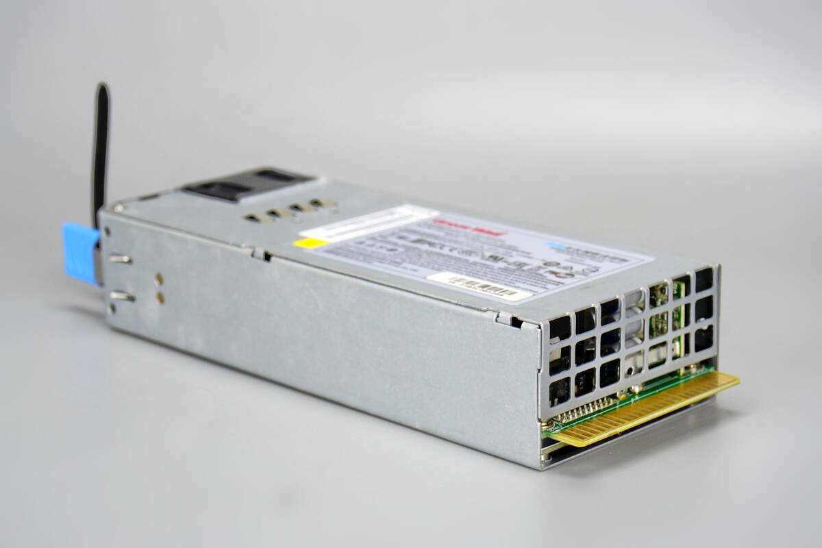

We recently acquired the GreatWall GW-CRPS550 Platinum server power supply. This unit supports a wide input voltage range of 100-240V and provides a 12V output voltage with a current rating of 45A. The standby power output is also 12V at 3A, delivering a total rated output power of 550W.
The power supply module features a cooling fan, power socket, and indicator light on the input side, while the output side is equipped with a gold finger connector. Internally, it utilizes a PFC+LLC architecture and supports PMBus communication. Next, we will perform a teardown of this power supply module to take a closer look at its internal design and component quality.
Teardown of GreatWall 550W 80 PLUS Platinum SiC Server Power Supply (GW-CRPS550)-Chargerlab
The power supply’s metal casing is secured with screws.
The other side is secured by clips.
Model: GW-CRPS550
AC Input: 100-240V\~ 7-3.5A 60/50Hz
DC Output: +12V 45A, +12VSB 3A
Rated Output Power: 550W

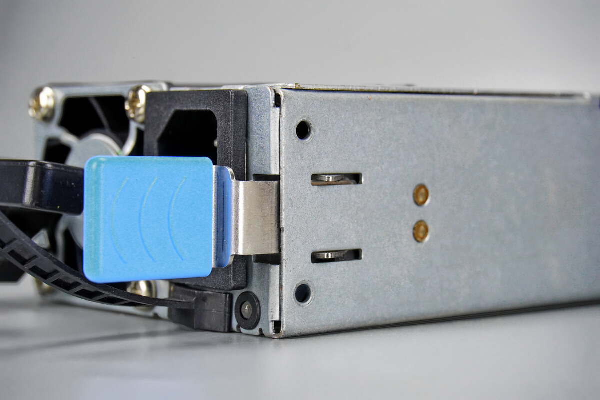

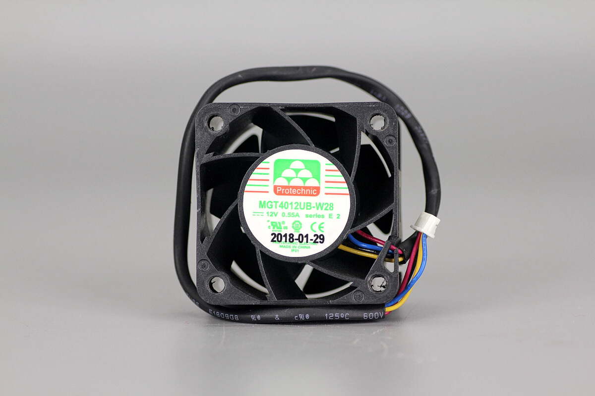

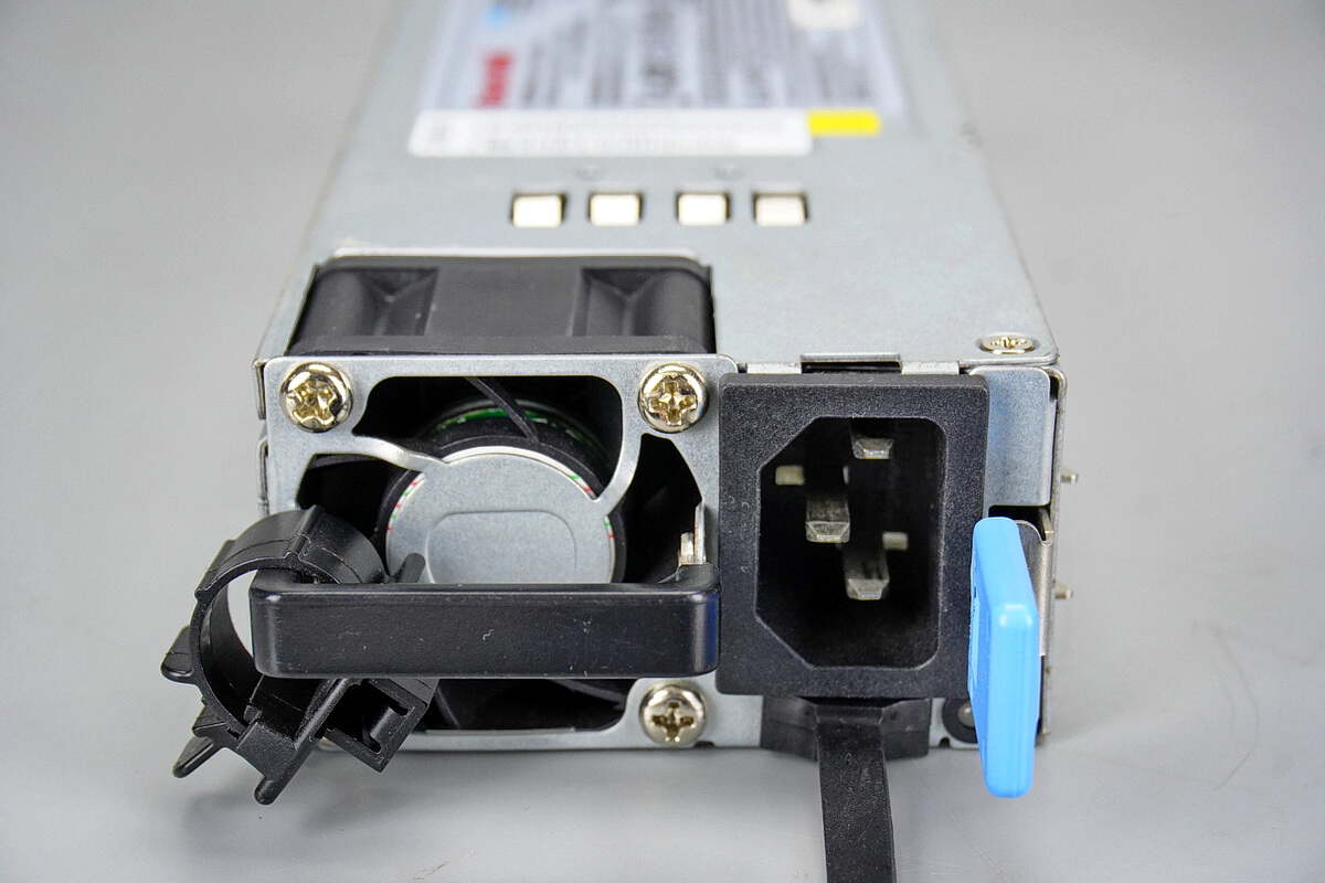

The input side is equipped with a handle, cooling fan, cable tie, release latch, C14 power inlet, and indicator light.
The indicator light is used to show the power supply’s operating status.
The release latch is used to secure the power supply module.

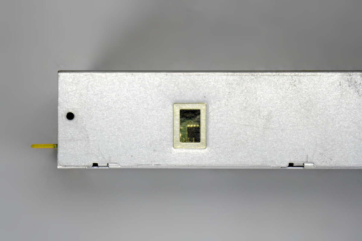

A plastic insulating sheet is attached to the opening of the casing.

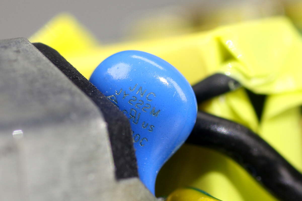

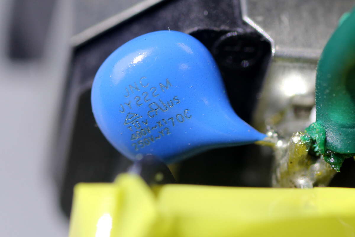

The blue Y capacitor is manufactured by JYA-NAY.
The other Y capacitor has the same specifications.

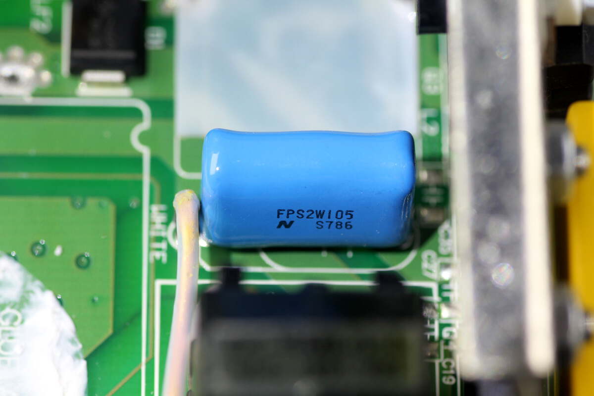

The safety X2 capacitor has a specification of 1 μF.

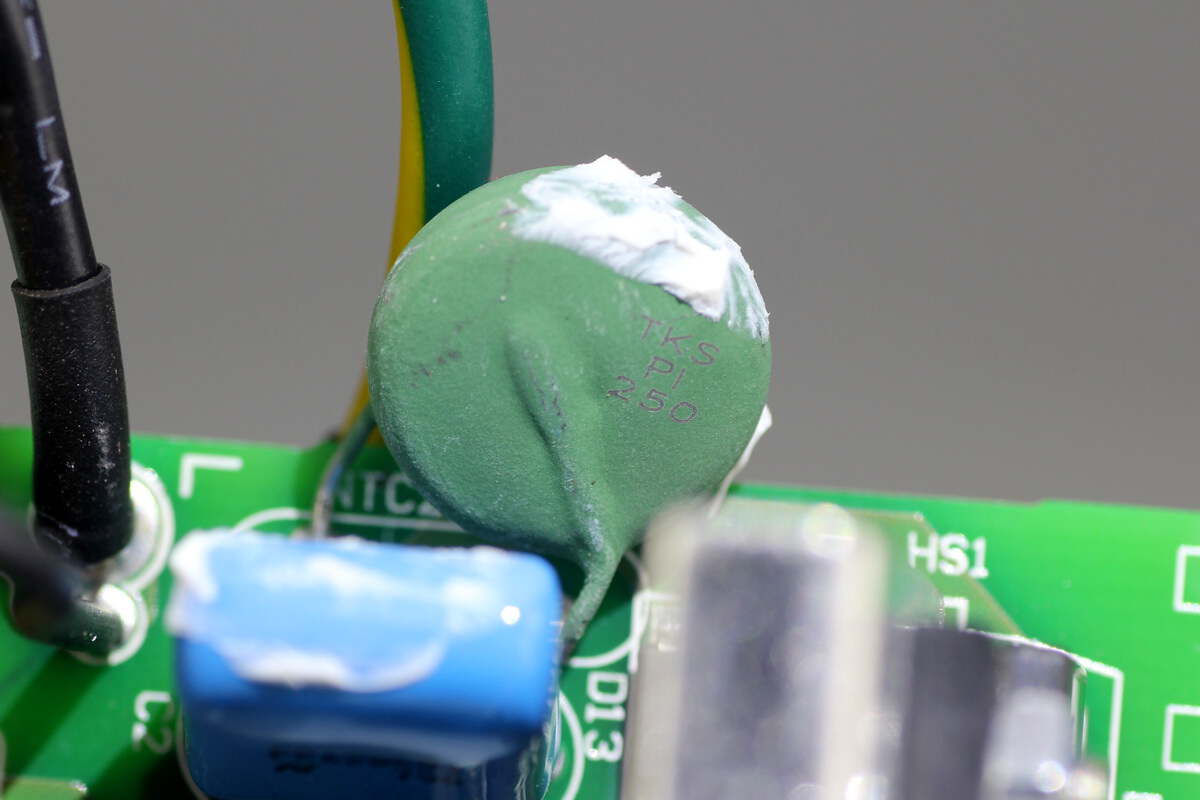

The NTC thermistor is manufactured by Thinking and is marked with "PI 250".

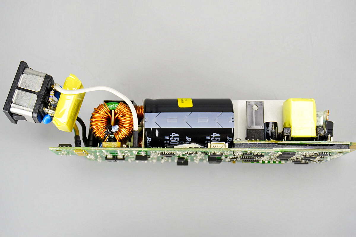

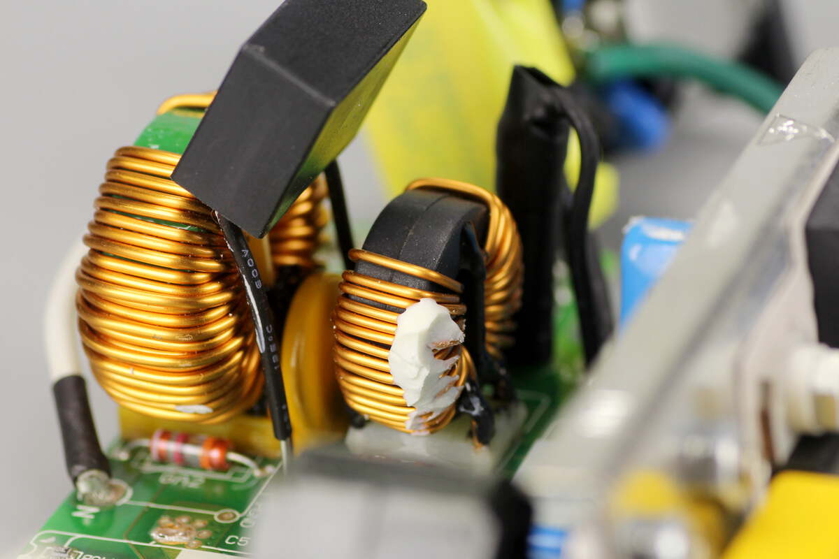

On the side of the PCBA module are the common mode choke, high-voltage filter capacitor, standby power controller IC, and standby power transformer.
The common mode choke is wound with enameled wire and has a bakelite insulation plate at the bottom.
The safety X2 capacitor has a specification of 0.47 μF.
Below the capacitor are a varistor and the common mode choke.

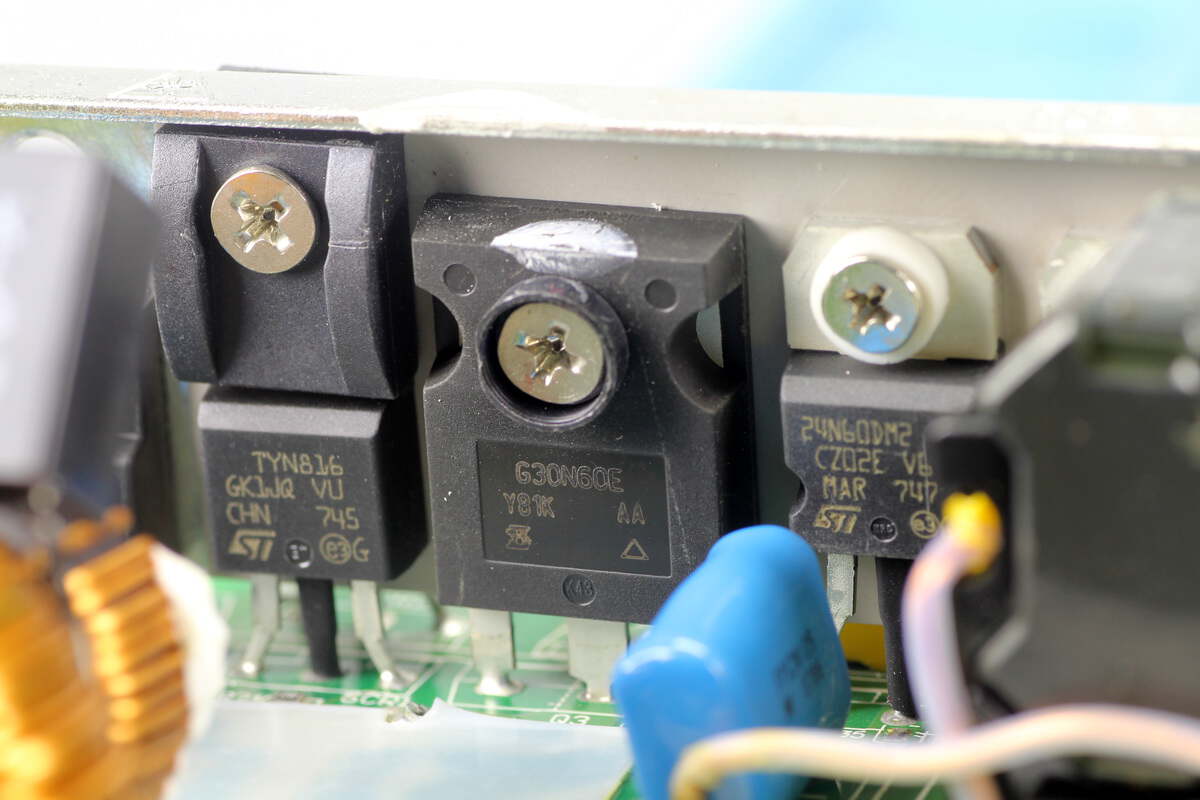

The heatsink houses the rectifiers, thyristors, PFC MOSFETs, PFC rectifier, and LLC MOSFETs.

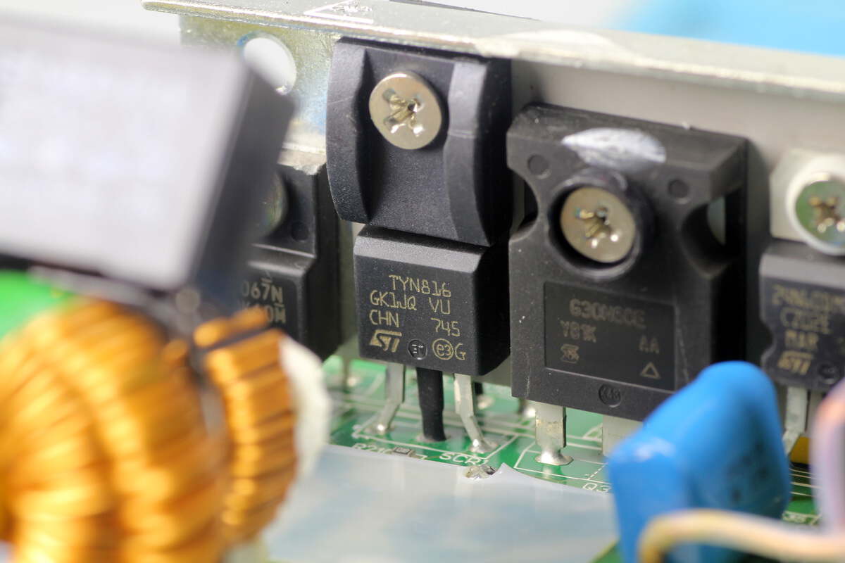

The thyristor is from STMicroelectronics, model TYN816, rated 16A 800V, and comes in a TO-220AB package.
The other thyristor has the same model.

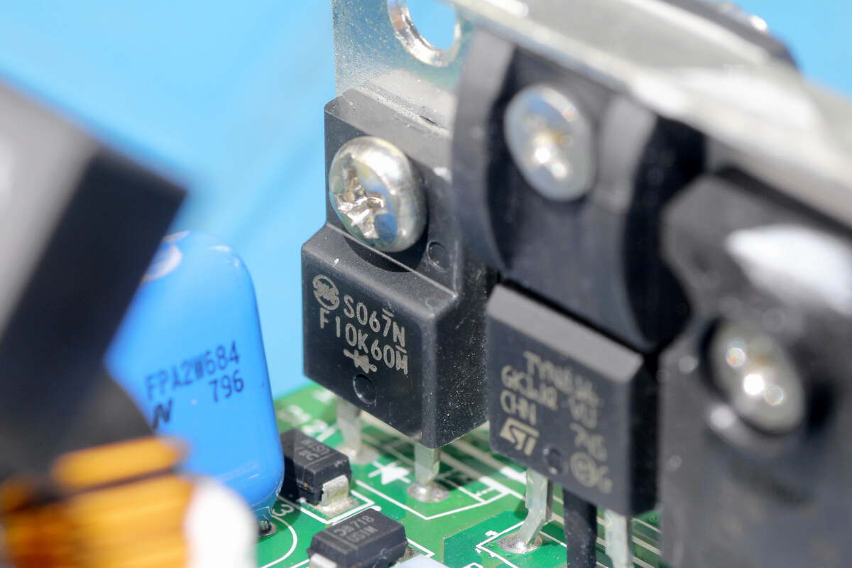

The fast recovery diode is from Shindengen, model SF10K60M, rated 600V 10A, and uses an FTO-220AG package.
The other fast recovery diode has the same model.

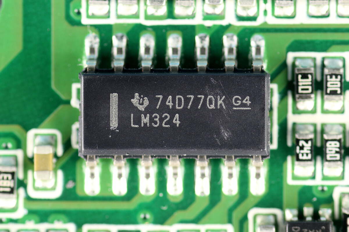

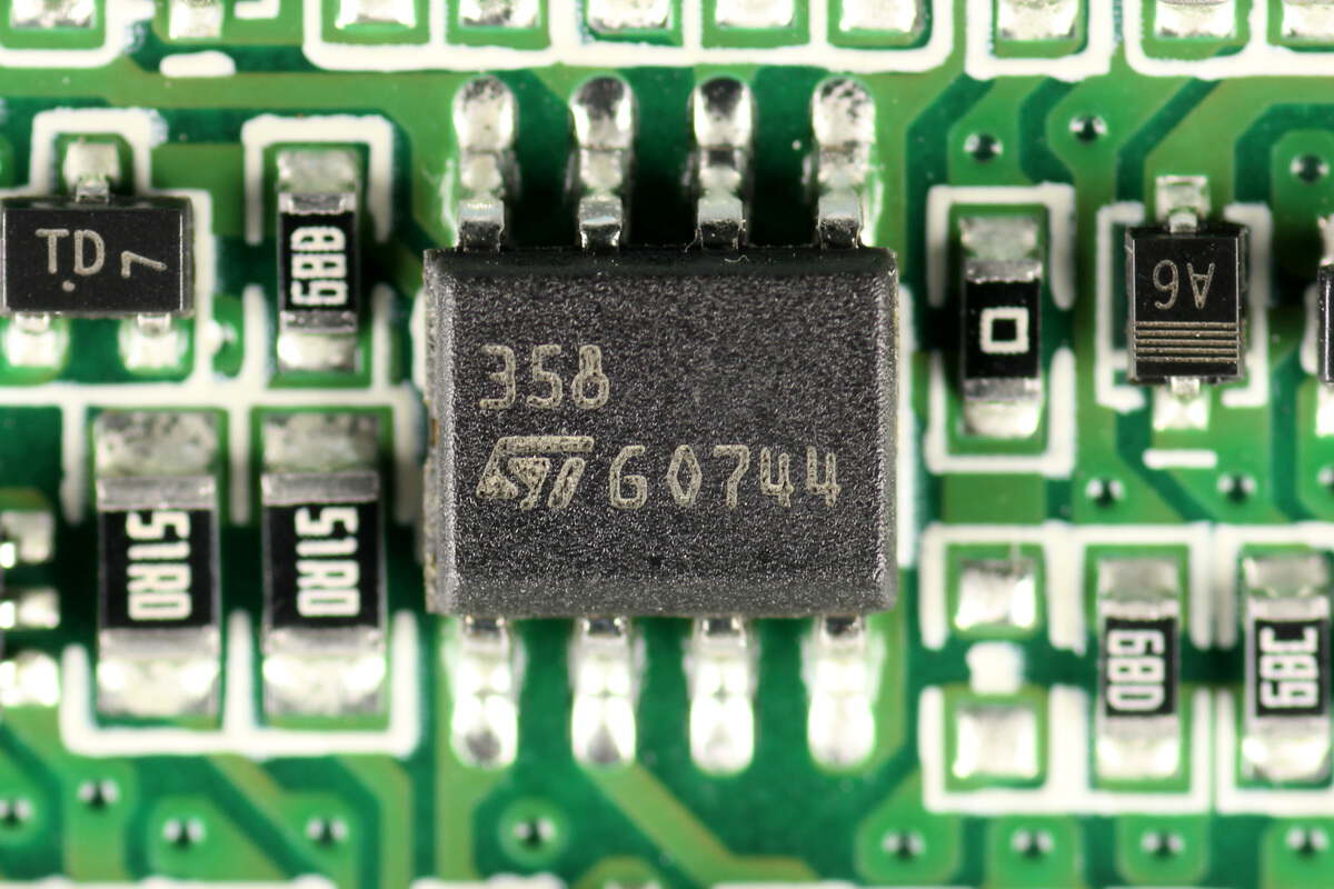

The operational amplifier is from TI, model LM258A. It is an industry-standard dual op-amp, rated for operation between -20°C and 85°C, and comes in an SOIC-8 package.

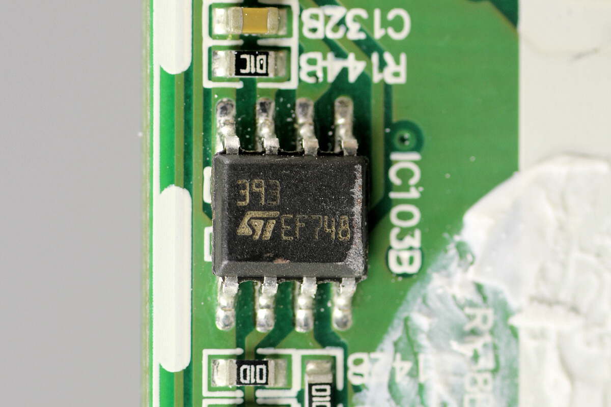

The voltage comparator is from STMicroelectronics, model LM393. It is a dual low-power voltage comparator and comes in an SO-8 package.

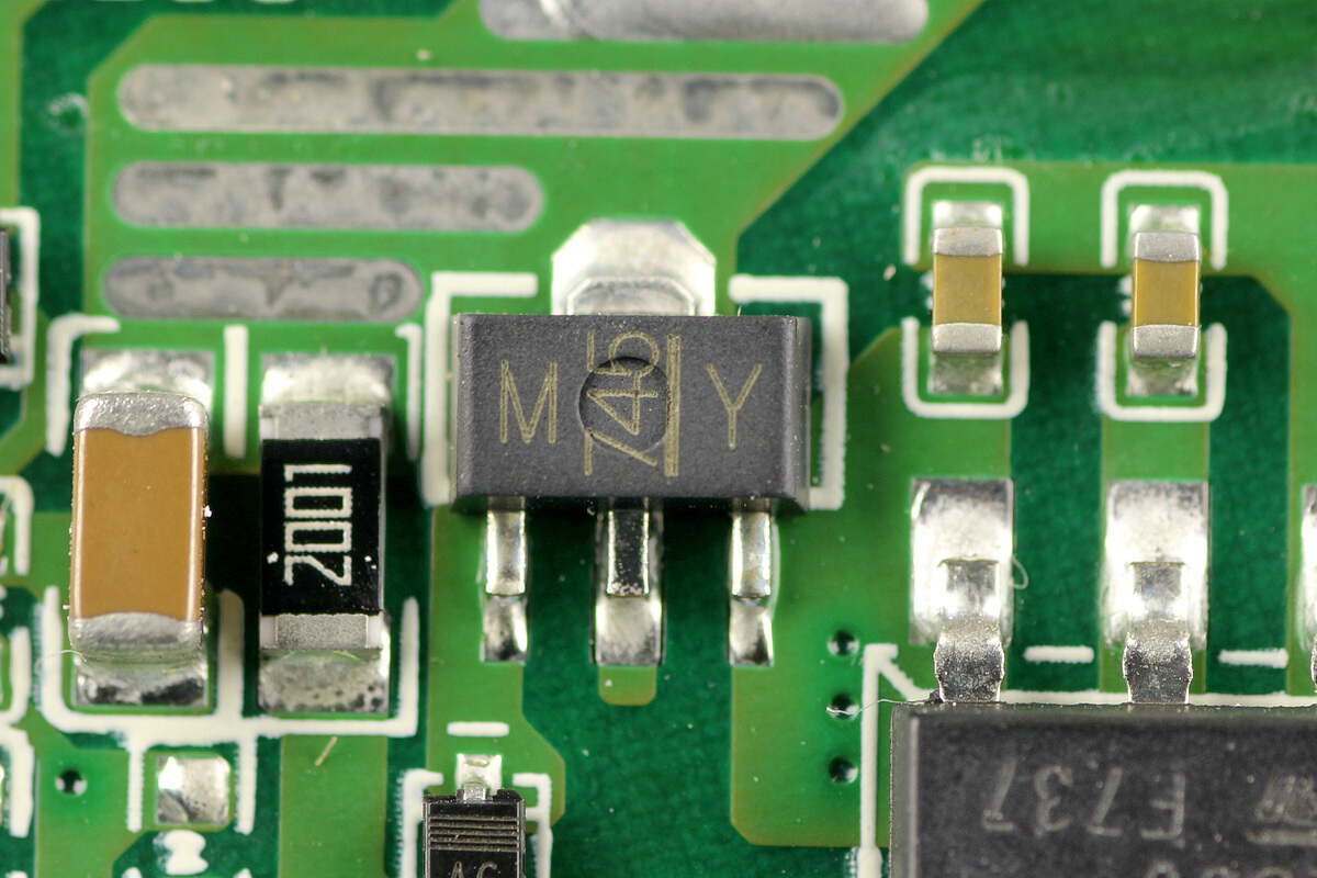

Close-up of the transistor marked with "MY".

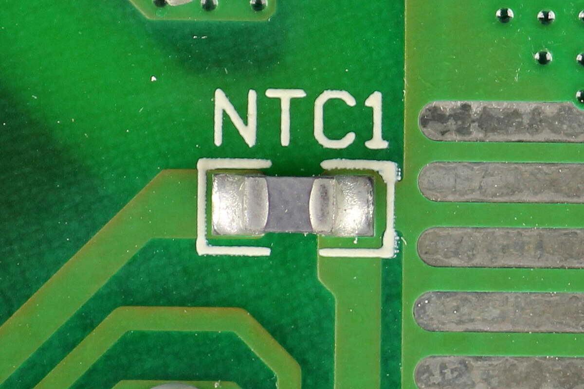

The SMD NTC thermistor is used to monitor the internal temperature of the power supply.

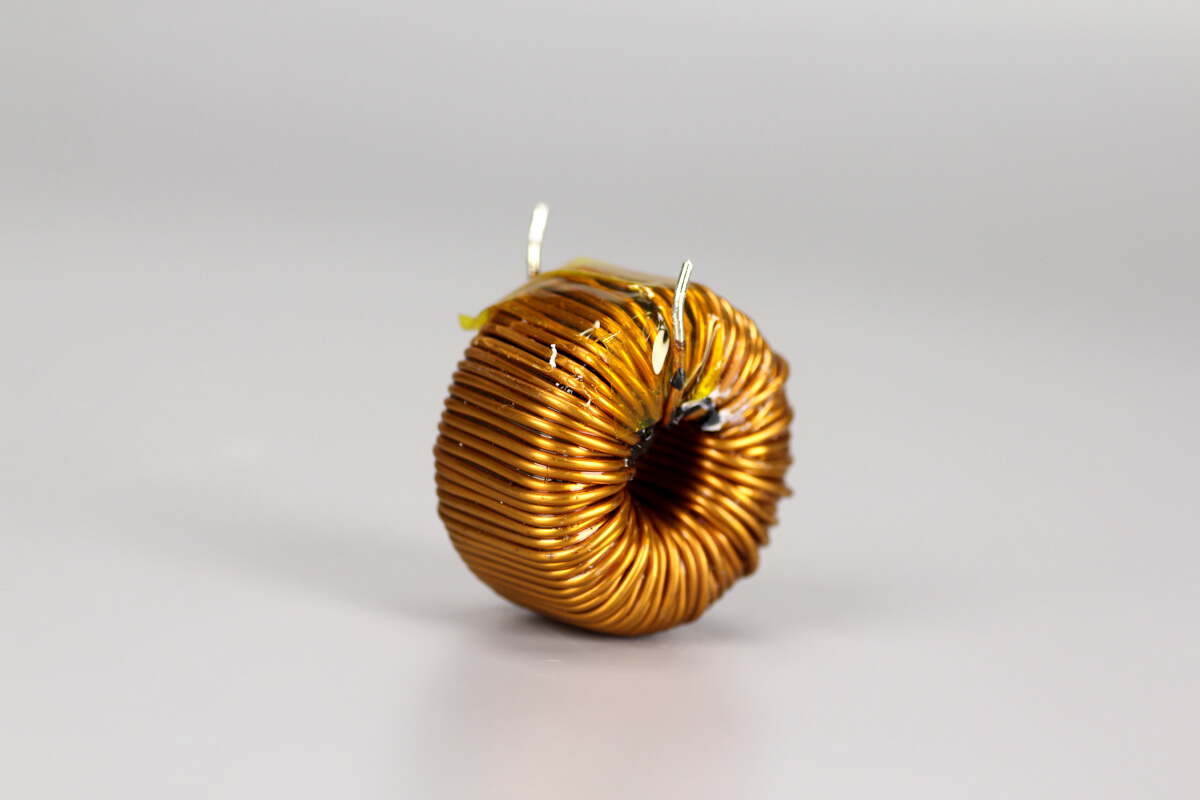

The PFC boost inductor is wound on a ferrite core.

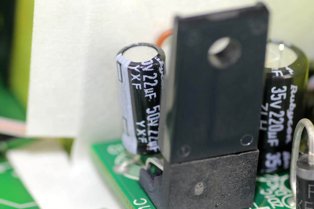

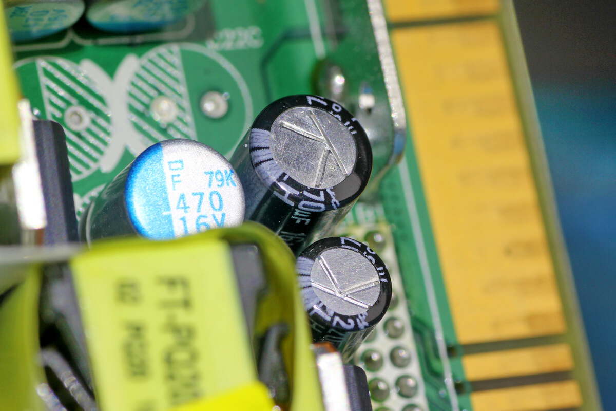

The high-voltage filter capacitor is from Rubycon, part of the MXG series electrolytic capacitors, rated at 450V 470μF.

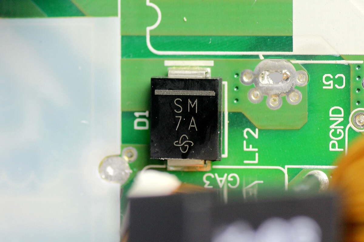

The PFC bypass diode is from VISHAY, marked with "SM", model S3M, rated 1000V 3A, and comes in an SMC package.

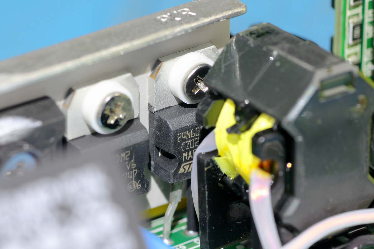

The LLC MOSFET is from STMicroelectronics, model STP24N60DM2. It is an N-channel MOSFET with a voltage rating of 600V, an on-resistance of 175mΩ, and comes in a TO-220 package.
The other LLC MOSFET has the same model.

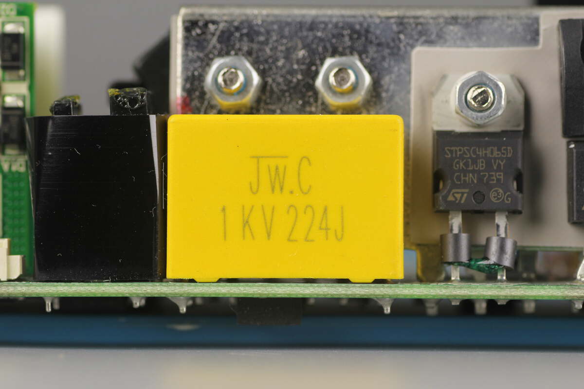

The resonant capacitor is rated at 1kV 0.22μF.

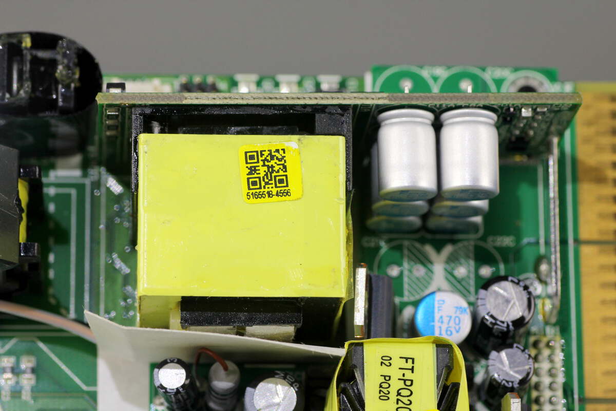

The transformer is soldered onto the vertical PCB.

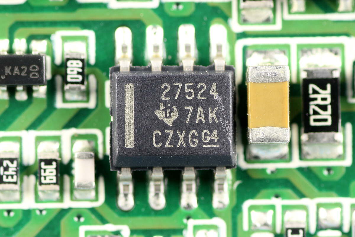

The synchronous rectifier driver is from TI, model UCC27524. It is a dual-channel, 5V high-speed low-side gate driver with negative input voltage capability, and comes in an SOIC-8 package.

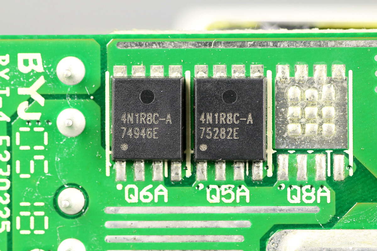

The back side of the vertical PCB contains the synchronous rectifiers and VBUS MOSFETs.

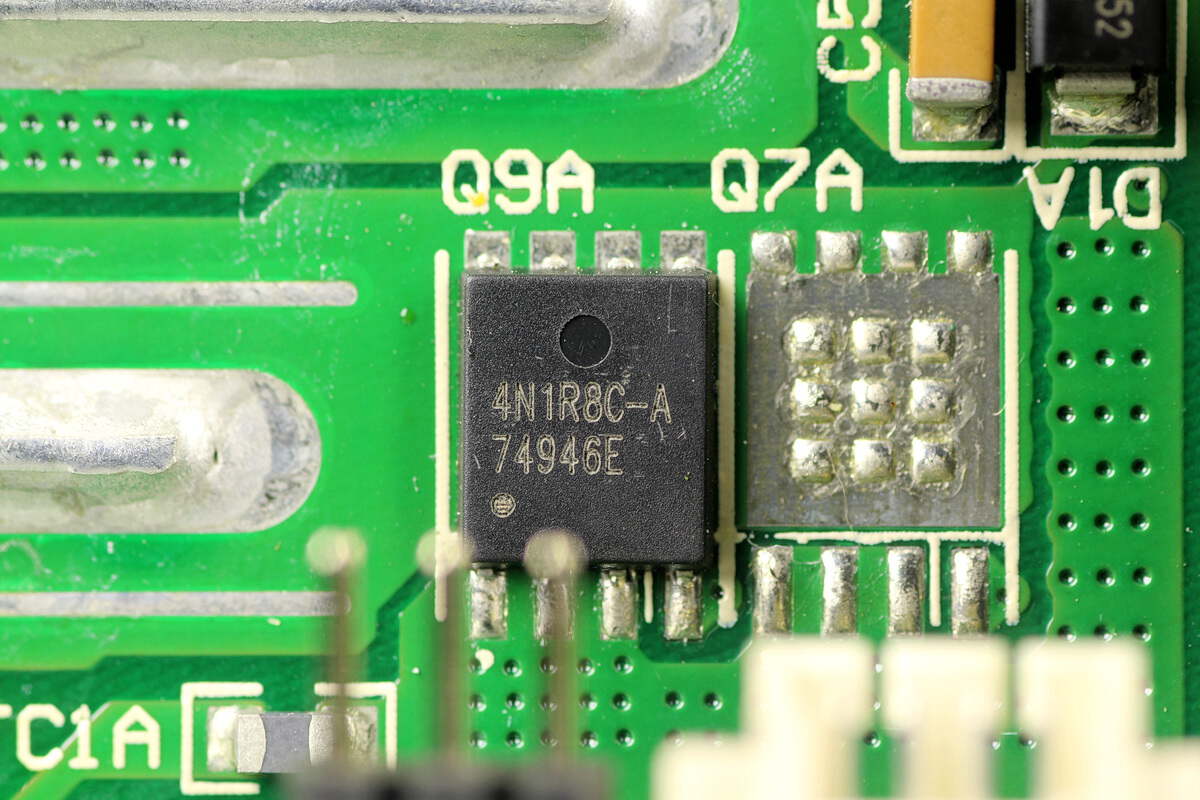

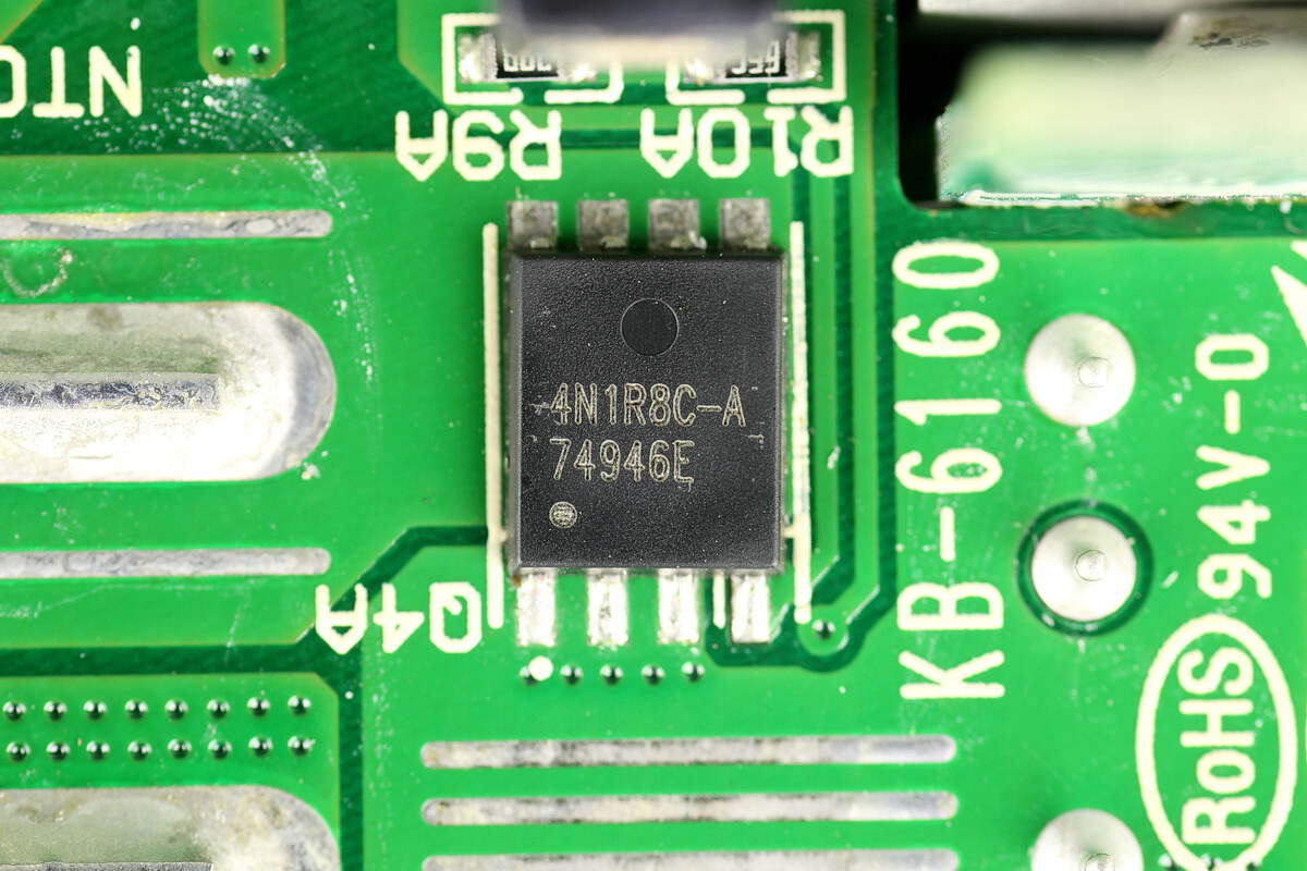

The synchronous rectifiers are from APEC, marked with 4N1R8C-A, model AP4N1R8CMT-A. They are N-channel MOSFETs with a voltage rating of 45V, an on-resistance of 1.8mΩ, and come in a PMPAK 5x6 package.
The other set of synchronous rectifiers has the same model.
Close-up of the second synchronous rectifier.

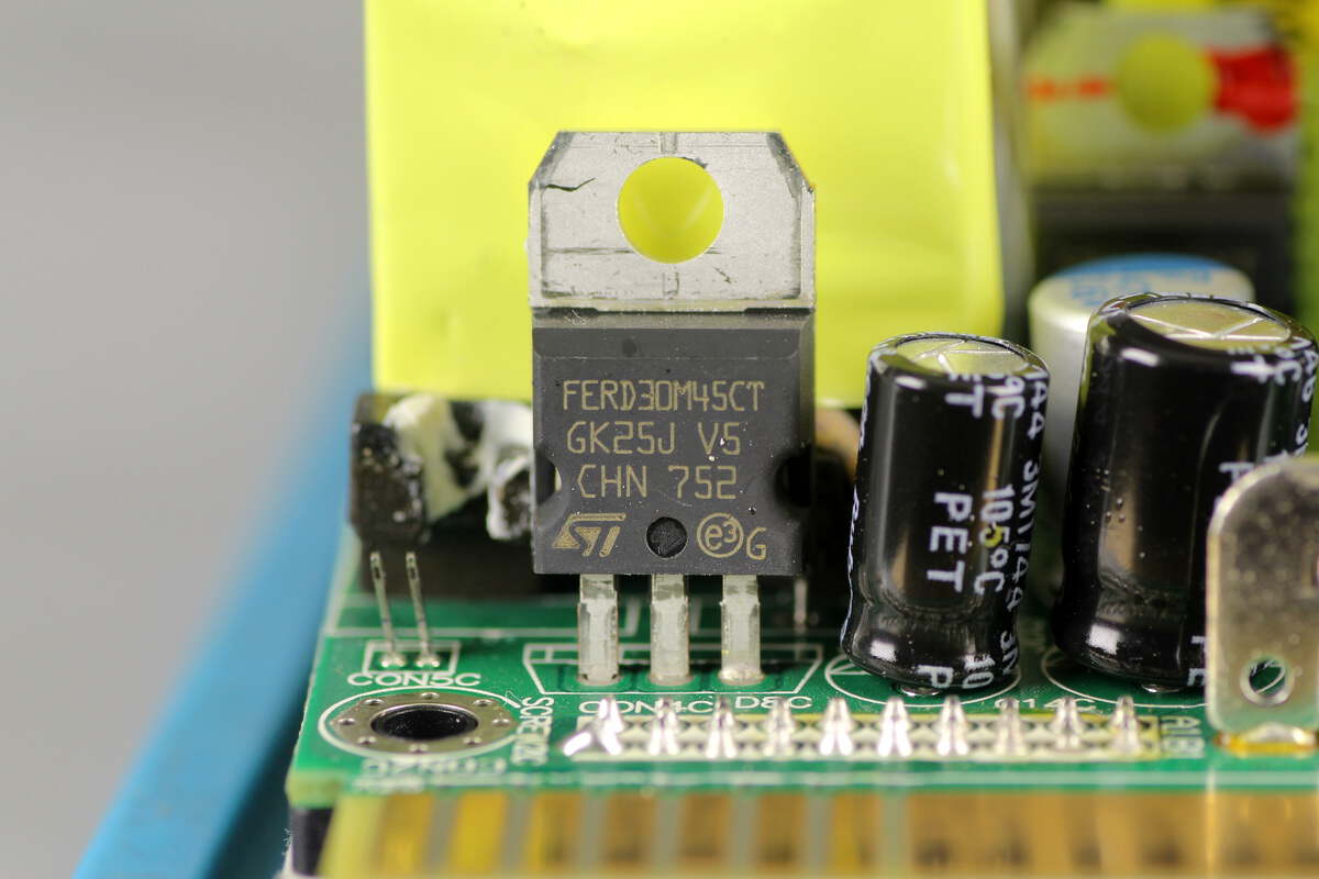

The standby power supply IC is sourced from SanKen, model STR-W6051S. It integrates a 650V MOSFET, an internal startup circuit, and standby functionality. The chip offers comprehensive protection features, supports an output power of up to 30W, and comes in a TO220F-6L package.

The filter capacitor is manufactured by Rubycon, with a specification of 22μF, 50V.
Another filtering capacitor is specified at 220μF, 35V.

The solid capacitor is rated at 470μF, 16V.
The filter capacitor is from Rubycon, with a specification of 470μF, 16V.
Another filtering capacitor is specified at 220μF, 16V.
The diode is sourced from STMicroelectronics, model FERD30M45CT. It is a field-effect rectifier diode, rated at 45V, 30A, and packaged in a TO-220AB case.

This operational amplifier is from TI, model LM324. It is a quad-channel general-purpose op-amp, packaged in SOIC-14.
The other operational amplifier is from STMicroelectronics, model LM358. It is a low-power dual op-amp, packaged in SO-8.

The cooling fan is from NJcon, model MGT4012UB-W28, rated at 12V, 0.55A, and made in China.

After taking it apart, we found that it uses a PFC+LLC architecture. Both the PFC controller and LLC controller are sourced from CHAMPION. The PFC MOSFET is a VISHAY SiHG30N60E, and the PFC rectifier is an STMicro STPSC4H065 silicon carbide diode.
The LLC MOSFETs are STMicro STP24N60DM2, driven by the SKYWORKS Si8230BD isolation driver. Synchronous rectifiers use APEC AP4N1R8CMT-A. The high-voltage filtering capacitor is from Rubycon, and the solid capacitors are from NCC. Parameter acquisition is performed using MCUs from NXP and Microchip. The workmanship and component selection are solid and reliable.
