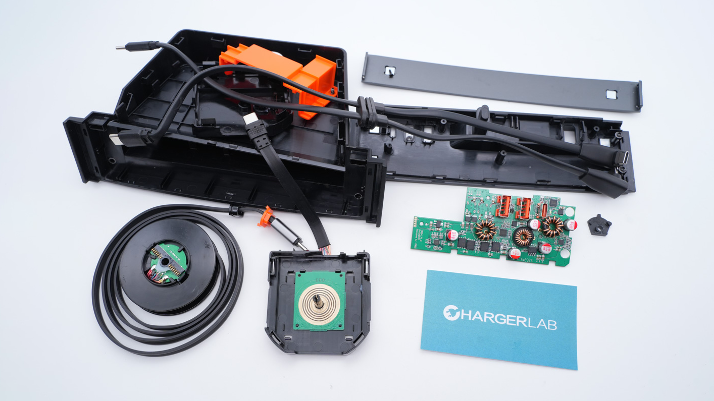

Now that we have completed our testing of this dock, it's time to take it apart and examine its internal components and structure.
For Your Tesla | Teardown of Baseus 45W PD Expansion Dock (BS-TS002)-Chargerlab
Firstly, let's pry along the gap to remove the cover. Most space inside is quite empty, cause there's no switching power supply.
As we can see, there're three USB-C sockets inside the dock. And the last two sockets are connected to the two input cables below. The first one is used to connect main PCB to the module.
The retractable cable module is covered by an orange plate.
Continue the teardown.
The main PCB is fixed by screws.
And the dust-proof cover is fixed by magnets.

At this point, you might be a little confused. It clearly has two USB-A and one USB-C output port, so why are there three USB-C sockets on the PCB?
Looking at it the other way around, everything starts to make sense. In reality, it allocates the two USB-A ports on the output panel, one USB-C port, and one USB-C retractable cable, all to the two rightmost USB-C sockets at the back.
Besides, two synchronous buck-boost circuits for two USB-C and a buck circuit for two USB-A are on the front.

Those USB-C sockets and other chips are on the back.
Two USB PD Sink controllers are from Hynetek. Model is HUSB238. They can control the output of two USB-C ports. And the output power can be up to 100W.
Two p-MOSFETs printed with 3419 are used for power supply control.

Finally, let's see this black case, which is used to store the retractable cable. We've also seen this structure in other Baseus products, you can click here to take a look.
Those metal contacts on the right small PCB are connected to the metal grooves on the left part. And the USB-C cable is connected to the USB-C connector on the main PCB.
Well, that's all components of this 45W expansion dock from Baseus for Tesla cars.
It brings two more USB-A ports to your Tesla car and exceeds the 27W charging limit. So you can fast charge more devices than before. And the retractable cable is very convenient for passengers in rear seat to charge their devices.
