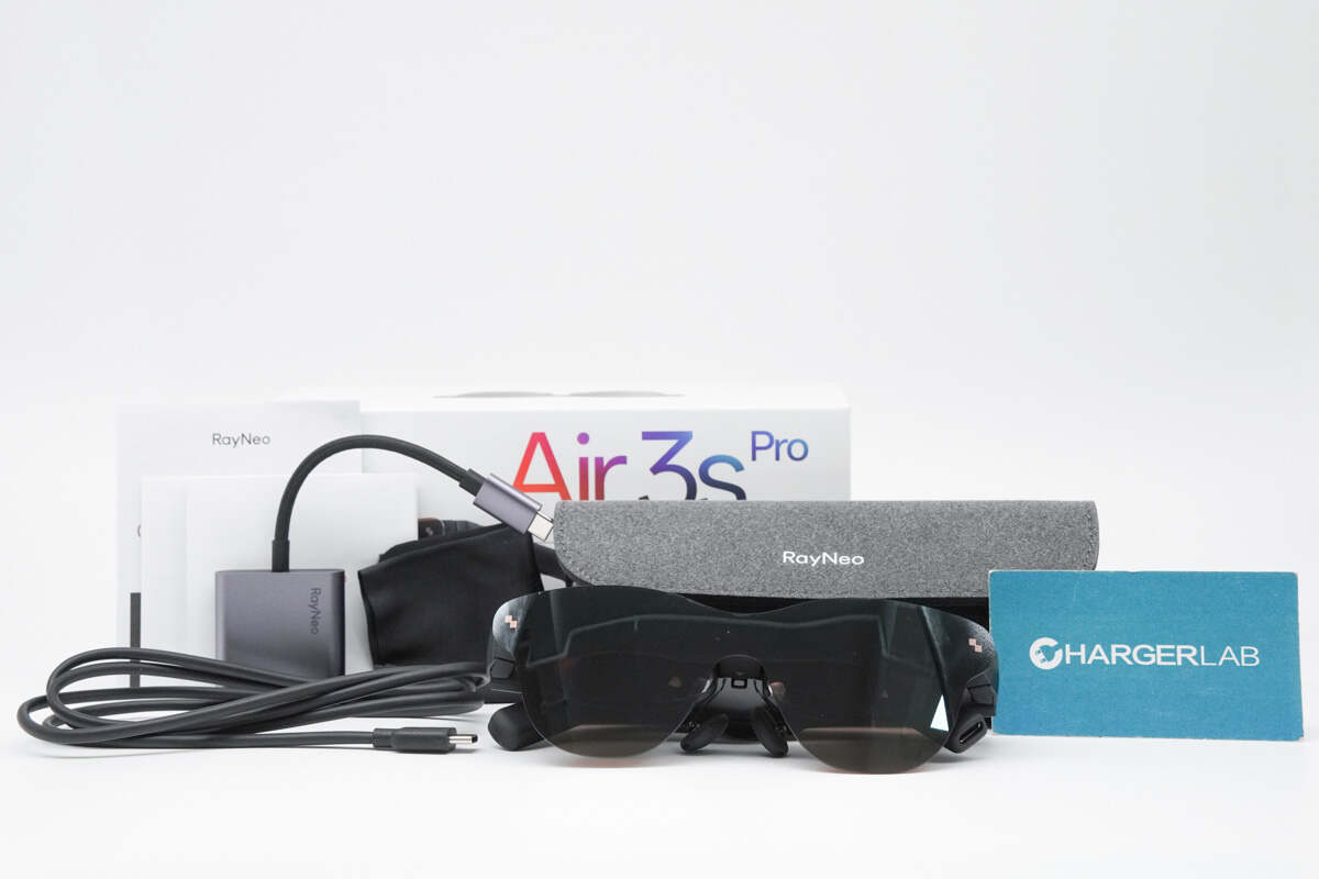

The RayNeo Air 3s Pro kit includes, in addition to the glasses, a data cable, the USB-C adapter, a user manual, a service card, a portable glasses case, a carrying box, and a cleaning cloth.

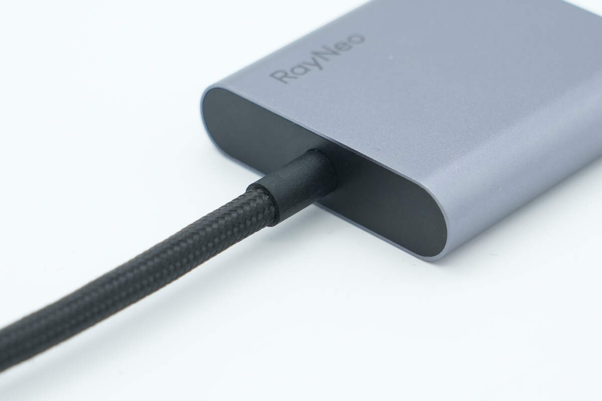

The junction between the cable and the device body also features a reinforced bend-resistant design.
Teardown of RayNeo Air 3s Pro Original USB-C Adapter (XRAC-CHA01OS)-Chargerlab

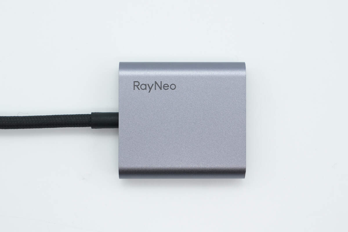

The RayNeo logo is located at the upper left corner on the front of the adapter.

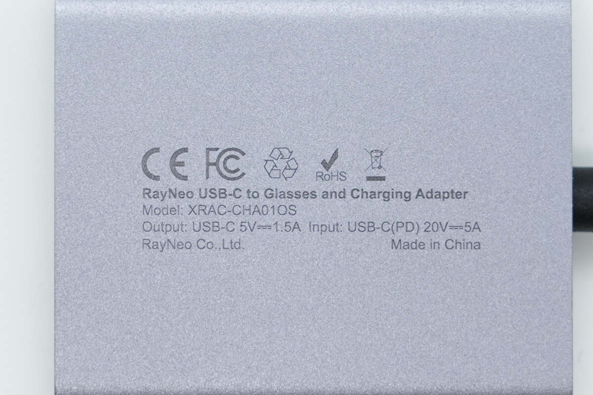

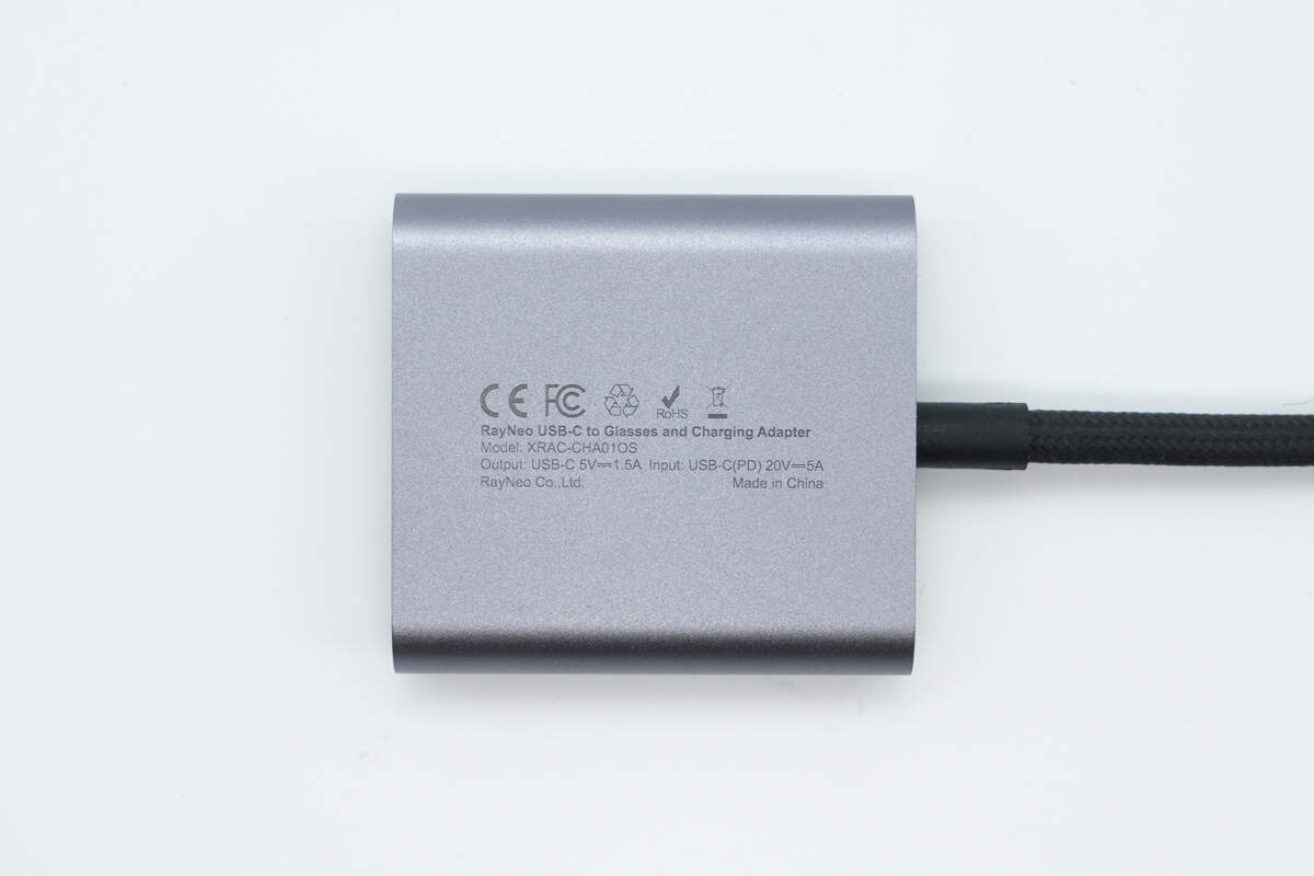

The back features laser-engraved technical specifications.
Model: XRAC-CHA01OS
USB-C (PD) Input: 20V 5A
USB-C Output: 5V 1.5A
It has passed CE and FCC certifications.

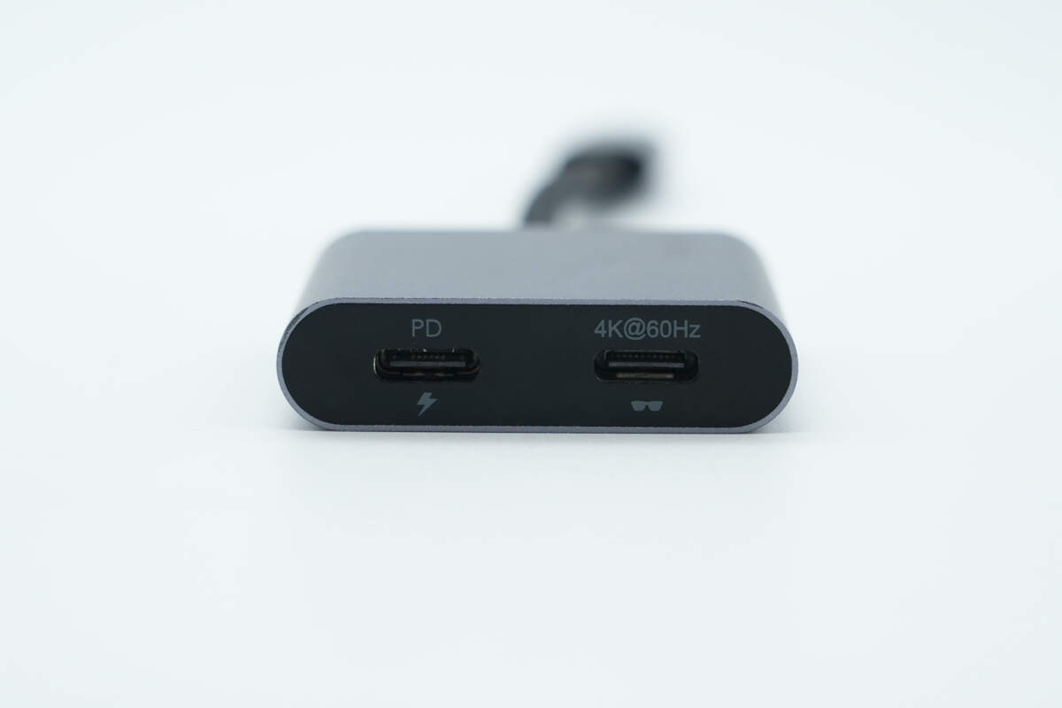

The other end features a USB-C PD input port and a USB-C video transmission port, which supports simultaneous 4K60Hz video transmission and 5V 1.5A power supply for the RayNeo Air 3s Pro.

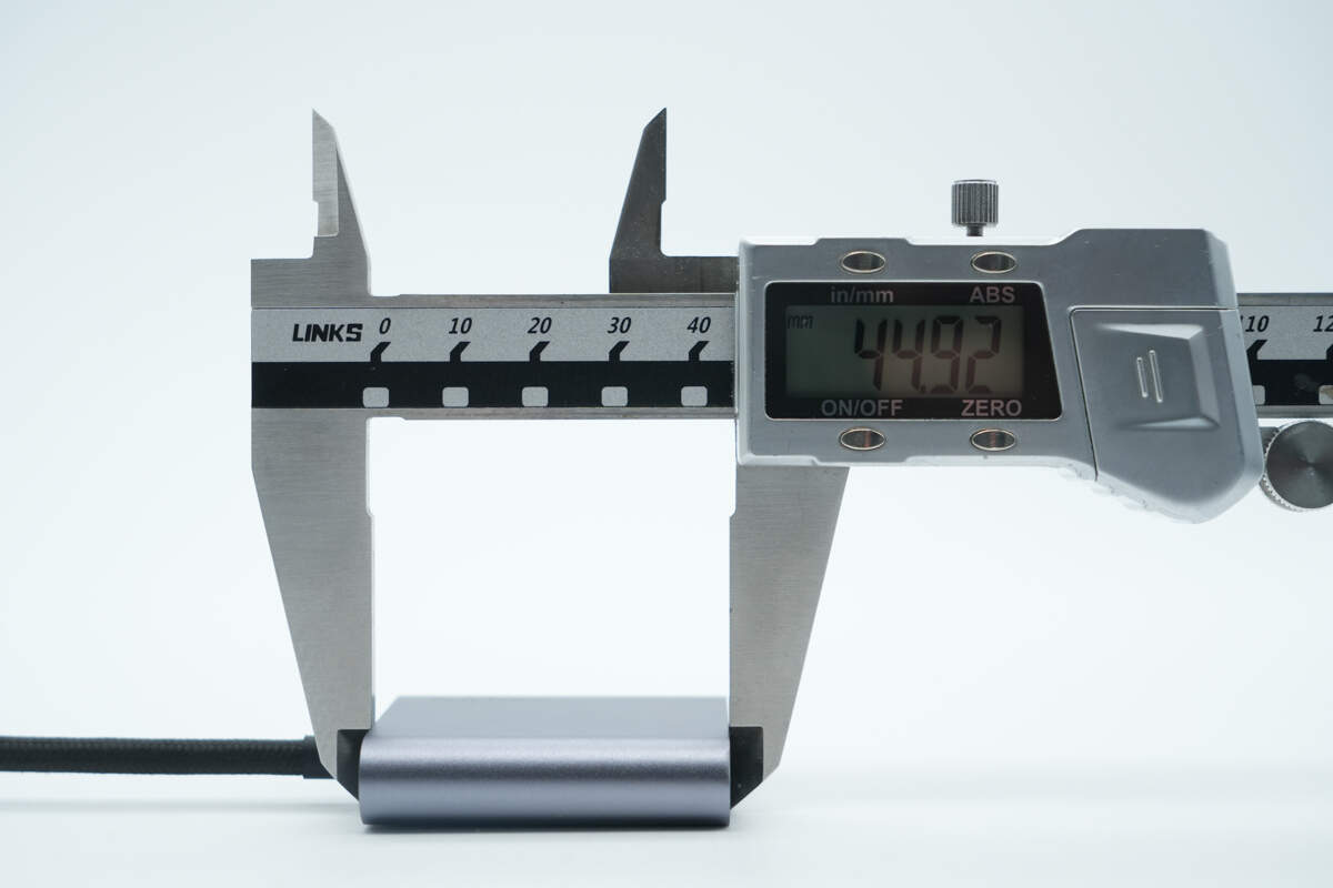

The length is about 44.92 mm (1.77 inches).

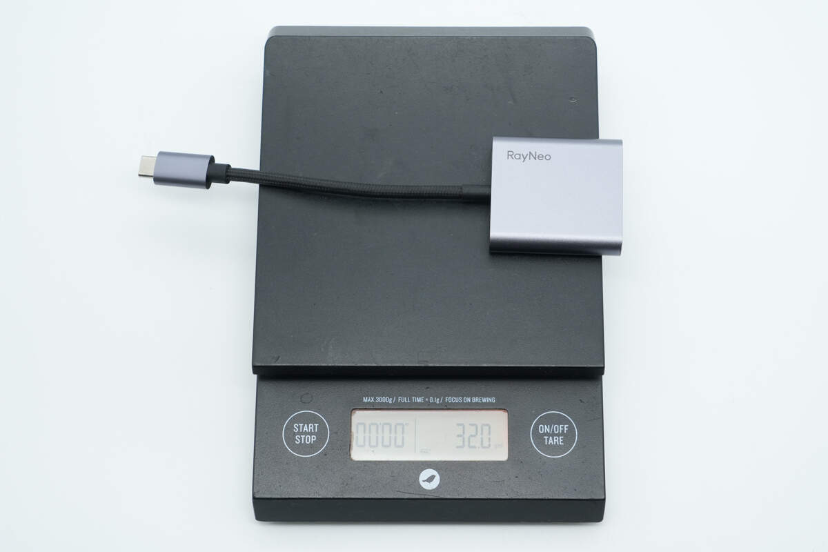

The weight is about 32 g (1.13 oz).

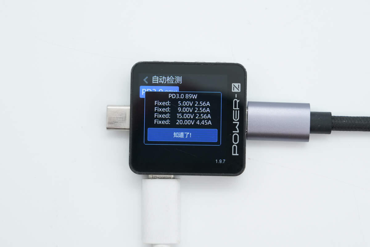

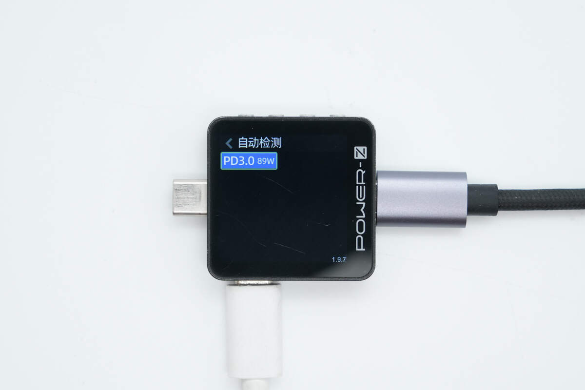

ChargerLAB POWER-Z KM003C shows that the USB-C cable supports PD3.0 charging protocol.
And it has four fixed PDOs of 5V2.56A, 9V2.56A, 15V2.56A, and 20V4.45A.

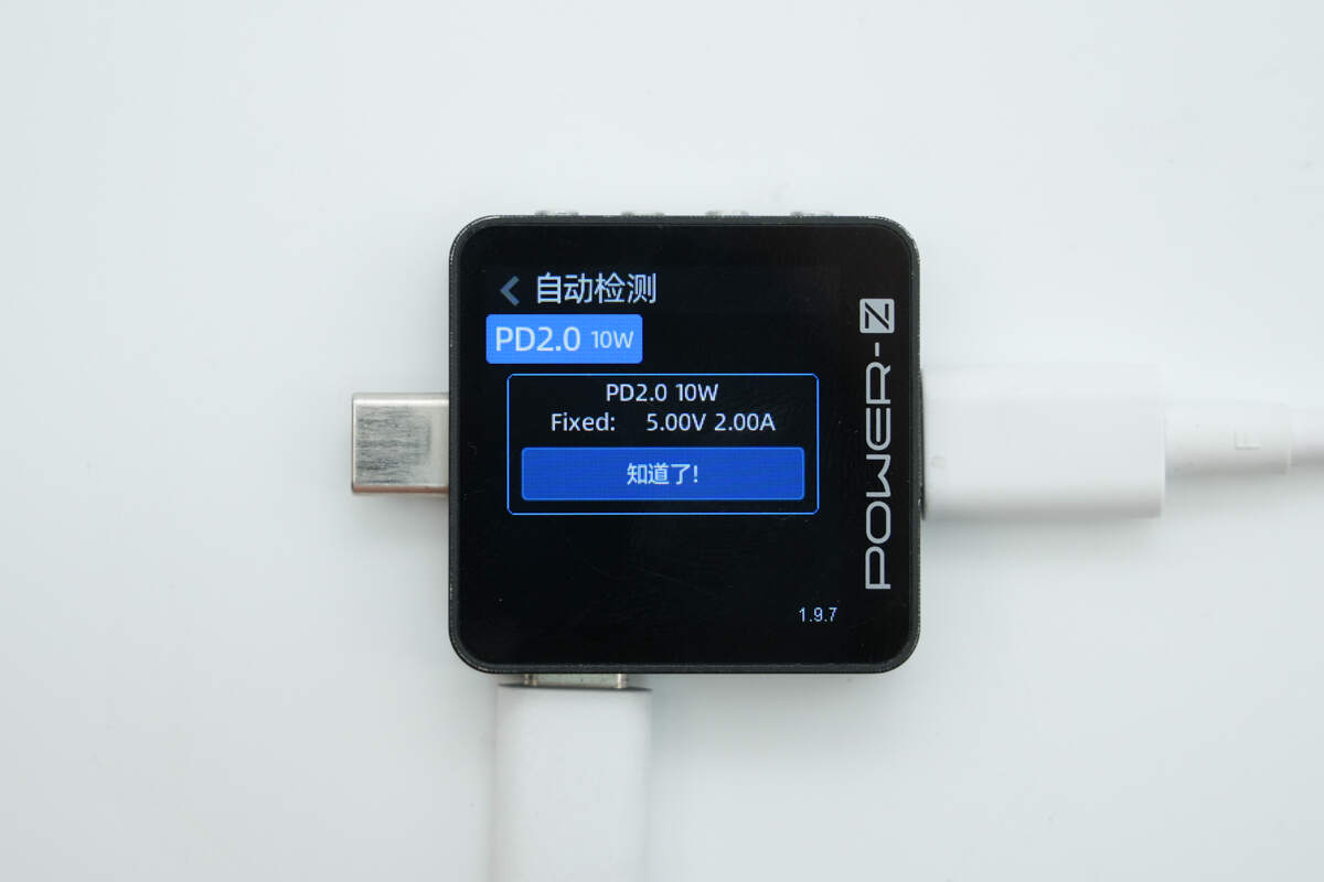

Testing shows that the USB-C video transmission port supports the PD 2.0 charging protocol.
And it has one fixed PDO, which is 5V2A.

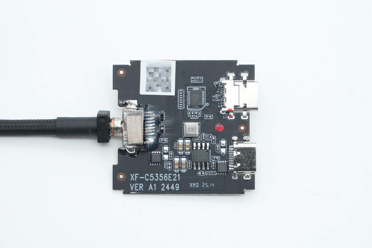

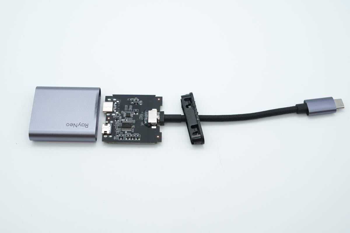

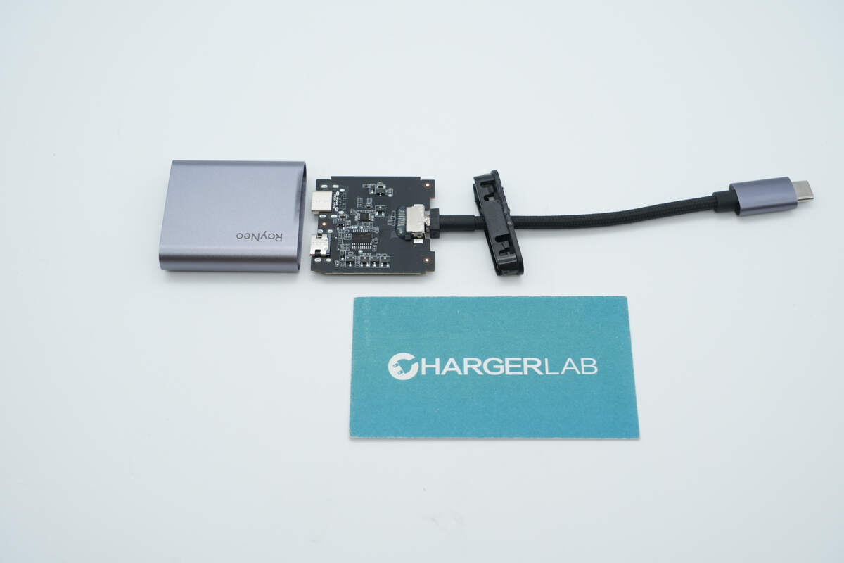

Disassembled the case to remove the PCB. The bottom plastic shell is secured with snap-fit clips.

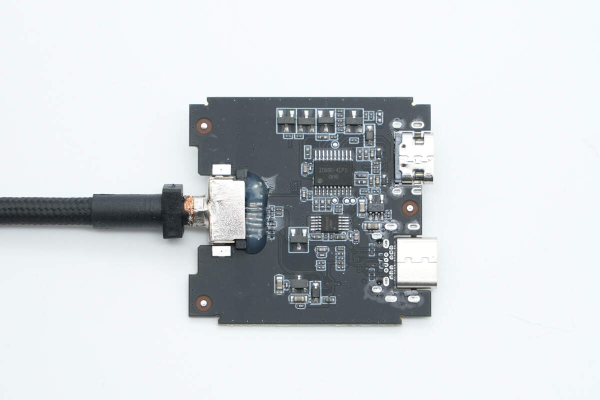

The wires are soldered to the PCB and clamped securely by a metal clip, which is lined with conductive fabric. The front side of the PCB features components such as VBUS MOSFETs, a synchronous buck converter, and a buck inductor.
The back side features components, including the ETA ETA6280S2F overcurrent protection chip.

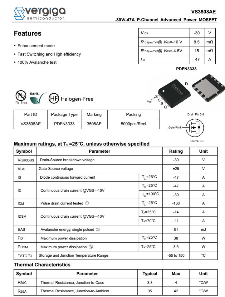

The VBUS MOSFET for the USB-C PD input port is from Vergiga, model VS3508AE. It is a PMOS rated for -30V, with an on-resistance of 8.5mΩ, and comes in a PDFN3333 package.
Here is the information about Vergiga VS3508AE.

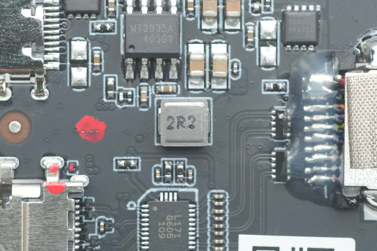

The synchronous buck converter is from M3TEK, model MT3935A. It supports an input voltage of up to 26V, delivers a continuous output current of 4A, and a peak output current of 5A. It integrates internal MOSFETs and comes in an SOP8-EP package.
Close-up of the paired 2.2μH buck inductor.
The VIA Labs VL171 is used for USB-C interface de-multiplexing, outputting both DP video signals and USB. It comes in a QFN-28 package.

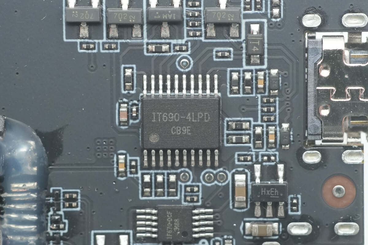

Close-up of a chip marked with "IT690-4LPD".
Close-up of a chip marked with "IF670-DCF".
