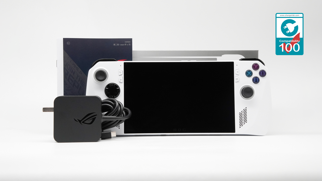

The realm of handheld PCs has been filled with constant excitement in recent years. Among the most anticipated handheld PCs on the market, the ROG Ally and Steam Deck have garnered substantial user interest. Many are curious about the charging compatibility between these two devices. We conducted a charging compatibility test for the Steam Deck shortly after its release and have recently acquired the Ally for similar testing.
After that, we did a ChargerLAB Compatibility 100 video for it. Through the video, we believe that everyone has gained some understanding of this console. Now, we present it in a textual format to provide a more detailed insight into its charging compatibility.
Charging Compatibility Test
Next, ChargerLAB will conduct a comprehensive test on the compatibility of the ROG Ally, evaluating its performance with a selection of more than 100 charging devices. These devices include ROG chargers, third-party chargers, power banks, and portable power stations, aiming to cover the majority of users' charging scenarios.
