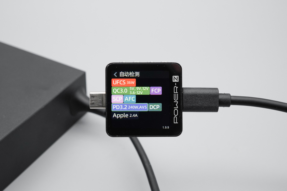

Testing shows that the Type-C port supports multiple charging protocols, including UFCS, QC3.0, FCP, SCP, AFC, PD3.2, AVS, DCP, and Apple 2.4A.

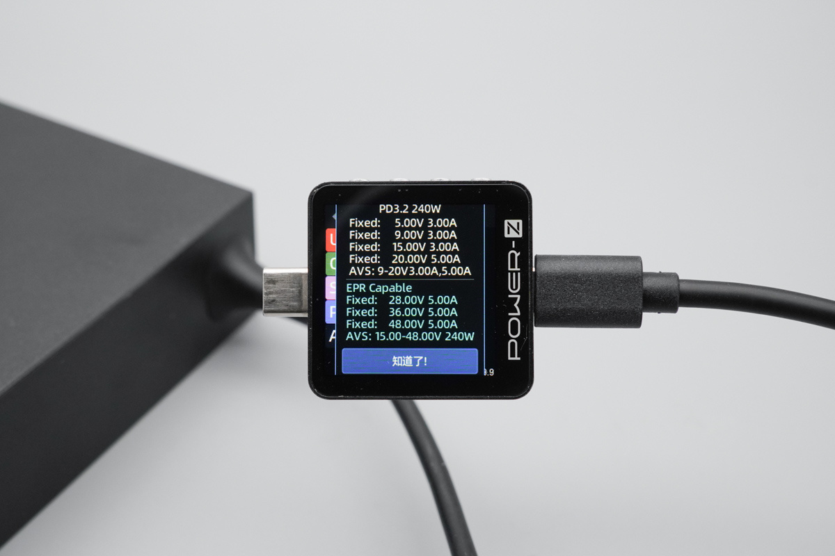

In terms of PDOs, testing confirms support for seven fixed voltage profiles: 5V3A, 9V3A, 15V3A, 20V5A, 28V5A, 36V5A, and 48V5A. It also supports AVS voltage ranges of 9–20V 3A/5A and 15–48V 240W, providing full voltage range coverage.
