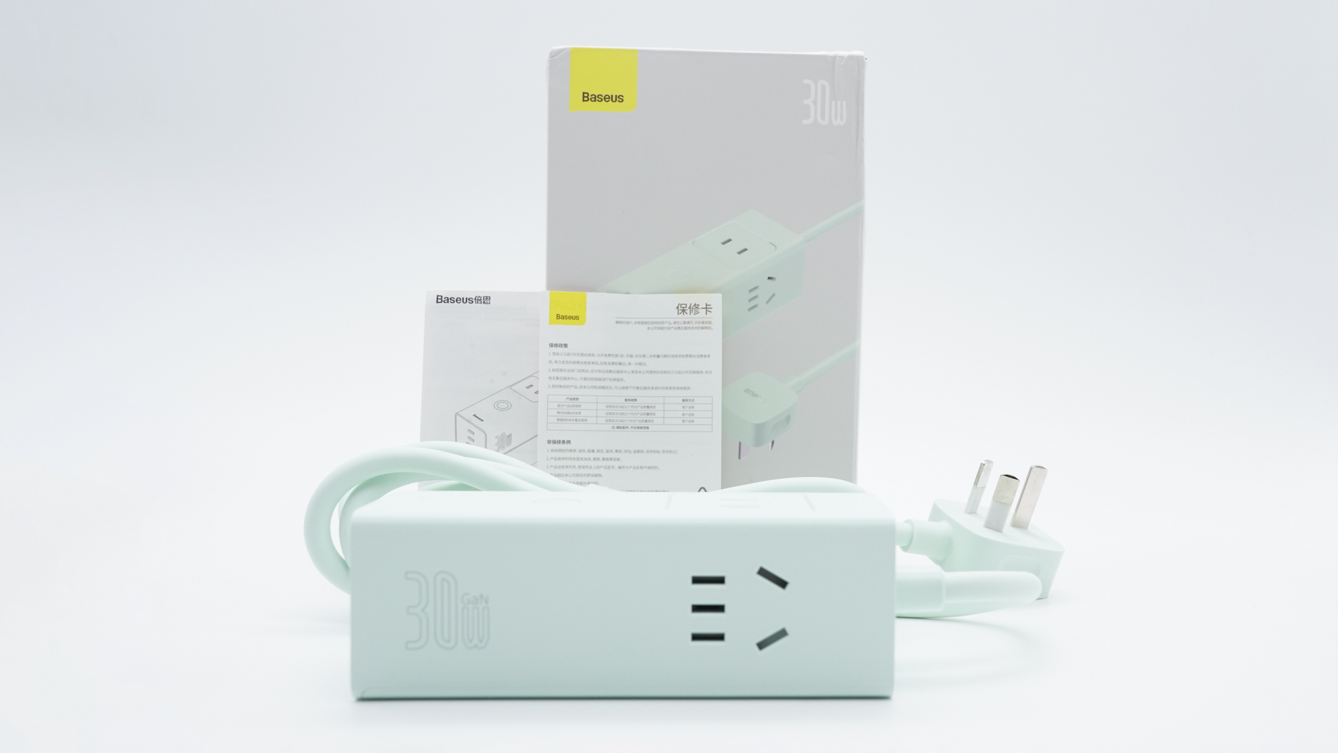

The packaging box of Baseus PowerCombo 30W GaN Power Strip adopts gray and white design, the product and its name are printed on the front.
Review of Baseus PowerCombo 30W GaN Power Strip-Chargerlab
And the usage scenario picture with specs info and some selling points are on the back.
Open the box, it contains some documents and the power strip itself.
It is made of matte PC material with matcha green color and is small in size thanks to GaN technology.
