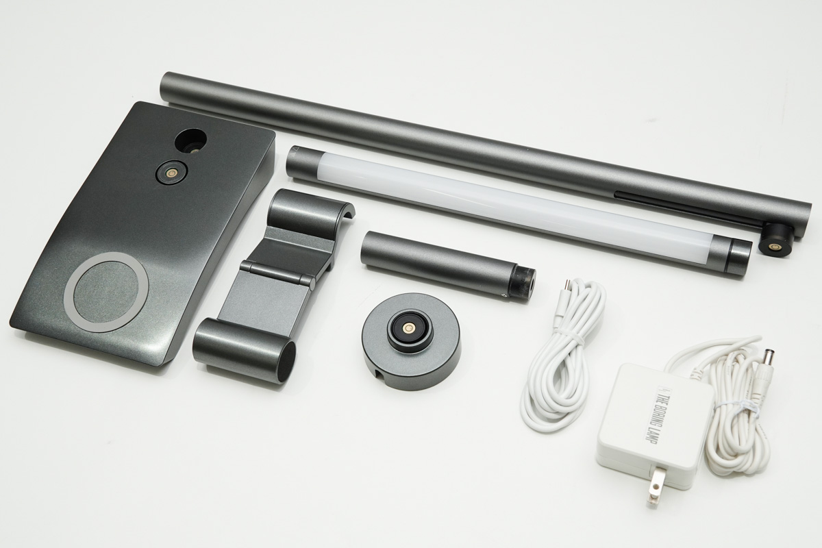

The box contains a retractable lamp stand, a wireless charging base, an LED light bar, a magnetic bracket of the screen light, a battery, a portable charging base, a dual USB-C cable, and a DC adapter.
