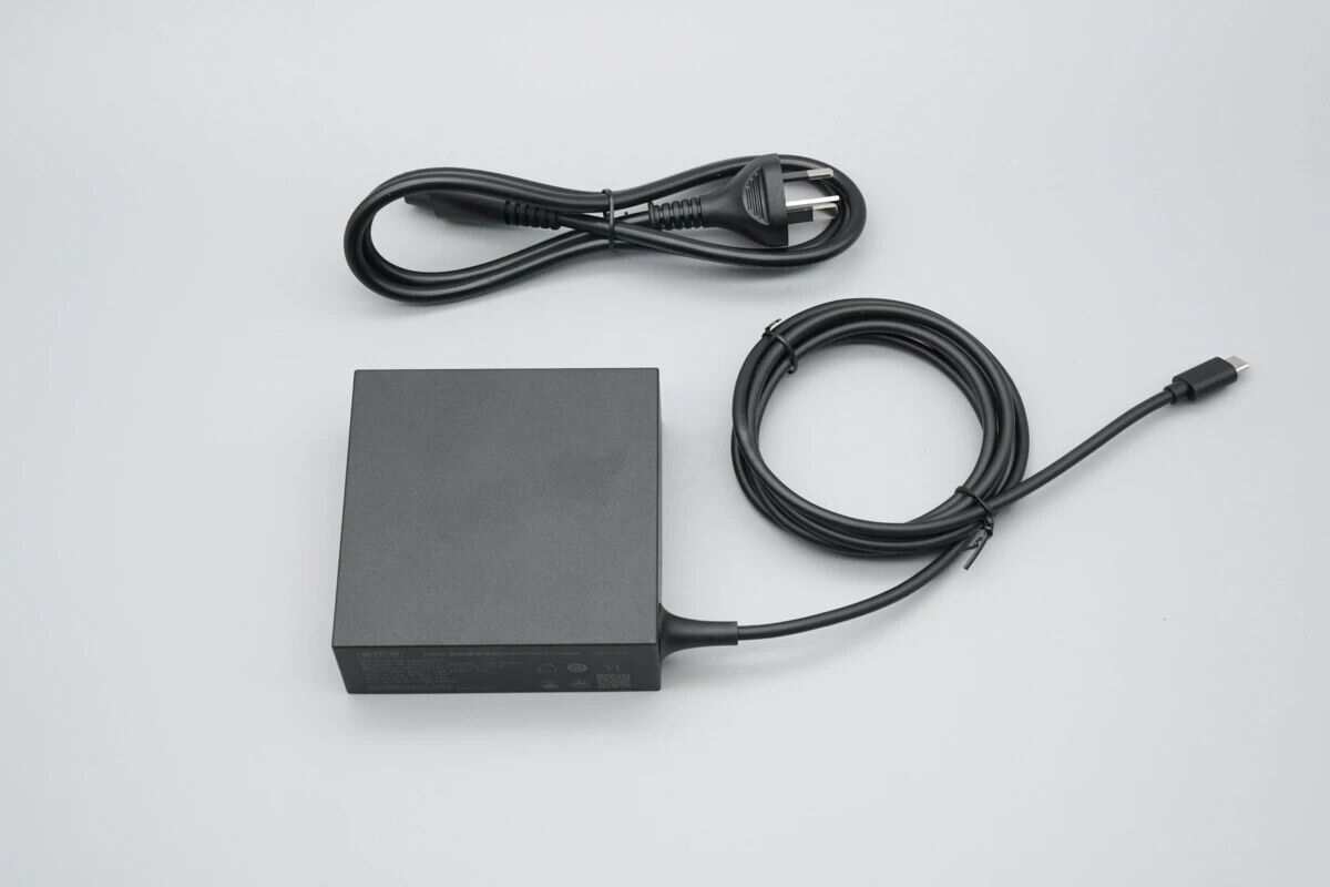

Recently, AMC Technology launched a 240W GaN charger tailor-made for NVIDIA’s DGX Spark GB10 computing platform. It is not only among the first batch of GaN products to support PD3.2 240W output, but also strictly follows NVIDIA’s customized size and appearance specifications. The charger incorporates high-efficiency solutions such as an AHB topology and digital control design. With Level 7 energy efficiency certification, it achieves superior power conversion efficiency. Below are the product specifications and POWER-Z test results.

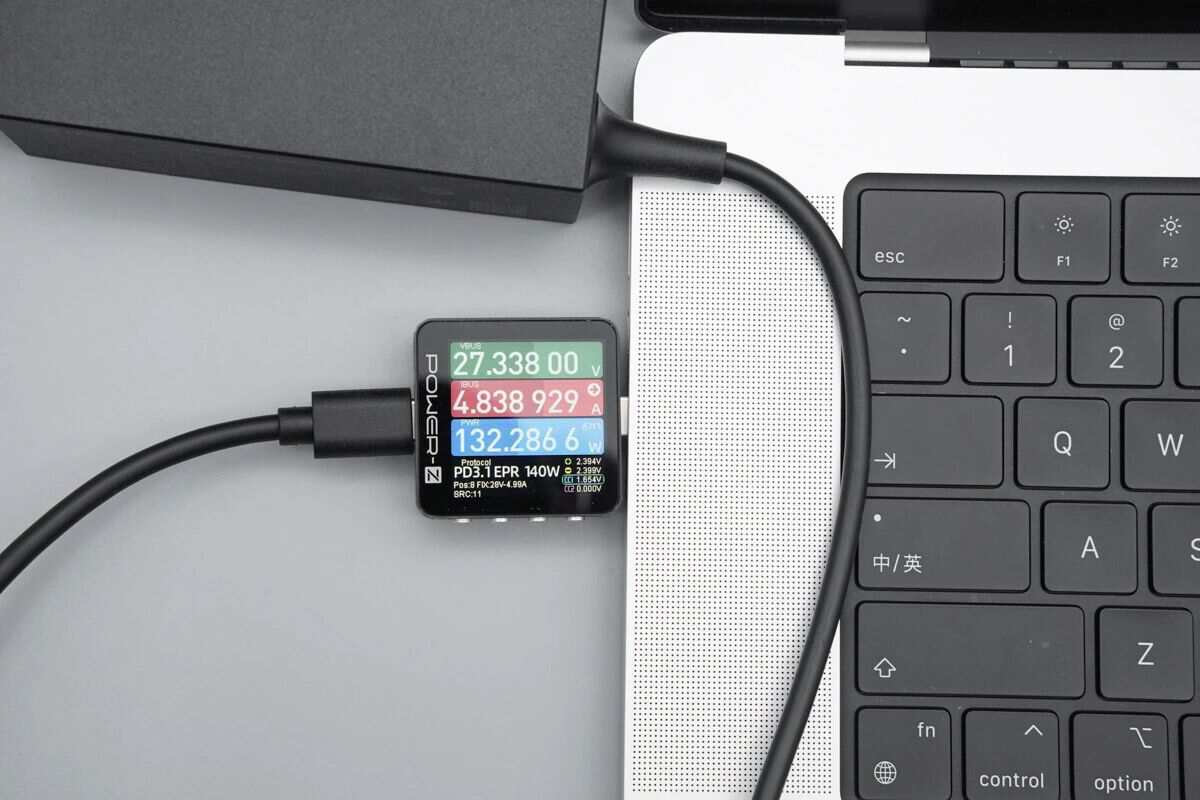

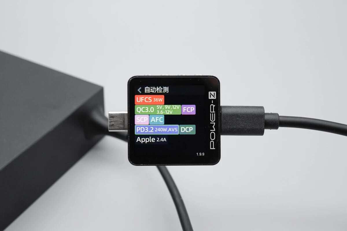

Tested with the POWER-Z P240, the charger can stably deliver up to 240W of output power. POWER-Z KM003C testing shows that it supports multiple fast-charging protocols, including UFCS, PD3.2, AVS, QC3.0, FCP, SCP, AFC, and DCP, with a wide range of PDO profiles available.
ChargerLAB POWER-Z Tests: AMC Technology PD3.2 240W GaN Charger-Chargerlab
In real-world testing, it delivered 132.29W to a MacBook Pro 16 M4 Pro, 132.41W to a high-power power bank, and approximately 36.48W to an iPhone 17 Pro Max. It is also compatible with the Framework Laptop 16 and computing servers from brands such as Acer and Dell.
