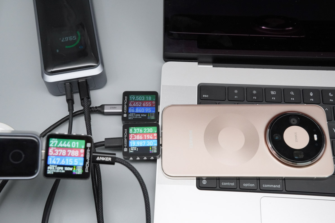

Scenario 1: Standard Pass-Through Charging (Input > Output)
ChargerLAB POWER-Z KM003C Tests Power Bank Pass-Through Charging Performance (with Tutorial)-Chargerlab
Case A
  • Input: 27.44V 5.38A 147.62W (PD3.1 EPR 150W)
  • Output: 19.99W to a phone, 87W to a laptop, total ≈ 107W
  • Difference: 147.62W − 107W = 40.62W
This remaining power is used to charge the power bank itself, which is normal behavior.

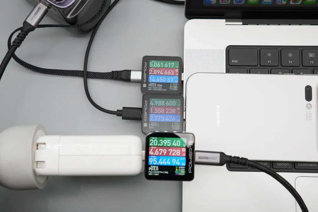

Case B
  • Input: 20.39V 4.67A 95.44W (PD3.0 100W)
  • Output: 7.77W to a phone, 14.65W to a laptop, total ≈ 22.42W
  • Difference: 95.44W − 22.42W = 73.02W
This remaining power is also used for charging the power bank.

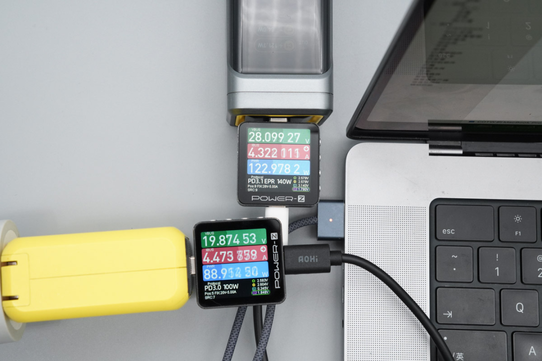

Scenario 2: Battery-Assisted Discharge (Input < Output)
  • Input: 19.87V 4.47A 88.91W (PD3.0 100W)
  • Output: 122.97W to a laptop
Difference: 88.91W − 122.97W = −34.06W
This indicates that the charger alone cannot meet the load demand. In this case, the power bank battery also discharges to support the output together with the input power. Although this consumes battery energy, it ensures stable high-power delivery to the device.
