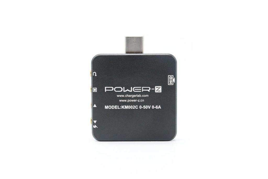

The four buttons on the left side are the "Back", "Confirm", "Left" and "Right", from top to bottom, respectively.

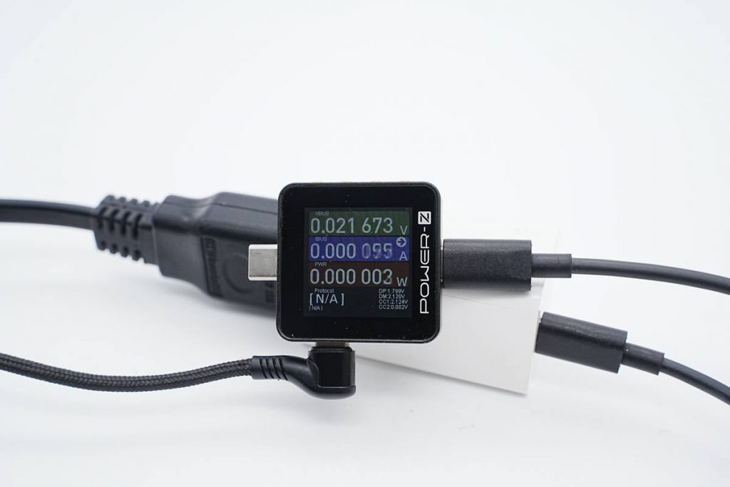

First, connect the POWER-Z KM002C to the device (we take the Lenovo 65W charger as an example). After connecting the charger, the tester will be turned on.
How to use the ChargerLAB POWER-Z KM002C PD3.1 tester to check fast charging protocols of devices?-Chargerlab

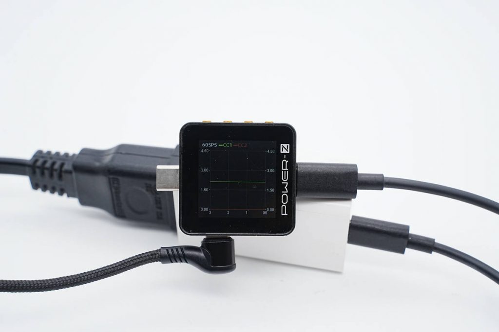

Press the "Right" button.

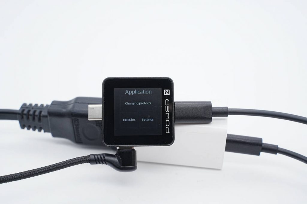

Then, press the "Right" button again, and we can see the Application Menu.
On the Application Menu, press the "Confirm" button to select the "Charging protocol", and then press the "Confirm" button again.

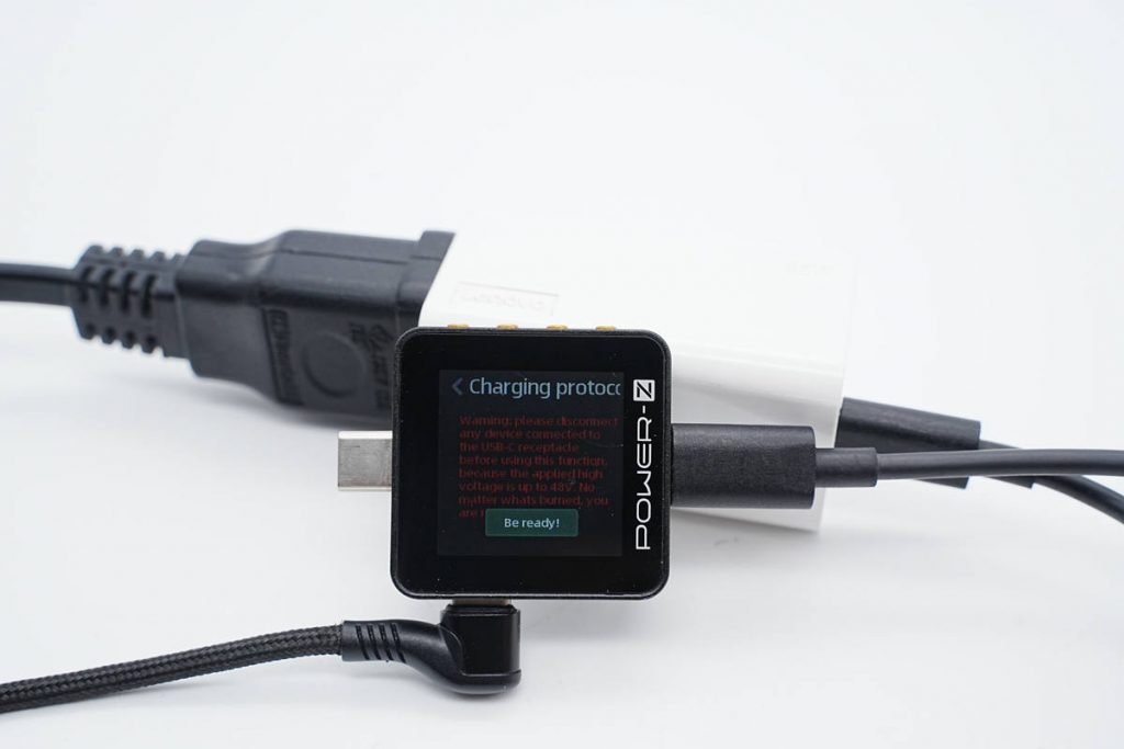

Please pay attention to the warning and press the "Confirm" button to be ready.

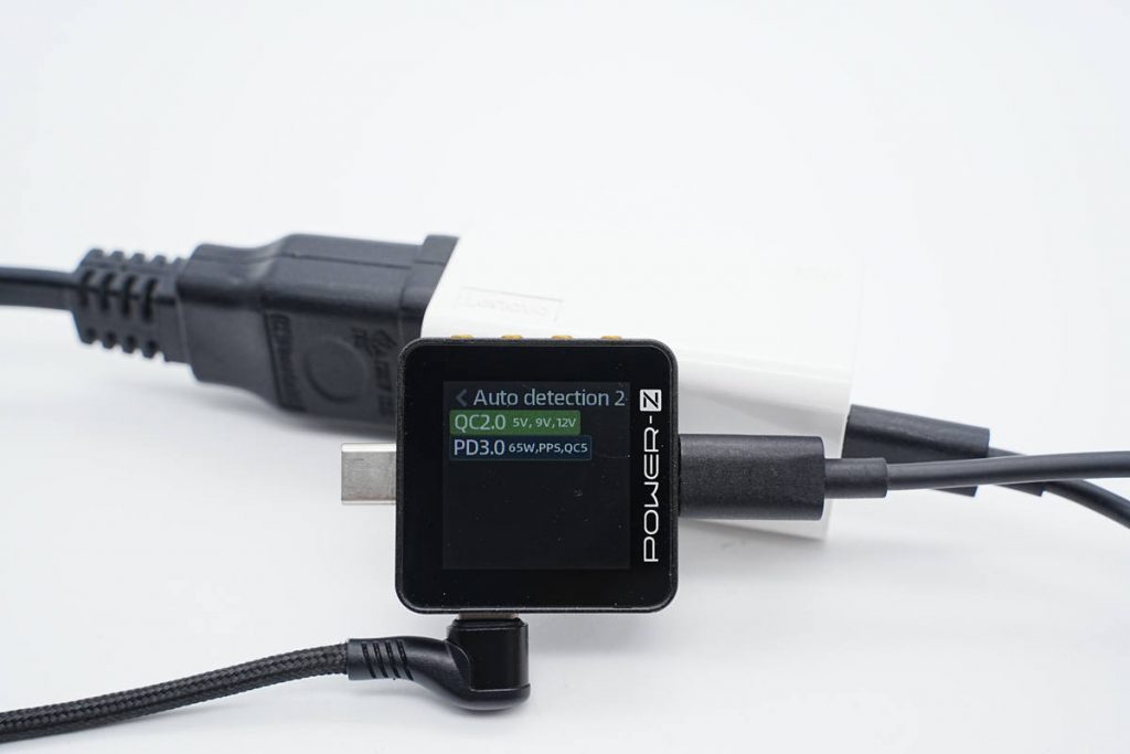

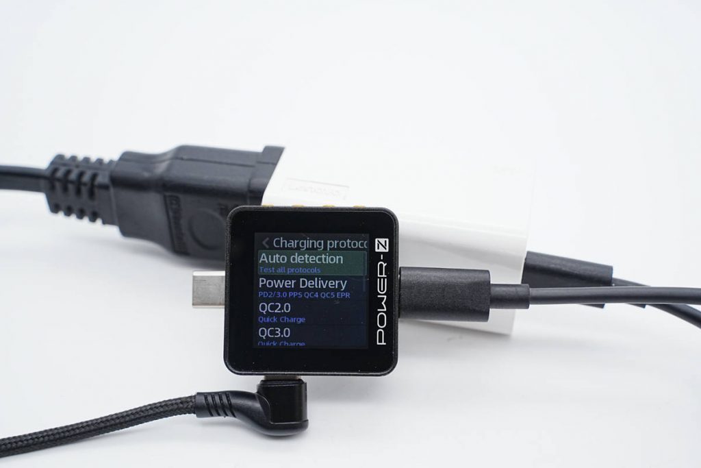

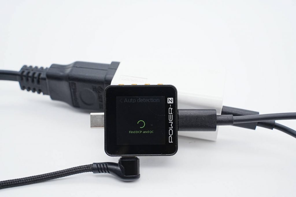

After entering the "Charging protocol", select the the first item, "Auto detection, Test all protocols", and then press the "Confirm" button.
The tester is reading the information of the charger.
The POWER-Z KM002C shows that the Lenovo 65W charger supports QC2.0, QC5, PPS and PD3.0 protocols.

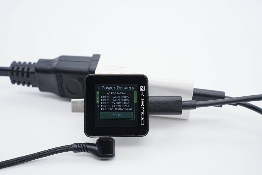

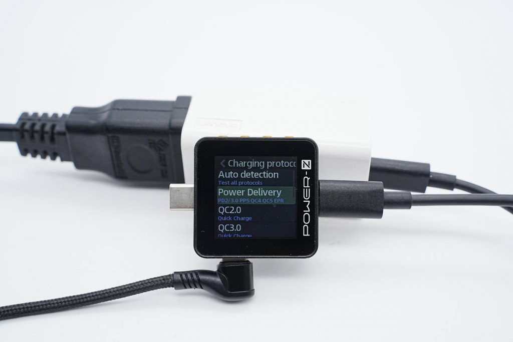

Then, go back to "Charging protocol", select the the second item, "Power Delivery", and then press the "Confirm" button.

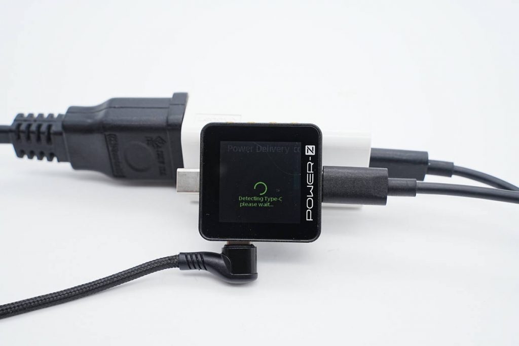

The tester is reading the information of the USB-C port.
The POWER-Z KM002C shows that the Lenovo 65W charger supports four fixed PDOs of 5V3A / 9V3A / 15V3A / 20V3.25A and one PPS of 5-20V3.25A.
