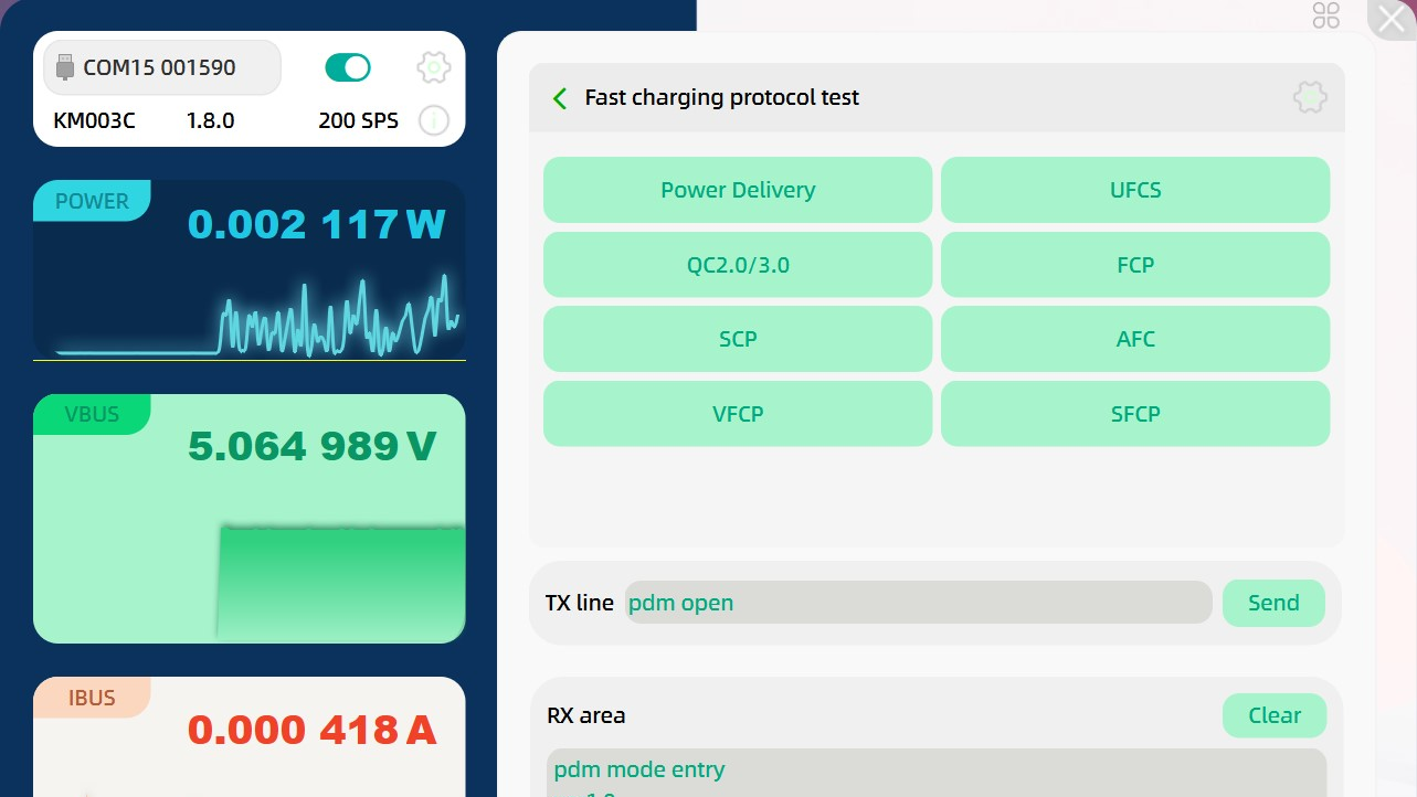

After connecting the tester, the PC software displays supported fast charging protocols: PD, UFCS, QC2.0/3.0, FCP, SCP, AFC, VFCP, SFCP, etc., allowing you to trigger voltage and current for the corresponding protocols.

Click the "Power Delivery" option to enter the voltage and current value selection menu for this protocol.
Protocol Trigger Module on PC | The New Update of POWER-Z KM003C/2C-Chargerlab
You'll see the various supported values for PD3.1, with the highest being 28V 5A.
