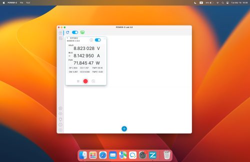

The main interface of POWER-Z Lab V3.0 consists of several sections: the status bar, function switch, data display area, and settings. Notably, both the Windows and Mac versions share the same interface and functionality. In this demonstration, we’ll use the Windows version as an example.
ChargerLAB POWER-Z Lab V3.0 Beta: Now Available for Mac!-Chargerlab
The status bar is divided into two sections: File and Tool. The File menu allows users to import data saved from other computers or previous versions of the software. The Function Switch provides a one-click connection to all testers, with a refresh button on the left for updating connected devices and a adjust refresh rate option on the right.
The Data Display Area presents real-time information from connected testers and provides access to historical data. Meanwhile, the Settings includes options for firmware upgrades (which can be updated online in the official release), software updates, tutorials (with links to the official POWER-Z website), about section, language selection (English/Chinese), and theme customization.

You can choose which testers to connect using the Toggle Switch in the blue box. To connect multiple devices at once, enable the Function Switch in the upper-left red box.
