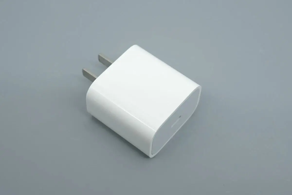

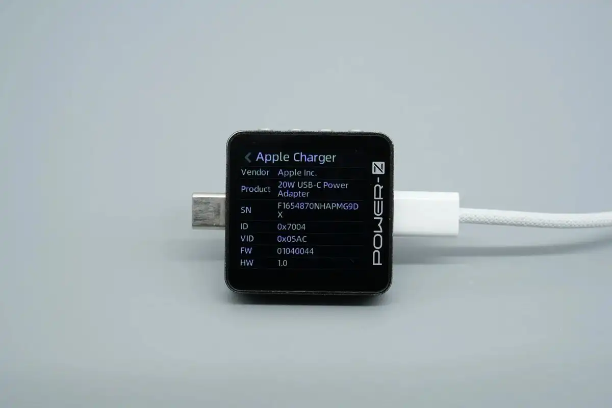

This month, Apple introduced the MacBook Neo, a new laptop line positioned separately from the existing Air and Pro series. One of its key highlights is the first-ever use of a smartphone-class processor in a Mac. The device features two USB-C ports and comes standard with a 20W USB-C power adapter. We used the KM003C to read and analyze the charger data.
ChargerLAB POWER-Z KM003C Reads SN of MacBook Neo Charger-Chargerlab
Charger Information (via KM003C):
Vendor: Apple Inc.
Product: 20W USB-C Power Adapter
Serial Number (SN): F1654870NHAPMG9DX
Device ID (ID): 0x7004
Vendor ID (VID): 0x05AC
Firmware Version (FW): 01040044
Hardware Version (HW): 1.0
Specifications:
Manufacturer: Salcomp Technology (Shenzhen) Co., Ltd.
Factory: Salcomp Technology (Shenzhen) Co., Ltd.
Input: 100–240V~ 50–60Hz 0.5A
Output: 5V⎓3A or 9V⎓2.22A
Model: A2244
SN: F1654870NHAPMG9DX
By cross-checking the serial number read by the POWER-Z KM003C with the SN printed on the charger’s physical label, we confirmed that the information matches exactly. The specifications are listed above. Test results are for reference only; actual performance may vary.
