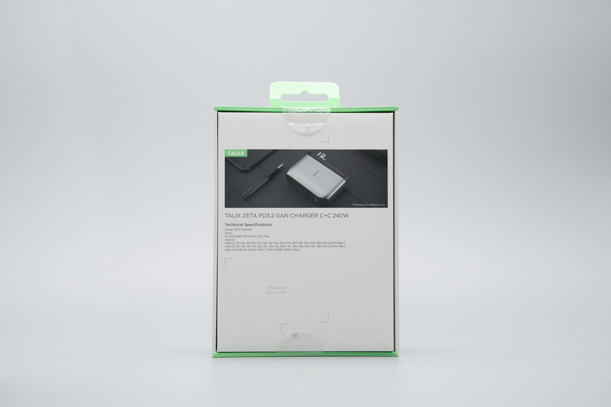

The product information is printed on the back

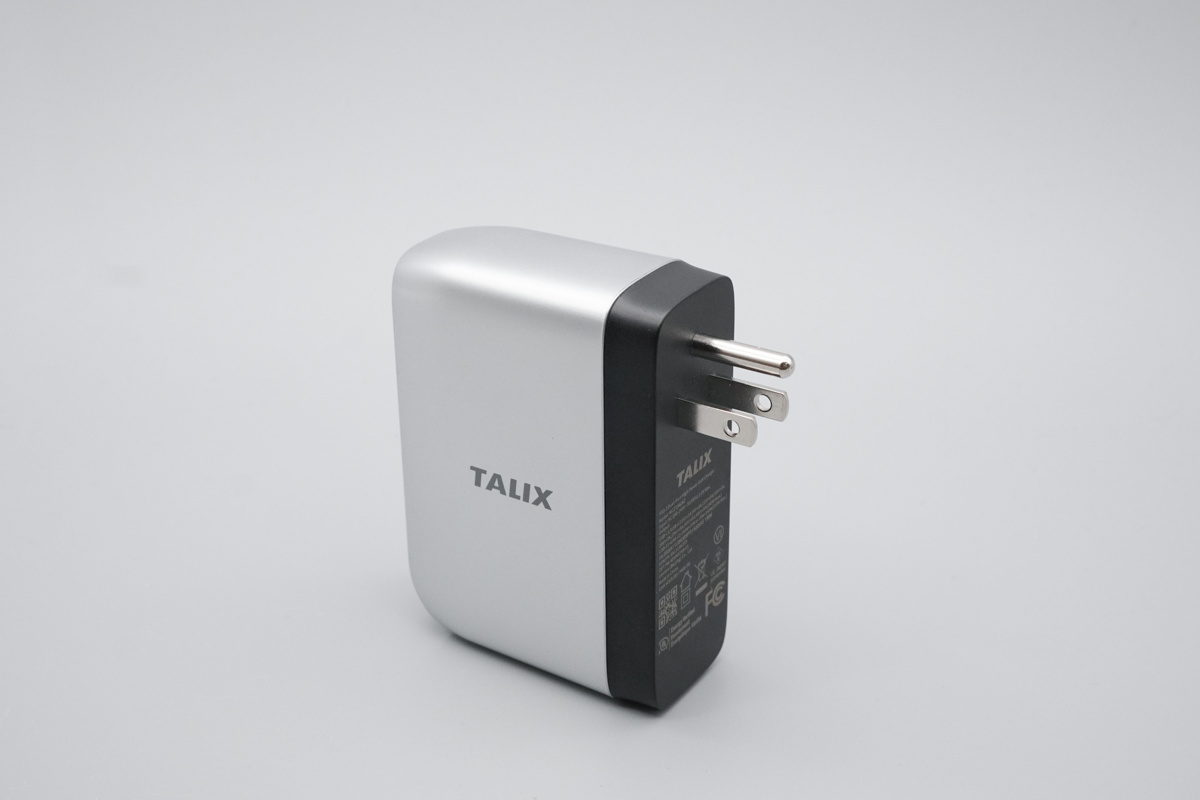

This charger is designed as silver-black appearance. The silver metallic paint has a very high-quality feel, and the outer shell is rounded with a US-standard AC plug.

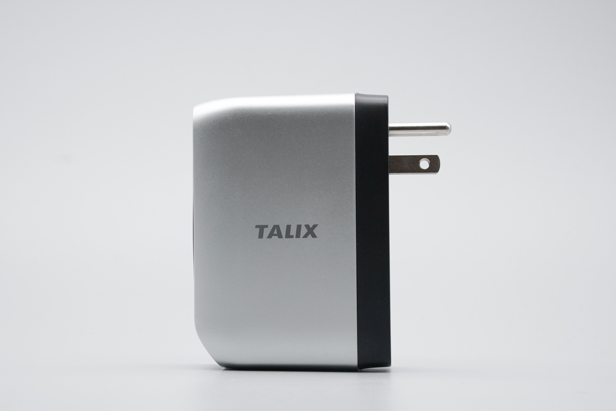

The charger remains the simple design on sides.

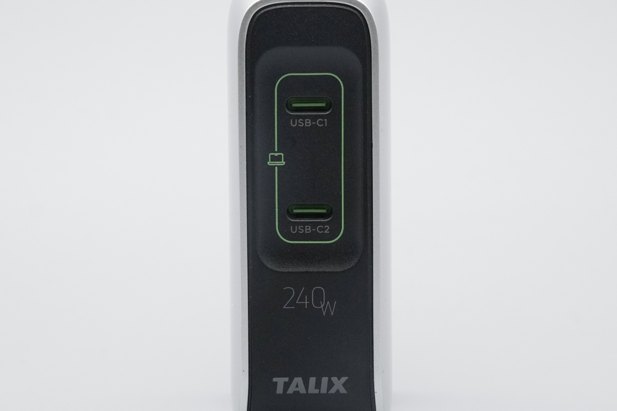

The output ports are equipped with two USB-C ports, which are outlined in green. Each port supports 240W output and dual-port output can achieve a super power of 210W.

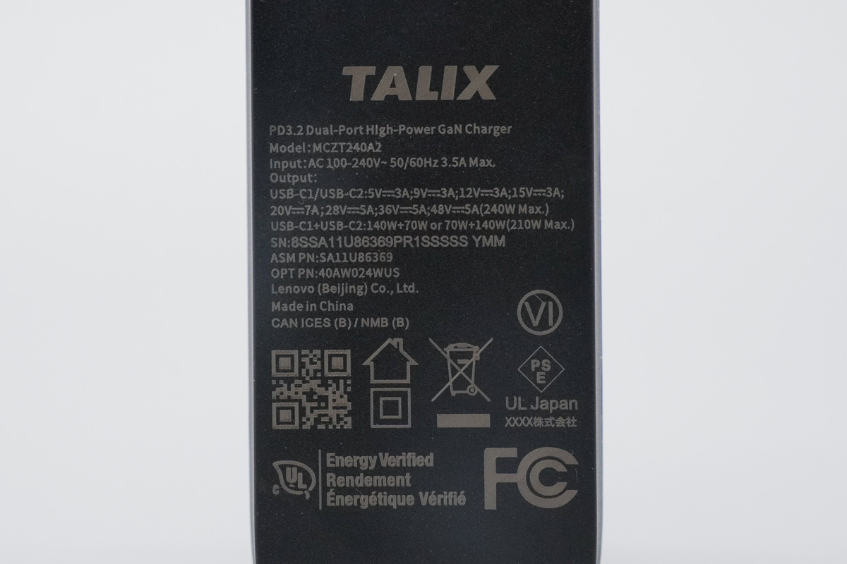

Detailed specifications are printed on this side.
Model: MCZT240A2
Input: 100-120V~3.1A,200-240V~1.56A 50/60Hz
Output:
USB-C1/USB-C2: 5V3A, 9V3A, 12V3A, 15V3A, 20V7A, 28V5A, 36V5A, 48V5A(240W)
USB-C1+USB-C2: 140W+70W or 70W+140W(210W)

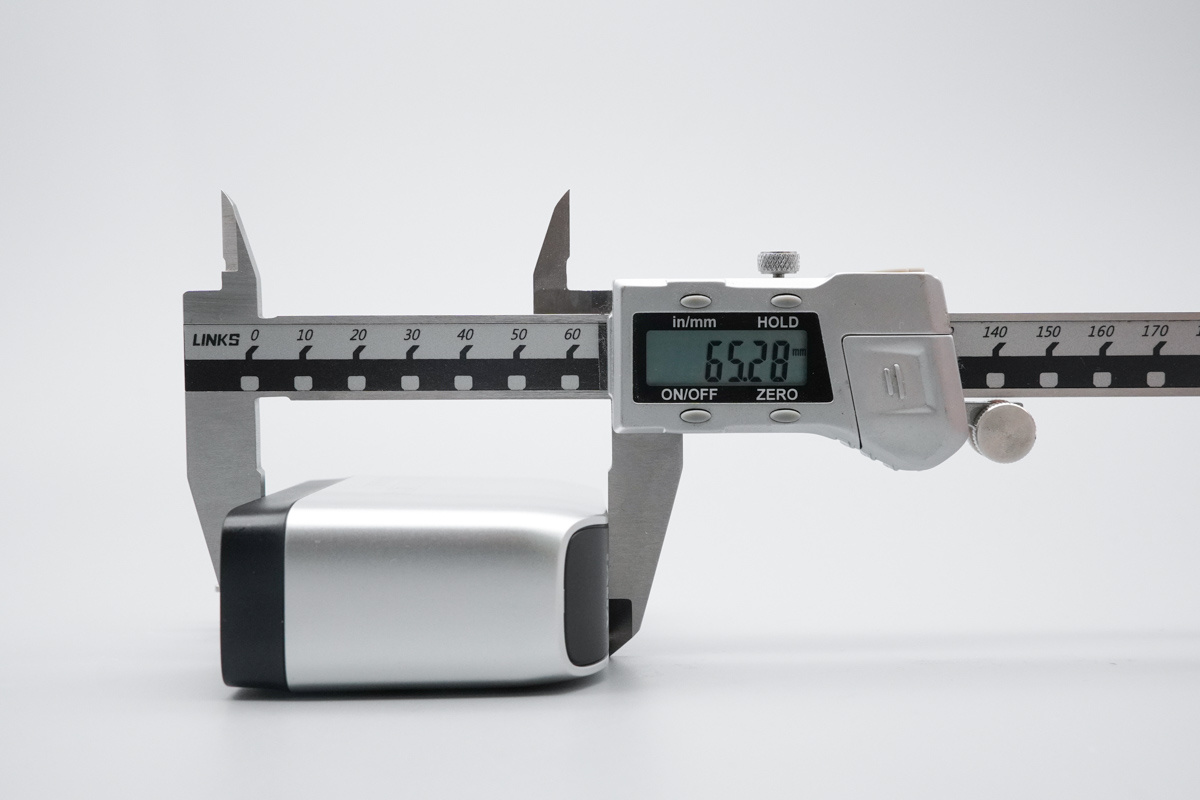

The length is about 65.28mm.

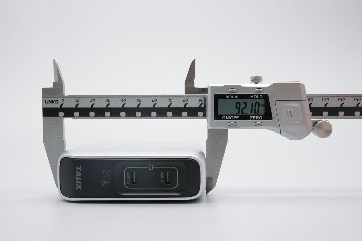

Review of TALIX Zeta 240W PD3.2 Charger-Chargerlab
The width is about 92.10mm.

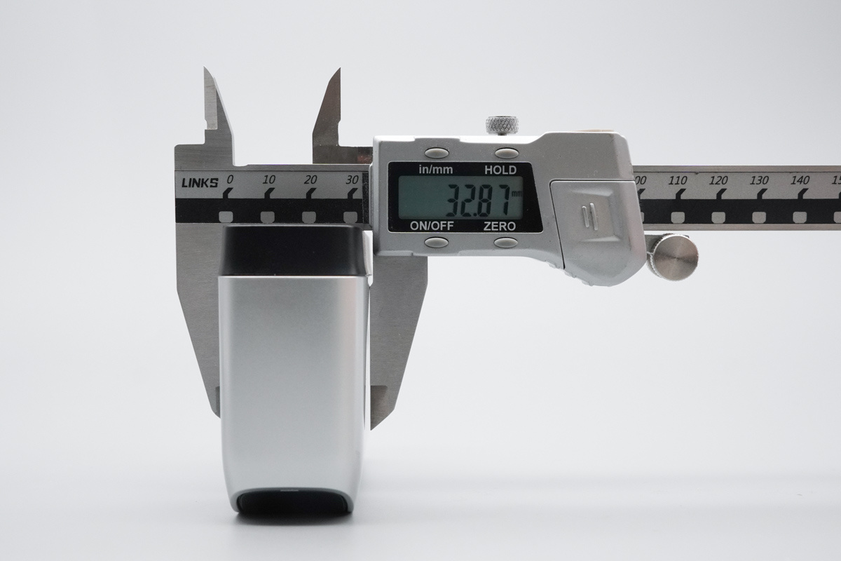

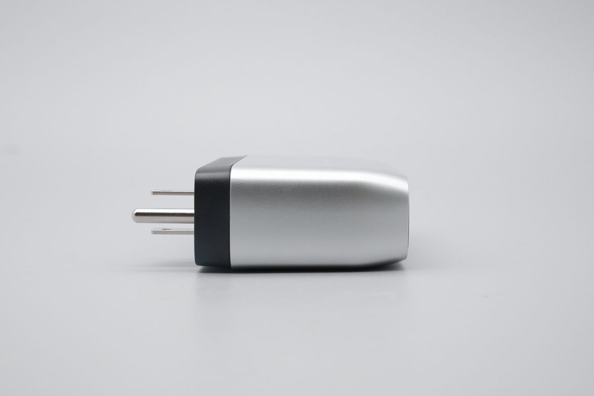

The thickness is about 32.87mm. The volume is about 197.12 cm³. Counting it at 240W, the power density is about 1.22 W/cm³.

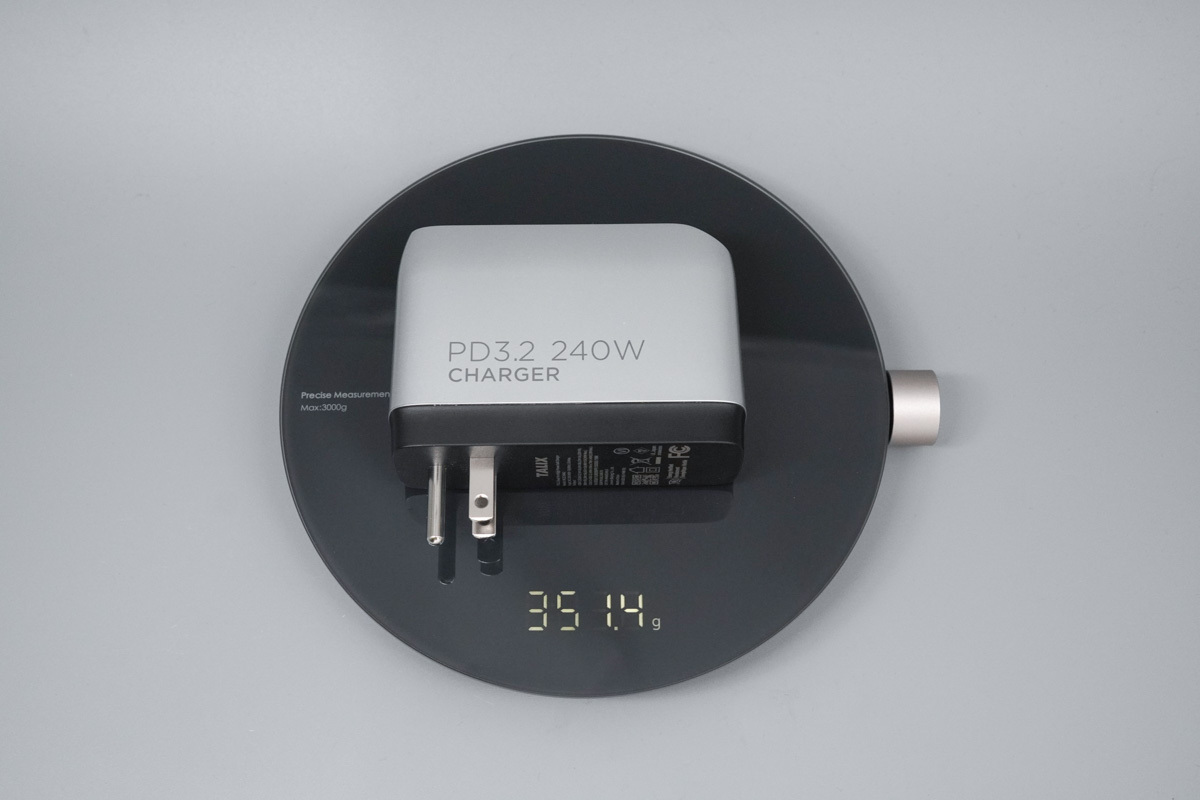

The weight is about 351.4g.

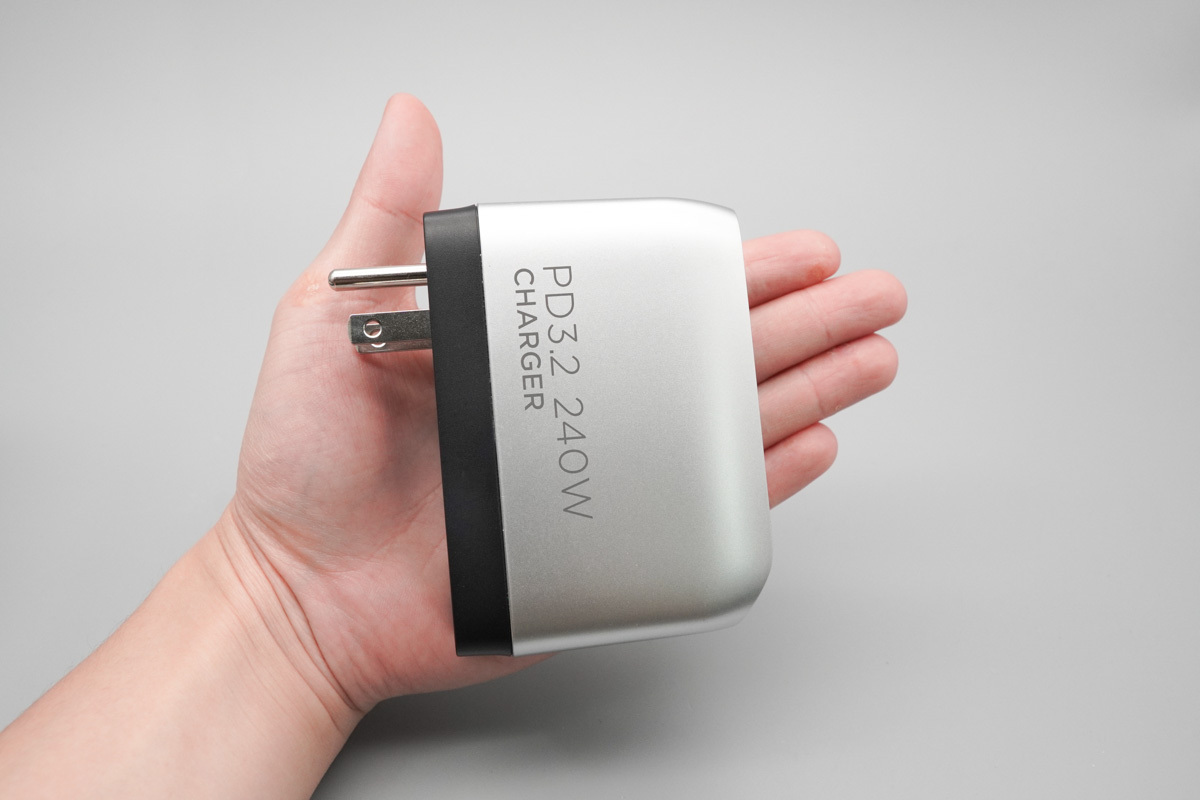

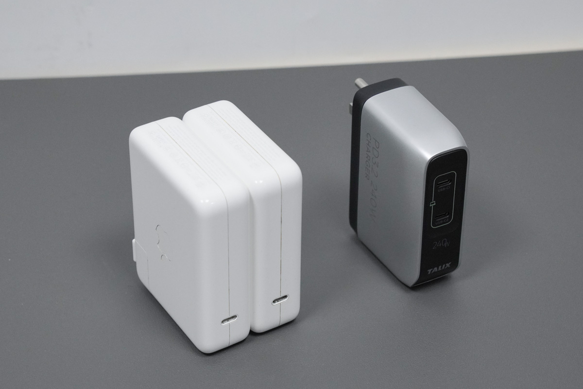

Thanks to the high power density, it achieves total power of 240W while deceases its size as possible. With the same efficiency as two Apple 140W chargers, the dual-port charger is only half as big.
The charger’s size when held in an adult’s hand is shown in the picture.

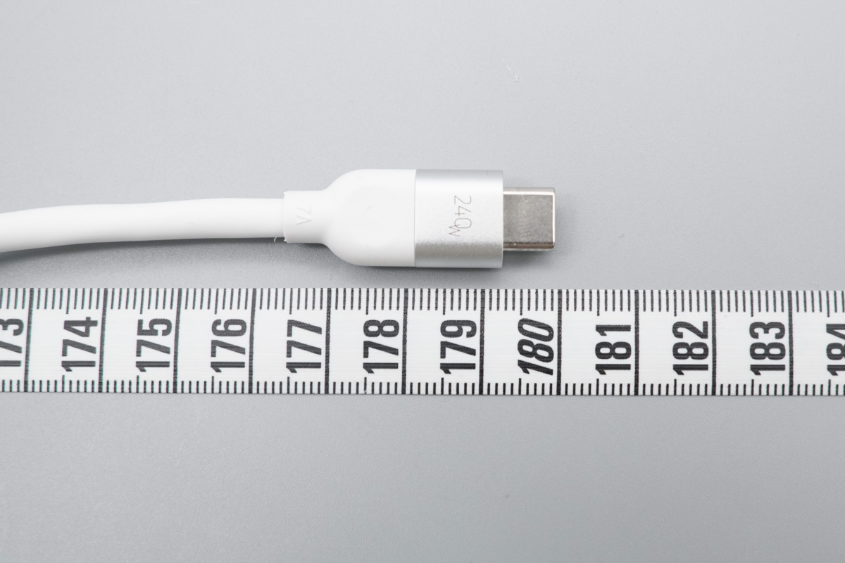

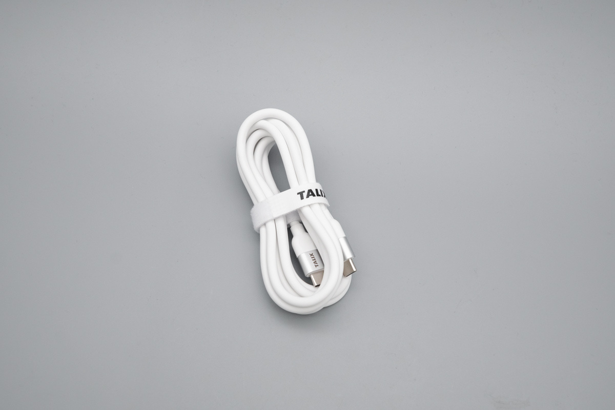

The silicone charging cable is extremely long, soft to touch, with a Velcro strap for easy storage.
The length of cable is about 180cm.

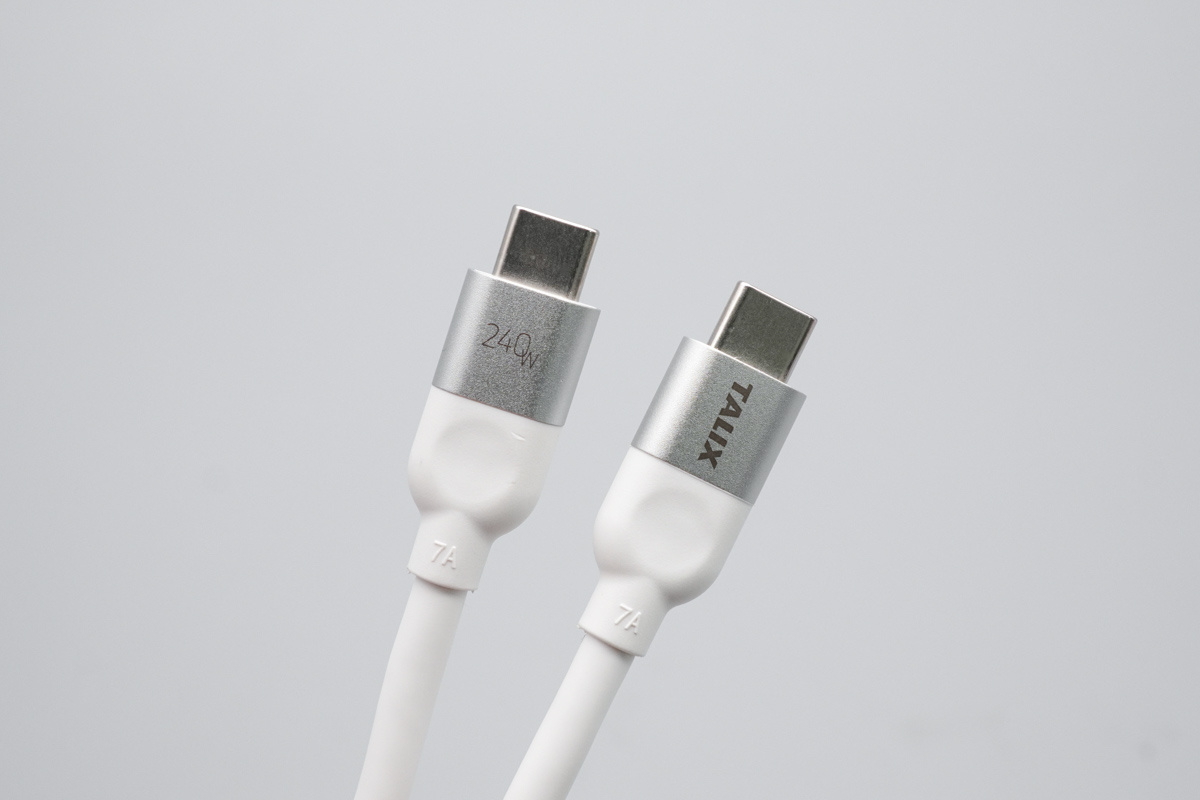

The connector is covered by alloy, featured with "240W, TALIX" and "7A", which can carry a large current.

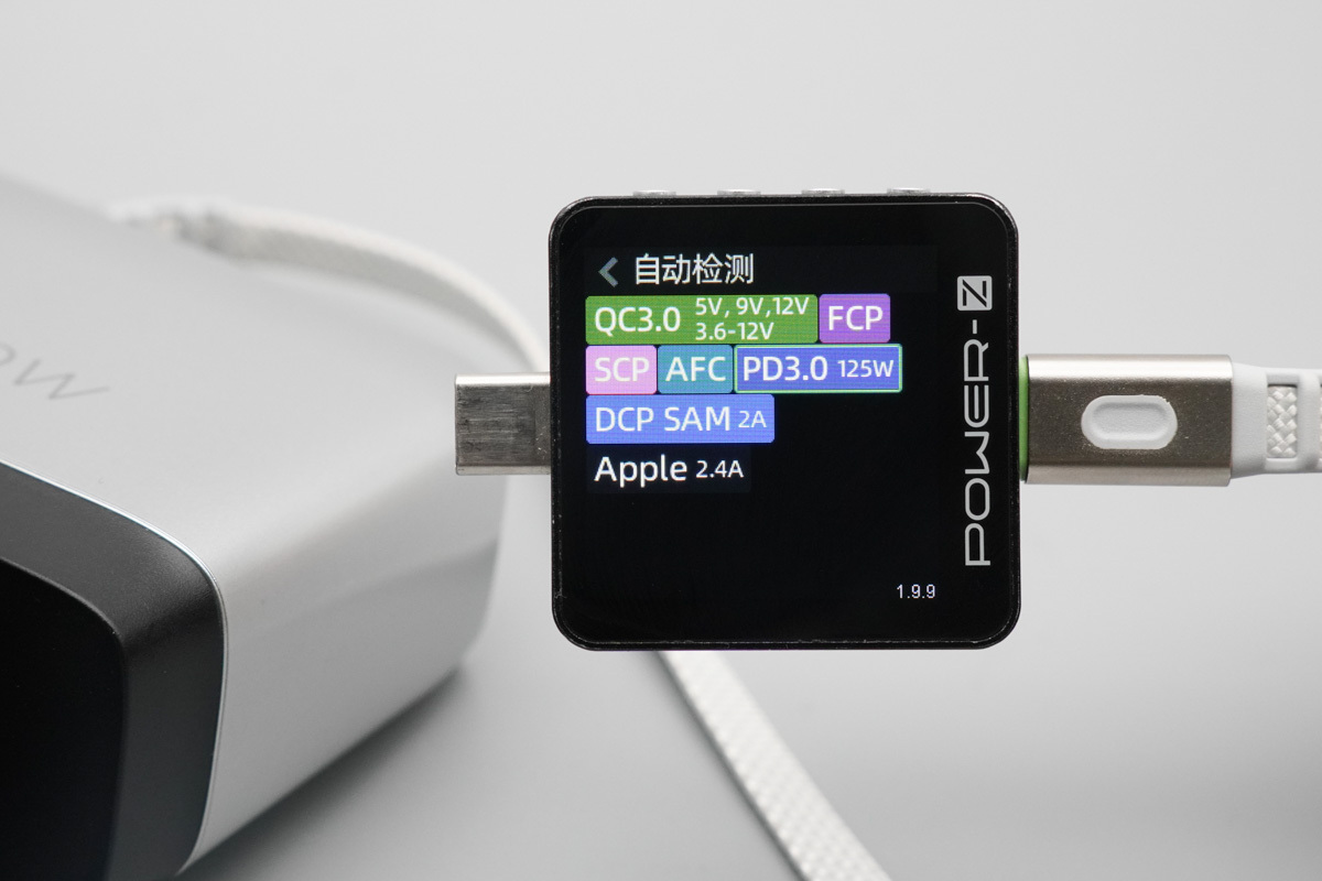

Protocol Test
Except for listed charging protocols, understanding the complete protocols can help users select devices based on the specific protocols, achieving a better fast charging experience.

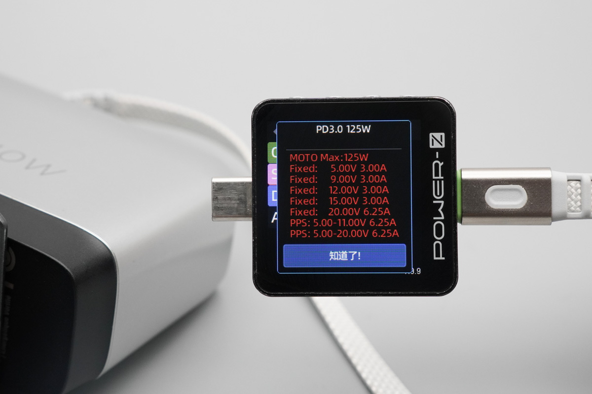

With the help of POWER-Z KM003C tester, USB-C1/C2 output supports QC3.0, FCP, SCP, AFC, PD3.0(MOTO 125W), AVS, DCP. In fact, it also supports PD3.2.
It features 5 fixed PDOs--5V3A, 9V3A, 12V3A, 15V3A, 20V6.25A--along with 2 PPS voltage range of 5-11V 6.25A and 5-20V 6.25A.

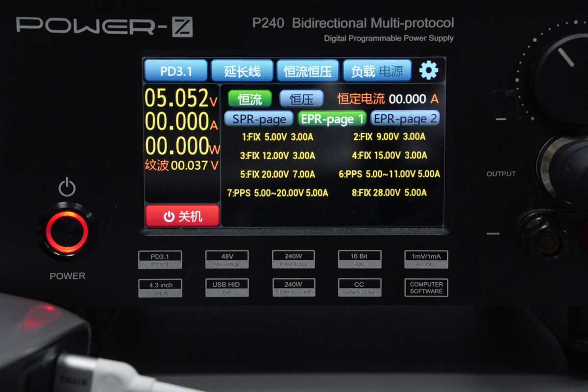

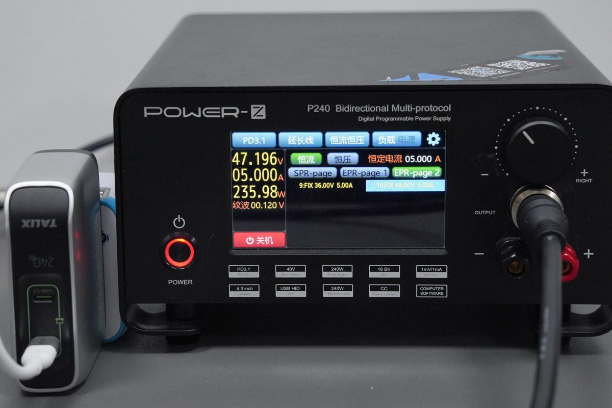

Using the ChargerLAB P240 tester for load testing, the complete PD range of 5-48V can be read.
The charger can operate normally if single port used in a maximum load of 48V5A 240W.

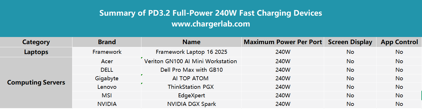

According to statistics, TALIX Zeta 240W PD3.2 also supports the Framework Laptop 16 (2025) and AI computing servers from other major brands, such as Acer, Dell, and Gigabyte, providing high-power power supply support.

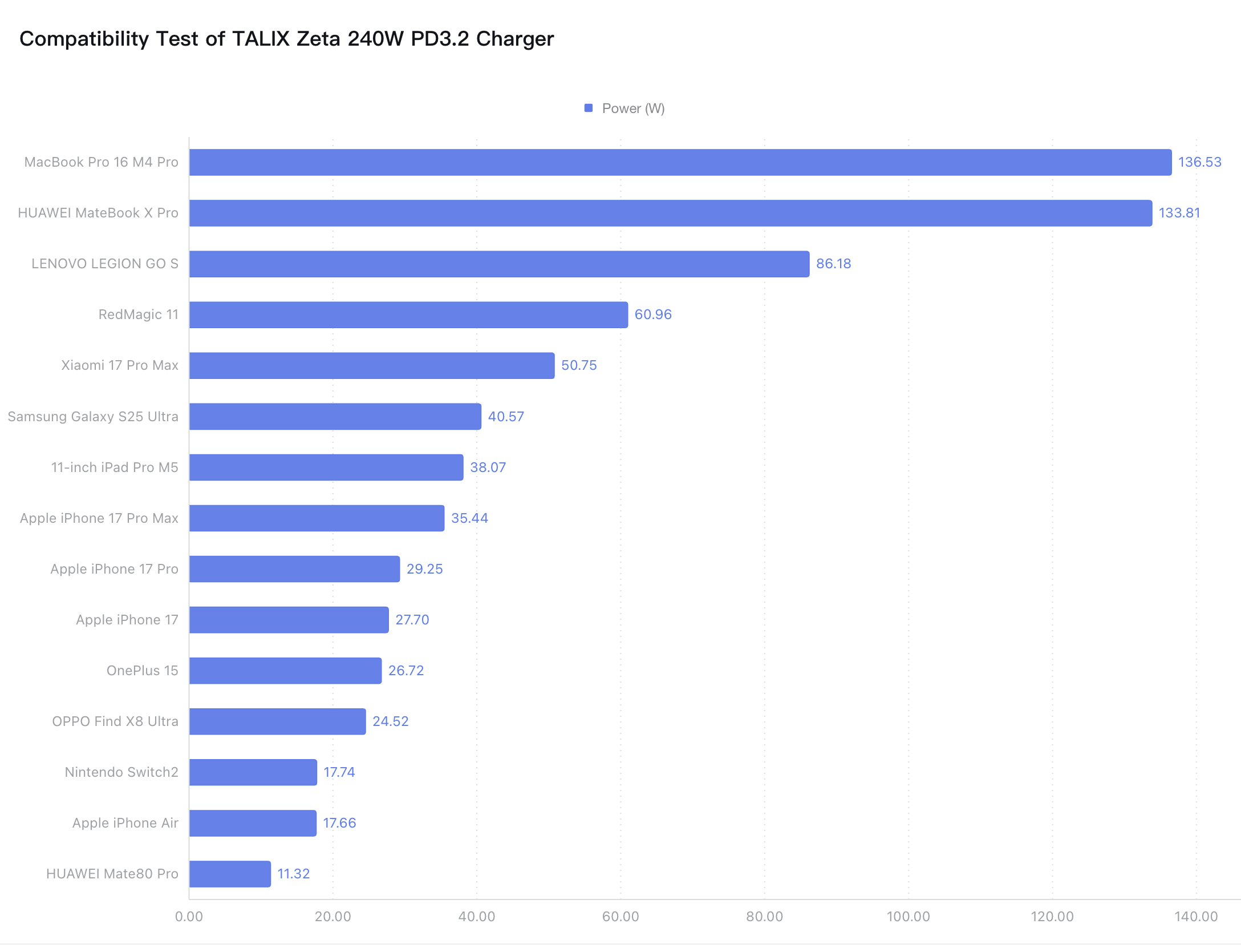

The compatibility testing phase clearly demonstrates how well the charger charges various devices. Below are test results with different devices.

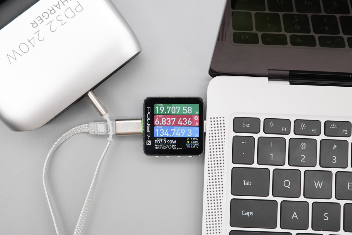

Use it to charge the MacBook Pro 16 M4 Pro. POWER-Z KM003C tester shows the power is 19.71V6.84A 134.75W.

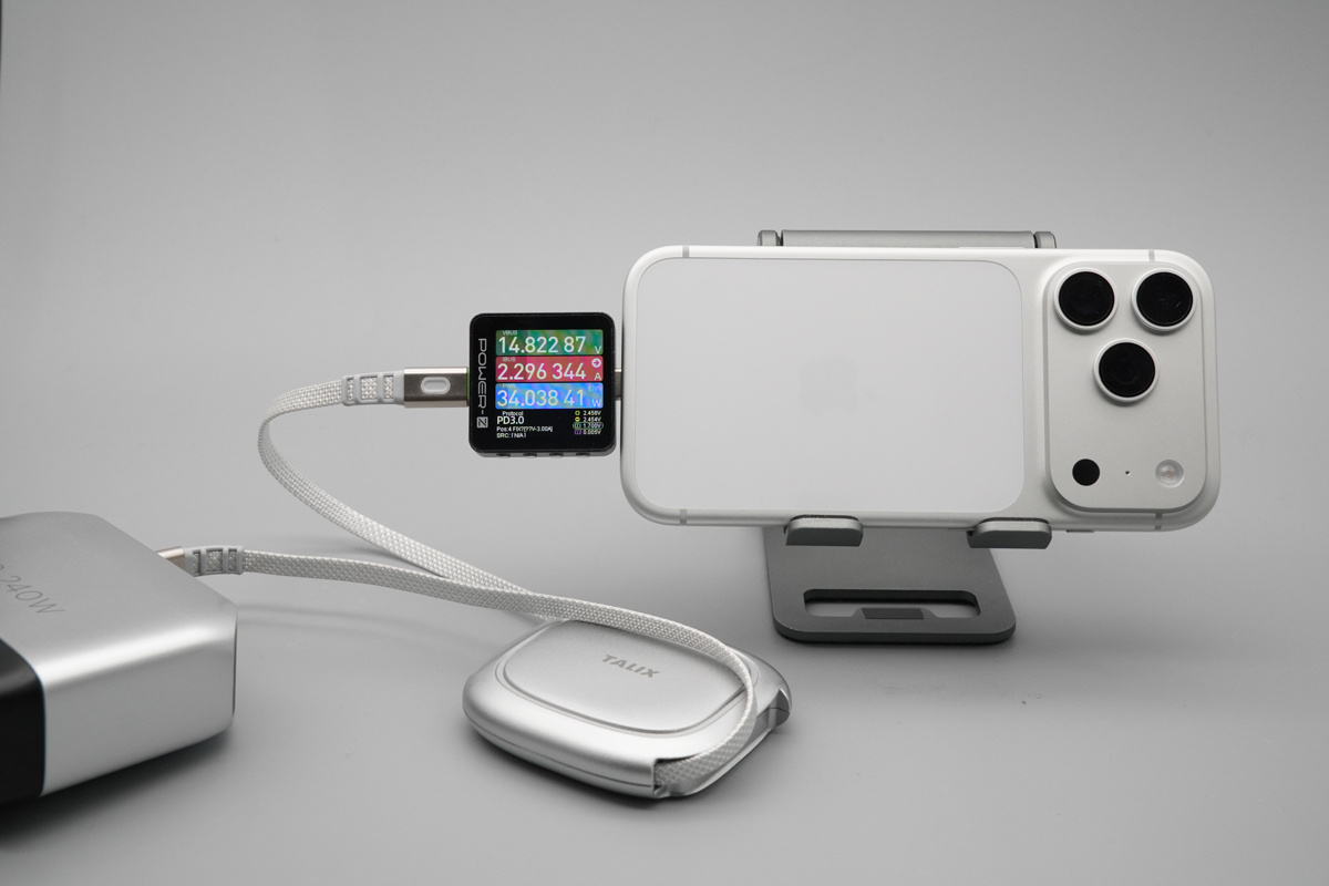

Use it to charge iPhone 17 Pro. POWER-Z KM003C tester shows the power is 14.82V 2.30A 34.04W.
Summarizing the data, it provides high-power fast charging for laptops, such as MacBook Pro 16 M4 Pro (136.53W), Huawei MateBook X Pro (133.81W). Most phones supporting high-power PPS protocols can reach 40-61W fast charging. iPhone 17 series can reach original charging power. Other Android phones can also reach above 24W charging power. Overall compatibility is excellent.

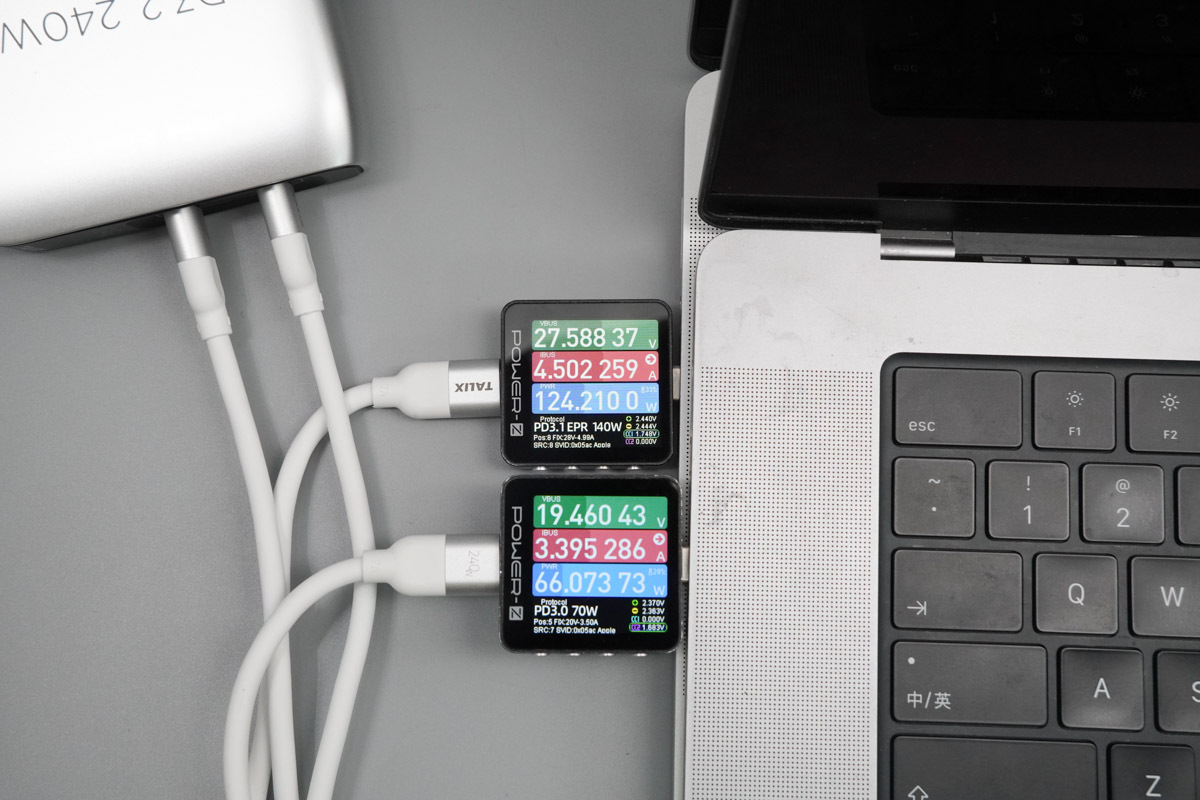

Use it to charge two MacBook, the power is 124.2W, 66.07W.

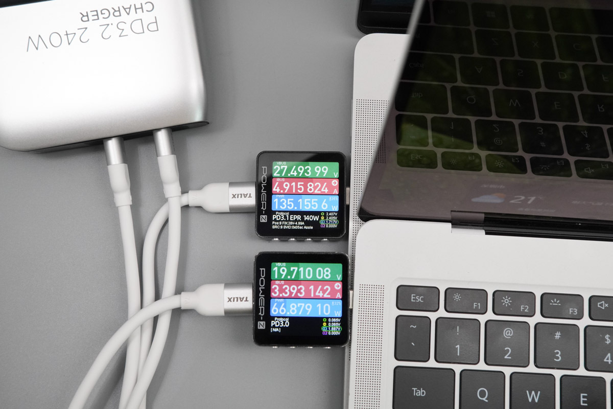

Use it to charge MacBook Pro 16 M4 Pro and MateBook X Pro, the power is 135.15W, 66.88W.

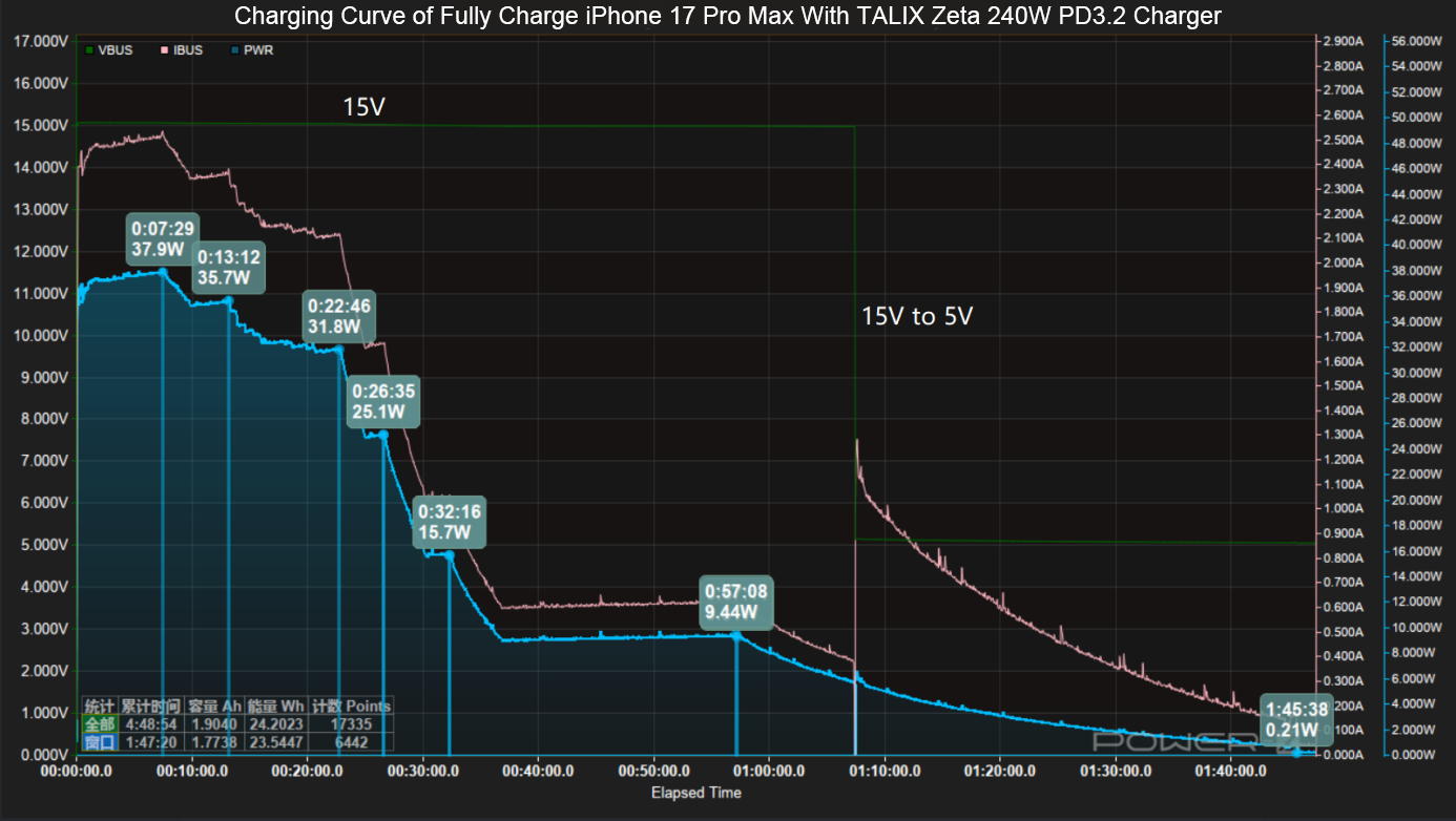

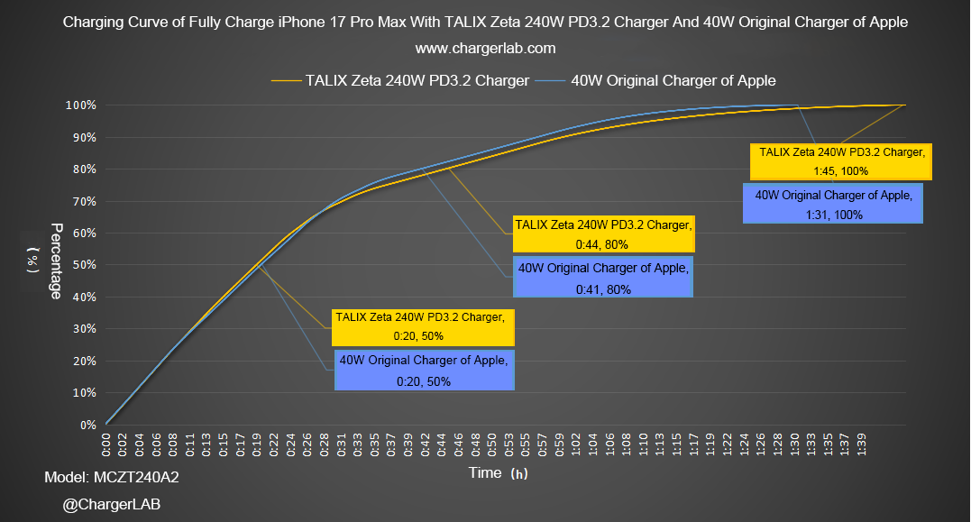

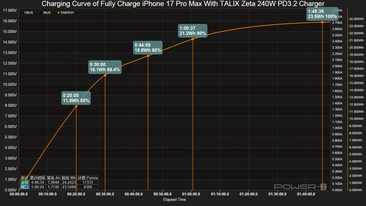

Use it to charge iPhone 17 Pro Max in a 25℃ constant temperature chamber with the record of POWER-Z KM003C.
The voltage is always around 15V. The charging power is 37.9W in the first 7 minutes. Then, the power drops to 35.7W until 13rd minutes. Eventually the power drops to 31.8W, 25.1W, 15.7W in turn. Until 57th minutes, the power drops to 9.44W. At 1 hour and 7 minutes, iPhone 17 Pro Max starts trickle charging and finally end charging at 1 hour, 45 minutes and 38 seconds.
It charges the iPhone 17 Pro Max to 50% in 20 minutes, 68.4% in 30 minutes, 80% in 44 minutes, 90% in 60 minutes, 100% in 1 hour, 45 minutes and 38 seconds.
Compared with Apple’s 40W original charger, the TALIX Zeta 240W PD3.2 charger maintains the same charging speed as original charger from 0-50%, but its charging speed is relatively slower than original charger’s in the later stage, differing by 3 minutes at 80% and 14 minutes at 100%.
Overall, the TALIX Zeta 240W PD3.2 charger passes the ChargerLAB’s iPhone 17 Pro Max fast charging test with the excellent result of charging to 50% in 20 minutes.

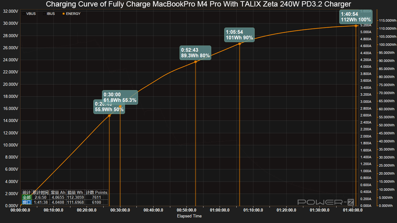

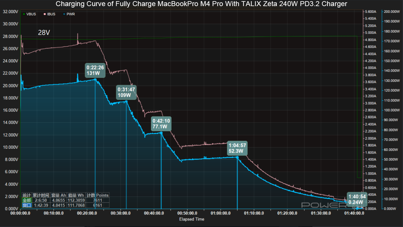

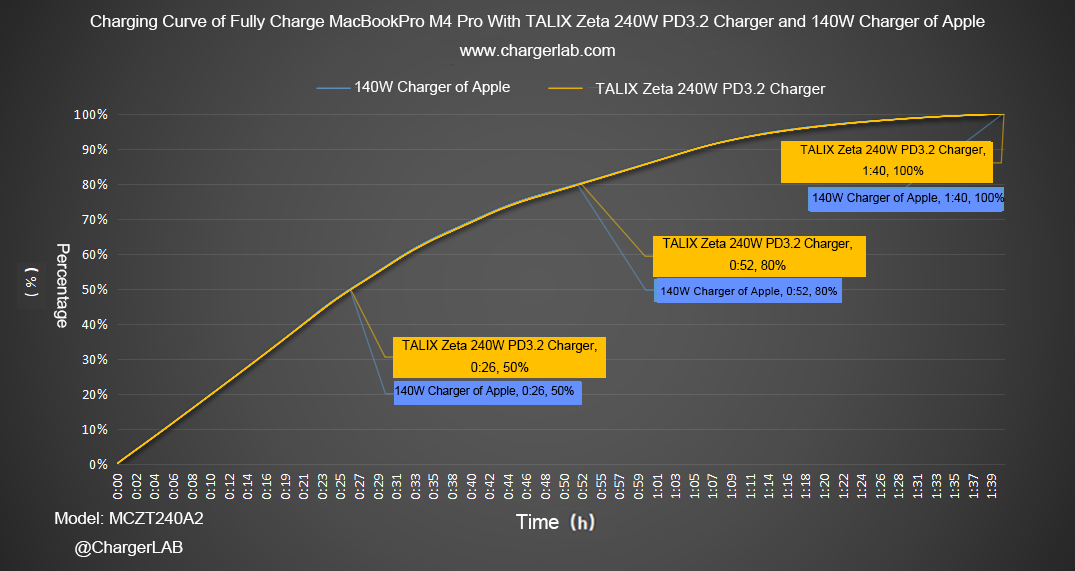

Use it to charge MacBook Pro 16 M4 Pro and record the result.
The voltage is always around 28V. The charging power is 131W in 22 minutes. Then, it drops to 109W and remains there until 31st minutes. The power then drops to 77.1W and lasts until 42nd minutes. Subsequently, it drops to 52.3W until 1 hour and 4 minutes later. Finally the charging ends at 1 hour and 54 minutes.
The TALIX Zeta 240W PD3.2 charger charges MacBook Pro 16 M4 Pro to 50% in 20 minutes, 55.3% in 30 minutes, 100% in 100 minutes and 54 seconds. The full charging is very fast.
Compared with the 140W original charger, its charging speed is consistent at every stage, reaching the original charging level, which is an excellent result.
Overall, the TALIX Zeta 240W PD3.2 charger passes the ChargerLAB’s MacBook Pro M4 Pro fast charging test with the excellent result of charging to 50% in 20 minutes, 80% in 52 minutes.

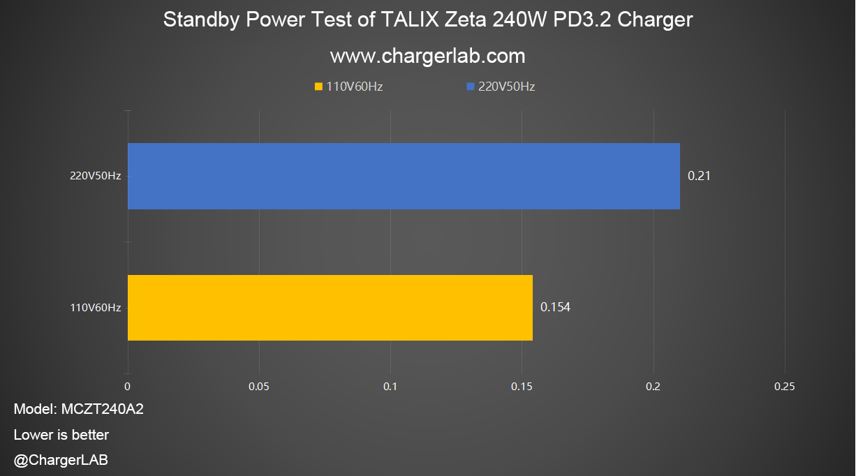

Power supplies are often kept plugged in for a long period. Even if the device is idle, the accumulated consumption during no-load operation becomes a hidden cost. No-load test is to verify the long-term power economy in such scenarios.
The no-load power consumption is only 0.21W at 220V 50Hz, translated to annual loss of approximate 1.84kW・h. If count it with the price of 0.6 yuan/ kW・h, the annual electricity cost of single device is about 1.1 yuan. At 110V 60Hz, the no-load power consumption further drops to 0.154W, with an annual loss of approximate 1.35kW・h, corresponding to an electricity cost of only 0.81 yuan.

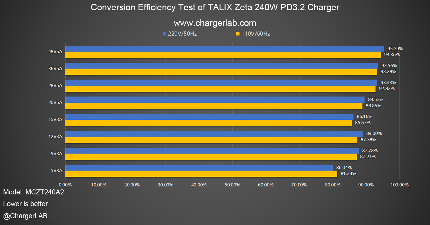

Essentially, a charger is a conversion device and there will be some losses during the process which is dissipated in the form of heat. The input power tends to be greater than the charger’s printed power. Next, we’ll test the conversion efficiency of TALIX Zeta 240W PD3.2 charger at 220V 50Hz and at 110V 60Hz.
First, overall conversion efficiency at 220V 50Hz is from 80.04-95.39%.The highest conversion efficiency reaches 94.36% in 48V 5A. The lowest conversion efficiency is 81.34% in 5V 3A.
Overall, the TALIX Zeta 240W PD3.2 charger’s conversion efficiency across both voltage is the first class among other charger on the market. At 28V, 36V, 48V, it can reach above 93% conversion.

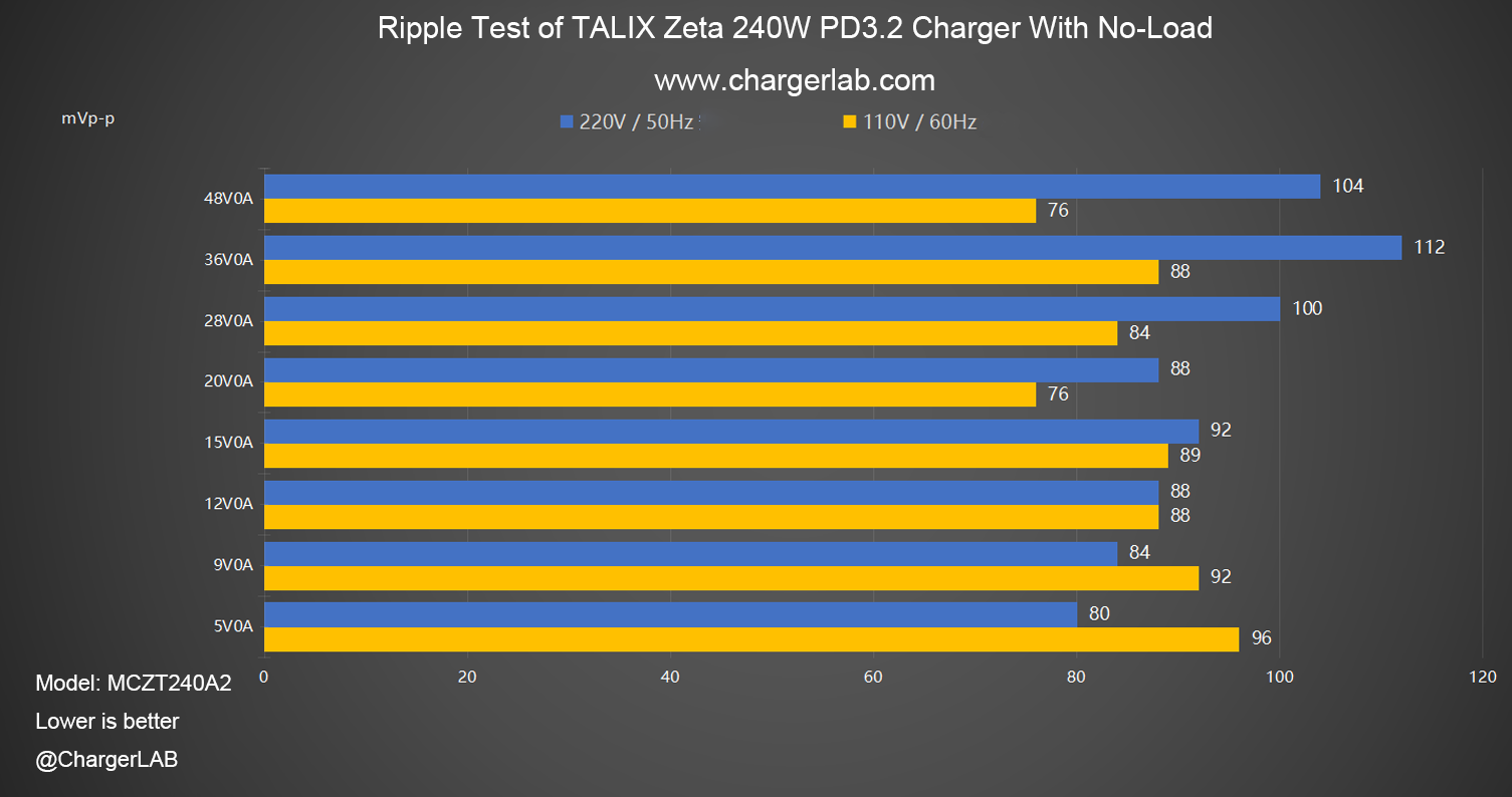

Ripple Test
First, let’s check out the result without load.
Under 220V50Hz condition, the highest ripple is 112mVp-p at 36V0A; the lowest ripple is 80mVp-p at 5V0A.
Under 110V60Hz condition, the highest ripple is 96mVp-p at 5V0A; the lowest ripple is 76mVp-p at 20V0A and 48V0A.

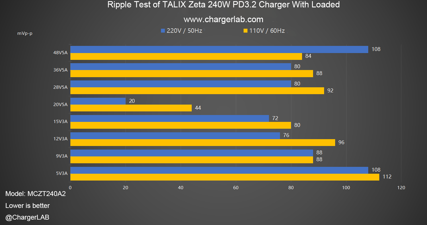

Next, there is the result with load.
Under 220V50Hz condition, the highest ripple is 108mVp-p at 5V3A and 48V5A; the lowest ripple is 20mVp-p at 20V5A.
Under 110V60Hz condition, the highest ripple is 112mVp-p at 5V3A; the lowest ripple is 44mVp-p at 20V5A.
Overall, the ripple is relatively stable under both voltage types. Most of the ripple are from 70-90mVp-p(with load). The actual ripple performance conforms to power supply ripple standard GB/T 20943-2025, meeting the stable power supply requirement of high-class electronic components.

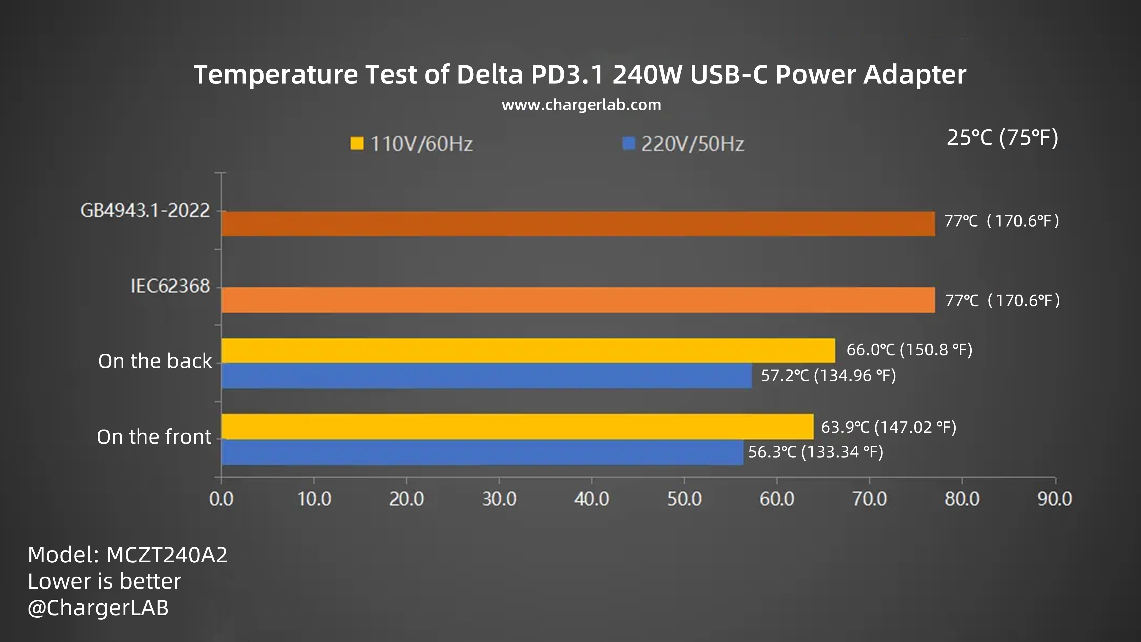

Temperature Test

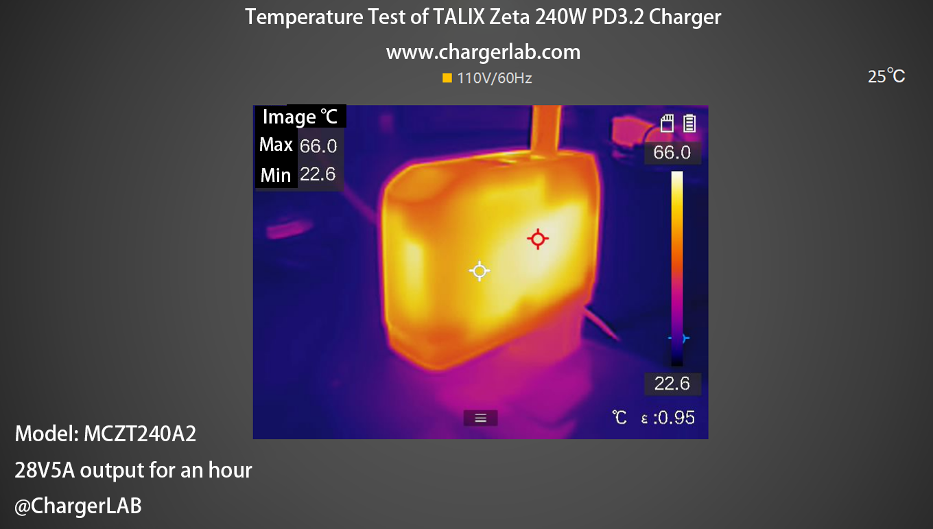

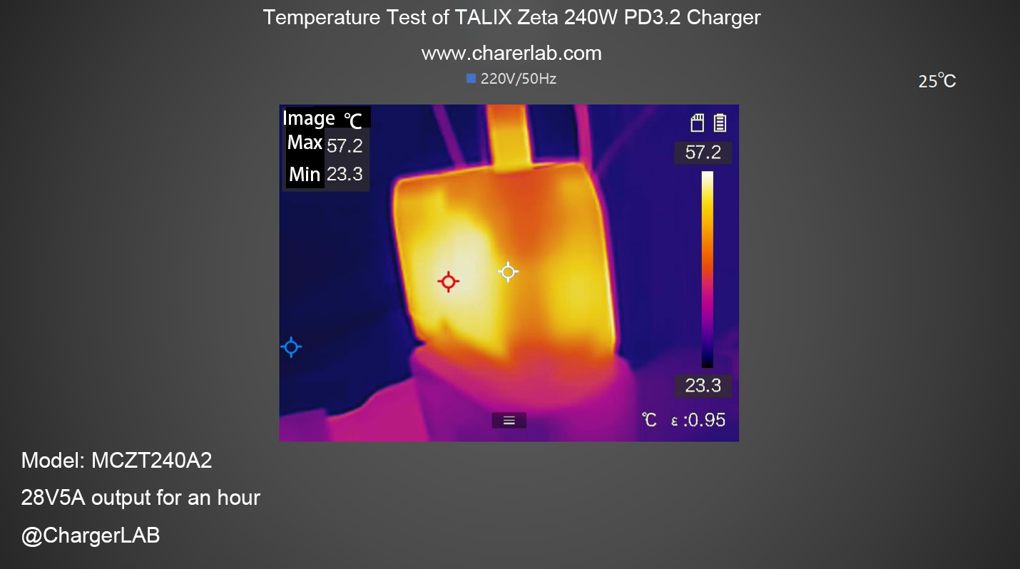

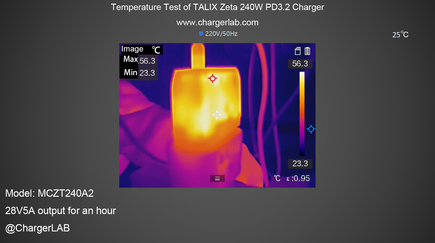

Temperature is a core indicator for evaluating the overall performance and safety of a charger. When high-power chargers operate with high loads, the power conversion will generate some heat. Poor dissipation can not only make it too hot to hold, but may also trigger the overheat protection, and even accelerate the aging with potential problems.

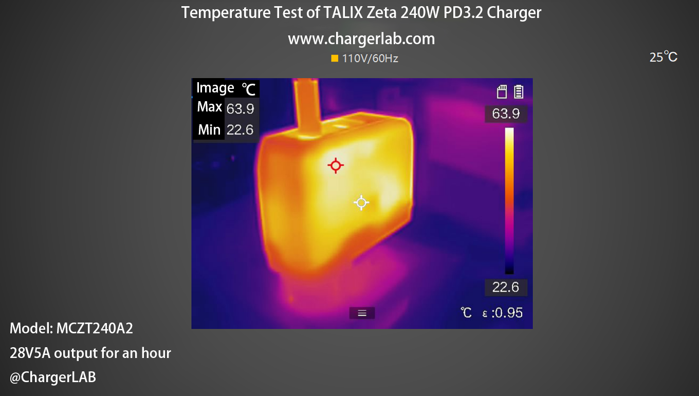

Then, we’re going to test TALIX Zeta 240W charger’s temperature control at 140W under 110V/60Hz and 220V/50Hz conditions.
The result directly reflects the rationality of the heat dissipation, which is also a key evidence to judge if it could operate stably for a long time.
One hour later, the maximum temperature is about 56.3℃ (133.34 ℉) on this side.
The maximum temperature is about 57.2℃ (134.96 ℉) on the other side.
The maximum temperature is about 63.9℃ (147.02 ℉) at 110V60Hz.
The maximum temperature is about 66.0℃ (150.8 ℉) on the other side.
Summarizing the data, the load at 110V60Hz is greater than it at 220V50Hz. Overall, under the 140W high-load condition, the temperature control of TALIX Zeta 240W charger is excellent. The highest temperature is only 57.2℃ at 220V/50Hz. It is kept below 66℃ even at 110V/60Hz.
Its surface temperature is completely lower than the safety threshold (77℃) which is regulated by GB4943.1 and IEC62368 standards. It has a significant output performance and a great heat control, avoiding the overheat problem for a long-term experience.
