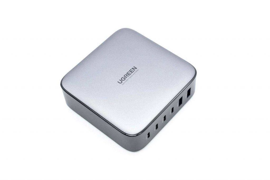

Recently, UGREEN has launched the Nexode 200W USB-C GaN desktop charger with six ports, four USB-C ports and two USB-A ports, supporting up to 100W PD fast charging and 200W total output, which can charge six devices simultaneously.
UGREEN Launches The New Nexode 200W GaN Desktop Charger (4C2A)-Chargerlab

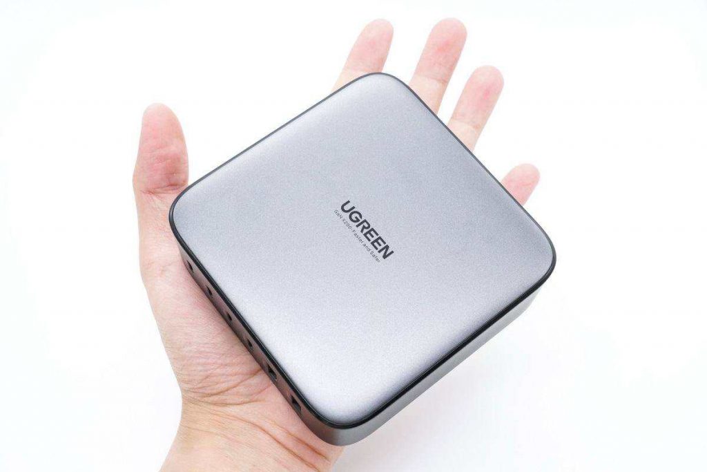

The UGREEN Nexode 200W GaN desktop charger has a black bottom and a silver cover. It's a flat square, easy to place on the desktop, under the monitor, on the TV cabinet, and in other places.

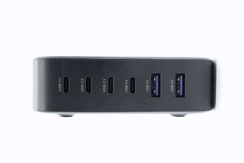

It is equipped with four USB-C and two USB-A ports, which can charge up to six devices simultaneously. Either USB-C1/C2 can support up to 100W output separately. And either USB-C3/C4 can support up to 65W output separately. For the USB-A1/A2, either can support up to 22.5W output separately.

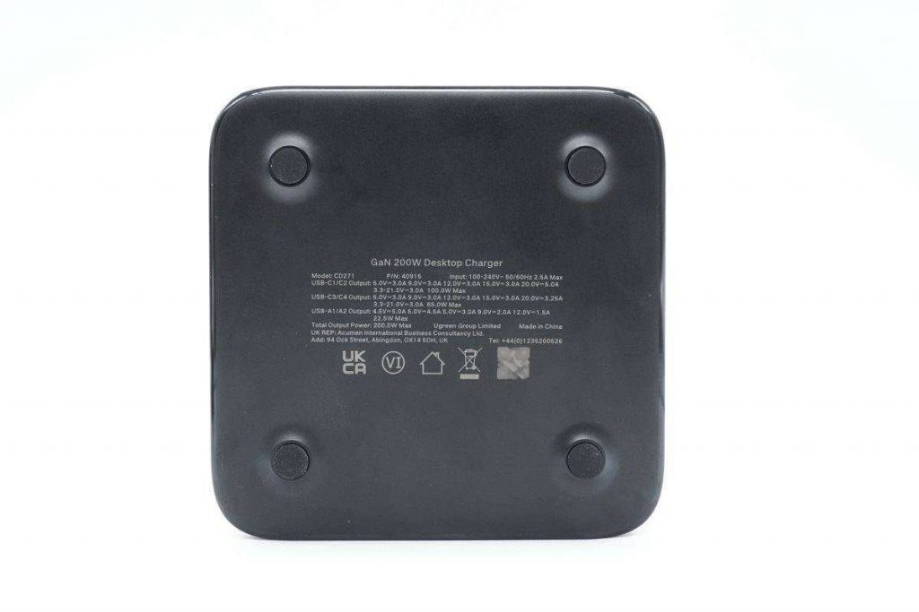

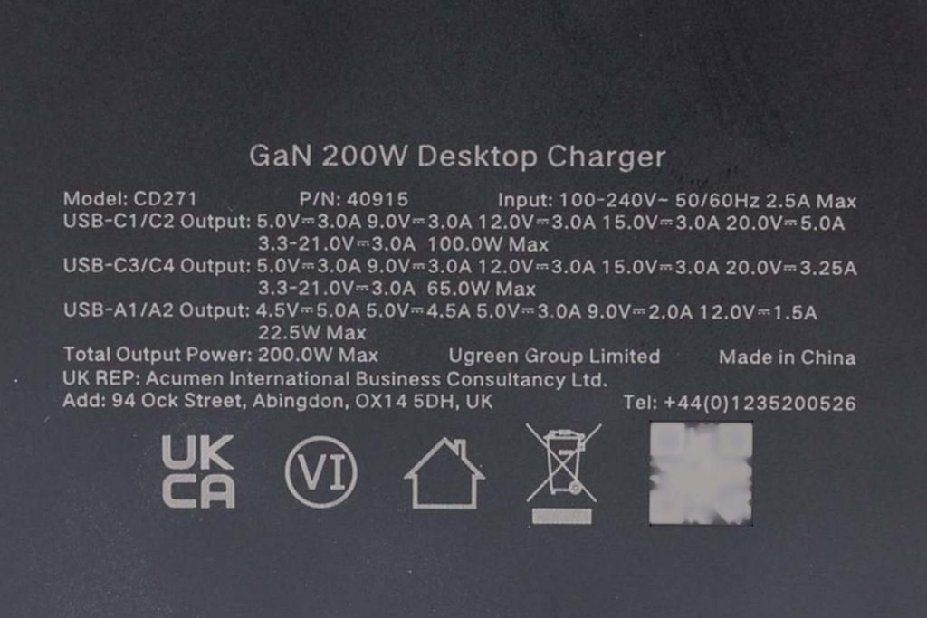

The bottom of the charger comes with four non-slip pads, and detailed specifications are printed in the center.
There are the specifications.
Name: GaN 200W Desktop Charger
Model: CD271
P/N: 40915
Input: 100-240V~50/60Hz 2.5A Max
USB-C1/C2: 5V3A / 9V3A / 12V3A / 15V3A / 20V5A; 3.3-21V3A; 100W Max
USB-C3/C4: 5V3A / 9V3A / 12V3A / 15V3A / 20V3.25A; 3.3-21V3A; 100W Max
USB-A1/A2: 4.5V5A / 5V4.5A / 5V3A / 9V2A / 12V1.5A; 22.5W Max
Total Output Power: 200W Max
With the UKCA marking and the Level VI efficiency

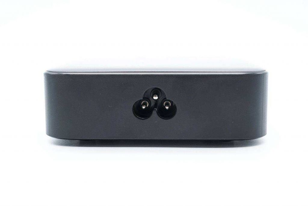

This is the input port.

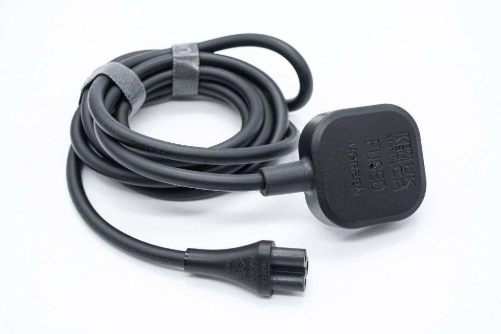

The British standard cable is 2m long and has a wire diameter of 3 X 0.75mm².

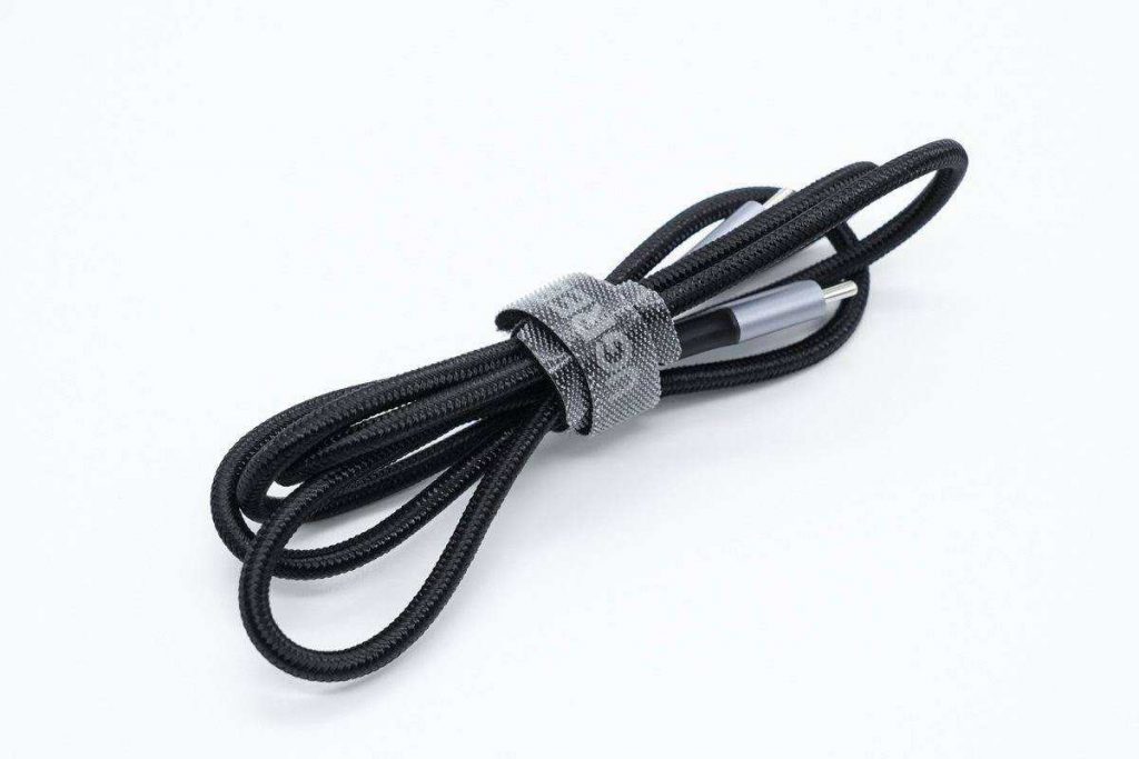

The package also includes a USB-C to USB-C cable with a built-in E-Marker to support 20V5A. Its maximum power is 100W, and the data transfer rate is USB2.0.

The size is about 101.36 X 100.81 X 33 mm (3.99 X 3.96 X 1.29 inches), the volume is 337.19cm³ (20.57 in³), and its power density is 0.59W/cm³.

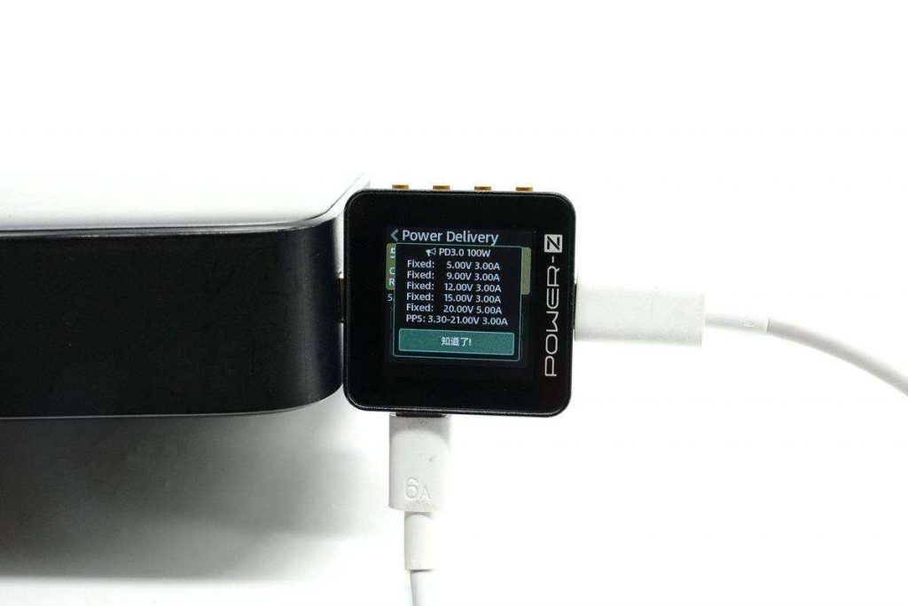

The USB-C1 or C2 port supports five fixed PDOs of 5V3A / 9V3A / 12V3A / 15V3A / 20V5A and one PPS of 3.3-21V3A with a maximum output power of 100W when used separately.

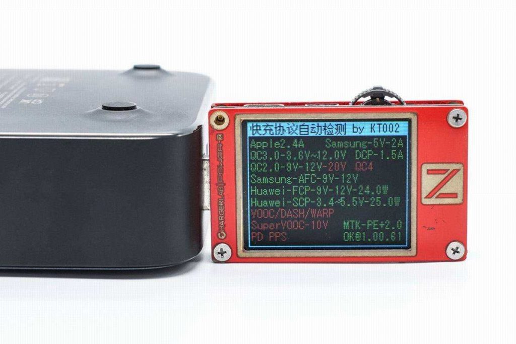

In addition to the USB PD fast charging standard,
All six ports support USB PD fast charging, APPLE2.4A, QC3.0, QC2.0, AFC, FCP, SCP and other common fast charging protocols. The USB-A PORT additionally supports MTK PE, making it widely versatile and suitable for new and old devices.

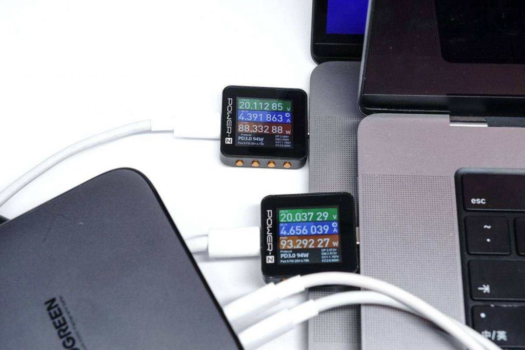

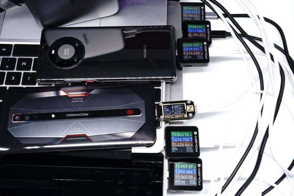

It can charge two laptops simultaneously, with the power of 20.03V 4.65A 93.29W and 20.11V 4.39A 88.33W. Both laptops are in ultra-high power PD fast charging, with a total output power of 181W.

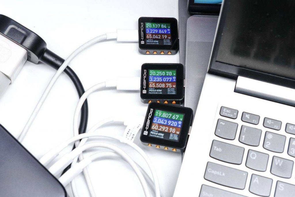

When three laptops are charged simultaneously, the power reaches 20.13V 3.22A 65.04W, 20.25V 3.23A 65.5W, and 19.8V 3.04A 60.29W. The total output power is 190W.

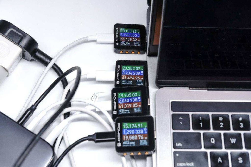

Charging four laptops simultaneously, the power reaches 20.13V 3.19A 64.43W, 20.25V 3.23A 65.49W, 19.9V 2.06A 41.01W, and 15.17V 1.29A 19.58W, for a total of over 190W.
When charging up to six devices simultaneously, the power reaches 20.16V 3.23A 65.18W, 20.35V 2.17A 44.23W, 5.02V 1.91A 9.61W, 4.8V 1.92A 9.26W, 19.94V 1.67A 33.42W and 11.95V 1.59A 19.04W, with a total power of over 180W.
The UGREEN Nexode 200W 4C2A GaN desktop charger has six ports, four USB-C ports and two USB-A ports, supporting up to 100W PD fast charging and 200W total output, which can charge six devices simultaneously. Either USB-C1/C2 can support up to 100W output separately. And either USB-C3/C4 can support up to 65W output separately. For the USB-A1/A2, either can support up to 22.5W output separately.
