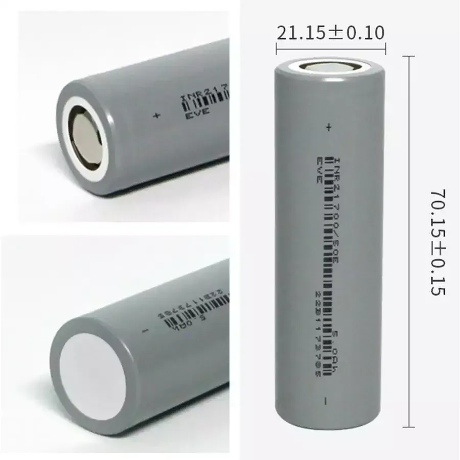

Spearheading this shift is the EVE Energy INR21700/50E. Delivering a steady 3.65V nominal voltage alongside 1C charge and 3C discharge capabilities, the cell has secured spots in the supply chains of tier-one brands like CUKTECH, Baseus, Lenovo thinkplus, SHARGE, and Xiaomi—powering everything from compact 5,000mAh pocket capsules to massive 210W super power banks.
EVE Energy INR21700/50E High-Power Cylindrical Cells Storm the Power Bank Market-Chargerlab

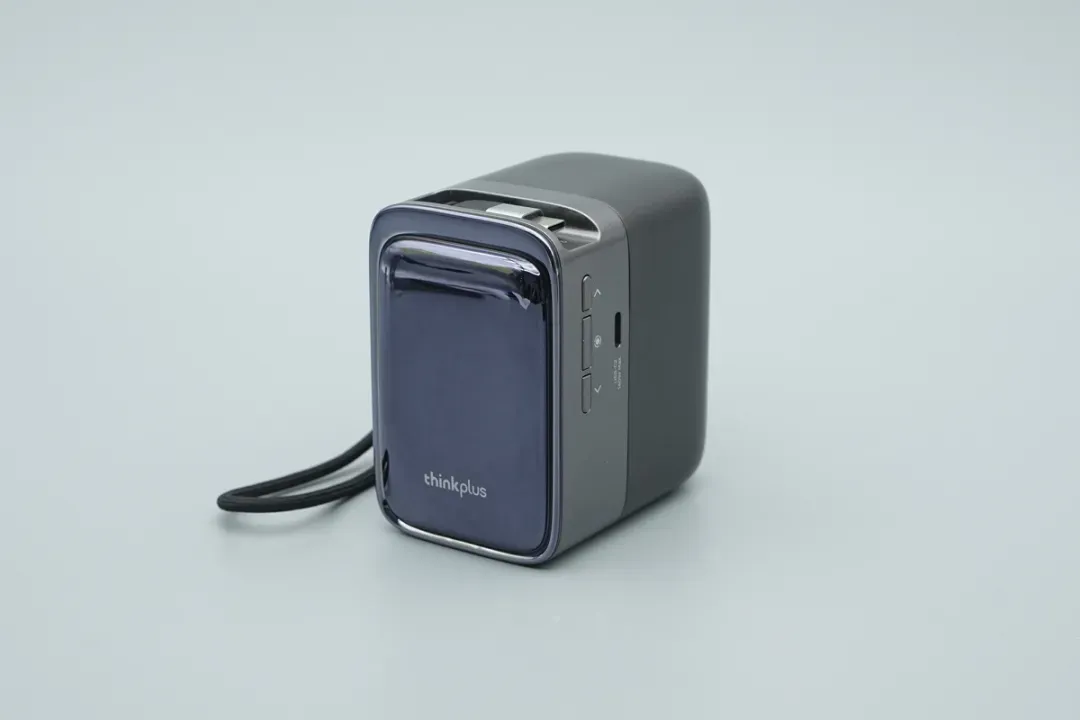

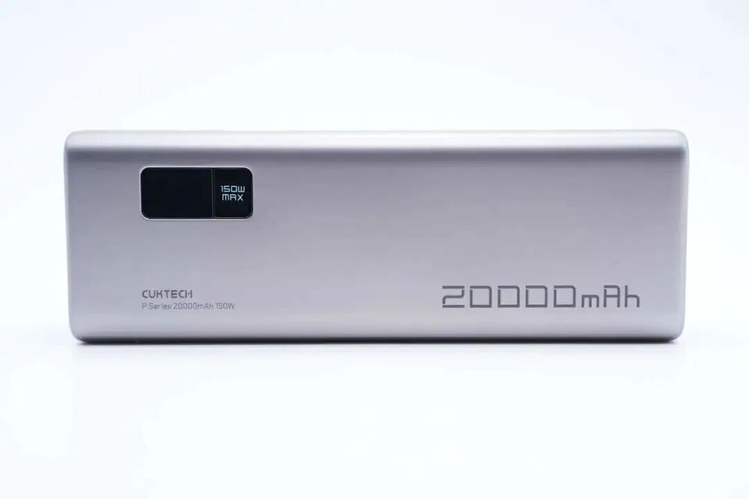

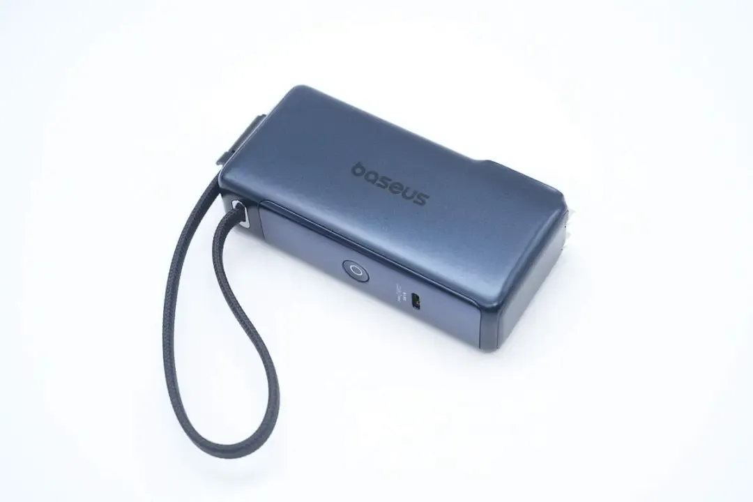

The EVE Energy INR21700/50E shines with stellar electro-chemical performance and exceptional safety integration. Rated at 5.0Ah, it operates strictly between 4.20V and 2.50V, delivering a single-cell energy capacity of 18.25Wh. Architecturally, a 2-cell configuration can be paired to yield 10,000mAh (e.g., Baseus 67W/35W chargers), while a 4-cell series handles 20,000mAh high-power laptop power banks (e.g., CUKTECH No. 15, Lenovo thinkplus 140W/190W). A 5-cell series perfectly drives 25,000mAh, PD3.1 100W-compatible power bricks (e.g., CUKTECH No. 20, Baseus 145W, ZMI No. 20), and massive 40,000mAh geek-tier power stations scale effortlessly via a 4S2P array.
