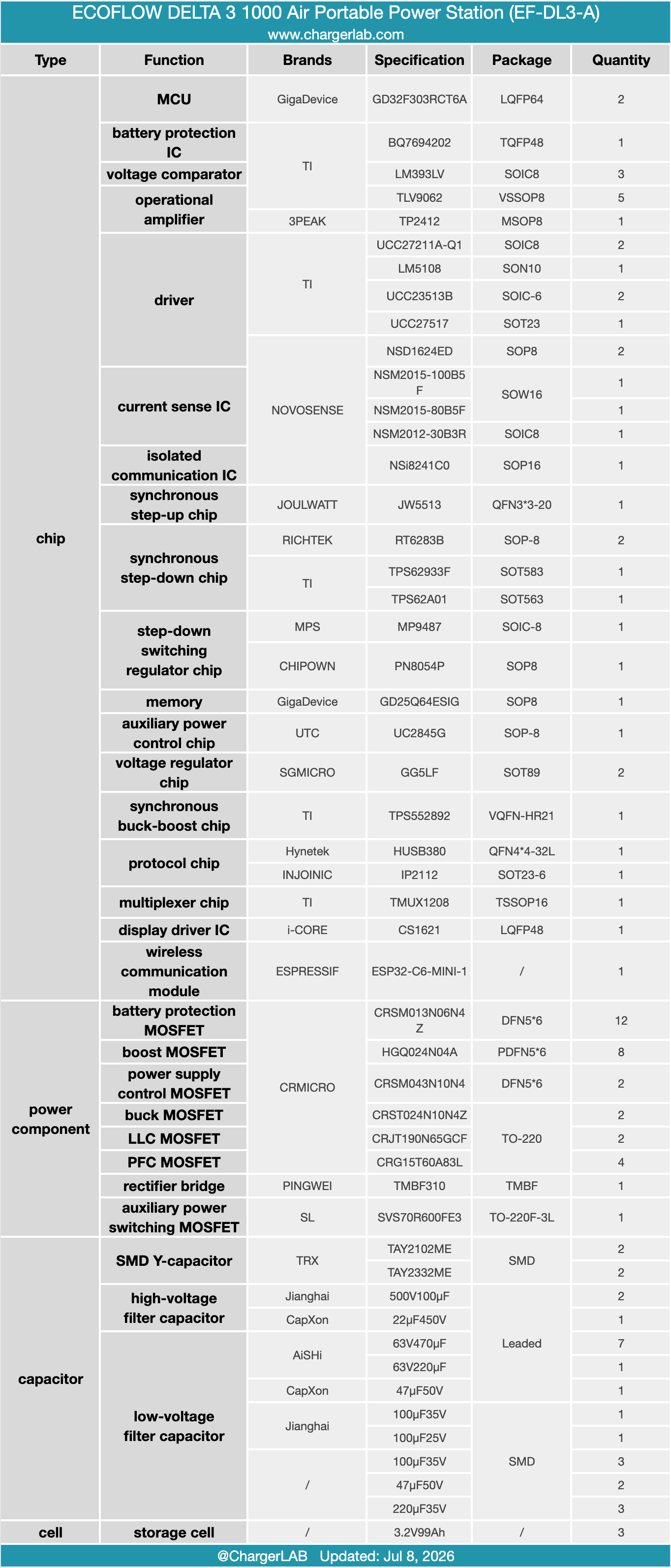

Here is the bi-directional inverter module, the upper-left section houses the battery terminals, fuses, protection MOSFETs, and filtering caps. Directly below are the connectors for battery voltage and temperature sensing. The lower-left area includes the charging input port, featuring a dedicated fuse, filtering chokes, and filtering caps. A heatsink is provided for the MPPT switching MOSFETs, positioned alongside the step-down choke.
Above the step-down choke, there is another heatsink, with filtering caps on the left and a transformer on the right. Beneath the transformer are the resonant and high-voltage filter caps. The right-side heatsink manages heat for the LLC switching MOSFETs and totem-pole PFC MOSFETs. To the left of this heatsink, the circuit includes the PFC choke, X2 safety caps, common-mode chokes, and relays. The top section contains the auxiliary power transformer and switching MOSFETs.
Teardown of the ECOFLOW DELTA 3 1000 Air Portable Power Station EF-DL3-A-Chargerlab
The back of the bi-directional inverter module hosts the control and protection circuitry, including the battery protection IC, MCU, current sensing ICs, gate drivers, isolated communication ICs, power MOSFETs, and SMD Y-caps. All critical components are coated with conformal coating and potting compound for electrical insulation and environmental protection.
The positive tab of the battery is connected via welding, with positioning through-holes provided on both sides.
The SMD fuse is from VICFUSE, spec 100A 72VDC, used for battery pack overcurrent protection.
The negative connection tab of the battery is connected via welding, with positioning holes provided on both sides.
Two 0.5mΩ current sense resistors are used to detect the battery pack current.
The battery protection IC is from TI, model BQ7694202, which supports 3-series to 10-series lithium-ion and lithium iron phosphate battery applications. The chip integrates internal NMOS drivers, dual programmable LDOs, and an I2C communication interface. It also features two independent ADCs supporting simultaneous voltage and current sampling, and is packaged in a TQFP48 format.
The battery protection MOSFETs, configured in a 6-parallel connection with opposing series arrangement.
The battery protection MOSFET is from CRMICRO, model CRSM013N06N4Z, NMOS, 60V and 1.1mΩ, and packaged in a DFN5*6 package.
Copper strips are soldered at the corresponding positions to enhance current-carrying capacity.
The filtering cap is from AiSHi, belonging to the RJ series of 105℃ heat-resistant and long-life electrolytic caps.
The filtering caps, 63V470μF.
The MCU used for the low-side and LLC control of the portable power station is from GigaDevice, model GD32F303RCT6A, which is a microcontroller featuring a main frequency of up to 120MHz and an embedded Cortex-M4 core. It incorporates 256KB of Flash memory and 48KB of SRAM, supports PWM signal output, and in an LQFP64 package.
Eight switching MOSFETs are located beneath the heatsink, used for inverter step-up and synchronous rectification.
The switching MOSFETs are from CRMICRO, model HGQ024N04A, NMOS, 40V and 1.6mΩ, and in a PDFN5*6 package.
The driver is from TI, marked 27211Q, model UCC27211A-Q1. It is an automotive-grade 120V driver featuring 8V UVLO functionality, providing a 3.7A source current and a 4.5A sink current capability. It supports an 8-17V supply voltage and in an SOIC8 package.
Another one shares the same model.

Well, those are all components of the ECOFLOW DELTA 3 1000 Air Portable Power Station EF-DL3-A.
EcoFlow's DELTA 3 1000 Air portable power station packs automotive-grade LiFePO4 chemistry with an automotive CTC architecture into a remarkably compact frame. Delivering 500W of nominal output that scales up to 1000W via X-Boost technology, it accepts multiple charging inputs including solar, car, and AC mains. The front fascia hosts an informative display and output outlets, while the sides accommodate AC/DC charging ports and an active cooling fan.
Our teardown reveals an internal 3-series prismatic LiFePO4 battery pack anchored to the chassis via adhesive and fasteners. Flanked by protective metal plates and secured with steel binding strips, the assembly uses an integrated thermistor for thermal management and heavy-duty copper ribbons to link with the bidirectional inverter module.
Mounted atop the battery enclosure is a multi-function PCBA integrating the bidirectional inverter, MPPT step-down stage, and battery management system. Core processing relies on a pair of GigaDevice GD32F303RCT6A MCUs for system and inverter control, paired with a TI BQ7694202 protection IC.
Power components including protection MOSFETs, boost MOSFETs, LLC MOSFETs, and modulation IGBTs originate from CRMICRO, driven by NOVOSENSE and TI gate drivers. NOVOSENSE also provides the current sensing and isolated communication ICs. USB-C power delivery utilizes a TI TPS552982 buck-boost converter and a Hynetek HUSB380 protocol controller. Finished with conformal coating and underfill adhesive reinforcement, the entire PCBA is built to withstand rigorous outdoor environments with maximum reliability.
