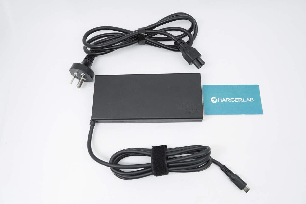

Delta PD3.1 240W power adapter has a flat appearance and is equipped with an integrated USB-C cable. The outer shell is made of fire-resistant PC with a frosted surface.

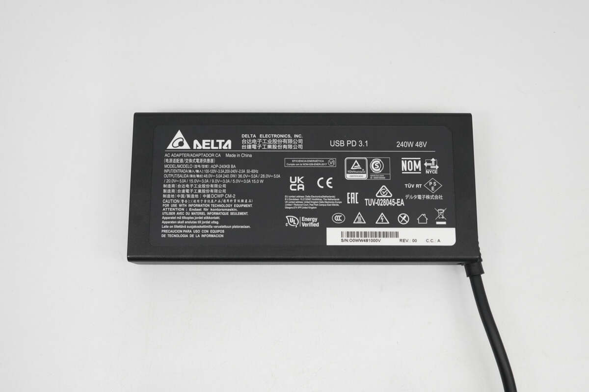

There is specs info on the back. Model is ADP-240KB BA. It can support input of 100-120V~ 3.5A or 200-240V~ 2.5A 50/60Hz. It can support output of 48V5A 240W, 36V5A, 28V5A, 20V5A, 15V3A, 9V3A, and 5V3A 15W.

The length of the output cable is about 180 cm (5 feet 10.9 inches).
Review of Delta's World's First PD3.1 240W USB-C Power Adapter-Chargerlab
The length of the power cord is about 150 cm (4 feet 11 inches).

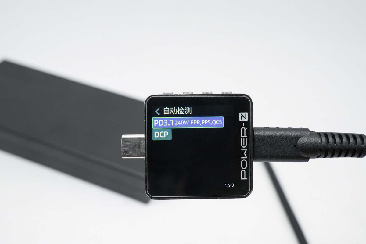

ChargerLAB POWER-Z KM003C shows it supports PD3.1, PPS, QC5, and DCP charging protocols.

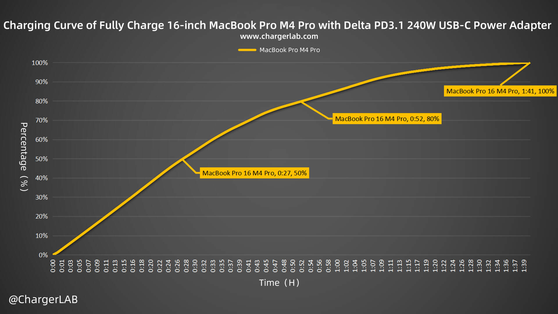

Next, we'll use it to fully charge the 16-inch MacBook Pro M4 Pro. The charger and the laptop will be put into a 25°C (77℉) thermotank throughout the test. Here is the charging curve made by the PC software of KM003C.
The voltage is always around 28V. The charging curve can be divided into six parts. In the first part, the peak power stayed at 137W for the first 18 minutes. Then, the power gradually drops to 133W, 112W, 83W and 52W in turn. The final part begins at 1 hour and 7 minutes, and the power slowly drops to almost zero. It takes 1 hour and 41 minutes to be fully charged.
We plot it into another curve to see how fast it can be. It can charge the 16-inch MacBook Pro M4 Pro to 50% in 27 minutes and 80% in 52 minutes, and it reaches 100% in 1 hour and 41 minutes. The charging time is almost the same as the 140W charging set that comes with the laptop.

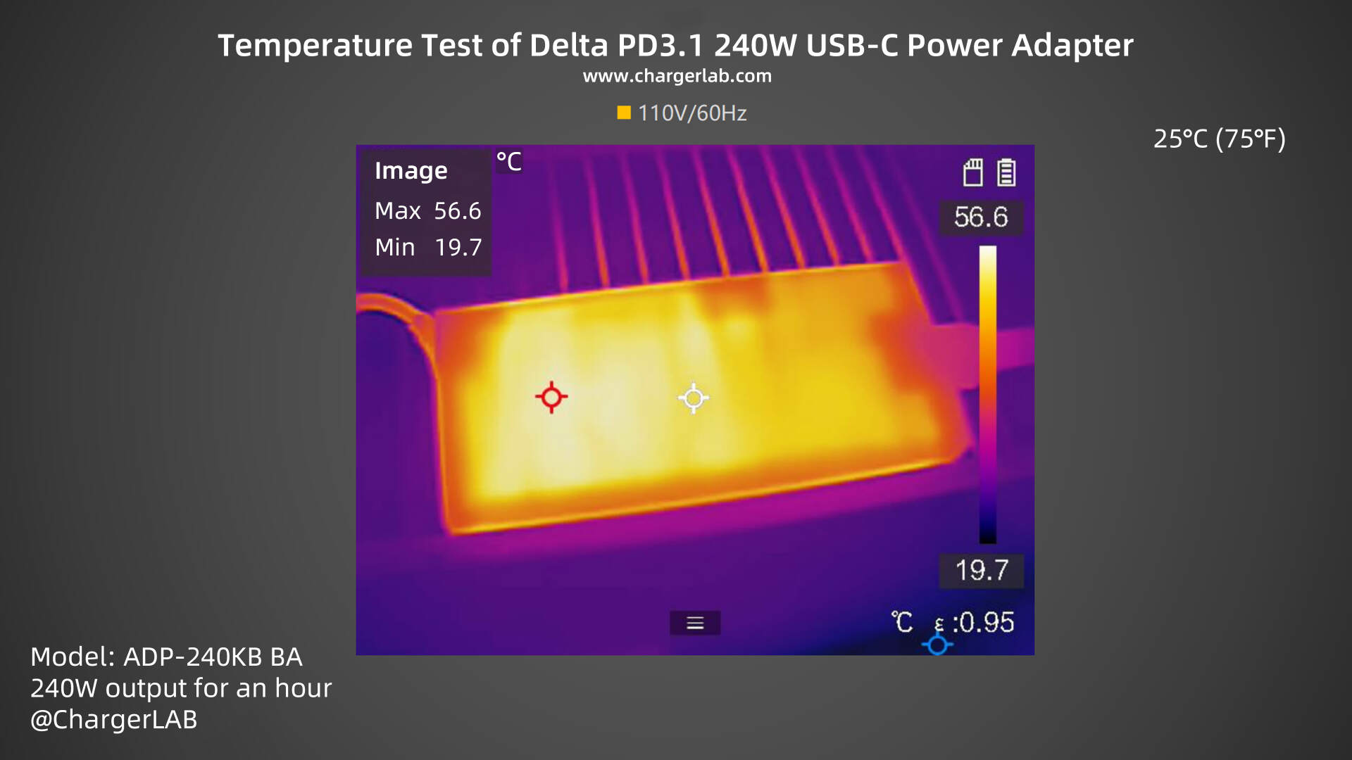

Next check how the temperature performance is under 110V 60Hz.
After one hour, the maximum front temperature is 58.2°C (136.76 ℉).
And the maximum temperature on the back is 56.6℃ (133.88 ℉).
Creating a bar chart to represent the data, it is evident that this adapter reaches a maximum temperature of 58.2 ℃ when operating under 110V 60Hz. This temperature complies with the International Electrotechnical Commission (IEC) 62368 standards for electronic and electrical equipment test, which stipulates that the temperature should not exceed 77 °C.
