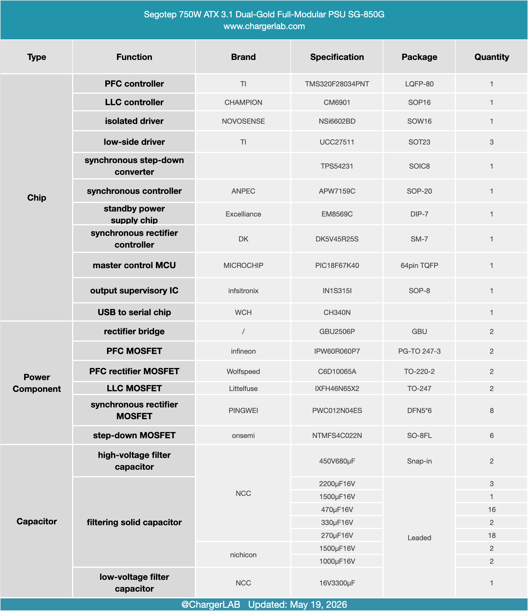

Today we’re ripping into the Segotep GM750W Gold Full-Modular PSU, a unit built to the latest ATX 3.1 spec with a native 16-Pin 12V-2x6 header primed for PCIe 5.1 GPUs. Under the hood, it adopts a high-efficiency Active PFC + half-bridge LLC + SR + DC-DC architecture, cruising through with an 80PLUS Gold badge and a 750W output that perfectly hits the sweet spot for budget-conscious mainstream PC builds.
Internally, it reveals a premium bulk cap on the primary side and crisp solid caps handling the output filtering, all tied together with a 5-year warranty. The full-modular design comes packed with black embossed ribbon cables for an ultra-clean cable management setup.
Let’s dive straight into ChargerLAB's teardown to see exactly what kind of hardware and silicon layout Segotep is packing inside.

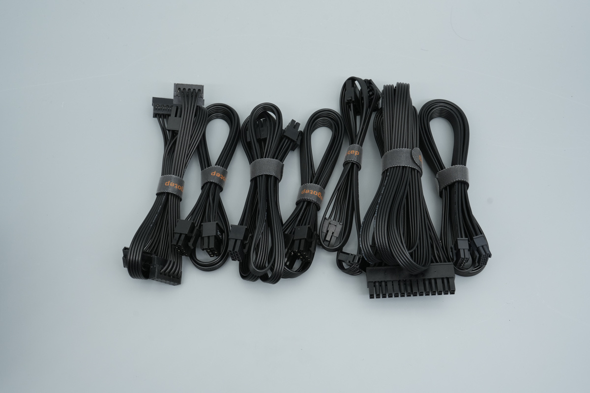

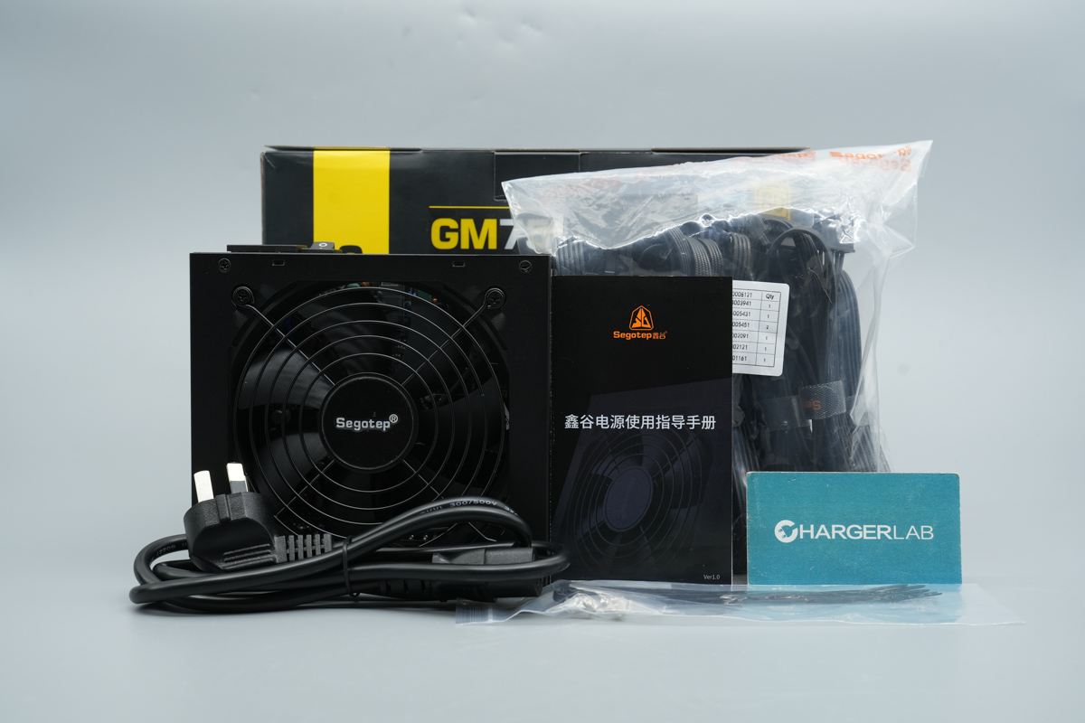

Here is the PSU chassis, power cord, and modular cable arrays straight out of the box. The main PSU chassis comes wrapped in EPE foam for optimal shock absorption.
Teardown of Segotep 750W ATX 3.1 Dual-Gold Full-Modular PSU SG-850G-Chargerlab
The bundled modular cables are secured with integrated hook-and-loop fasteners.
Here is the type and length specs for the bundled modular cables.

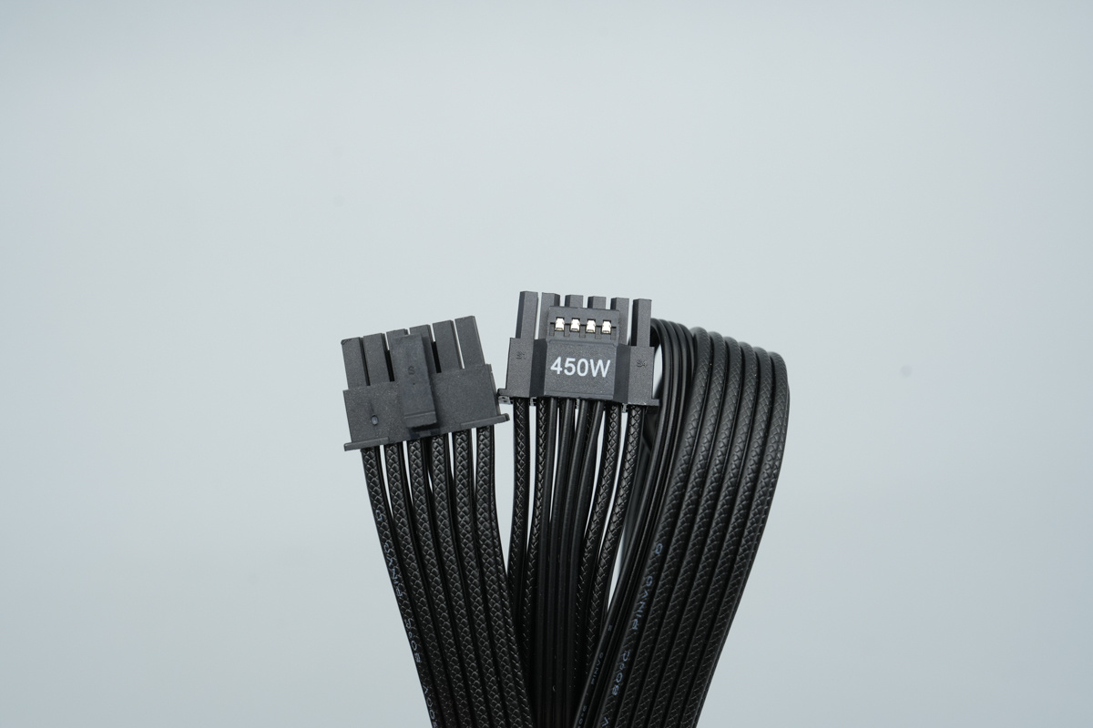

The GPU modular cable is officially stamped with a 450W power limit spec.
Here is the 24-Pin main PCB modular cable.
Here is the PCIe 8Pin modular cable.
Here is the peripheral modular cable.

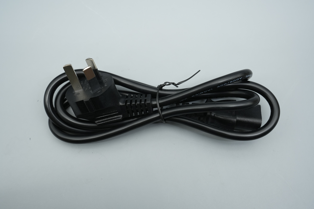

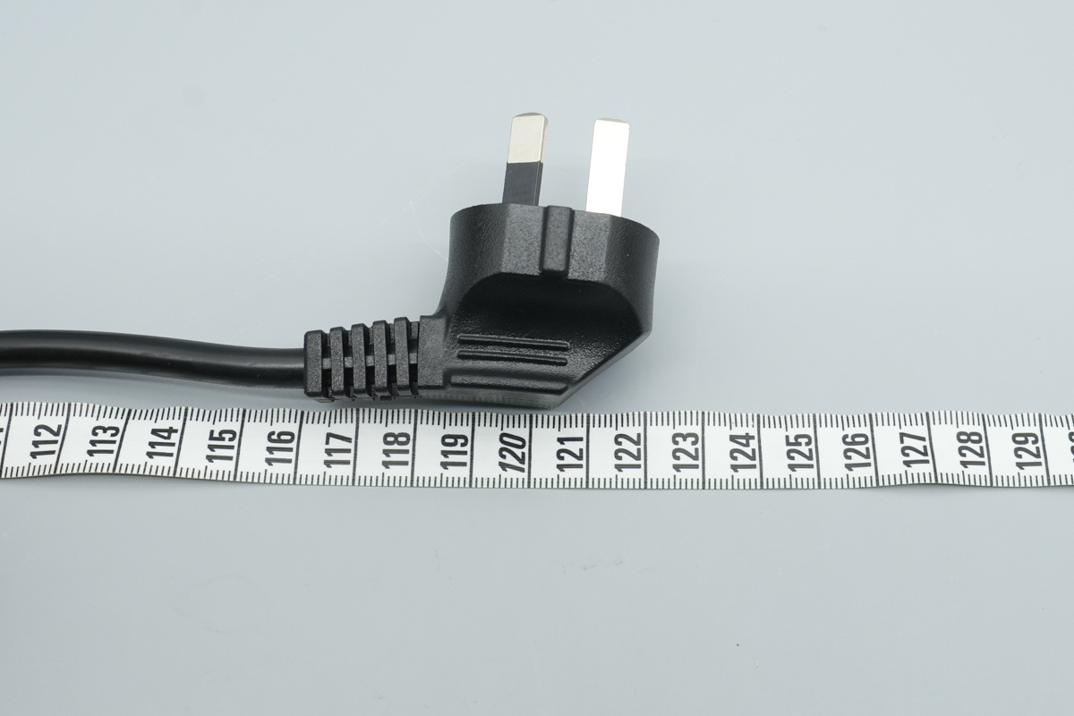

The power cord is secured with integrated cable ties.
The length of the power cord is about 1,2m (47.244 inches).

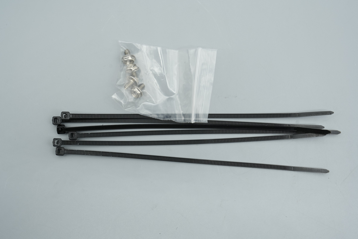

These are the chassis mounting screws and cable ties.

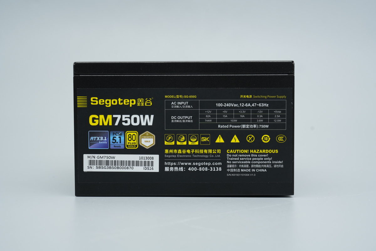

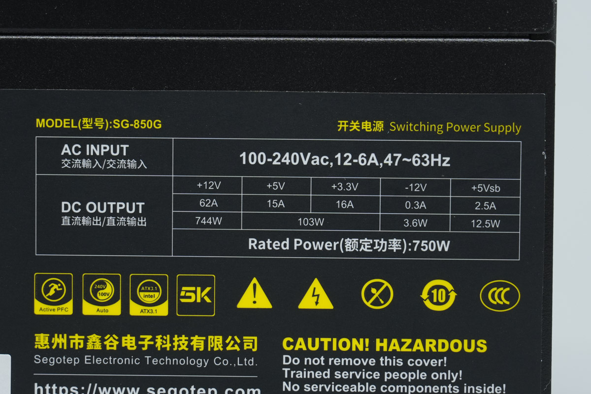

The side of the power supply features a specs label denoting the GM750W model, with ATX 3.1 and PCIe 5.1 standards, alongside official 80 PLUS Gold and CYBENETICS GOLD badges.
Full breakdown of the model and power rails on the right side:
PSU Model: SG-850G
AC Input: 100-240Vac, 12-6A, 47-63Hz
DC Output: +12V 62A 744W
+5V 15A, +3.3V 16A 103W
-12V 0.3A 3.6W
+5Vsb 2.5A 12.5W
Total Output: 750W
Manufacturer: Huizhou Segotep Electronic Technology Co., Ltd.

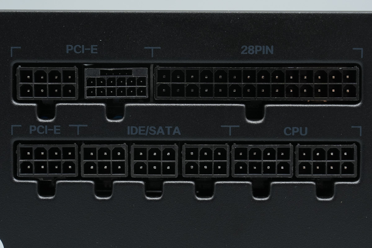

The output end features a dual-row modular connector matrix.
The upper row of the modular connector matrix is dedicated to GPU and main PCB power delivery, while the lower row is power supply to GPU, peripheral, and CPU.

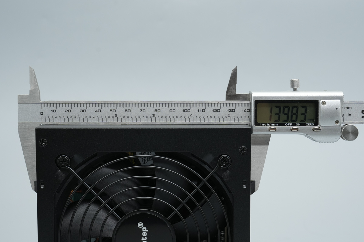

The length of the PSU is about 139.8mm (5.504 inches).

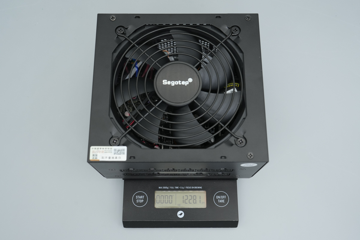

The weight is about 1228g (43.32 oz).

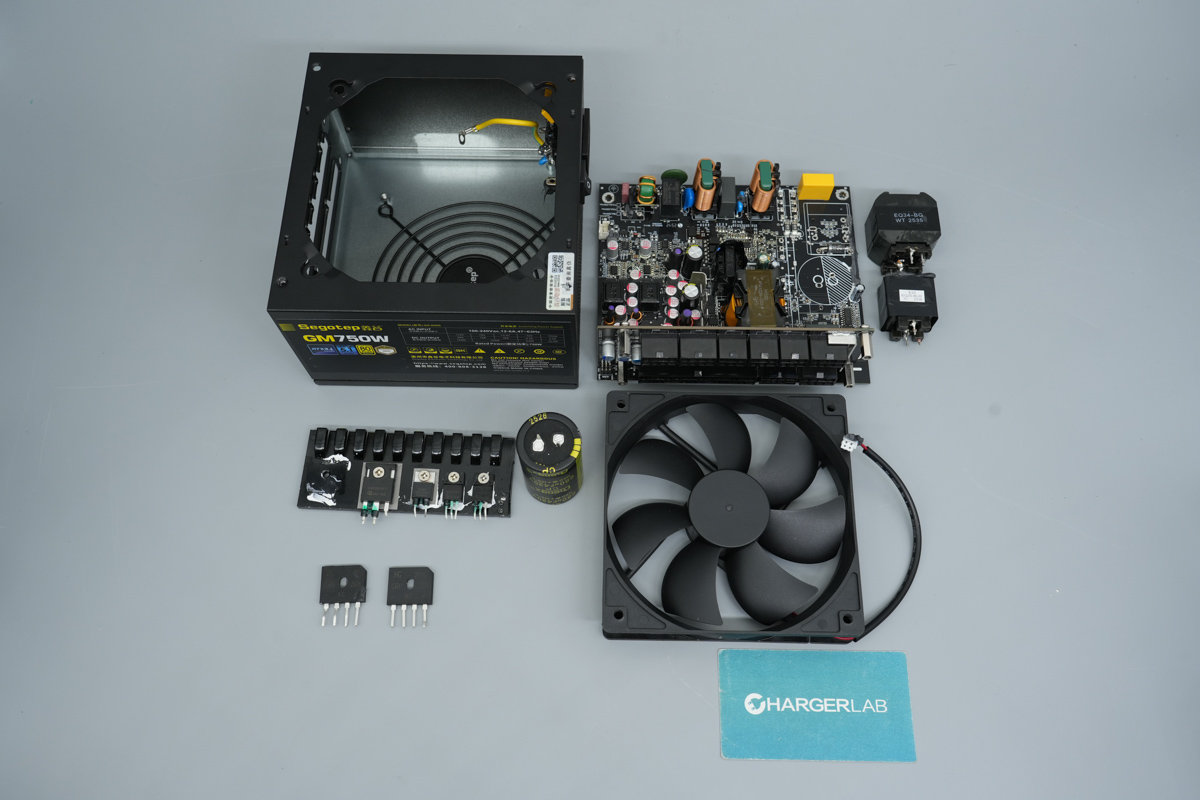

Now that we are done checking out the PSU’s looks and inbox goodies, let’s crack it open and dive straight into the internal architecture and hardware components.
First, unscrew the mounting screws and pop open the PSU casing.

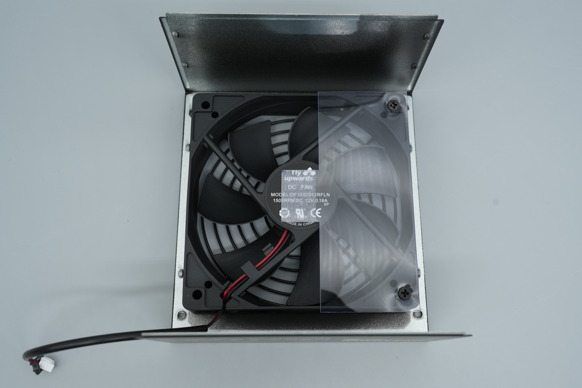

The cooling fan is interconnected via a dedicated terminal connector assembly.

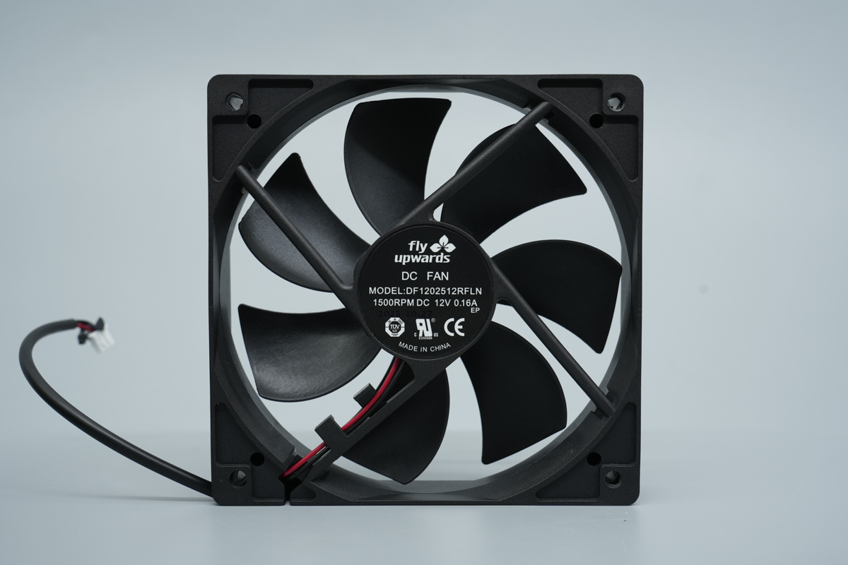

Inside the top panel, a cooling fan pairs up with a baffle to route the breeze.
The cooling fan is from Xunyuda, model DF1202512RFLN, 12V 0.16A.

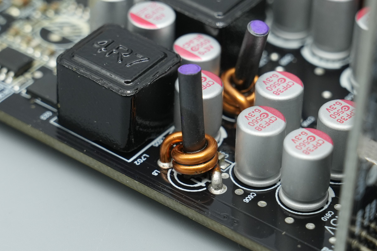

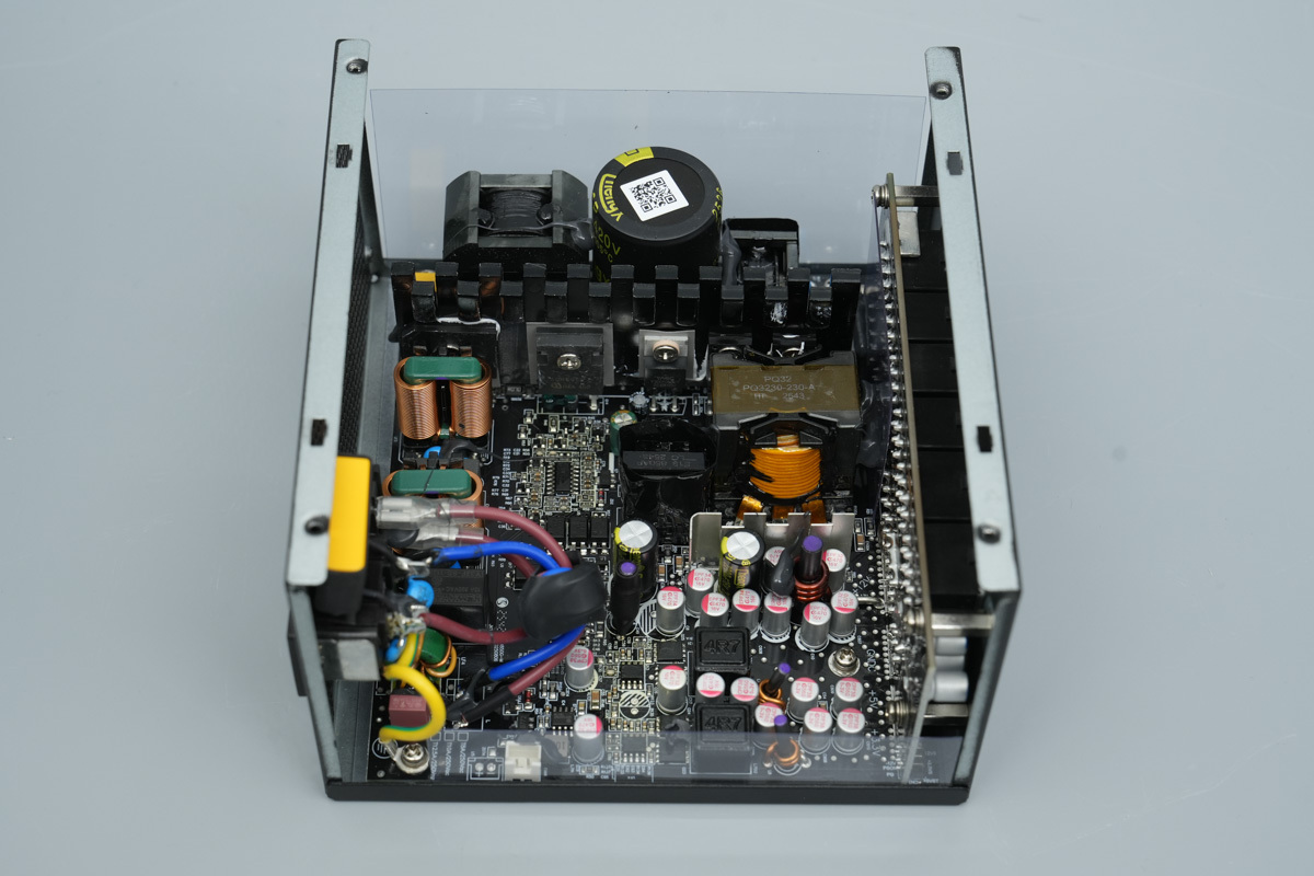

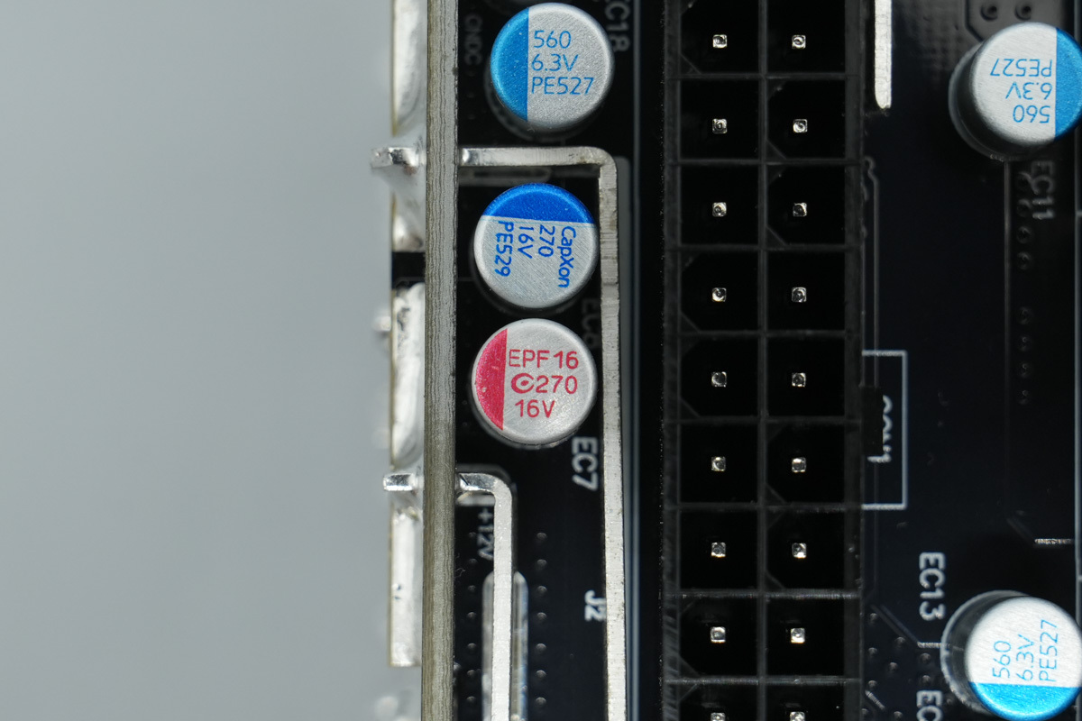

A view of the PCBA layout, The bottom-right corner handles the AC input entry, packing the fuse, common-mode choke, NTC thermistor, relay, and MOV, followed inline by another common-mode choke and the safety X2 cap. That long strip heatsink on the left cools down the rectifier bridge, PFC MOSFET, PFC rectifier, and LLC MOSFET. The bottom-left area holds the film filter cap and the PFC boost choke, while the high-voltage filter cap sits right in the middle-left.
Up top is the modular output PCB. The top-left corner sports the resonant cap and resonant choke, while the main transformer sits to the right of the vertical heatsink. To the right of the transformer, you’ll find the synchronous rectifier MOSFETs, synchronous rectifier controller, and filter caps. Right under the transformer sit the standby power supply chip and standby transformer, with the 3.3V and 5V step-down circuits flanking the right side.

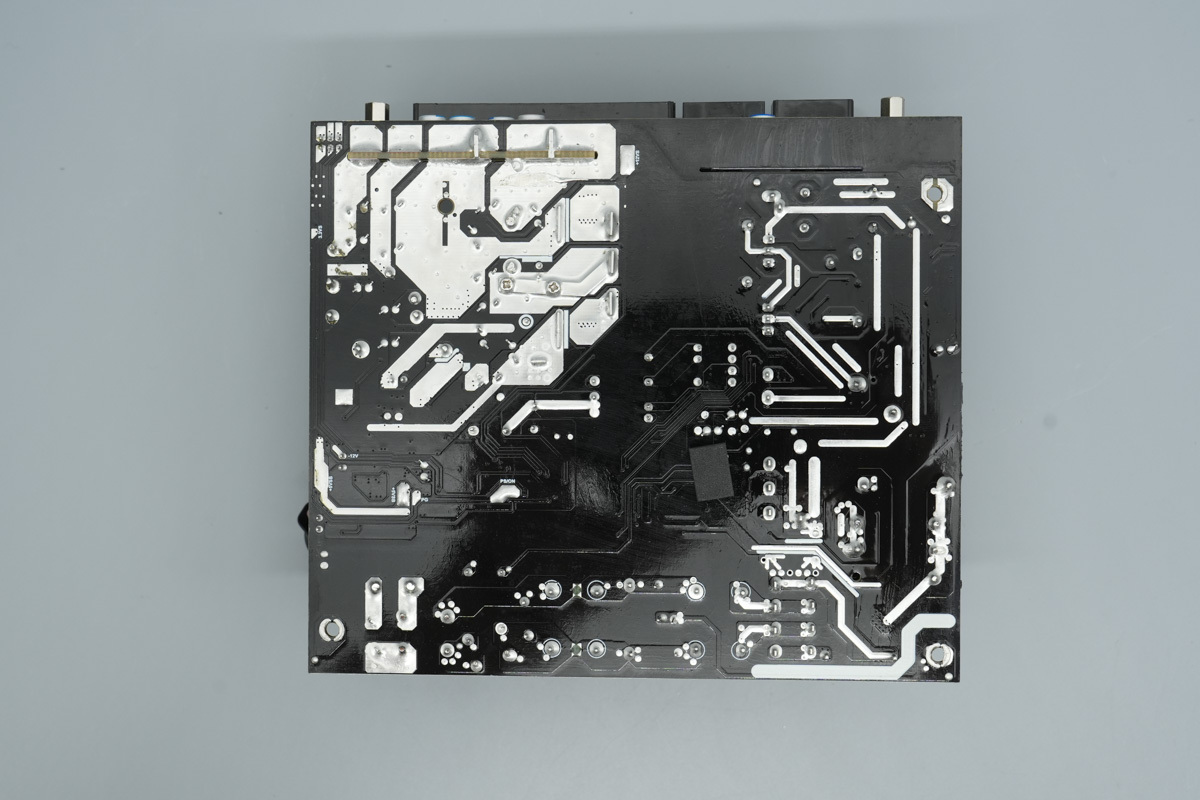

The back of the PCBA is devoid of components, featuring exposed traces with solder along the high-current pathways to boost power delivery.

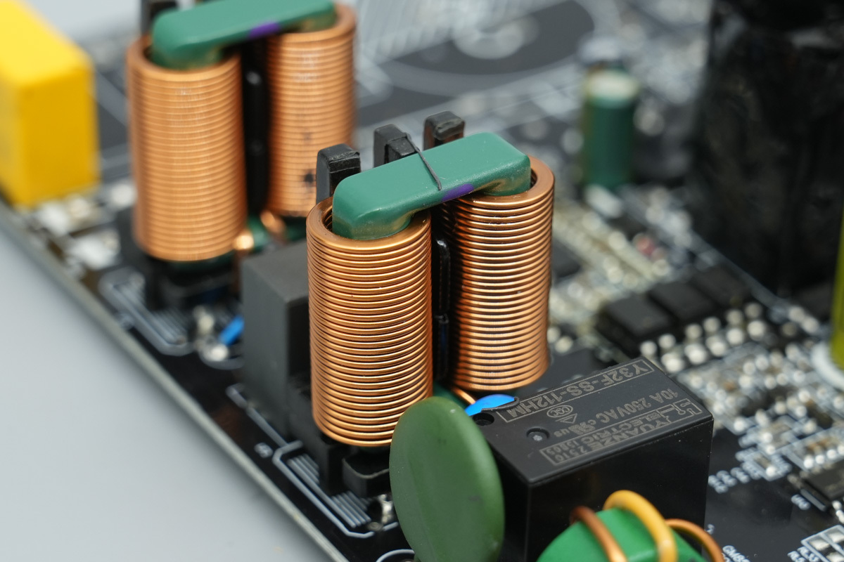

The common-mode choke is wound with a combination of enameled wire and insulated wire.

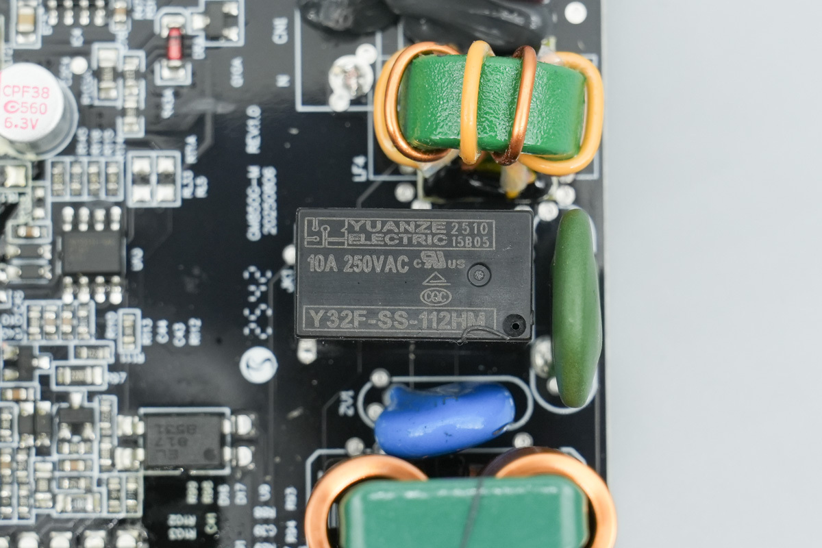

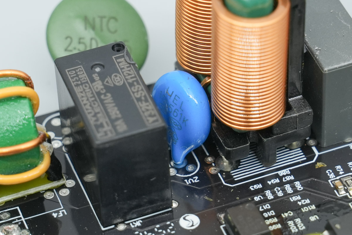

The relay is from Yuanze, model Y32F-SS-112HM, is used to bypass the NTC thermistor. Rated 10A 250VAC, run on 12V.

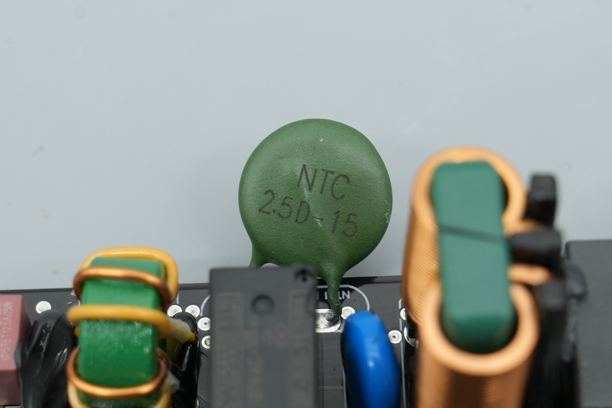

A NTC thermistor, marked 2.5D-15.
The MOV is from Hongzhi, model 10D561K, utilized for transient overvoltage surge absorption.

The common-mode choke is wound with high-density flat copper wire.

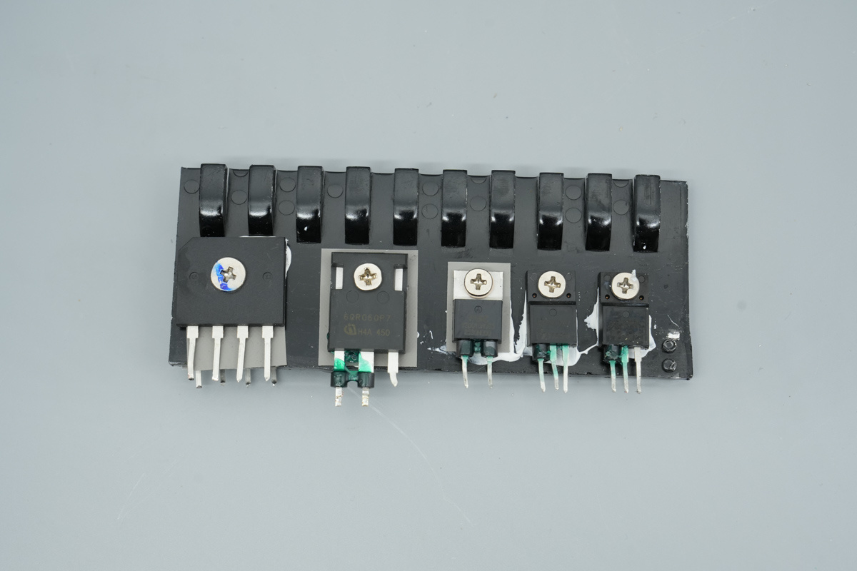

The left side of the heatsink is populated with the rectifier bridge, while the PFC MOSFETs and the PFC rectifier MOSFETS sit in the middle, and the LLC MOSFETs is on the right.

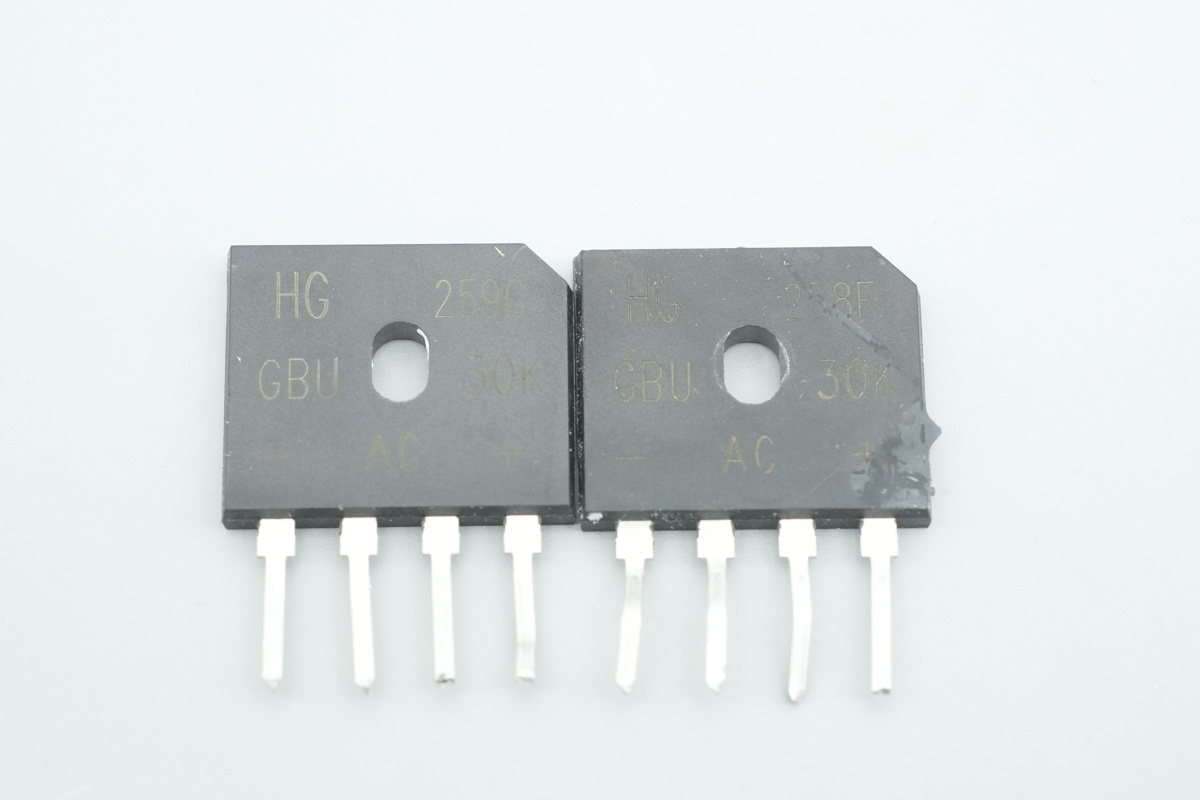

The other side of the heatsink is populated with an additional rectifier bridge.
The rectifier bridge is from HG, model GBU30K, 30A 800V, in GBU package.
The film filter cap is from Jingyu, the CBB23 series, 450V 1μF.

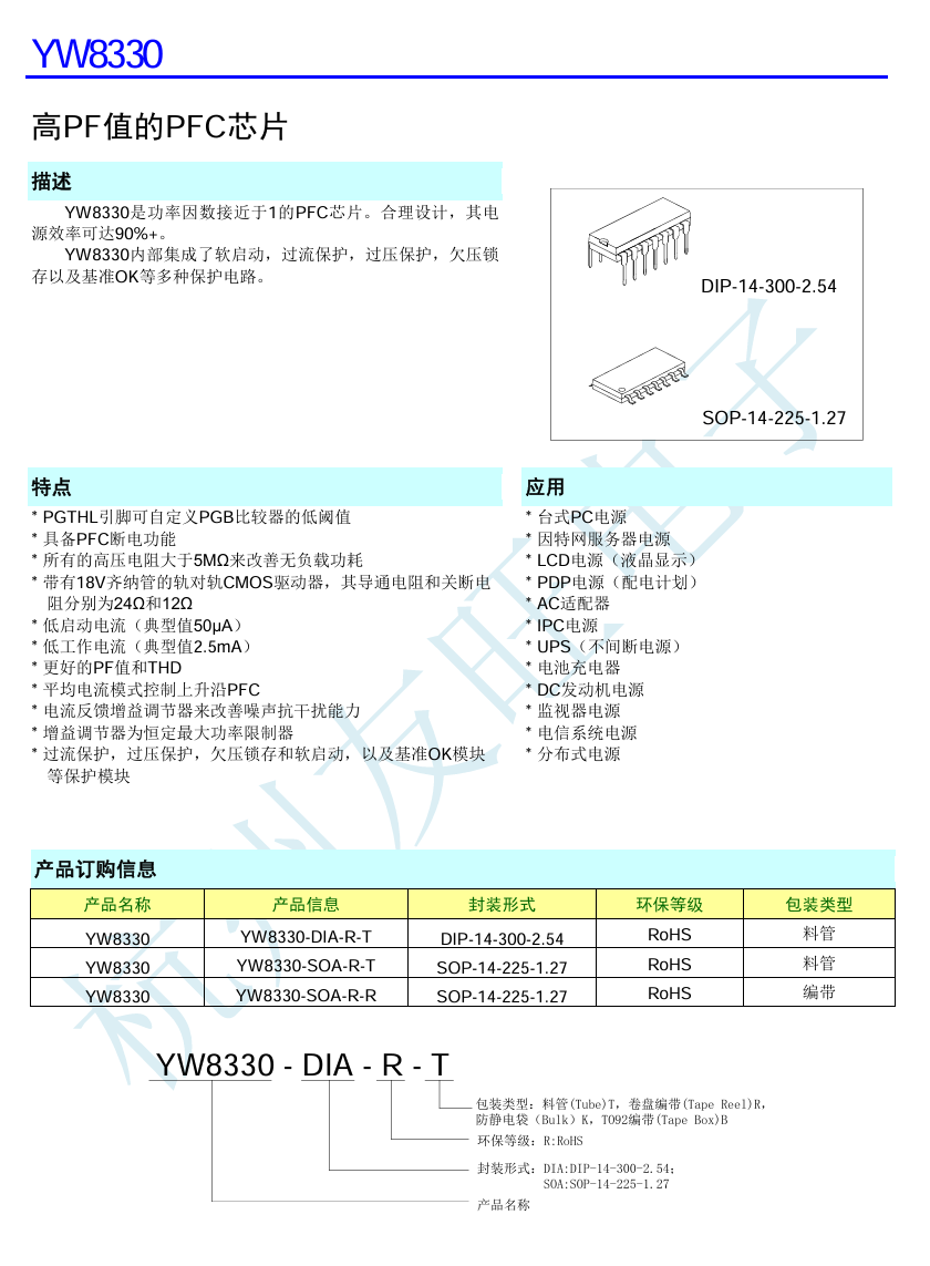

The PFC controller is from Youwang, model YW8330. It is a high-PF PFC chip that integrates internal protection circuitry, including soft-start, OCP, OVP, and UVLO. It features low startup and operating currents while utilizing average current mode control. It is perfectly suited for applications such as PC power supplies, power adapters, UPS systems, and fast chargers, and is housed in an SOP-14 package.
Here is the info about Youwang YW8330.

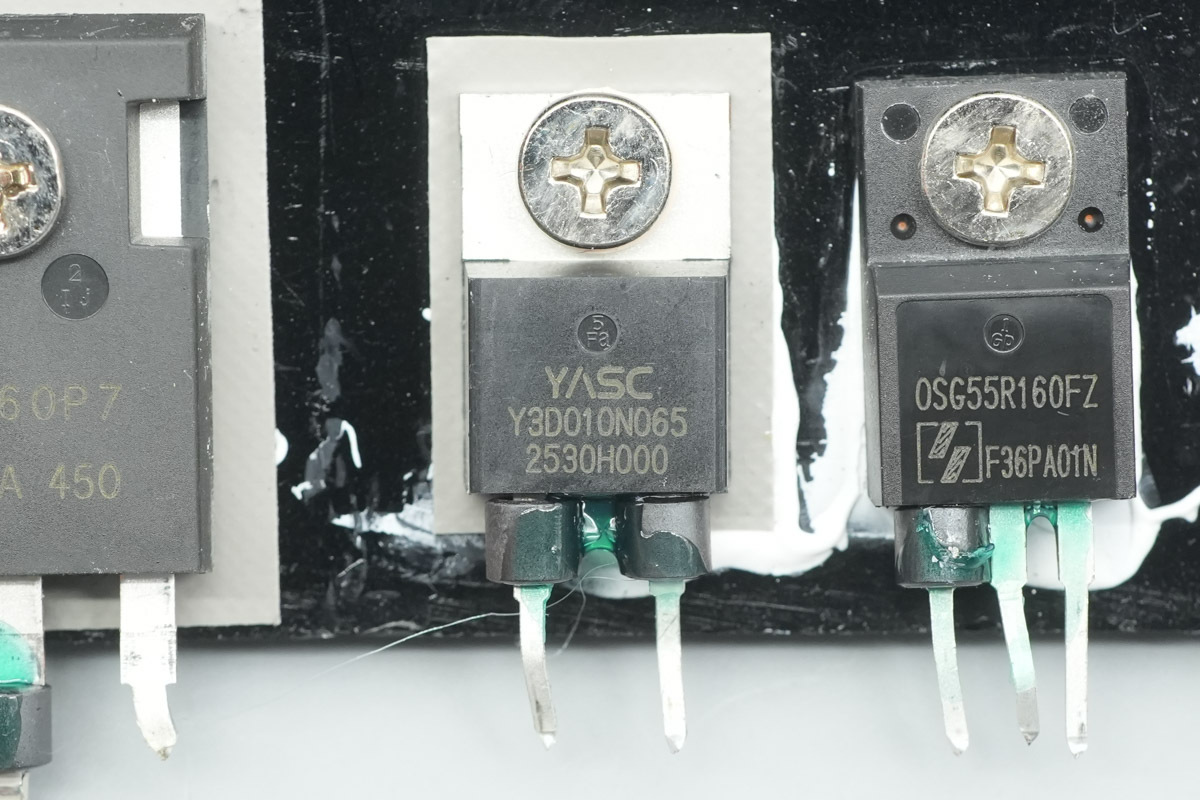

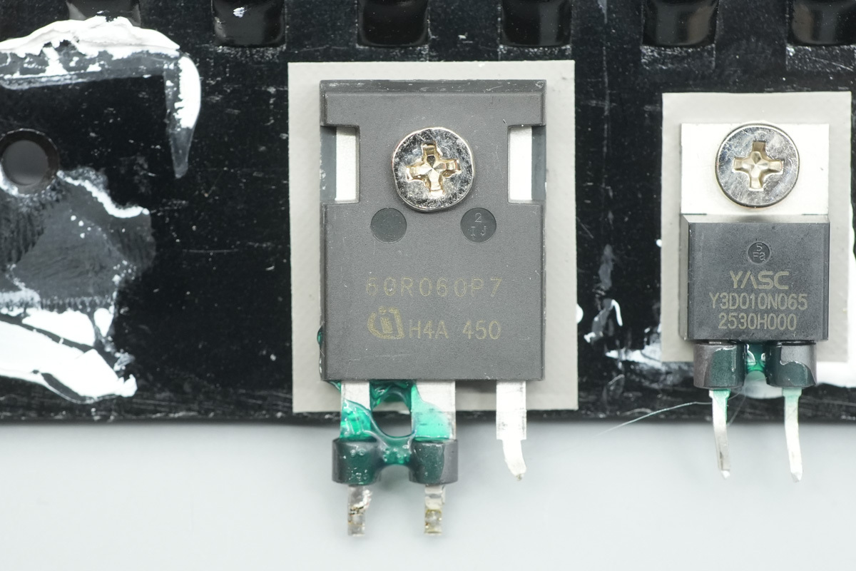

The PFC MOSFET is from Infineon, model IPW60R060P7, the CoolMOS P7 series. It is an N-channel MOSFET, 650V and 60mΩ, in TO-247-3 package.
The PFC rectifier MOSFET is from YASC, model Y3D010N065T2J, 650V and 10A, in TO-220-2 package.

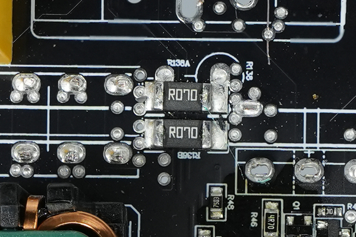

Two 70mΩ current-sensing resistors are configured in parallel to monitor the PFC MOSFET current.

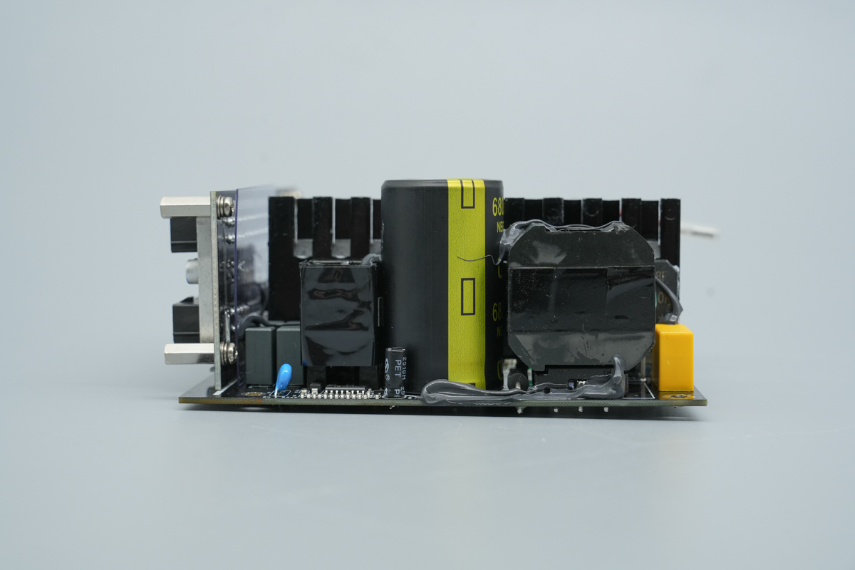

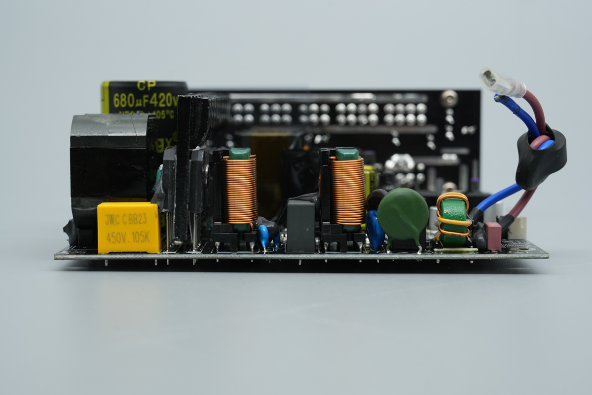

The side profile of the PCBA is populated with the PFC boost choke, the high-voltage filter cap, the LLC resonant choke, and the LLC resonant cap.
The PFC boost choke is wound with high-frequency Litz wire.
This is the PFC bypass MOSFET.

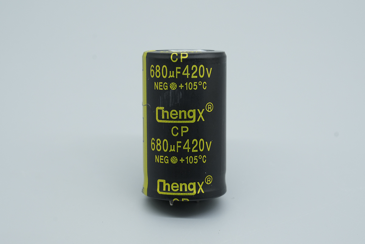

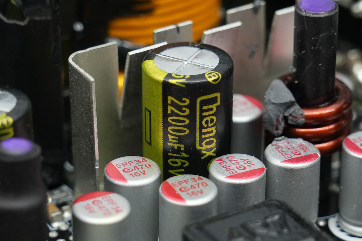

The high-voltage filter cap is from ChengX, the CP series of high-ripple current resistant aluminum electrolytic caps, 680μF 420V, rated for 105℃.

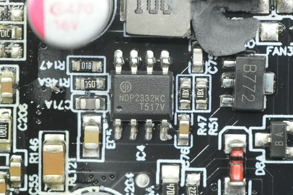

The filtering cap supplying power to the main controller, 22μF 50V.

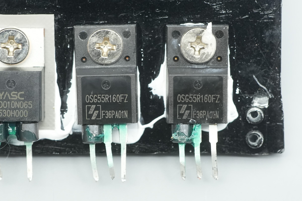

The LLC MOSFET is from Oriental Semiconductor, model OSG55R160FZF. It is an N-channel MOSFET, 600V and 160mΩ, in TO-220F package.

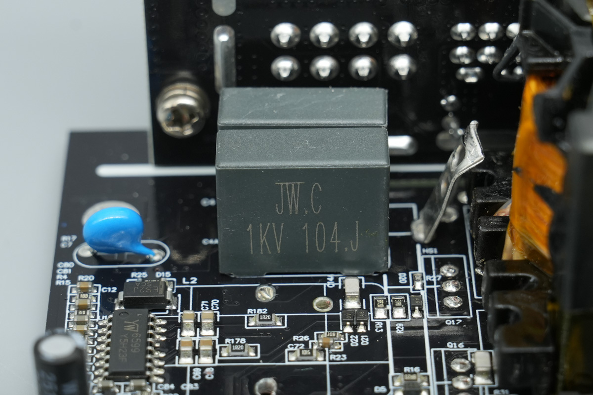

The resonant cap is from Jingyu, 1KV 0.1μF.

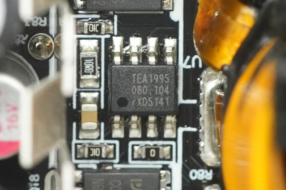

The synchronous rectifier controller is from NXP, model TEA1995. It integrates dual independent synchronous rectification drivers specialized for secondary-side rectification in LLC resonant architecture switching power supplies. It offers a highly streamlined peripheral component count, supports a 38V working voltage, and in SO8 package.

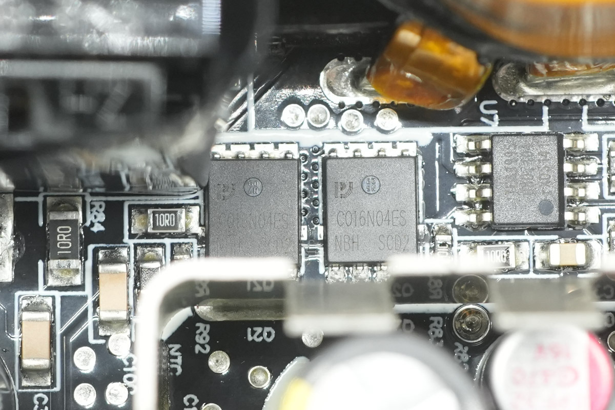

The synchronous rectifier MOSFET is from PINGWEI, model PWC016N04ES. It is an N-channel MOSFET, 45V and 1.3mΩ, in DFN5*6 package.
The opposite side mirrors this setup with a pair of identical synchronous rectifier MOSFETs.

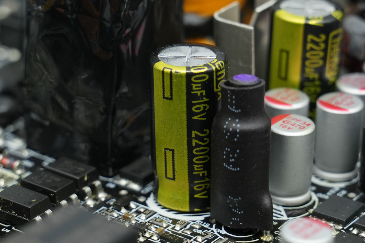

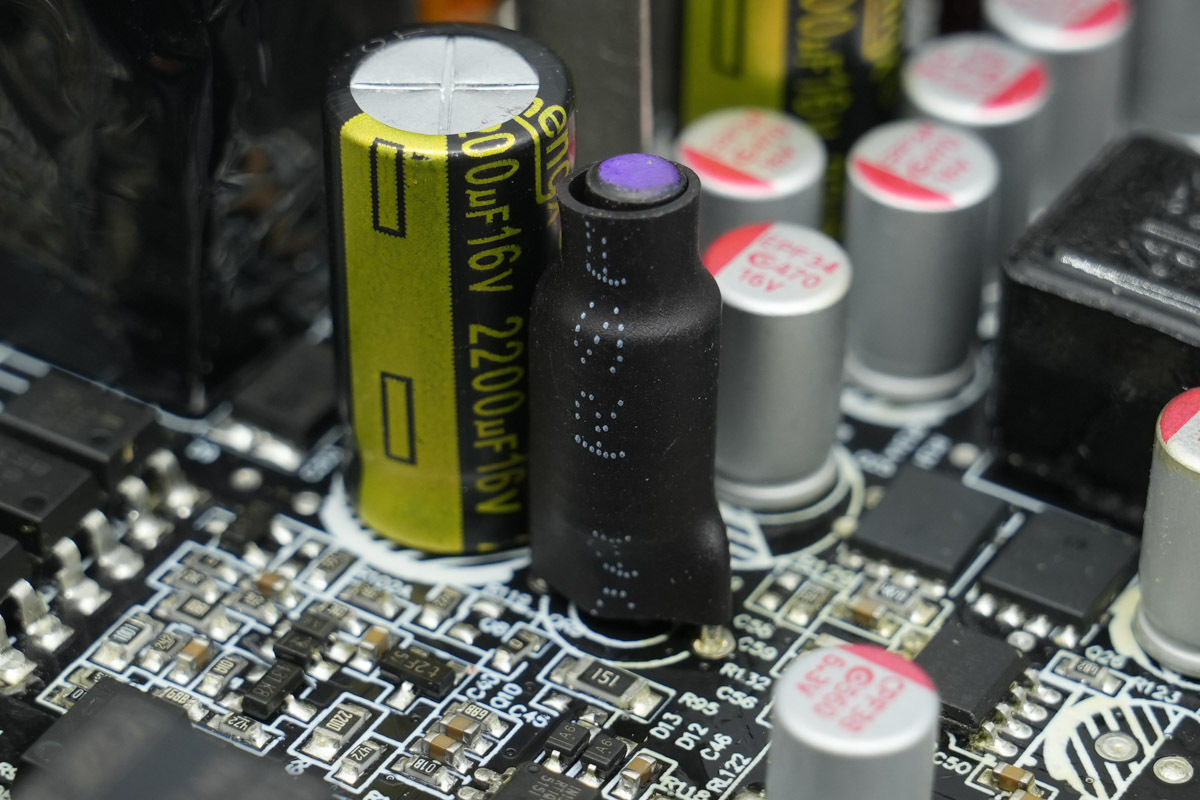

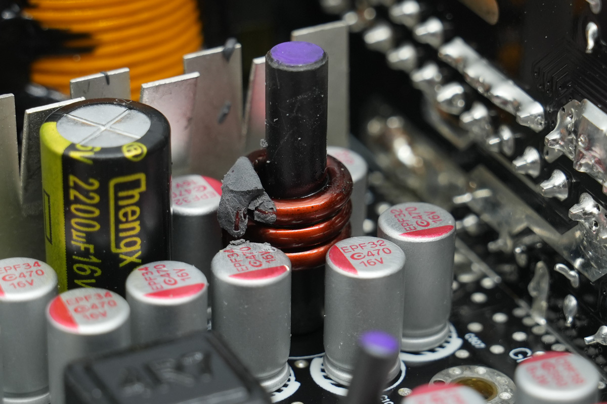

The electrolytic cap is from ChengX, 2200μF 16V.
This is the output filtering choke.

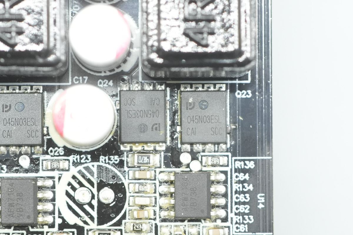

The accompanying MOSFETs are from PINGWEI, model PW045N03ESL, in DFN5*6 package.
The other side mirrors this setup with a pair of identical MOSFETs.

These are two 4.7μH step-down choke.
The synchronous step-down chip is from NDP, model NDP2332KC, in SOP-8 package.

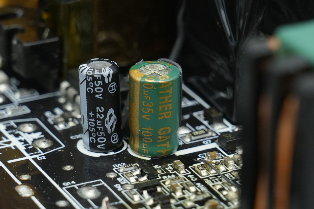

The filtering cap, 220μF 50V.
Another one is from GATHER, 100μF 35V.

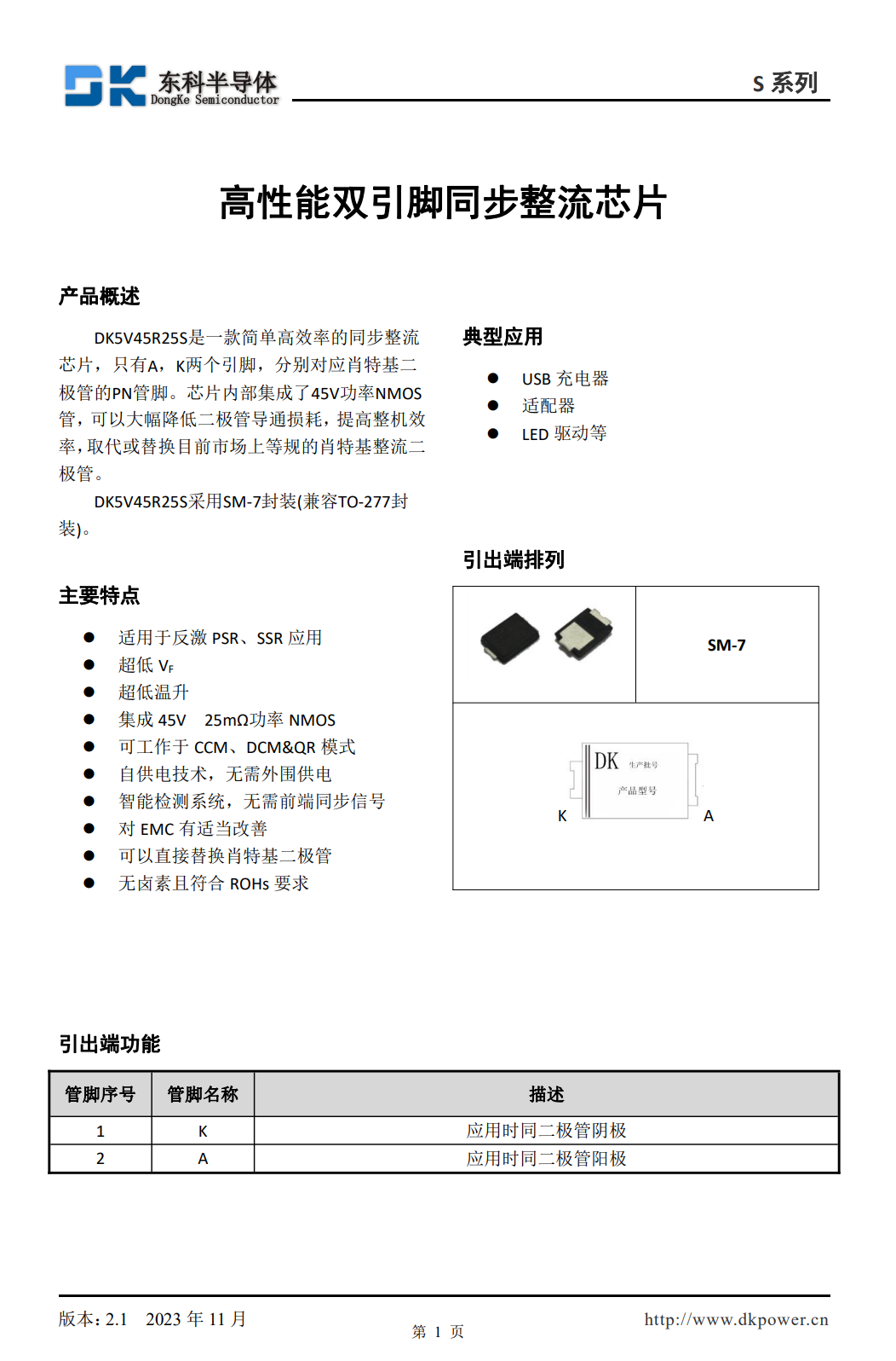

The synchronous rectifier chip is from DK, model DK5V45R25S. It is a peripheral-free synchronous rectifier chip featuring an integrated synchronous rectifier MOSFET with a 45V breakdown voltage and an on-resistance of 25mΩ. It incorporates proprietary self-powering technology to directly replace traditional Schottky diodes, supporting CCM, DCM, and QR operating modes without requiring any external components, in SM-7 package.
Here is the info about DK DK5V45R25S.

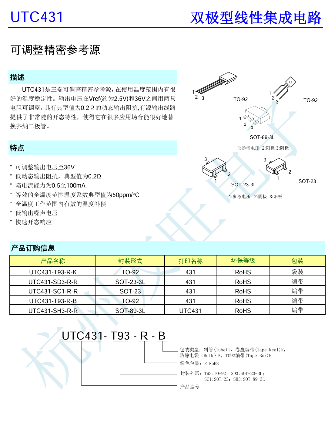

The voltage reference is from Youwang, model UTC431. It is a three-terminal adjustable precision shunt regulator, providing an adjustable output voltage range of 2.5-36V. It features low dynamic output impedance, low output noise voltage, and rapid turn-on response, in SOT-23 package.
Here is the info about Youwang UTC431.

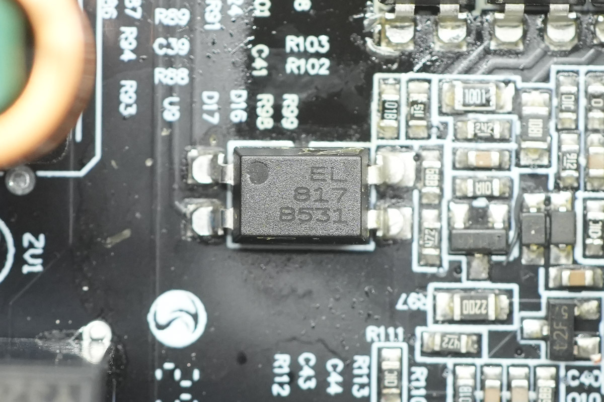

The optocoupler is from EVERLIGHT, model EL817.

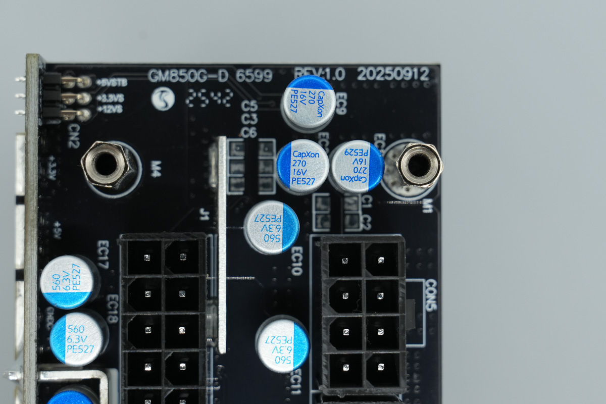

The output PCB is connected via header pins and copper busbars. The PCB houses the modular output connectors and solid filtering caps.

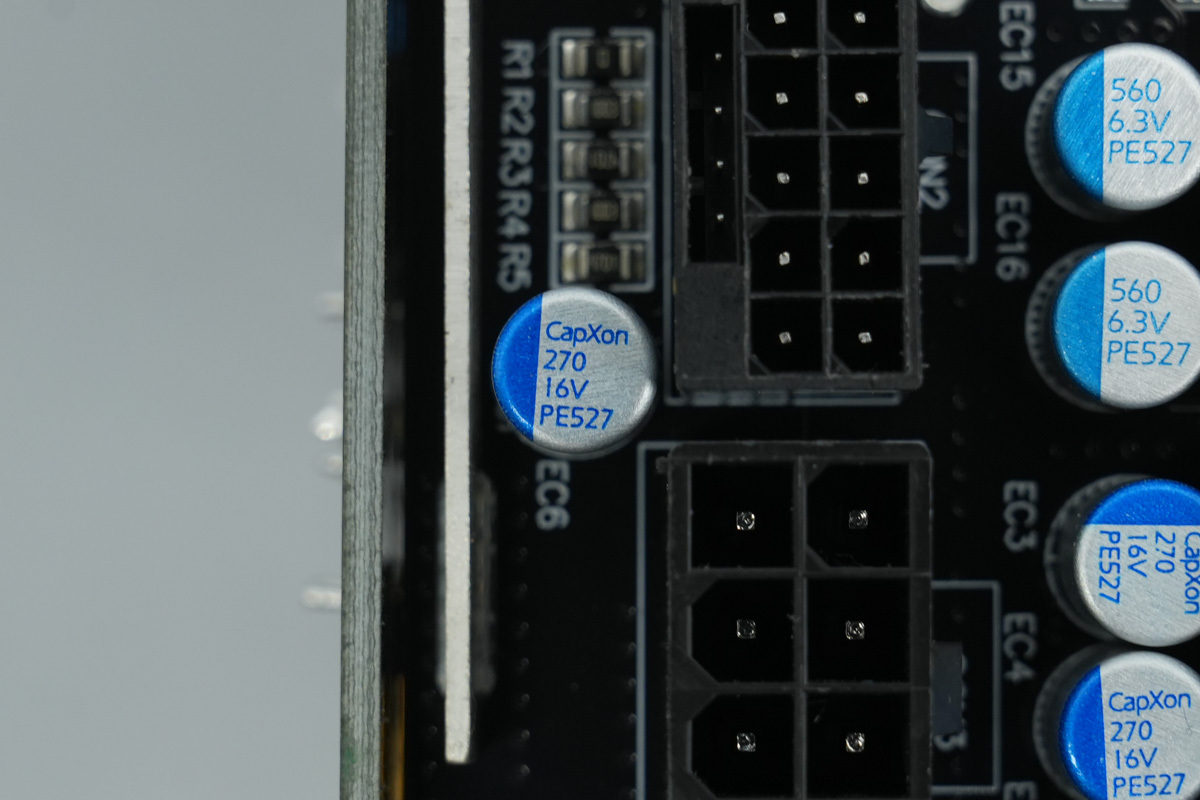

The filtering caps are from CapXon, 270μF 16V and 560μF 6.3V respectively.
Two filtering caps are utilized, 270μF 16V.
The filtering cap, 560μF 6.3V.
The filtering cap, 560μF 6.3V and 270μF 16V respectively.
The filtering cap, 2700μF 16V.
