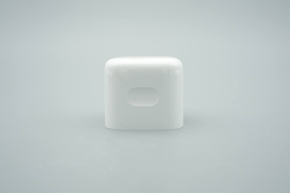

Teardown of Apple 40W Dynamic Power Adapter (A3365, HK Version)-Chargerlab

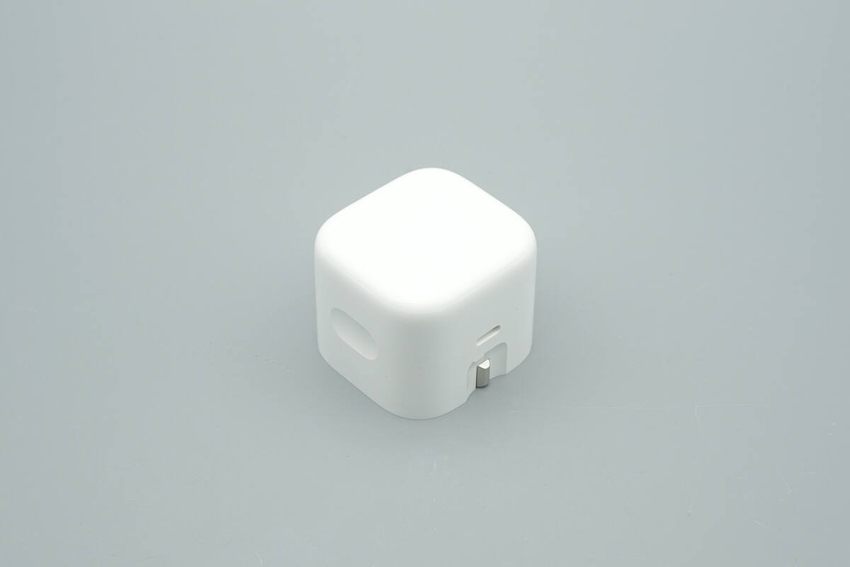

It features a white glossy casing with a minimalist design.

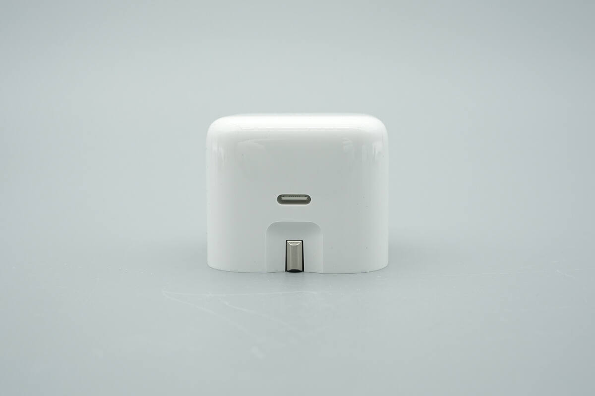

The output side is equipped with a single USB-C port with a white plastic sheet.

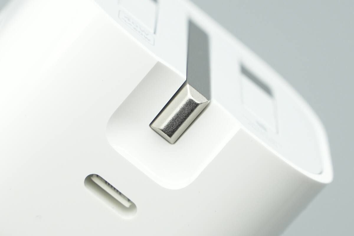

The plug area features a recessed design to make it easier to remove the plug.

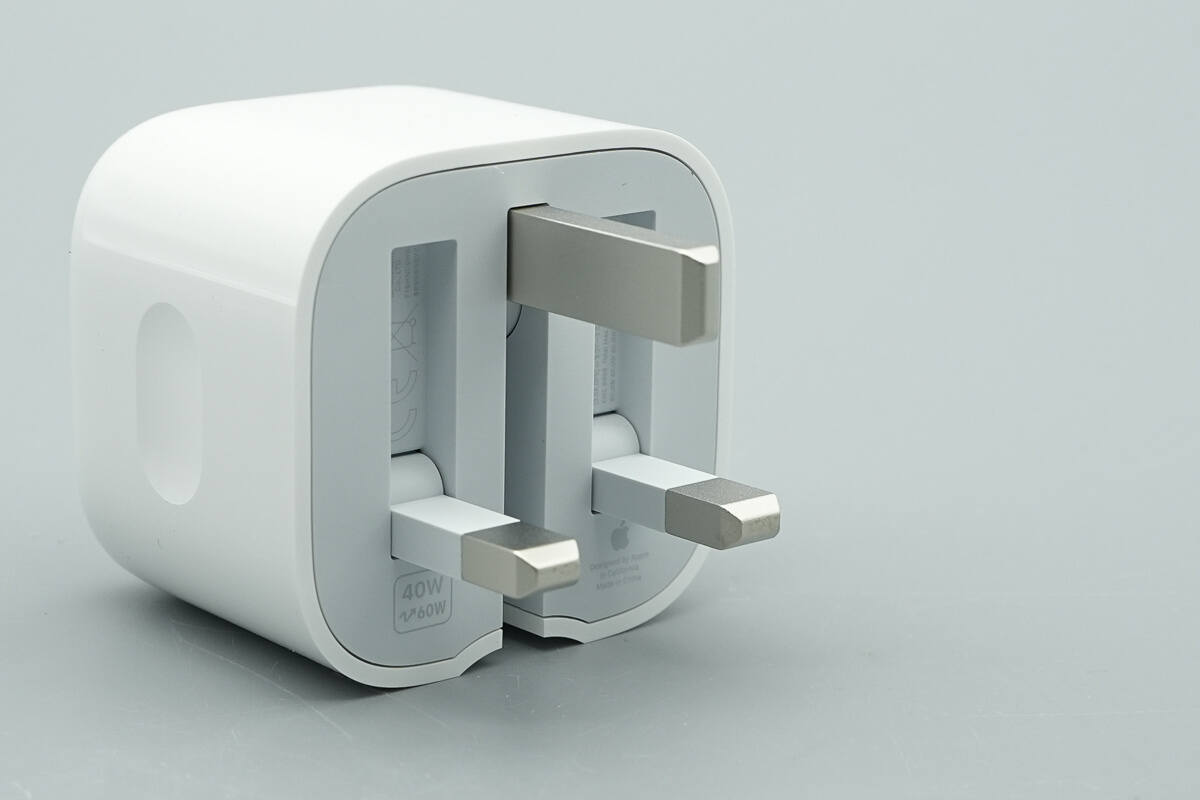

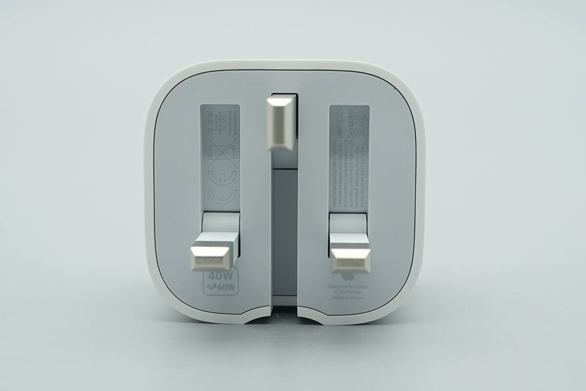

The UK plug is foldable.

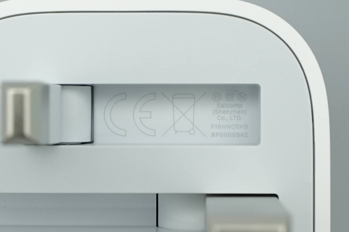

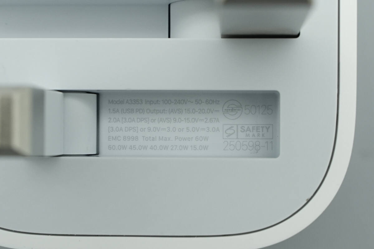

The plug storage slot is printed with product specifications, certifications, and manufacturer information.
Model: A3353
Input: 100–240V~50/60Hz 1.5A (USB PD)
Output: (AVS) 15–20V 2A [3.0A DPS] or (AVS) 9–15V 2.67A [3.0A DPS] or 9V 3A or 5V 3A
Maximum total output power: 60W
It is certified with CE and meets Level VI energy efficiency standards.

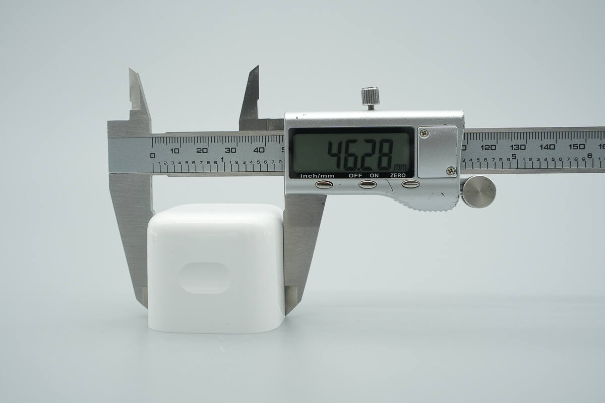

The length of the charger is about 46.28 mm (1.82 inches).

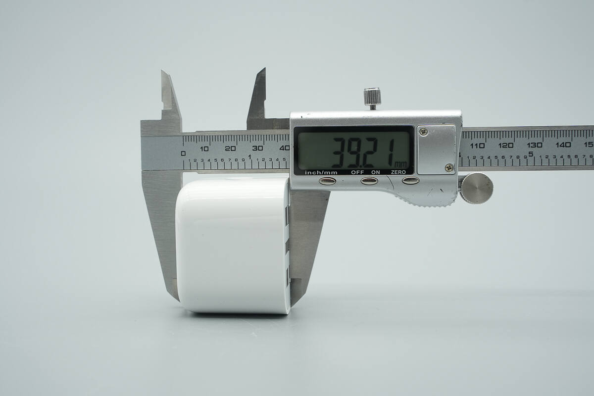

The thickness is about 39.21 mm (1.54 inches).

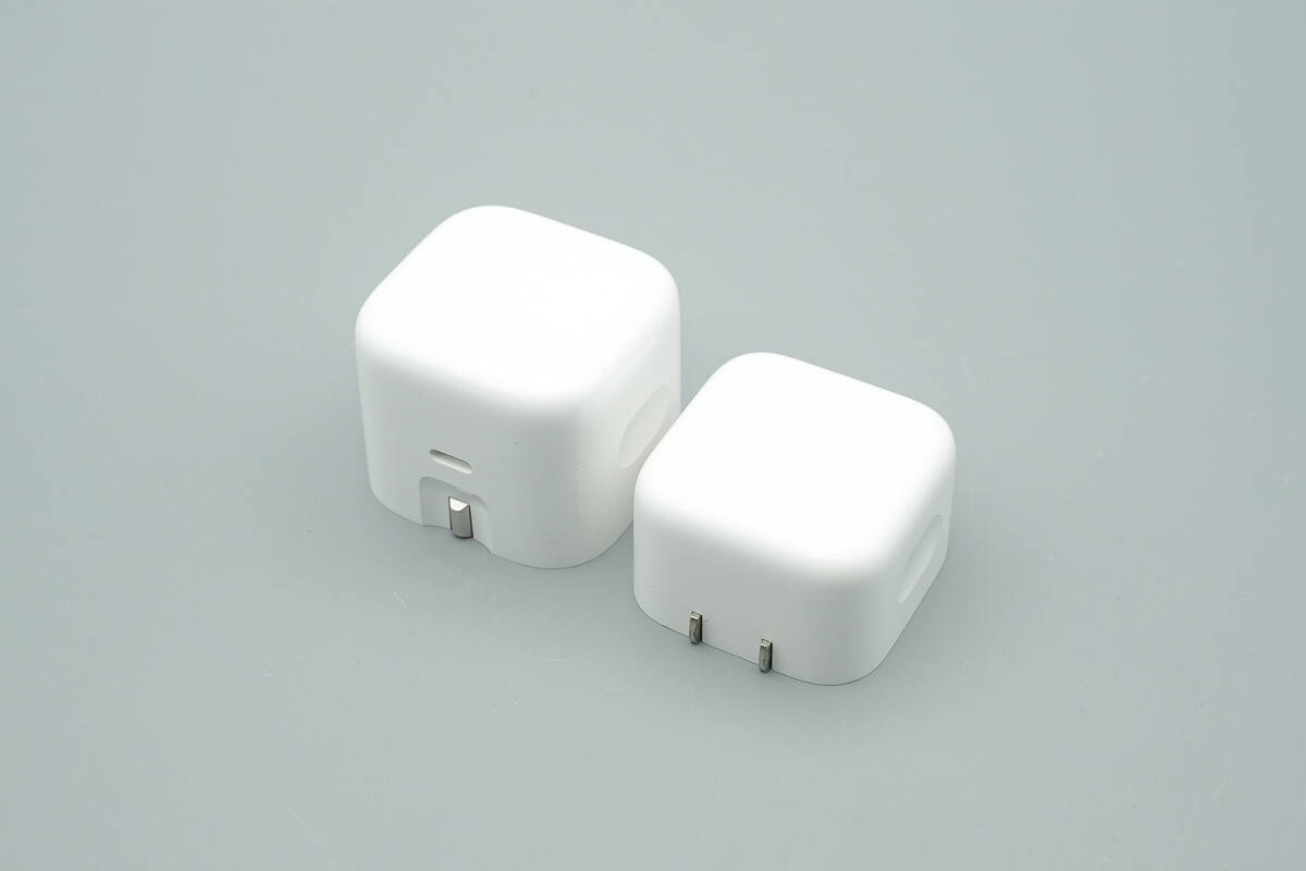

Placed side by side with the Chinese version, the two adapters have nearly identical cross-sectional dimensions, but the Hong Kong version is noticeably thicker.

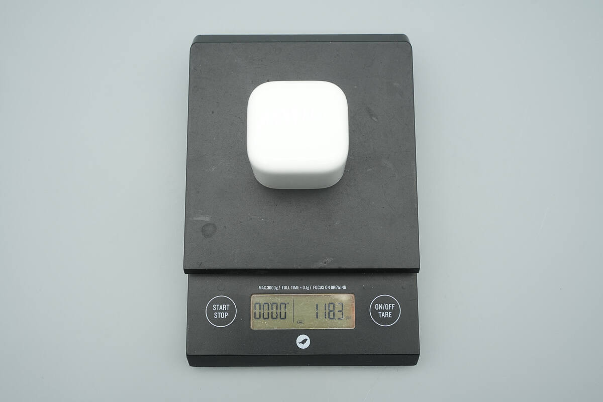

The weight is about 118 g (4.16 oz).

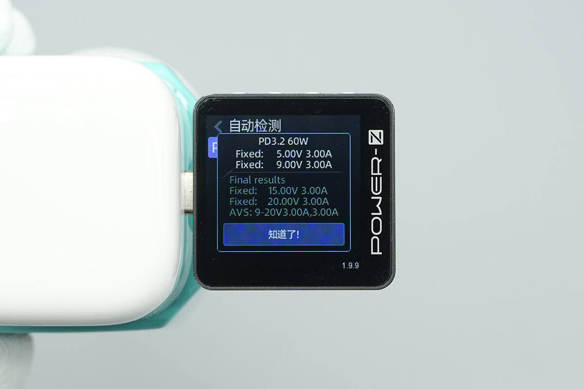

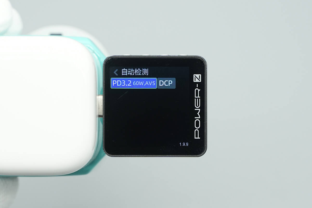

ChargerLAB POWER-Z KM003C shows that it supports PD3.2 and DCP charging protocols.
It has four fixed PDOs of 5V3A, 9V3A, 15V3A, and 20V3A. It also has a set of AVS, which is 9-20V3A.

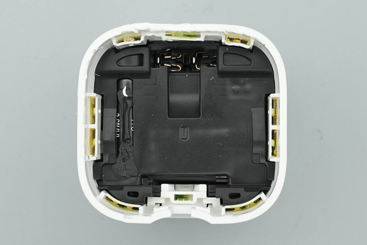

The bottom casing is removed, and the edges have retaining clips.

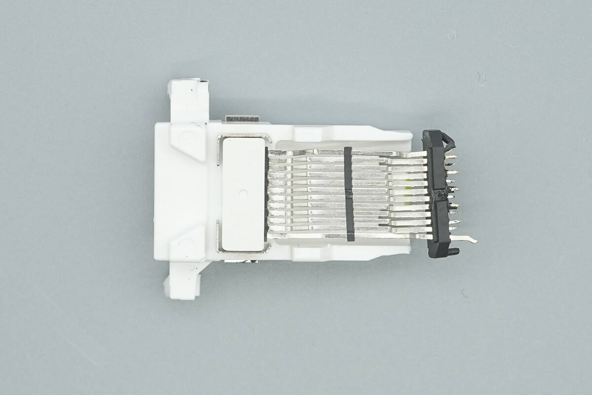

The plug module uses a linked mechanism, allowing the live and neutral pins to fold or unfold simultaneously by simply moving the ground pin.
Close-up of the linked lever at the ground pin.
Another area is lined with insulating paper.

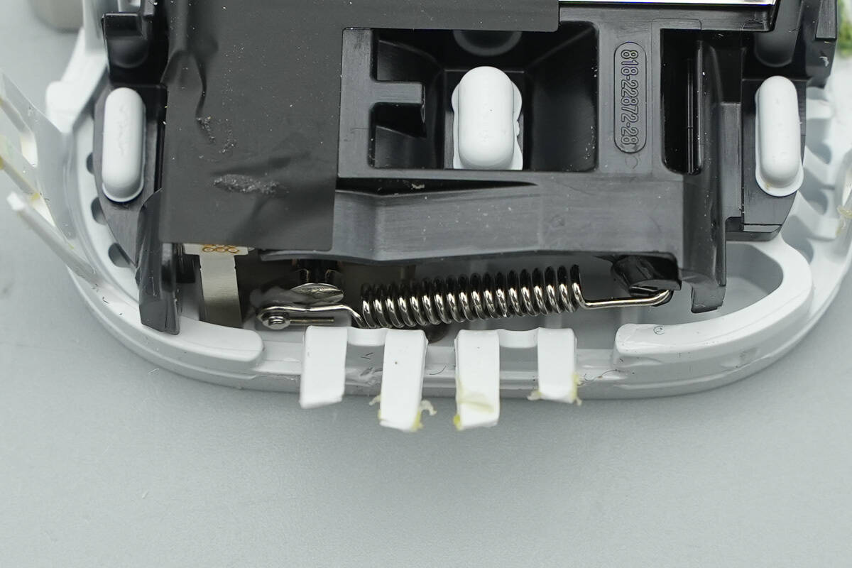

Auxiliary retaining springs are installed on both sides of the module to prevent the live and neutral pins from loosening after prolonged use.

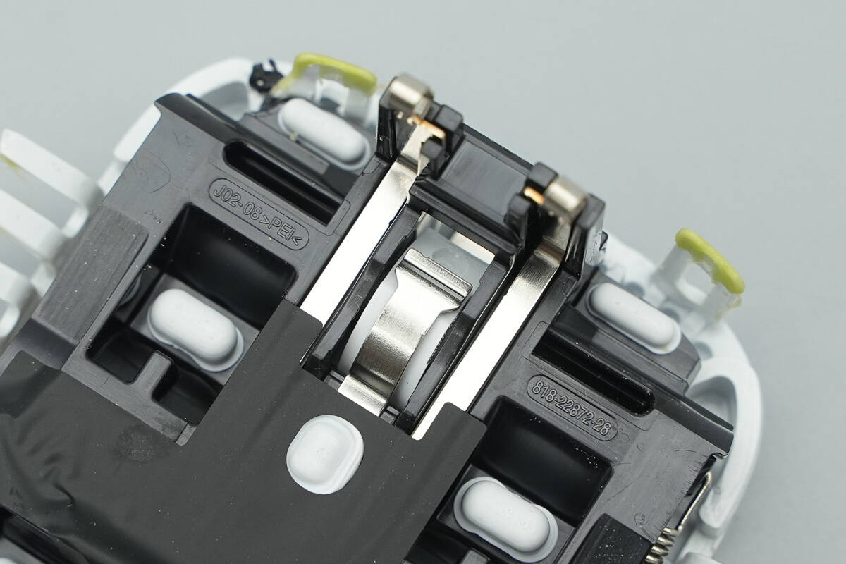

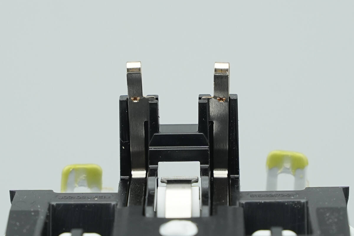

The plug module and the PCBA module are electrically connected through direct contact.

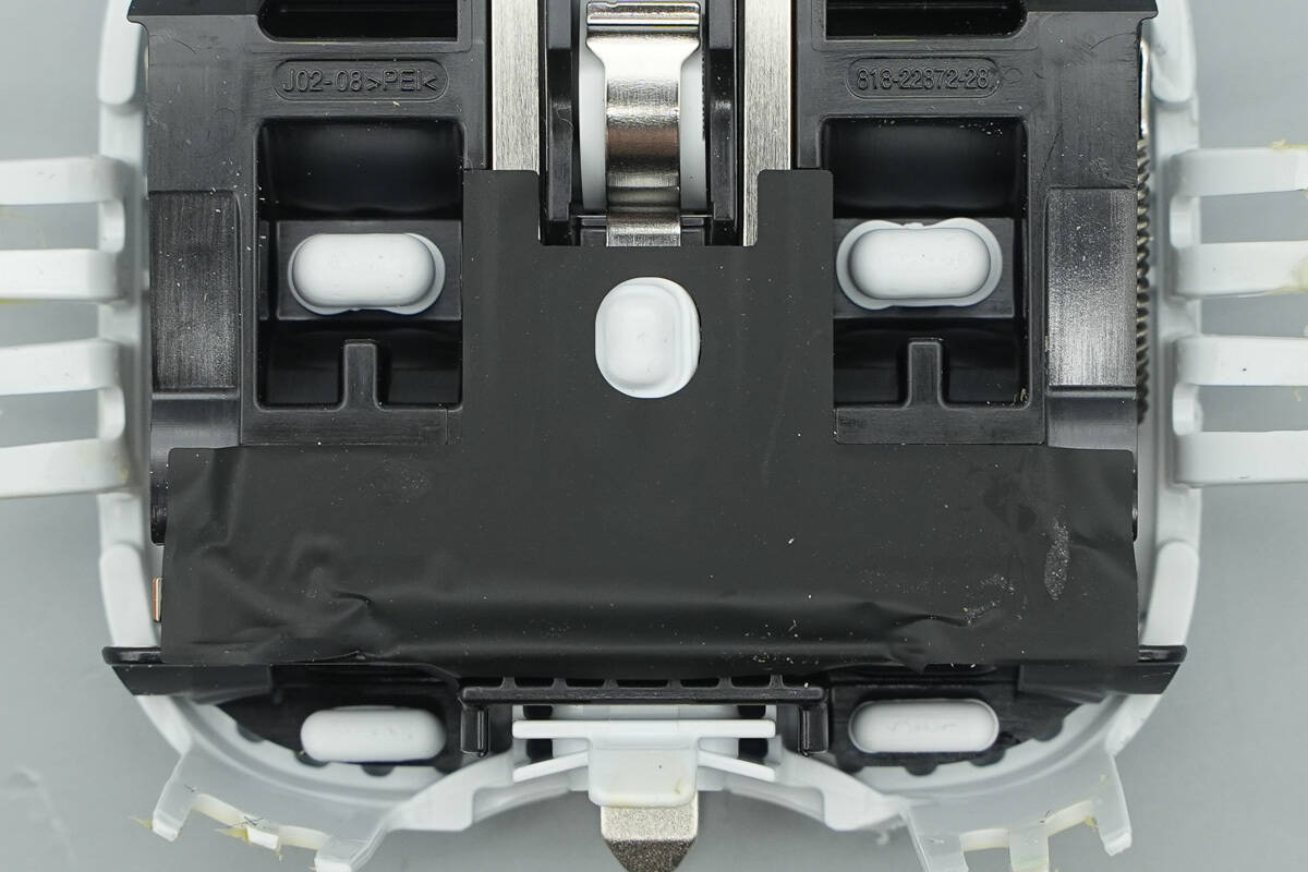

A protective rubber pad is placed at the bottom of the PCBA module.

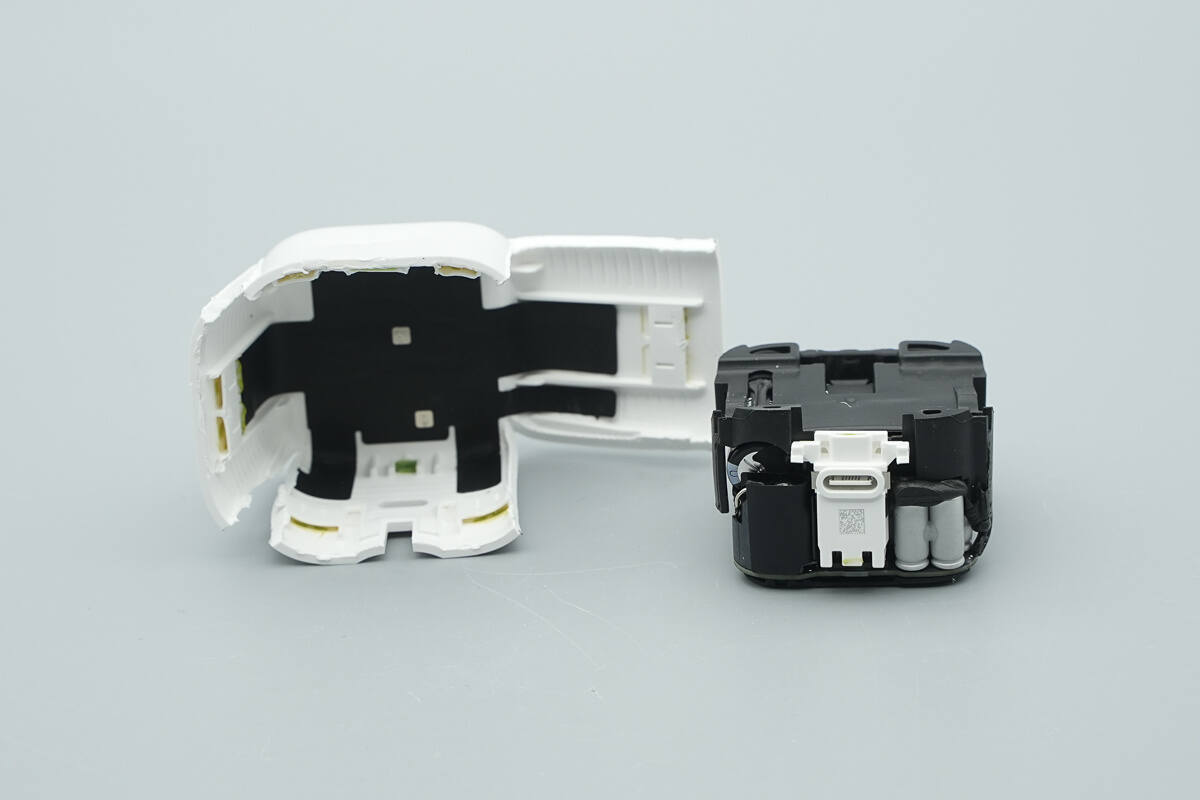

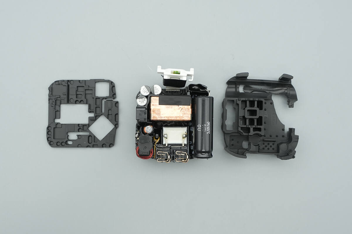

Cut open the casing to remove the PCBA module.

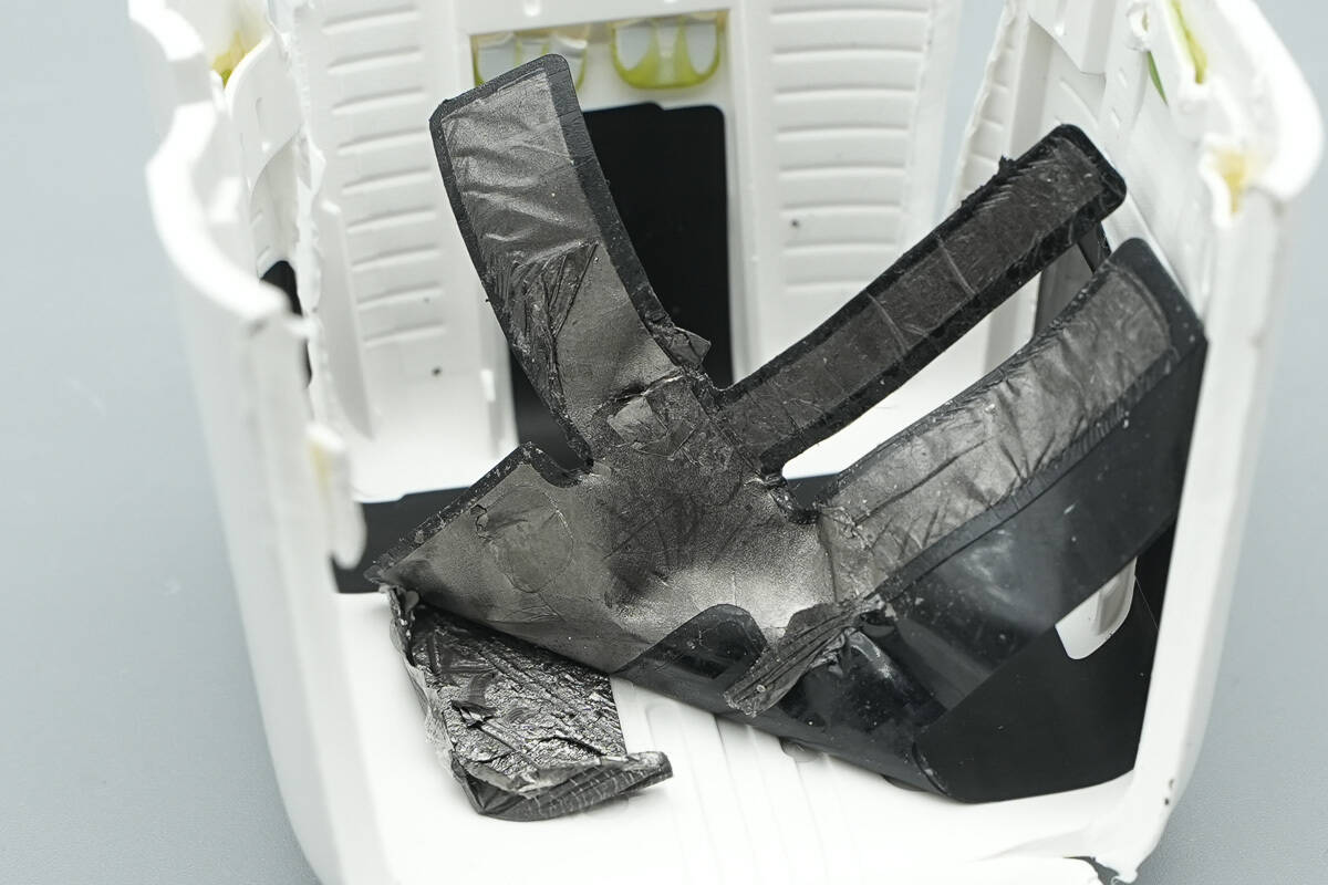

The inner side of the other half of the casing is lined with graphite thermal tape and has been insulated.

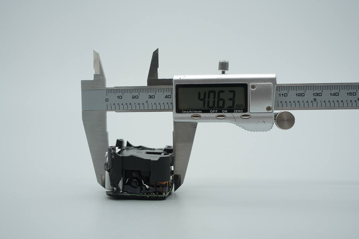

The length of the PCBA module is about 40.63 mm (1.6 inches).

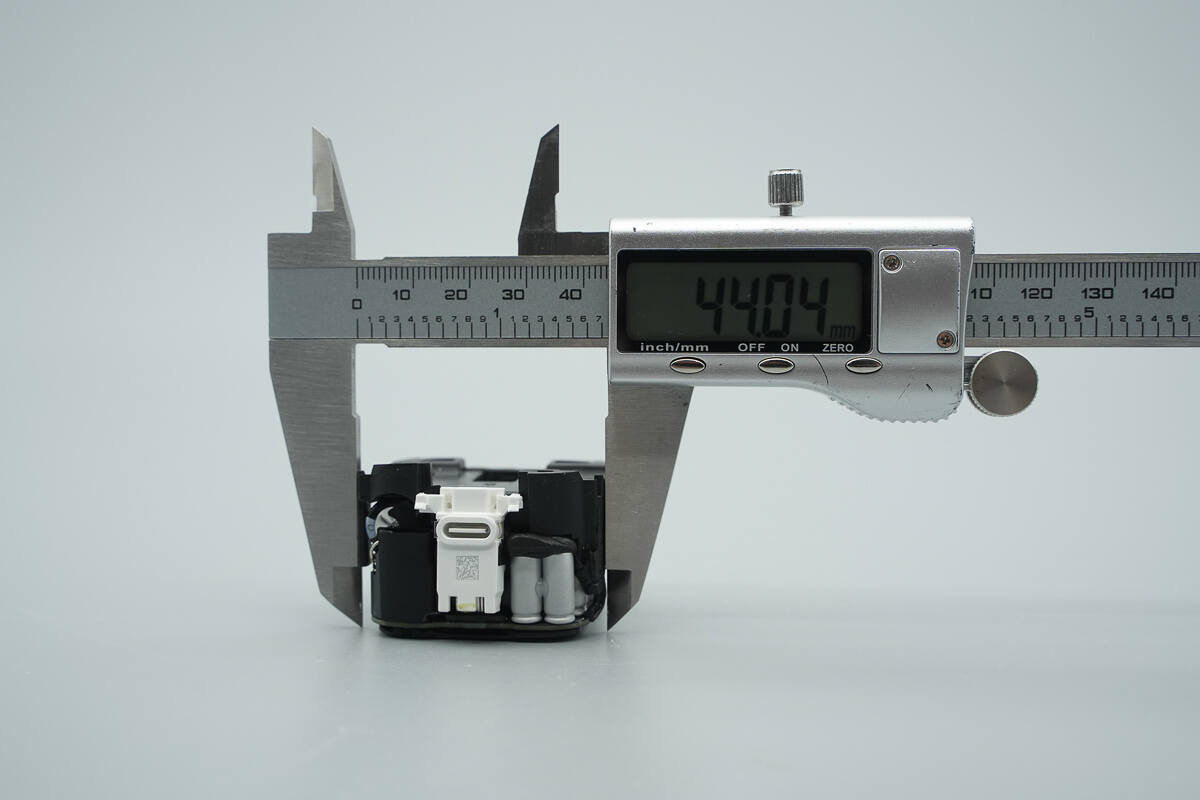

The width is about 44.04 mm (1.73 inches).

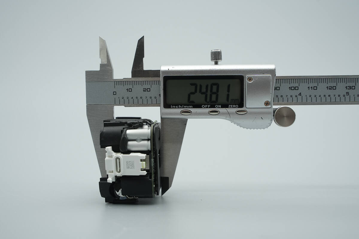

The thickness is about 24.81 mm (0.98 inches).

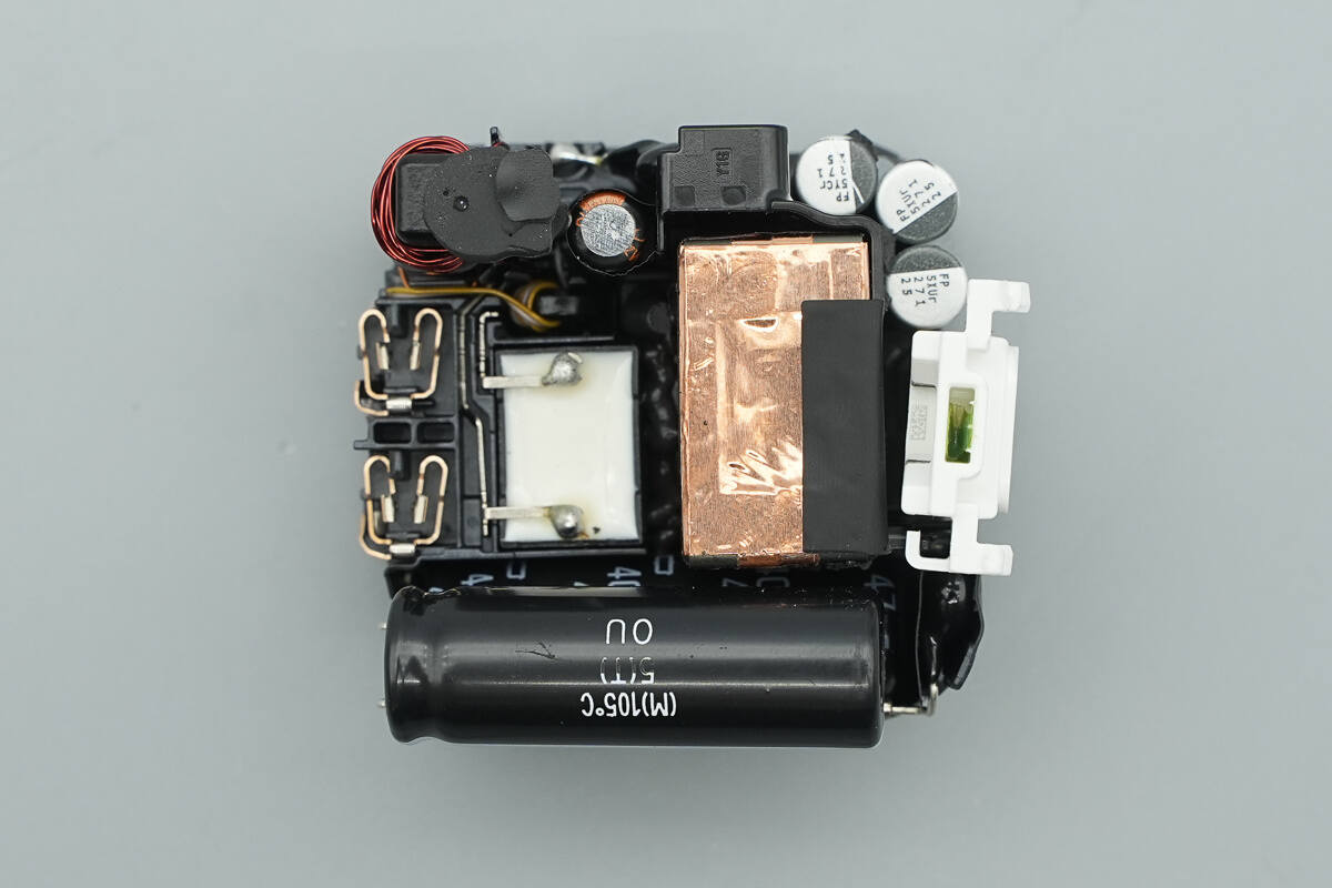

The protective rubber pads on the top and bottom of the PCBA module are removed.
The transformer at the center of the module is wrapped in copper foil, with a plastic casing on the secondary side for reinforcement and insulation.

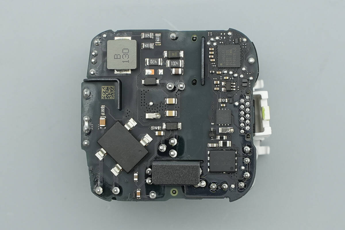

The back of the PCB features a bridge rectifier, differential-mode choke, synchronous rectifier, protocol chip, and VBUS MOSFET.

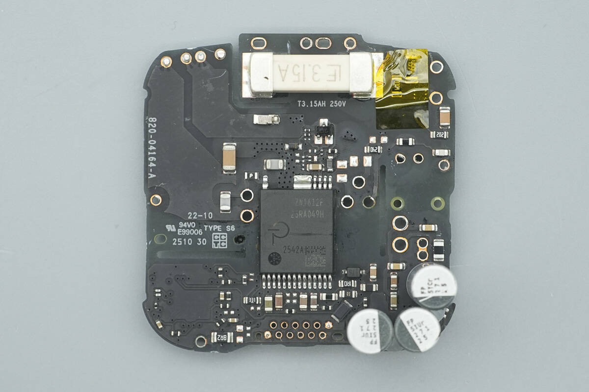

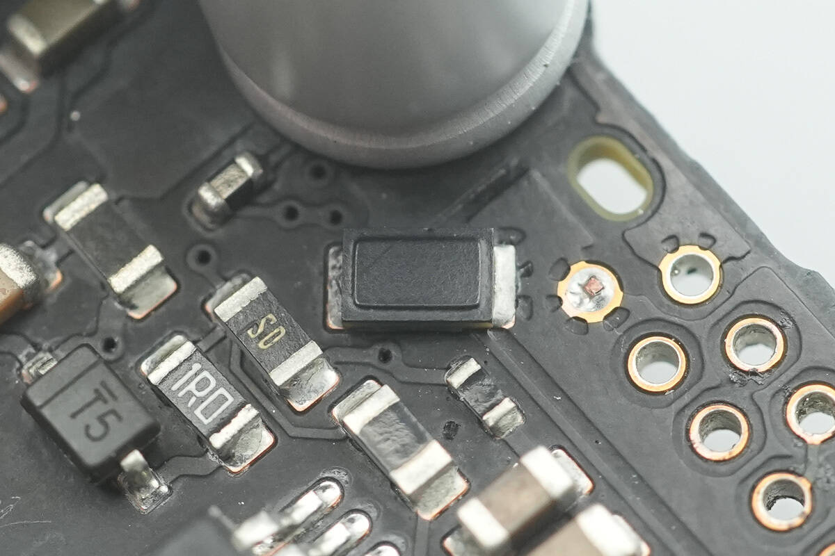

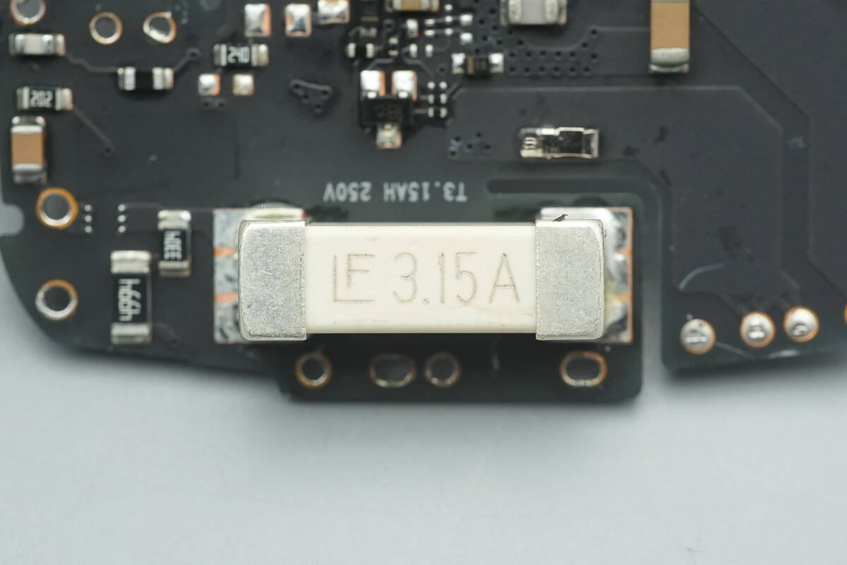

The SMD fuse is from Littelfuse, rated at 3.15 A.

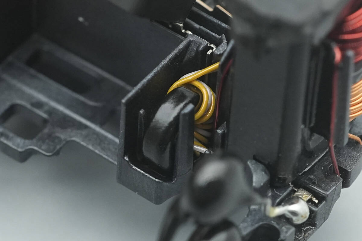

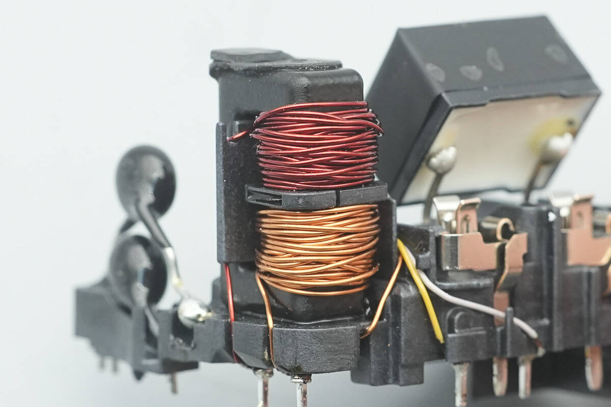

The common-mode choke is used to filter out EMI interference.
Close-up of another common-mode choke.

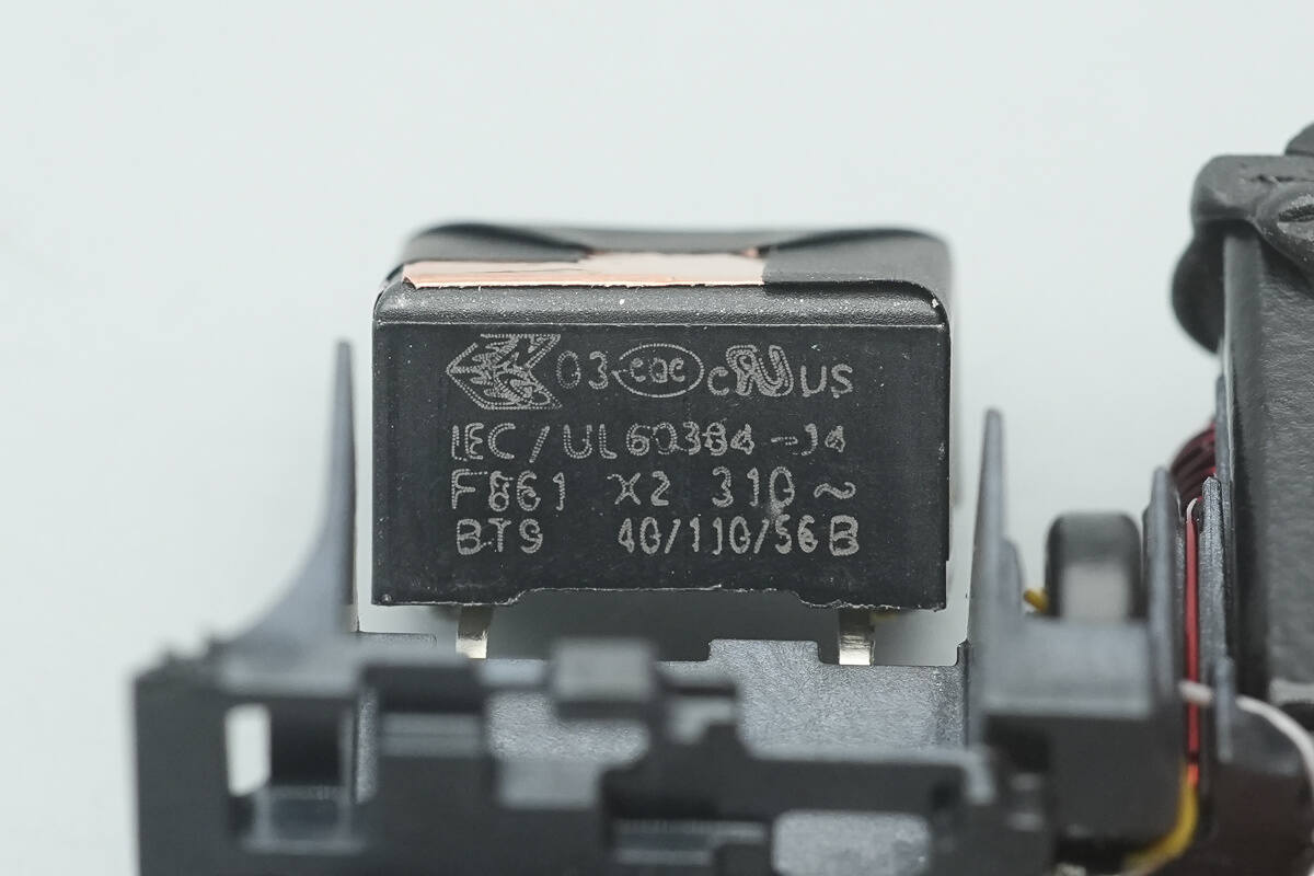

The safety X2 capacitor has a specification of 0.1 μF and is wrapped in a copper foil shield.

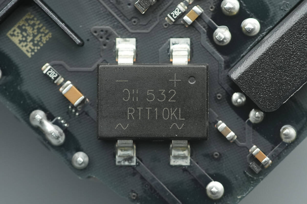

The input-side bridge rectifier is from DIODES, with a custom model RTT10KL, and comes in a TTL package.

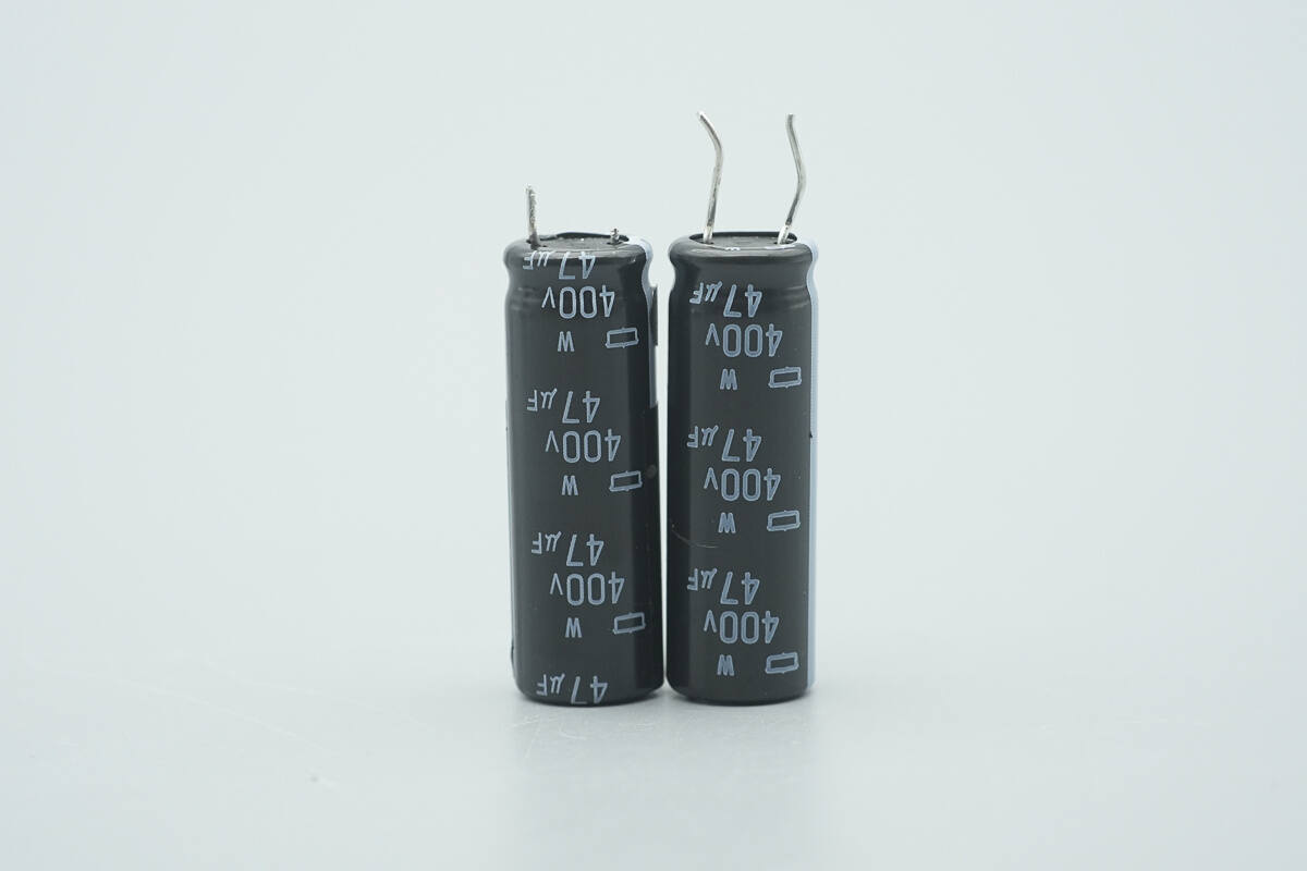

The high-voltage filter capacitors are from NCC, rated at 400 V 47 μF, with two units connected in parallel.

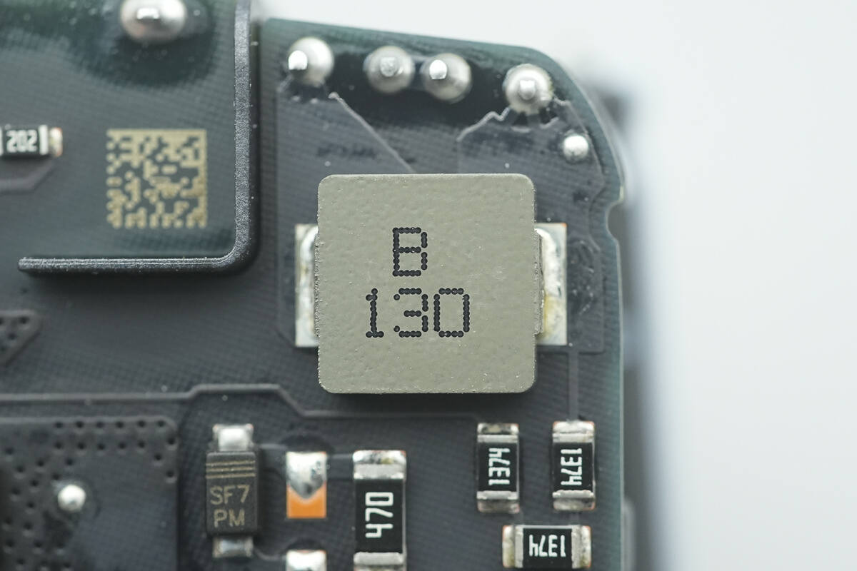

The differential-mode choke is rated at 13 μH.

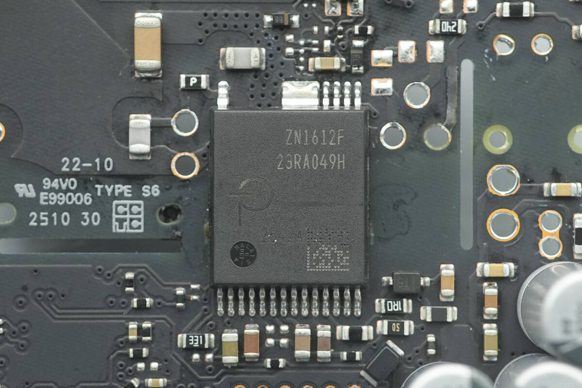

The master control chip is from PI, marked ZN1612F, a custom model for Apple. It integrates the primary controller, high-voltage MOSFET, synchronous rectification controller, and feedback functions, offering high integration and minimal external components, which simplifies fast-charging power supply design. It comes in an InSOP-T28D package.

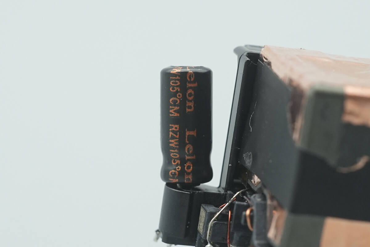

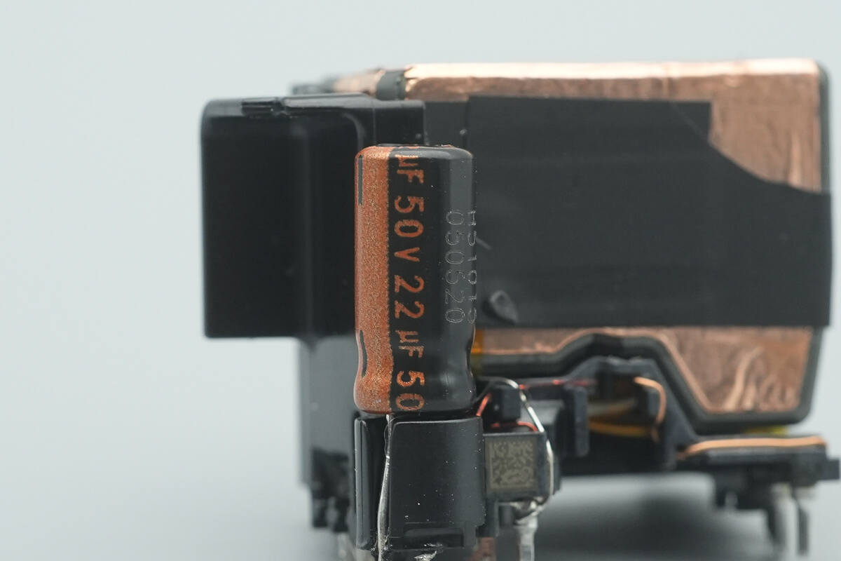

The capacitor supplying power to the master control chip is from Lelon.
The capacitor is rated at 50 V, 22 μF.

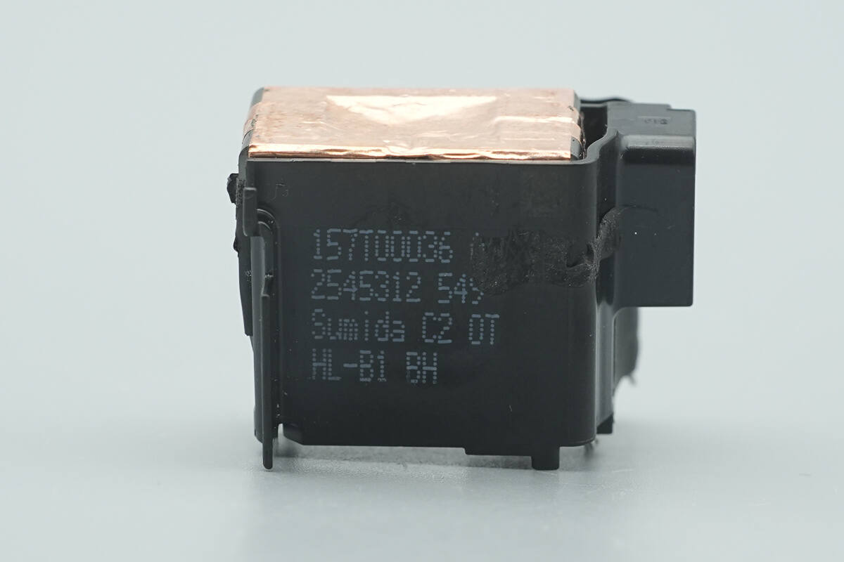

The transformer is manufactured by Sumida.

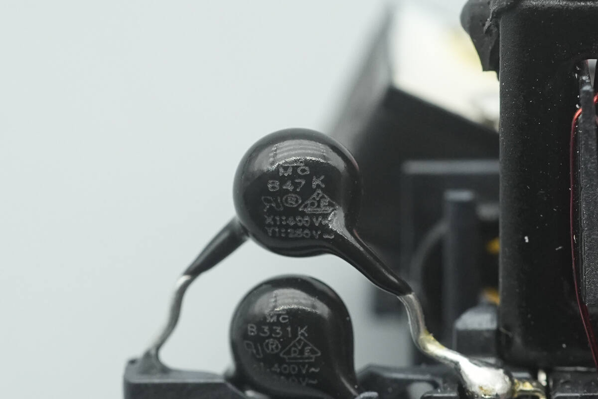

Close-up of the black Y capacitors.
Close-up of the third capacitor.

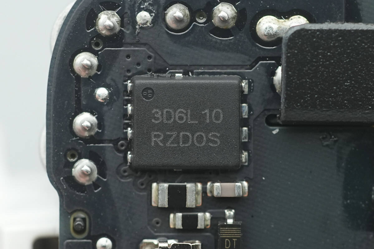

The synchronous rectifier is from Onsemi, model NTMFS3D6N10MCL, an NMOS with a voltage rating of 100 V and an on-resistance of 3.6 mΩ, in a DFN5 package.

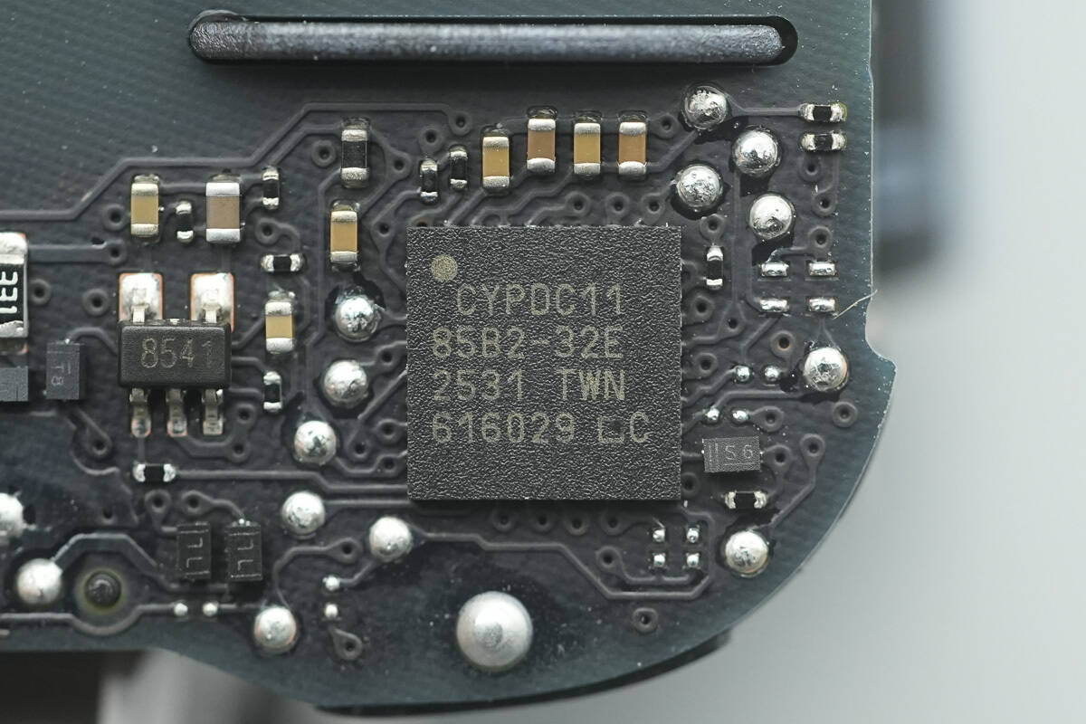

The protocol chip is from Infineon, model CYPDC1185B2-32E, in a 32-pin QFN package.

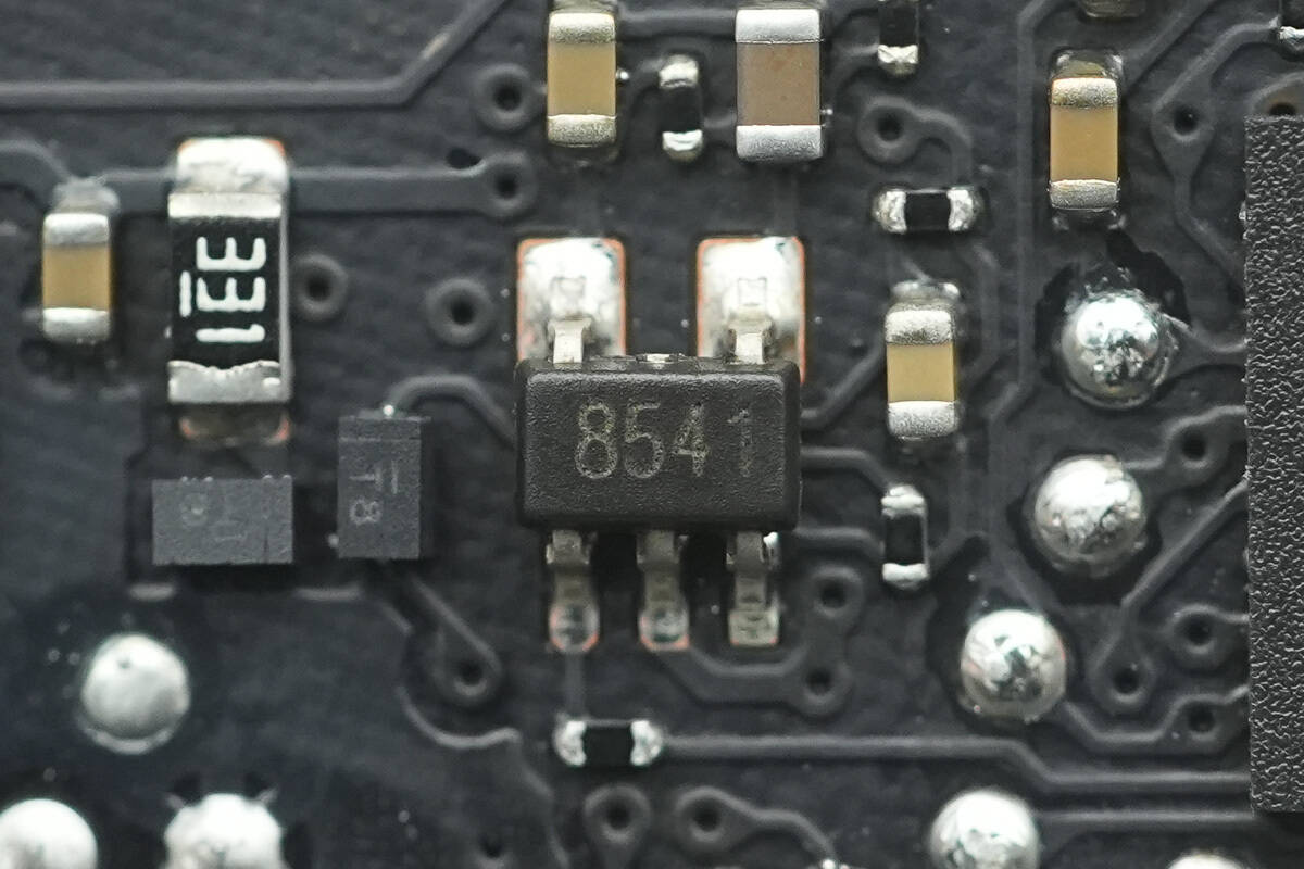

The single operational amplifier marked 8541 comes in an SOT-23 package.

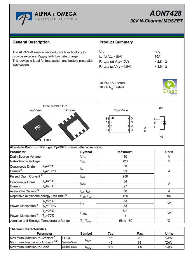

VBUS MOSFET from AOS, model AON7428, NMOS, with a voltage rating of 30V and an on-resistance of 2.8 mΩ, packaged in DFN3.3 × 3.3EP.
Here is the information about AOS AON7428.

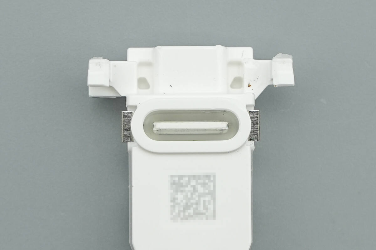

The USB-C connector pins are extended and soldered onto the PCBA.
Close-up of the USB-C connector.

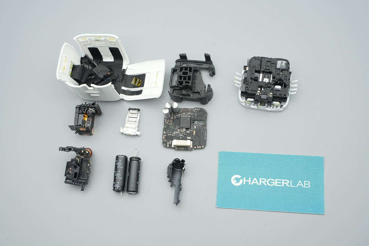

Well, those are all components of the Apple 40W Dynamic Power Adapter (A3365, HK Version).

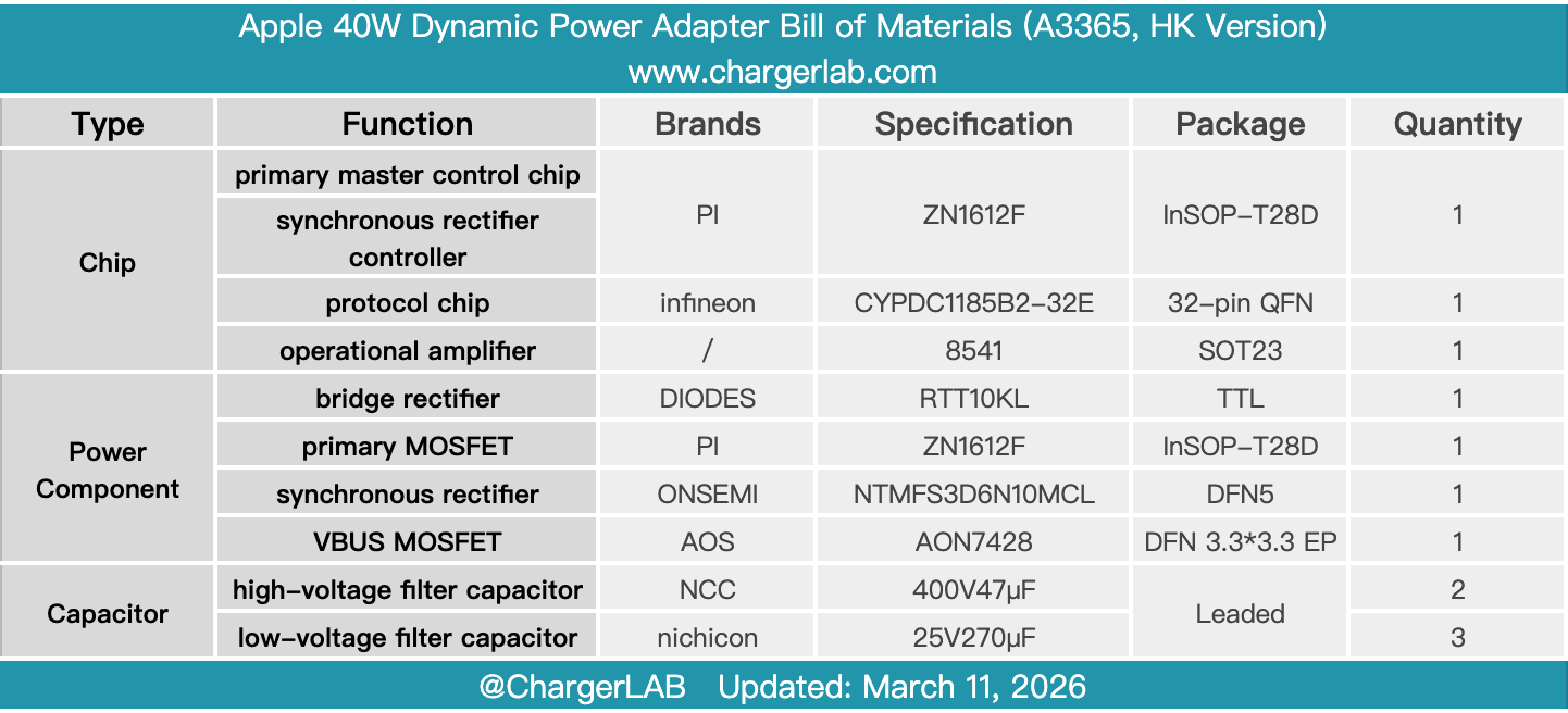

Here is the component list of the Apple 40W Dynamic Power Adapter (A3365, HK Version) for your convenience.
