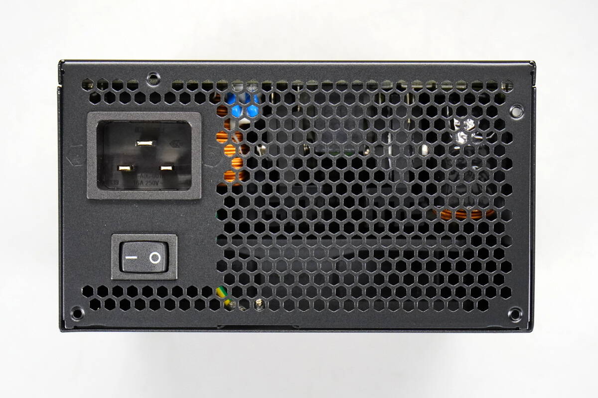

Teardown of HuntKey MVP P1600X Platinum SiC Fully Modular PSU (HK1K6-51PG)-Chargerlab
The input side uses a C20 socket and is equipped with a switch.

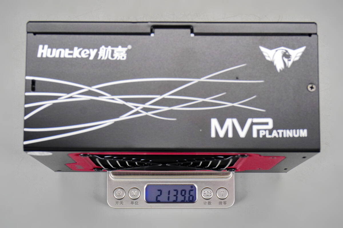

The weight is about 2140 g (75.49 oz).

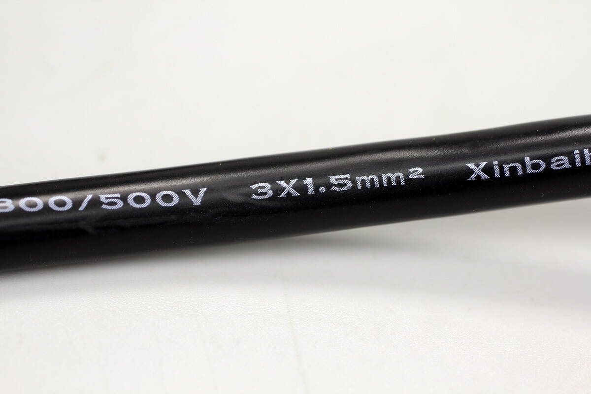

The power cable is specified as 3 × 1.5 mm².

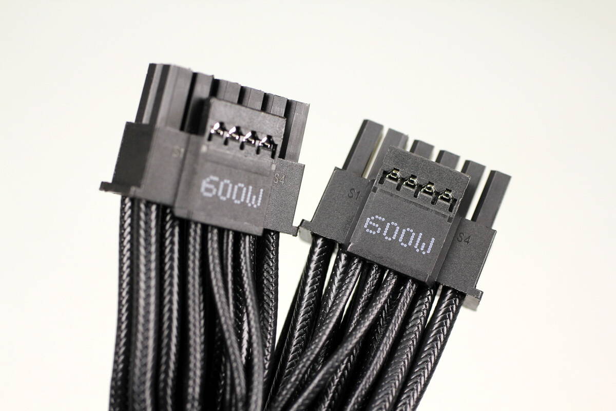

The PCIe 5.1 modular cable supports up to 600W of power.

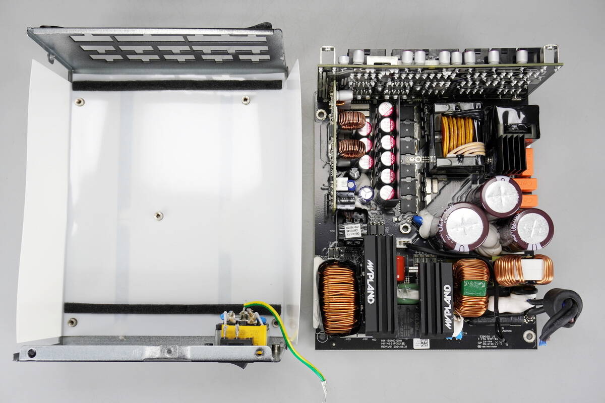

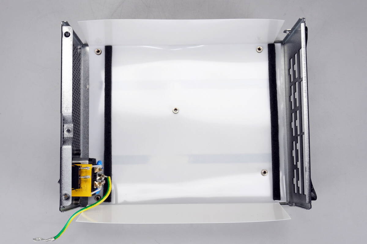

The PCBA module is secured inside the casing with screws, with Mylar sheets on both sides for insulation.
Remove the PCBA module from the casing.
The Mylar sheets are affixed with foam padding for protection.

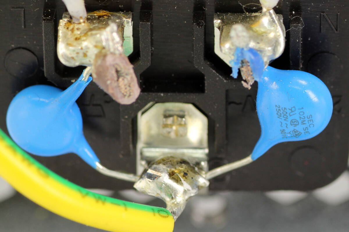

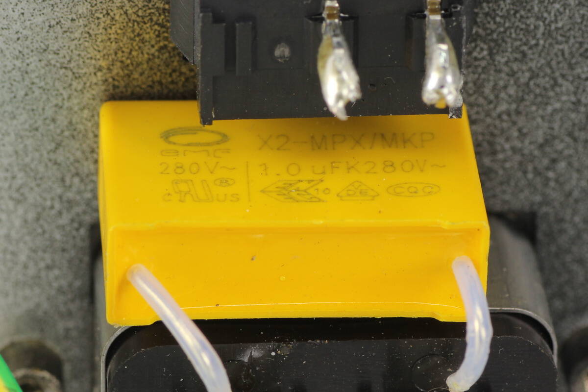

The input socket is secured with screws, with X2 and Y safety capacitors soldered to it.
The X2 safety capacitor is from EMF, rated at 1 μF.
The two blue Y capacitors are from SEC, part number 102M.

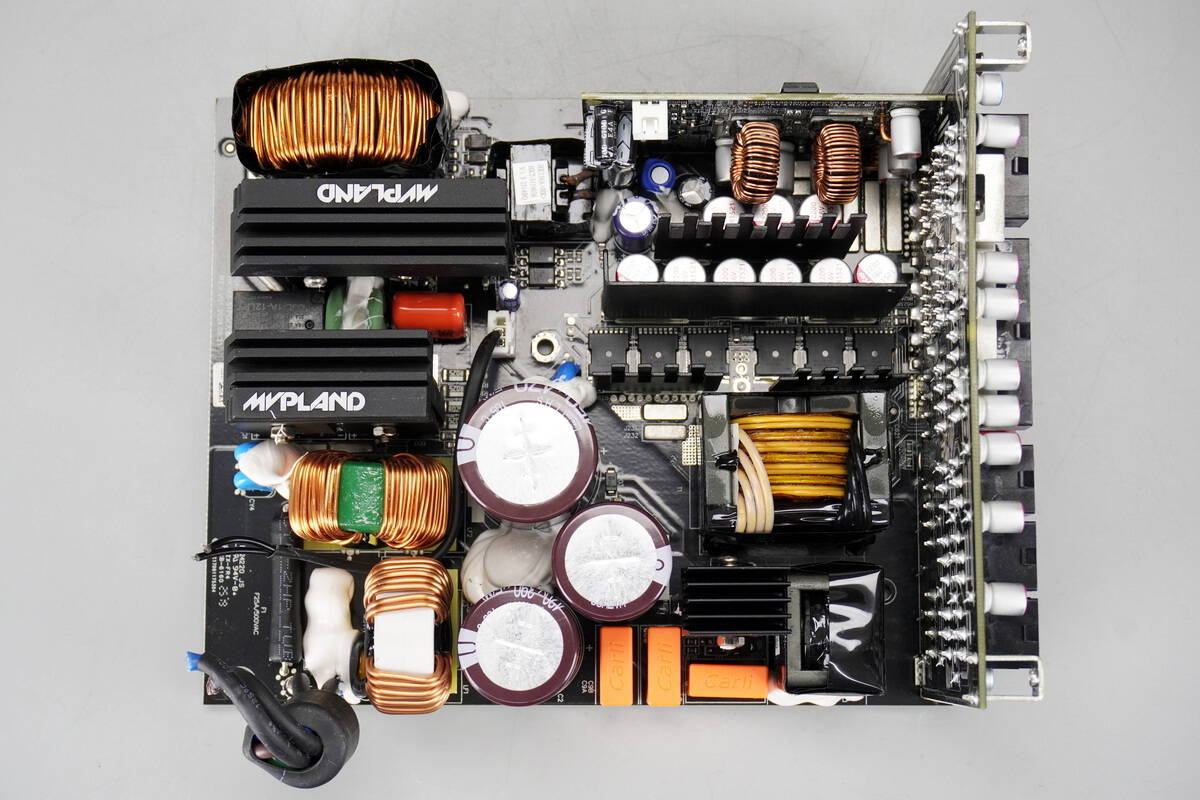

The front side of the PCBA module features a fuse, varistor, safety X2 capacitor, common-mode chokes, bridge rectifiers, PFC boost inductor, PFC MOSFETs, PFC rectifiers, standby power transformer, high-voltage filter capacitors, LLC MOSFETs, resonant capacitors, resonant inductor, and other components.

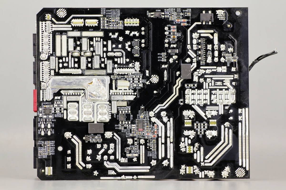

The back side contains a PFC + LLC controller, synchronous rectifier controller, bridge rectifiers, and other components.

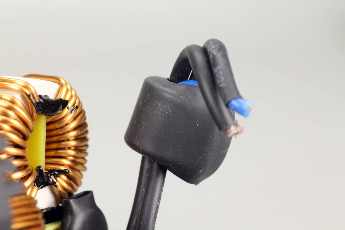

The input cable passes through a ferrite ring to suppress high-frequency interference.

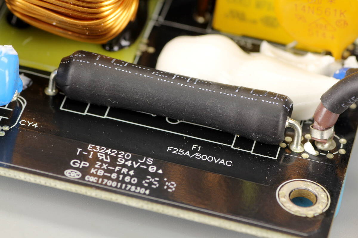

The input fuse is rated at 25A, 500V, and is insulated with a heat-shrink tube.

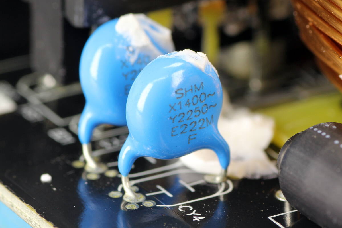

The blue Y capacitors are from SHM, part number E222M.

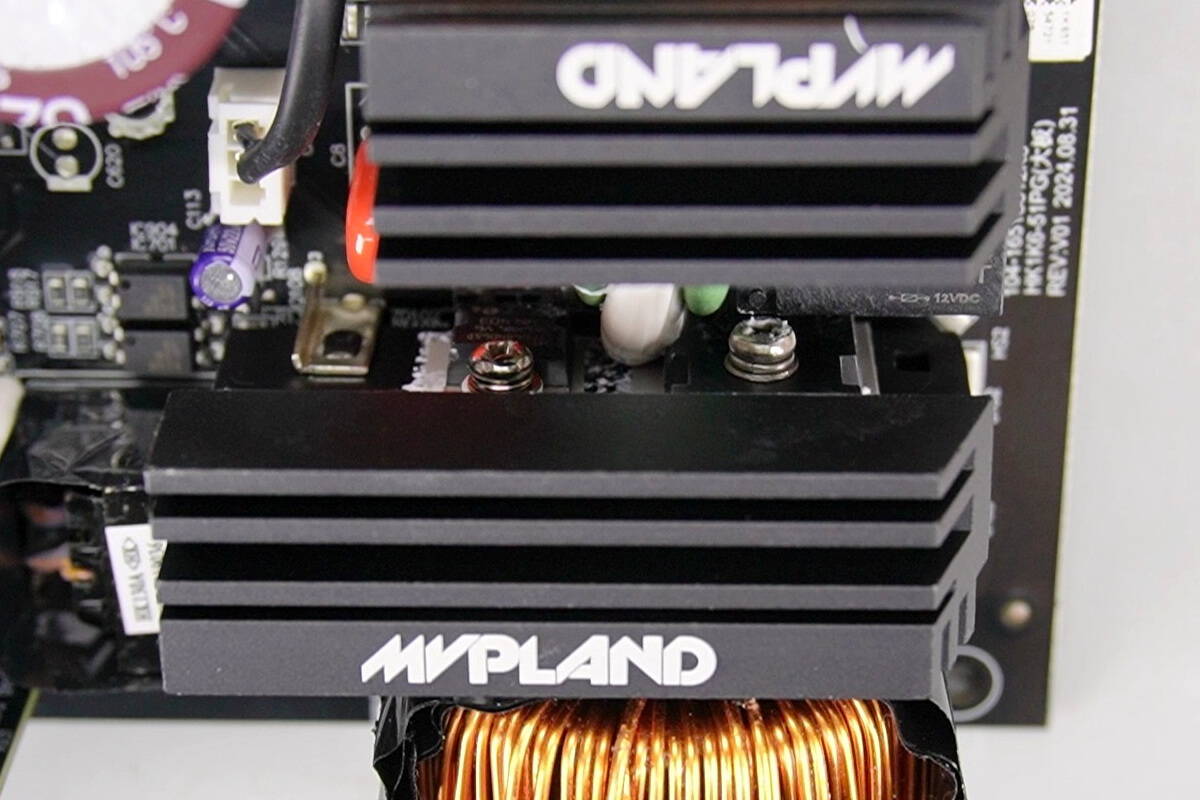

Four bridge rectifiers are mounted on the heatsink.

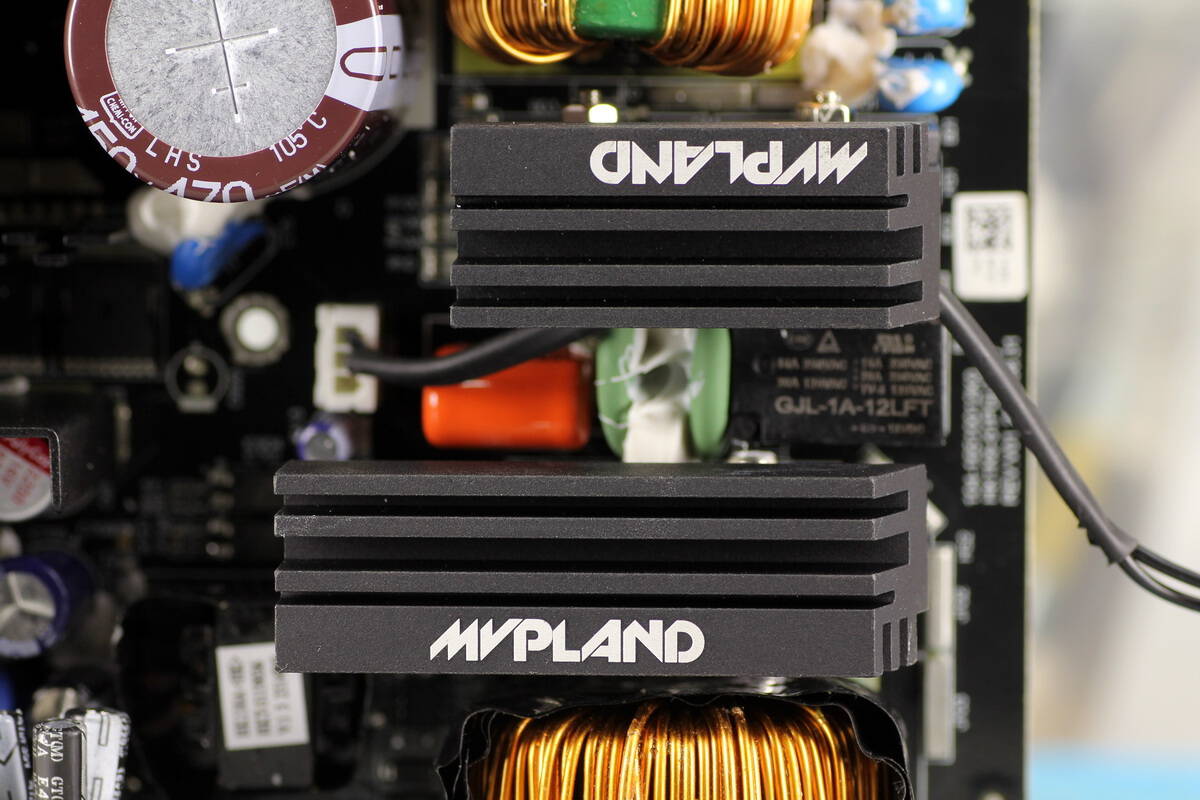

Between the two heatsinks are a film capacitor, an NTC thermistor, and a relay.

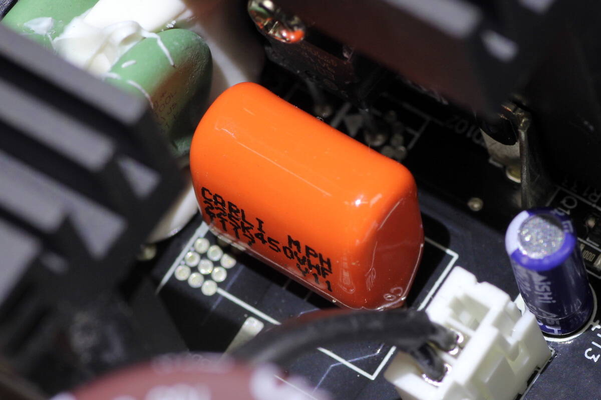

The film capacitor is from Carli, rated at 2.2 μF, 450 V.
Relay from GOLDEN, model GJL-1A-12LFT, is an ultra-compact high-power relay with a contact rating of 20A at 250VAC and a coil voltage of 12V.
The NTC thermistor is from JOYIN, model 20S100L, and is used to suppress inrush current during power-on.

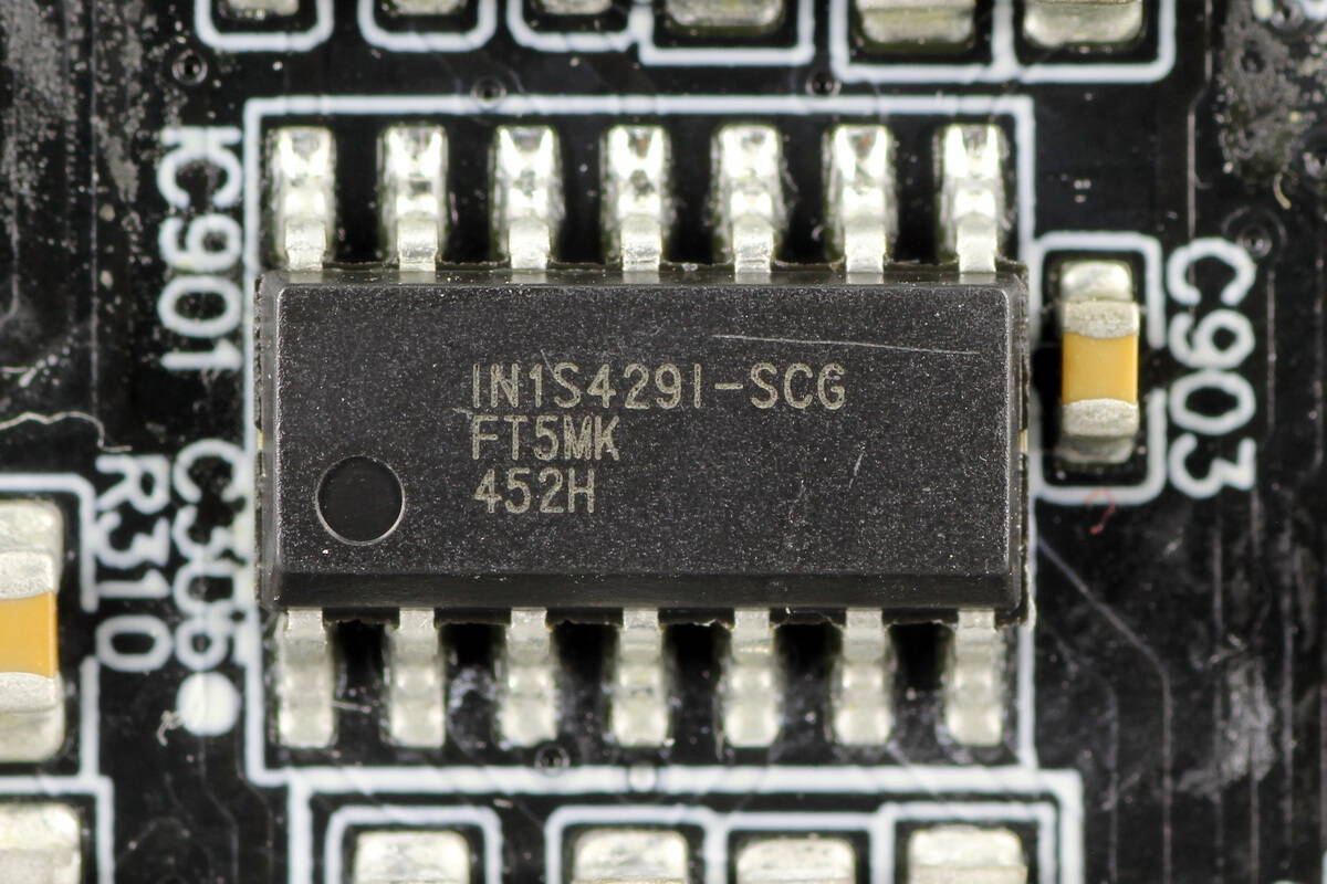

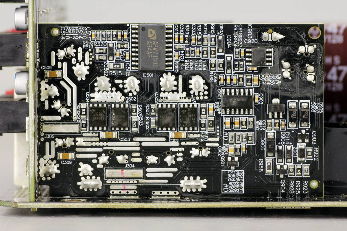

The master control chip is from NXP, marked HKP6288AT. It integrates both PFC and LLC controllers and drivers, and comes in an SO16 package.

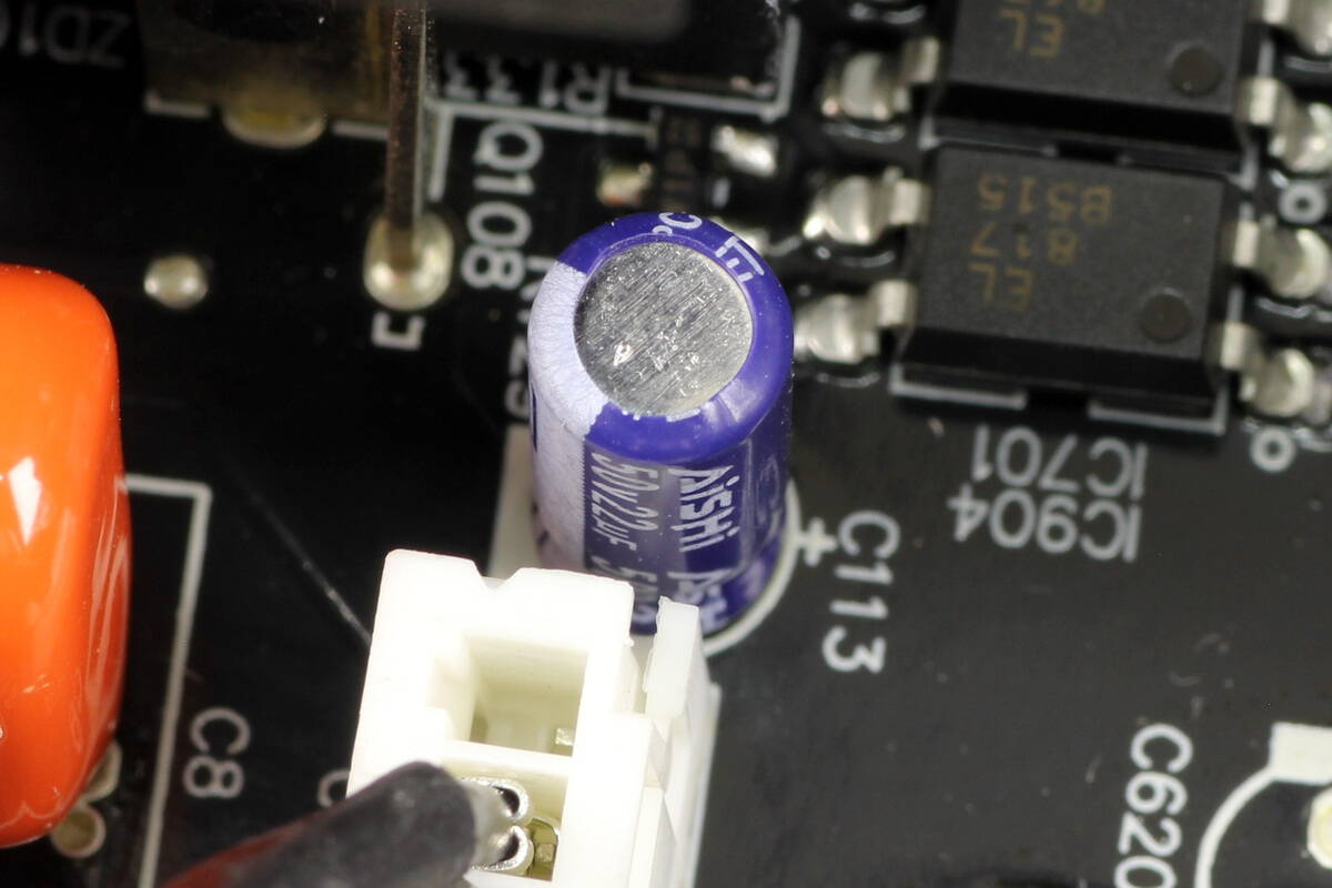

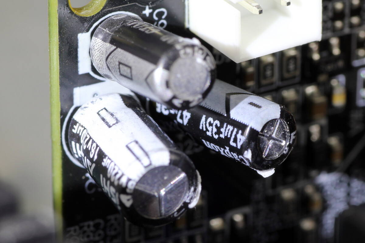

The filter capacitor supplying power to the master control chip is from AiSHi, with a rating of 50 V 22 μF.

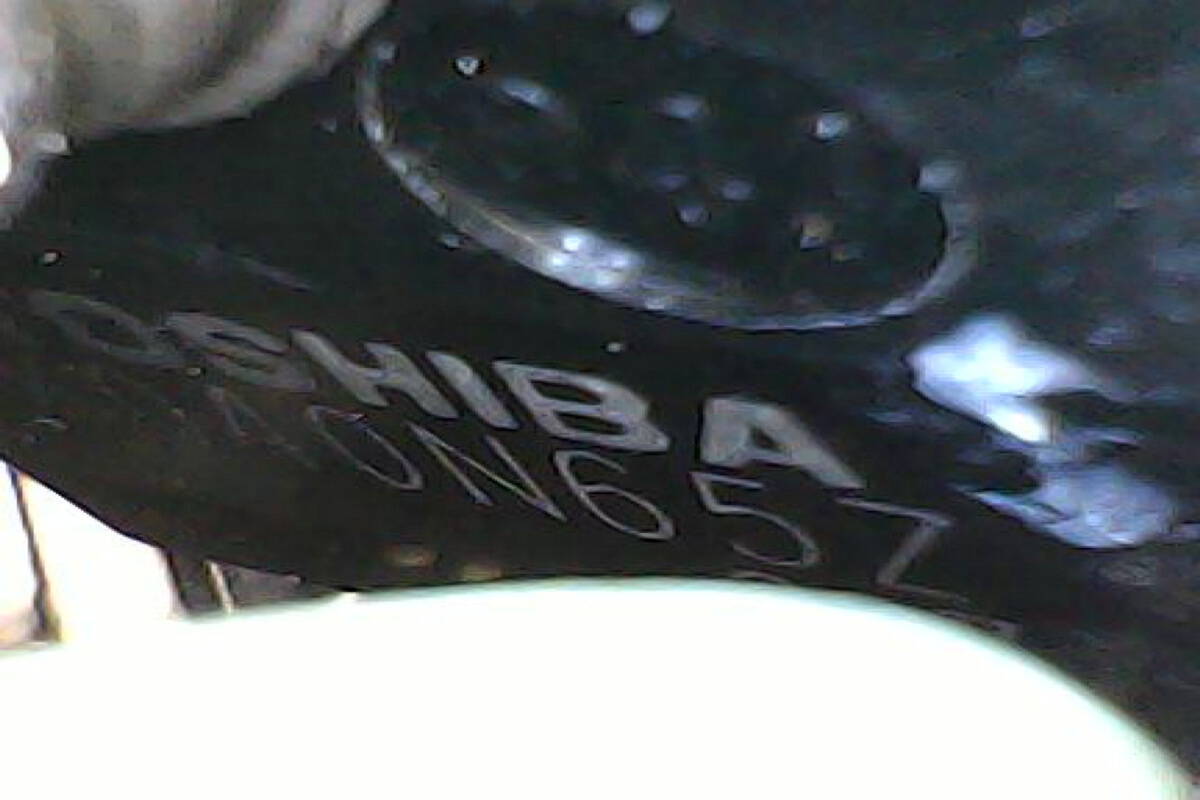

The PFC MOSFET is from Toshiba, model TK040N65Z. It is an N‑channel MOSFET with a voltage rating of 650 V, an on-resistance of 33 mΩ, and comes in a TO‑247 package.

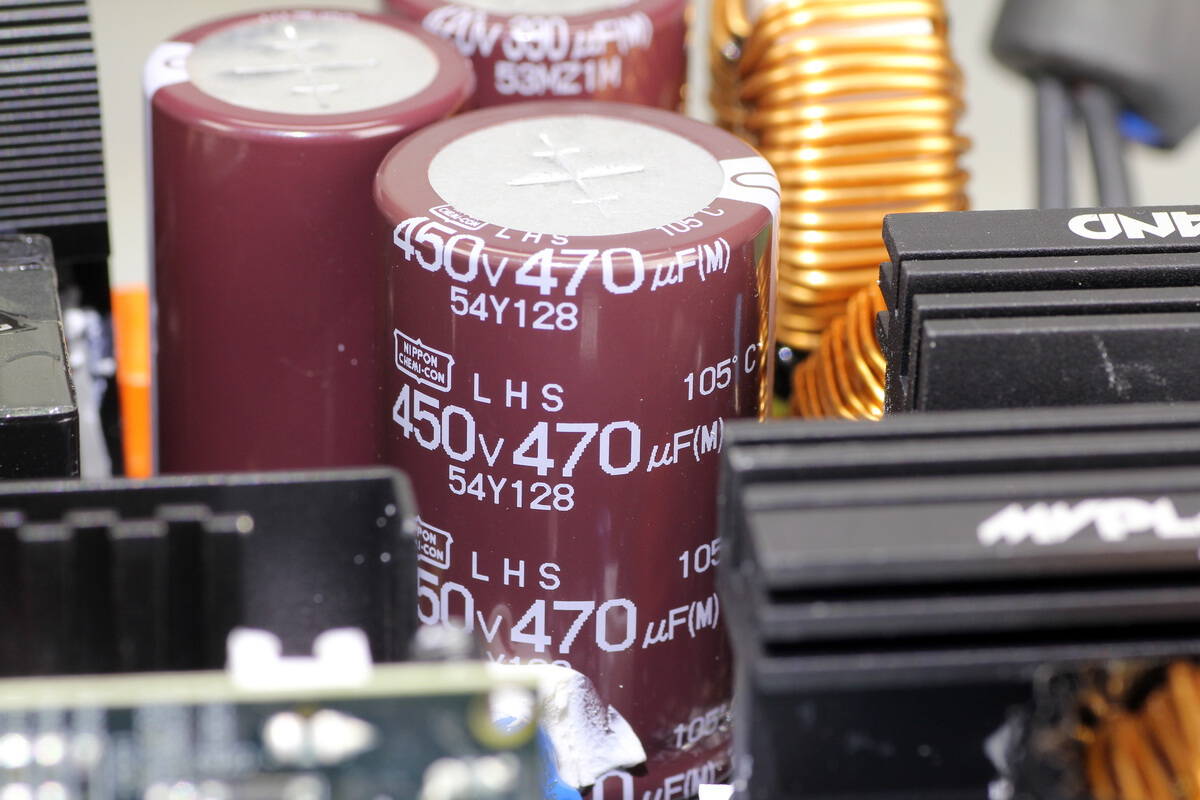

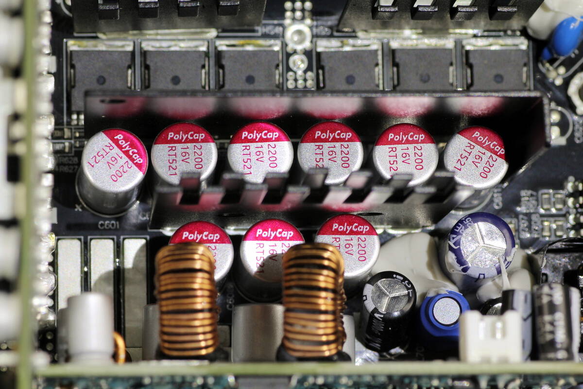

The high-voltage filter capacitor is from NCC, part of the LHS series of long-life electrolytic capacitors, rated at 450 V, 470 μF.
The other two filter capacitors are also from NCC, part of the KMW series of electrolytic capacitors, rated at 420 V, 390 μF.
Another filter capacitor has the same specifications, bringing the total filter capacitance to 1250 μF.

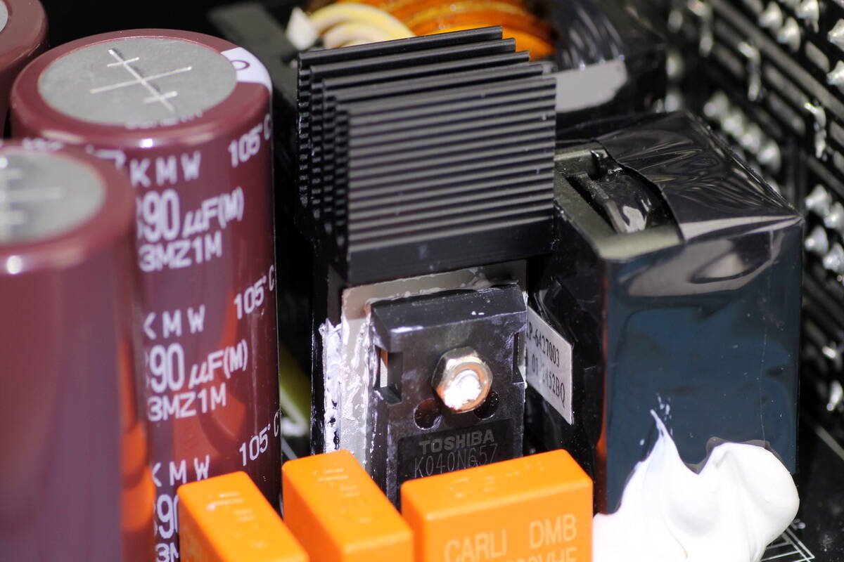

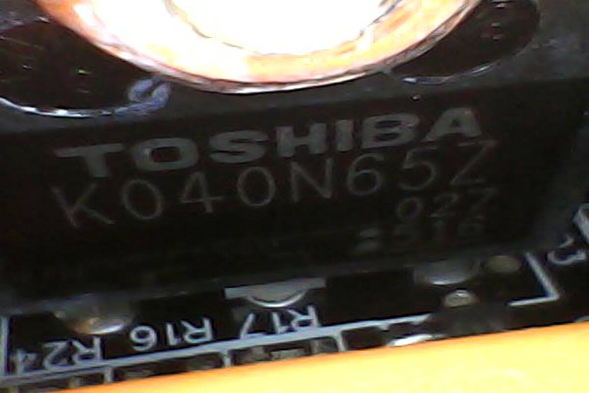

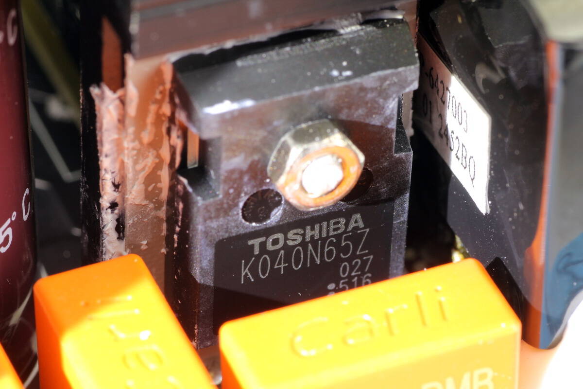

The LLC MOSFET is from Toshiba, model TK040N65Z, and shares the same model as the PFC MOSFETs.

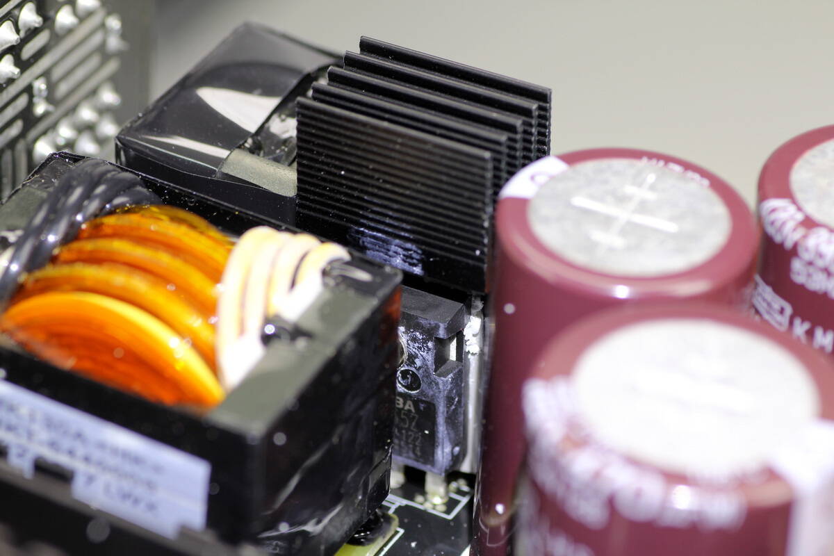

The transformer primary is wound with multi-layer insulated wire, the secondary is fabricated with soldered copper foils, and a bakelite board is installed at the base for insulation.
Copper foils are soldered to the base of the transformer to enhance current-carrying capability.

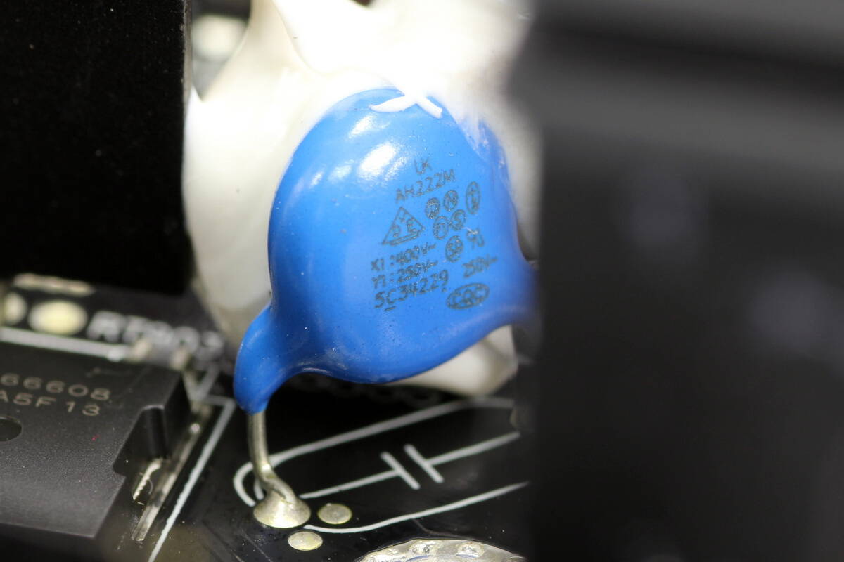

The blue Y-capacitor is from Walsin, part number AH222M.
A heat sink is installed beneath the transformer to dissipate heat from the synchronous rectifiers.

Six synchronous rectifiers are installed in the middle of the heat sink.

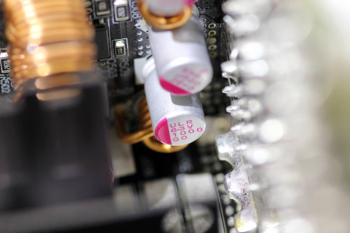

The output filter capacitors are from PolyCap, part of the RT series of solid-state capacitors, rated at 2200 μF, 16 V, with a total of nine units installed.
Copper foils are also soldered to the bases of the corresponding filter capacitors to enhance current-carrying capability.
On the outer side of the buck PCB, there is a synchronous buck controller, synchronous buck MOSFETs, a control IC, and a voltage comparator.

The synchronous buck controller for 3.3 V and 5 V is from ANPEC, model APW7159C. It is a dual-channel synchronous buck controller with excellent output voltage regulation, integrated soft-start and patented soft-stop features, a built-in bootstrap diode, and support for output overvoltage, undervoltage, and overtemperature protection. It comes in an SOP-20 package.

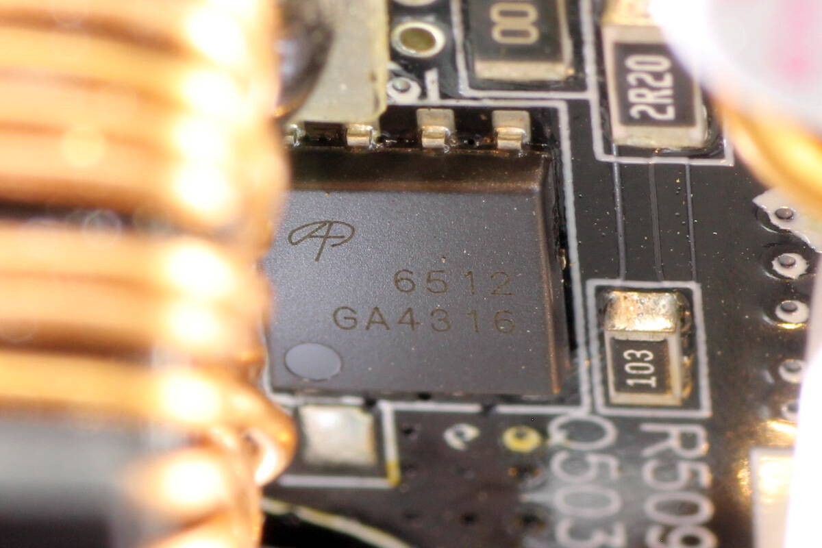

The synchronous buck MOSFETs are from AOS, model AON6512. They are NMOS transistors with a voltage rating of 30 V and an on-resistance of 1.7 mΩ, featuring low gate charge and high current capability, suitable for DC/DC converter applications, and come in a DFN 5×6 package.

The power management IC is from Infineontrix, model IN1S429I-SCG. It provides overvoltage, undervoltage, overcurrent, short-circuit, and overtemperature protection for 3.3 V, 5 V, and 12 V outputs, and comes in an SOP-14 package.

There are three filter capacitors, one of which is from CapXon, rated at 47 μF, 35 V.
Another capacitor is from AiSHi, rated at 220 μF, 16 V.
The remaining capacitor is from SAMXON, rated at 4.7 μF, 50 V.

The power supply filter capacitor is from CapXon, rated at 47 μF, 35 V.

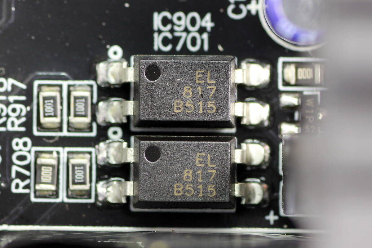

An Everlight EL817 optocoupler is used for output voltage feedback.
A close-up of the other two EL817 optocouplers.
A close-up view of the EL817 optocoupler.

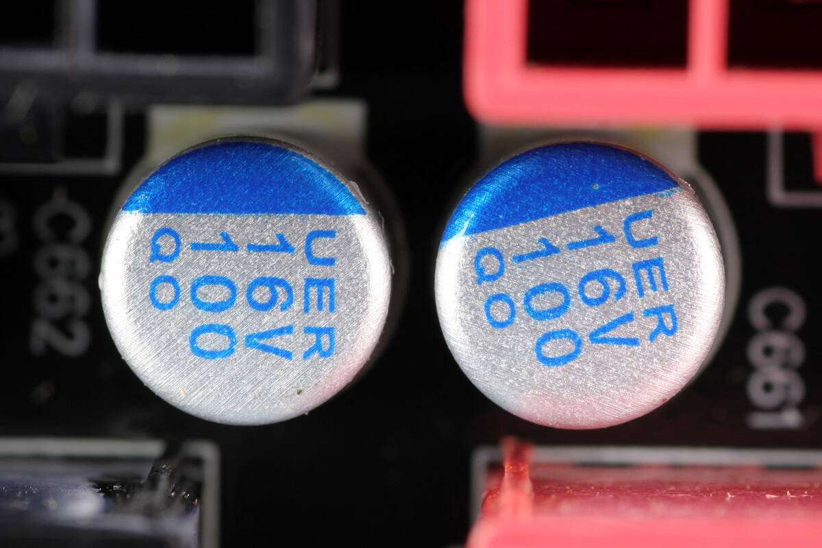

The UER solid capacitors are rated at 100 μF, 16 V, with a total of 14 units.

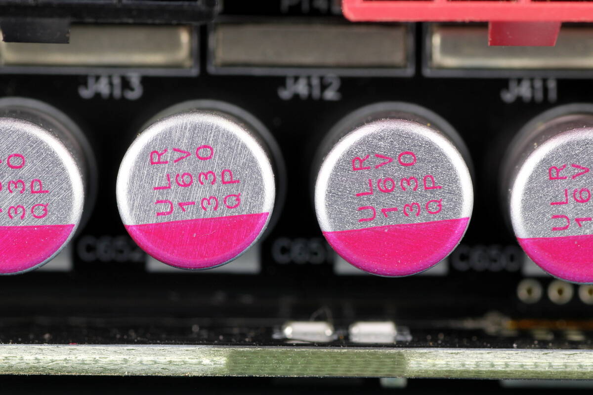

The ULR solid capacitors are rated at 470 μF, 6.3 V, with a total of eight units.

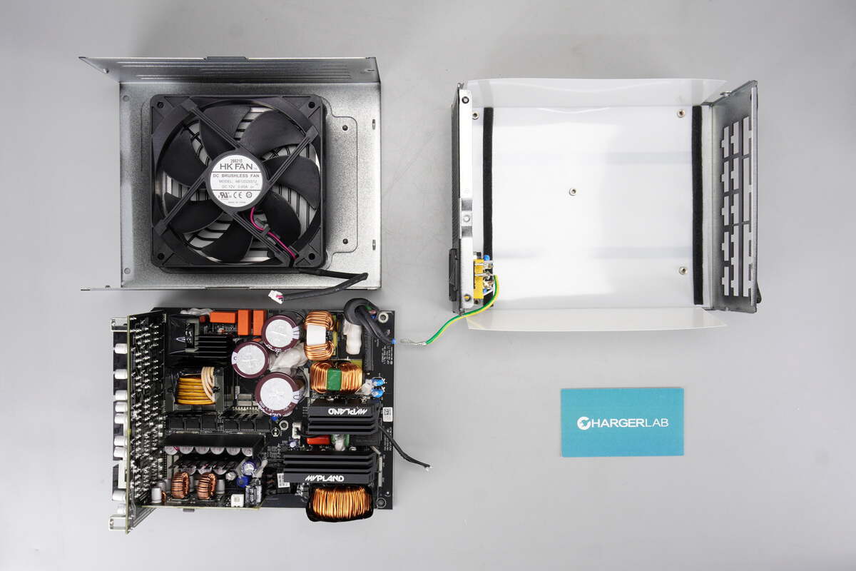

After taking it apart, we found that it uses an active PFC + half-bridge LLC + synchronous rectification + DC-DC architecture. It is controlled by an NXP HKP6288AT main controller, which is a digital power IC for PFC and LLC control. The PFC and LLC MOSFETs are Toshiba TK040N65Z, and the PFC rectifiers use STMicro STPSC8H065D silicon carbide diodes.
The synchronous rectifier controller is an NXP TEA2095 paired with AOS AOTL66608 synchronous rectifiers. The synchronous buck controller is an ANPEC APW7159C, paired with AON6512 MOSFETs for 3.3 V and 5 V step-down outputs. High-voltage filter capacitors are from NCC, and solid capacitors are from PolyCap and SAMXON. The construction is robust, and the components are reliable.
