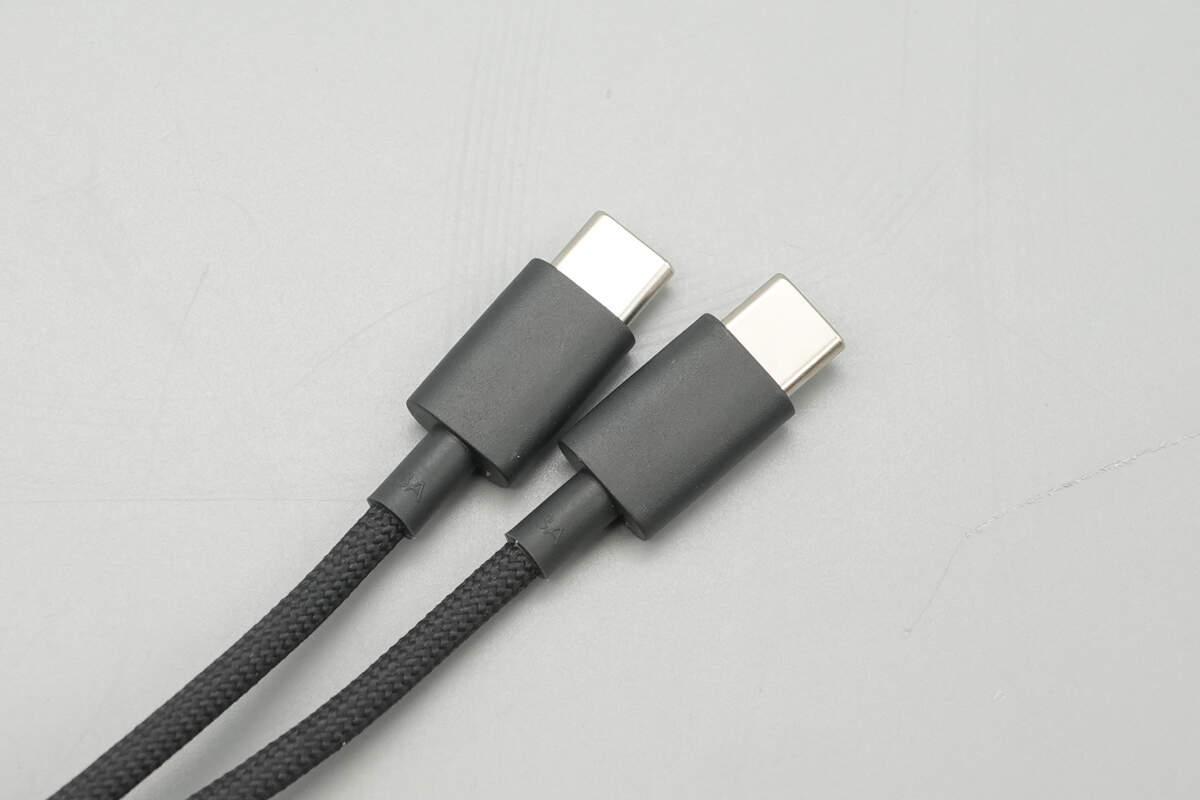

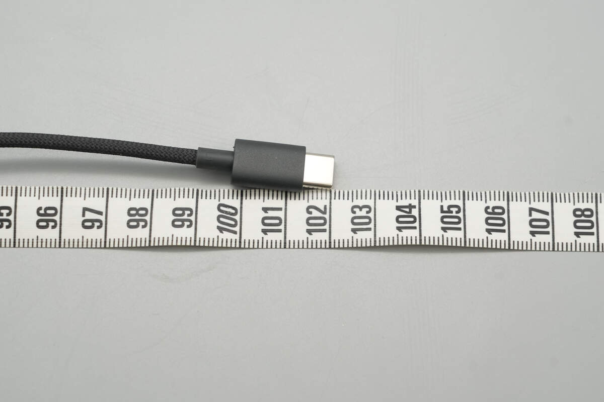

The included cable is a 3A USB-C to USB-C cable with a braided design.
Teardown of Xiaomi 30W Car Magnetic Wireless Charger (MDY-20-ED)-Chargerlab
The length of the cable is about 102 cm (40.16 inches).

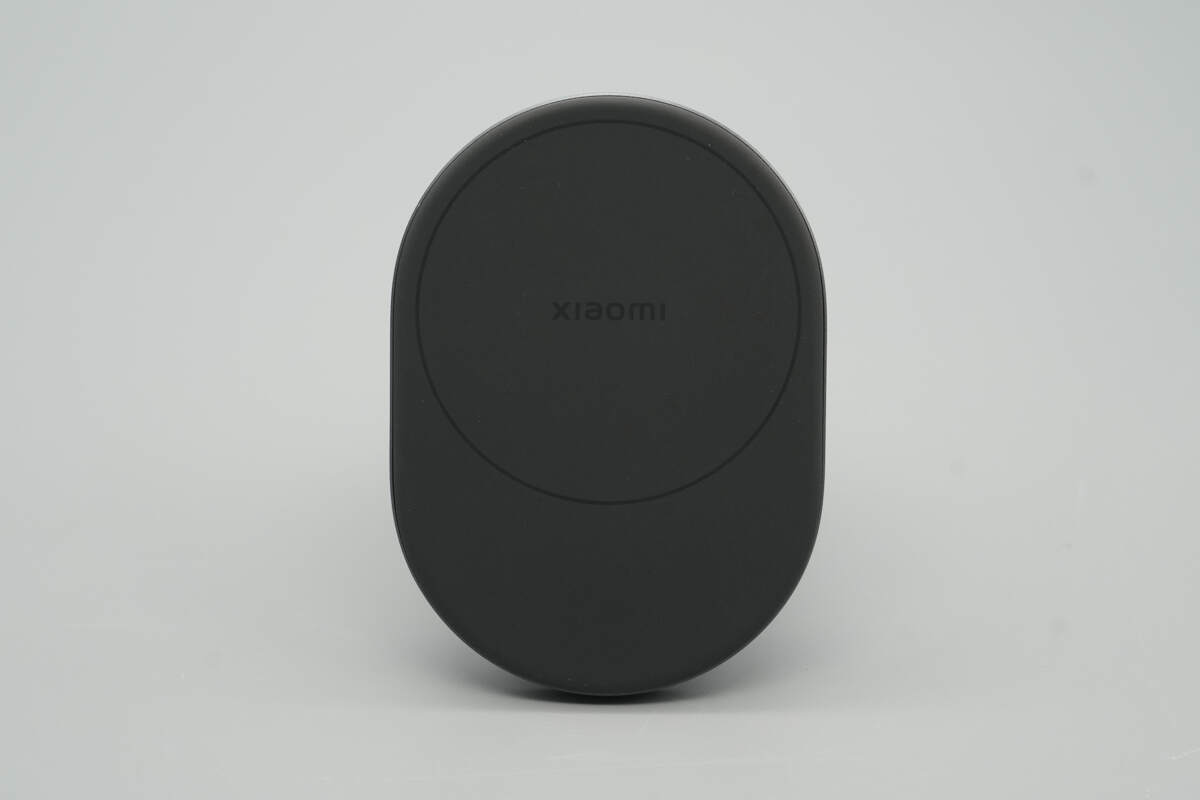

The wireless charging area features a circular, with the Xiaomi logo at the center.

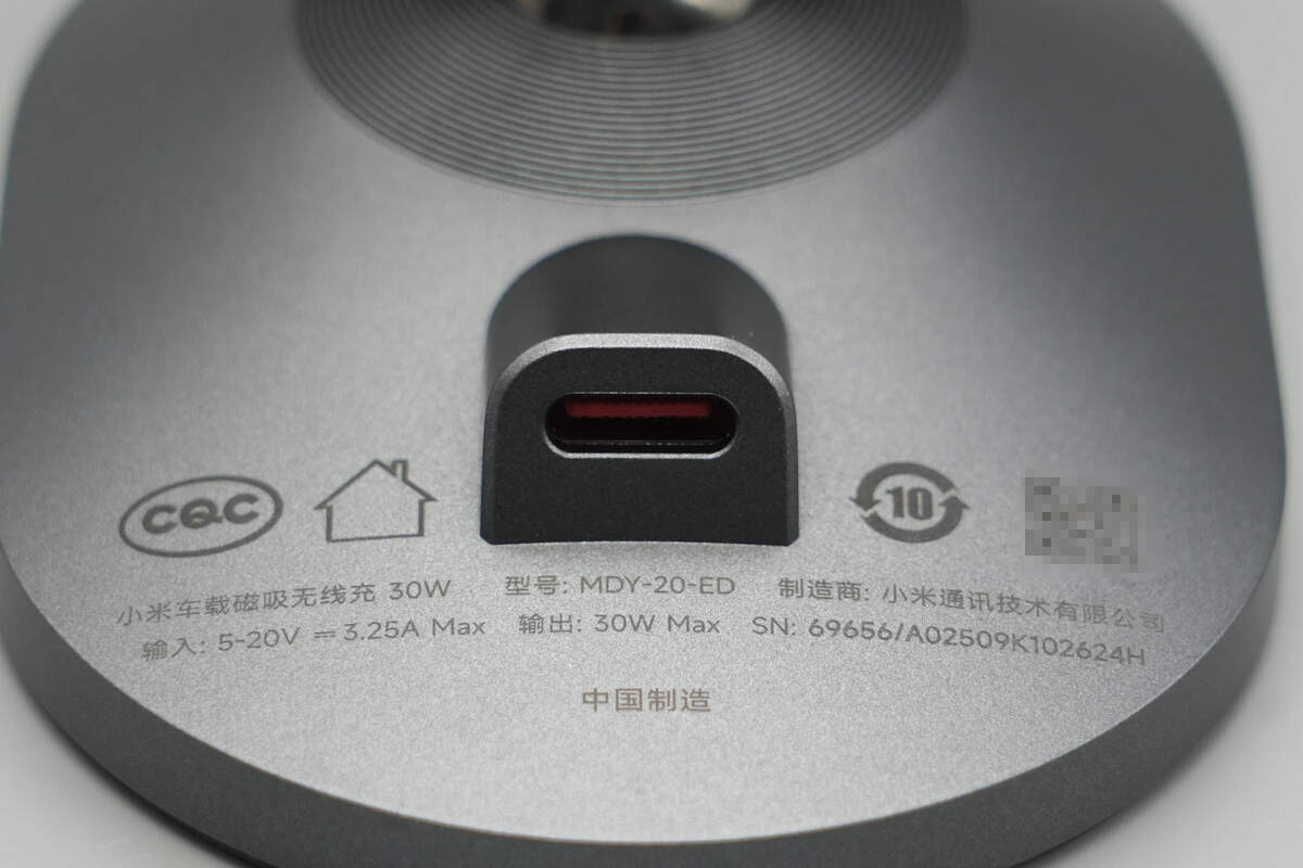

The back of the panel displays the specifications.
Model: MDY-20-ED
Input: 5-20V 3.25A Max
Output: 30W Max
The product is CQC certified.
This is the USB-C input port.

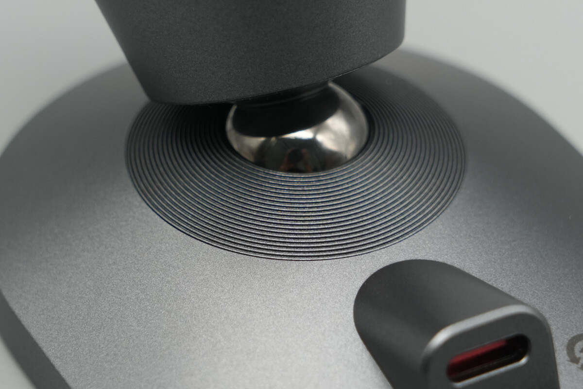

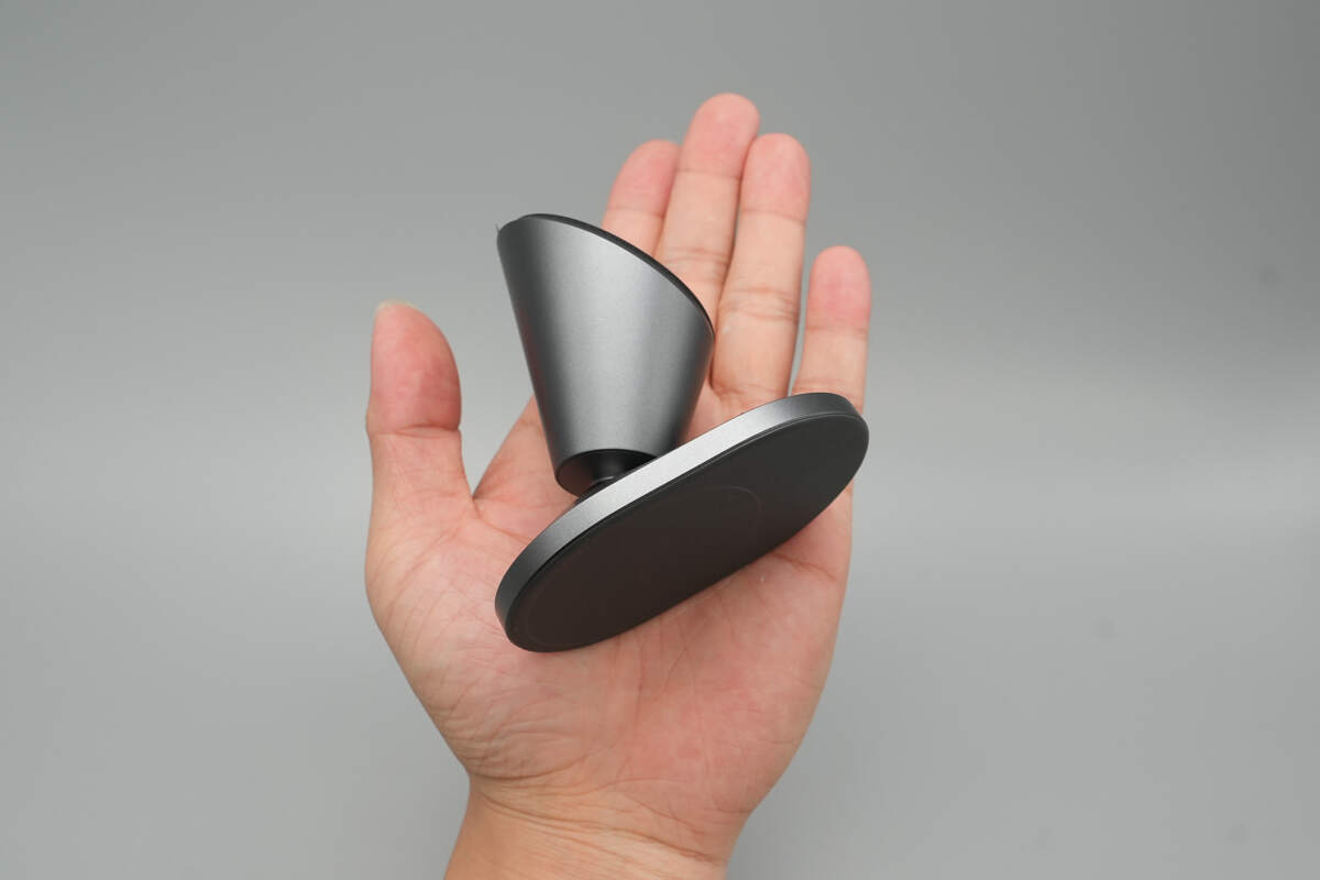

The ball head is made of metal.

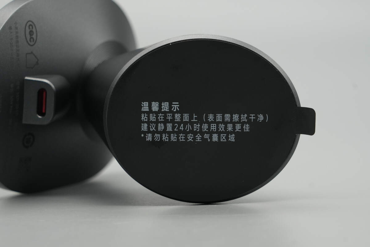

It supports both adhesive and clamp mounting options. The base's adhesive sticker features important instructions.

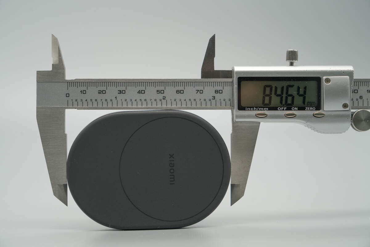

The length of the panel is about 84.64 mm (3.33 inches).

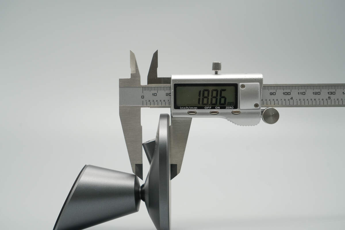

The thickness is about 18.86 mm (0.74 inches).

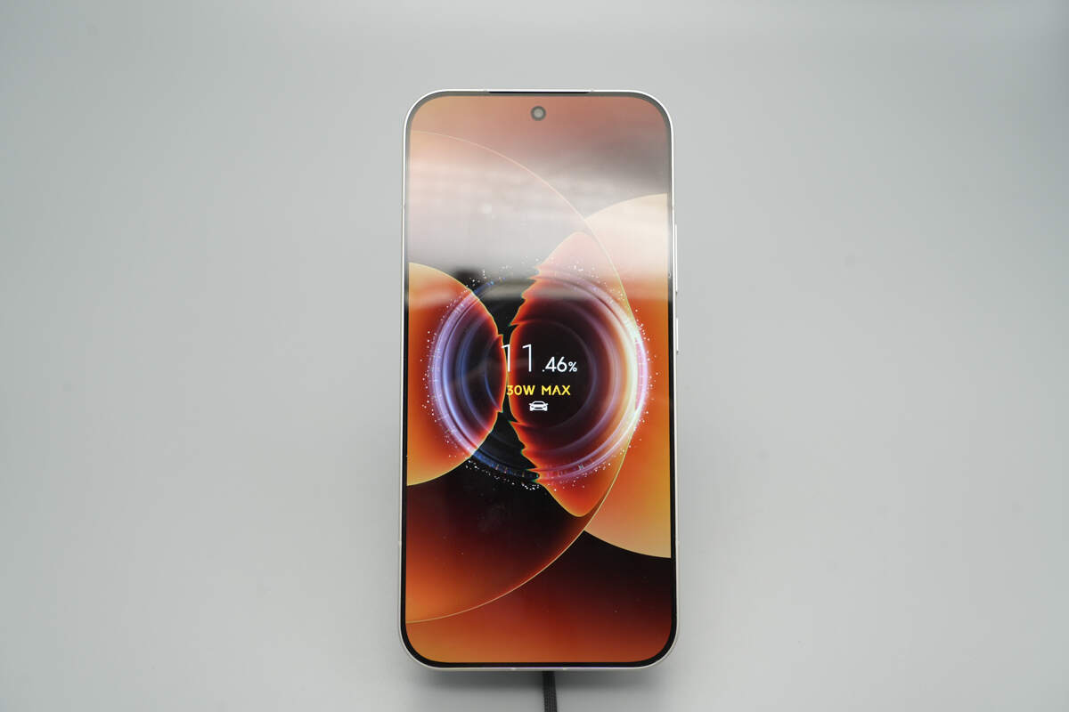

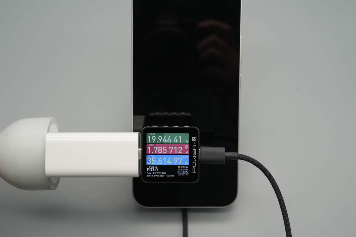

Once powered on, the phone successfully activates 30W wireless fast charging.
When the wireless charging power stabilizes, the output power of the charger is about 35.61W.

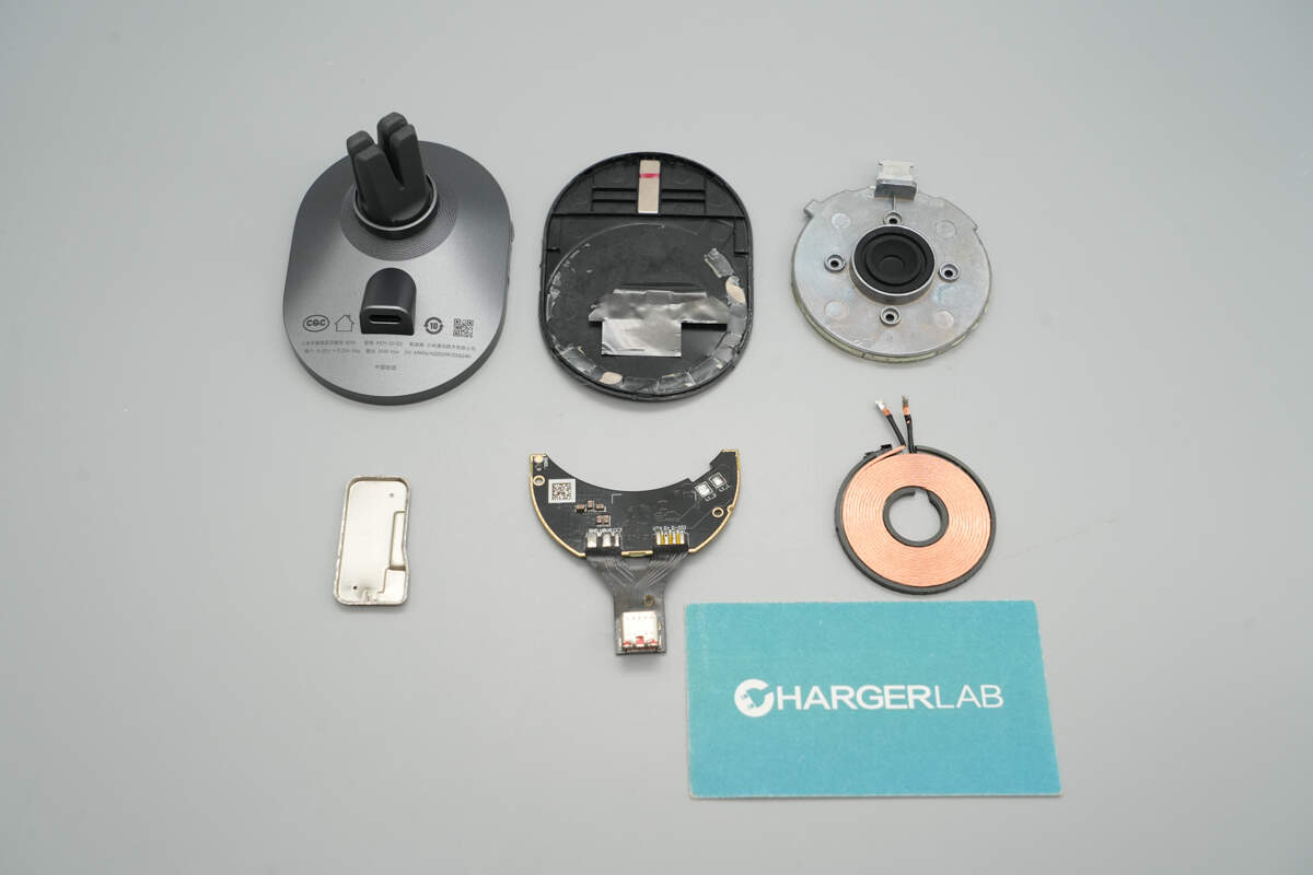

Next, let's start to take it apart and take a look at the internal components.
Remove the front cover of the magnetic charging panel. On the inside of the cover, there is a strip-shaped magnet.
The magnet ring is fixed with adhesive, and the PCB is secured with screws.
The wireless charging coil is soldered to the PCB, with well-formed solder joints.
Beneath the wireless charging coil, there is a metal heat dissipation plate, which is secured with screws.
Remove all the internal components from the charging panel.

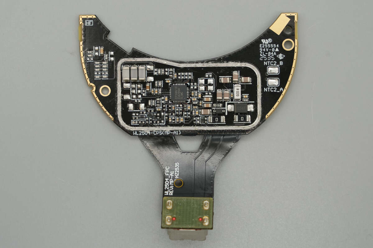

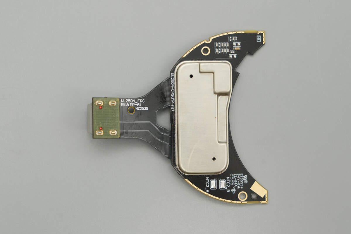

The front of the PCB features a shielded cover over the wireless charging circuitry.
Remove the shield, revealing the wireless charging chip, NPO resonant capacitors, and other components.

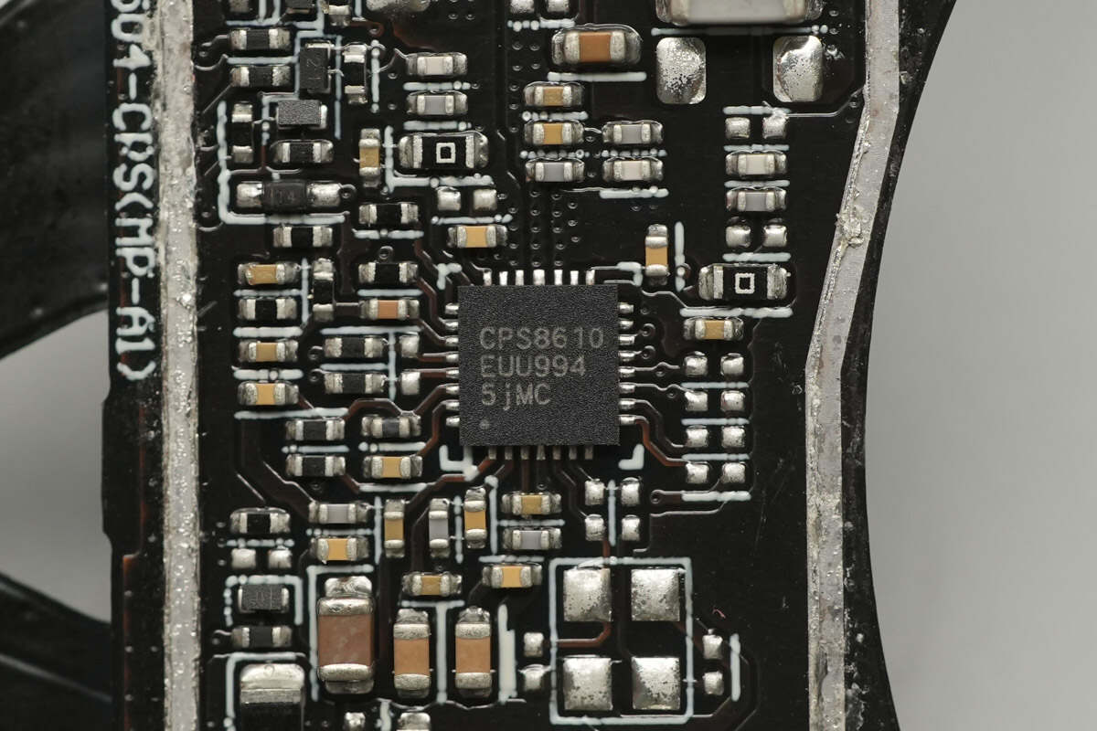

The wireless charging chip is from CPS, model CPS8610. It is a highly integrated wireless charging transmitter chip with an embedded fast charging protocol. It supports fast charging power delivery, controls the external boost converter to supply power to the wireless charging stage, and allows for the connection of an external safety chip. The chip integrates a wireless charging power transistor, simplifies surrounding components, and uses an FCQFN package.

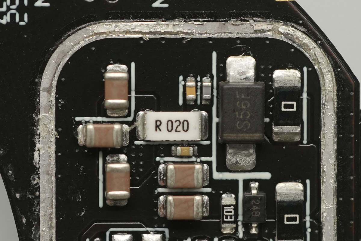

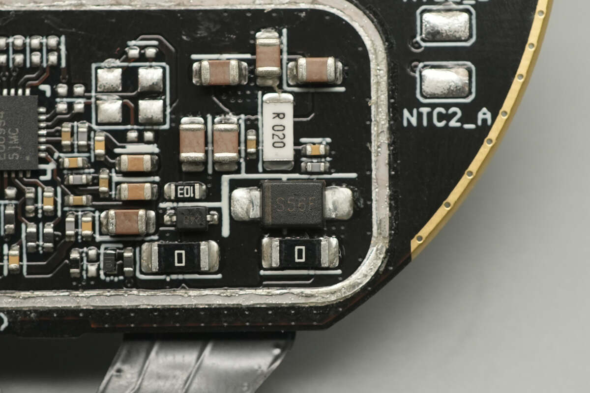

Close-up of the 20mΩ current sensing resistor.
A diode used for reverse polarity protection, marked with S56F.

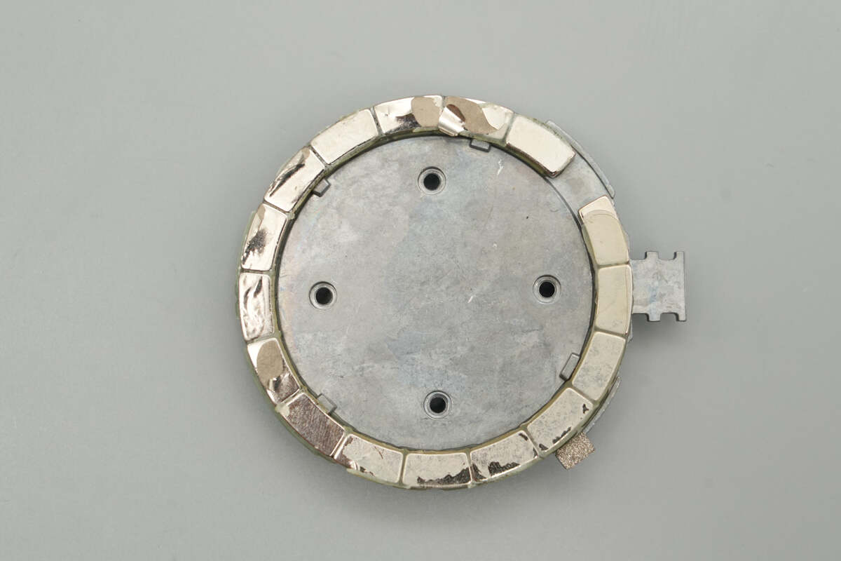

Close-up of the magnet ring and the metal plate.

Well, those are all components of the Xiaomi 30W Car Magnetic Wireless Charger.

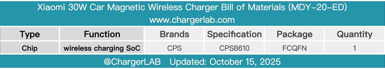

Here is the component list of the Xiaomi 30W Car Magnetic Wireless Charger for your convenience.
