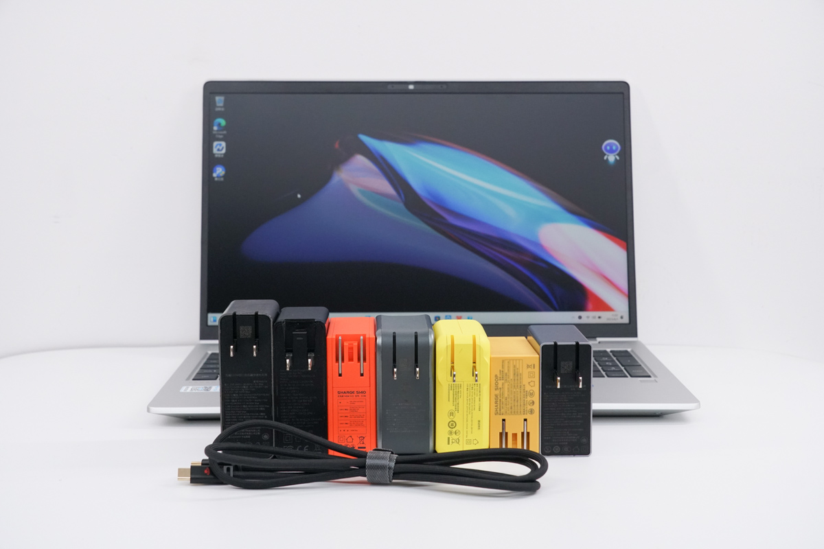

These are the 140W-rated third party chargers used in this test. They include brands such as Nubia, UGREEN, AOHi, and others.
