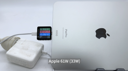

Switching to a 61W charger increases the input power to 14.71V 2.2A 33.27W.
