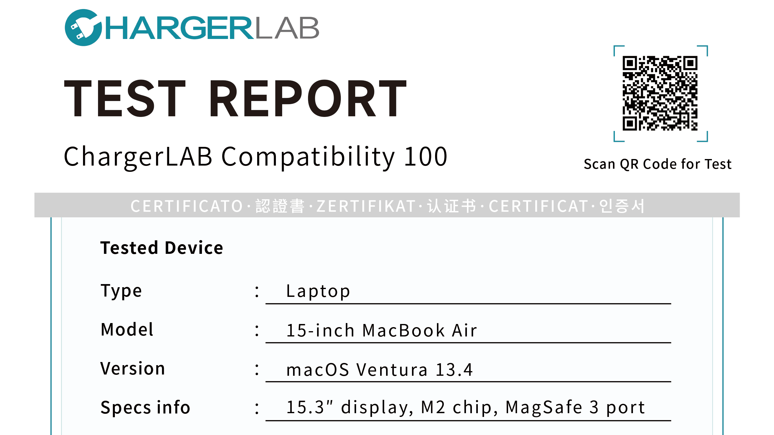

A few days ago, ChargerLAB presented a compatibility 100 test video for the Apple 15-inch MacBook Air. Now, we will provide a detailed textual description, including more data, to give everyone a clearer understanding of the charging compatibility of this laptop.
Apple 15-inch MacBook Air | ChargerLAB Compatibility 100 Reveals Charging Details-Chargerlab
It features the latest M2 chip and a 15.3-inch display. The official claim is that it is fast-charge capable with a 70W USB-C power adapter.
Charging Compatibility Test
The compatibility test segment provides a clear understanding of how the device charges with different devices. ChargerLAB will use 100 charging devices to charge the Apple 15-inch MacBook Air, allowing everyone to have a comprehensive understanding of its charging compatibility.
Charger
These are the 100W-rated chargers used in this test, all paired with the MagSafe 3 cable. They include brands such as Nubia, UGREEN, AOHi, and others.
First, let's take the AOHi 140W charger (model: AOC-C102) as an example. Using the ChargerLAB POWER-Z KM003C, it was determined that this charger can provide 69.63W of power to the Apple 15-inch MacBook Air and successfully trigger the PD fast charging protocol.
The test data is summarized in a table, indicating that all the high-power chargers tested can trigger 20V output, with most power outputs falling within the range of 60-70W.
A bar graph is plotted, and it is evident that the Apple's own charger, specifically the 96W model, stands out. At first glance, an interesting phenomenon is observed: all the data form a stepped pattern. Upon closer inspection, it becomes clear that each step corresponds to the maximum output power of these chargers. Undoubtedly, the compatibility is top-notch.
Moving on to power banks, out of the 10 models tested, no incompatibilities were found. However, the voltage situation varied significantly, making it difficult to observe differences at a glance.
A bar graph is plotted, and it shows that the Red Magic 10000mAh power bank (model: P01CT) has the highest charging power. The top three power banks all reach a charging power of over 60W. While the lower-powered models did not exhibit any incompatibilities, it is still recommended to use high-power power banks for charging the laptop to achieve a better charging experience.
Finally, let's discuss portable power stations. Out of the ten models tested, eight triggered the 20V output.
Once again, a bar graph is plotted, and it shows that the EcoFlow DELTA mini 1700W power station (model: EFD320) has the highest charging power. Except for the Jackery 2000W and YooBao 500W power stations, which have lower charging powers not exceeding 20W, the rest of the devices fall within the range of 60-70W, which is quite impressive.

In conclusion, the charging compatibility of the Apple 15-inch MacBook Air can be deemed as highly impressive. The extensive testing conducted with various chargers, power banks, and portable power stations revealed a consistent and robust performance. From the 20W-rated chargers to the power banks and portable power stations tested, the MacBook Air showcased remarkable compatibility.
Whether it was the Apple's own charger or third-party options, the laptop demonstrated seamless charging capabilities, ensuring a reliable and efficient charging experience. With its ability to handle different charging devices with ease, the Apple 15-inch MacBook Air undoubtedly stands out as a top choice for users seeking exceptional charging compatibility.
