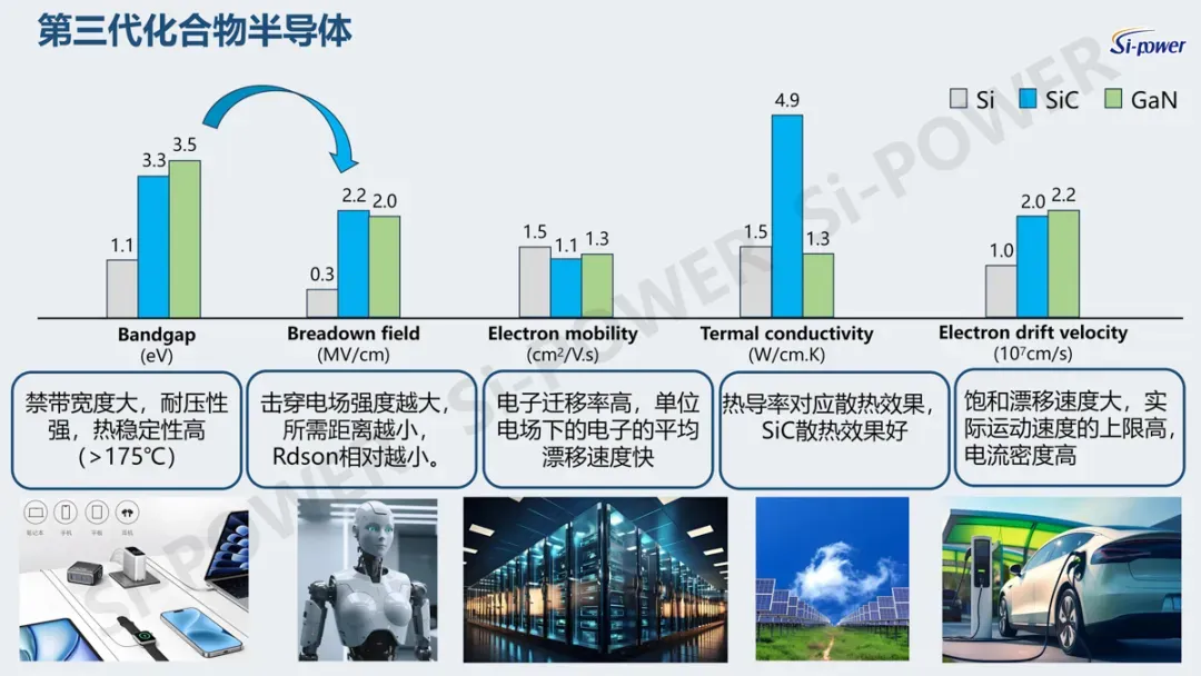

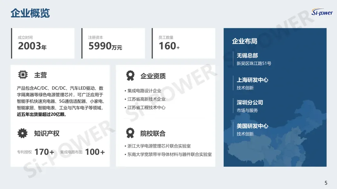

With over 20 years of expertise in green power management, Si-Power is harnessing the superior electron mobility and thermal conductivity of wide-bandgap semiconductors to shrink components and supercharge power density in fast chargers and home appliances.

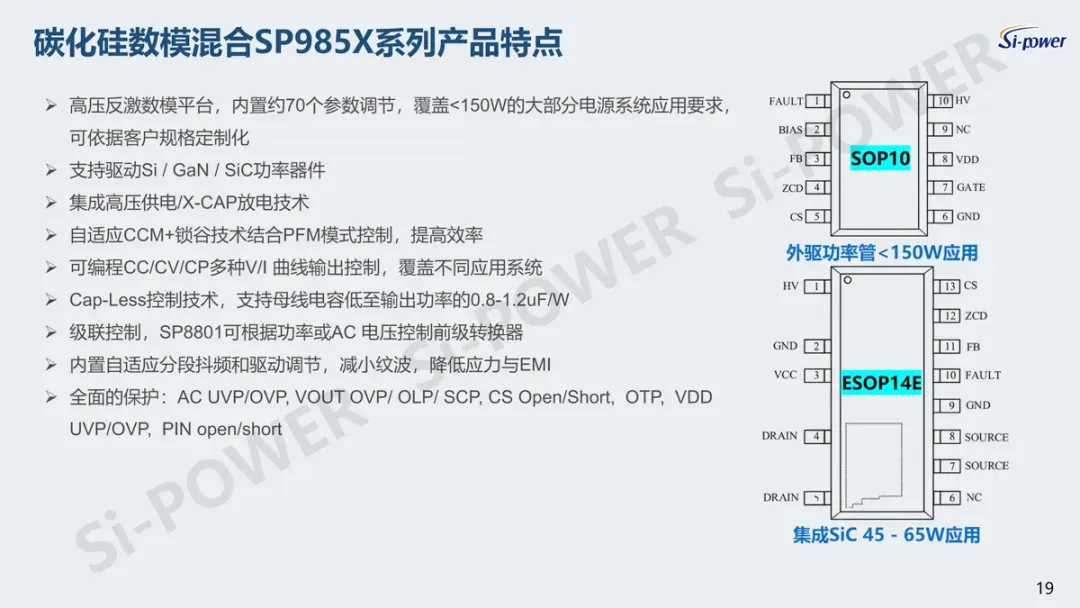

Si-Power’s SiC lineup brings game-changing thermal resilience, high-frequency operation, and rock-solid reliability to the table. In consumer fast charging, their pioneering SP9477 series (featuring an integrated 700V/380mΩ SiC MOSFET) has been widely adopted by over 20 mainstream OEMs, delivering a stunning 94.29% efficiency at 20V output while passing brutal 20KV ESD and 4KV surge testing with zero avalanche risk.
Pioneering the Fast-Charge Revolution, Si-Power’s SiC Innovations Set the Pace in Charging Technology-Chargerlab

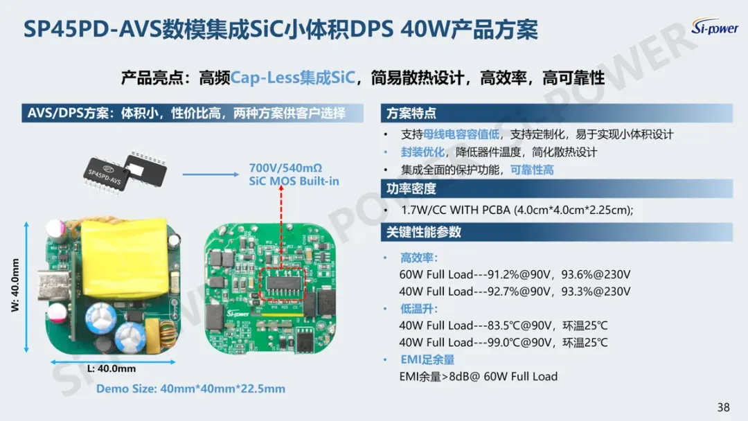

Paired with the SP9857E digital-analog hybrid flyback controller—which leverages patented Cap-Less digital control and adaptive CCM—developers can drastically cut down bulk capacitor size. The result is a fanless 65W adapter that keeps full-load temperature rises under 91.4℃, shrinking PCBA footprints and streamlining EMI design.
