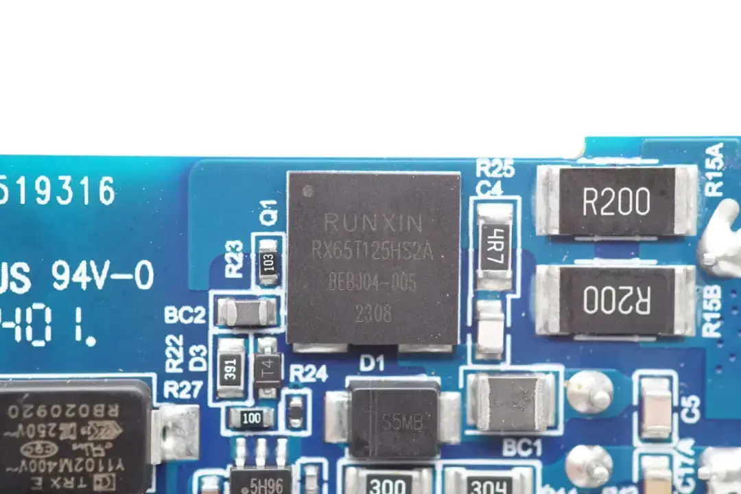

During a routine teardown of the Philips charger, it was found to incorporate the RX65T125HS2A, a 650V GaN MOSFET from RUNXIN Micro. Paired with the primary controller chip, this component helps manufacturers deliver a high-efficiency and safe charging experience for users.

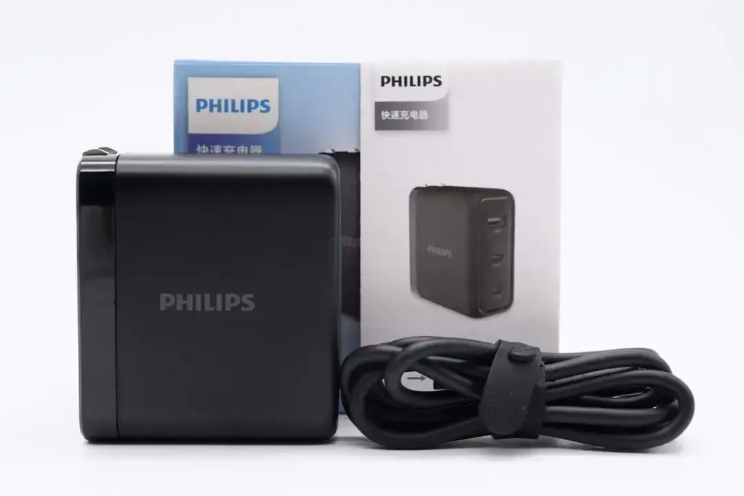

The product packaging is simple, including the charger, a 20V 5A black USB-C cable, and an instruction manual.

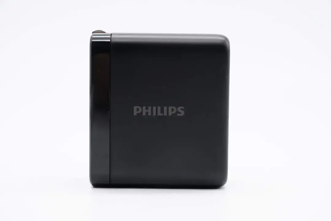

The charger has PHILIPS printed on the center of the front, and the shell is made of PC flame-retardant plastic. The plastic sheets of the two USB-C and the USB-A ports are all orange.
RUNXIN RX65T125HS2A
RUNXIN's GaN Chips Enter Philips Supply Chain-Chargerlab

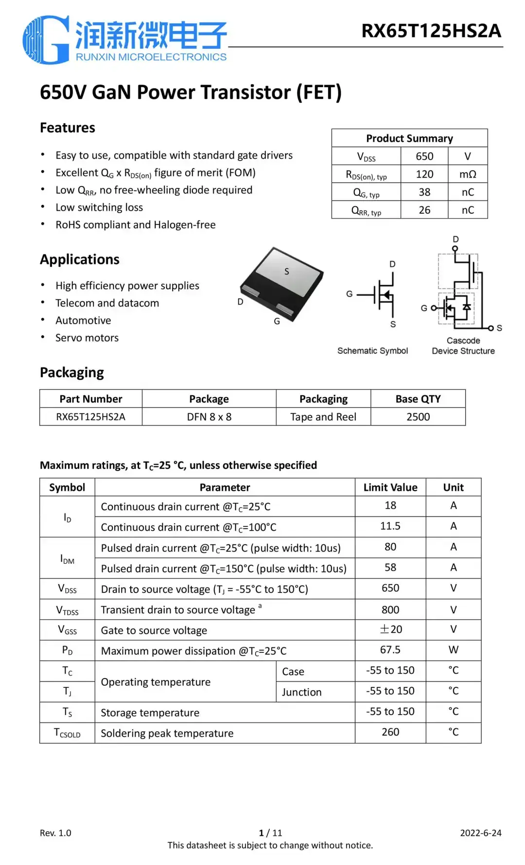

RUNXIN RX65T125HS2A, with a withstand voltage of 650V and a resistance of 125mΩ. The gate supports a withstand voltage of 20V. It complies with RoHS regulations, is halogen-free, and adopts the QFN8*8 package.
This device features low switching losses and is compatible with traditional silicon drivers, eliminating the need for a freewheeling diode, which effectively reduces the overall cost. It can be widely applied in various scenarios, including PD fast charging, communication equipment, automotive applications, and servo motors.
