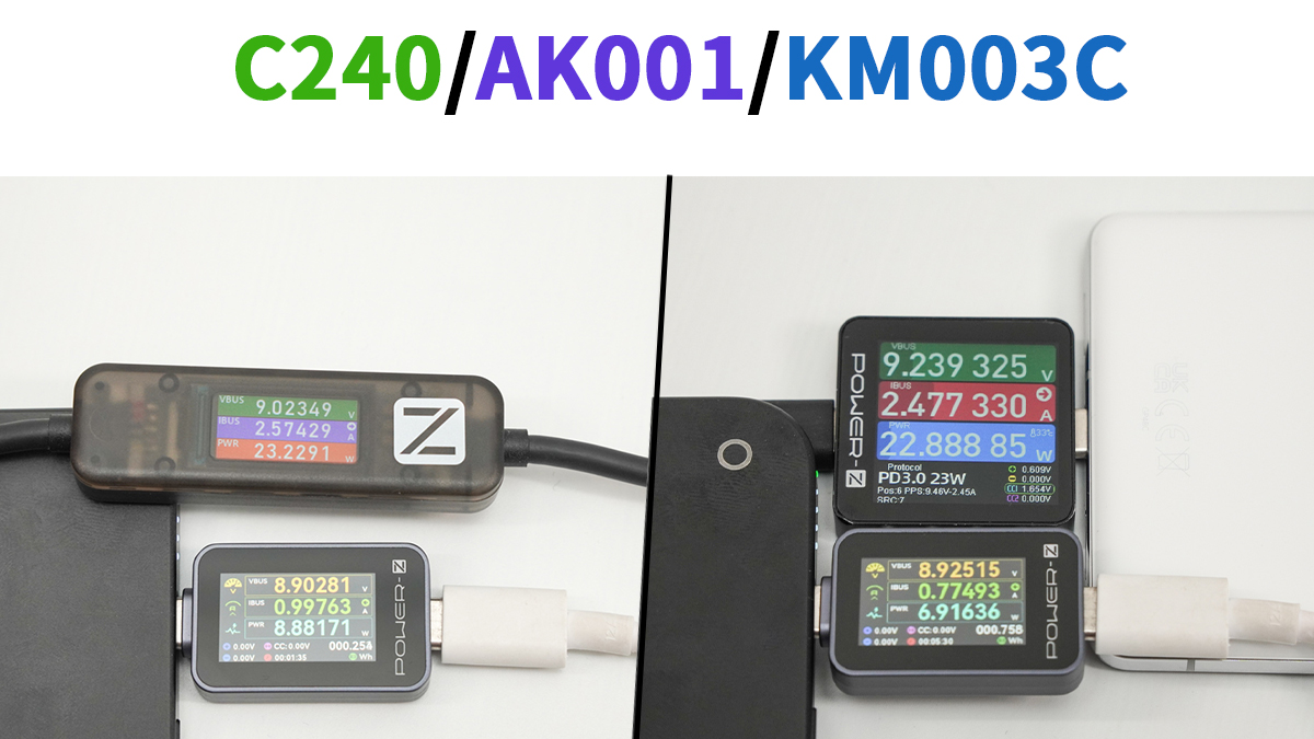

Compared to our own products, the ChargerLAB POWER-Z C240 tester offers many basic functions like voltage and current measurement at a much lower price than the KM003C, and it has a relatively narrow design, resembling a mini version of the KM003C, making it even more portable. When compared to the AK001 at the same price, it boasts a larger 1.14-inch IPS color display, providing clearer visibility of various testing information.

The first line of the color display shows real-time voltage, the second line shows real-time current with an indicator of the current direction on the right side. This means it supports bidirectional current, allowing you to detect both the discharge status of power banks and the charging performance of chargers. The third line displays charging power. At the bottom, you can find D+, D-, CC, charging timer, and accumulated energy input (Wh). This tester supports voltage up to 50V, current up to 6A, and a maximum power of 240W, perfectly catering to the testing needs of the vast majority of smartphones, tablets, laptops, including the latest PD3.1 protocol with 140W.
