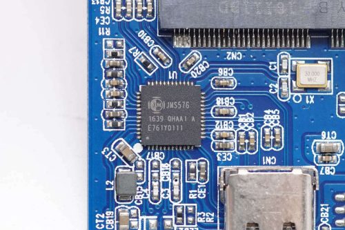

JMicron JMS576
The JMS576 is a high-performance USB 3.1 Gen1 to SATA 6Gb/s bridge controller designed and manufactured by JMicron. This chip integrates a USB Type-C multiplexer and device CC control logic, making it ideal for USB Type-C storage solutions.
JMicron JMS576: A Reliable USB 3.1 Gen1 to SATA 6Gb/s Bridge Controller-Chargerlab
The JMS576 supports external SPI NVRAM for providing Vendor ID (VID) and Product ID (PID) to USB 2.0/USB 3.1 Gen1 device controllers. It features 10 customizable GPIOs and allows firmware upgrades via USB 2.0 and USB 3.1 Gen1 interfaces. Additionally, it complies with the USB Mass Storage Class Bulk-Only Transport (BOT) protocol and USB Attached SCSI Protocol (UASP) for enhanced data transfer efficiency.
With its built-in power-saving mode, the JMS576 optimizes power consumption while supporting SHA-1/SHA-256 algorithms for IEEE-1667 digest calculation, ensuring enhanced data security. The chip also supports the ATA/ATAPI PACKET command set, ensuring broad compatibility with various storage devices. Due to these features, the JMS576 is widely used in external HDD/SSD enclosures, NAS storage solutions, and USB-C storage applications, offering high-performance data transfer with efficient power management.
